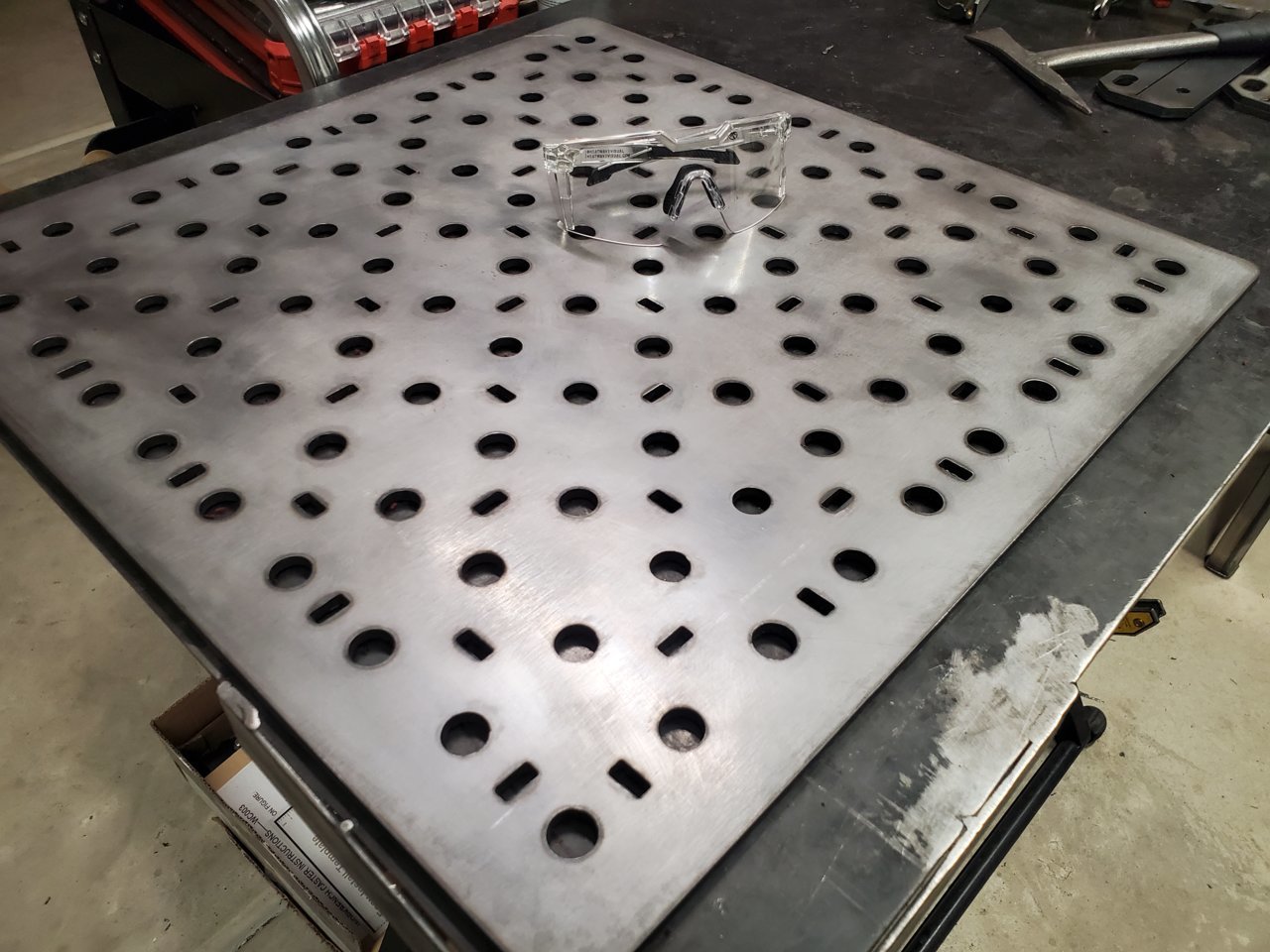

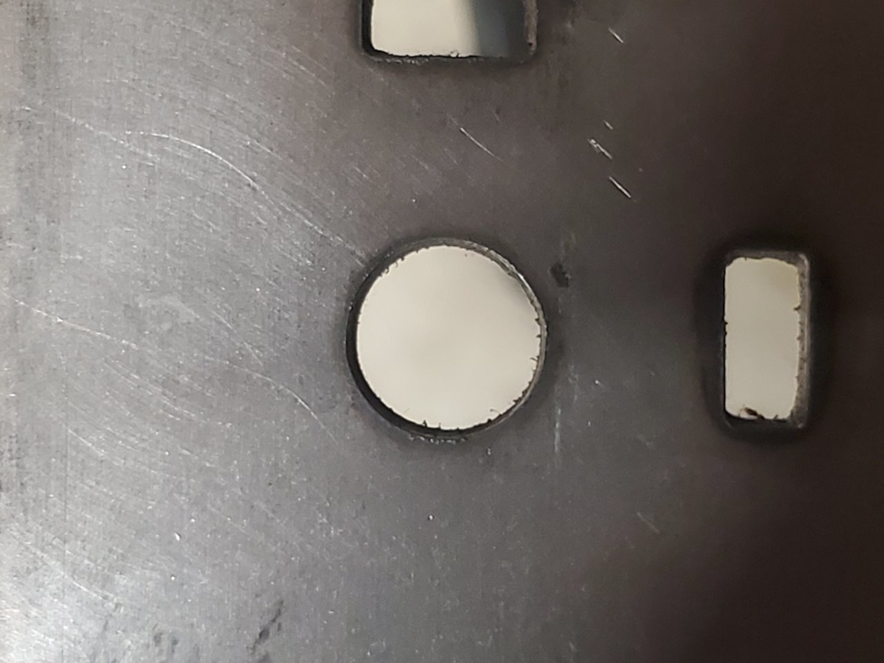

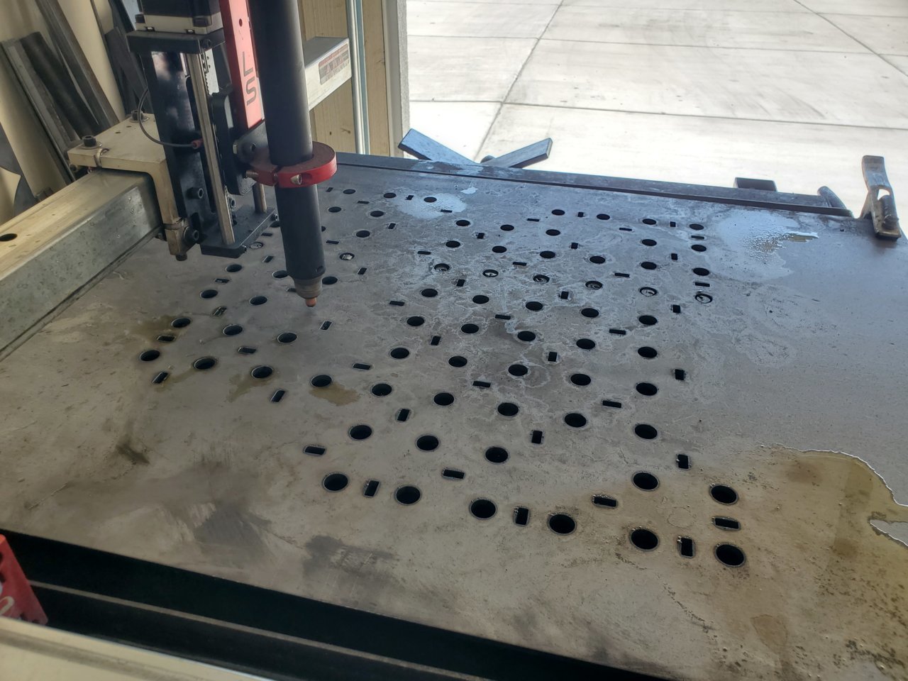

    Got a little bit of slag on the backside but it's too late in the day to mess with it so it's still on there
    Wiped the top with acetone and thought I'd assess the layout

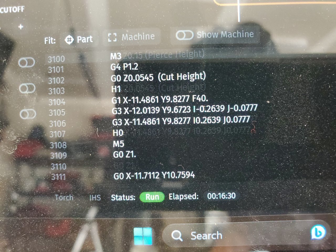

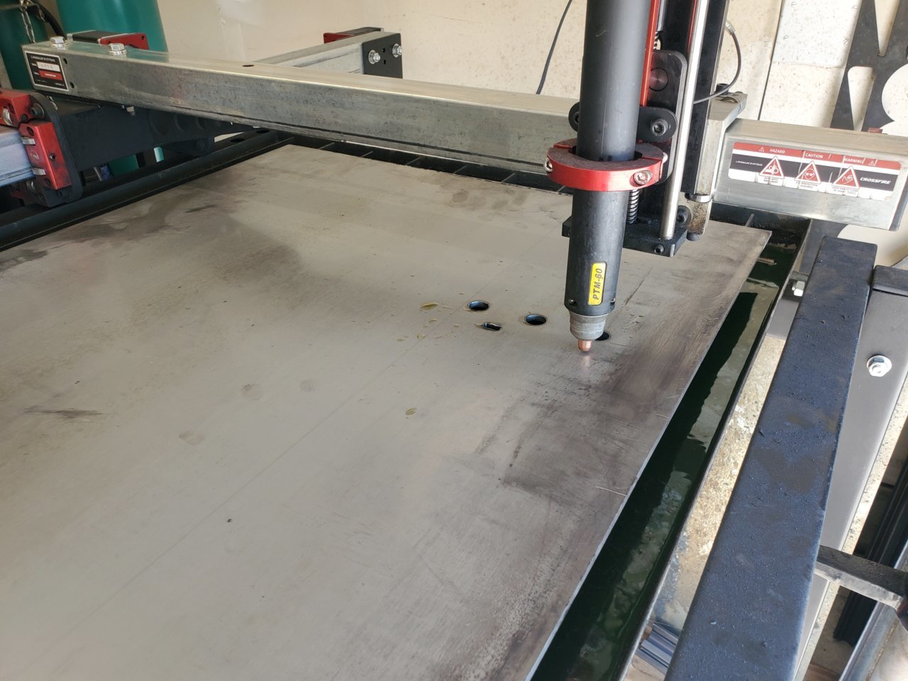

    What I didn't mention is after the first 4 or 5 holes were cut out, I noticed I probably zeroed my z axis way too high (as I had swapped out my nozzle before cutting)
    What I mean is, on initial height sensing, the torch would come down but stop as if hitting an invisible "bump" (without ever touching the workpiece surface), springback and then proceed to cut
    I say this because I have for every file my cut height set to .0545 programmed which brings my torch to .060 actual
    What was actually happening was that the torch was cutting at closer to half an inch above the material surface
    After seeing the holes come out just fine, I ran with it since I didn't want to ruin clean steel
    There's always a tiny bit of beveling though with plasma anyway, it'll never be as accurate as laser
    I'll call it "good enough"
    Holes have never been an issue for me, I'm just worried about the small rectangular cutouts
    If I have to file them out a big then no biggie
    I've read about people needing to hand ream holes on their fab tables that were bought brand new; I'd be beyond pissed if I had to do that on something "laser cut"

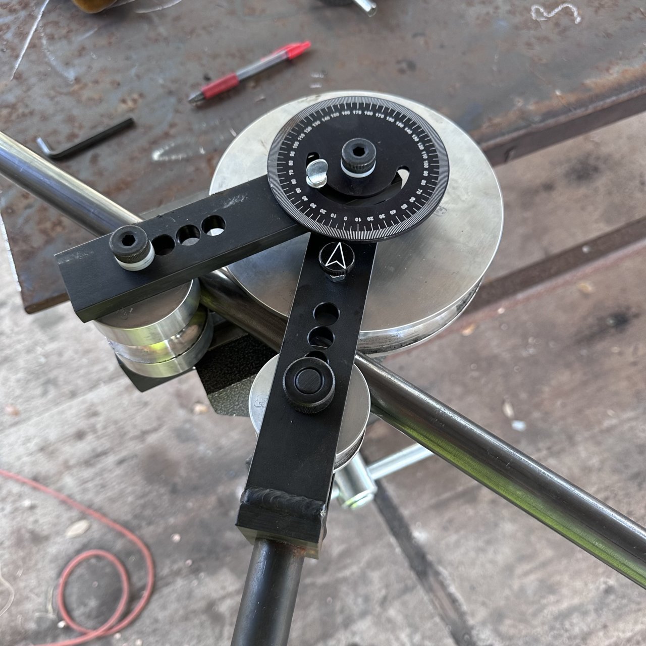

    I love building stuff and been a welder in almost every industry. Actually swapped to quality control to save my body so all I do is read prints and check fit ups and stuff now…. And nothing annoys me more than car stuff since nothing is ever square or level with these things :laugh: roof rack almost all mocked up. Gotta finish off the back section and add some supports and expanded metal for the floor then comes the super fun mounts to make that are gonna suck too

    What bender you using? And how thick is that tube, and diameter?

    1” , 14 gauge soooo .083” I believe, and I boujeed out on a sweet little bender from MB tools. Im still figuring it out with the whole reference point and nailing bends. Thankfully I can just cut and splice 90’s, 45’s, whatever I decide to bend because it’s a roof rack. But im pretty stoked to know the endless possibilities once I figure it out consistently. also have a JD2 M32 but like how small this dude is for smaller tubing.

    It bends really decent actually. I’m impressed. You need a cheater bar for sure but once the bend is started it goes smooth. I have been wanting to build roof racks for some years but needed a way to get off angles and this fit the need. $500 all said and done basically. $200 and some change for the tool and the die was $250 I believe. Worth it so far without a doubt plus being able to stand out and do custom designs that others can is well worth it.

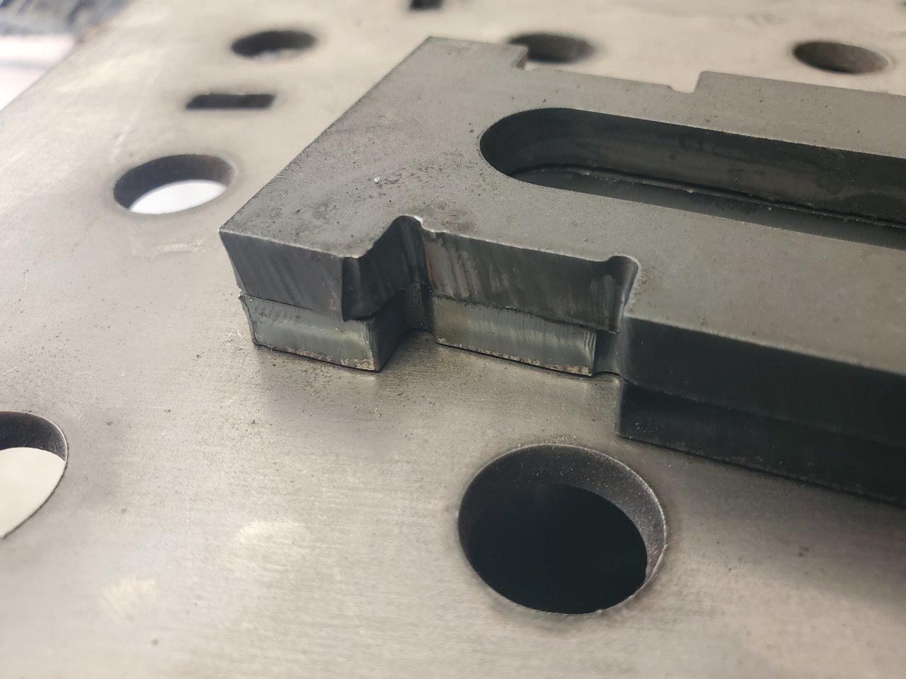

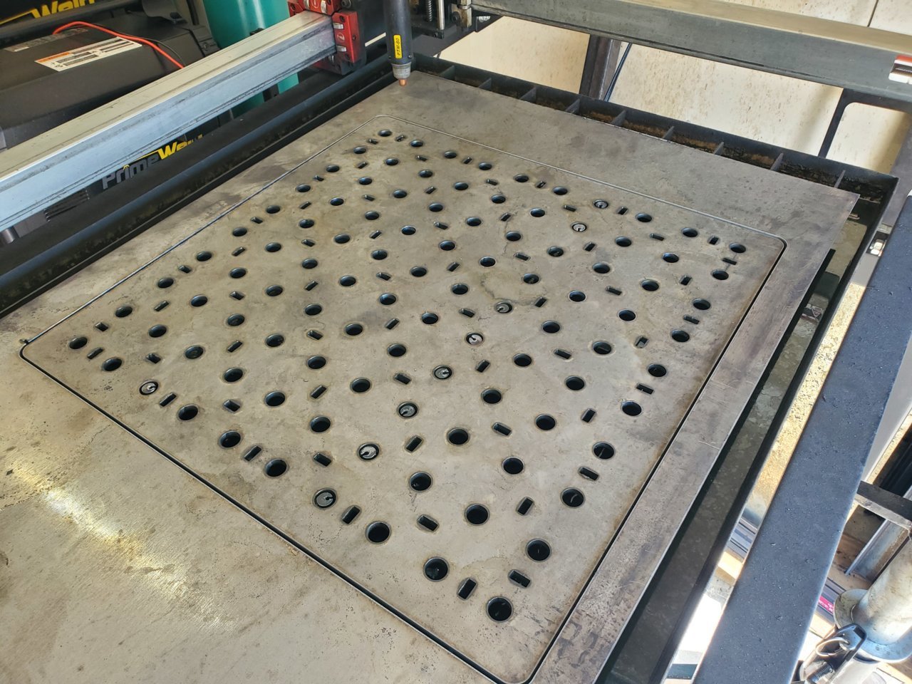

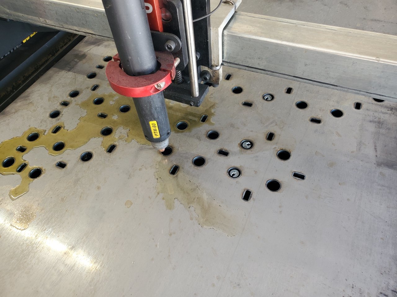

    The small issue I had when I cut that table out yesterday?
    I quickly saw my Z axis was binding...never done that before but that explains why during initial height sensing it never touched the work piece.

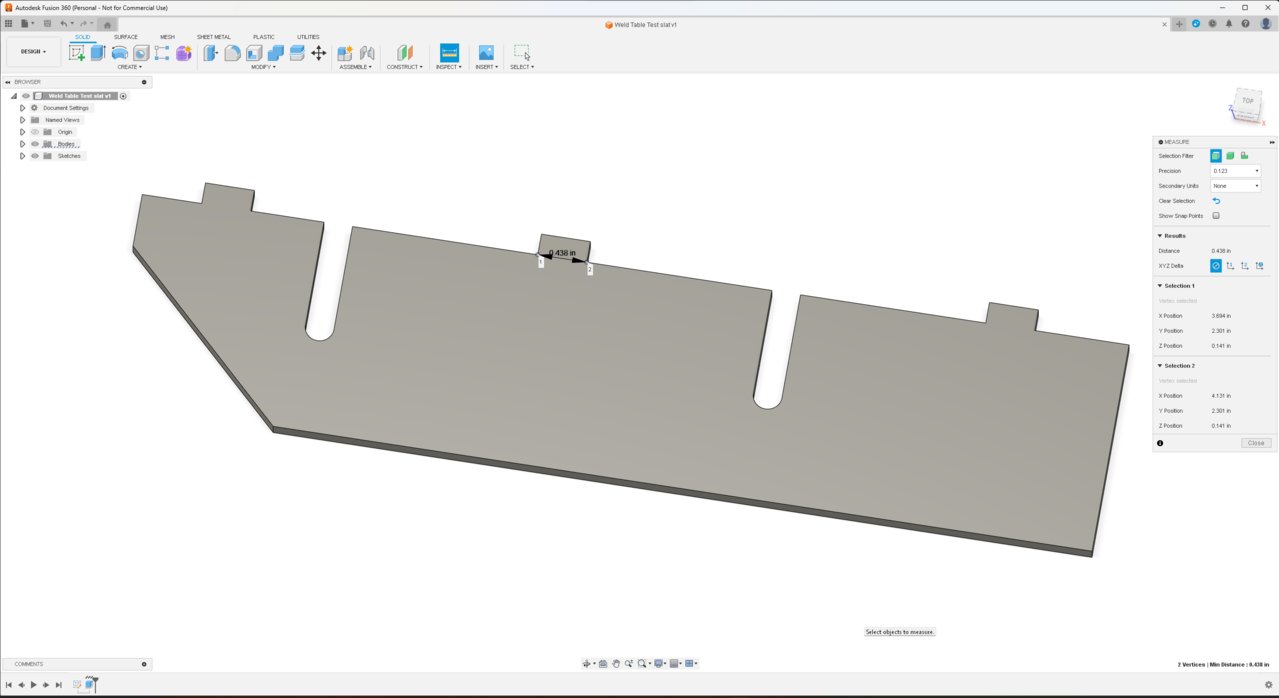

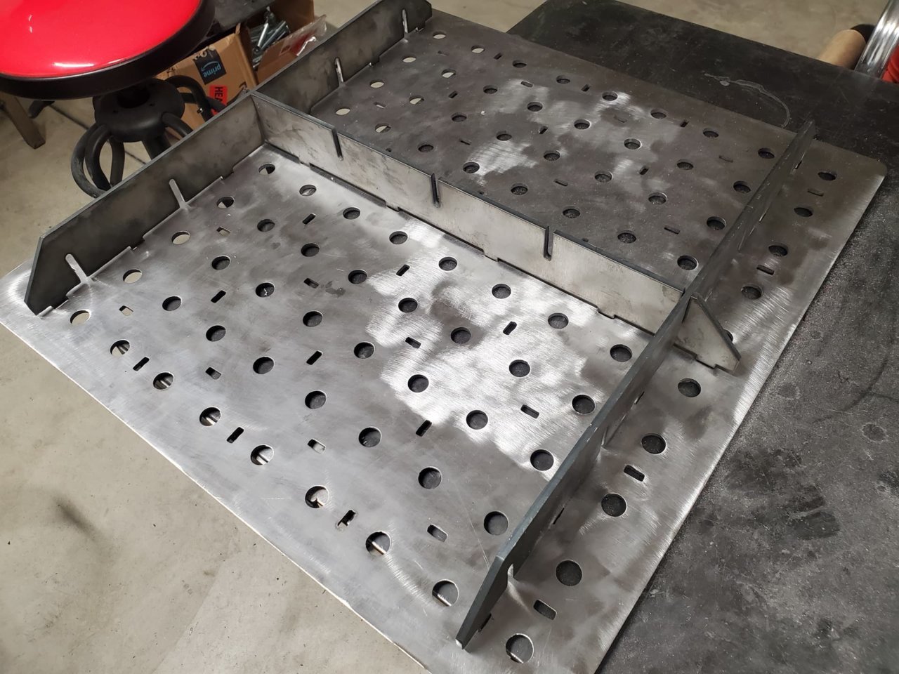

    Knocked these out after ensuring Z was good; now the only problem is I'll need to grind down a few tabs -
    No biggie because for the remaining 7 slats, I'll be making the tabs slightly smaller to fall in place.
    Going to test the tab size on some scrap as a "partial" before going to cut the real thing -

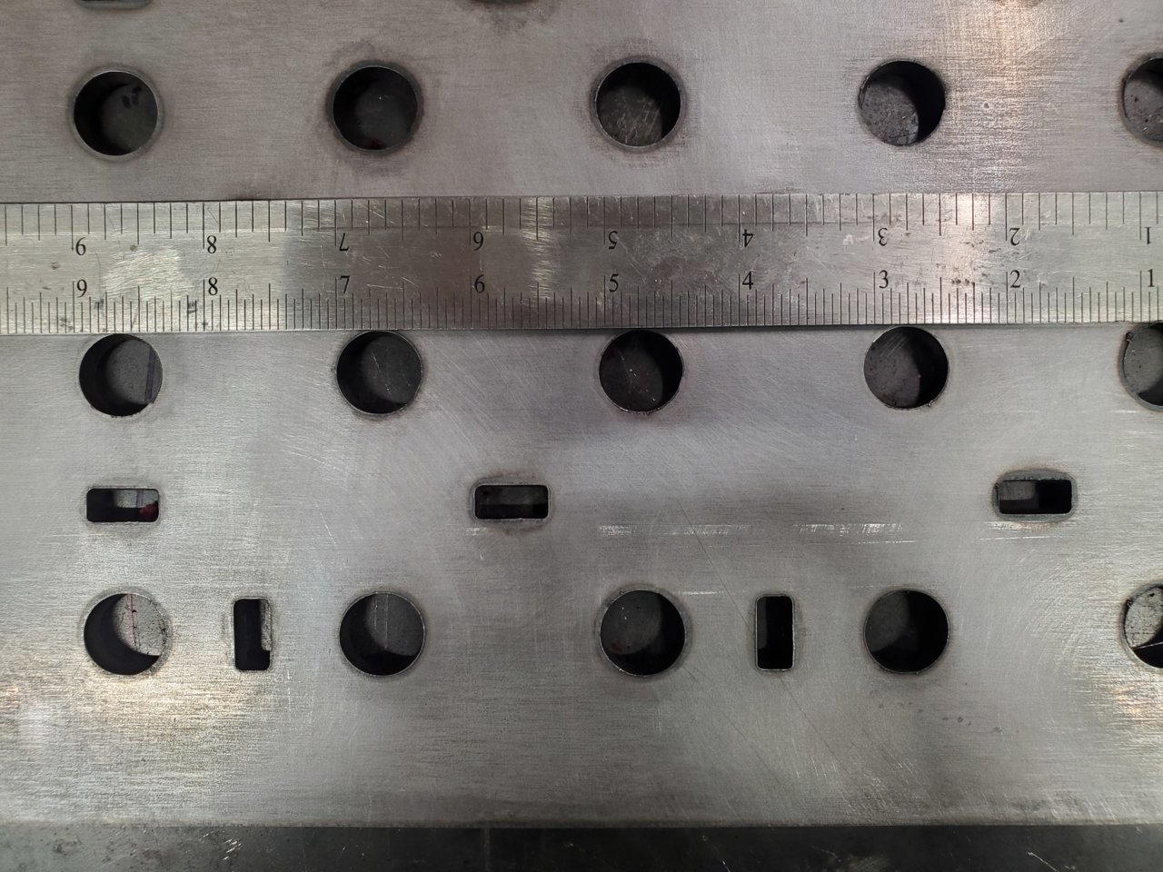

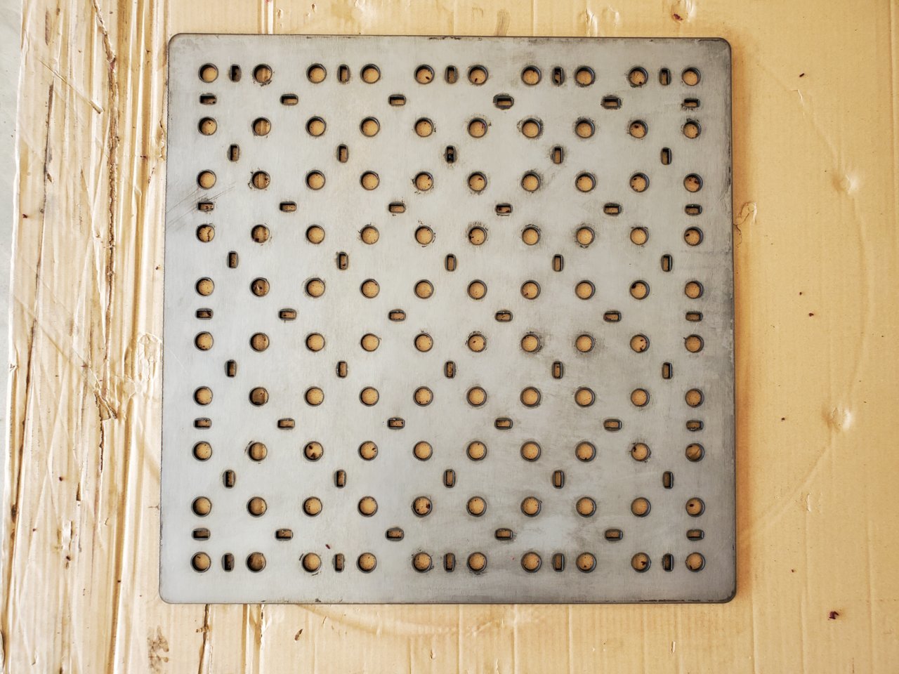

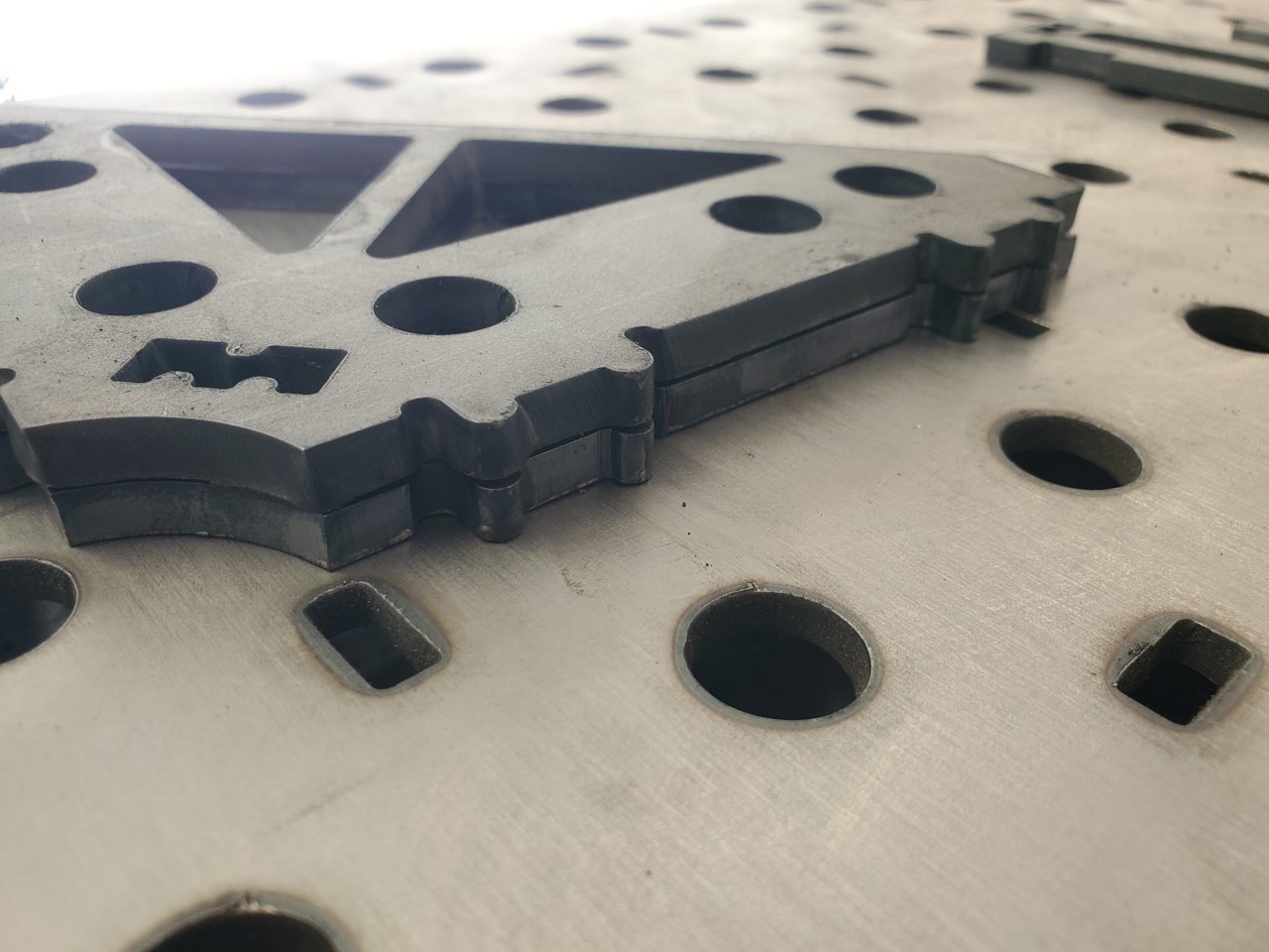

    Plasma vs laser, it gets close
  18. Sep 29, 2023 at 5:37 PM
    Kwikvette
    Feb 27, 2019
    #284735
    81,121
    Fresno County
    4 run, 2 don't

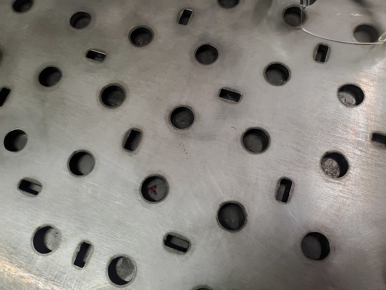

    This is the one that was laser cut
    Will have to grind down the tabs a bit on the plasma cut stuff, or just toss it, revise the tab widths, and cut another set out with loose tolerances

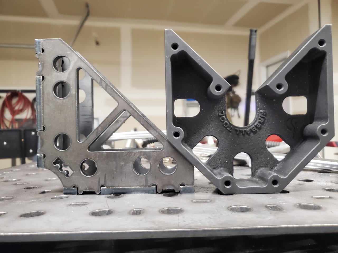

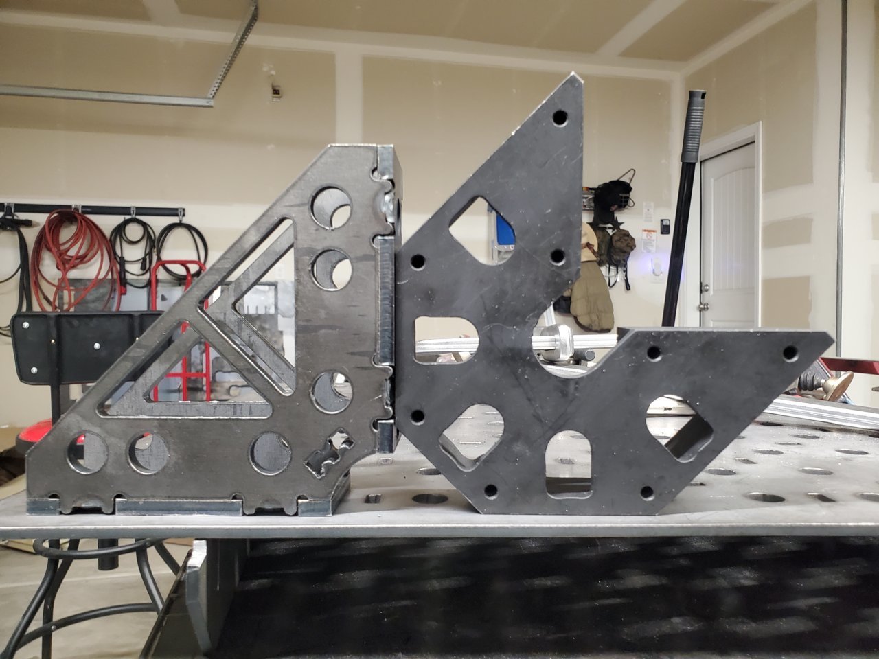

    I have that fireball square lol. Let me know when you're ready to sell yours
    soundman98 and Drainbung like this.

    Squares for welders are like clamps for wood workers; can never have enough :luvya:
