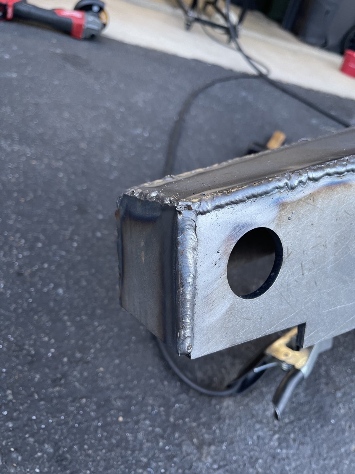

    Working on a bumper for the 60 series. How am I doing?

    First pic told me = very inconsistent
    Second pic told me = yep, bad positioning would do that
    Whether you're a novice or a pro, one thing every successful welder will tell you is that you need to establish your ABC's which means ALWAYS BE COMFORTABLE
    Set yourself up in a position where you're as naturally relaxed as possible, then do a quick dry run to ensure you're not limited in space and/or movement, then run your weld
    Do that every single time, and I guarantee you'll lay down a better bead

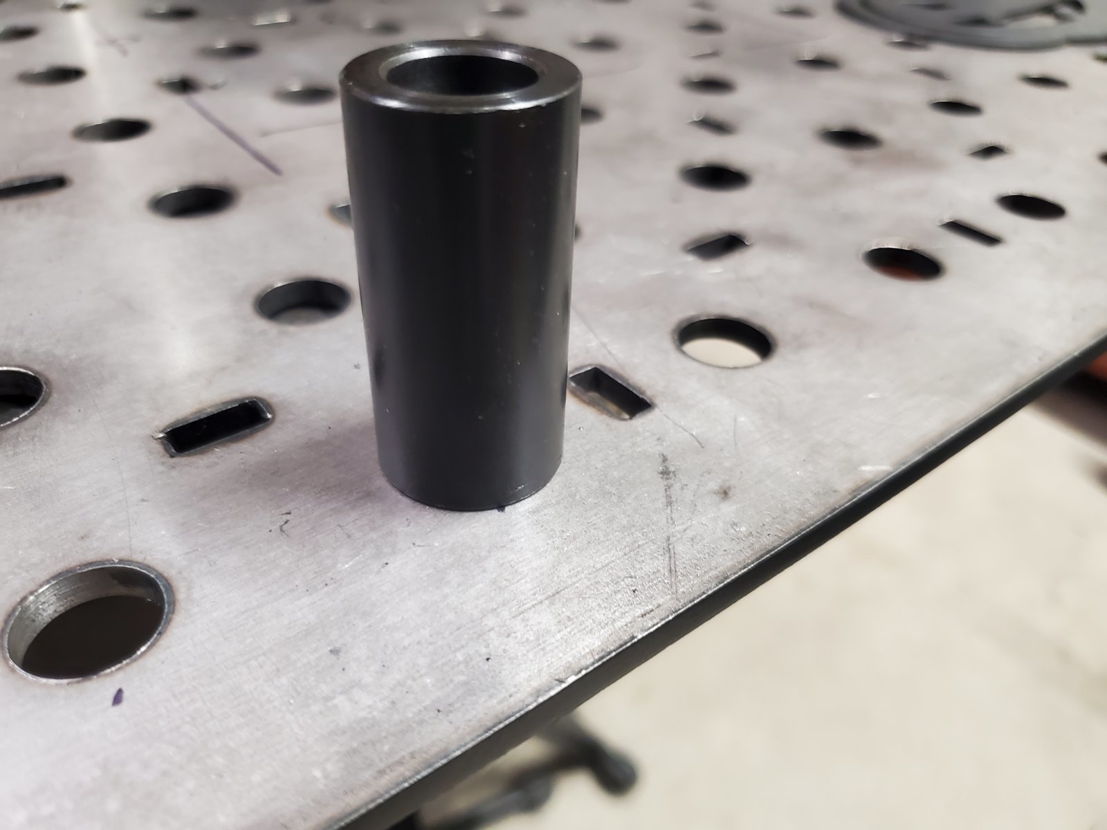

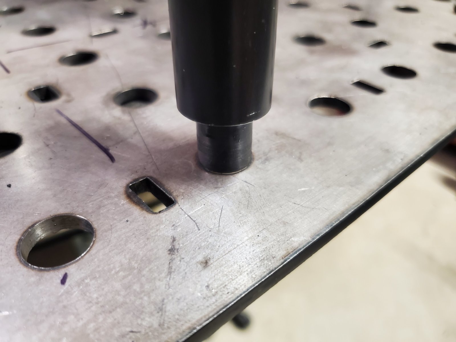

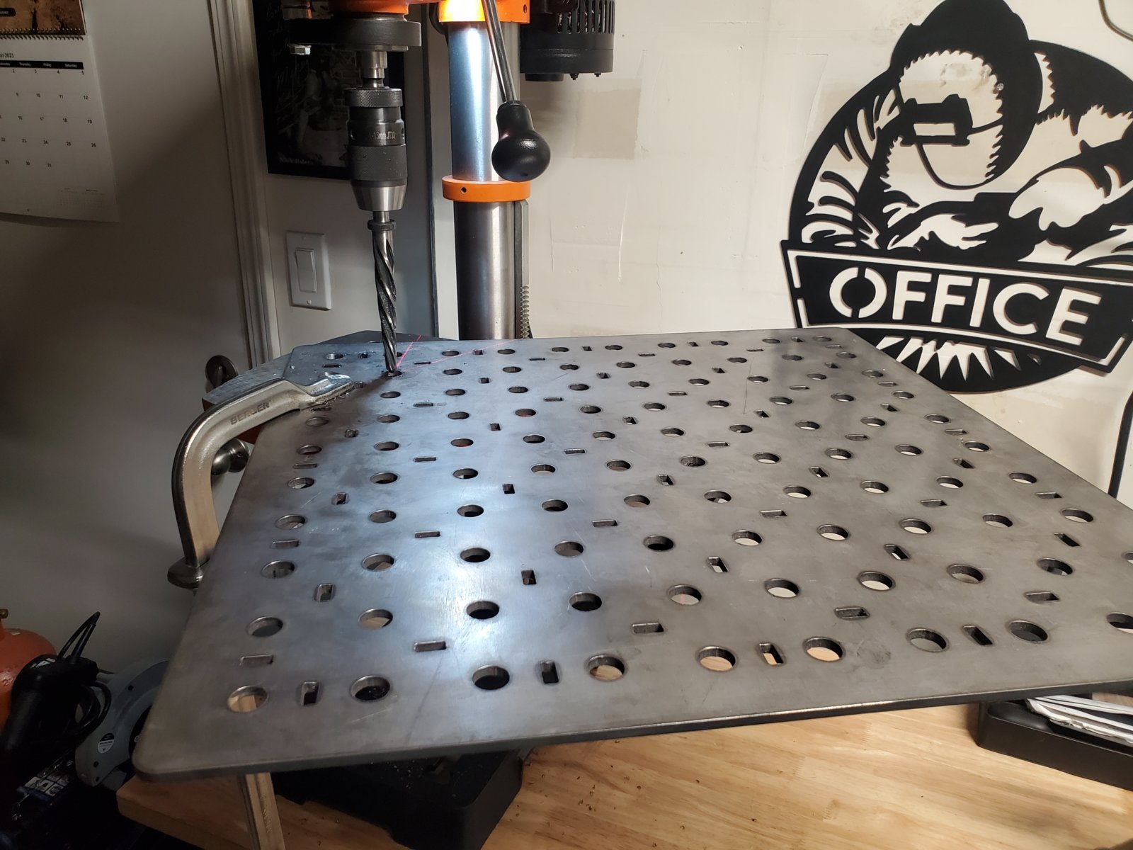

    So, I am genuinely surprised just how little reaming these holes require
    Plasma cut hole -
    5/8" reamer run just partially through
    Holes still maintain 2" centers so this little fucker is going to be a great little asset
    My 3/8" thick table should be ready soon; that one I ordered locally and it's being laser cut so I'll have two welding table fixtures
    I'll still need to grab that other one that is just a few hours from me :anonymous:
