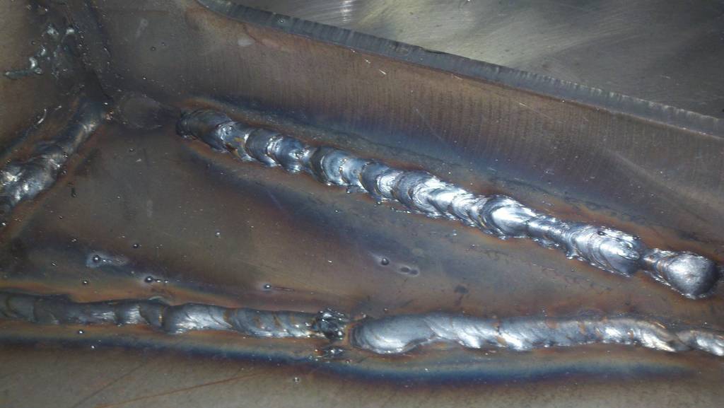

    Thanks for the info. Sadly I am in the middle of nowhere, so scrap 3/16 steel just is not around. All the scrapyards are closed on the weekends, and by the time I get off work I can't get to them on time during the week. Sad, but true. Plus I think the bad welds add character! Since they are on the inside and you can't see them! Hahaha. I will get there. So far only a few spots are welded.
    I got ya on my travel being inconsistent. Non steady hands, and to be honest a bit of apprehension in my abilities are causing me to make some errors. I will see about dialing up the heat some. I am assuming dialing up the heat will give me better penetration, and less of a peak in the metal weld itself. at least that makes sense to me anyway.
    My tip is recessed some into the cup. (I am thinking about 1/4 inch?) But the cup is a screw on, so I can't adjust it any. I am trying both push and pull to see which ones I am most comfortable with, and that I can get the best weld out of. I know that each method has it's own result.
    Thanks for the advice everyone!

    What is your gas set at? Turn your heat up and your wire down just a bit. I rarely look at the numbers when dialing a machine it. It's all about how the arc looks and how it sounds. I used to tune my old bosses welder in without looking while he was welding and I was holding shit in place.

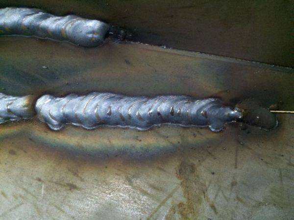

    Just one of my stainless passes I laid a while back. Helium and 140 dollar 14lb grade stainless single shield 0.30.

    The TIG weld took 10 minutes for prep, fit up, welding, and checking to make sure it it still level. Then goes to inspection, x ray, dye pen, hydro, PMI, & hardness.
    The mig weld was on a "hobby" project. It takes no longer make a good quality, attractive weld than it does to slap some shit on there.

    ok. Gas is actually at 17. Here is my recent pass in the middle. Settings are now:
    Speed: 313
    Voltage: 19.0
    Inductance: 6.5
    It looks like I am getting a better pool, and better penetration. Still sucks not having a steady hand. Plus it is difficult to always see the butt joint clearly, so sometimes I push it a little off center. I am guessing my helmet screen may need some adjustment. It is an autodarkening with a dial on the side.

    With 10ga, I wouldn. Depends if you full pen it or not. If you have full penetration I would not do both sides.

    I want to know how fools are laying mig welds like this. I have yet to find a video of this but knew one guy at the shop I used to work at that laid single shield like this. He was gone two days after that so I never got to ask him what he did to produce this kind of weld. I assume it is all in how you manipulate the puddle.

    Did the picture not link? It shows on my end:confused:
    I lay a decent weld 90% of the time so I would just do the front. Especially if it is fillets on a butt joint. Like what's his nuts said though, you could lay some 1 on 12's or 2 on 12's if you wanted to beef it up even more.
