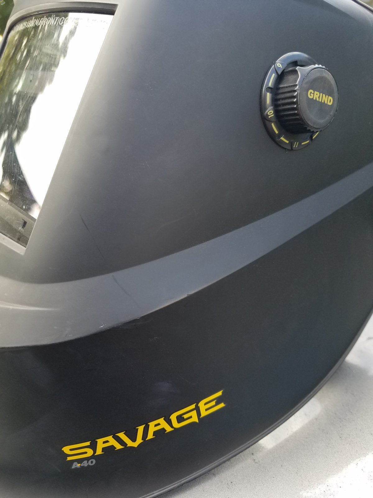

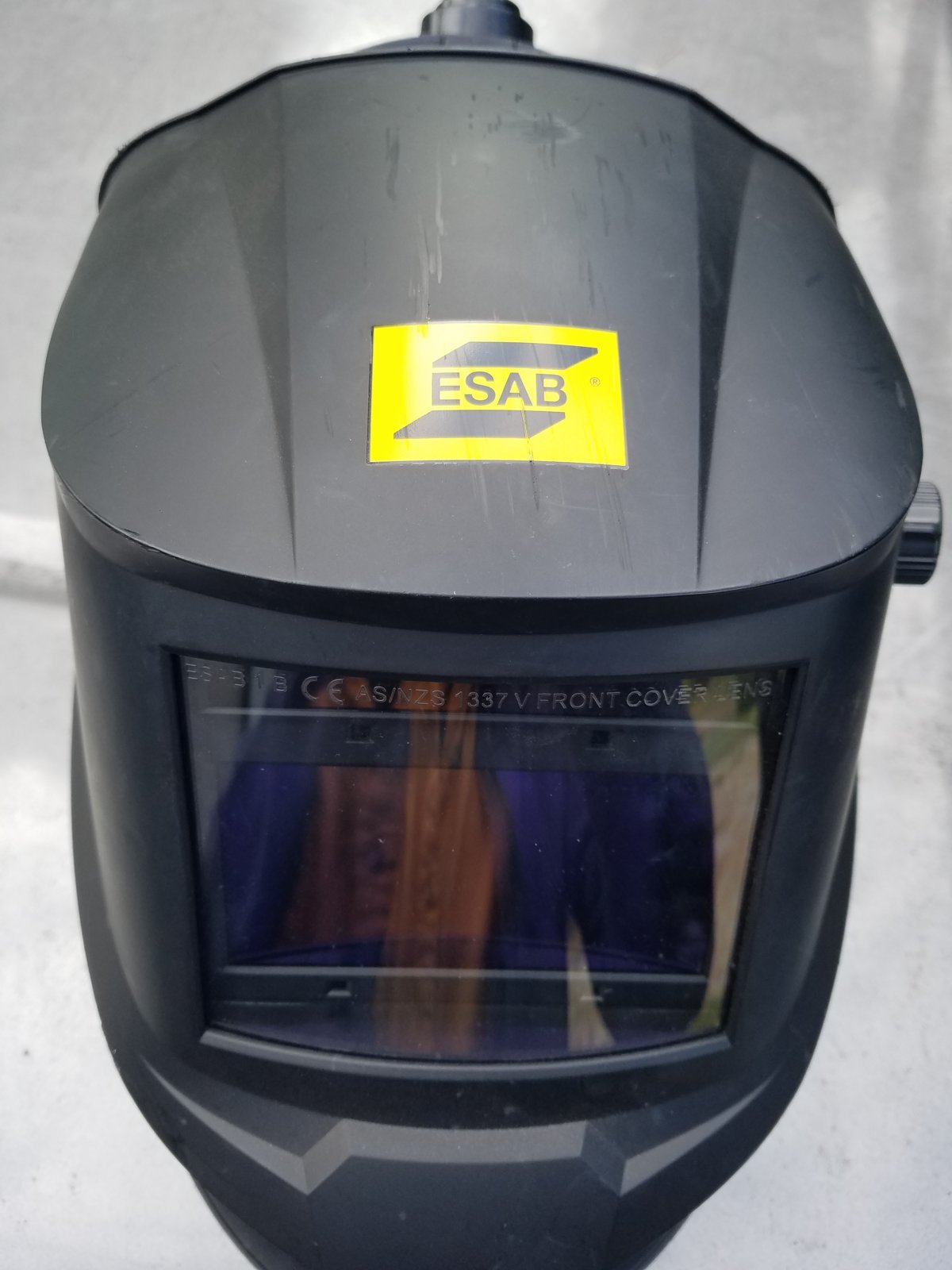

    Well hello there!
    I was driving down 4 lane about 2 miles from my house. I was feeling a little down as I just came from biopsy for possible skin cancer on my scalp.
    Saw something black and looking like a welding helmet in the grass adjacent inside lane on south bound side. Because I jog that area regularly, I knew I could catch a median cut in only about another 200 yards.
    Got it and it looks like almost brand new. Can't believe it wasn't scratched from the fall. $140 on Amazon. 319 ratings averaging 4.5 stars.
    I actually have a welding project I'm gonna tackle in the next few weeks making a manlift basket for my pallet forks on Kubota. Perfect timing.

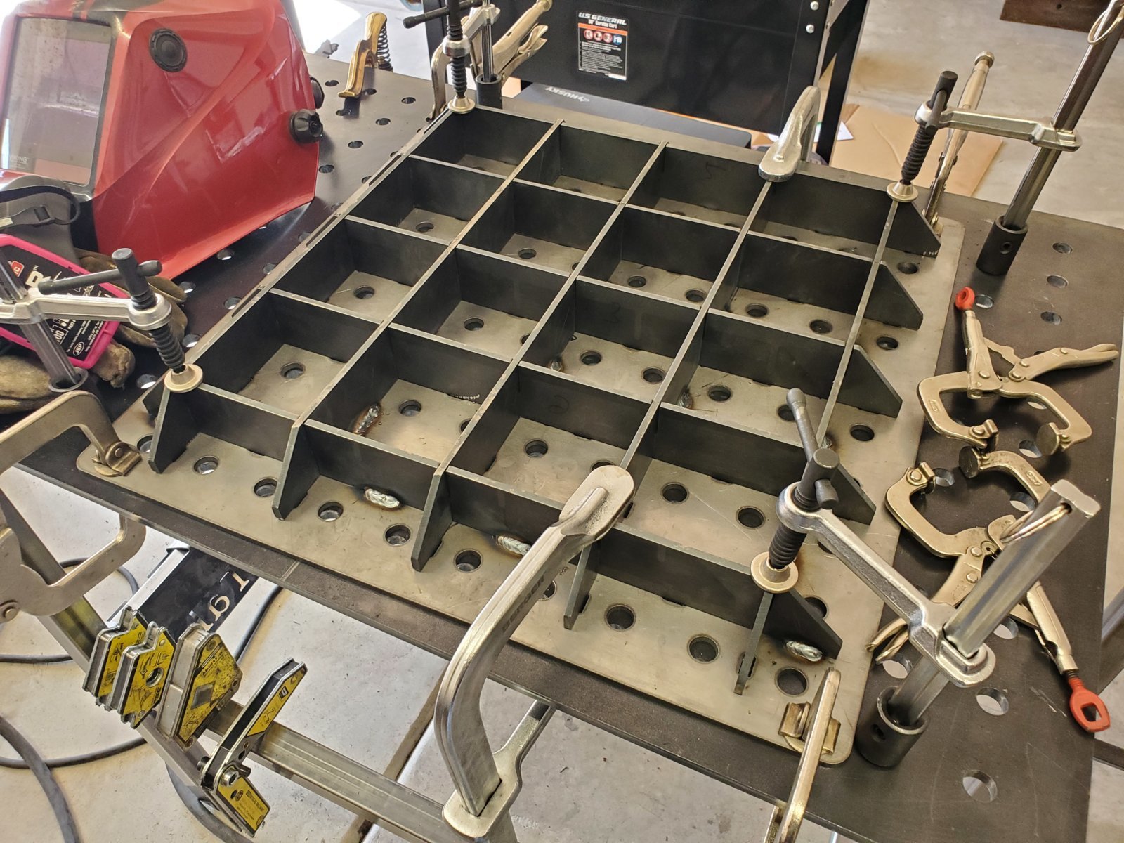

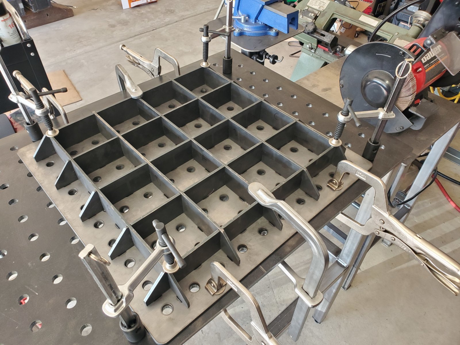

    Clamped and ready to go
    Threw some beads, and even though I've been hitting it with compressed air I'm going to let it chill for a bit before finishing up

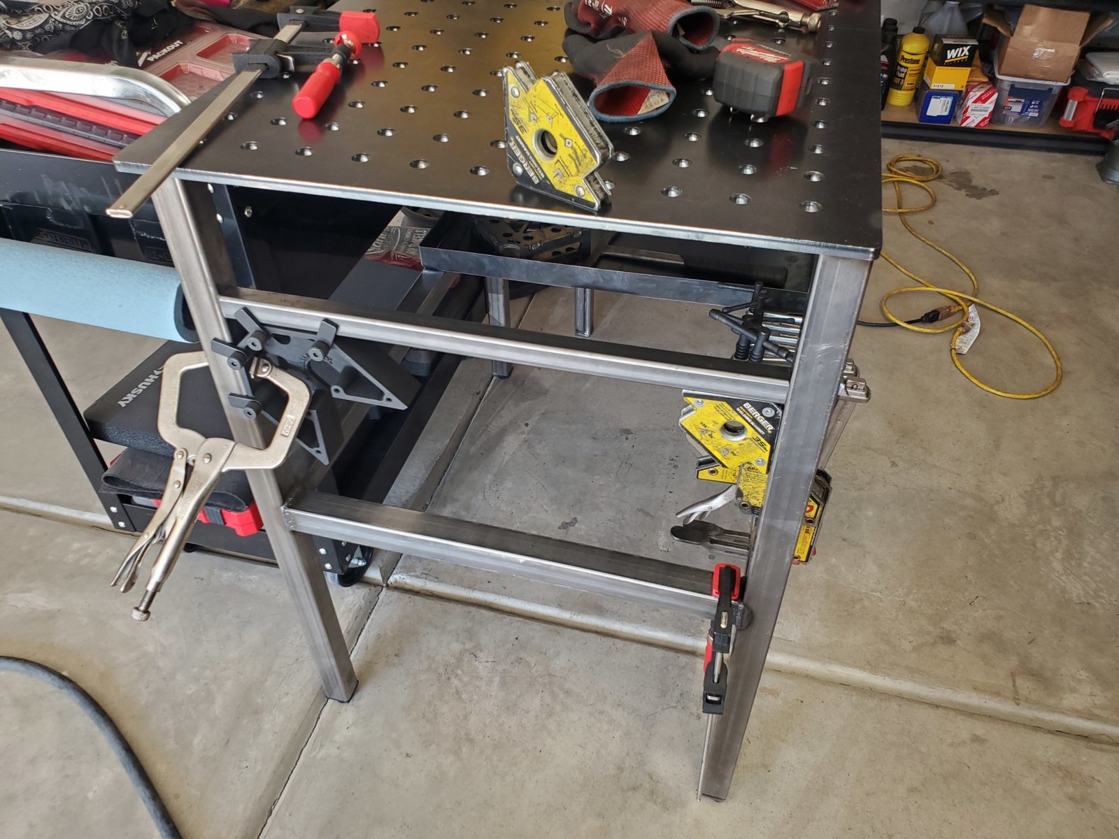

    Fuck it, I'm calling it done

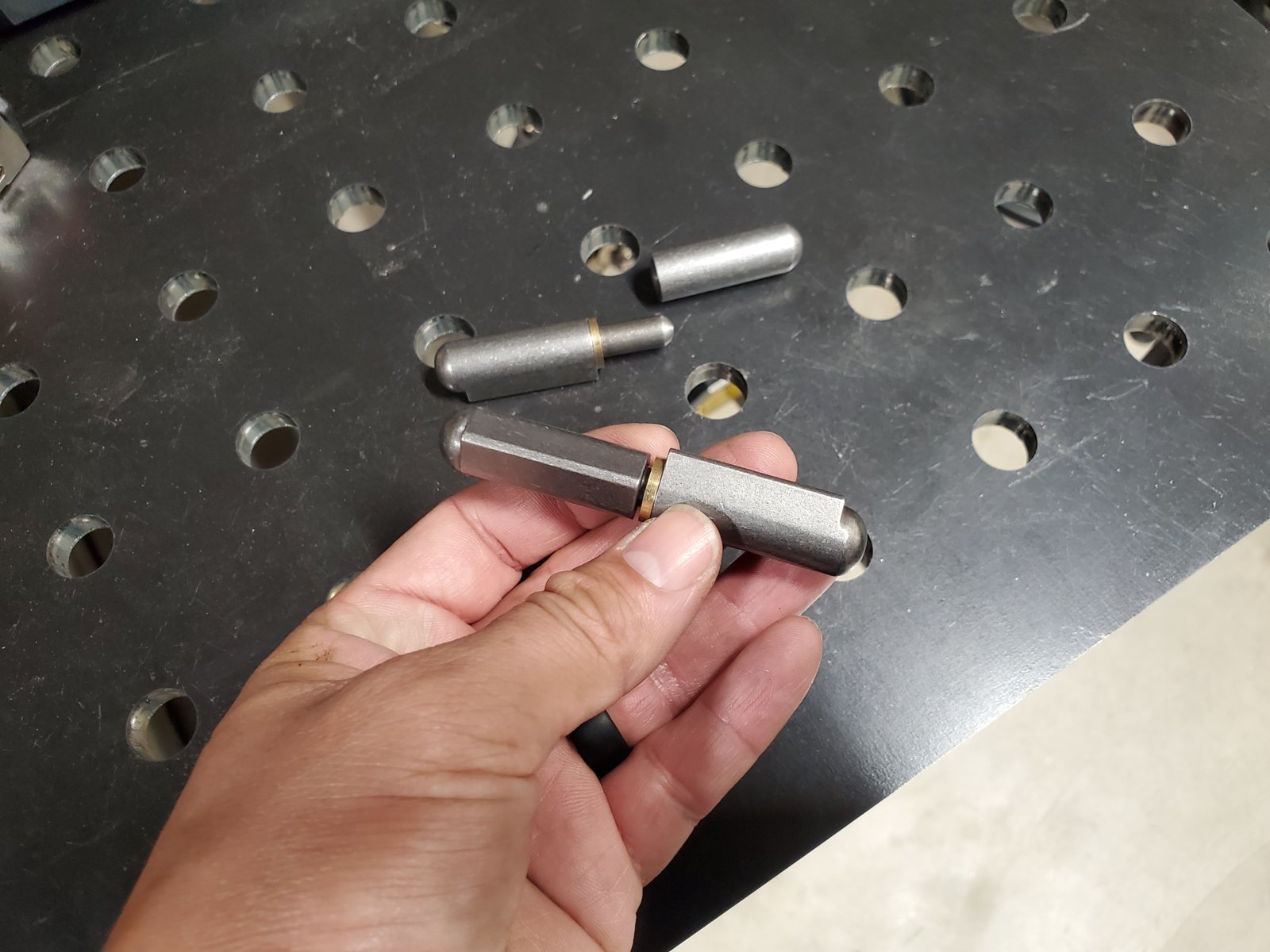

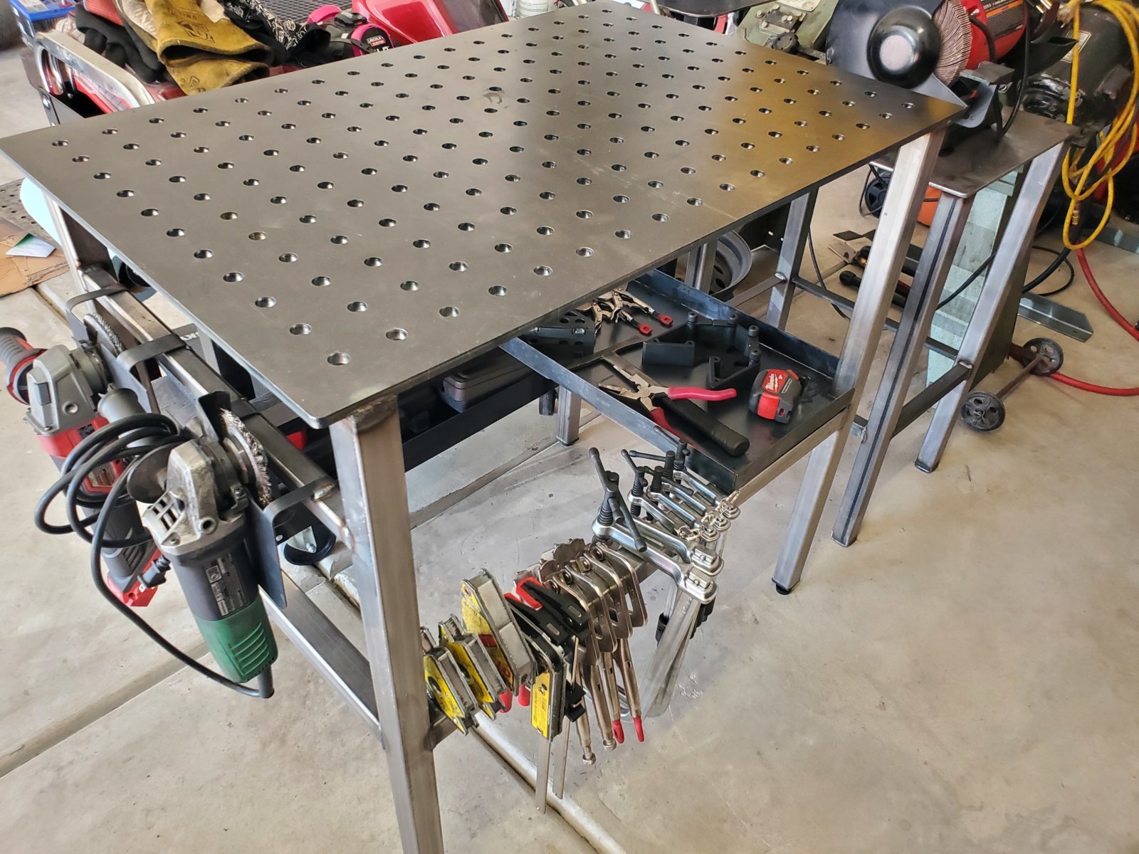

    Fuck me, so my customer came by to pick up some parts and he let me have these
    So, I'm making parts for him for his low rider and he brought these over; they're hinges he'll weld the plates to for making them "dance" attached to linear actuators
    They're super smooth and really low profile which got me thinking, I can make a flip up table top extension to my new table using these hinges with a fold out arm/catch

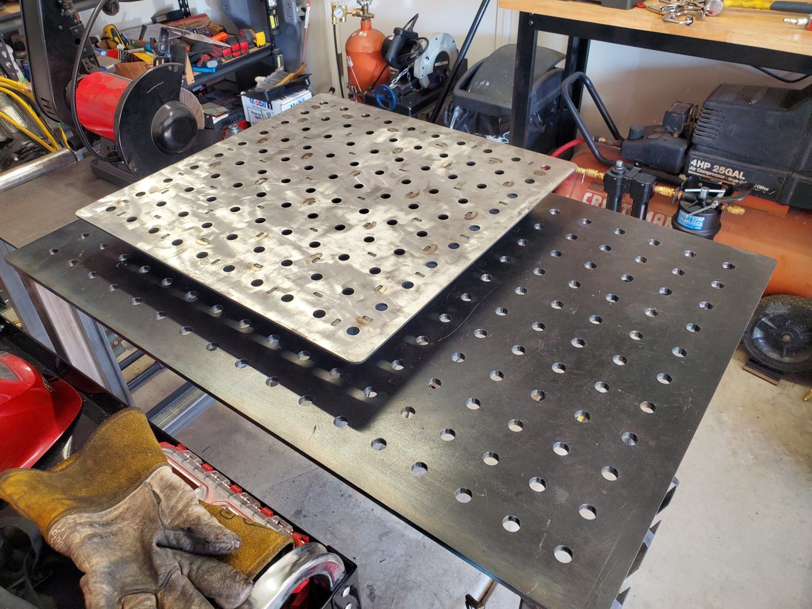

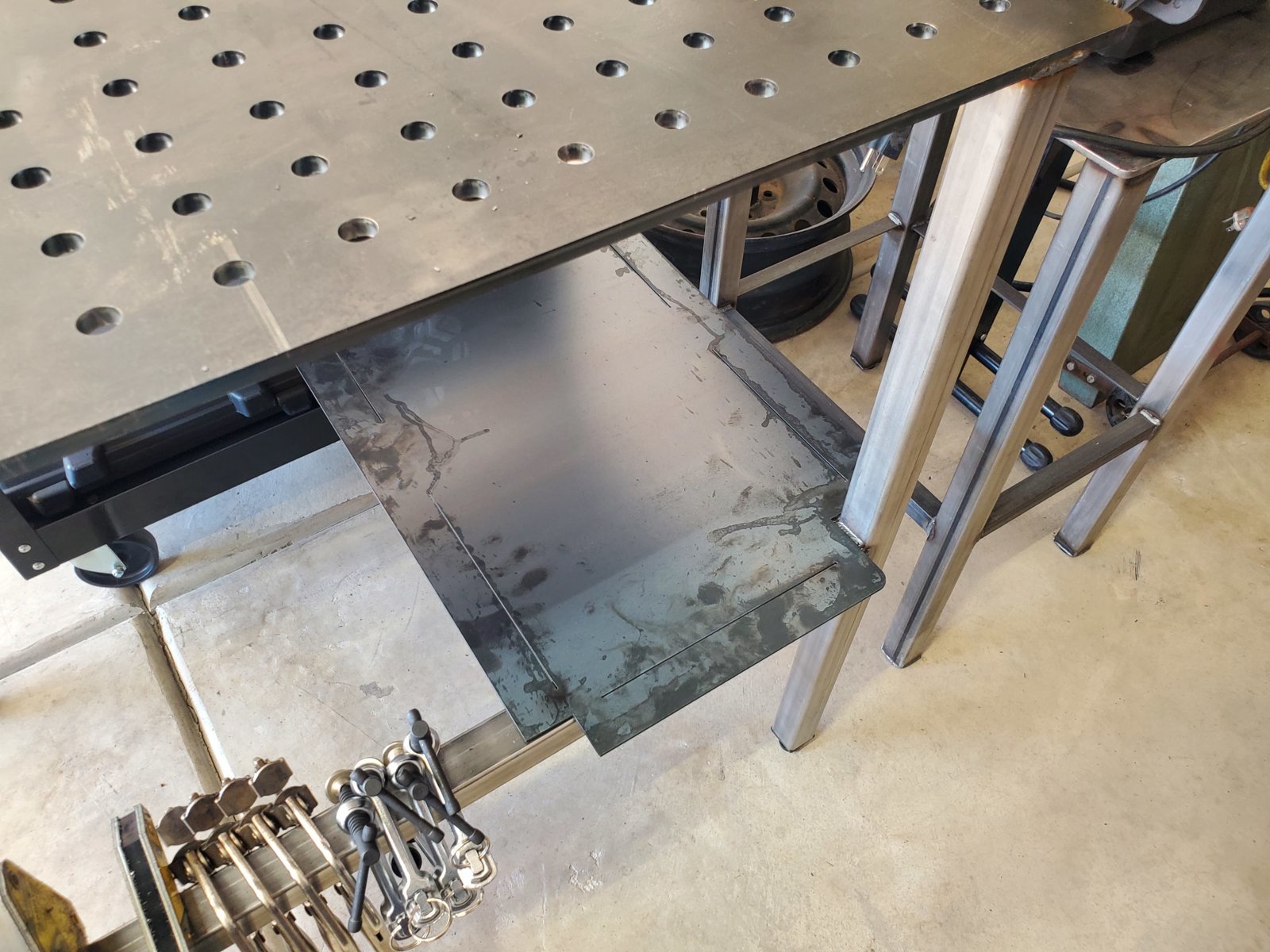

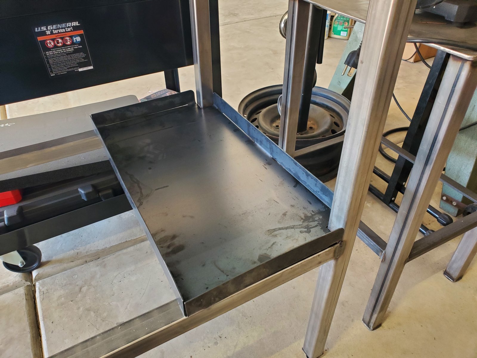

    I don't post up many videos so here's one for your viewing pleasure -
    https://youtu.be/riwTdTrLCQ4
    Test fit
    All bent, had to do this on my table since my brake only goes as wide as 19" and the shelf is 15.6" x 27"
    I'm almost just planning to leave it as is as I intended to weld some 1/2" square tube to run down under the left edge of the shelf between the table's "crossmember"

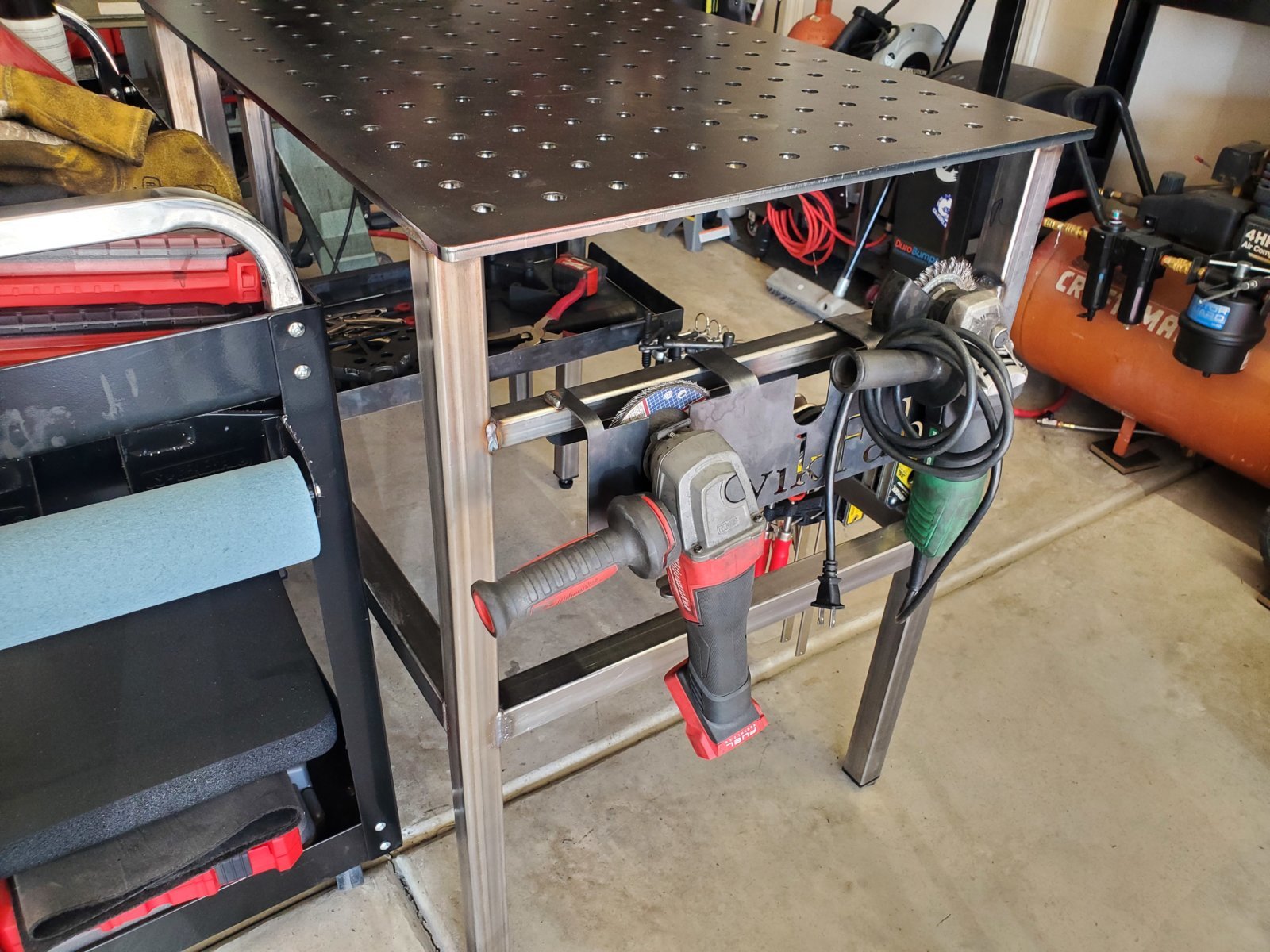

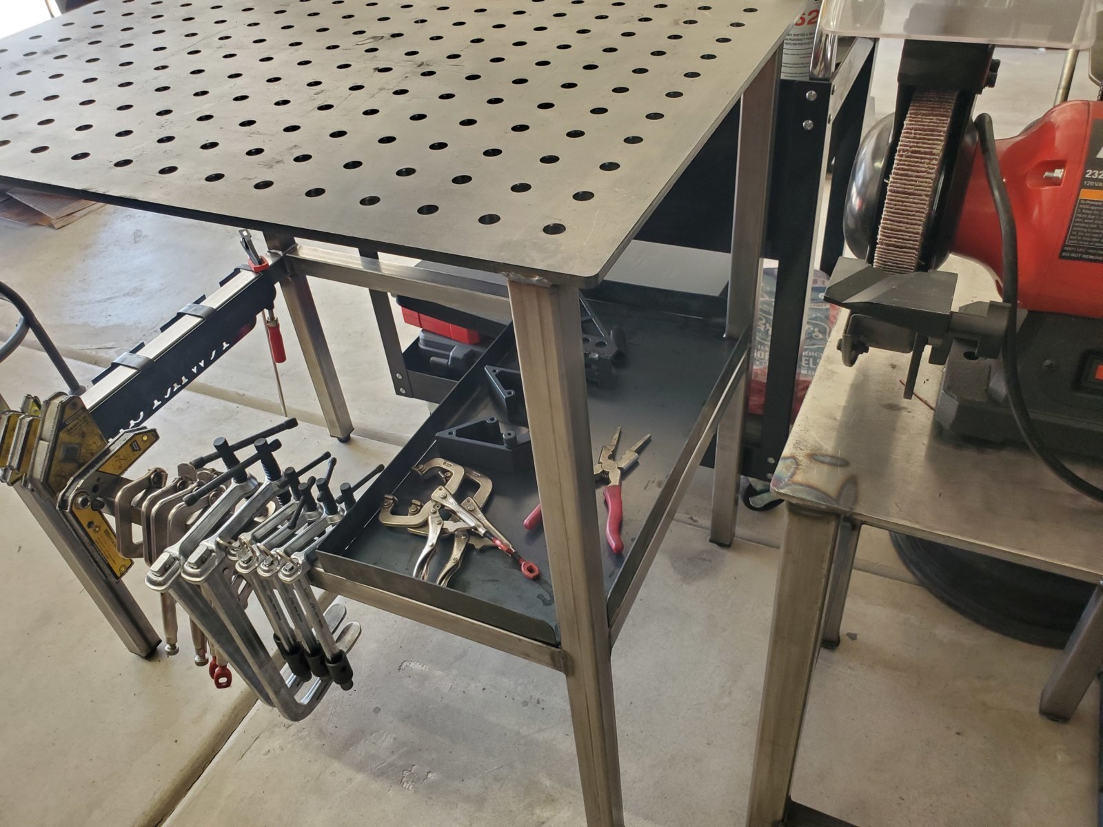

    If you're wondering why 1 clamp and 1 magnet, some of my square tube is actually stainless :anonymous:
    Got multiple angle grinders, but these are my most used so they'll go on the table

    Was trying to make use of space and add utility; I had to buy some remnants for the shelf portion but with a lot left on it, I'll easily make more than the $20 I spent on it (2' x 4' as shown in video)
    With that said, all in I'm at $158 (table top) + $9.49 (adjustable feet) + $20 (remnants for the shelf) = under $188
    The angle grinder holder was left over scrap and the square tube for the holder was more scrap from over a year ago.
