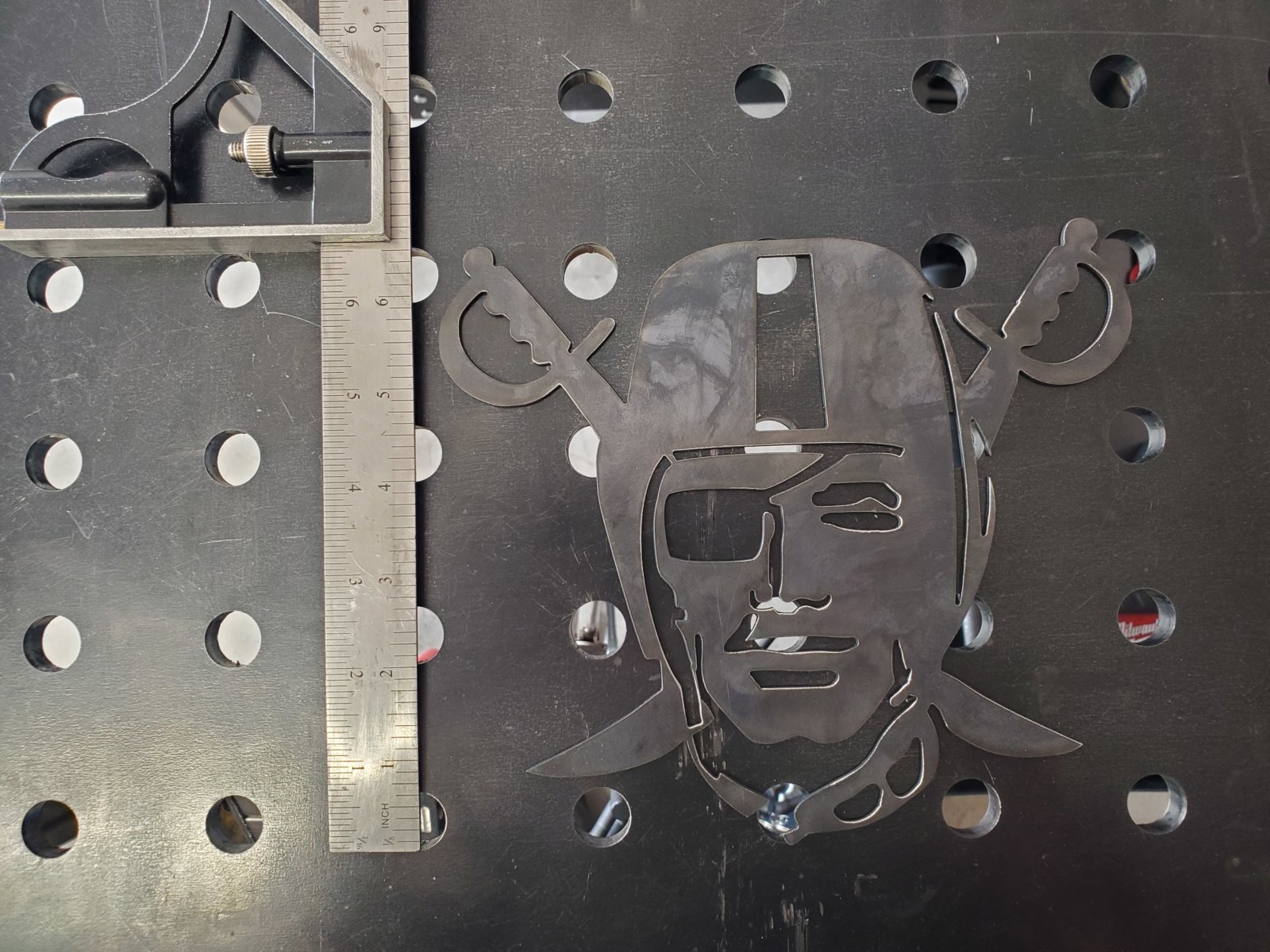

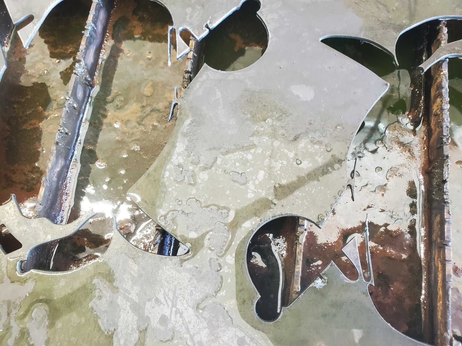

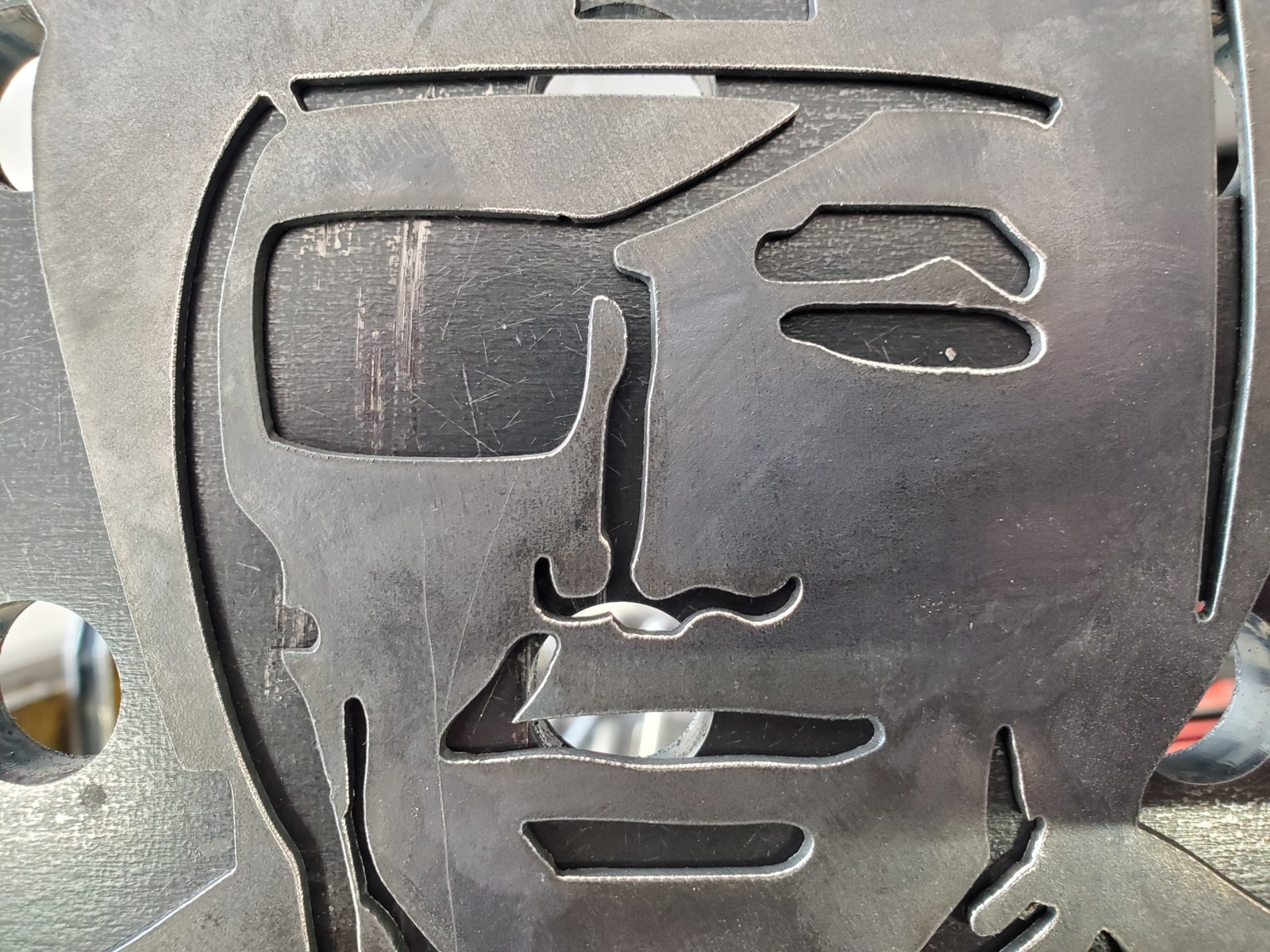

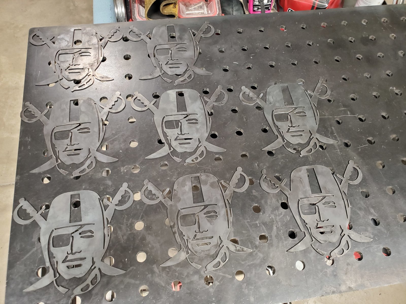

    Quoting myself cause, those remnants I bought for my shelf? It's already paying me back times four -
    Anyone that does CNC plasma can appreciate this, and I'll explain why -
    I had trouble drawing this whole thing, specifically because it needed to be a specific size (no more than 7").
    Well, even after making multiple profiles with either center or sideways compensation, lead-ins shortened to 1/8" and more, I continued to have linking constraint issues; for those that don't know it means your cuts are too close together and that part of your profile is omitted.
    So, I scaled up my drawing for a +10" model and was able to create my profiles.
    The best part? In my controller software I scaled it down to a factor of 0.65 in hopes that it'd retain many of the details and shit you not it did!
    Here's the left over from all that -
    Cutting stuff is one thing, but cutting stuff to such tight tolerances and making it work multiple times over just feels so good.
    Need to buy some morw 16 gauge to cut the rest out, not to mention make stuff for another customer.
    This Raider's fan was a word-of-mouth customer I just talked to yesterday and met today so I'll be cutting more for him in the future.

    Oh no, maybe I phrased that incorrectly :rofl: (typing on a phone with no proof reading)
    No help needed, more like, I got a level of detail that programming wouldn't allow cause "on paper" it wouldn't have worked
    And this is maybe the 3rd or 4th time I've done something similar, and I've been successful every time :D

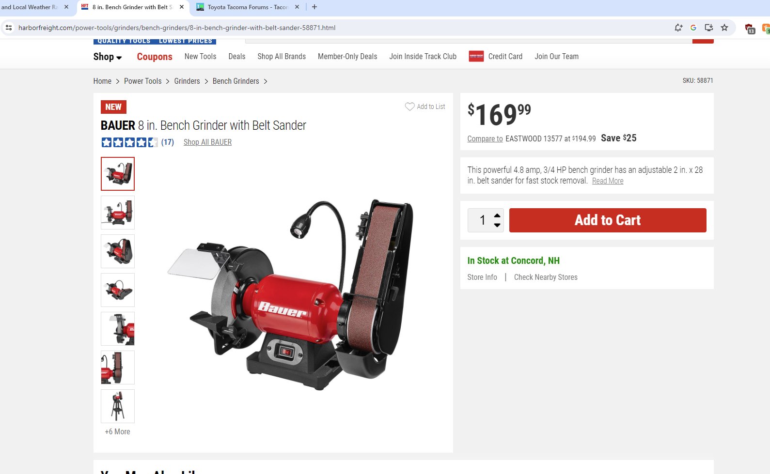

    Did someone on here get one of these semi-recently? How is it?
    Im caving in and I am getting a scratch start tig setup for my mig 180 and need something to sharpen tungstens.

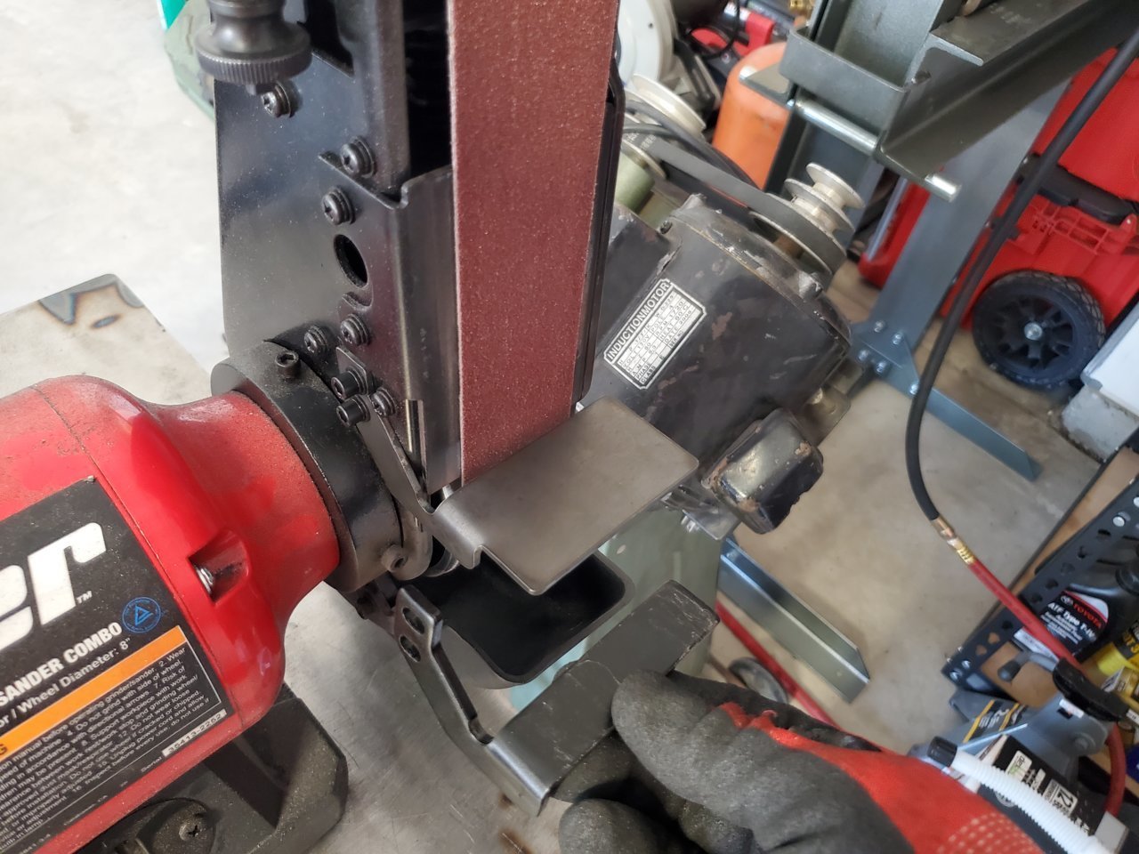

    Having TIG welded professionally, as well as having learned in an appropriate setting, I'll share what I've learned and why I do what I do.
    Many TIG welders (specifically the older folks) would say just use a grinding wheel. It's fast and it works.
    In fact, it's best to chuck it up on a hand drill, and turn it while running it on the grinding wheel. You can go this route as it works really well.
    I didn't want a grinding wheel, even though that setup you linked does include one; I own it.
    Instead I opted to remove the grinding wheel to make use of another wheel for more versatility and opted for a dedicated tungsten grinder recommended by another member here. It's actually cheaper overall than the HF offering and being as compact as it is, means you won't need a dedicated spot for said tool.
    Just don't use the abrasive belt to sharpen your tungsten with as any contaminants from cleaning up metal can embed themselves into your tungsten. It's why you use separate brushes and discs for cutting or cleaning up aluminum, mild steel, and stainless steel.

    I do know about the contamination issue, I planned on using the grinding wheel for tungsten then the belt for final shaping type stuff if that makes sense. I know the grinding wheel will be decent enough but how is the belt for grinding down 1/8" for example? Does the belt work for belt grinding or is a complete POS?
  11. Oct 23, 2023 at 10:05 AM
    Kwikvette
    Feb 27, 2019
    #284735
    81,614
    Fresno County
    4 run, 2 don't
    When I bought it, I intentionally kept the box for a good month before tossing it (just tossed the box days ago) cause I expected it to bog down or worse.
    Nope, you can push metal into it and it runs without issue.
    I use it for quick clean-up and shaping and it works well for that. Hard to answer about the 1/8" cause I don't know if you're removing that much material or what.
    I normally dabble in 10 gauge (thicker than 1/8") and above with 3/16" being ny choice of thickness.

    Oh, one thing I don't like is the shelf on the belt sander is really small/short.
    Had to make my own.

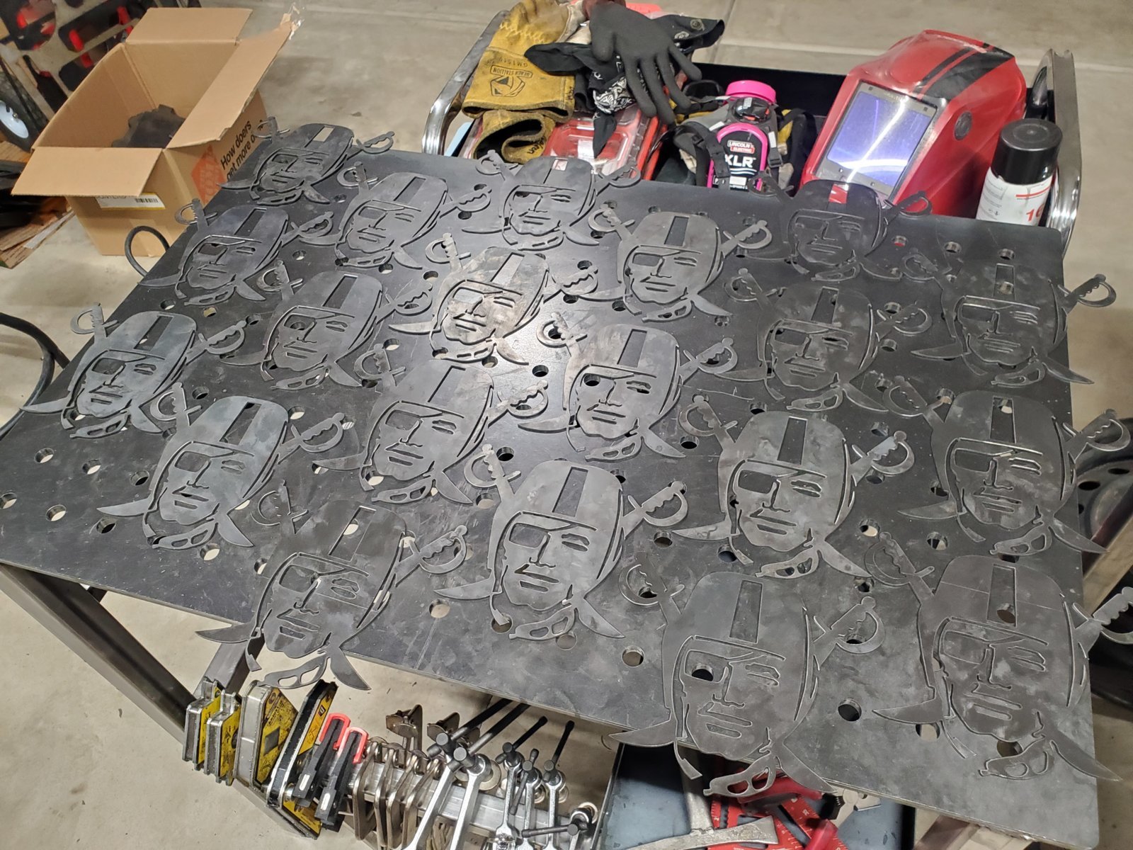

    Customer wanted 20 so..
    Wrapped up and ready for pick up tomorrow

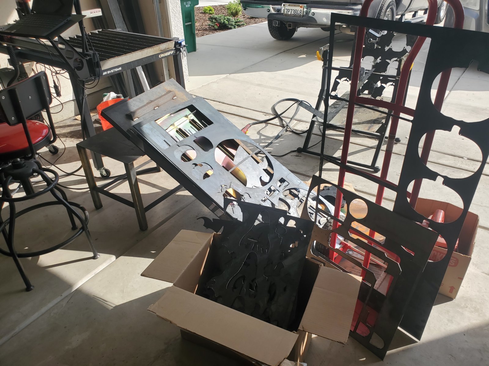

    And since my scrap guy has been MIA, I decided to take this
    And turn it into this for recycling tomorrow
