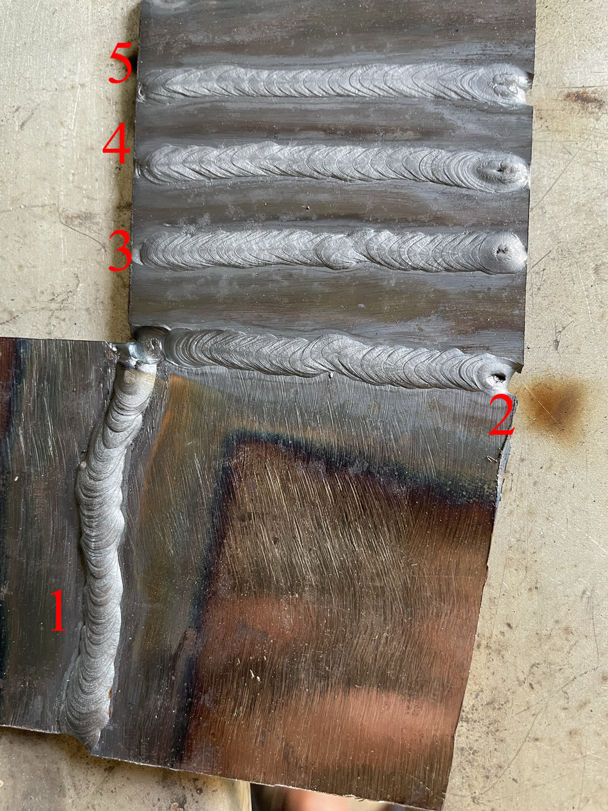

    Hello TW Welding Gurus,
    I bought myself my first TIG welder for fun and was hoping you could critique a few of my lines. I've only informally dabbled in FCAW for a couple of years with home projects here and there. I'm completely school of YouTube taught.
    Yeswelder 200P ACDC TIG with foot pedal (Amazon Prime Special)
    100% Argon @ 15 LPM
    7 cup with 3/32 Red Tip tungsten with about the same stick-out as the cup ID is wide.
    Tried to keep the tungsten as close as I could without touching the puddle.
    Holding the torch almost vertical, minus about 15 degrees (I'm a lefty so I did left to right).
    Steel was 11ga sheet I had laying around.
    All set between 130-140 amps.
    1) Butt joint using ER70S-2 1/8" filler rod. Every time I dipped it in the pool it stuck to the metal. So I downsized to 1/16" for all others. The bead is really thick. Am I going too slow, not hot enough or was I right in changing to a thinner rod?
    2) Butt joint with ER70S-6 1/16" filler rod.
    3-5) Just running beads over the surface to practice straight lines (which is really hard to go straight!). All with ER70S-6 1/16" filler rod.
    * I didn't feel like my puddle was that big. It was difficult to touch the front of the puddle with the filler rod without touching the tungsten.
    * Whats with the porosity at the end of my beads? I have a 3 second post-flow that I hang around at the end because YouTube tells me to :confused:
    You guys have any tips for me moving forward? Trying not to just keep pushing through and learn bad habits before I just play with all the variables.
    Thanks all! :cheers:

    I'm not good at critiquing TIG on flat like that other than just add another dab of filler at the end and turn up your post flow a tad more.
    Fortunately mild steel is much more forgiving but if you did that on aluminum, it can even crack at the end of your weld.
    If you want to follow straight lines, just take a ruler and draw multiple across said steel with a sharpie.

    Thanks for that! I’ll definitely try it. The sharpie idea is a good one, but even with following the straight butt joints I couldn’t make a straight line :rofl:

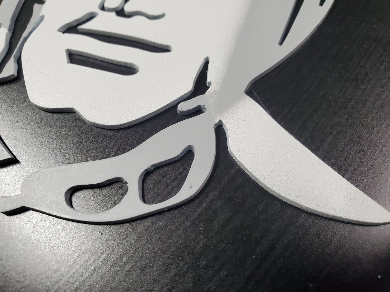

    Speaking of @mjbtaco if you really want it, just pay shipping but here's the blemishes
    The grey here is ruined cause I had taped it up only 15-20 minutes after I painted it; I did it so I can spray on the white
    Pulling the tape off pulled some of the paint
    And this spot here I accidentally painted white (as you can see the texture) and so I sprayed some grey over it again
    Last but not least, I had accidentally got some glue on the backplate
    That meant completely wiping off the paint and glue with acetone only for streaks to appear after I painted it again
    Really is the worst sign I've ever painted :bananadead:

    You shouldn’t have problems with the filler metal touching the tungsten. Pull out a tad when you go to dab if that’s how you’re doing it. Kinda like drumming but super slow. Filler metal. Tungsten. Filler metal. Tungsten.
    The crack at the end could also be you’re going too slow on thin metal and waiting too long thus blowing it out. Aka melting through. More filler would help or even to speed up a bit because the plates are getting hotter the longer you would so you speed up some towards the ends of that makes sense.
    Beads look pretty decent tho. I’m a decent welder but terrible at putting stuff into words and explaining it all so i struggle with this kinda stuff lol. Definitely looks like you’re going a bit slow for how thin the metal is IMO

    I appreciate the comments and your explanations are just fine! As I get more comfortable I’ll speed up and see how it does and I’ll definitely try that drumming technique. At the ends I burned through trying to find that sweet spot with the foot pedal and taper off at the end. Obviously I haven’t found that sweet spot yet. Or maybe it’s just better to speed up at full amperage and circle back with the post flow?
    Any ideas on why the filler rod was sticking to the weld pool?

    If the filler rod is sticking then you’re too far from the puddle or don’t have it hot enough. If does stick just bring the torch closer to it to melt it off

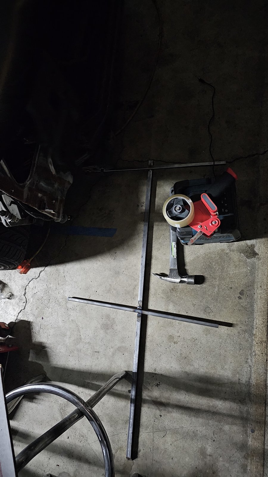

    Going shooting tomorrow morning. Couldn't find anything to hold up my targets. Welded this up very poorly out of scrap lol. Let's see if it works haha

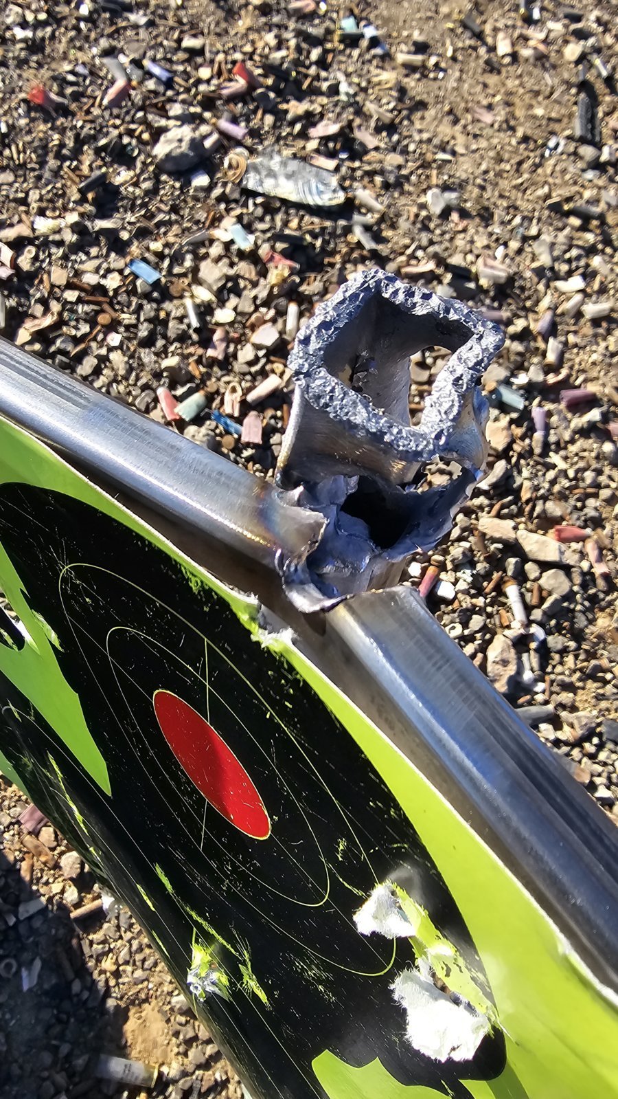

    What are the odds I hit the damn welds at 110 yards lol
