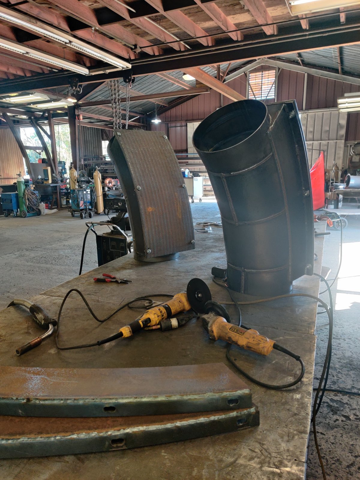

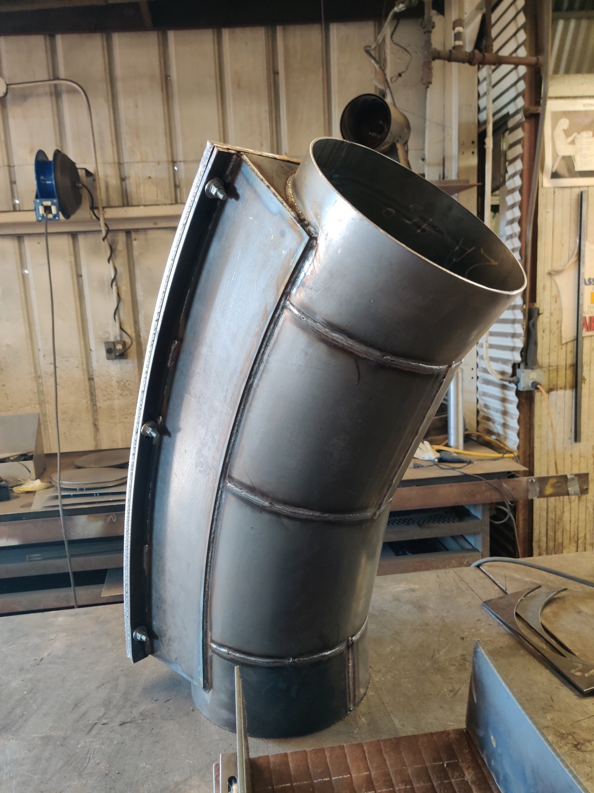

    Well instead of lining it, which then you have to replace the entire elbow when it wears through. You can back it with wear plate and when it wears through the elbow all the cavities fill with media protecting specifically around the flanges. And then simply replace the wear back plate when needed.

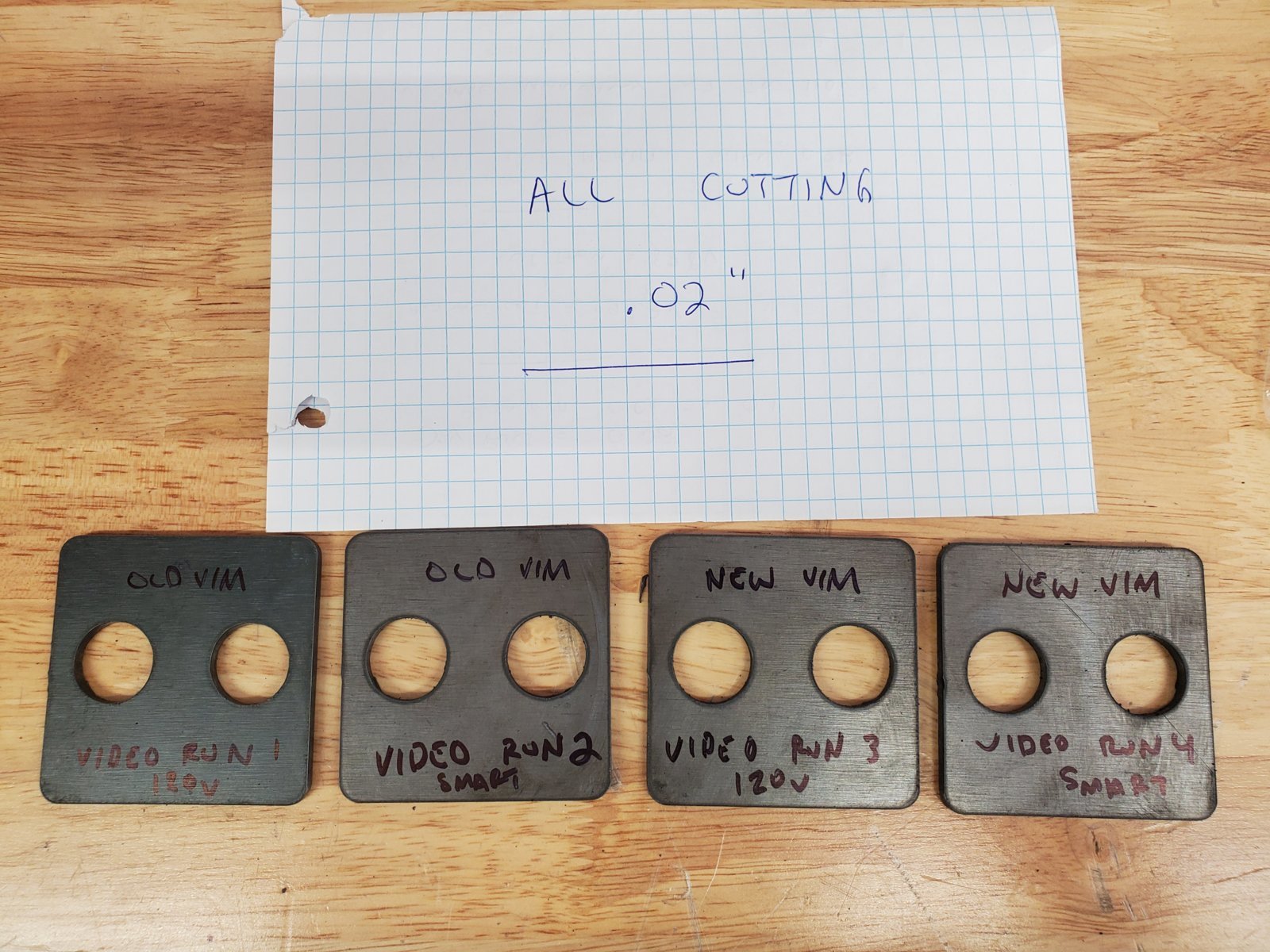

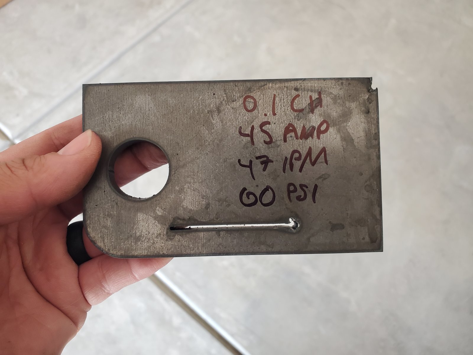

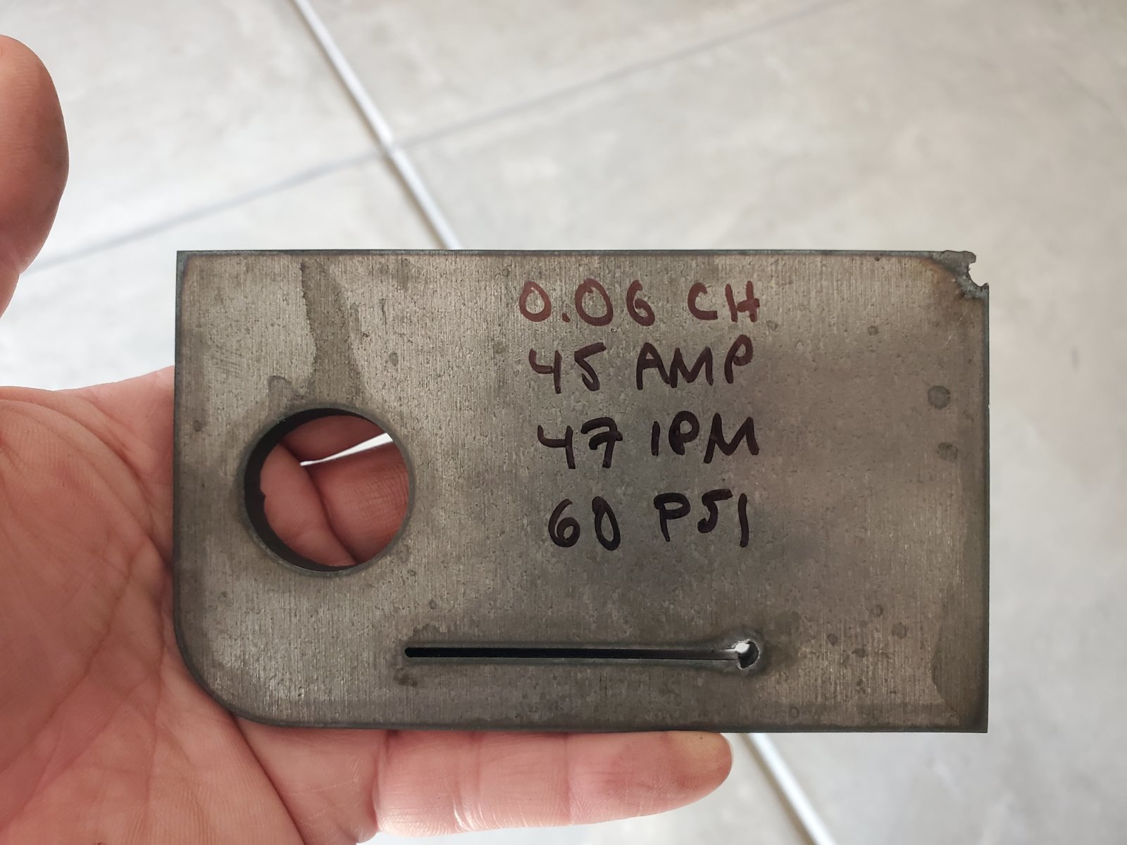

    My CNC table issue is so perplexing, the most seasoned users on the forum can't figure it out and even Langmuir chimed in to say that they have to brainstorm with their team tomorrow first thing in the morning.

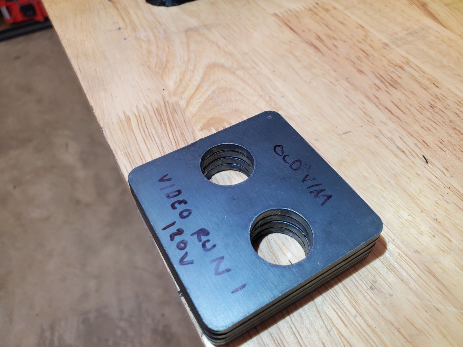

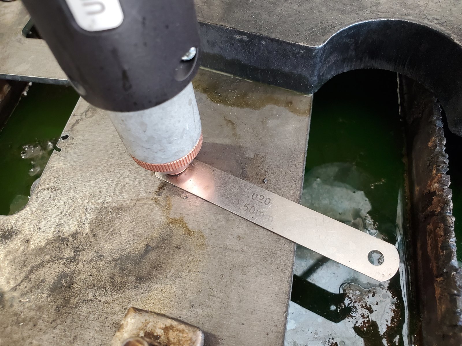

    In the shortest possible explanation - my cut height is stuck at a height of .02" irrelevant to what the G code is.
    This leads me to believe 1 of 2 things -
    A fault in the hardware, causing an interruption of the initial height sense and/or torch height control operation or
    A mechanical issue, which to the largest extent, has been proven to not be the case especially since it is an exact .02", consistently
  7. Nov 5, 2023 at 12:42 PM

    It reads correctly. That's one of the basic troubleshooting steps I'm 20 steps ahead of already.
    Voltage isn't the issue as, get this, a file with no activation points (meaning, won't fire, but cycles z axis as needed with proper springback and cut height) still results in a .02" cut height.
    It's used as a test file commonly on the forum.
    The Z axis has been dismounted, thoroughly checked, no binding, contact switches checked (in place and fully clean). Everything from a physical standpoint is as it needs to be.

    Oh we did that; you can disable THC on Firecontrol and I did run programming that way.
    This means only initial height sensing brings down the torch to the work piece, then springs up to the correct cut height, and THC does nothing at all throughout the cut.
    Result? The same .02"
    Reason? Initial height sensing, as mentioned, sets a cut height of .02" even though programming says otherwise.
    We even had other members provide their own files to remove CAM as being the possible factor on my end; no changes.

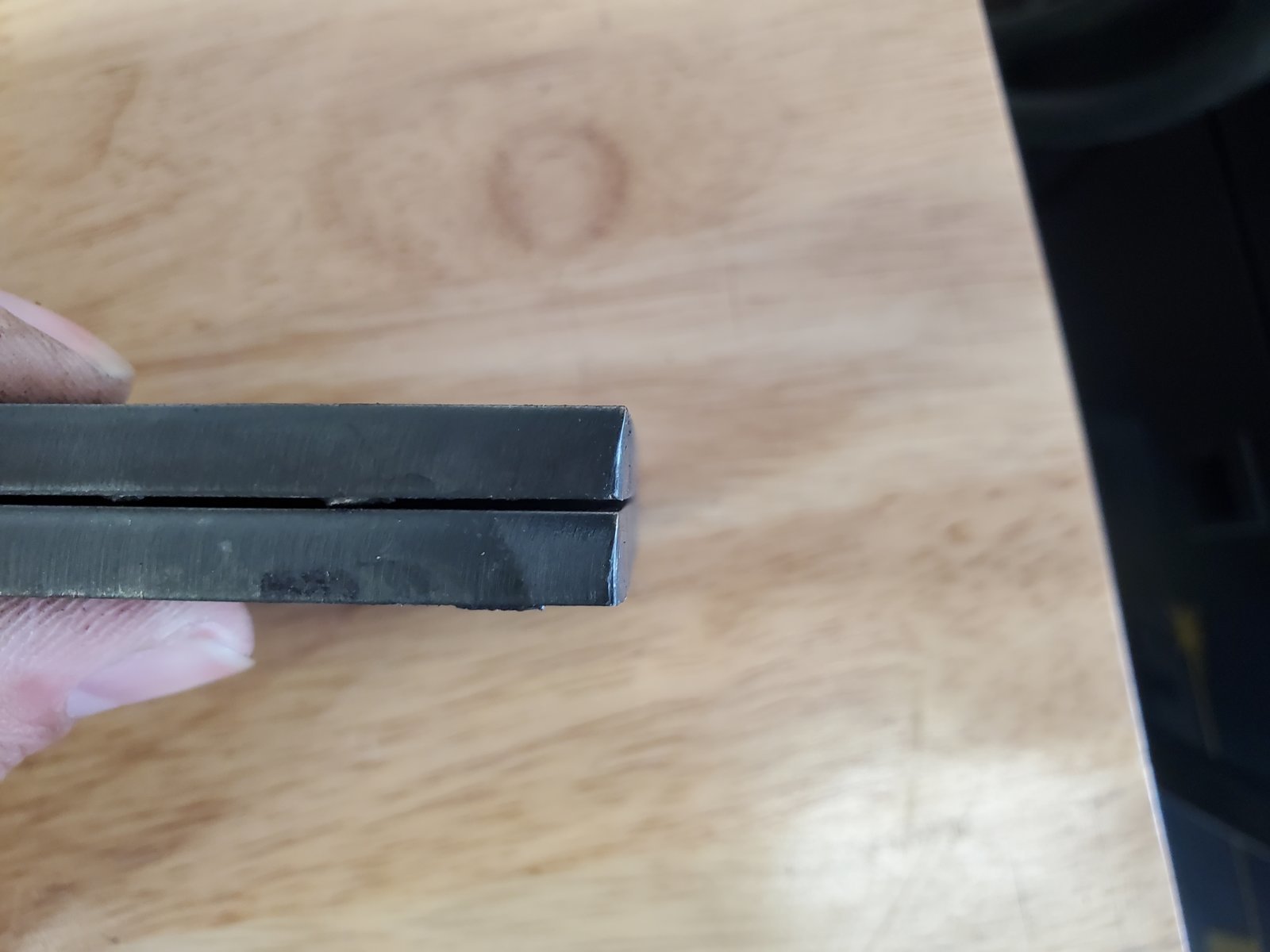

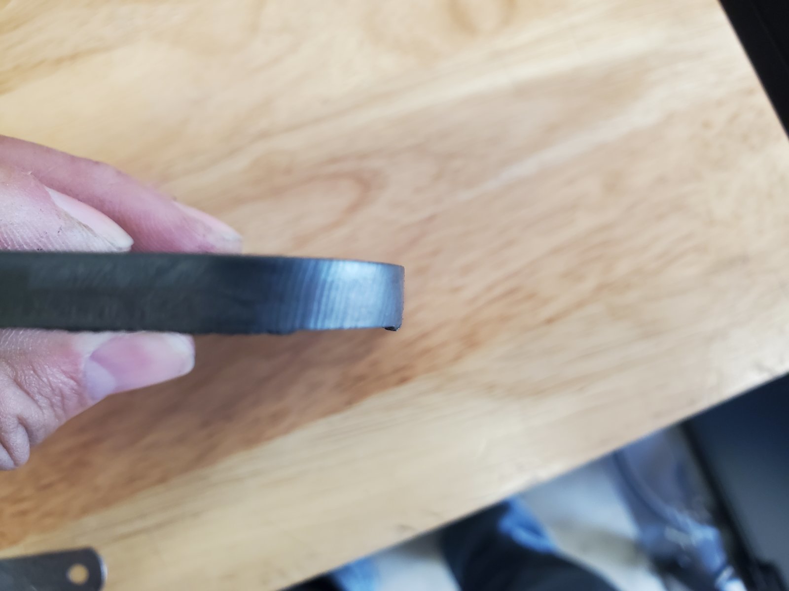

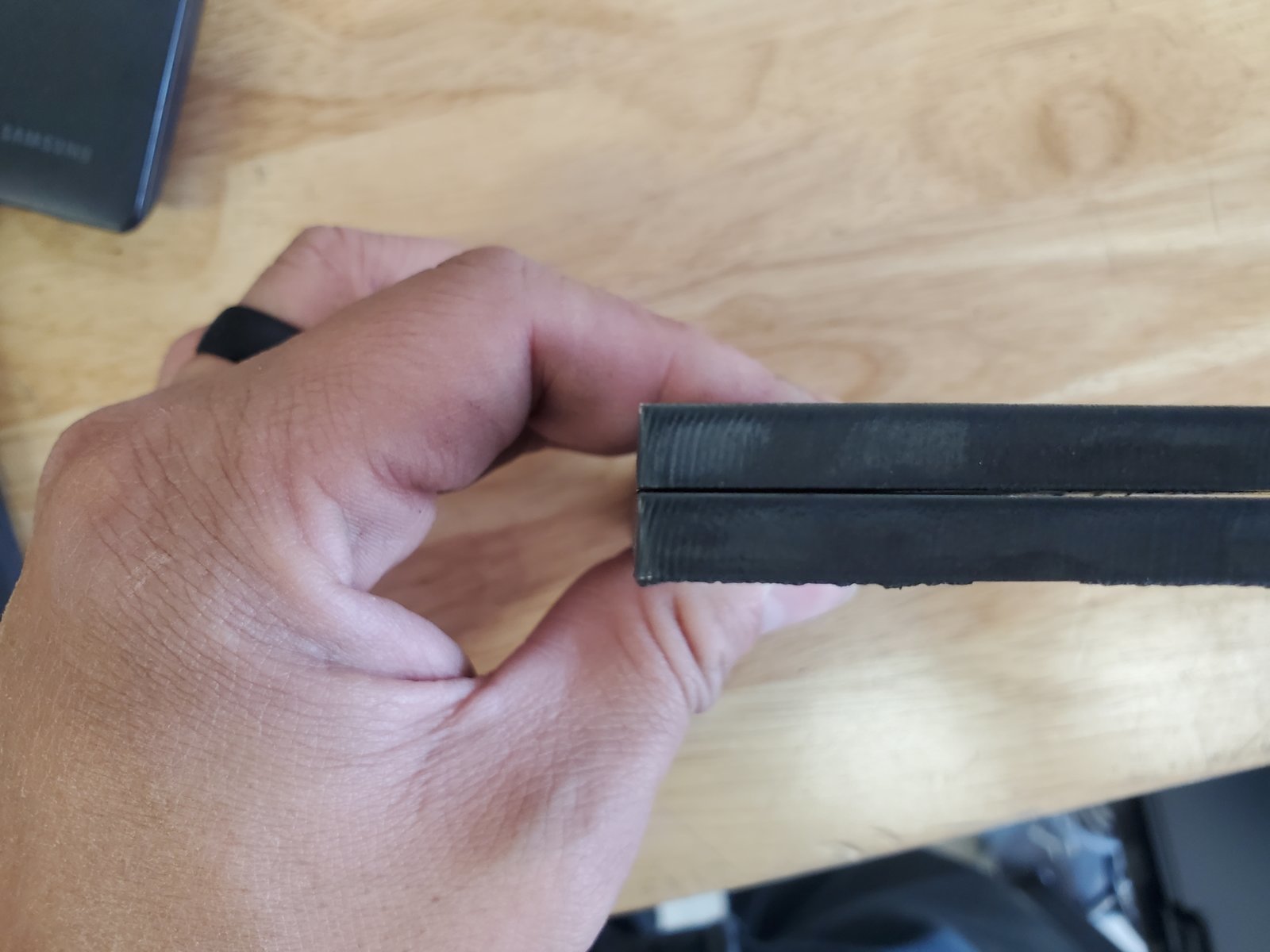

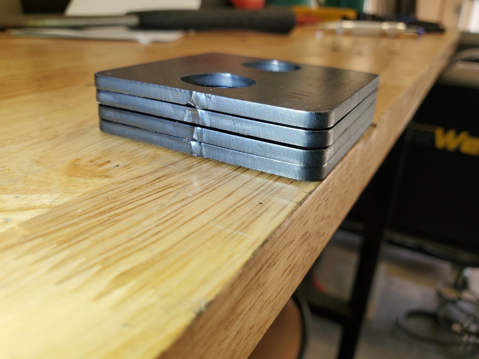

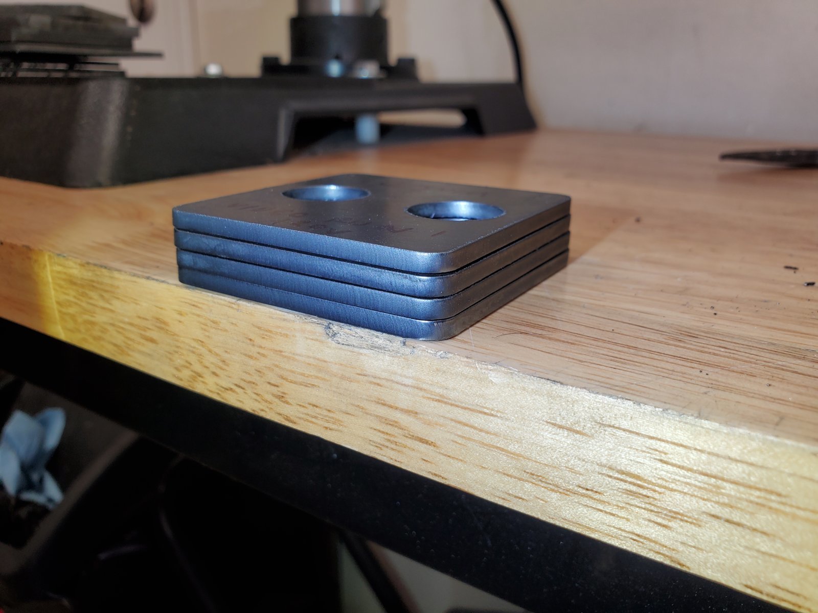

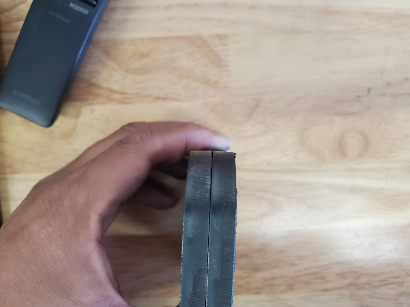

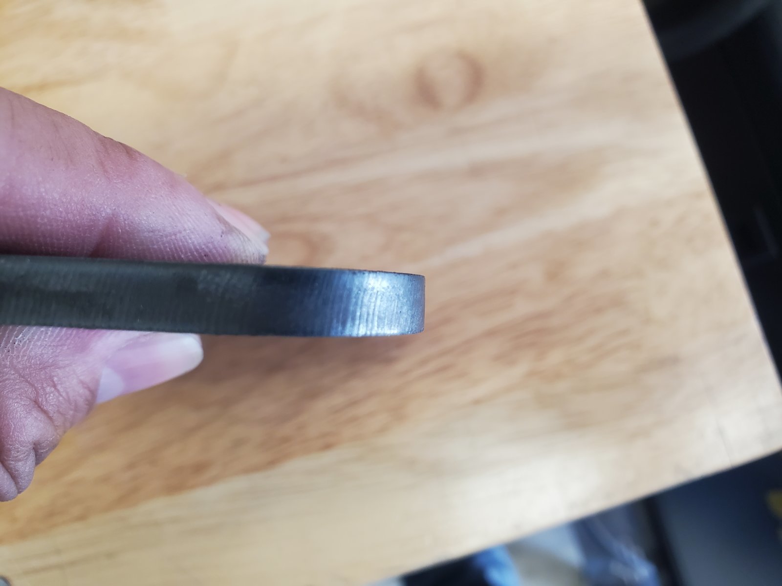

    So that's just it, table runs fine in every other sense of the word.
    Hell, check out these cuts on a test file first with .06" programmed
    And .1" programmed
    The results are identical
    The above is all from yesterday. I measured live voltage while being cut with THC off; no different with it on.
    You can adjust cut height to the work piece, then run a program with completely eliminating the THC module manually (this disables both initial height sensing and torch height control).
    But we're troubleshooting to find out why initial height sensing isn't putting is at our proper cut height. So yes, I did tons of thorough testing all relating to voltages both smart (auto) as well as manually entered all with the same results.
    It's not a voltage thing.
    It's an initial height thing before actual cutting occurs to begin with -
