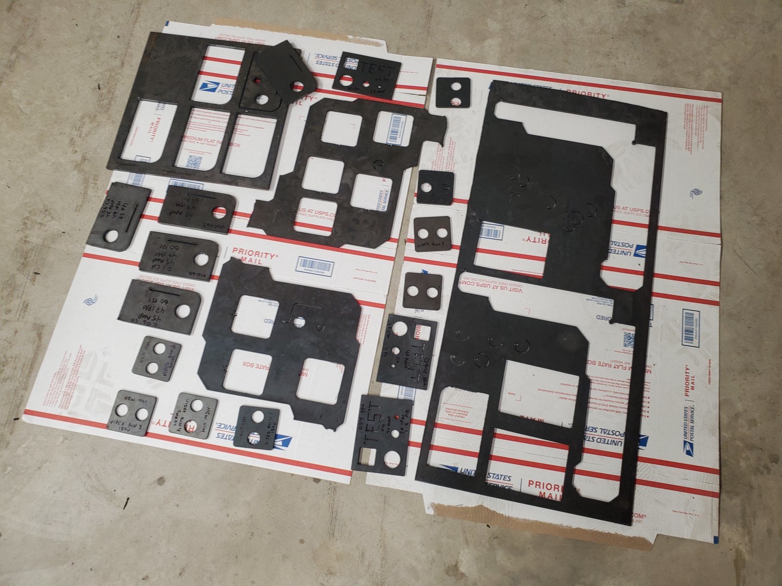

    Someone even mentioned adjusting the speed of my Z axis as it ran that file; I ran it and it did result in a change of speed on the Z axis -
    But still had the same exact result of .02"

    Force THC to work; did something like that but not to that extreme.
    I put (cause I have multiple cut outs) 10 gauge on dross left over that was stuck to the slat; THC did it's thing and showed ACTIVE and moved as needed to maintain an average 93.7v which = .02" cut height

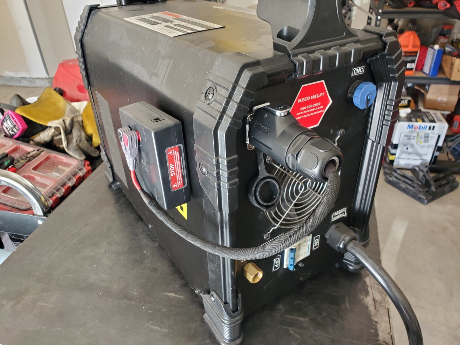

    i'm going to laugh so hard if they come back that it's that fancy connector that i insisted you install.

    What is this fancy connector you speak of?

    I'm still on the same Firecontrol version that has worked just fine since January of this year.
    When did it start, unsure, but the only changes that occurred (which leads me to something may have been cooked) is -
    Around October, I had a THC issue.
    Voltage provided to the voltage input module can be read as DIVIDED, or RAW.
    From January up to October, I ran DIVIDED. Long story short, I fried a resistor (number 8) in the DIVIDED circuit.
    I got a new voltage input module sent however, I went ahead and wired up for RAW voltage and continued using the same module as they are separate circuits.
    So going from DIV to RAW is the only change; in my troubleshooting process I did incorporate the new voltage input module but yielded the same exact results meaning the module is not the issue.
    That's why these pieces say "OLD" and "NEW"
    Now to answer your question about 'when did it occur' or better yet, why did I notice?
    I think I didn't notice it right away because I had only been cutting 16 gauge since October. It's too thin to show any real beveling.
    I ordered a new torch and in anticipation, I wanted to create test cut files the same way I did in January when I set everything up.
    I'm a 'perfectionist' in a sense in that, I wanted to properly set my torch height correctly for the new torch as I was physically removing the old one.
    That's when I noticed my cut height did not change and well..how we are where we are now.

    This -
    But if anything, the cable run is physically shorter and would not introduce any resistance to make a difference.
    The initial pierce still shows 120v if you watch the videos -
    https://youtu.be/ROaB3EerrgA?si=BWpnoJB0JXiJM3G3
    https://youtu.be/XrwJ8EV2VFo?si=GBrH3qKNK4JKErN2
    Plus, if it was the port (consisting of only 2 wires) why would a non-firing run result in the same incorrect height?
    soundman98[QUOTED] and Drainbung like this.

    I'll be trying that tomorrow; I cut all this out already. It's not just the pieces cut out, but the many cuts on the larger panels where I would pause mid cut to measure height multiple times
    All 1/4" and 10 gauge

    seriously though, your setup before was 2 open wires that were somewhat separated from each other. combining those 2 wires into the loom makes it look nicer, but depending on the frequency you're dealing with, could introduce EMI between wires.
    i really doubt any part of this is your problem, it really sounds like a software issue.. i would try a different pc if possible.
