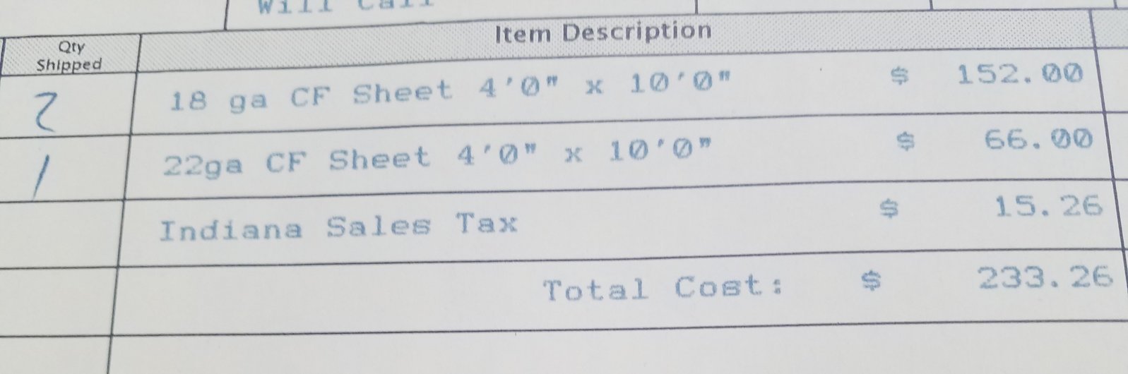

    I am blown away by the price you guys get steel for down south! Here's some local (Toronto GTA) prices for comparison. These are from metal supermarlets and can usually get 10-15% cheaper by in store quote or other local supplier.
    Your prices are inline with what I used to pay 20 years ago!! 1" .065 square CREW used to be just under $1/ft now $4/ft is teh minimum price we expect to pay here.
    If theres anyone here North of the boarder that knows much better options, I'm all ears.

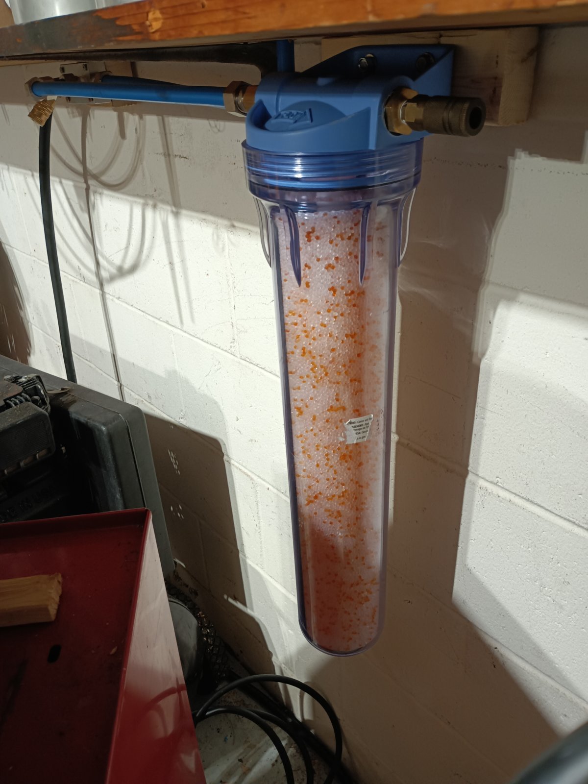

    That little desiccant in a tiny container doesn't do very much. I need large volumes of dry air to run my O2 scuba booster. I get big jugs of desiccant on Amazon for about $25. I made this several years ago. It didn't cost much more than buying on off the shelf unit. It's only rated for 125psi, but I have a regulator in front of it anyway.

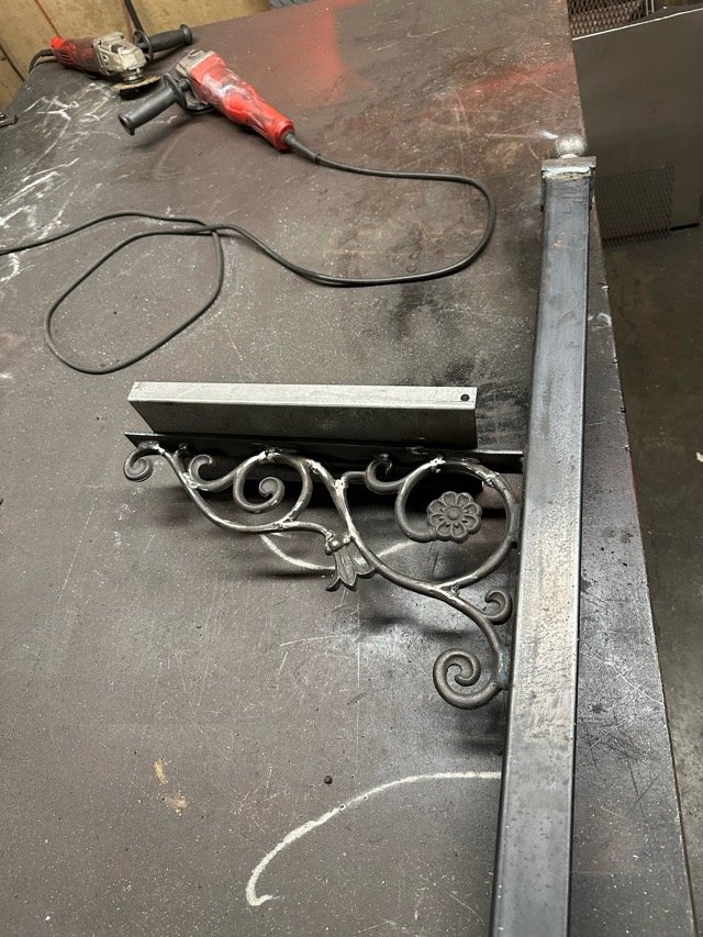

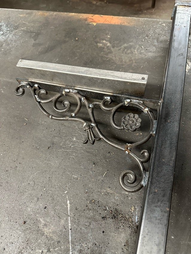

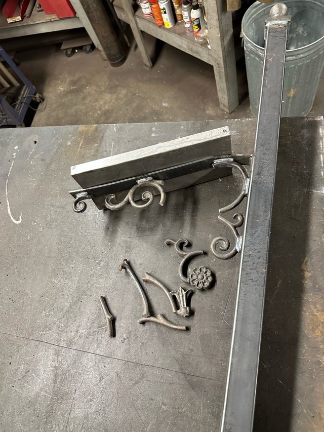

    Once they powdercoat it I still won’t be able to see it from my house. I’ve never been a fan of puzzles.

    Now that is a desiccant filter :rofl:

    Dang, who cut them?
    Least it isn't cast aluminum, that stuff sucks to weld.
  9. Nov 29, 2023 at 8:24 AM
    six5crèéd
    six5crèéd Be the light
    Jul 9, 2019
    #298734
    35,983
    Southern Virginia
    8 lugs no plugs
    Somebody dropped it and broke it, it was a cast steel piece :thumbsup:
  10. Nov 29, 2023 at 8:41 AM
    Kwikvette
    Feb 27, 2019
    #284735
    81,768
    Fresno County
    4 run, 2 don't
    Well sir, it looks good
    We poured our own, and the aluminum used was all recycled from cans, broom handles, you name it
    And welding on it? Holy shit :bananadead:

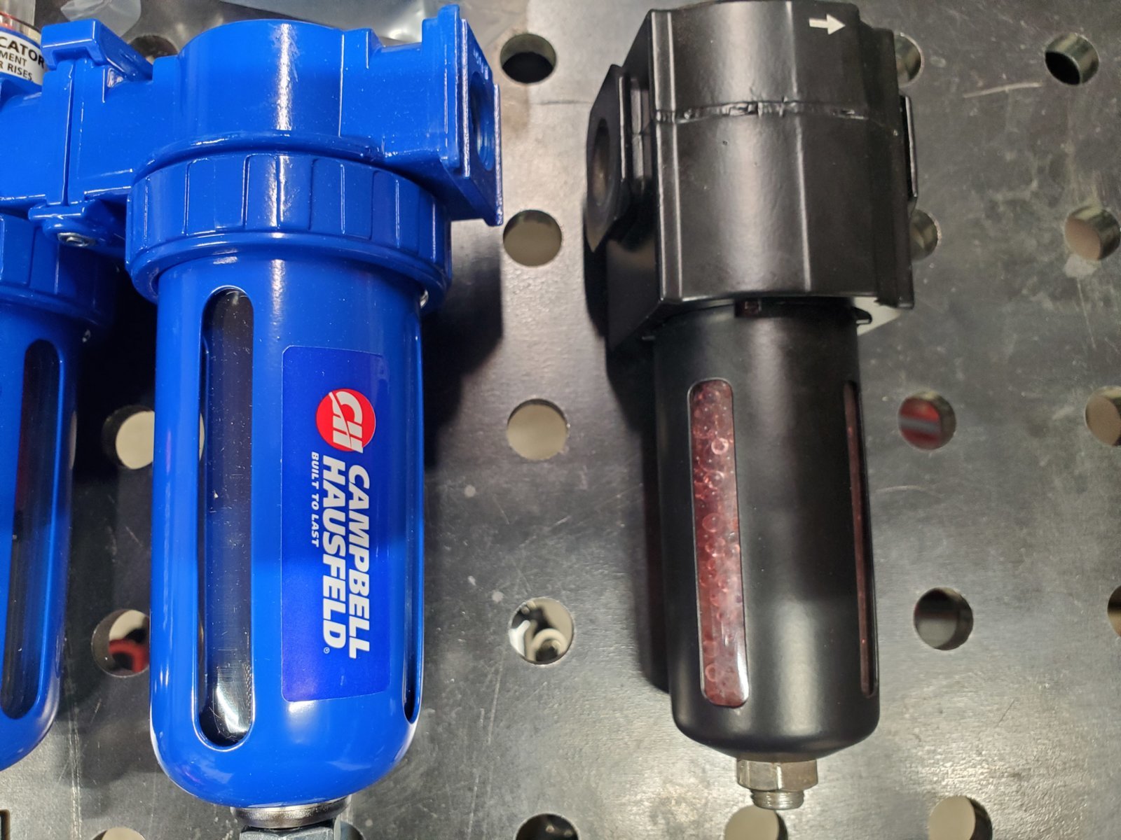

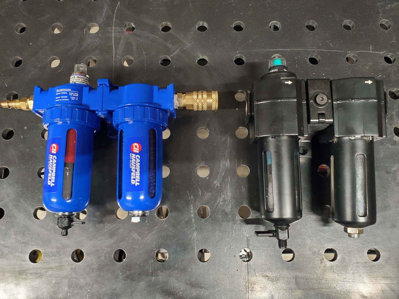

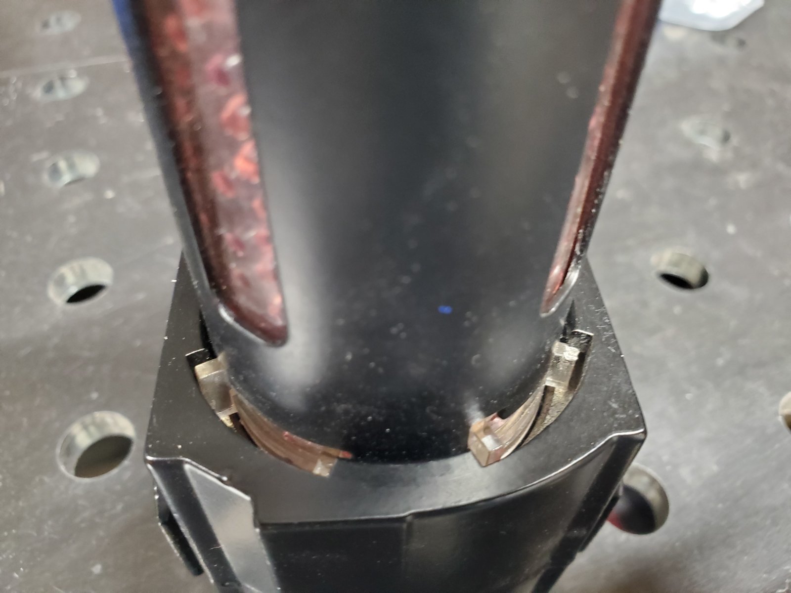

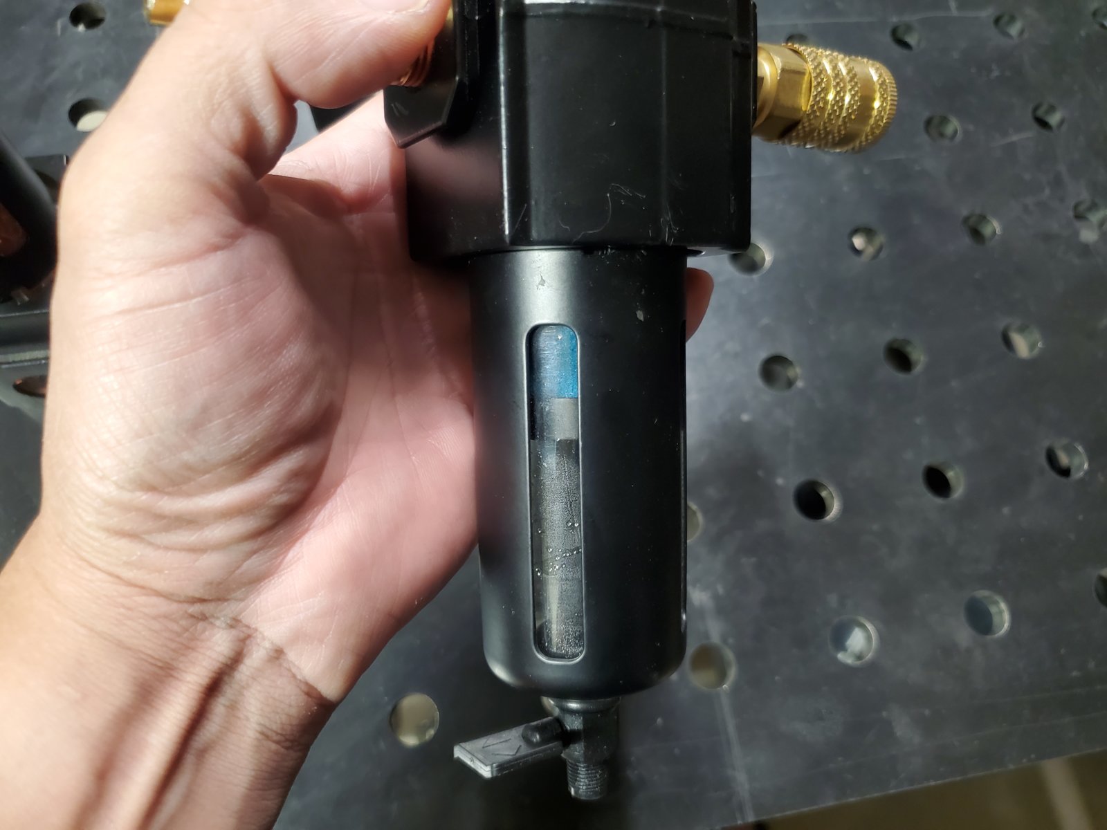

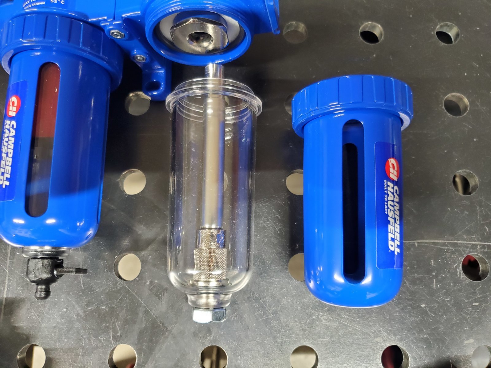

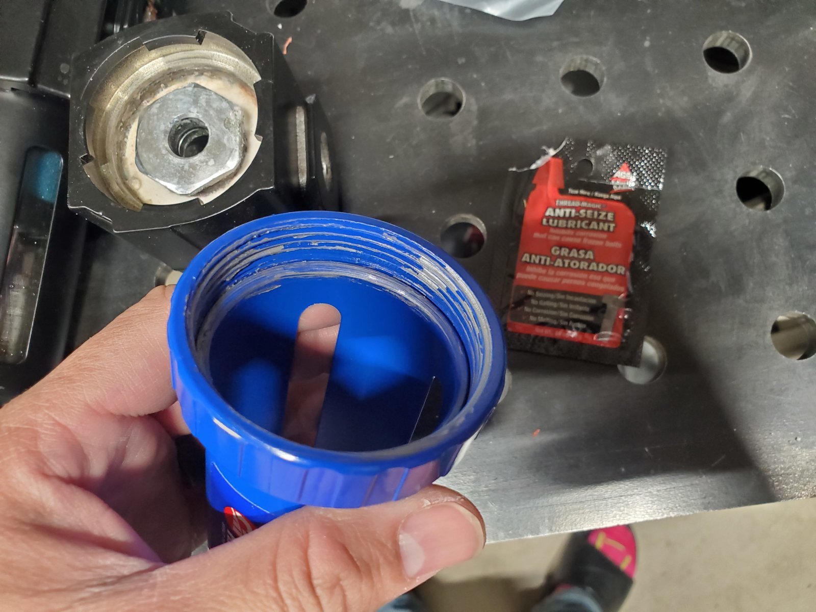

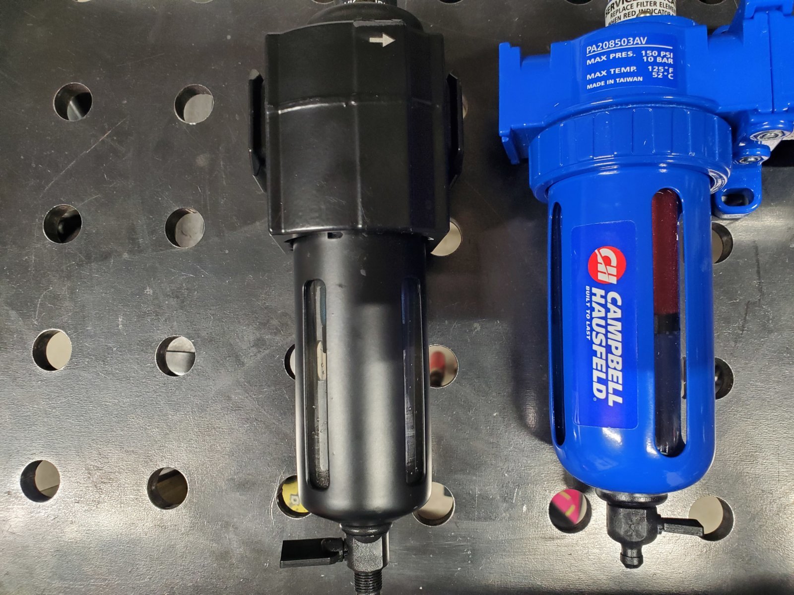

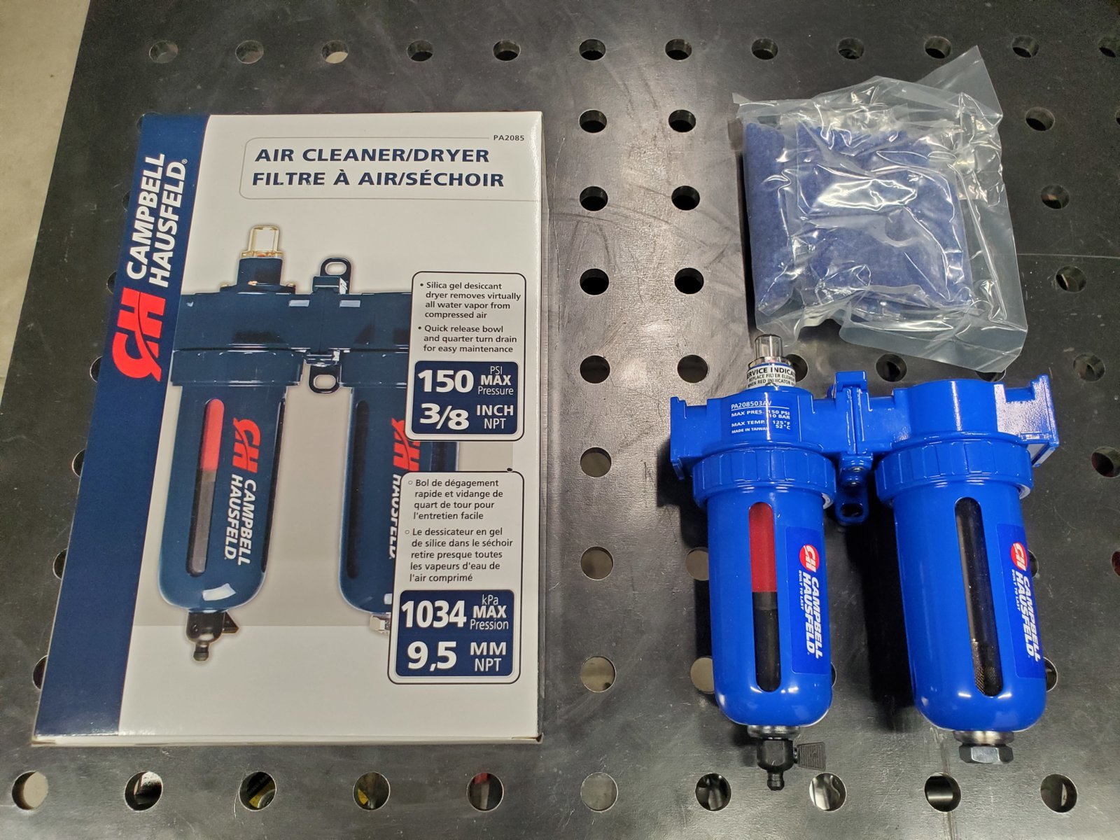

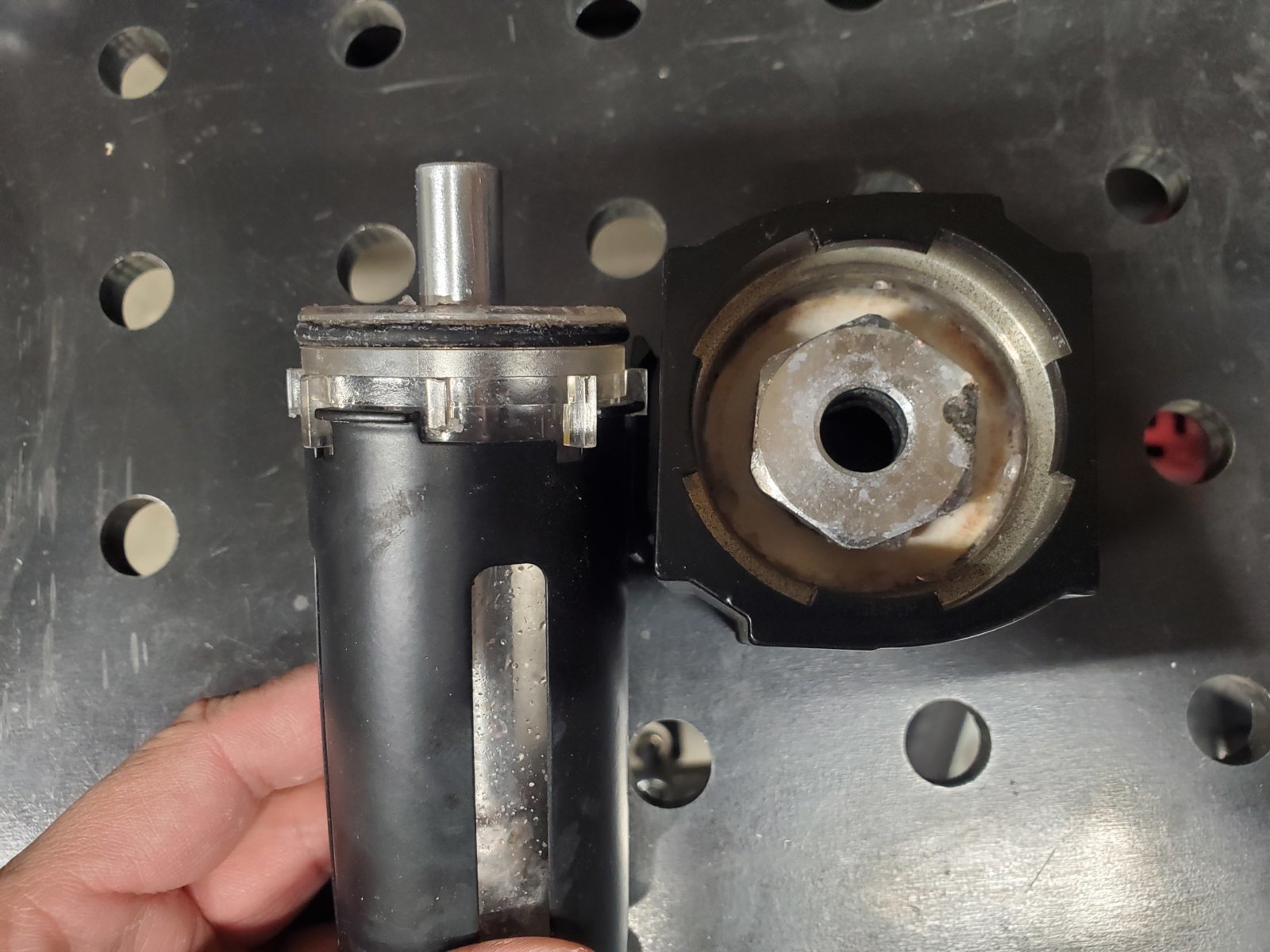

    See, this is how the cheap filter "screws" together with the use of these plastic tabs
    Finally got it apart; it's nasty inside
    Replacement arrived
    Small comparison, if it matters. The bowl is slightly bigger and the foam filter insert is larger on the CH
    The downside is the drain valve on the HF feels tighter
    The desiccant side
    You can see the bowl is much easier to remove
    I figured if plastic alone gets as nasty and as gunked up as it did, I'd use a little preventative on the metal itself
    We'll see how she does, hopefully no leaks

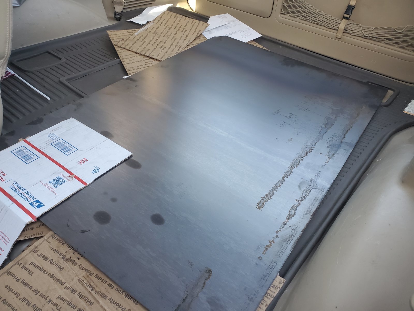

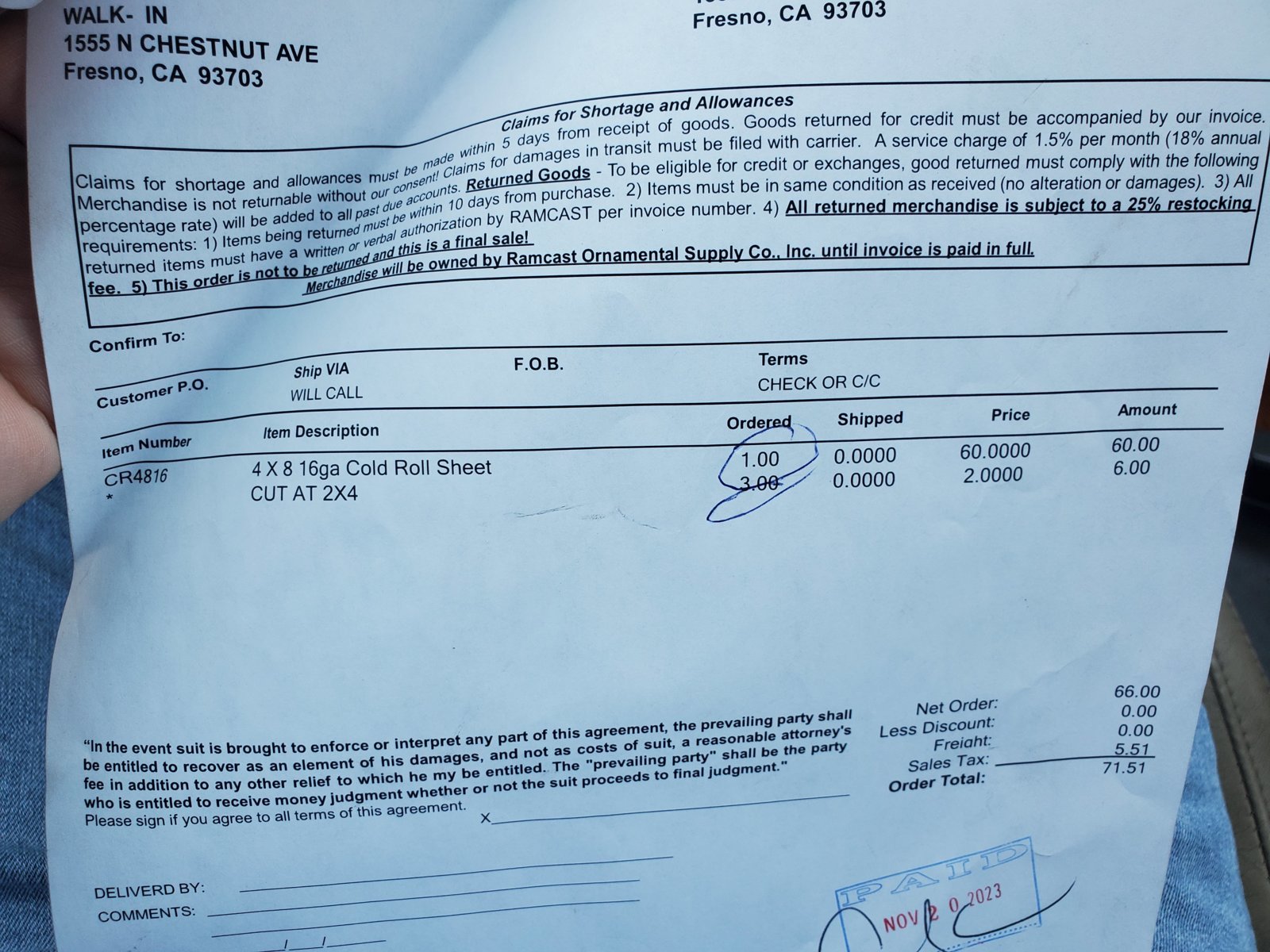

    Just paid $10 for a 2' x 3' hot rolled 16 gauge a few minutes ago
    And the order of cold rolled recently

    Its almost worth the drive to pick up at those prices. I wonder how much i could disguise as skid plates crossing back? :rofl:

    This is awesome! Run a pair and you could regenerate one unit while using the other unit.
    I'm so humid in the summer, the unit that KV posted would be useless after 2 hours.
    I'm not sold on refrigerated air dryers, I think they are more complicated than they need to be.
    A desiccant dryer down stream from some copper loops to condense the majority of the water would most likely be fine for what I do.

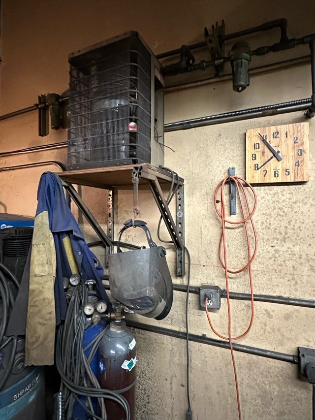

    We have this dryer at work, if you’ll notice it isn’t plugged in and hasn’t been for a while. We have an automatic drain on the compressor that comes on every 30 minutes. That helps a lot and we don’t see much, if any moisture in the hoses.
