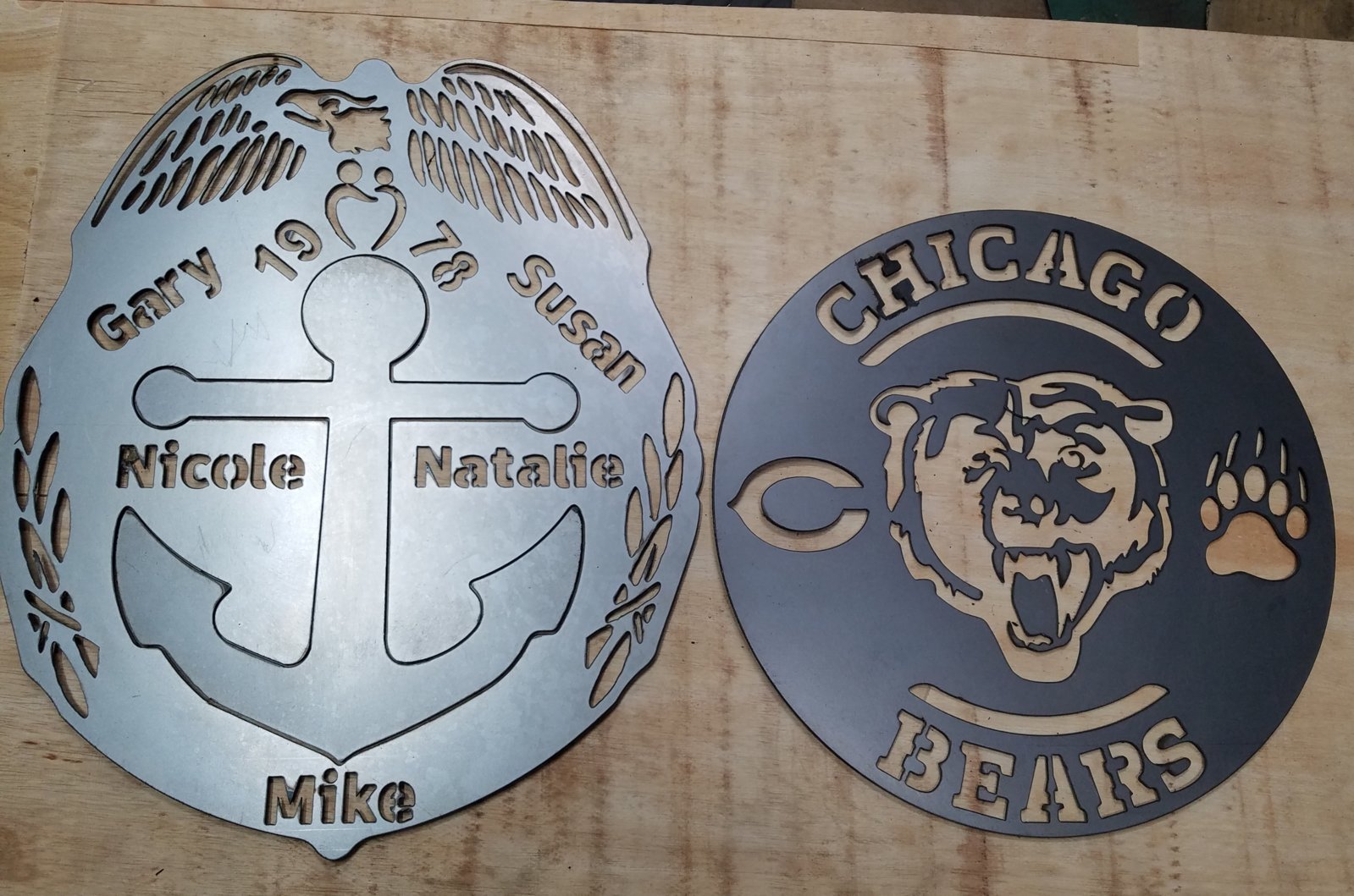

    I haven't had any cutting time for a little over a month. I got a chance to cut two 18 gauge signs this afternoon. Both will have 22 gauge backplates and wall brackets. Hope to get the garage heated tomorrow afternoon and get started painting them.
    The Bears one is for my sister to give husband for Christmas.
    The other was a request for me to design a tribute a friend could give her Dad for Christmas. He is a Navy vet and a retired State policeman. She also wanted marriage and family represented. It's supposed to look like what cops call the "potato badge" and then the Navy anchor. I think it'll look good when painted. I have a 4 color paint scheme planned.

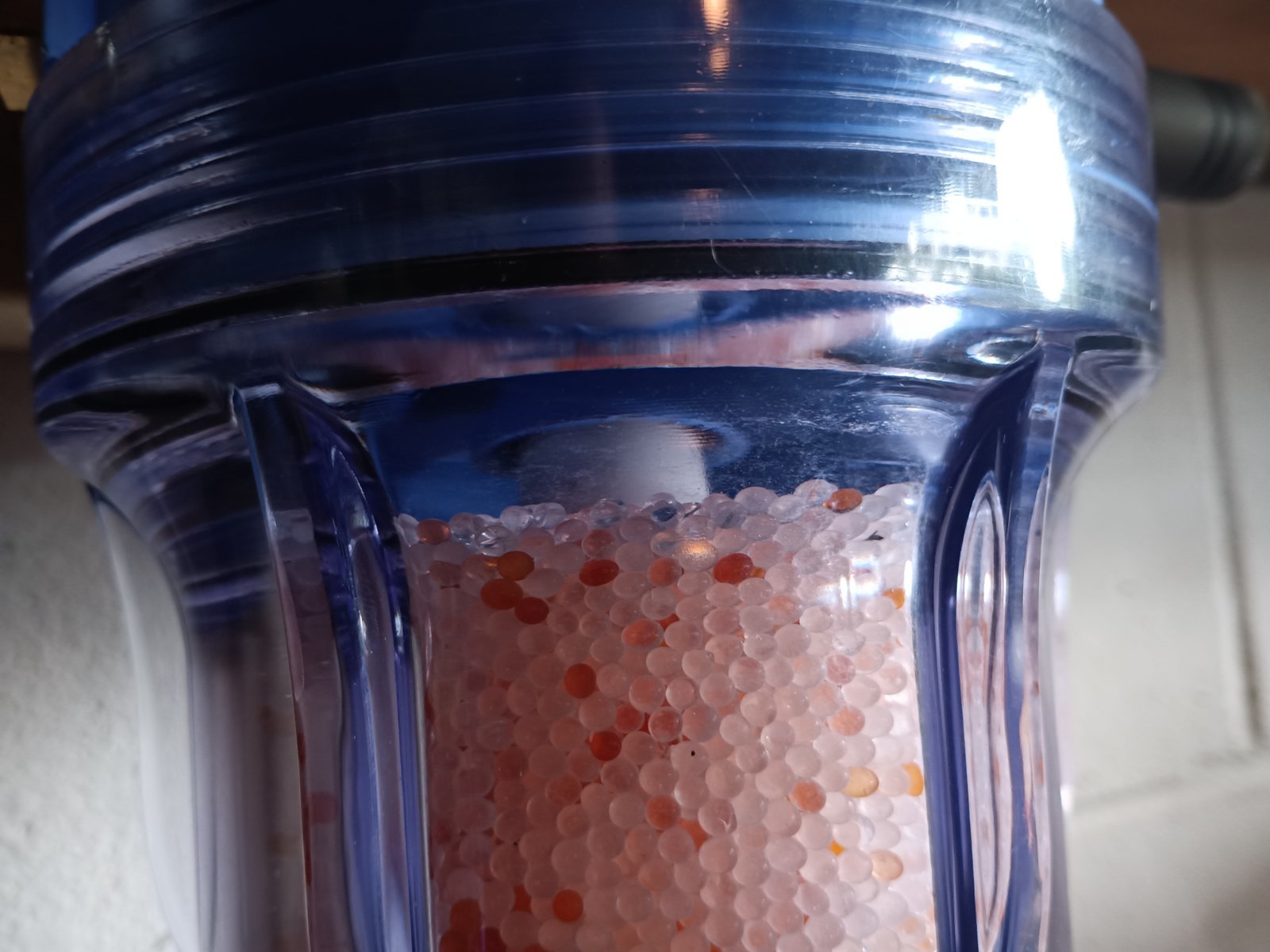

    When I have time, I'm going to make up a copper zig-zag with some drain valves in the valleys to mount on the wall in front of the desiccant.
    3/4" thin wall PVC pipe fits the OD of where the filter cartridge normally sits in those Hayward housings. It's really just as simple as getting the pipe length correct so it seals when you screw it shut.

    I think I know what you mean, but I think others would like more description about the 3/4" PVC pipe part.

    The pipe seals against the top and the bottom when you cut it to the correct length. Drill some very small holes in the bottom ~2 inches. I also filled my piece of pipe with a stainless steel scrubby. Put the pipe in the housing. Fill it with desiccant, center the lid and screw it on.

    Exactly what I was hoping you would post.

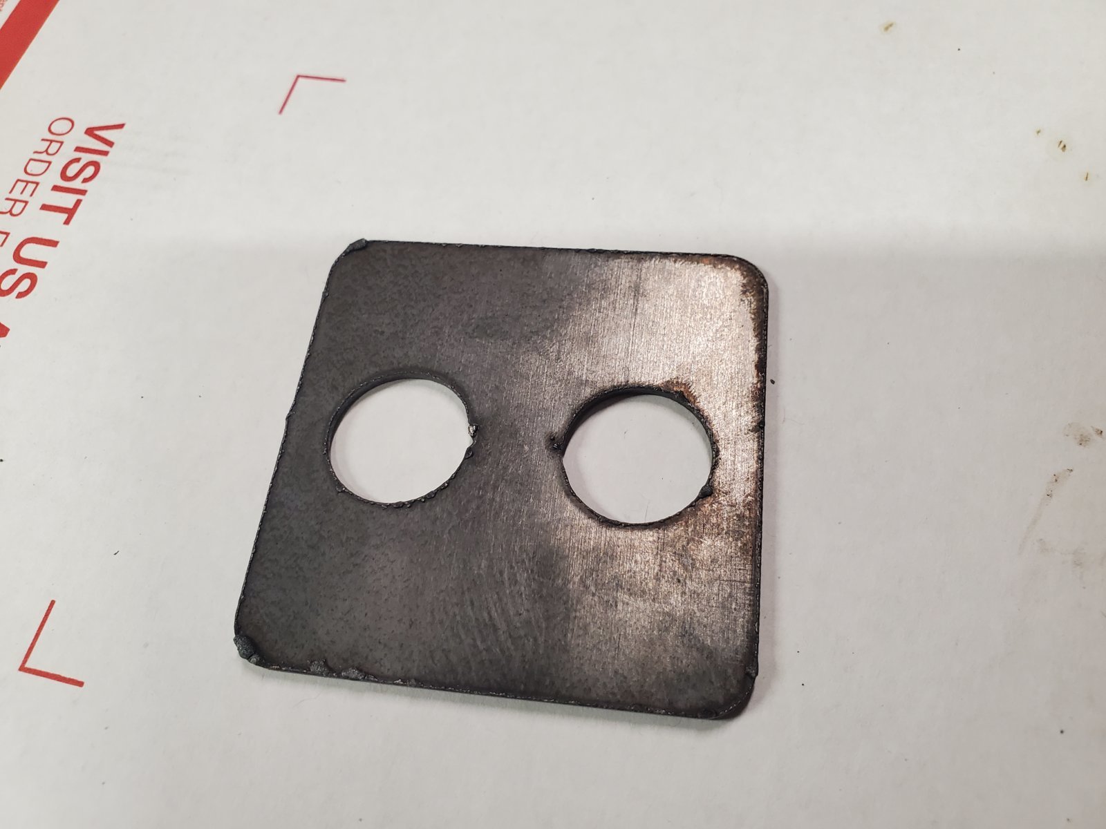

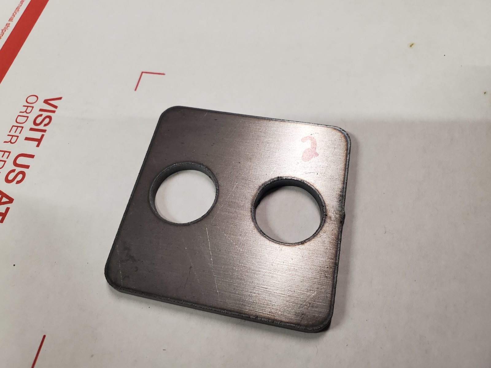

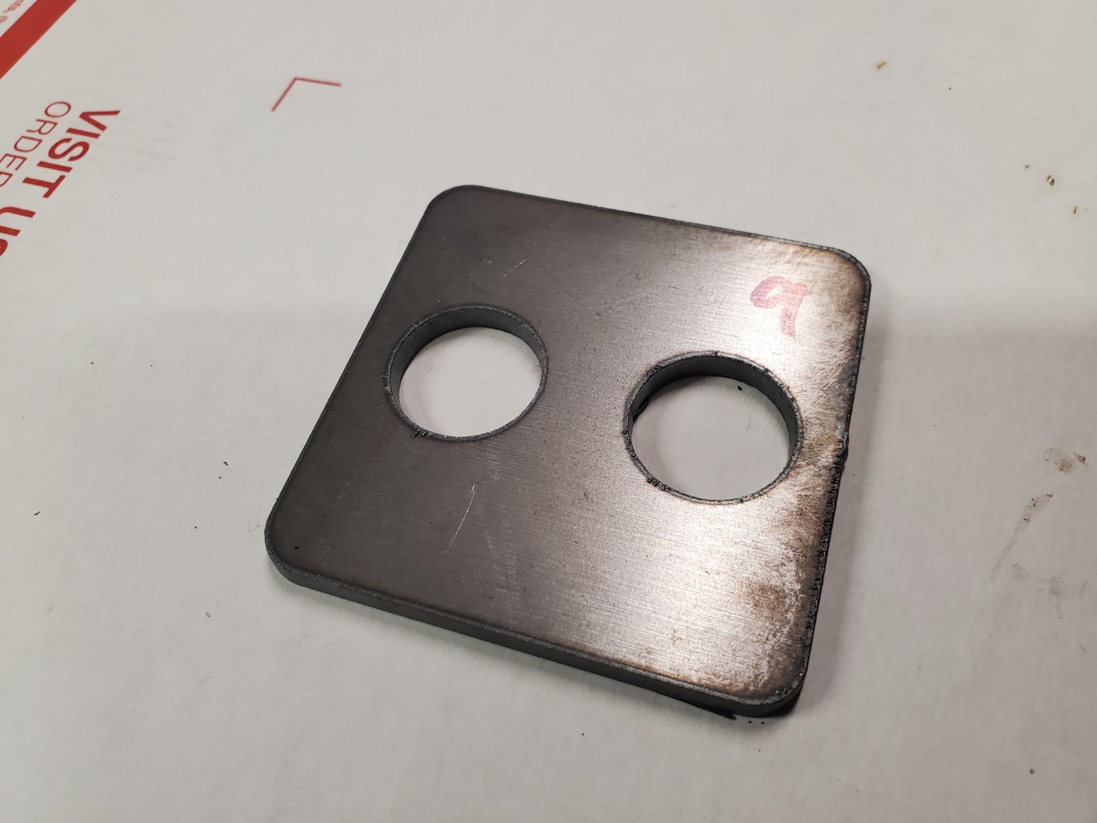

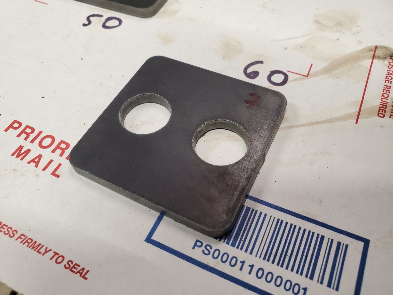

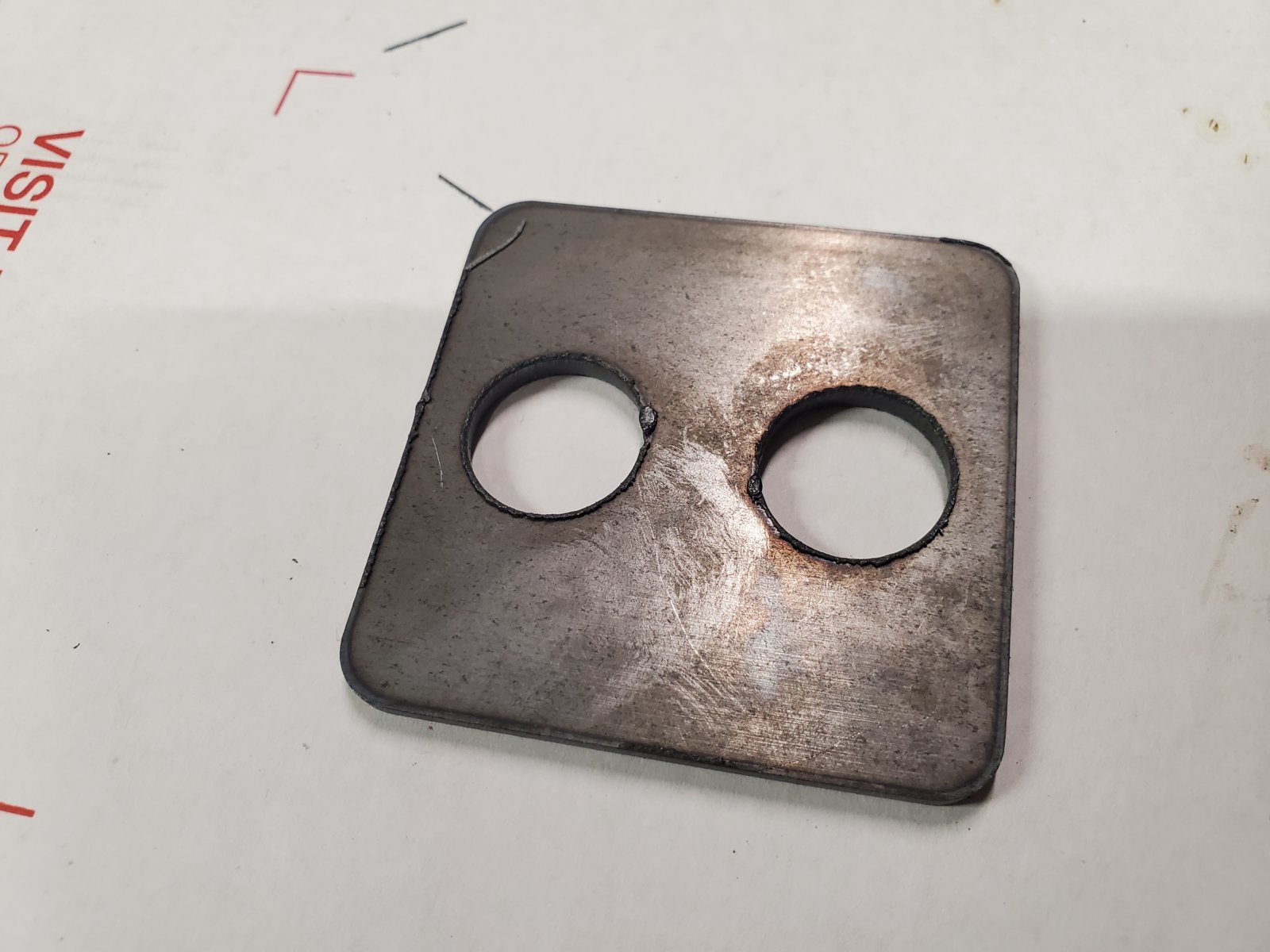

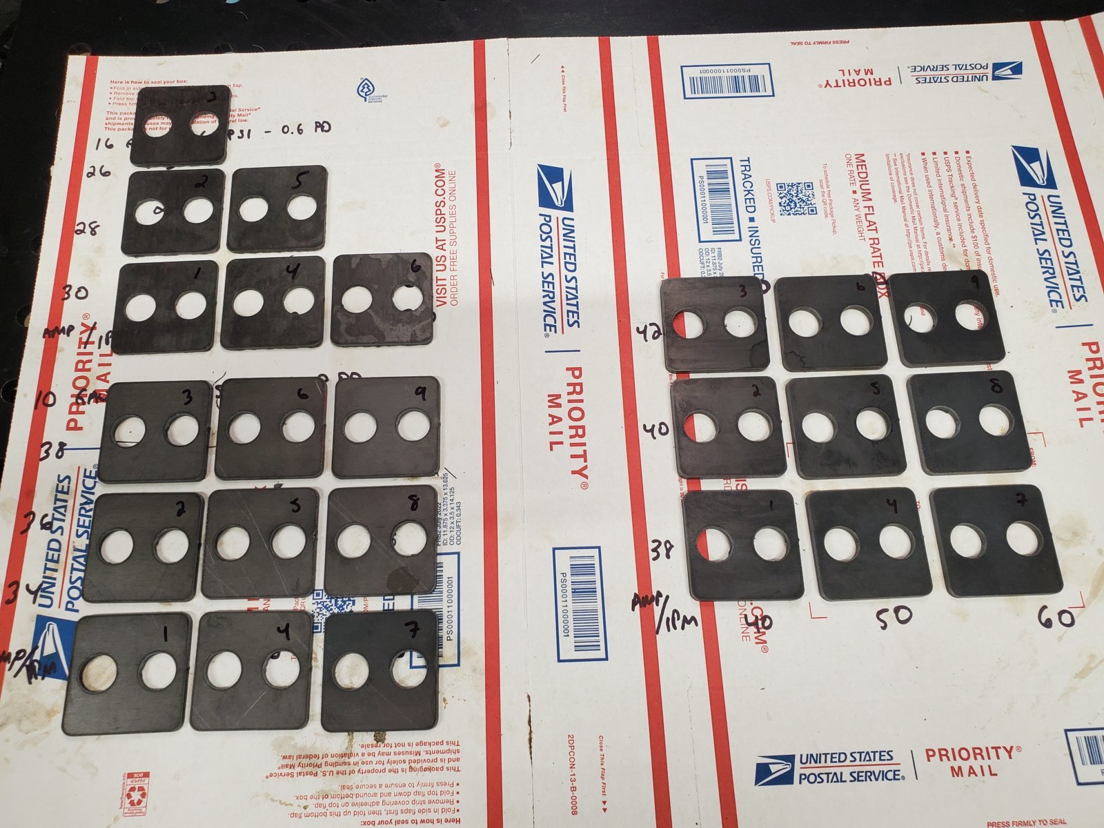

    Even though I ran multiple signs and whatnot on the new torch, I figured it was finally time to 'dial it in'
    Decided to work on 16 gauge and 10 gauge for a bit; I'll need to add a few 12 gauge profiles not to mention do the test cutting for 3/16" and 1/4"
    I have most of my settings documented for when I used my PTM-60 torch however, I found out instantly on the first thing I cut that these settings won't work on the UPM-105
    Three test cuts, each at varying amperage (2 amp increments above and below recommended) not to mention three cut speeds per amp setting (10 ipm increments above and below recommended)
    On average, my speeds were about 20ipm slower but also required less current compared to the older torch
    For those wondering why there are some test cuts missing in the 16 gauge section, it's because the cut quality was so far off that I disregarded further testing in that speed and/or amp setting
    All right off the table, no clean up

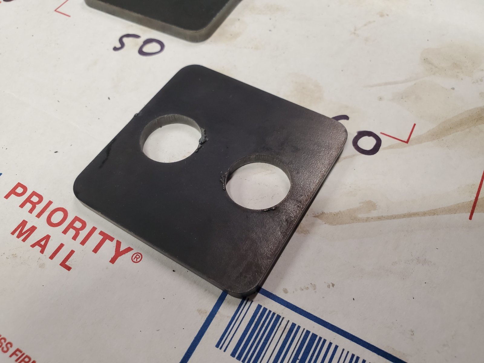

    Best piece on 10 gauge
    Best piece on 16 gauge

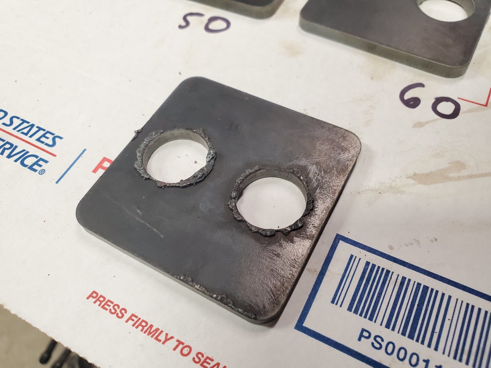

    Worst piece on 10 gauge
    Worst piece on 16 gauge
    Tomorrow if I get a chance, I'll run some test cuts on the other gauges mentioned above otherwise it'll happen in the next few days
    All with a 1.0 kerf width, and running the new air compressor and desiccant filter setup

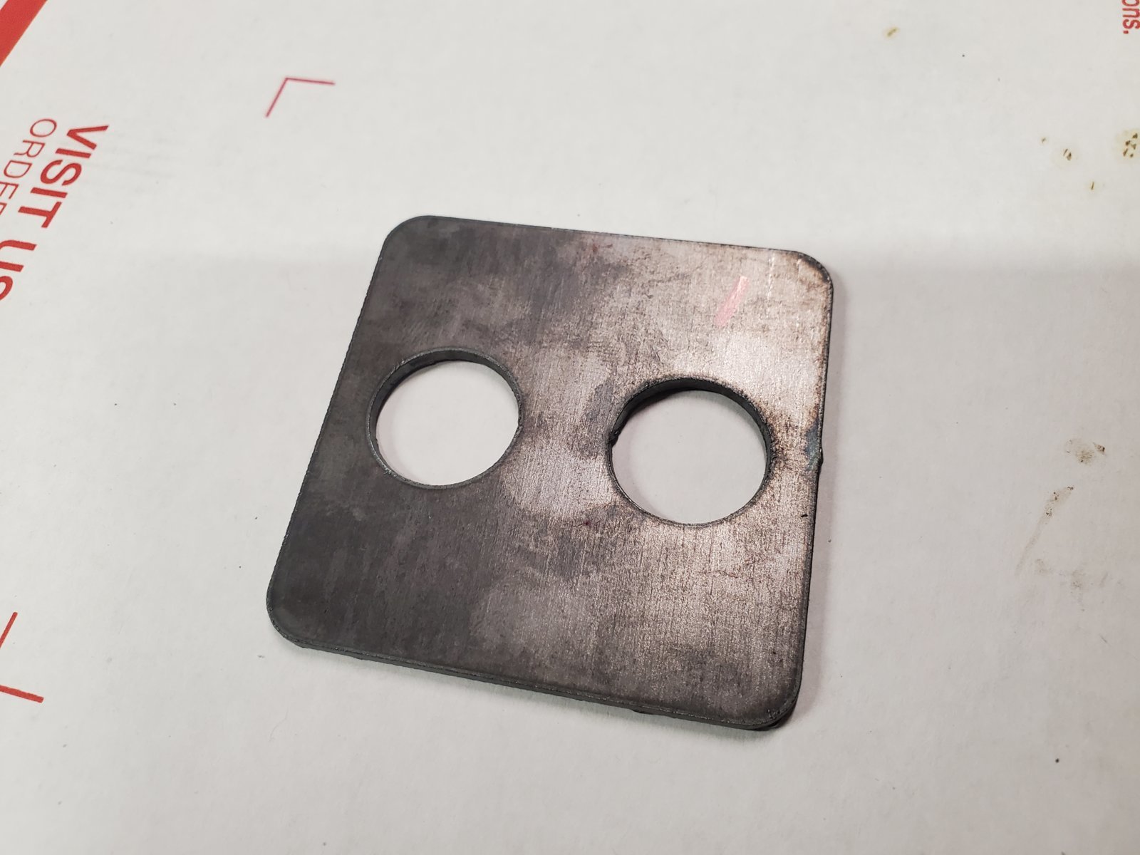

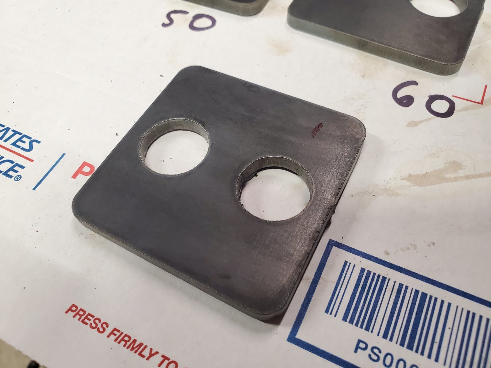

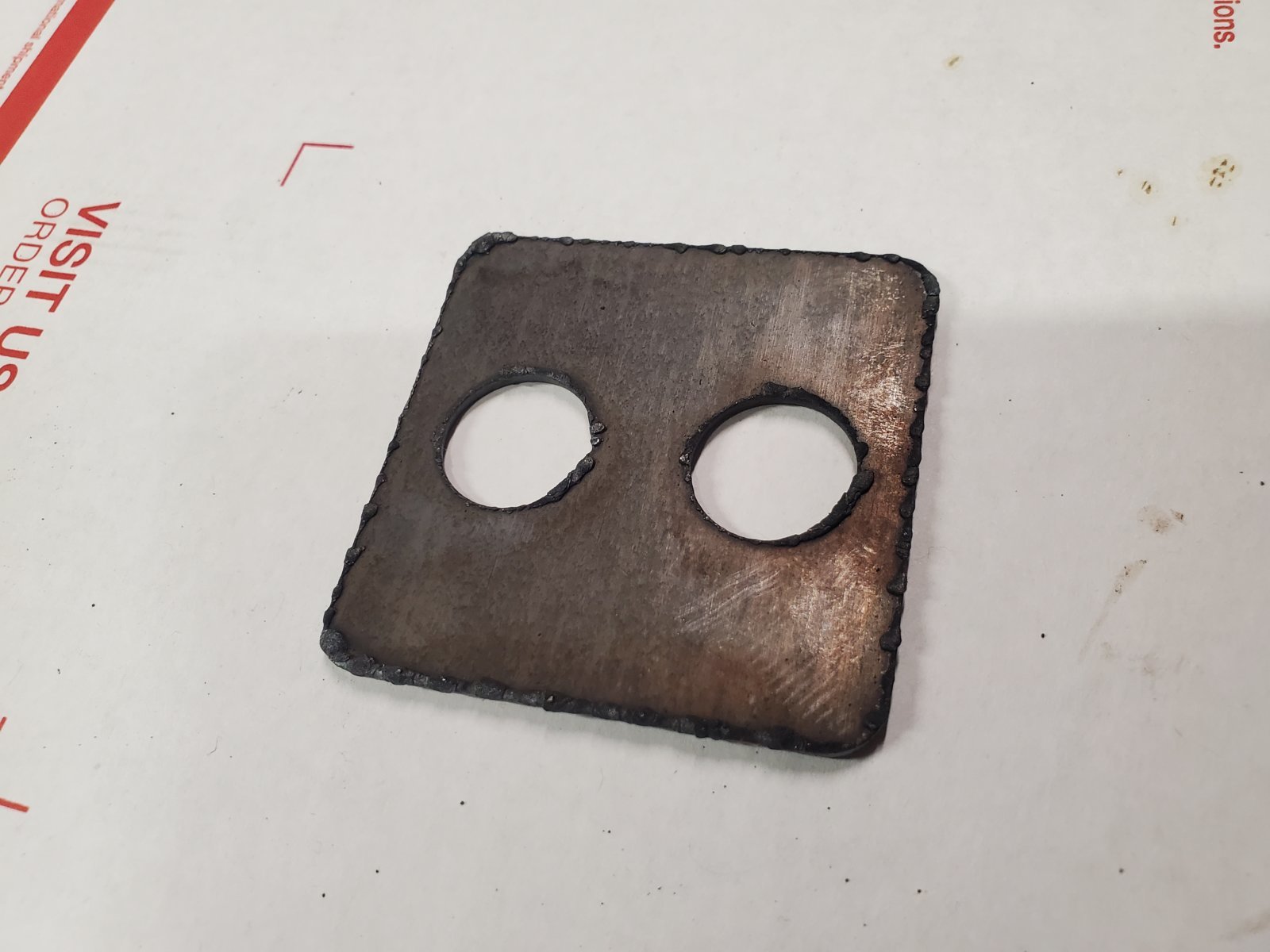

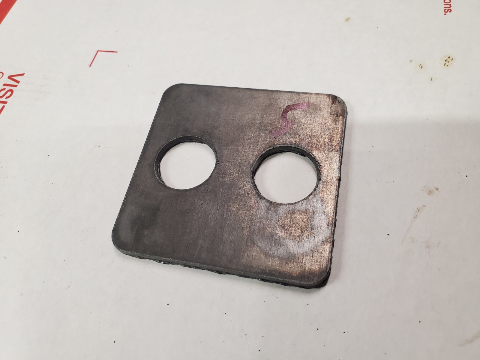

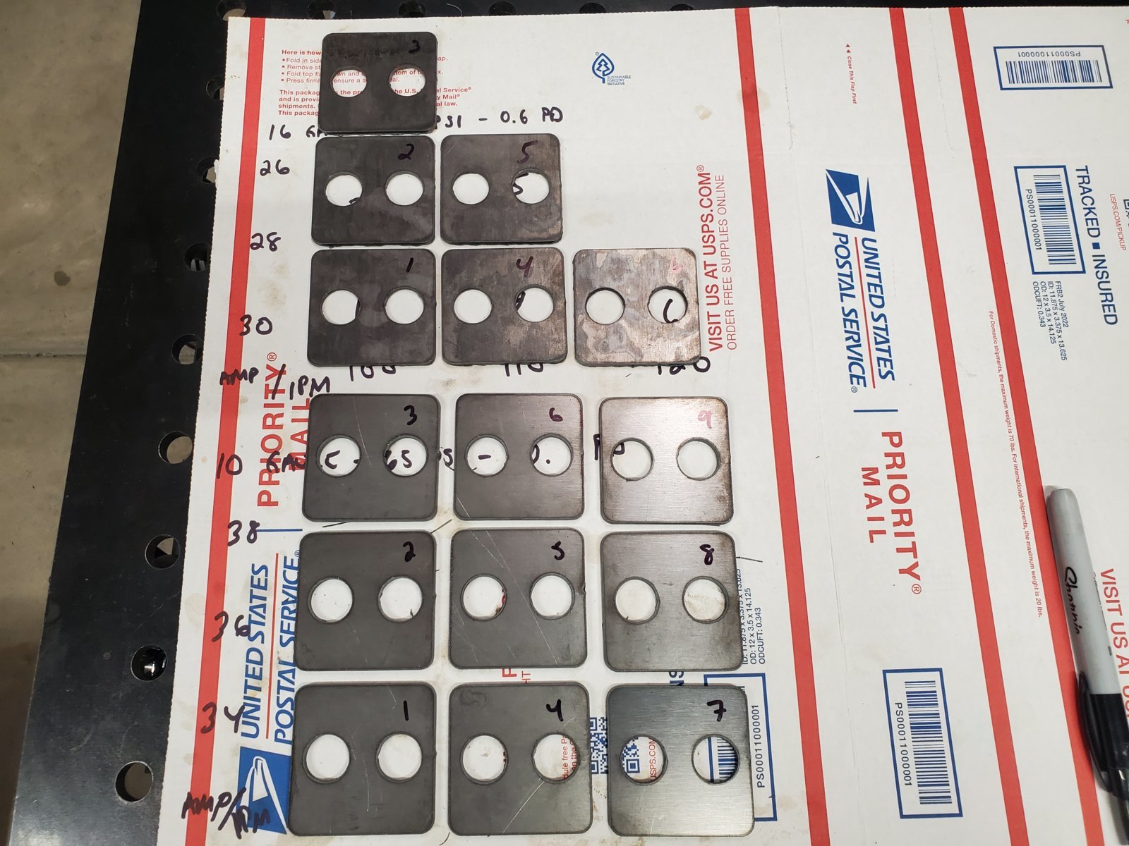

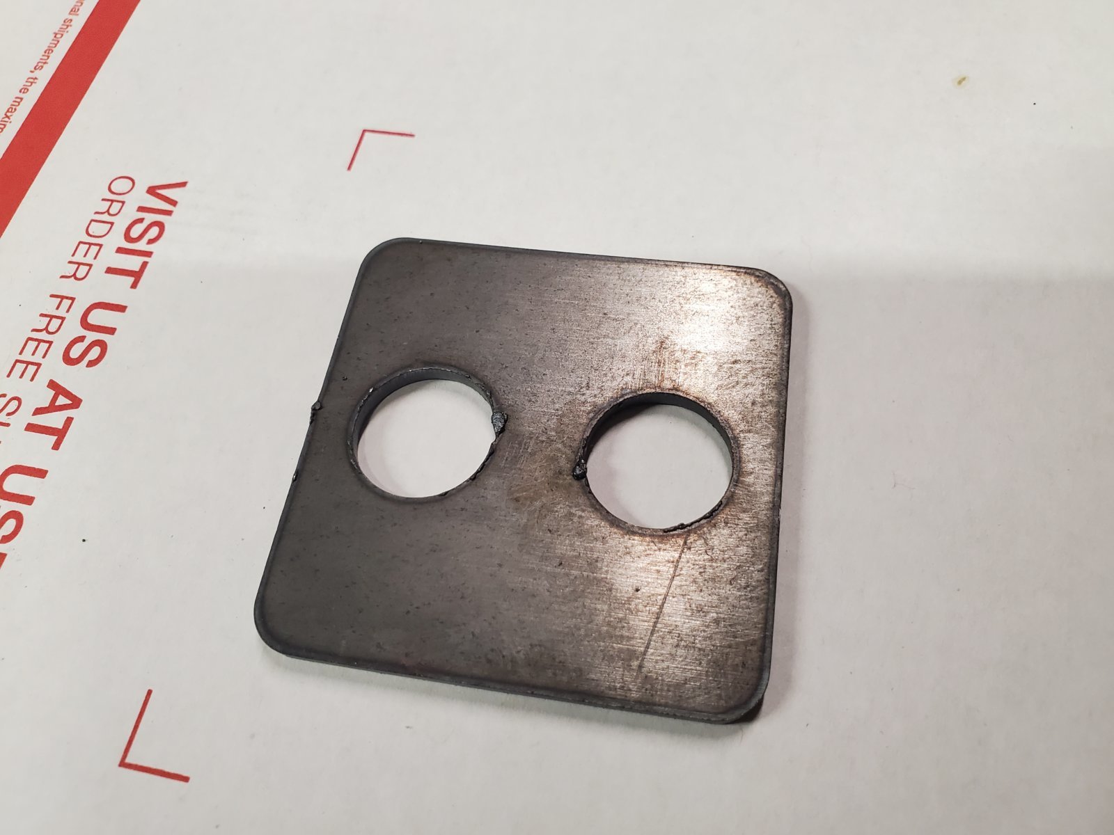

    Little more test cutting today, knocked out 3/16"
    Many of the results were close, like 10 gauge but I found a clear winner here
    Followed by the worst
