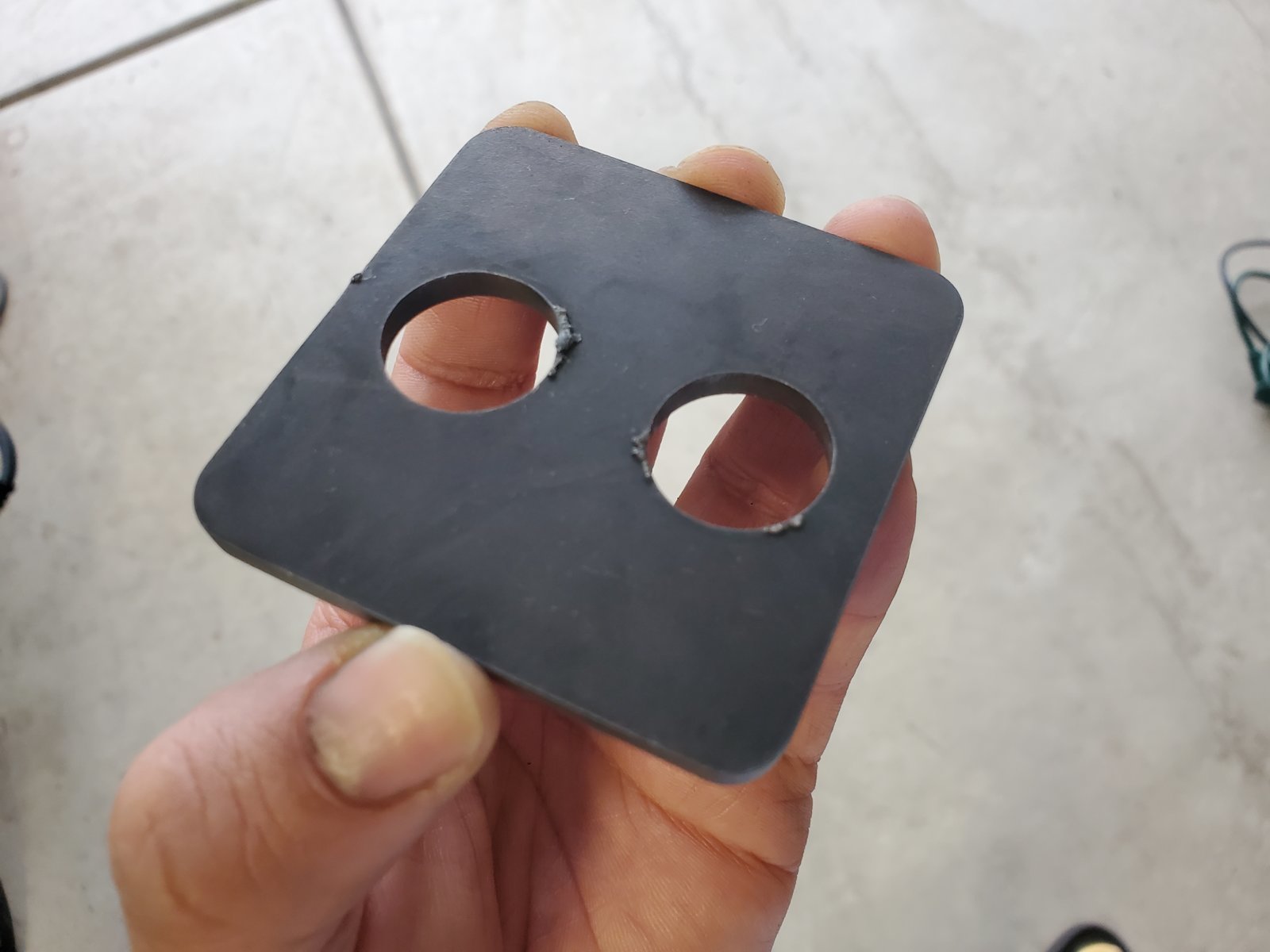

  2. Dec 3, 2023 at 11:55 AM
    Kwikvette
    Feb 27, 2019
    #284735
    81,768
    Fresno County
    4 run, 2 don't
    Ok they both came out good; here's the second one

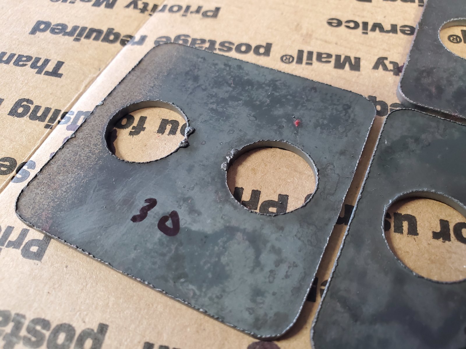

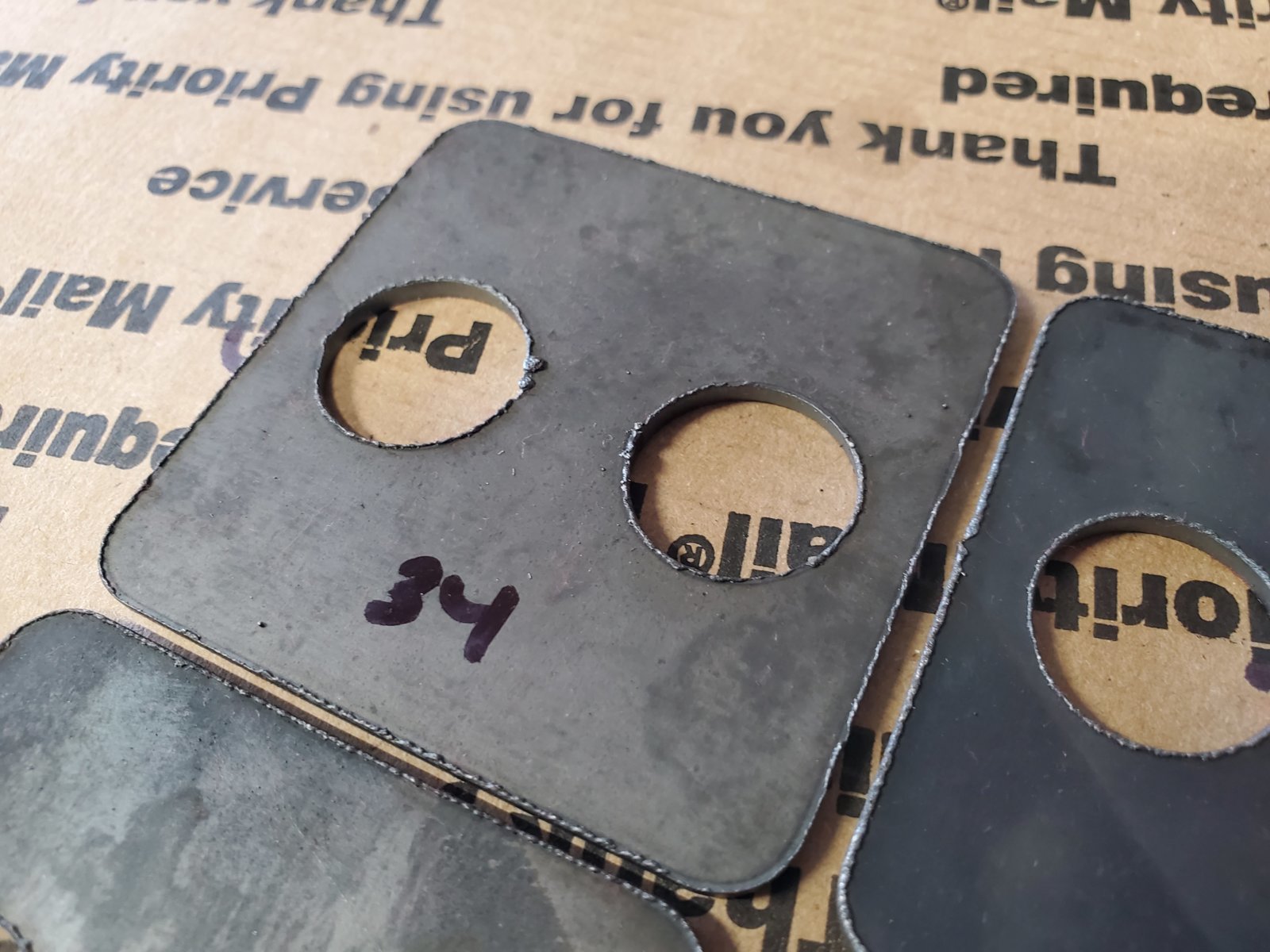

  3. Dec 3, 2023 at 3:52 PM
    Kwikvette
    Feb 27, 2019
    #284735
    81,768
    Fresno County
    4 run, 2 don't

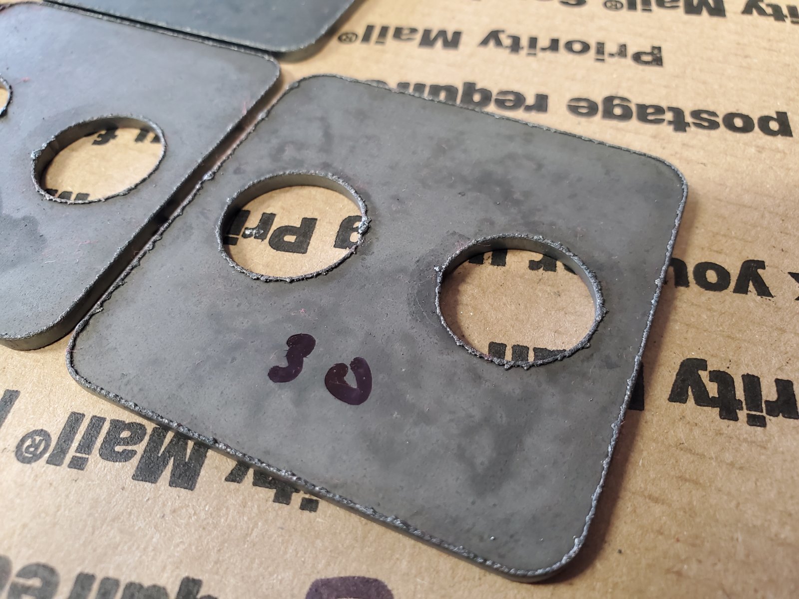

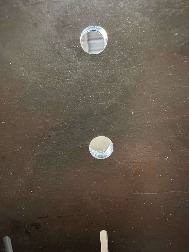

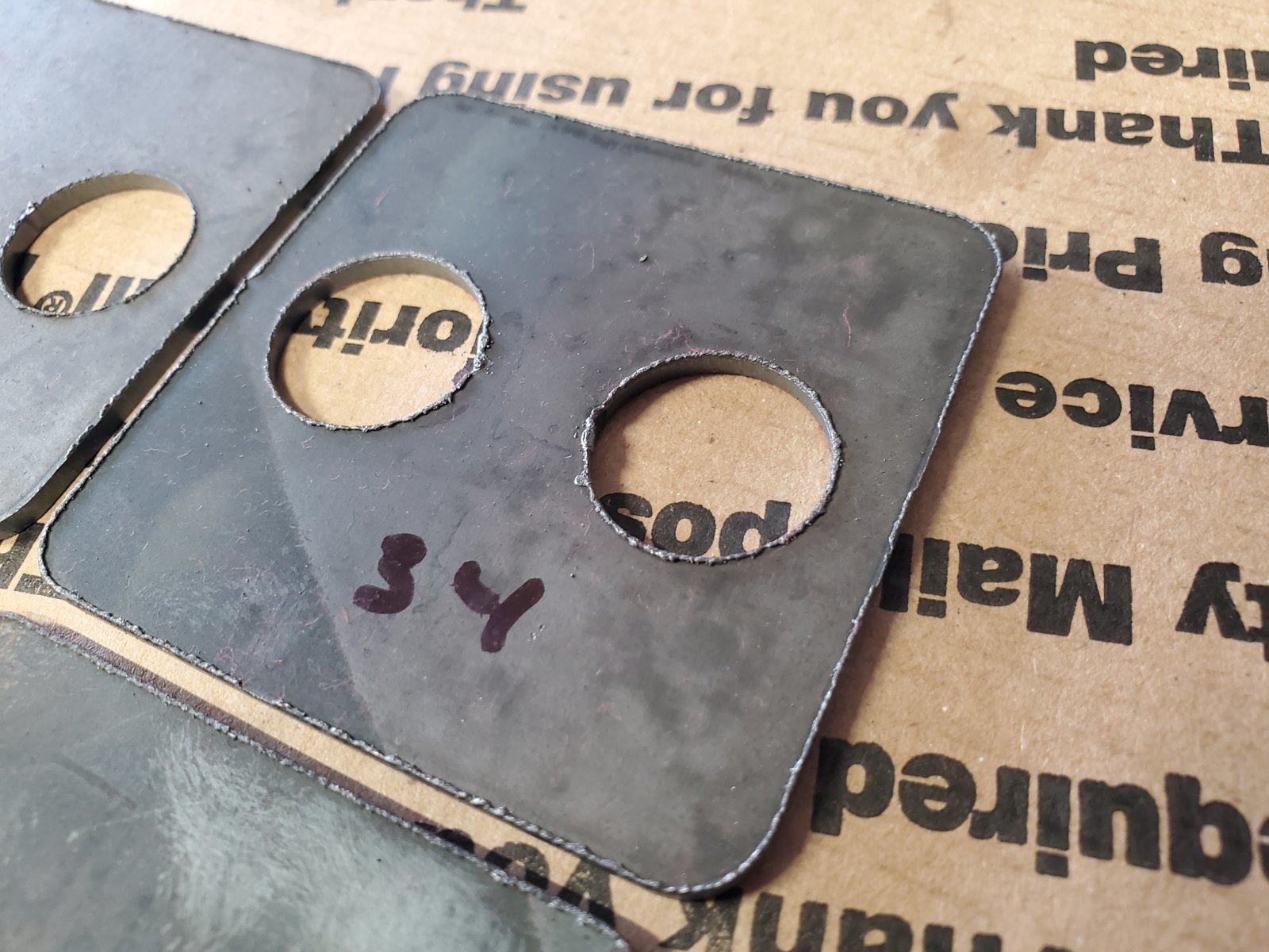

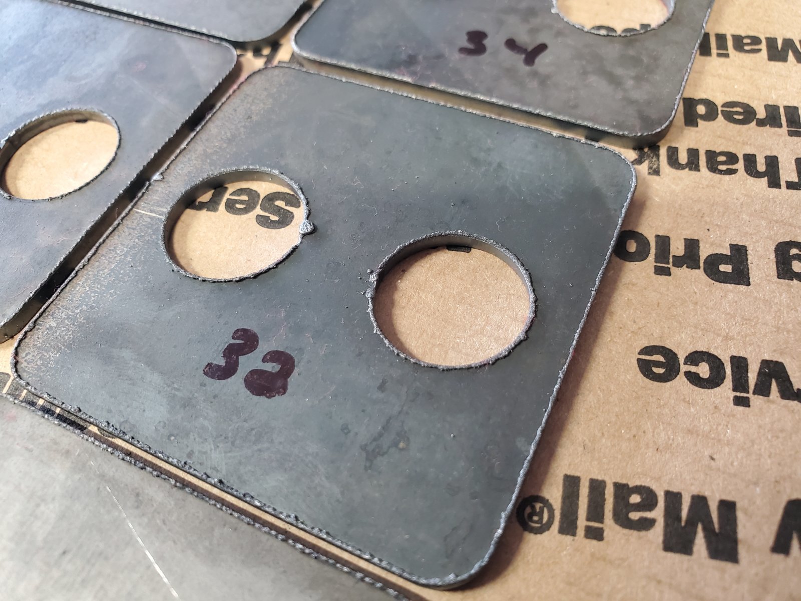

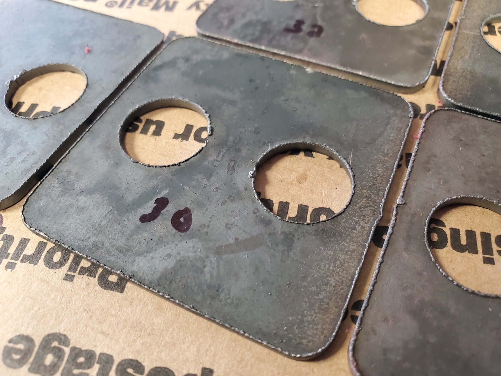

    Man, tests on 12 gauge were rather inconclusive
    I ran tests from 70ipm up to 100ipm at various settings between 30 to 34 amps
    No single piece was "bad" but no single piece was also "dross free"
    Most all of them had the same amount of dross around the outer edge and some less in the center than others
    All off the table with no clean up, all are pics from the underside
    koditten and Drainbung like this.

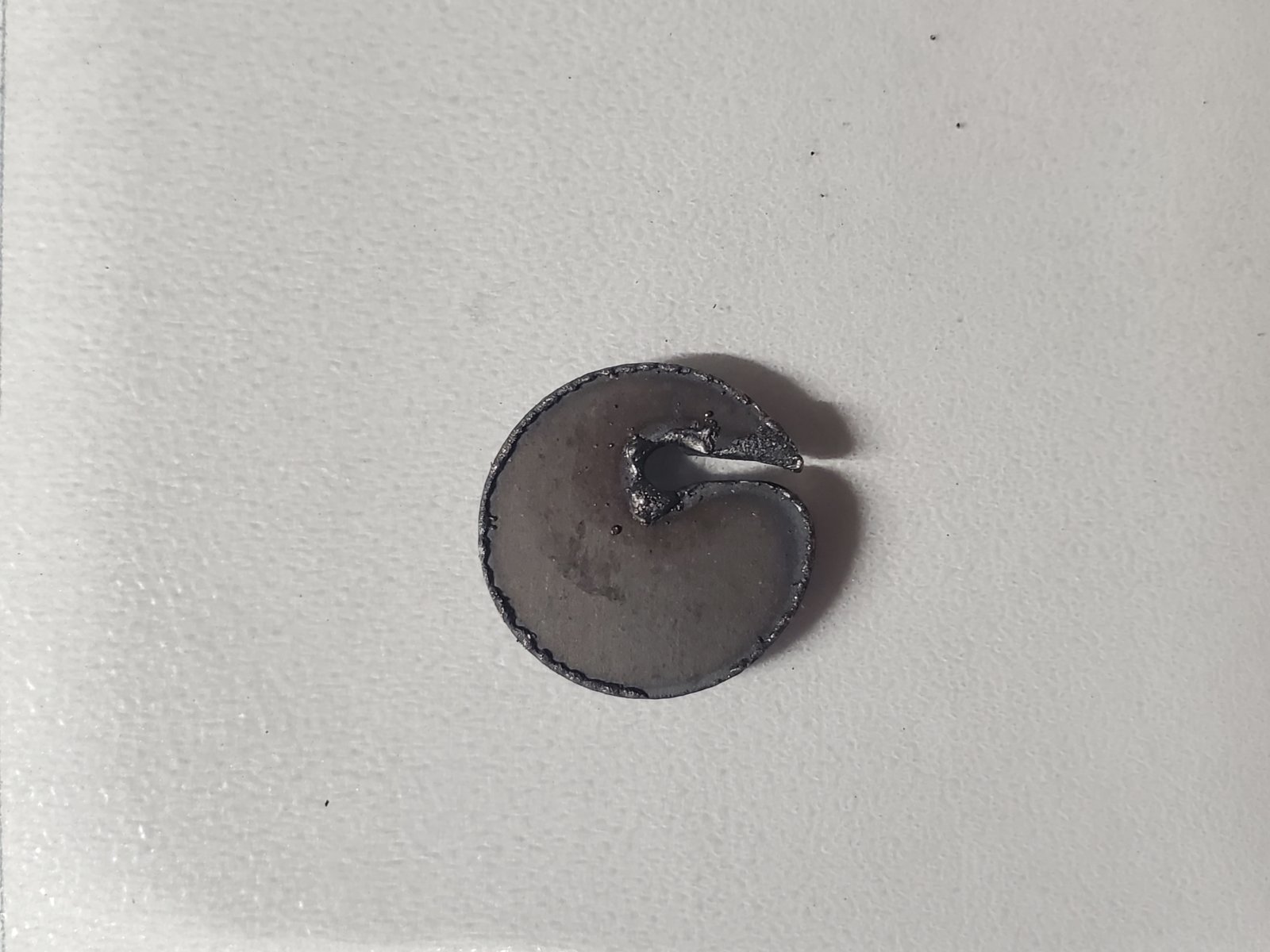

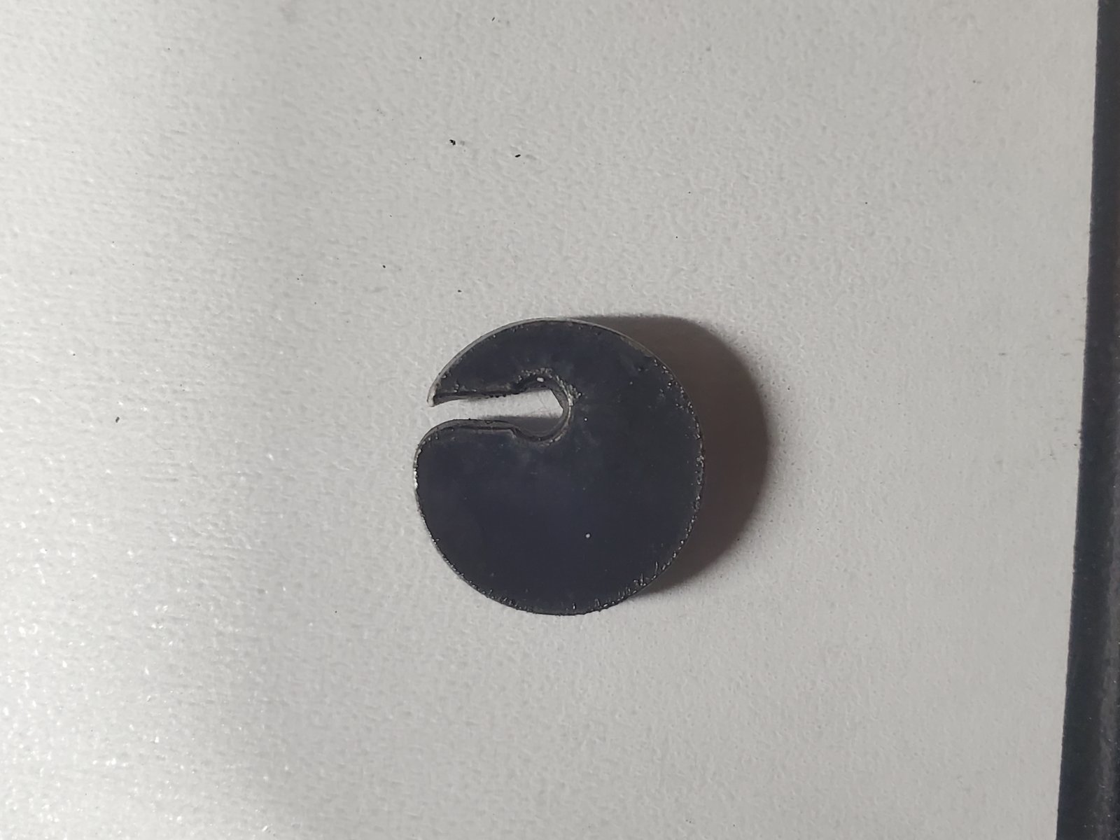

    Any chance you could shows some pics of the drops? I'm curious what the lead in/outs look like.
    I'm not an expert, but I do want to learn .
  5. Dec 3, 2023 at 4:01 PM
    Kwikvette
    Feb 27, 2019
    #284735
    81,768
    Fresno County
    4 run, 2 don't
    The circular cut outs?
    I could try tomorrow :rofl:
    They'll be mixed in with all the same sized cut outs from 10 gauge, 16 gauge, and 3/16".
    As for the lead in, I did a longer than normal one for the outside by accident and just left it alone cause it's scrap.
    I'll grab a pic for ya in just a second.

  6. Dec 3, 2023 at 4:02 PM
    koditten
    koditten Well-Known Member
    Sep 8, 2013
    #112077
    19,794
    Kirk
    Central Michigan
    04 trd x-cab 4 x 4 3.4l
    Reserected from the dead.
    Yep, the cutouts.
  7. Dec 3, 2023 at 4:10 PM
    Kwikvette
    Feb 27, 2019
    #284735
    81,768
    Fresno County
    4 run, 2 don't
    @koditten

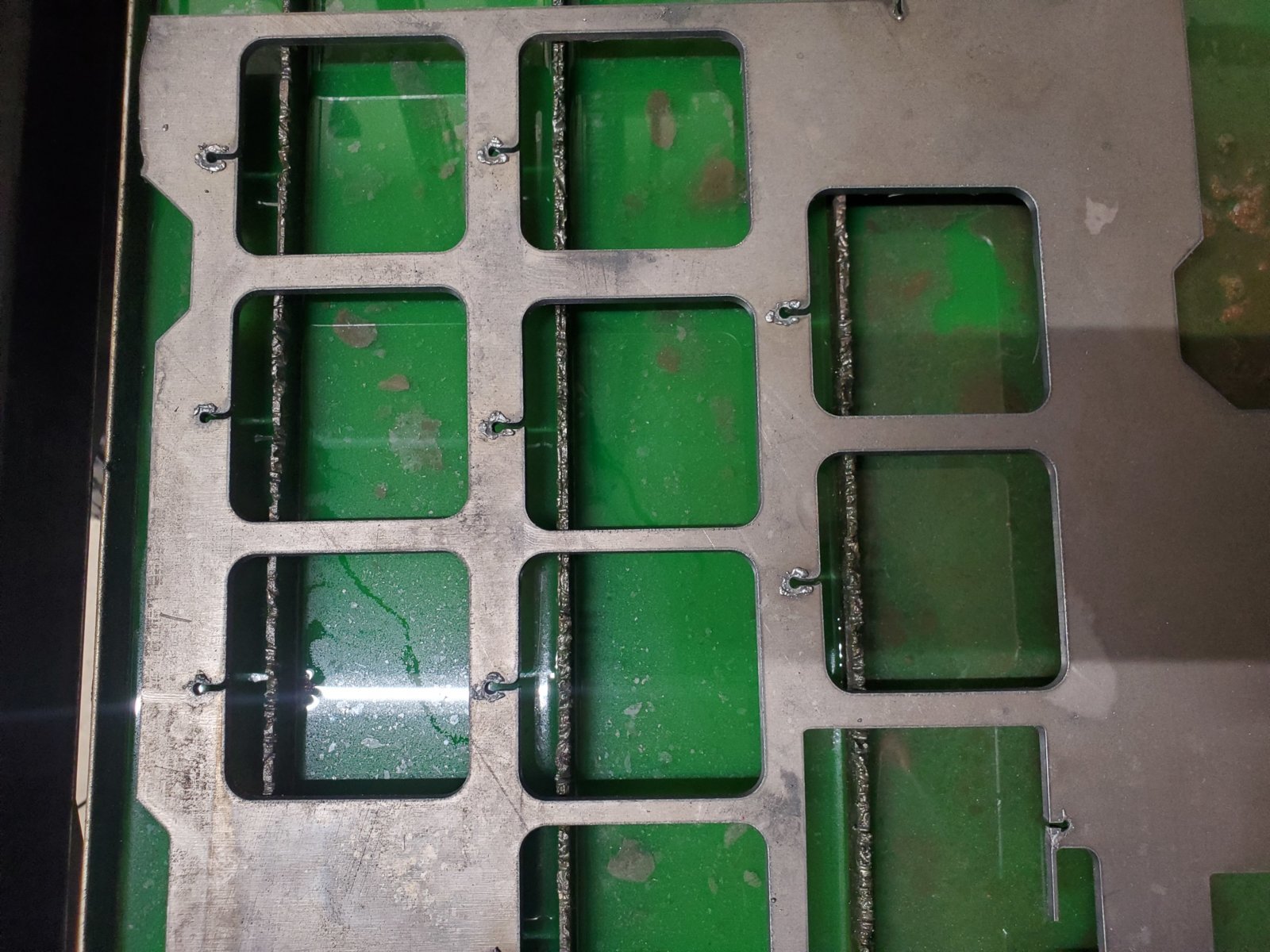

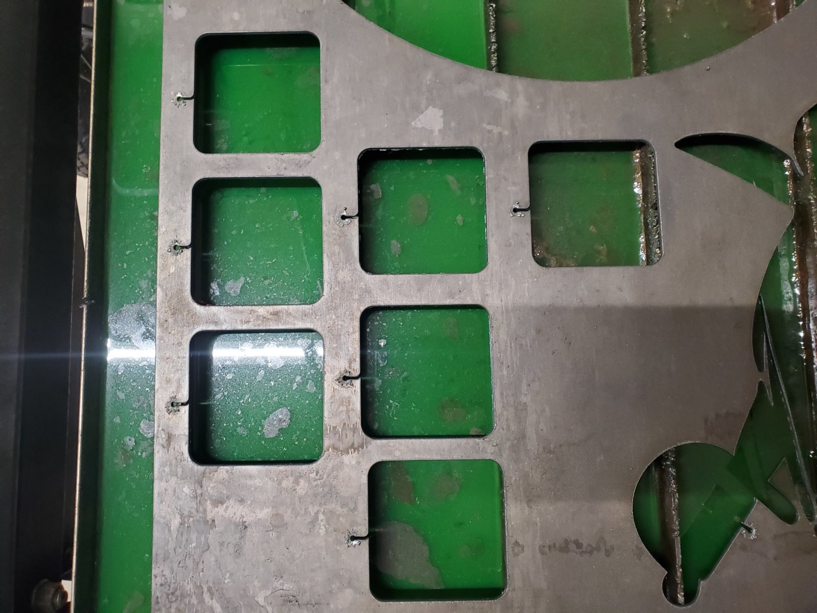

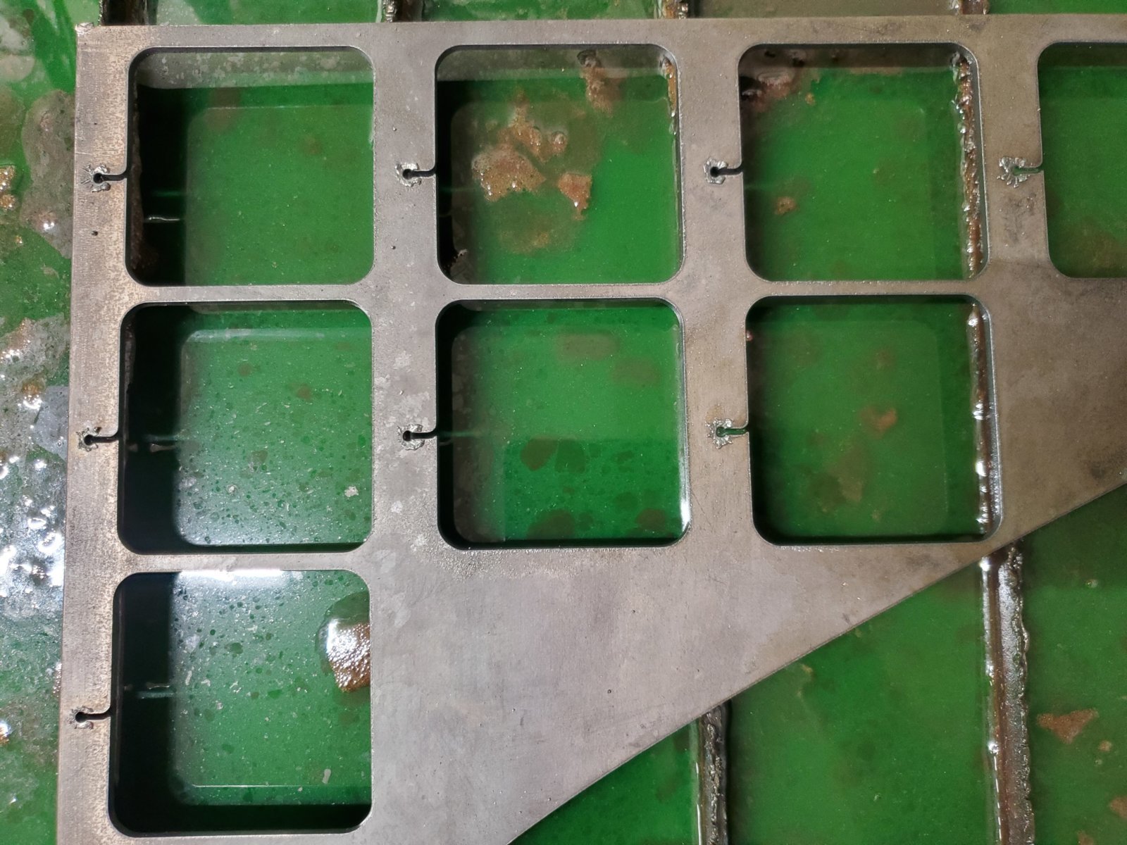

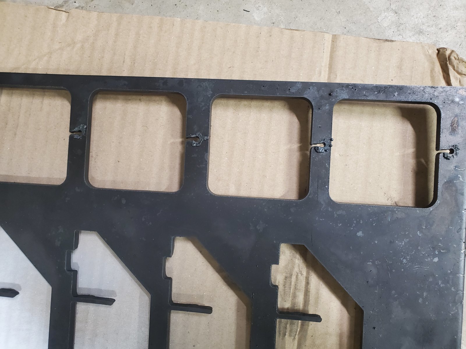

    Here are the plates
    After the first test cut, I left the lead in because it perfectly centered the test pieces between the slats
    Allowing a Y axis cut alongside the slat would've introduced dross that wouldn't normally be present and I didn't want any of my tests skewed by outside factors
    I'll fish out the drops tomorrow with a magnet

  8. Dec 3, 2023 at 5:59 PM
    Kwikvette
    Feb 27, 2019
    #284735
    81,768
    Fresno County
    4 run, 2 don't
    As far as 12 gauge goes, I'm thinking of running 33 amps and 75ipm to see if there's an improvement or not
    Then onto cutting a customer's order on 12 gauge
    Drainbung and koditten like this.

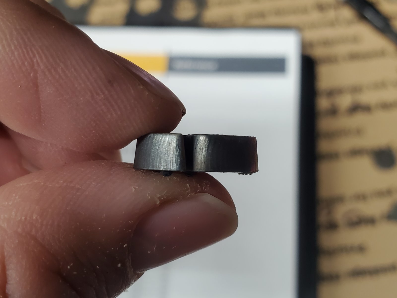

  9. Dec 4, 2023 at 10:47 AM
    Kwikvette
    Feb 27, 2019
    #284735
    81,768
    Fresno County
    4 run, 2 don't

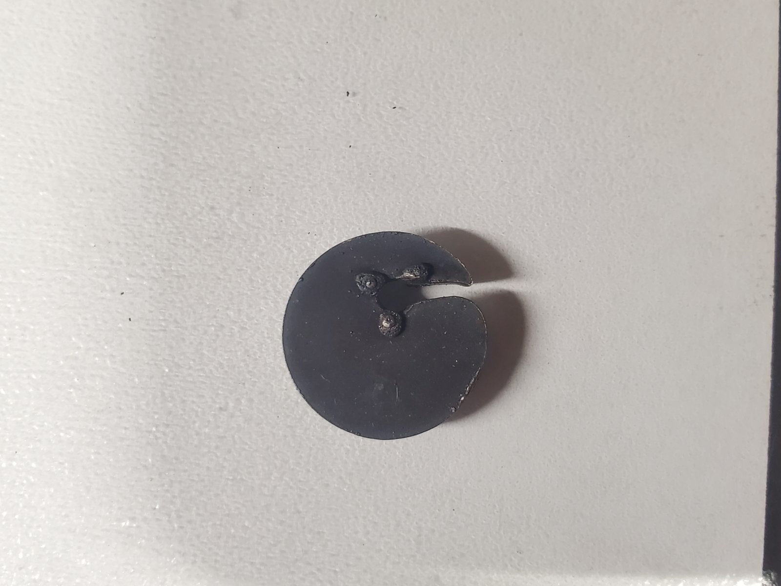

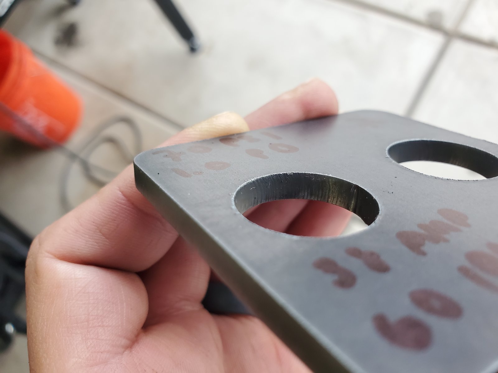

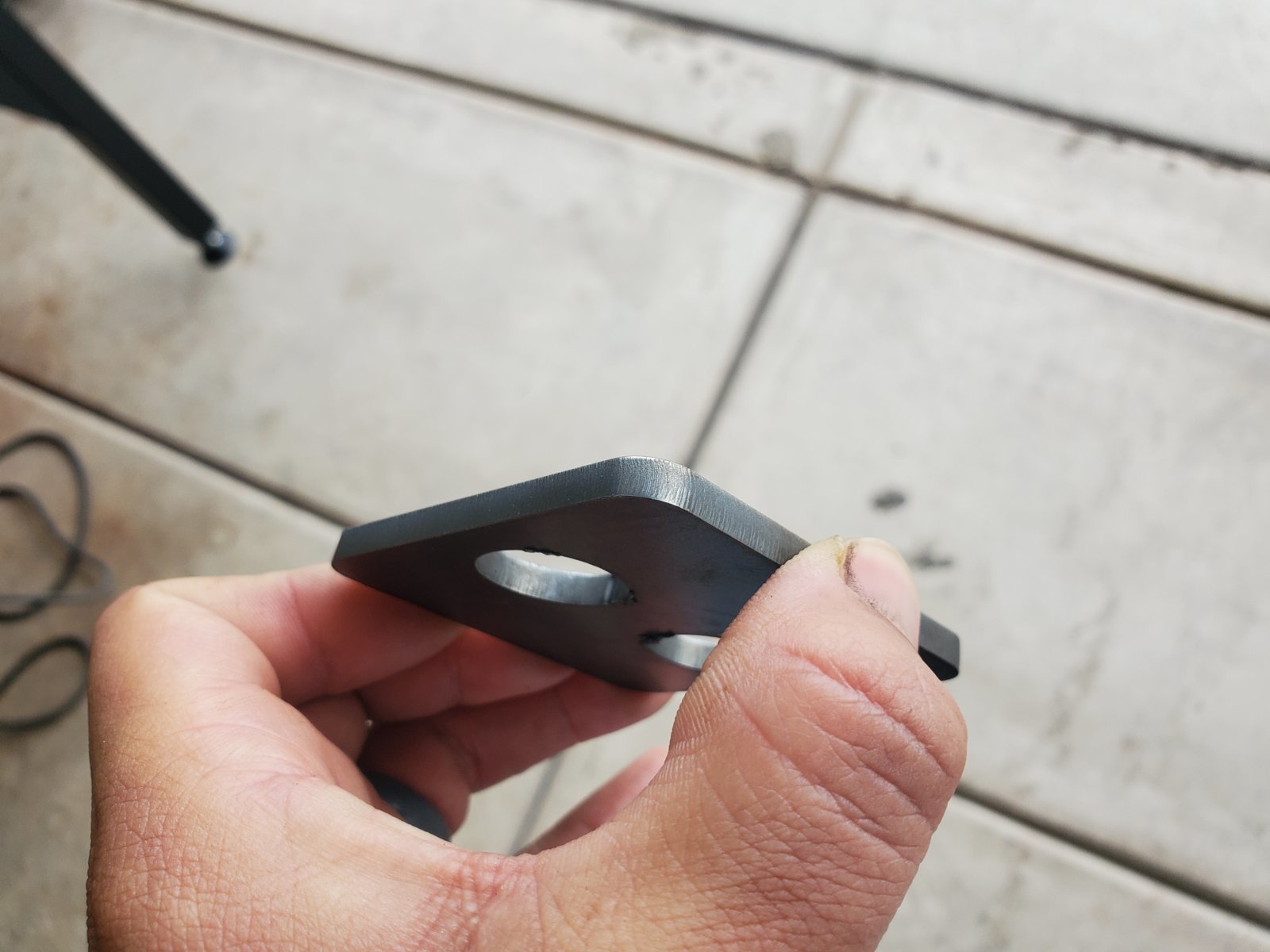

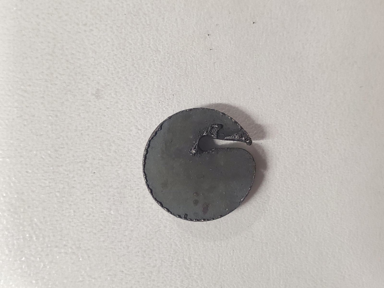

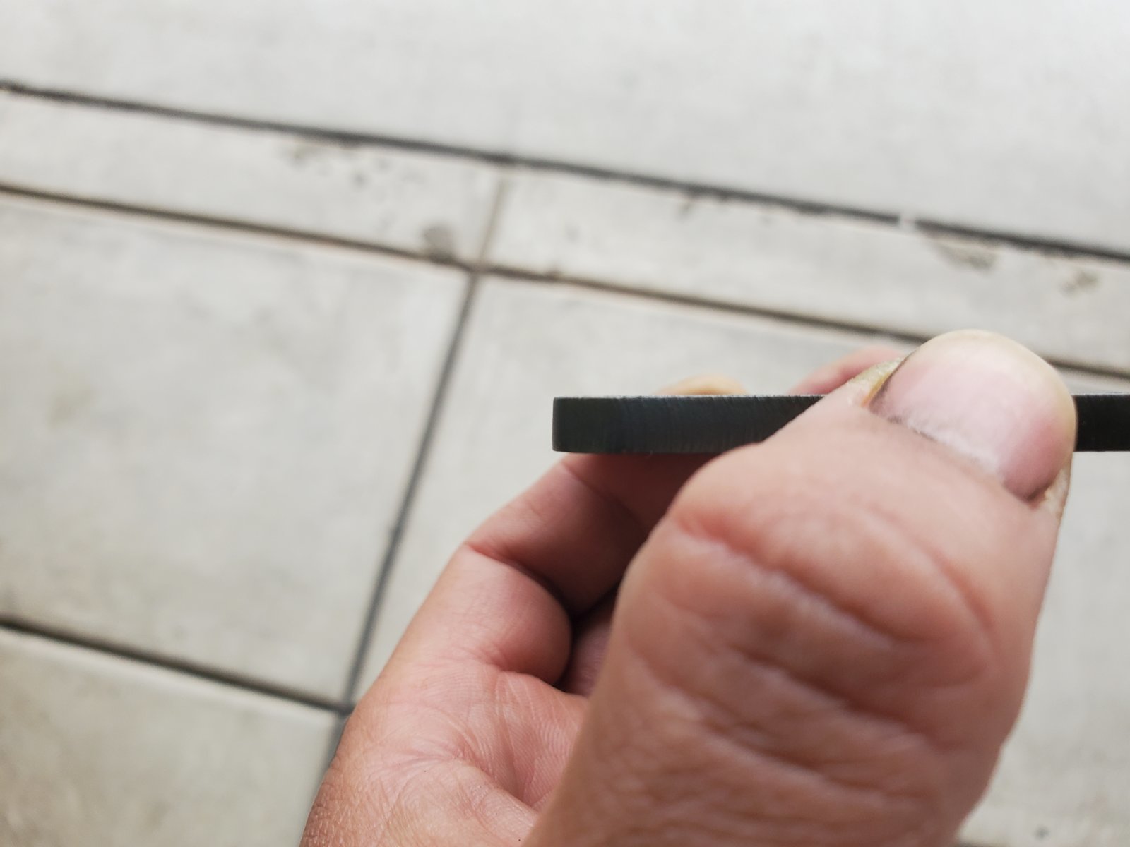

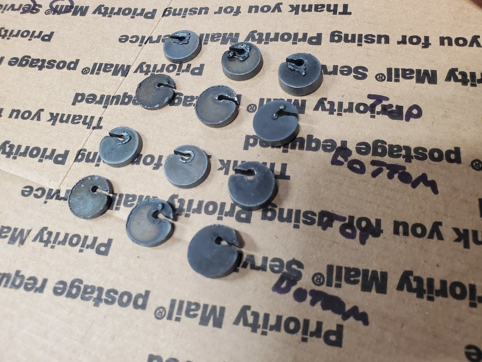

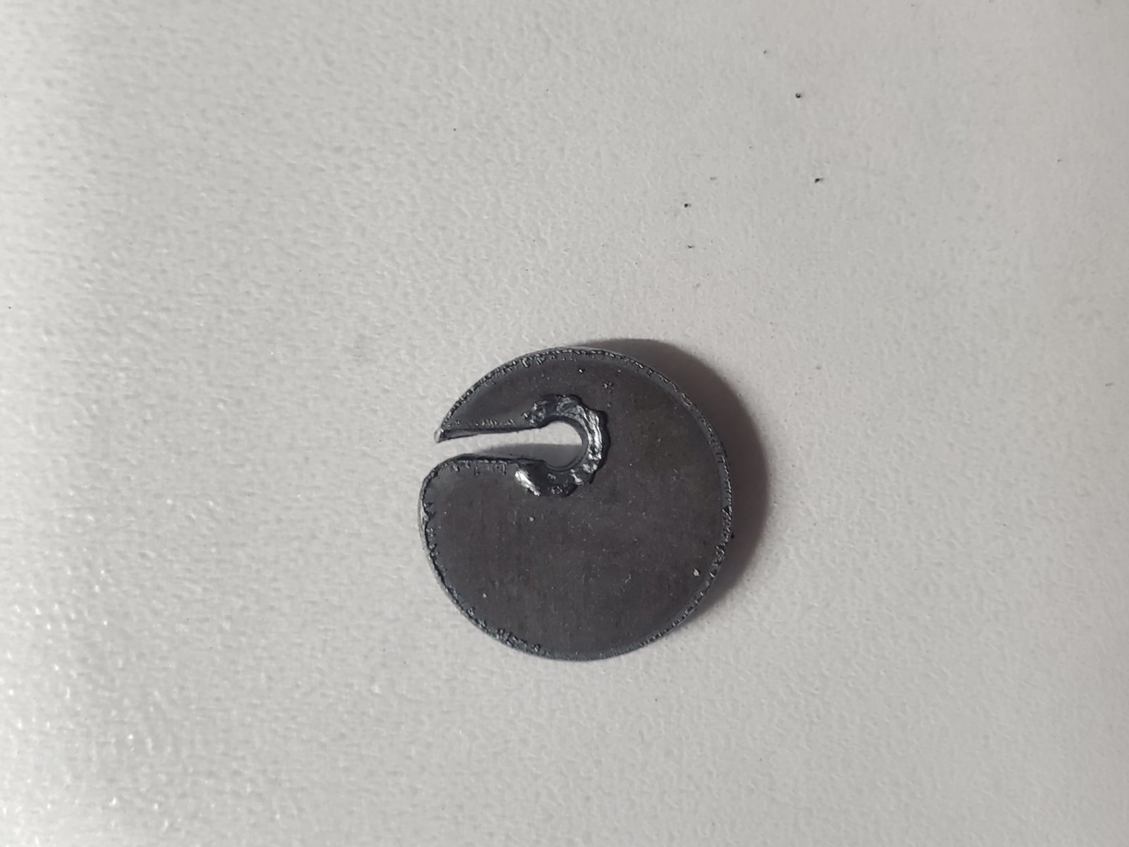

    @koditten
    Got a few 16 gauge, 10 gauge, and 3/16" drops
    12 gauge drops are in there but it's way messy inside the table
    Close-up of 16 gauge, top then bottom
    10 gauge
    And 3/16"
    The thicker the metal the more trouble people seem to have when it comes to holes, at least what I see in the group and forum
    The holes all measure for 0.375" and the only difference I add is a .125" lead-in radius; comes out perfect in my parts
    Even though the drops have a tiny bit of bevel, the holes and parts themselves are square; this is where that important factor of cutting counter clockwise on inside cuts and clockwise on outside cuts is important
    I'm no expert, and really I expect everyone here to already know what I mentioned but hope the pictures help!

    Looks like mine. I don't see how you can do any better.
    The only other options is laser and water jets= big$

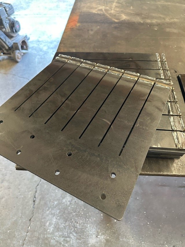

    Somebody said laser :D
    Just picked these up from another shop who laser cut them for us. I’m welding beads on the tips. They are fingers for a robot. 5/16” AR400 plate.

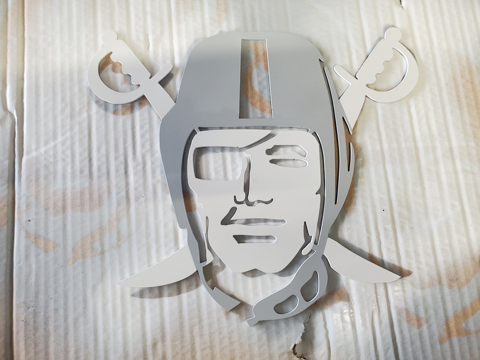

    Started on this last night
    Feel like I'm a good ways there and almost done
    Buddy was hoping I could pull this off after I told him that one of Biscuit was a first-and-last ever attempt; I'm good at making shit but not anything art-related
    Pooch passed away in 2019 and his wife has been hurt from it since
