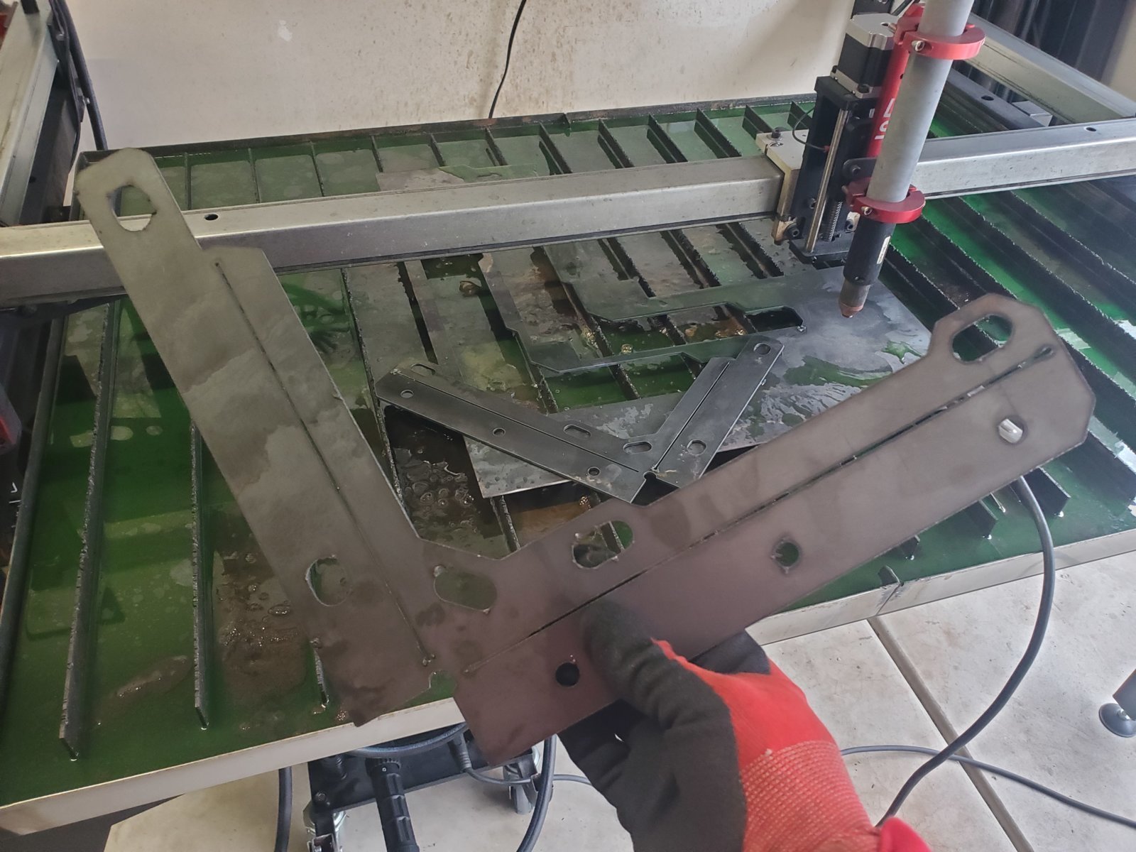

    a new idea for you. a guy at work had these custom made for his jeep many years ago. i like the idea, i'd like to do 3-4 baja designs s2 lights on each side in that location, without the light bar spanning across the top. problem is, i want to come up with a way that mounting it uses factory bolt locations, with no modification to the a-pillar structure (though not opposed to tying it into a prinsu rack above the windshield).

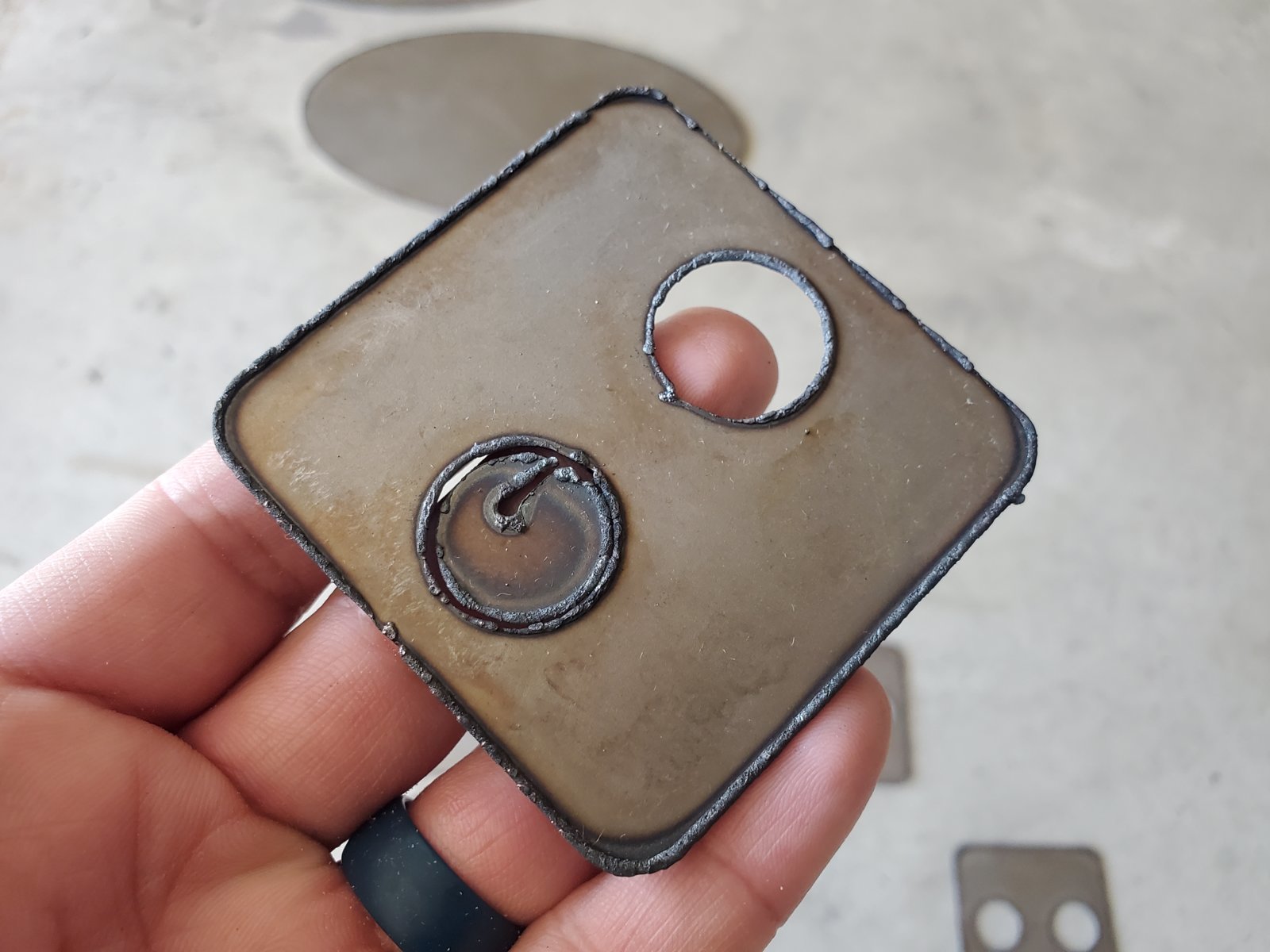

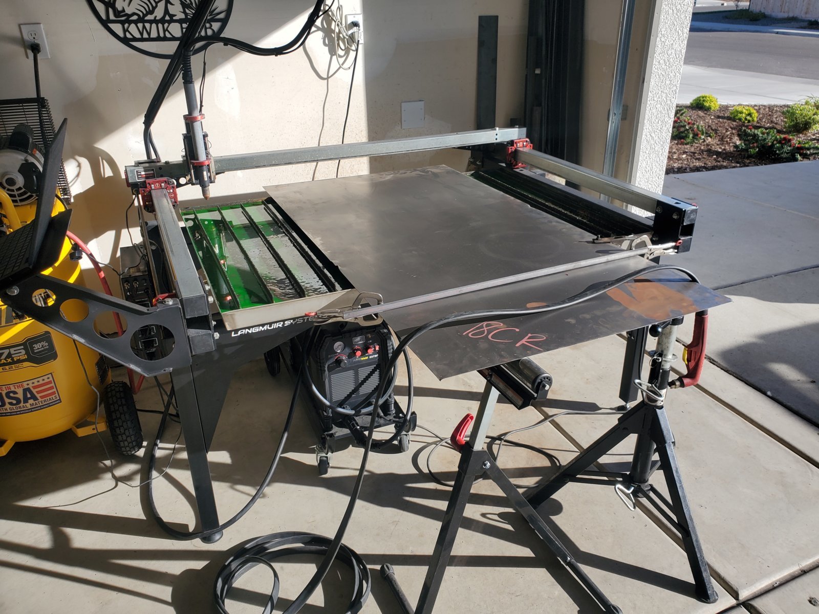

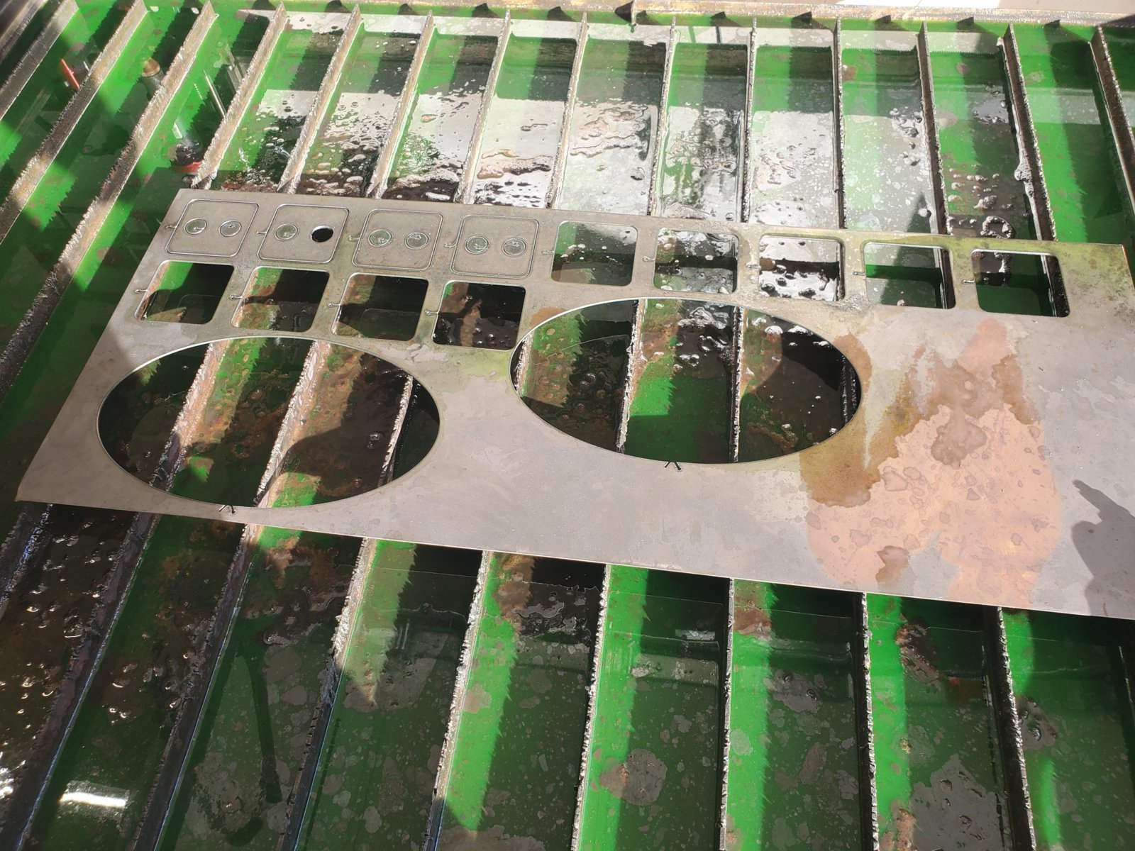

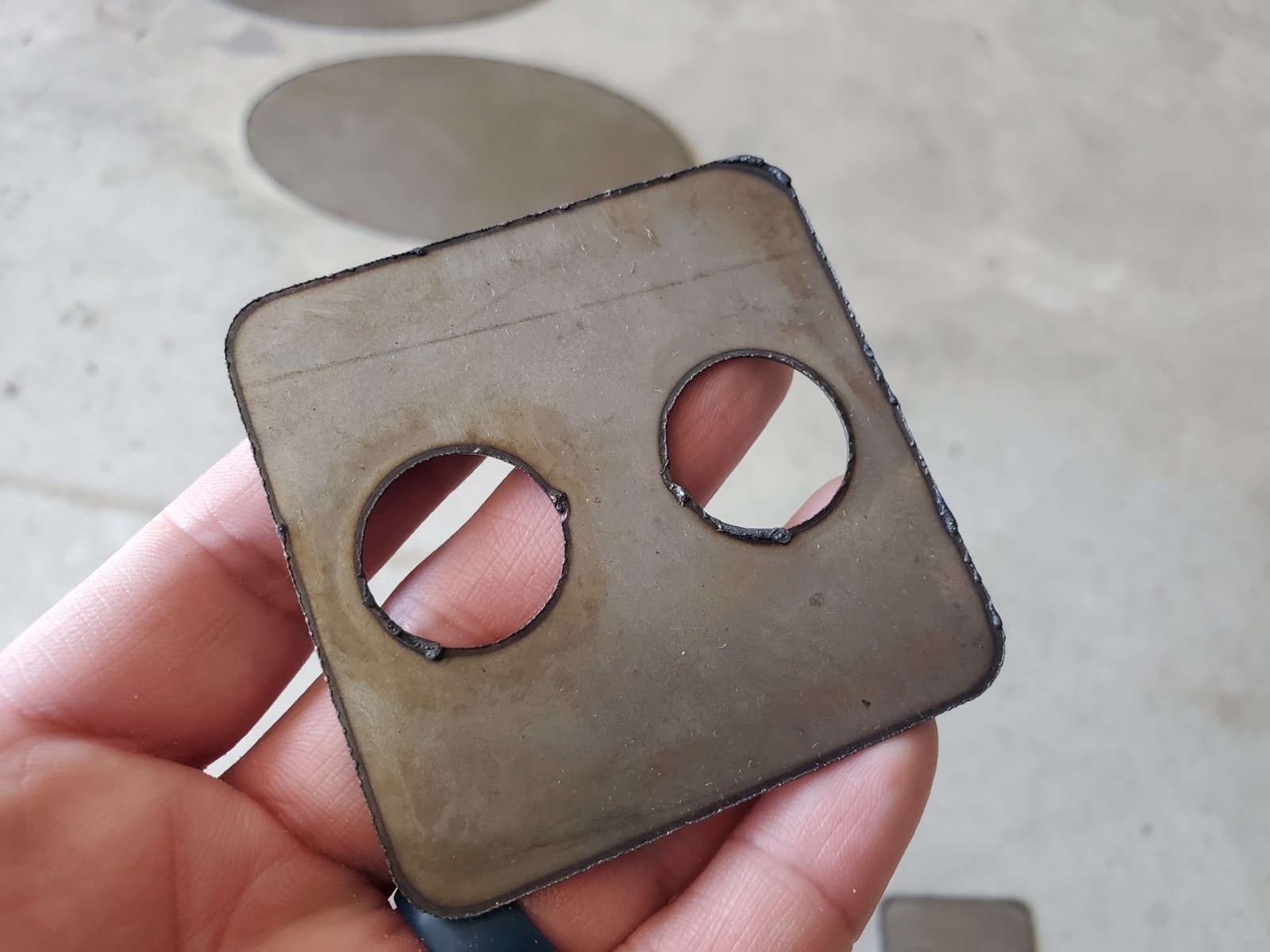

    Picked up some steel today, 16 gauge and 18 gauge
    Only when I got home did I realize these were 5' long sheets :rofl:
    Measured at 63" x 33"
    Perfect, cause I've never cut 18 gauge on my table before; 15" x 33" scrap I can use to dial in on
    Normally I'm pretty good at guessing what my settings will be but not this time
    24 and 26 amps at 160 wouldn't cut all the way, and it wasn't until I was dialing in between 110 to 140 that pieces were dropping
    Not perfect but so far it's the best of the bunch at 110 and 30 amps
    With the worst being at 140 and 26 amps (that piece did fall out on its own after a bit)
    Small part of me says 29 amps and between 105 to 115 could be the ticket; I'll test it when I've got time

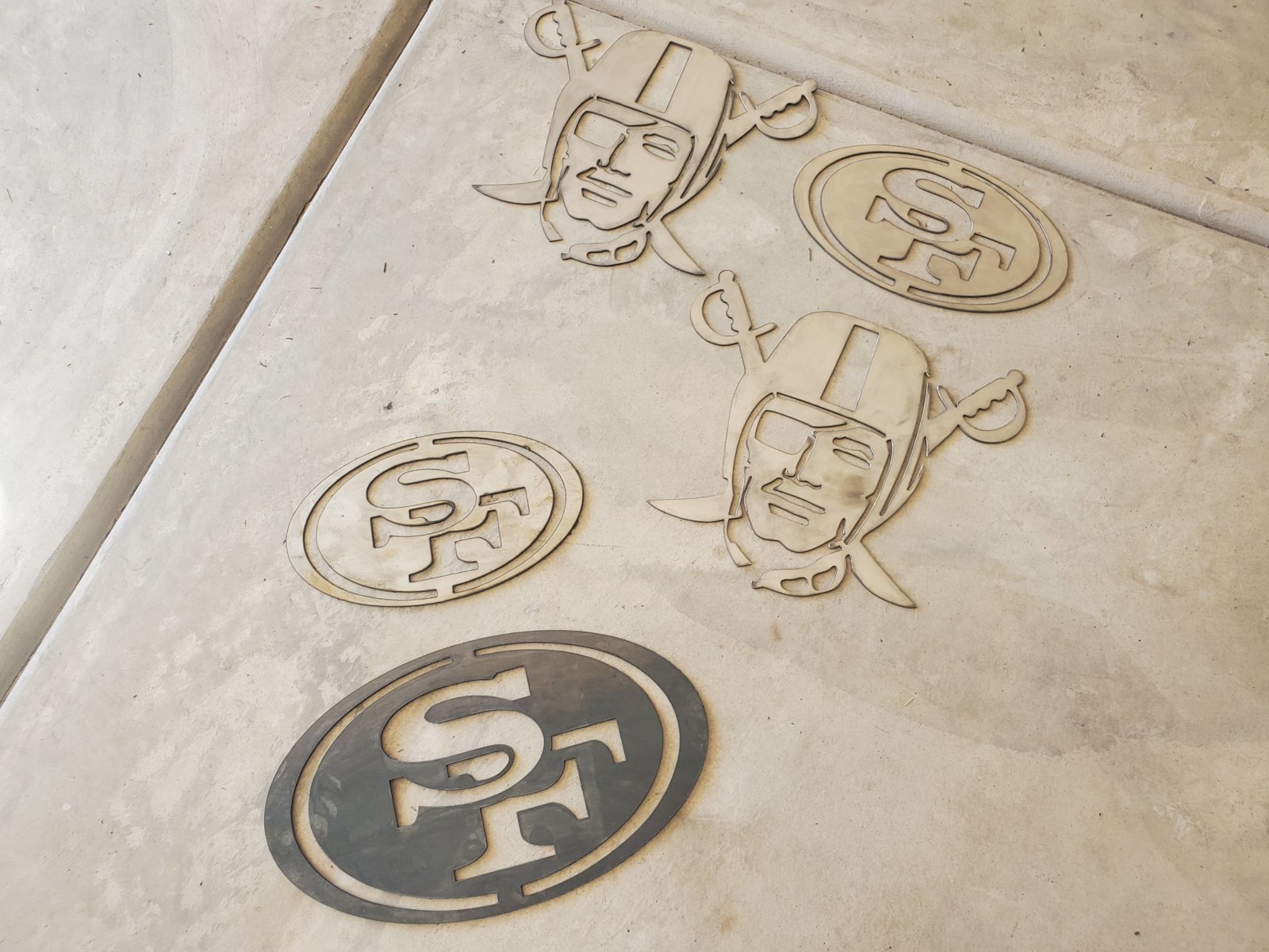

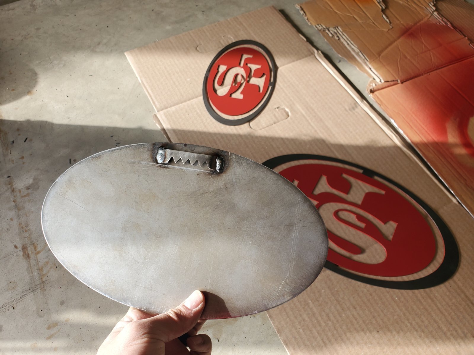

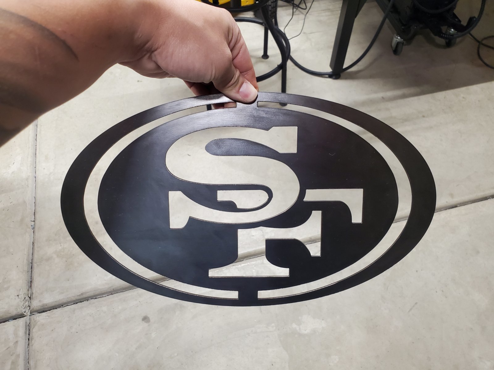

    Those two oval cut-outs? Making those 49ers signs from yesterday layered

    lol. he said he had those brackets custom cut by a fellow jeep forum member. for $400!

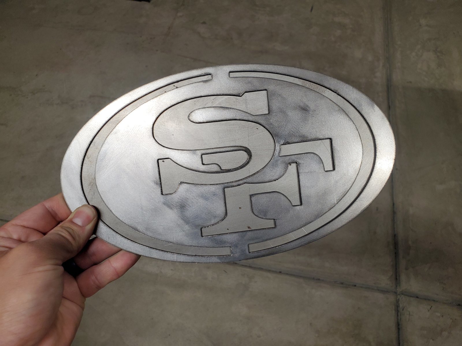

    Last night I got an emergency order for a set of stiffies so I got those knocked out today
    Also cut some saw blade style hangers
    And got one of these done up
    I'm a horrible painter and horrible at layering so as long as people order parts raw, I'll stay in business :rofl:
    That 49ers sign is for my mom since she's coming by to visit tomorrow; haven't seen her in months

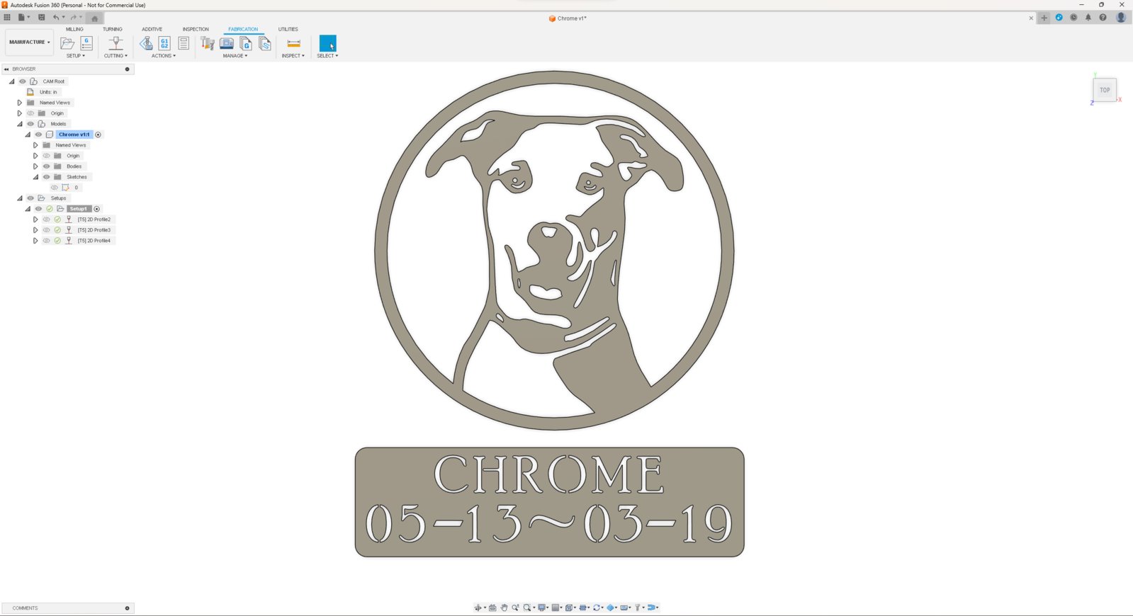

    I should add, I'm hoping to knock this out tomorrow (if time permits)

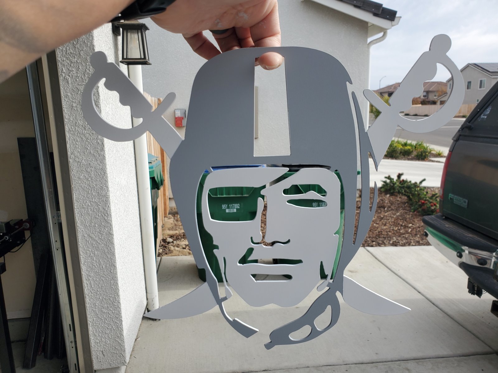

    Where did you get this file at? I’ve got a good friend at work who is getting ready to retire and I’d like to make him a layered one.

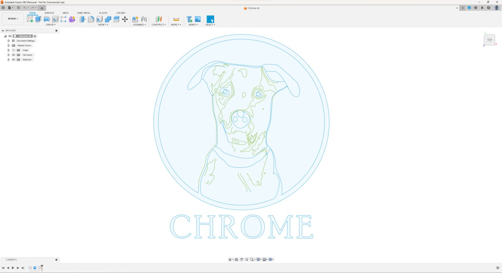

    I drew it, tracing an image file as a canvas
  15. Dec 9, 2023 at 1:46 PM
    Kwikvette
    Feb 27, 2019
    #284735
    81,552
    Fresno County
    4 run, 2 don't
    Although truth be told, I'm still learning how to draw
    If you want, I can send you the dxf file later just PM me your email

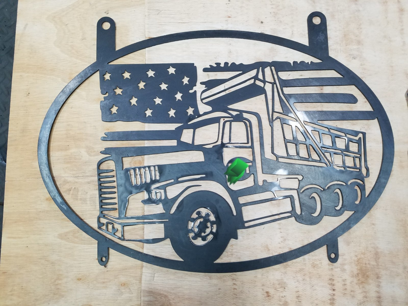

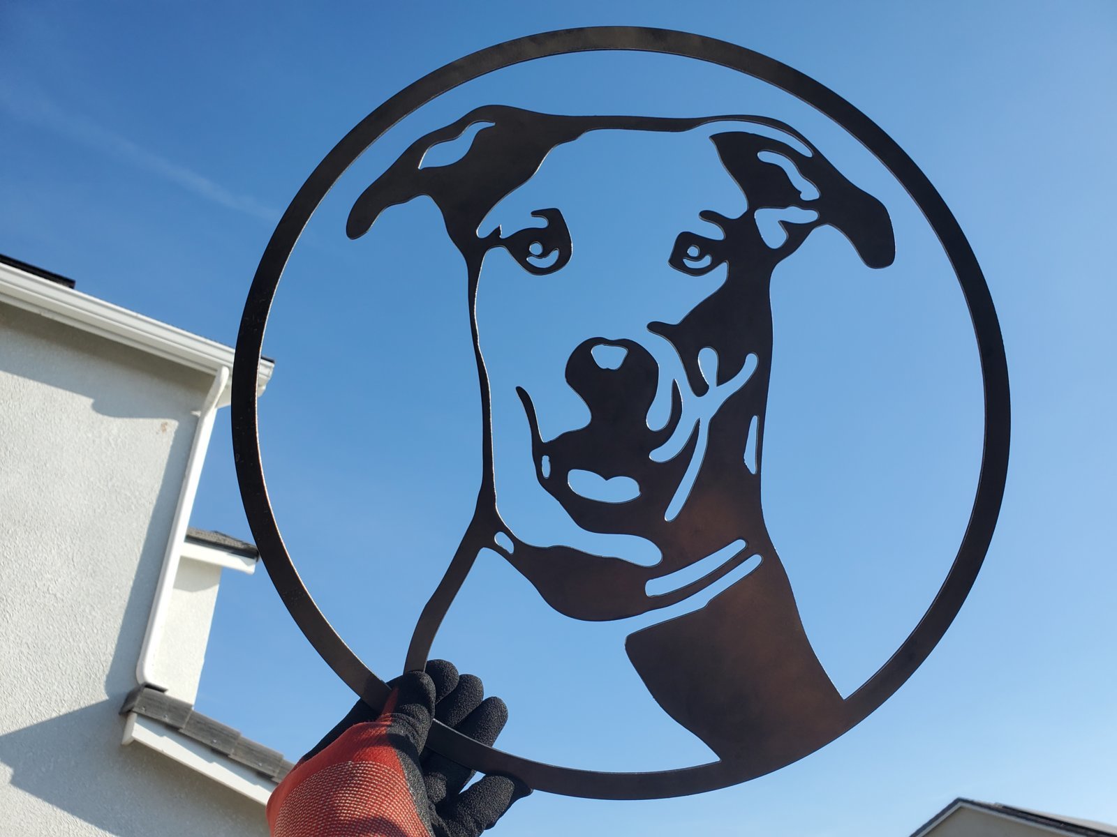

    Worked on my Christmas gifts this afternoon. These things are really popular. I think makes 7 I've made and still don't have one for myself.
    This one I finally got a good cut on. I tried last Winter and had two failed attempts. Gradually, I've redrawn the entire sketch and finally got it right. I have a hanging sign with company name cut for underneath, but I don't want to post as this is a gift and you never know who might see it and spill the beans.
    This is one a friend asked for after his wife say it on Amazon. Laser cut, they were asking $28. I traded it Wednesday for a case of cheap beer!
