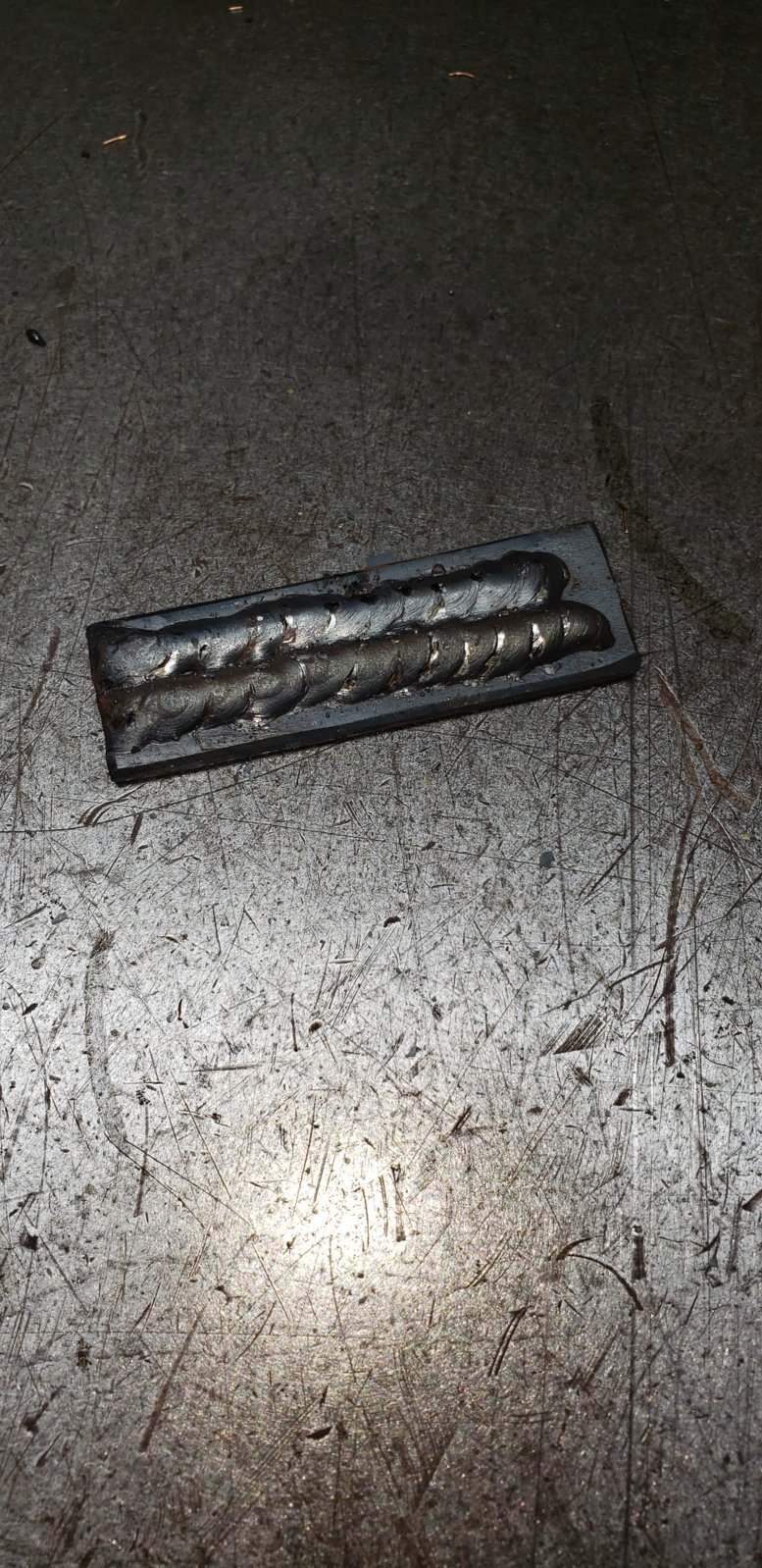

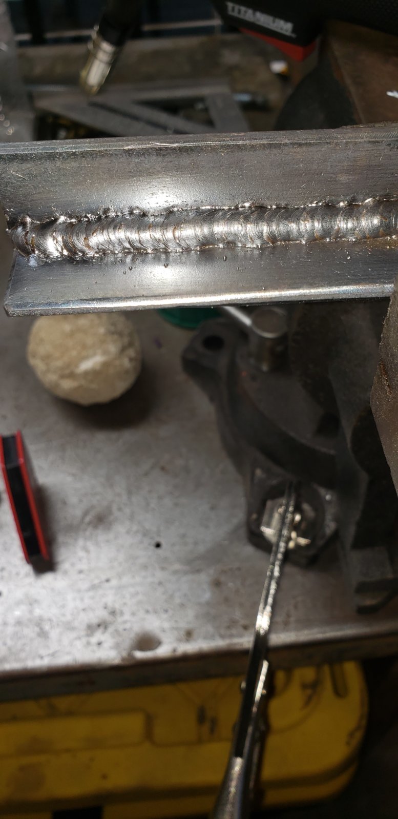

    Allright everybody, I've recently bought myself my first welding machine, a Titanium HD170 currently set to 120v using .030 with Lincoln Wire and 75/25 Gas. Been watching YouTube to learn how to weld.. sort-of.
    This is where I'm at so far using 1/8", which is probably the max for this machine. I know I can do better, opinions and suggestions please!!

    So, the reason why you can tell your travel speed is too slow is -
    1. You have undercut paired with
    2. You have fat caterpillar beads
    The one suggestion I make to every new welder is take flat stock, regardless of how wide it is, and run beads on it.
    With a silver sharpie, or metal marking pen or pencil, scribe straight lines spaced about an inch apart the whole length of the steel. Don't make the steel any longer than 6-8" or you'll tire yourself out easily.
    Doing this you will familiarize yourself with two things -
    1. Welding paired with learning travel speed
    2. Learning how changes on the machine affect your bead profile
    Run your bead the length of that piece, while practicing staying between the lines. Run another bead alongside it at a different travel speed. Run another by changing a setting.
    You'll soon find that you're learning to control travel speed, not to mention gaining muscle memory to stay in between the lines. You'll also learn how to watch your puddle as you're welding and adjust as you go.

    I think you got your wire speed too fast and your heat a little low.
    You are in the ballpark, just not in the infield.

    what settings are you using? also, the connection at the bottom, are you on positive or negative?
    i had to look up what the far right 'inductance knob' does, as i'm not familiar with that function.
    https://unimig.com.au/what-does-the-inductance-setting-on-a-welding-machine-do/
    and most importantly, what are you planning on using the welder for? it makes little sense to dial yourself in on 1/8" plate if you end up using it all the time on 1/16" plate.
    on page 24 of your user manual is a 'troubleshooting guide' to welding bead appearance-- keep that page handy(they also include it in the quick start guide) and reference it for every weld bead made until you get a better feel for the technique and settings needed. generally, i've always found that it's 10% settings, and 90% user input that makes for a good/bad weld.
    definitely too slow, and i suspect the voltage is too low with too high a wire speed, it doesn't look like it penetrated great. i would suggest experimenting with flipping the jumper between positive and negative-- it will alter if you're 'pushing' or 'pulling' the arc into the material, which changes how the pool reacts.
    i can't tell if that welder gives a wire feet/min readout or a voltage readout. for 1/8", with the welder tip facing down, the lincolns at work, or my eastwood at home, for 1/16-1/8", i'd start with the wire feed at 320-350 depending on my mood, and 21.0v-22.0v. ultra-safe generic settings, i like starting with 220 wire feed, at 20.0v. generally, welding vertically, bump wire speed +50, and upside down is around +100. on your helmet, if it's auto-darkening, i'm normally around a shade 9-10, no darker than 11 to properly see the puddle.
    you can also play with your tank pressures-- i'm normally around 30-40psi most times. depending on how much air movement there is around the workpiece.
    in a corner bead like your first pic, focus on keeping the welder tip the same distance(ideally about 1/4-1/2" above), and only wiggle the tip enough to move the puddle from material to material to effectively cut into them--normally, that's only about a 1/4" side to side movement. don't worry about the final actual puddle width, it's more important to get good penetration between the surfaces at the center point, the puddle will work itself out as it cools. a good corner bead is going to be slightly curved inwards, yours bowing out indicates too slow of a speed, and possibly too wide of a sway side to side.
