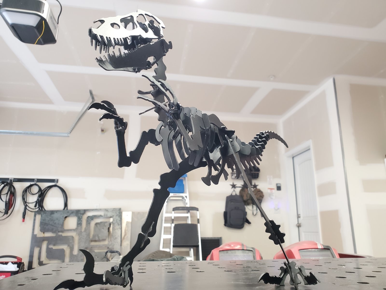

    I was at home, chilling, baby napping, and I suddenly got the urge to change, grab my gloves and....
    Taking home a 3' x 3' sheet of 10 gauge so I can cut out a 3' version of that raptor :anonymous:

    The way this works is, it's meant for laser cutting so having cut it out on plasma the slots for everything are larger than called for.
    This means all the parts wobble when slotted.
    I knew this going in, hence I tack welded it.
    It's not difficult at all but 16 gauge, and slots as small as 1/4" or smaller, burn off easily when welded.
    That and you literally have to hold pieces in place as you weld them to ensure they're true and straight.
    Lastly, little things like the teeth and front claws are super delicate when first cut out.
    If none of this scares ya and you're ok with all of that, I can cut one out after I knock some signs out and other misc. items. Just gotta buy some more 16 gauge.

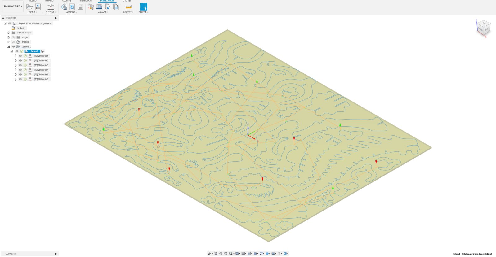

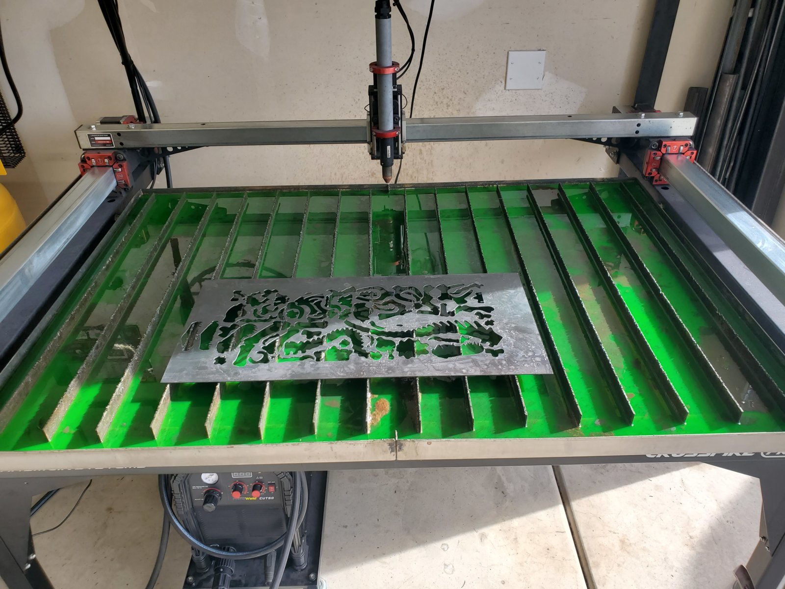

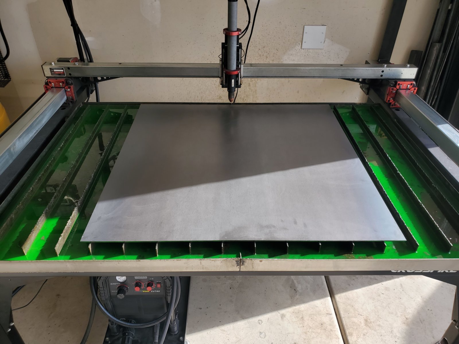

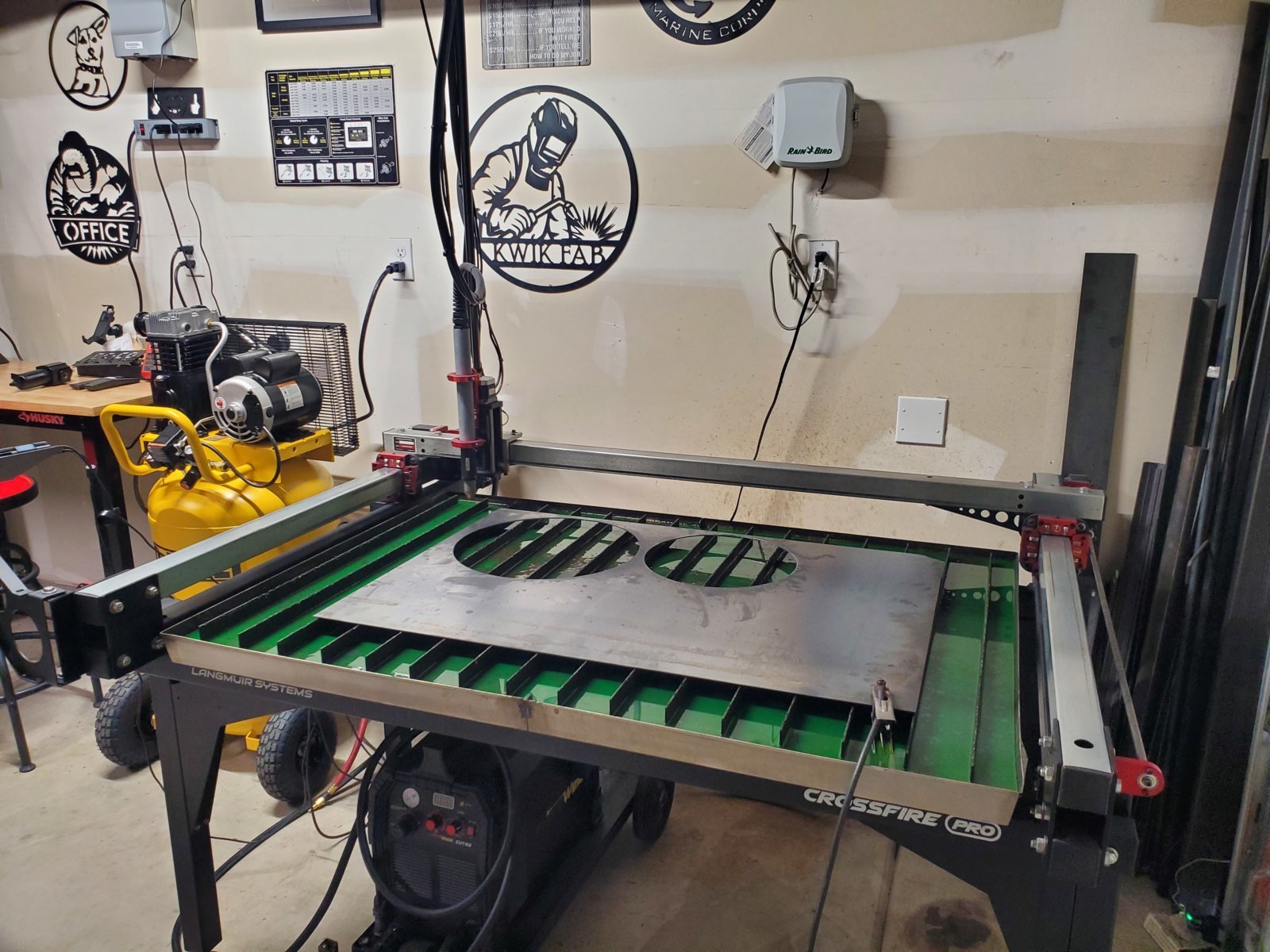

    It's a 4' x 3' (more like 33") and the big one nested fits onto the 32" x 32" scrap piece I've got
    I'd be able to make the 8' version as well seeing as how the longest piece spans under 4' across
    Speaking of, just got done creating my profile

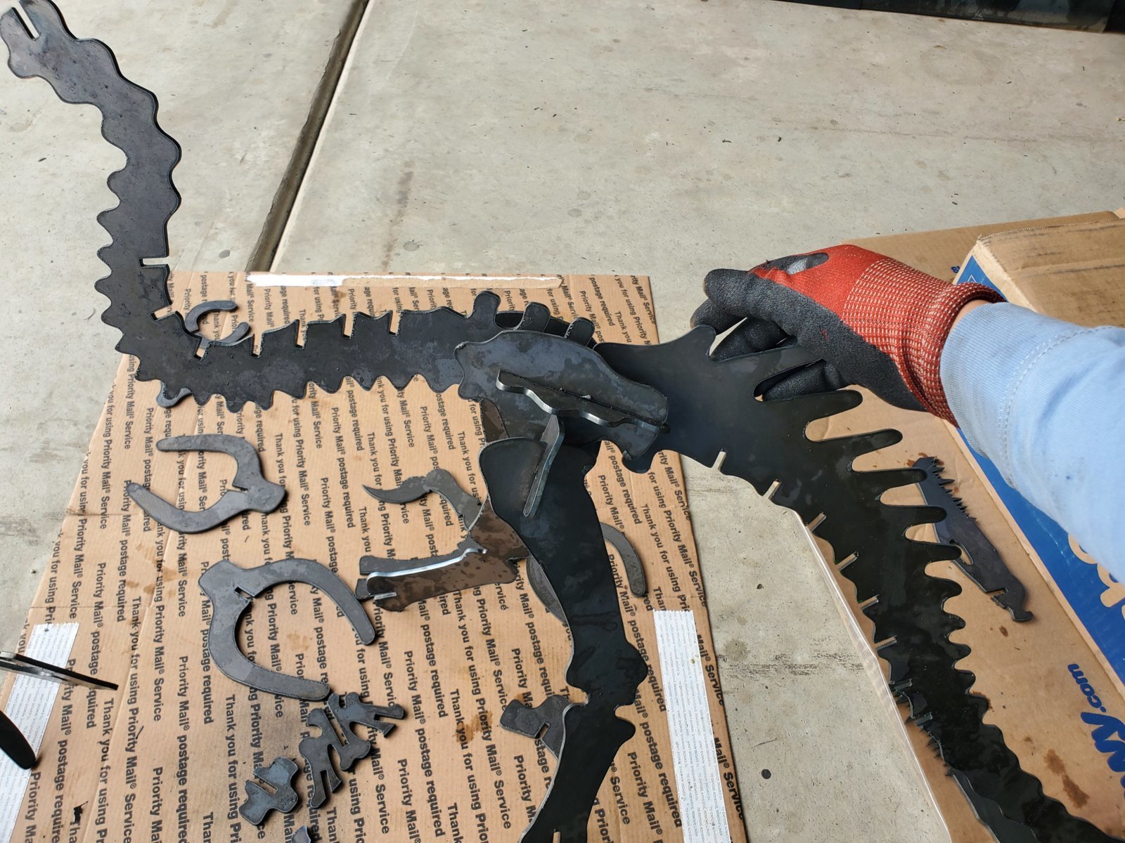

    This is why I mentioned "if you're good at welding" as several of these tabs are less than 3/4"
    Comparison between yesterday's piece
    And what I'll be cutting out here in the next few minutes

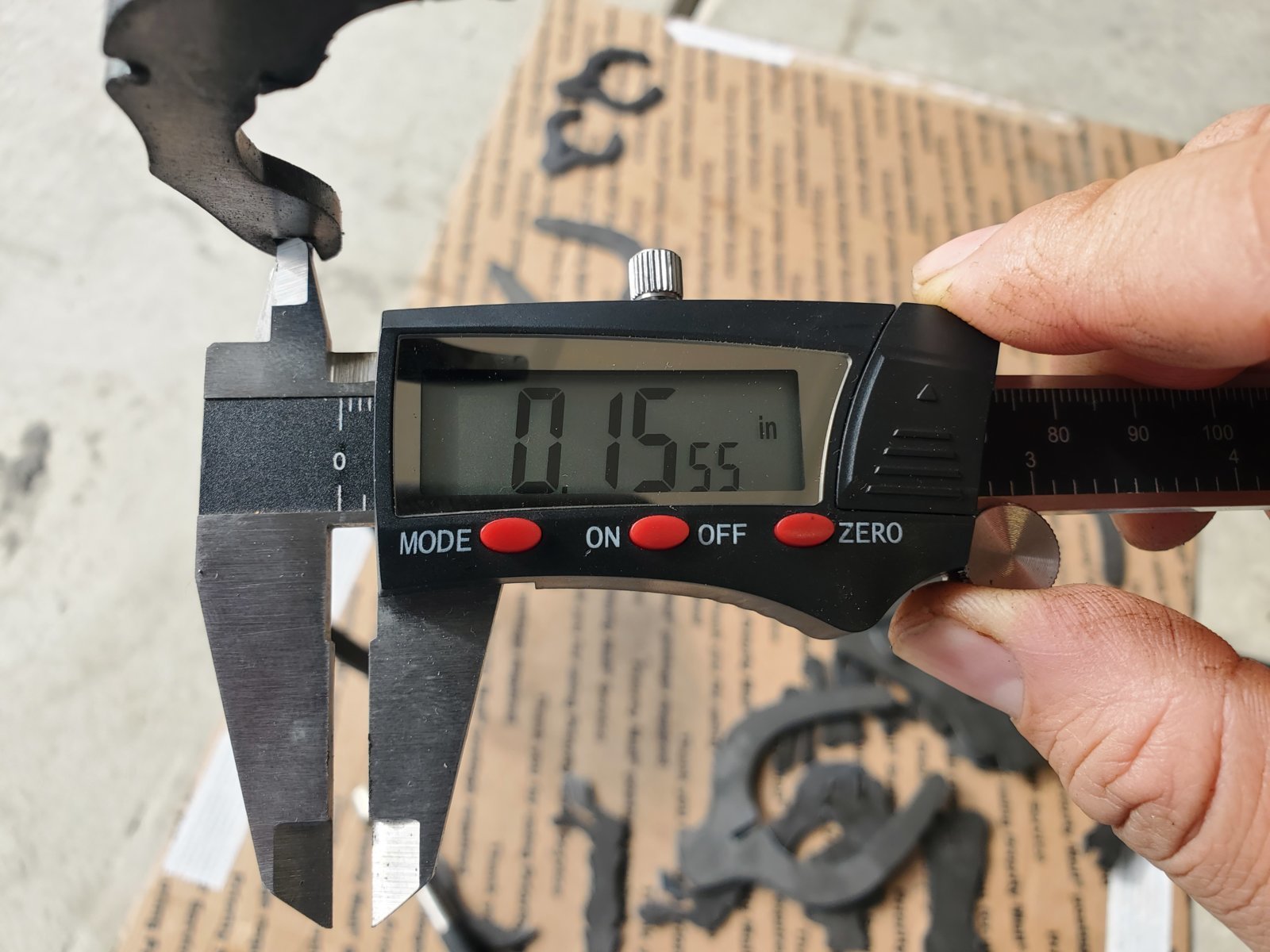

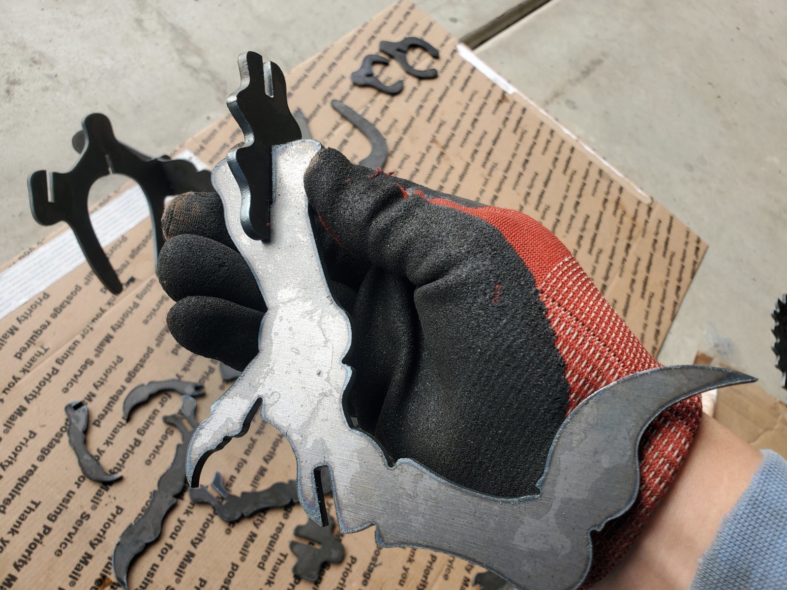

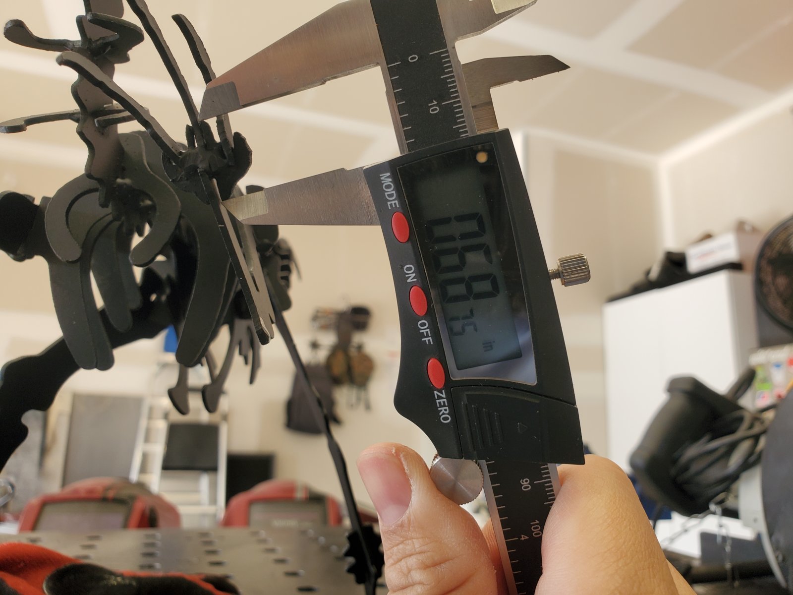

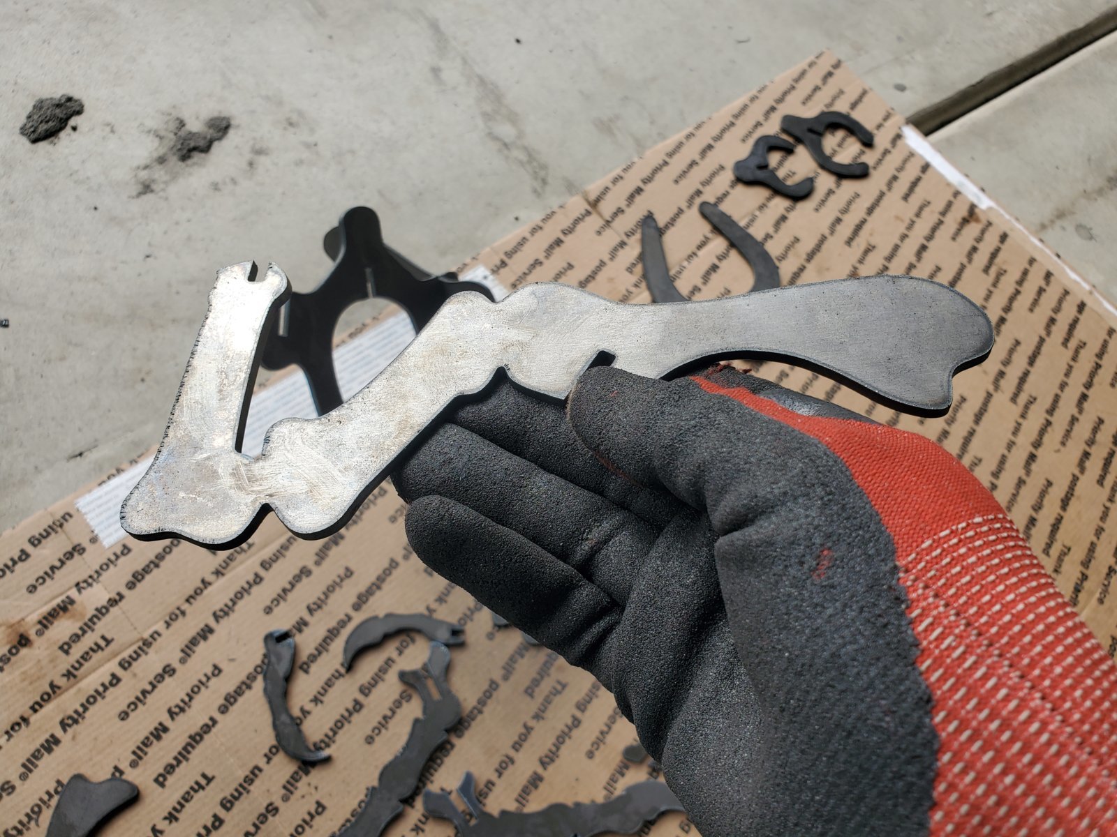

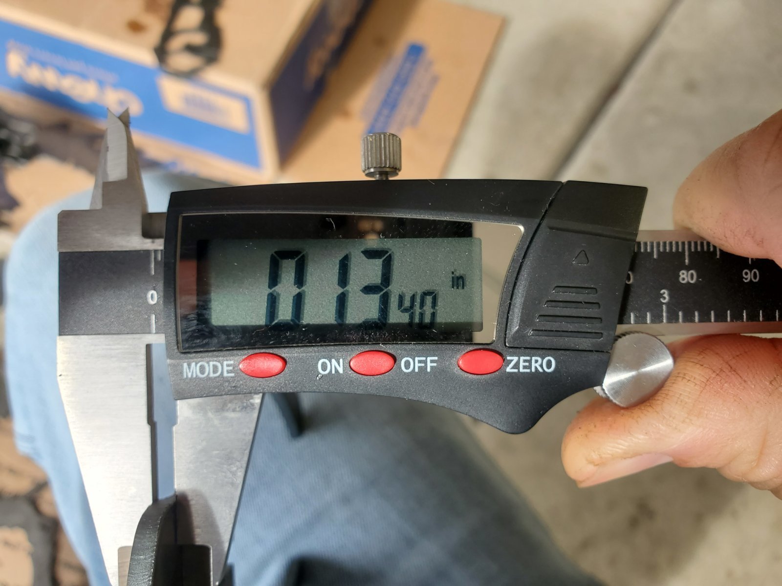

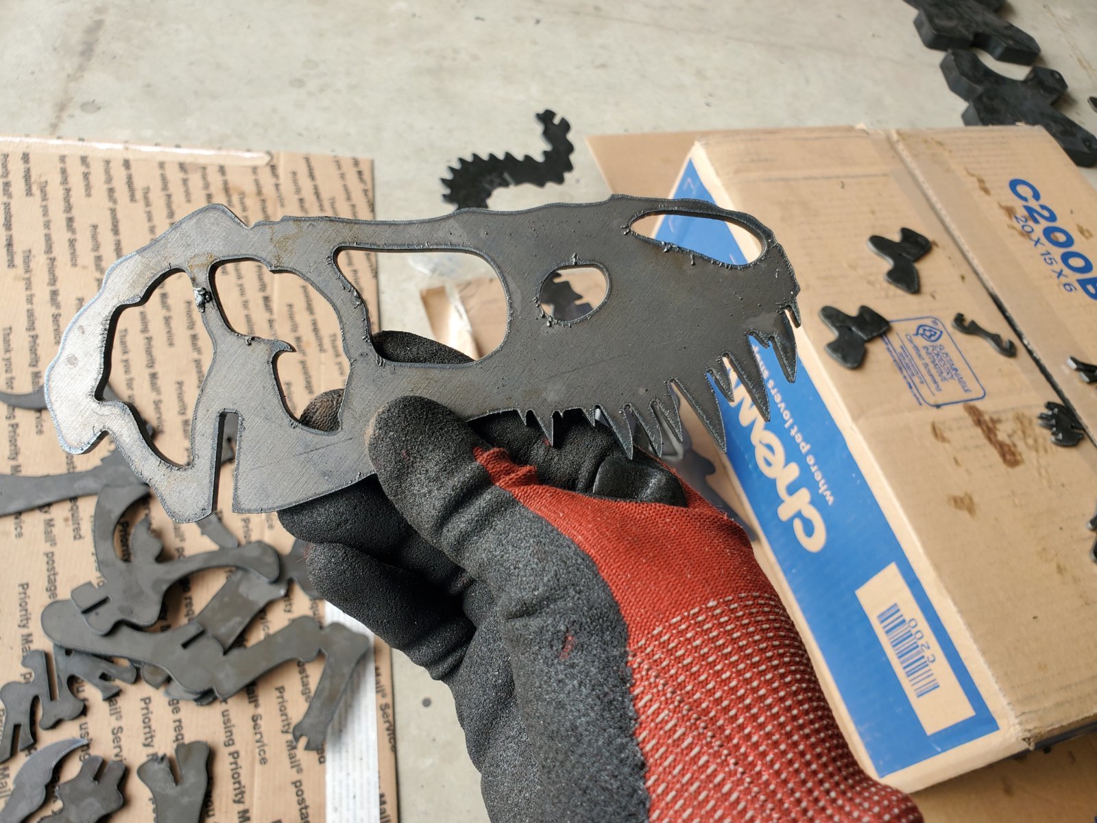

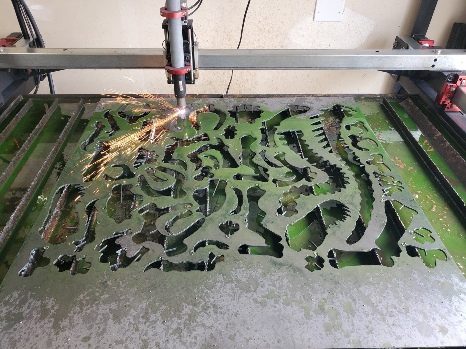

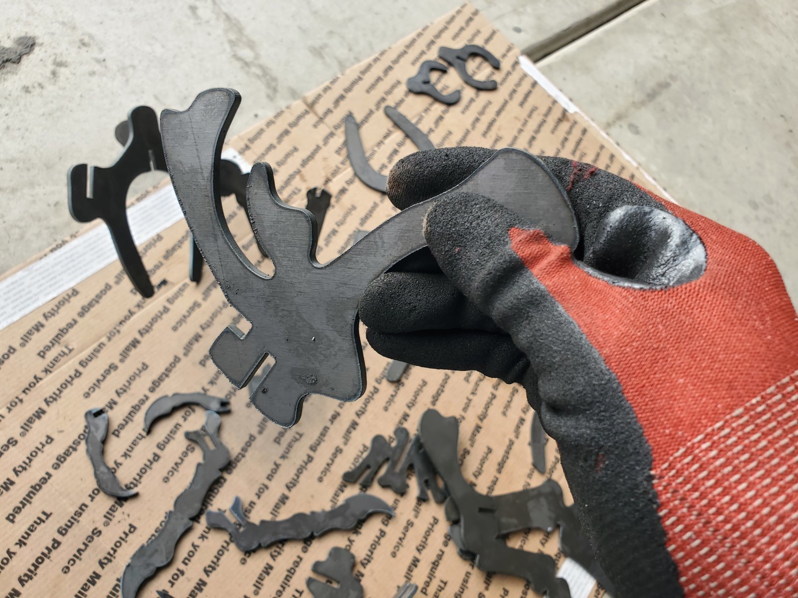

    Ok, if your shit is not dialed in, do not cut patterns out with tight tolerances!
    Fortunately I know wtf I'm doing :cool:
    This plan was set for 11 gauge (.125)
    I scaled it up to fit 10 gauge (.134) with a tolerance of over two hundredths of an inch
    This is how clean and practically dross free most of the parts came out
    The achieved tolerance
    The parts are loose enough to fit together, but tight enough to hold themselves together
    A total run-time of 18 mins 11 seconds and 64 pierces
    Everything shown is right off the table, not a single bit of dross was cleaned off

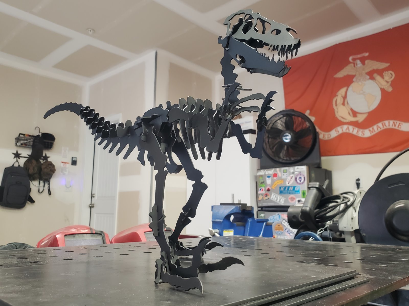

    Already 90% assembled and it's completely held together by being slotted
    This is a kit I would not mind cutting and selling, the only pain in the ass part would be packaging it up due to the length of certain pieces
