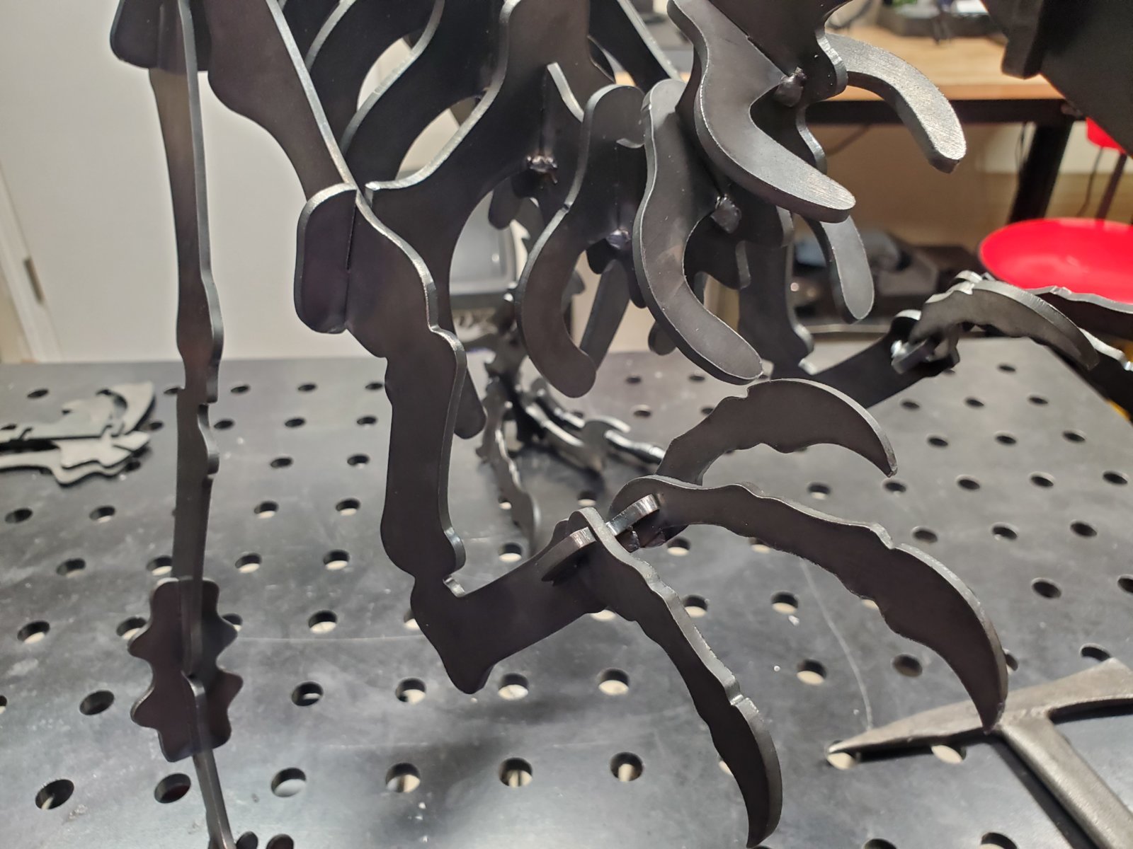

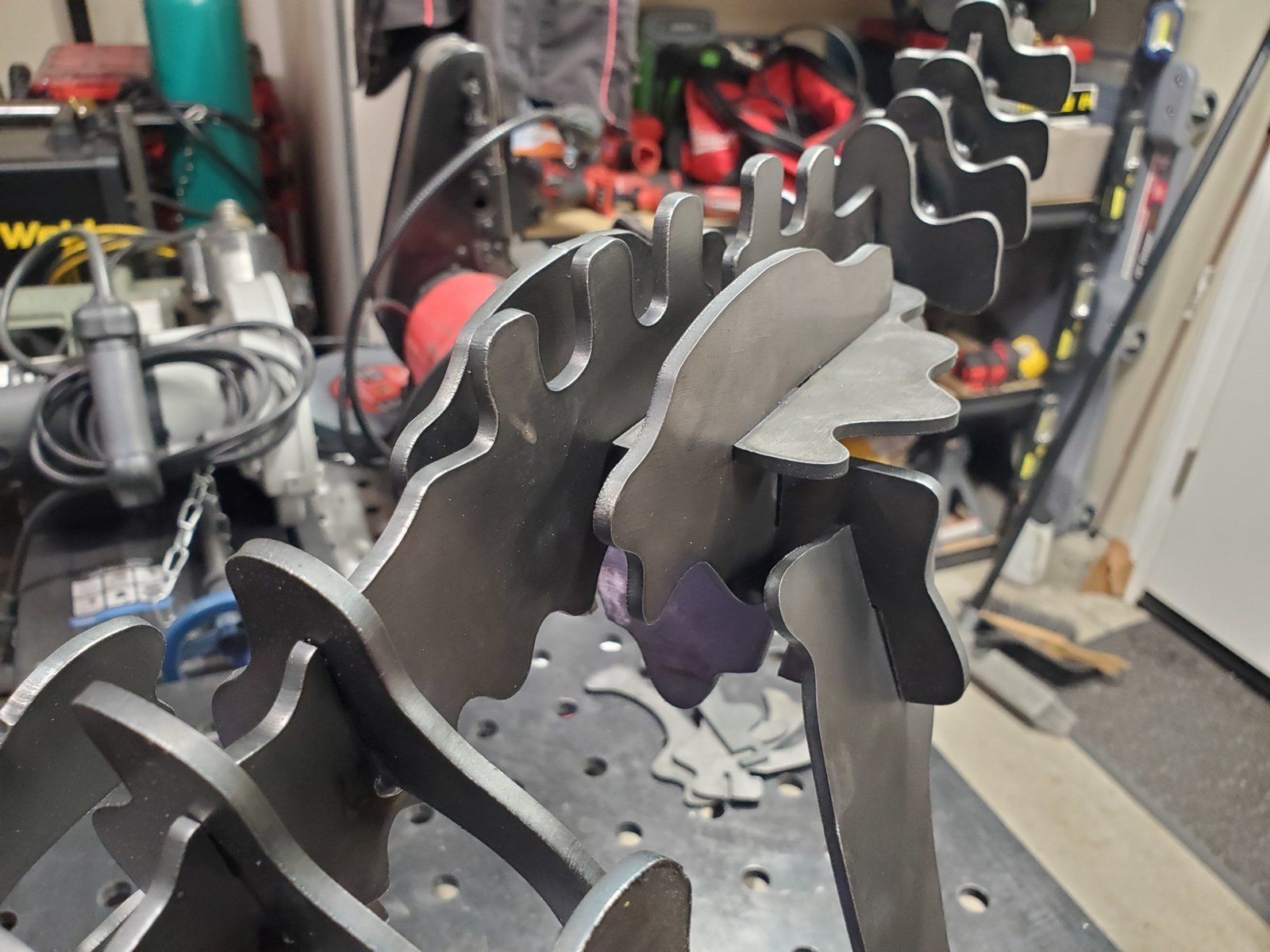

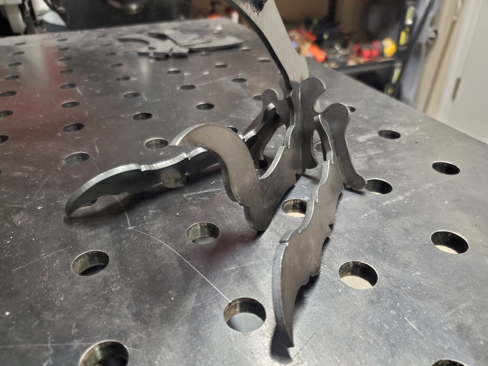

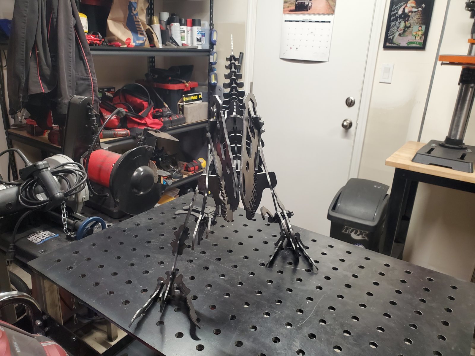

    Few close ups of the fitment and finish on the cut pieces
    Alignment is key in getting it to self-balance

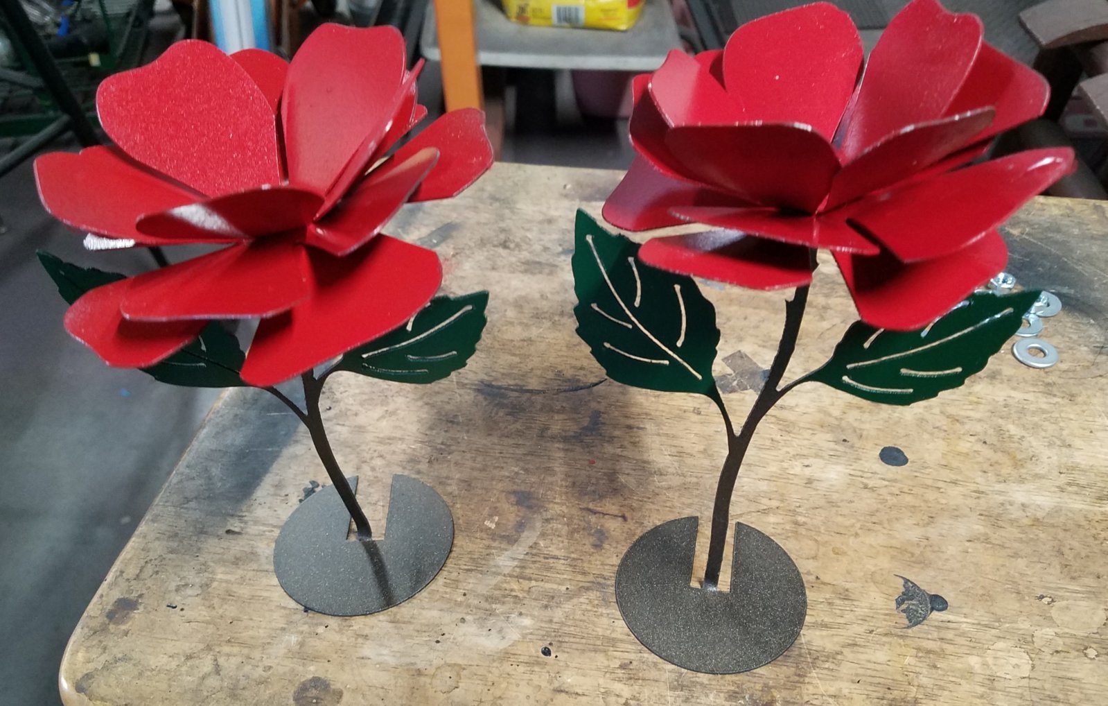

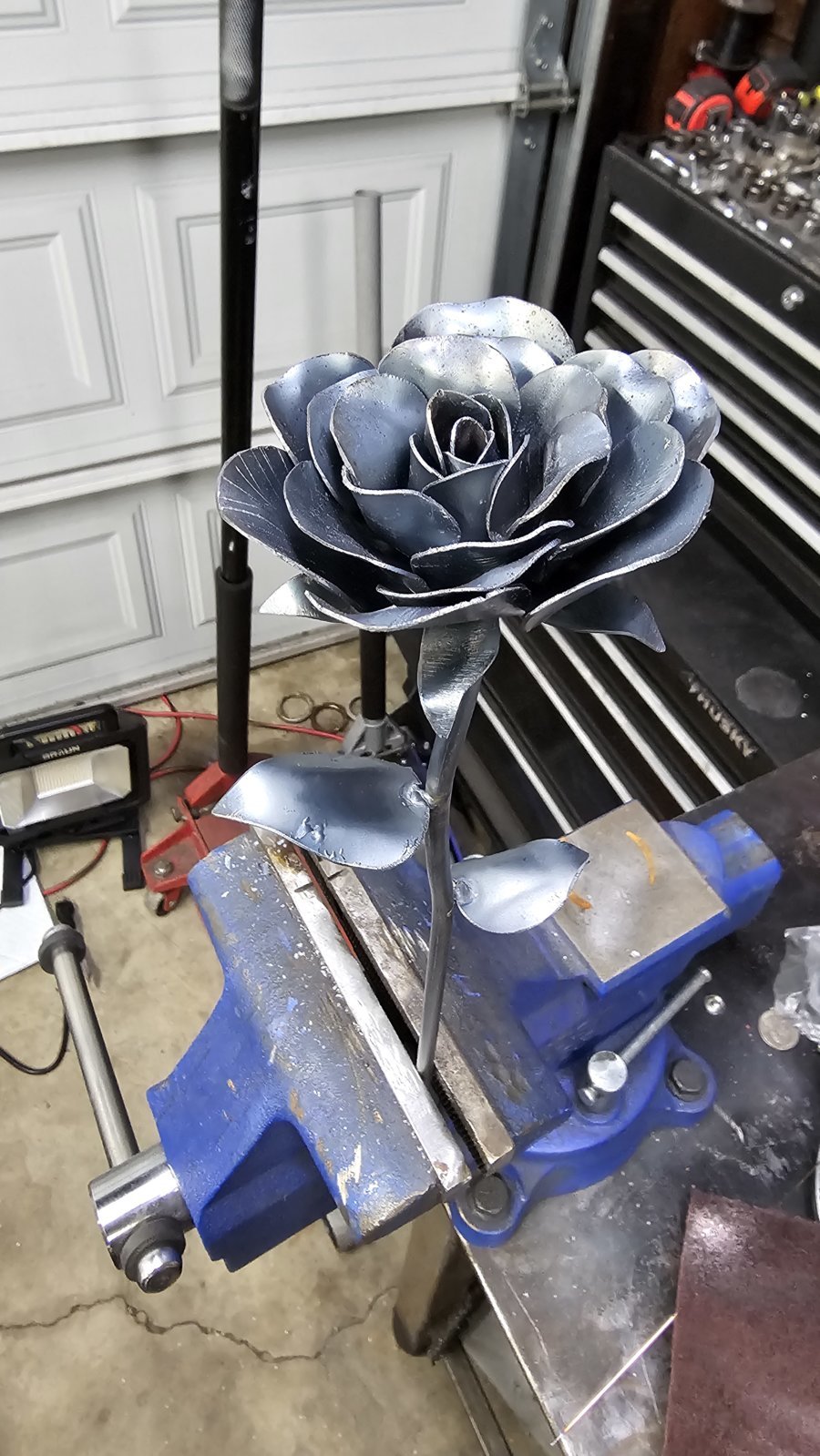

    Little project I made the wife for Christmas. Not a ton of welding but there's some lol.

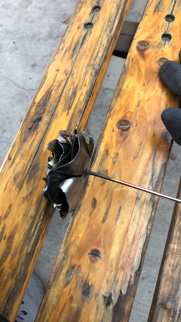

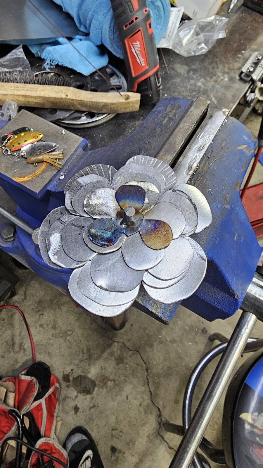

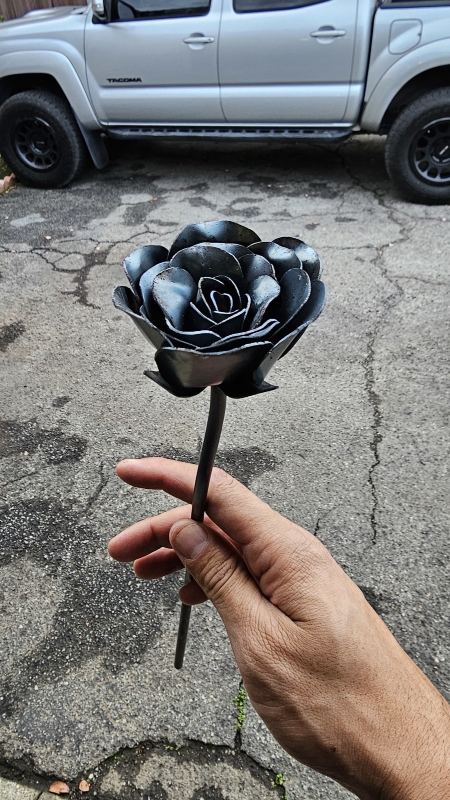

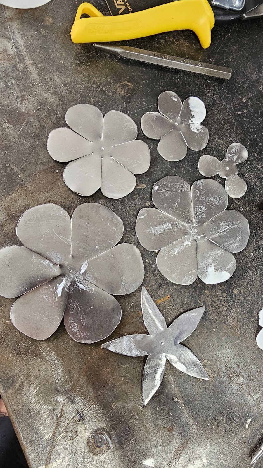

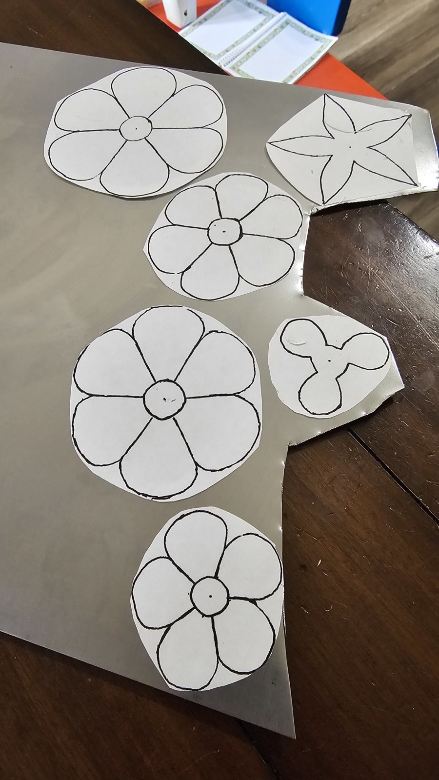

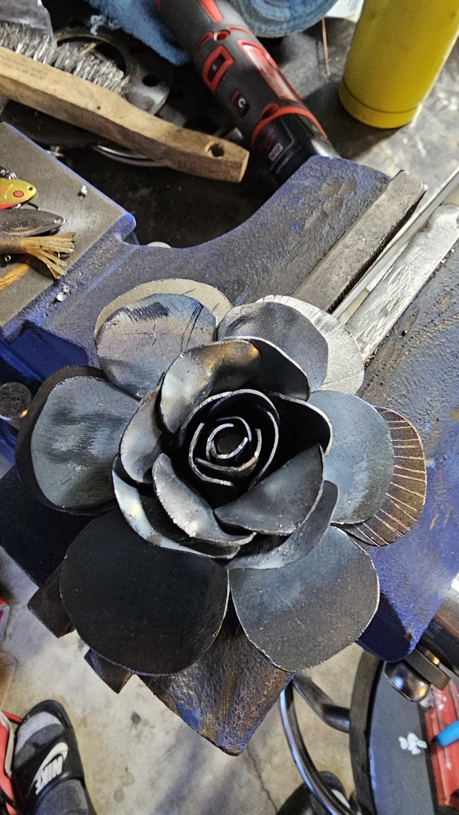

    Cut them all like ninja stars and then curl the edges more
    I also smash all mine with a bean bag pad and a round ended hammer to make them all form more like a bowl
    6C2FA6D6-2C85-42BB-A09D-44A45A07176D.jpg C86F6A7C-29F8-492A-AF91-44900AC00348.jpg
    I shouldn’t say ninja stars
    I should say…. Saw blades

    Man, y'all fancy

    I cover mine in acetone and light them on fire too :rofl:
    keeps them from rusting

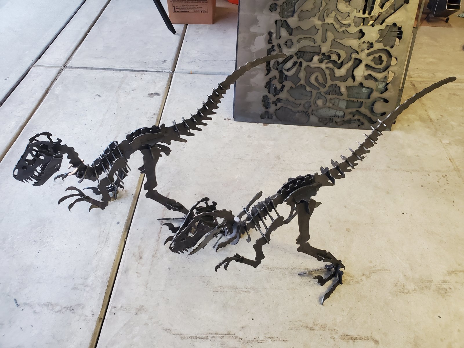

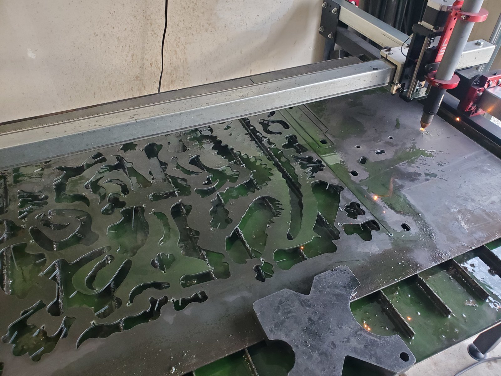

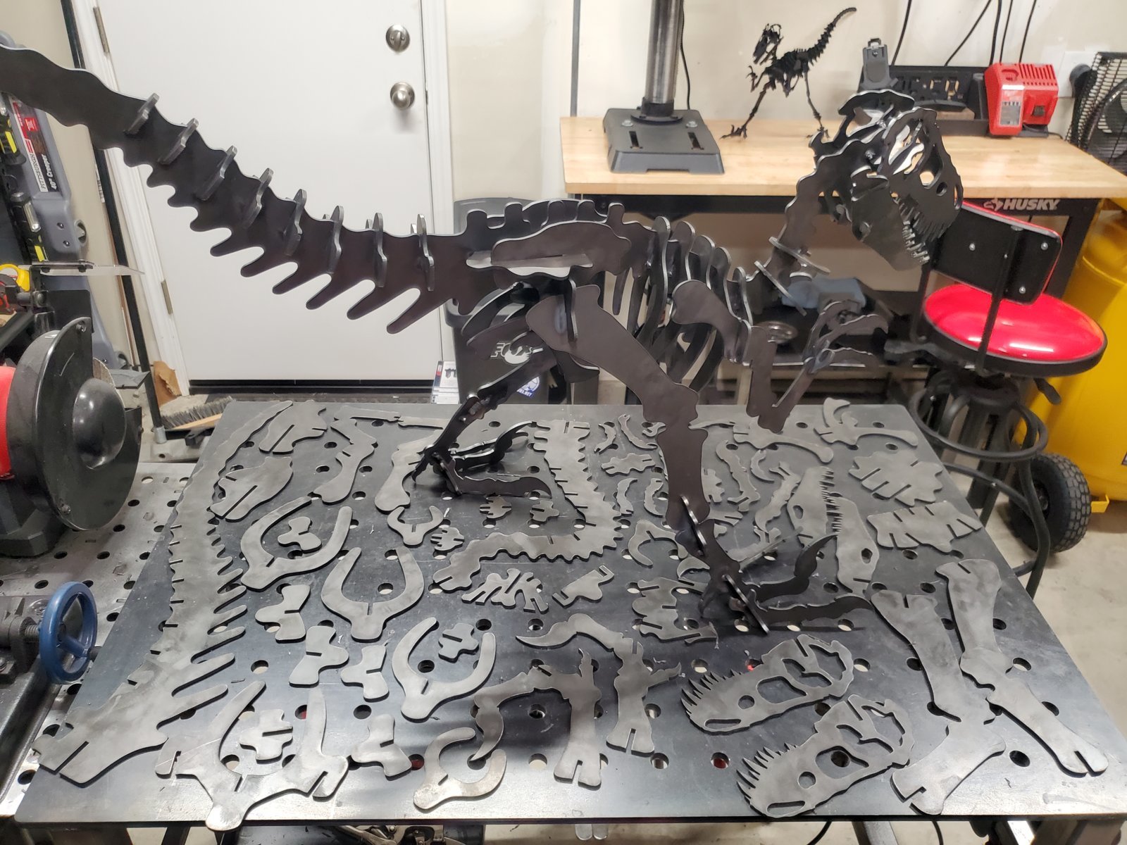

    First sold order, sold as a kit
    All 52 pieces laid out
    I have to say, considering this steel plate had a big bow in the center, all the pieces cut perfect as it assembled and held together just like my first one
    One on the right is held together via slots, one on the left is welded
    If this is something TW would be interested in, I'd be happy to make a thread and sell them as a kit

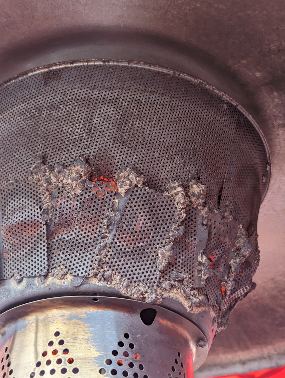

    Heat lamp at a local restaurant

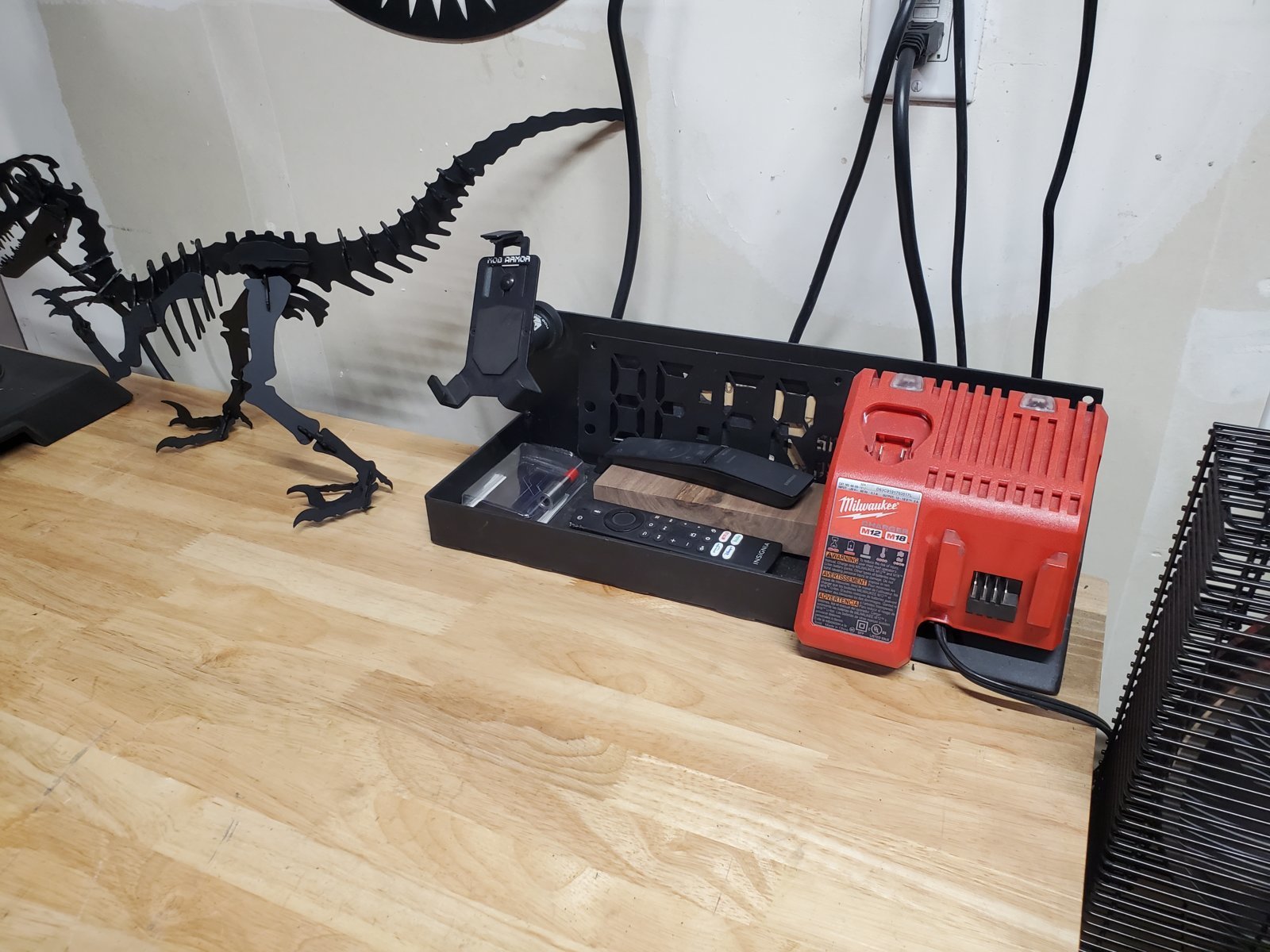

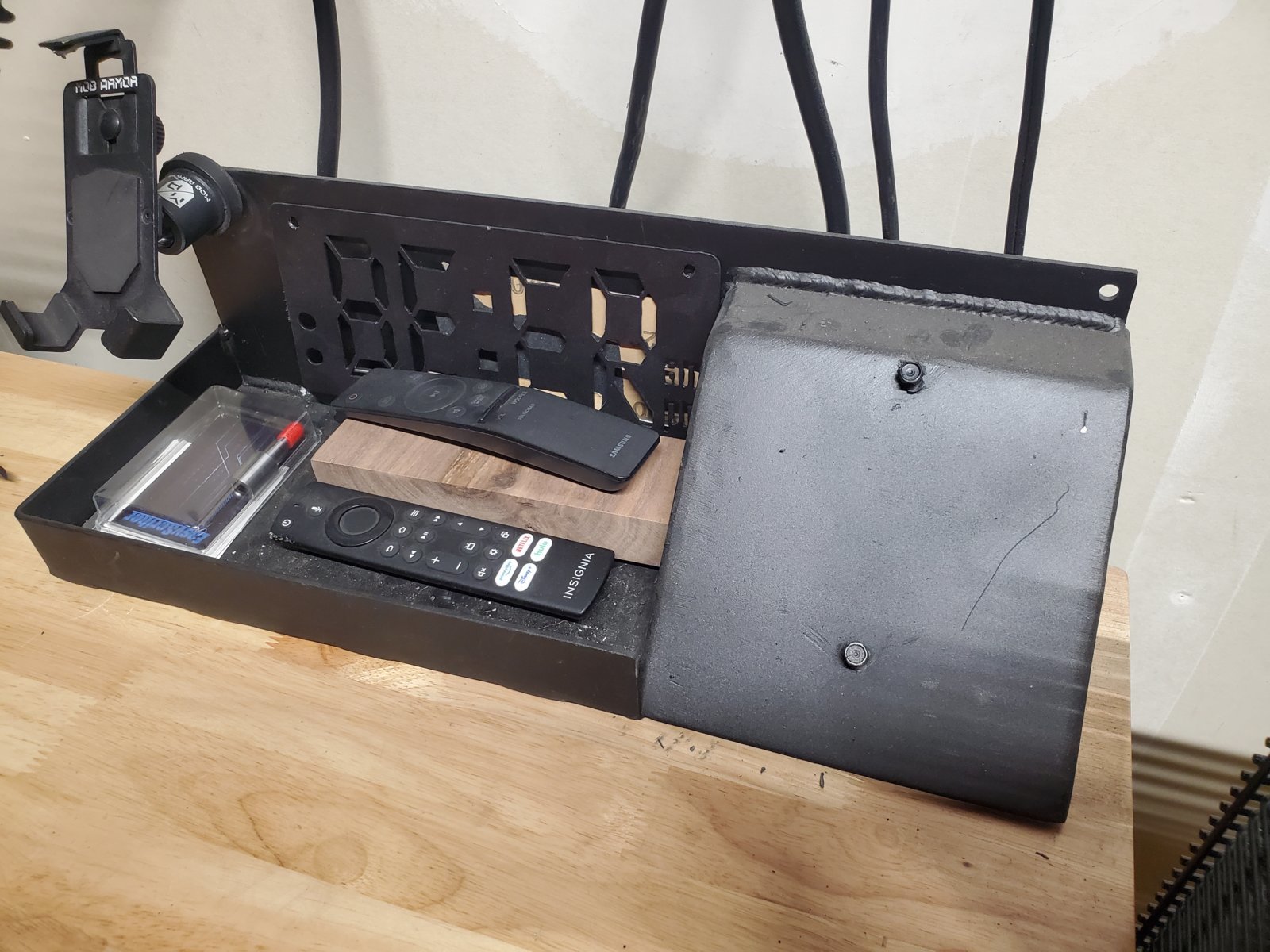

    @soundman98
    That charger holder (ignore the welds, I was just learning to weld)
    With the charger removed; I welded two bolts on it to prevent the charger from falling off cause sometimes I just shove a battery on it quickly while I go grab another
    I use that phone holder to throw my phone on the charger while I'm in the garage
    Holds my TV and soundbar controllers so I don't lose them
    A misc wood block in case I need it for the drill press nearby
    And a ton of extra tension wrenches and other lock picking tools
    It's super useful

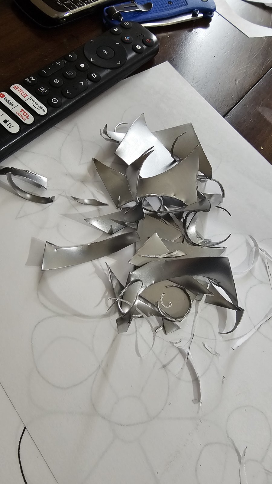

    I made some flowers for our Christmas table.
    Not an original design on my part. Tried 18 gauge and they wobble like they are outside in the wind! :rofl:
    16 gauge for the next sets. Gonna make a few extra for future craft fair items.
