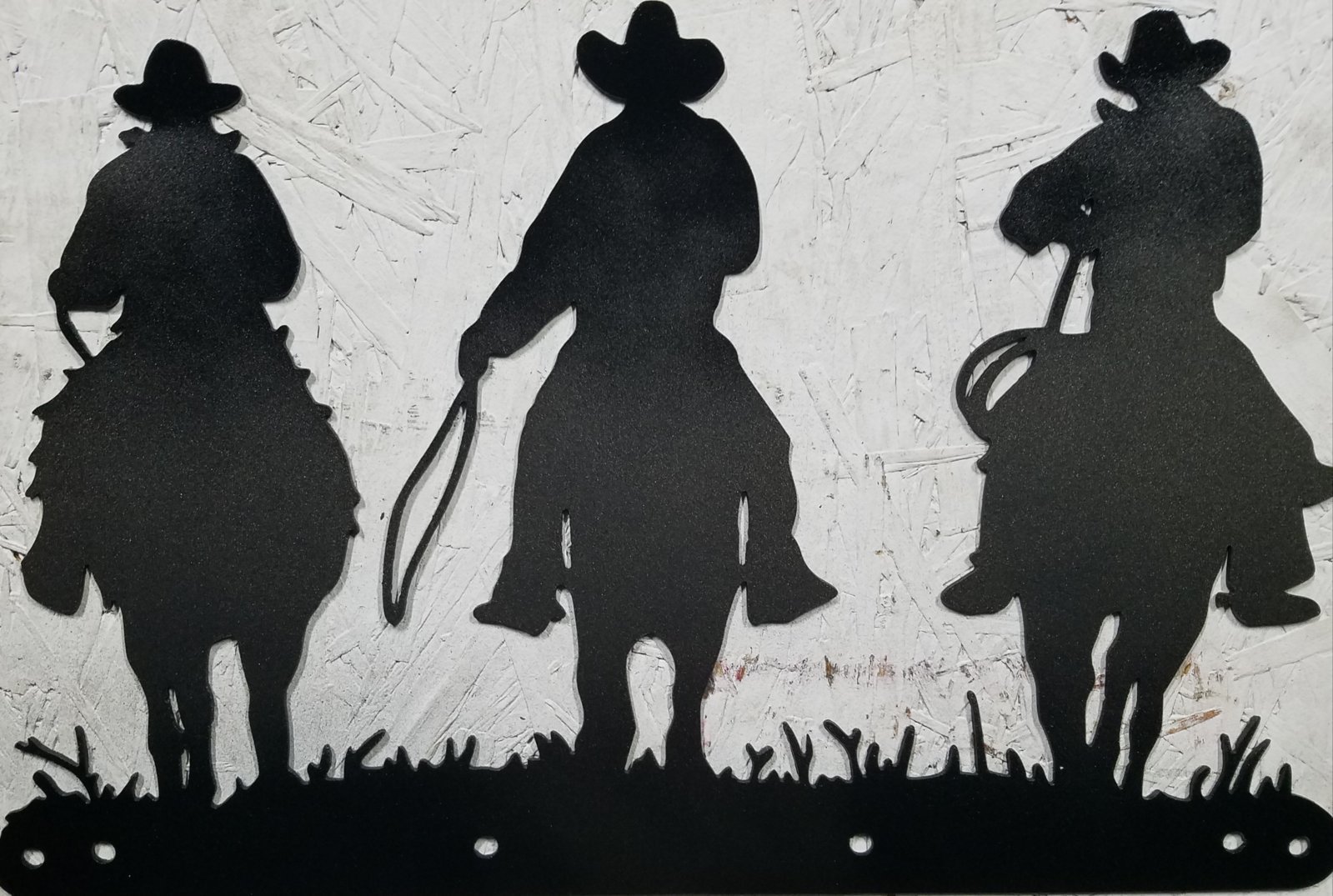

    Cut a coat rack today. Still need to get the hooks and I think I will jazz up the paint. Ropes yellow and maybe add some blaze to the chest of at least one of the horses. Outside holes are for attaching to the wall.

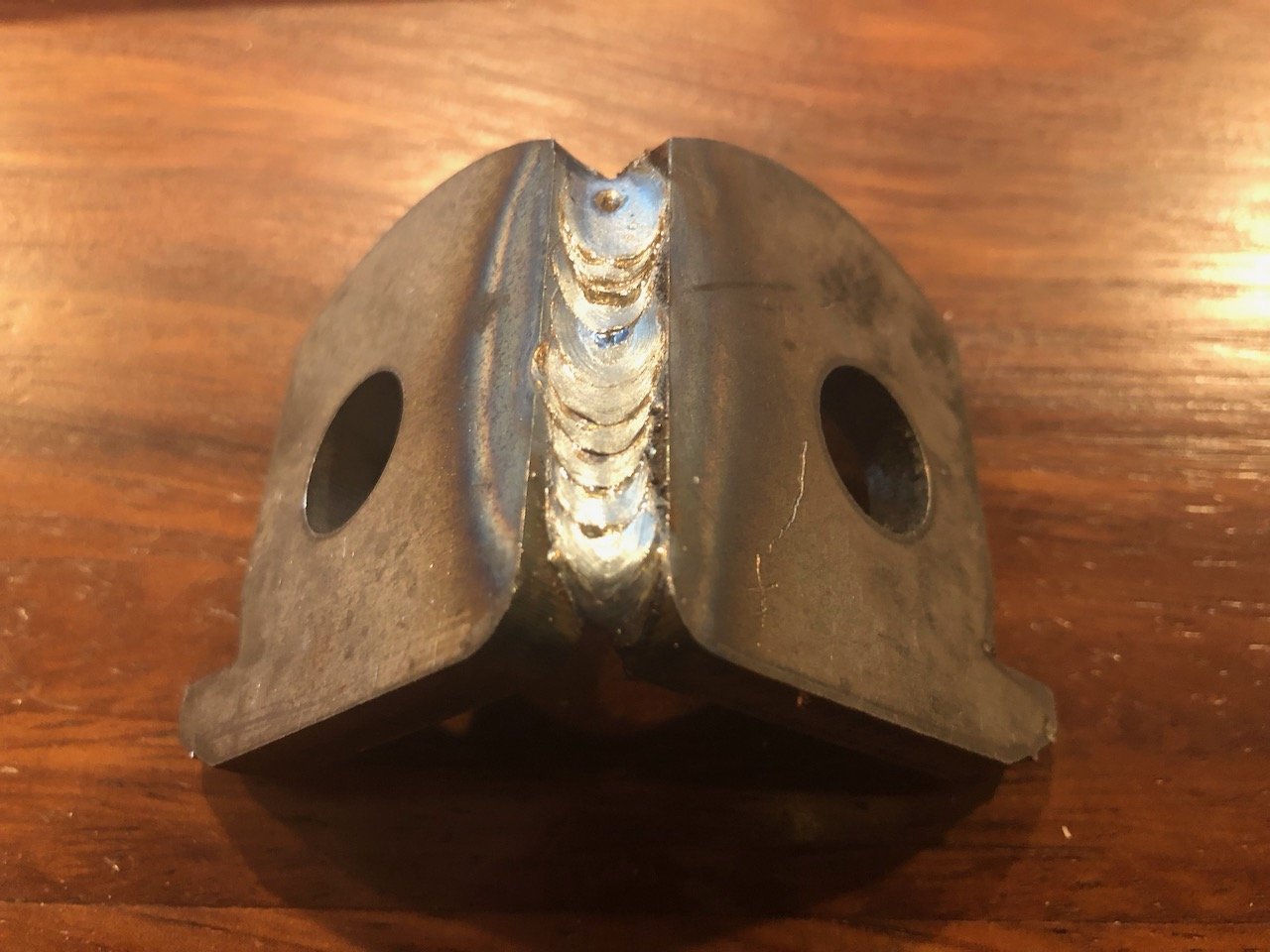

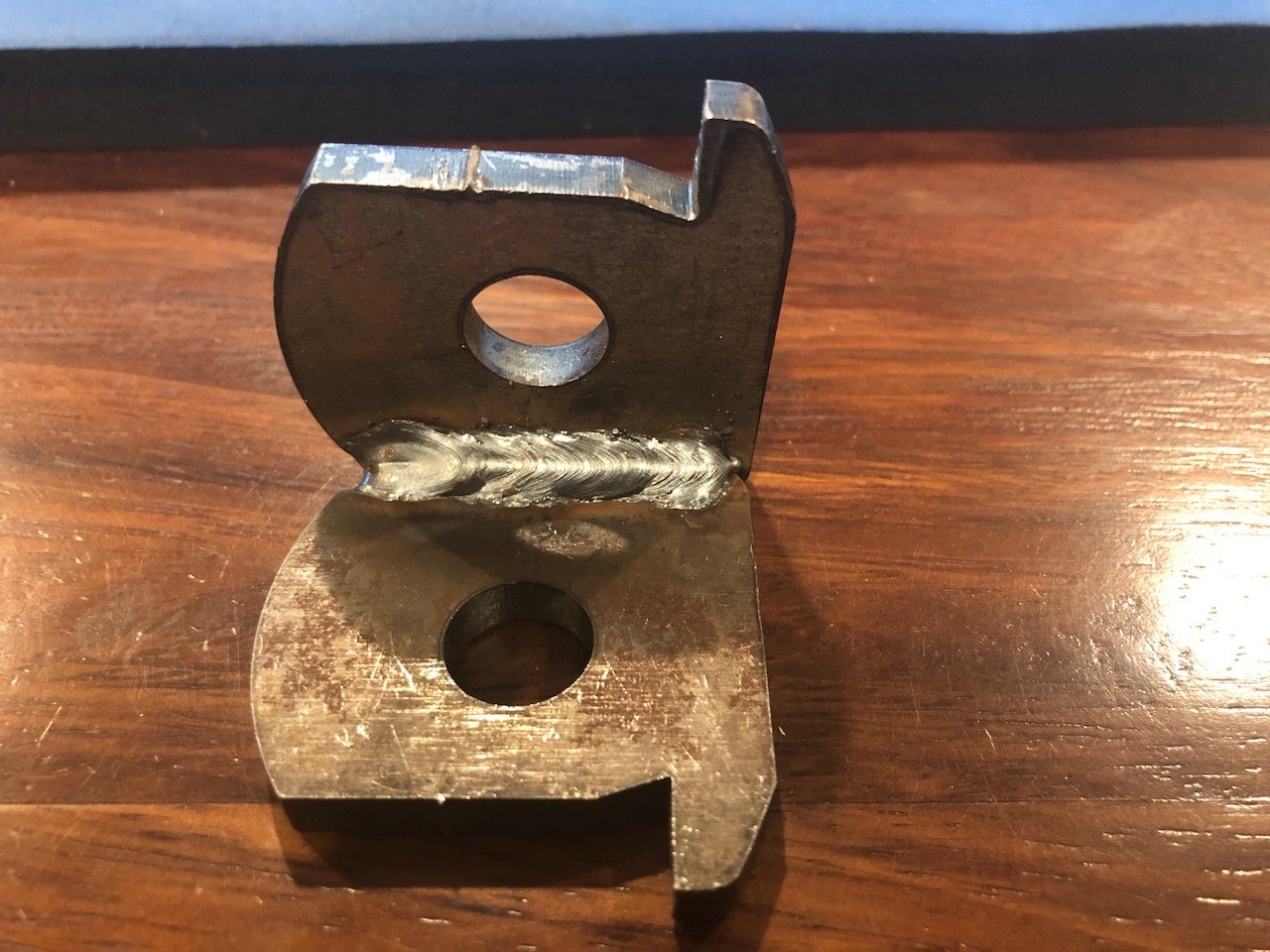

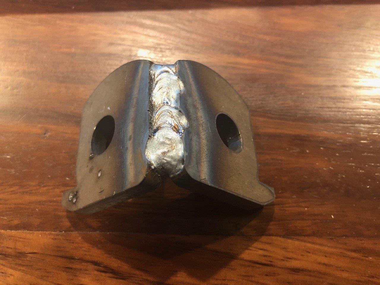

    I was playing with (practicing) my welder (Miller 211), and was having a problem with vertical uphill welding. Hopefully someone will have a solution.
    I started laying down flat welds. I am not using Autoset mode. I was happy with my flat welds - as long as I did my part, I made a nice weld.
    Switching to vertical uphill, some were OK, some were way off. I adjusted the heat and wire speed, but could not figure out how to make it work. The uphill weld started fine, then the buzzing stopped, the wire continued to feed and melt, the piece was hot (red), but I ended up with a blob of melted wire and no penetration. This behavior was repeatable.
    To convince myself I hadn't totally lost it, on one piece, I welded a flat weld (with success) and immediately welded uphill, with the problem.
    What am I missing?
    And, since I know everyone likes pictures, here some of my successes. All of these were welded in the flat position. Not dimes, but good heat penetration.

    Settings are completely different going uphill and downhill vs flat
    Why are you going uphill on such a wide open corner?
