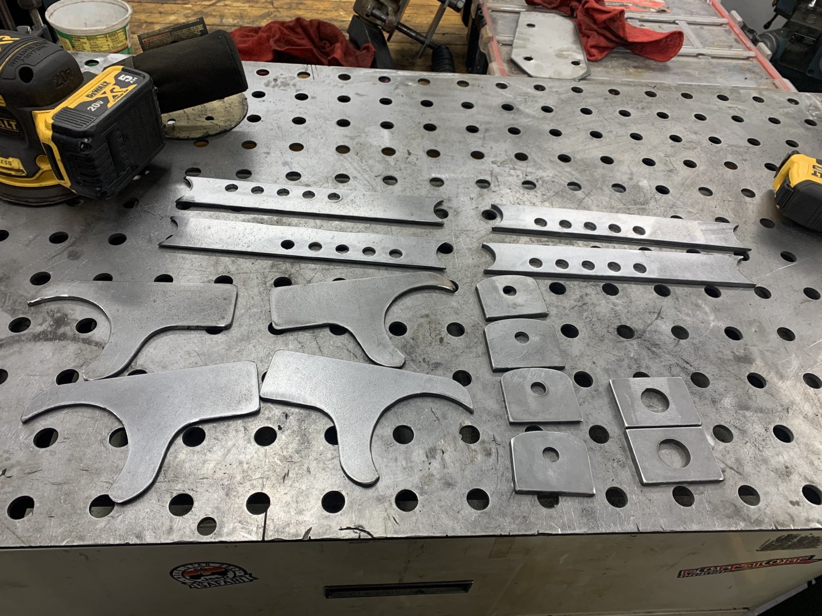

    Where are you advertising for selling stuff? I mostly just posted on Instagram and orders come in waves sadly and would like to try to be more consistent. I mainly do tabs and brackets and axle stands and not much art work because of the flood of Etsy guys etc. IMG_3515_Original.jpgIMG_3938_Original.jpgIMG_3897_Original.jpg
  7. Dec 27, 2023 at 10:27 PM
    Kwikvette
    Feb 27, 2019
    #284735
    81,083
    Fresno County
    4 run, 2 don't
    Looks good!
    It's a combination of word of mouth, repeat customers (since I'm low cost with fast turn around), and threads I've done work in/on and a PM suddenly comes in asking if "I can do this/that"
    For CNC stuff, I've said no only once and that was because it was on 5/8" steel and I flat out said unless he had extra to spare, I don't have my settings dialed in for 5/8".
    Some of my repeat stuff is local as well as there are two shops I make parts for.

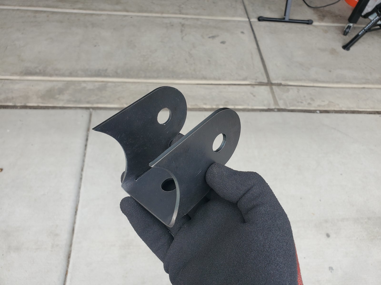

    Likely the last job of the year.

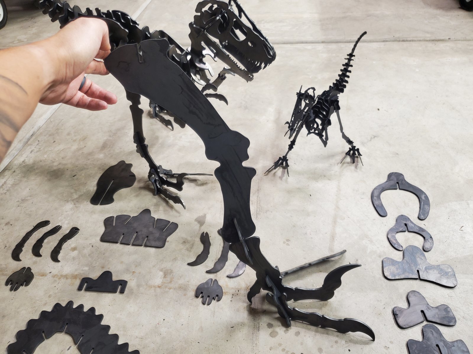

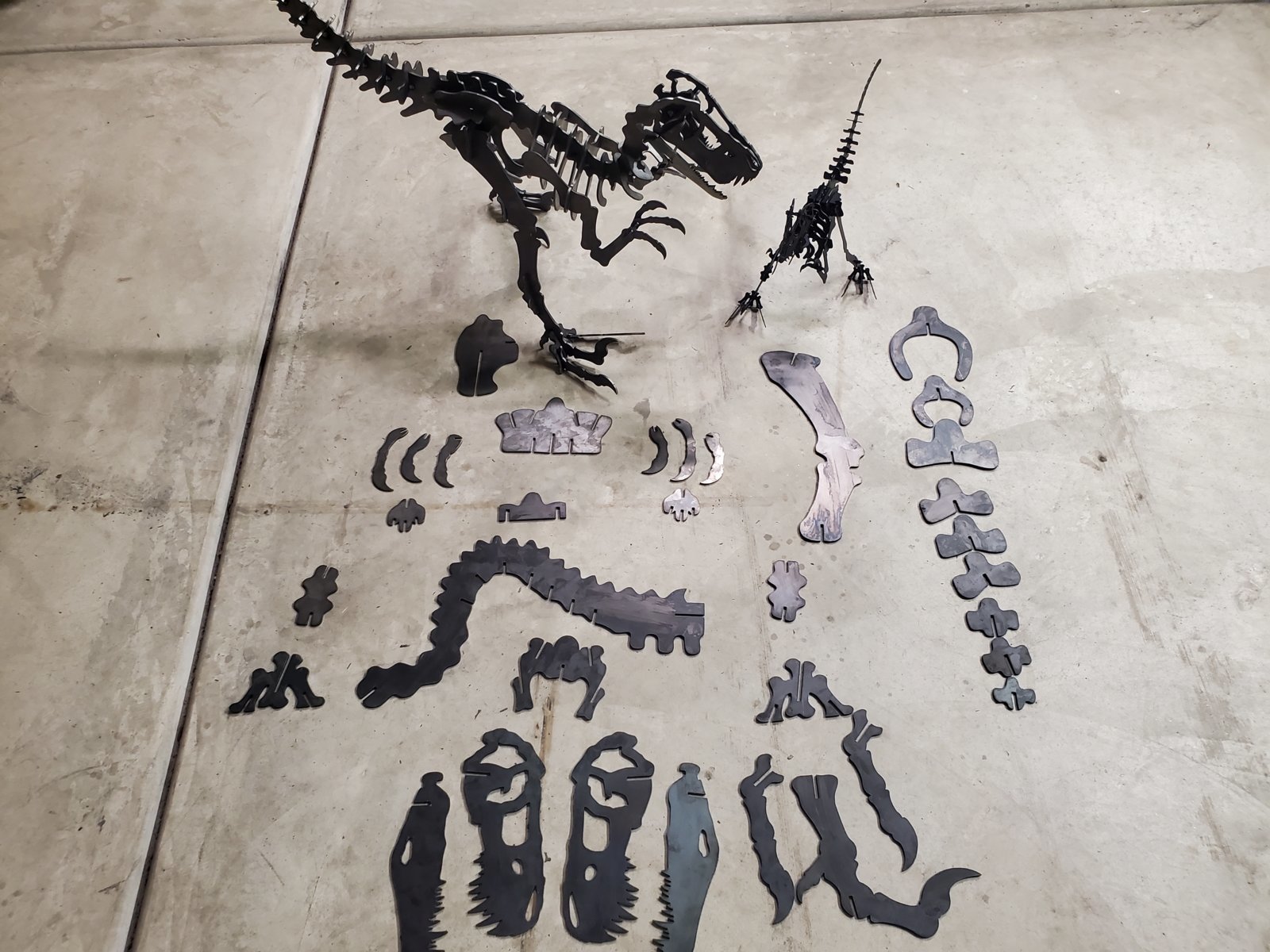

    So, those Dino Kits?
    I sold a few already; one was picked up yesterday but before it was...I decided to re-cut 3 individual pieces to replace. Mainly because the faces had some gouging from handling.
    Nested a few parts to cut out as 'extras' for future orders in case they got lost by a customer or damaged via welding. Well, it wasn't until after I cut the entire group of parts that I saw I used the wrong set; I accidentally picked parts from my +5' variant!
    Customer came by to pick up some parts today so I thought I'd cut a few more of that +5' Dino.
    The assembled one there is my +3' variant; you wouldn't have thought that considering the size of the parts laid out :rofl:
    Here's the +3' along with the 20" variant -
    Just assembling one of the legs (below the hip) it's already taller than my big one -
    This is going to be so badass :D
    Not to mention, the customer that had swung by wants a parts kit as well so have to cut 2 more.
