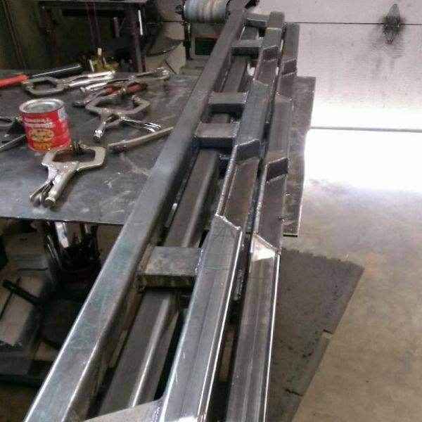

    My contribution from the last couple of days......

    Sliders with steps?
    I dig it. He didn't want to chop, or you didn't?

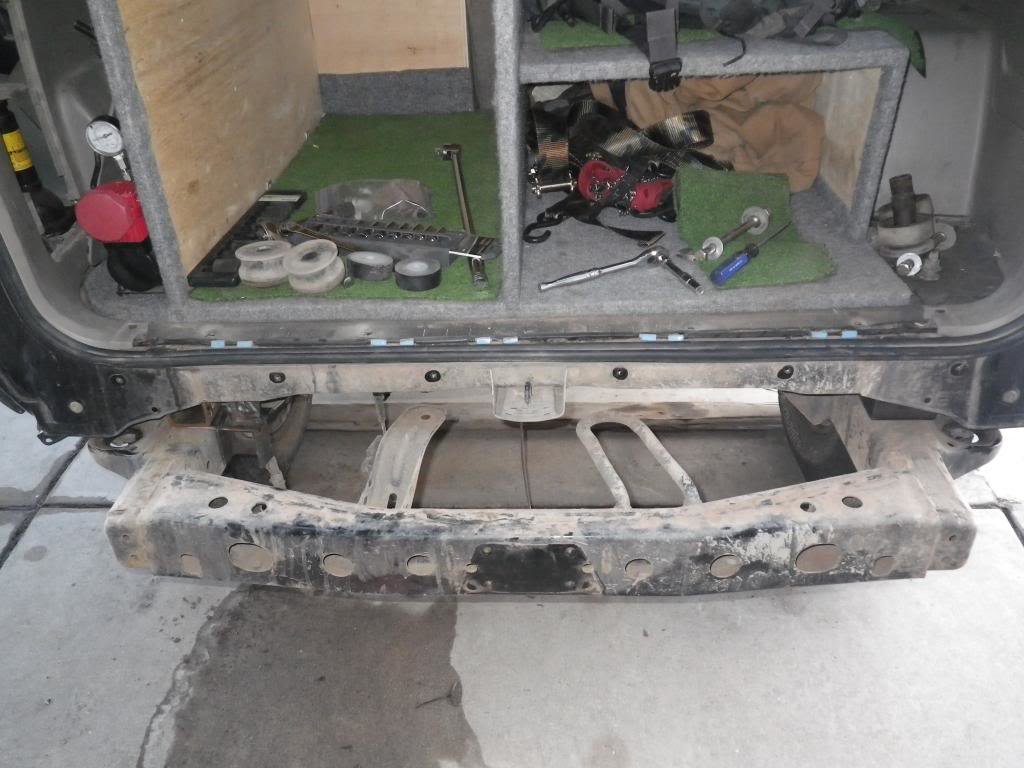

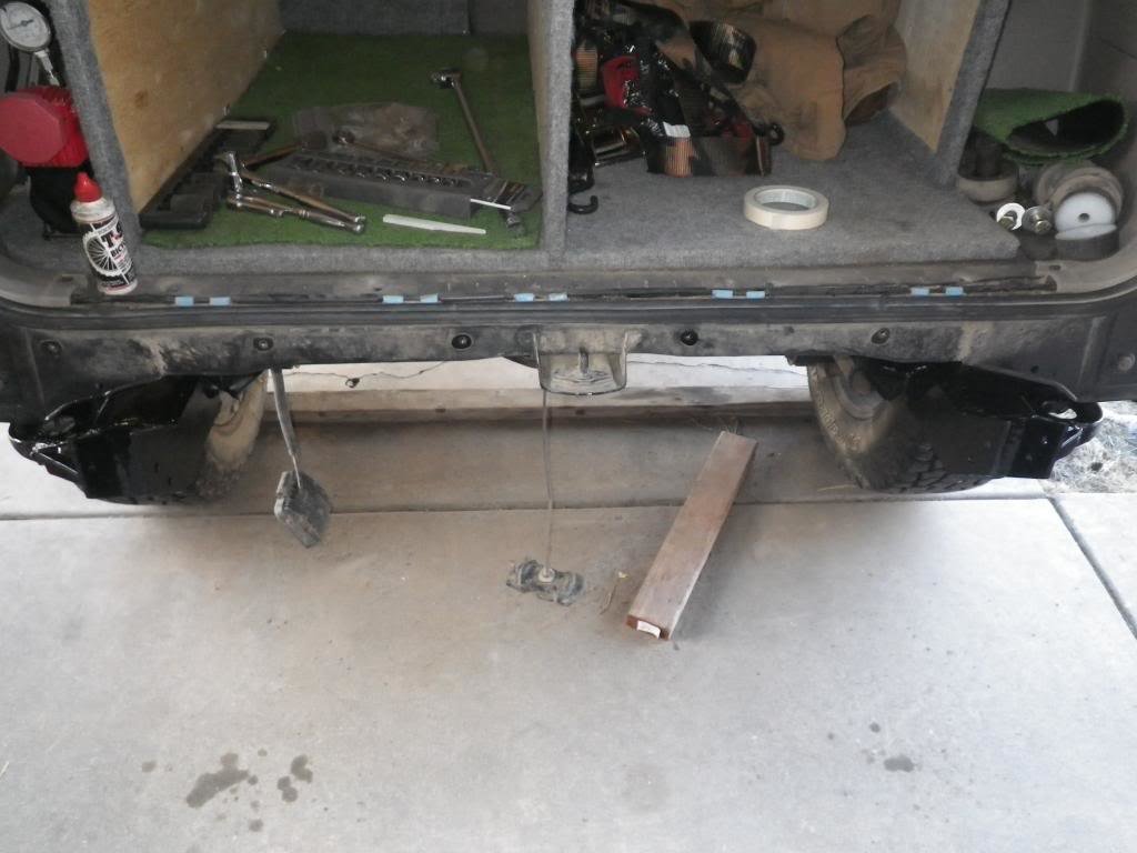

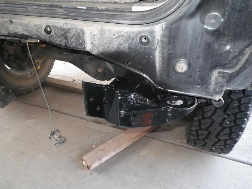

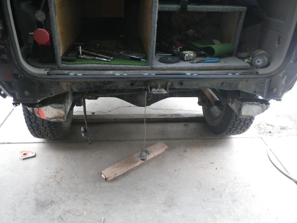

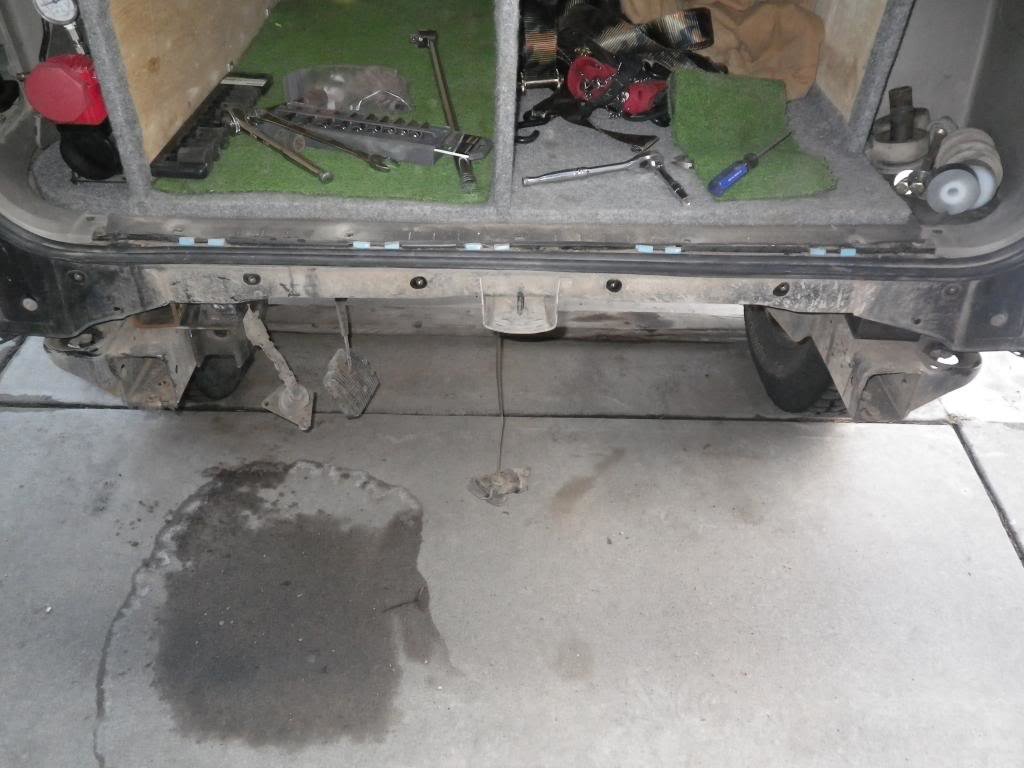

    Spent my first full weekend fabbing and working with the welder, and I must say I have even more respect for you guys that do this for a living. This is some time consuming back breaking at times shit!
    Here is what I have come up with for a bumper, chopped the cross member and capped the fram, and then added some mounting points that will sandwich the bumper mounts, held in place with 4 grade 8 1/2" bolts.

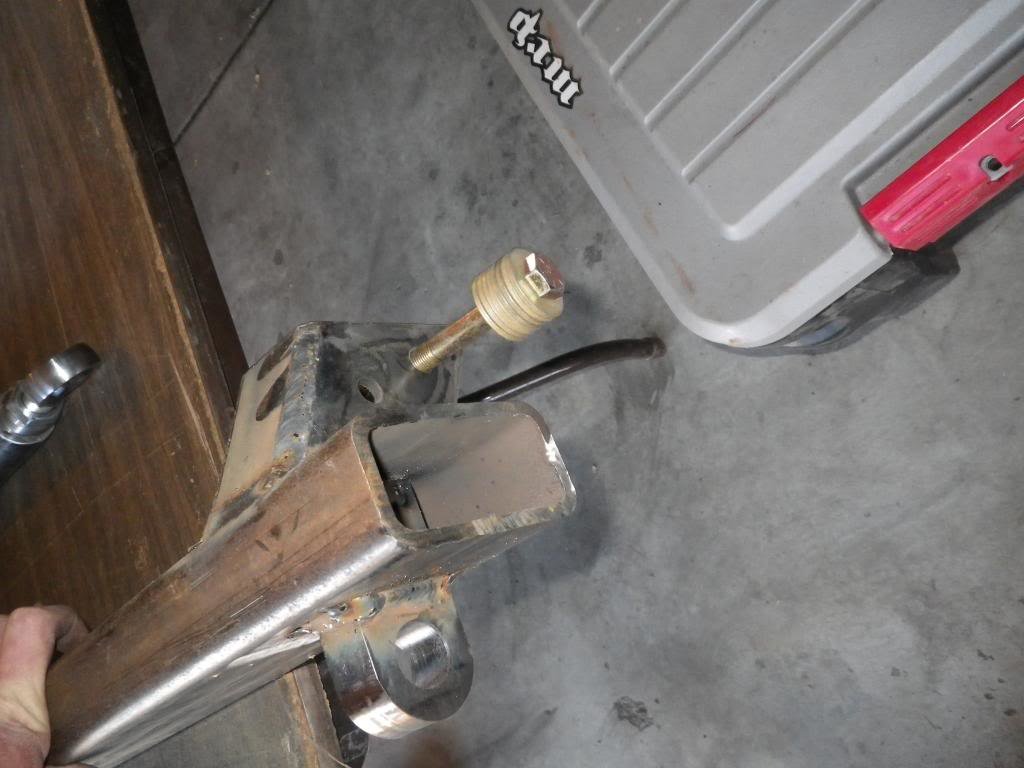

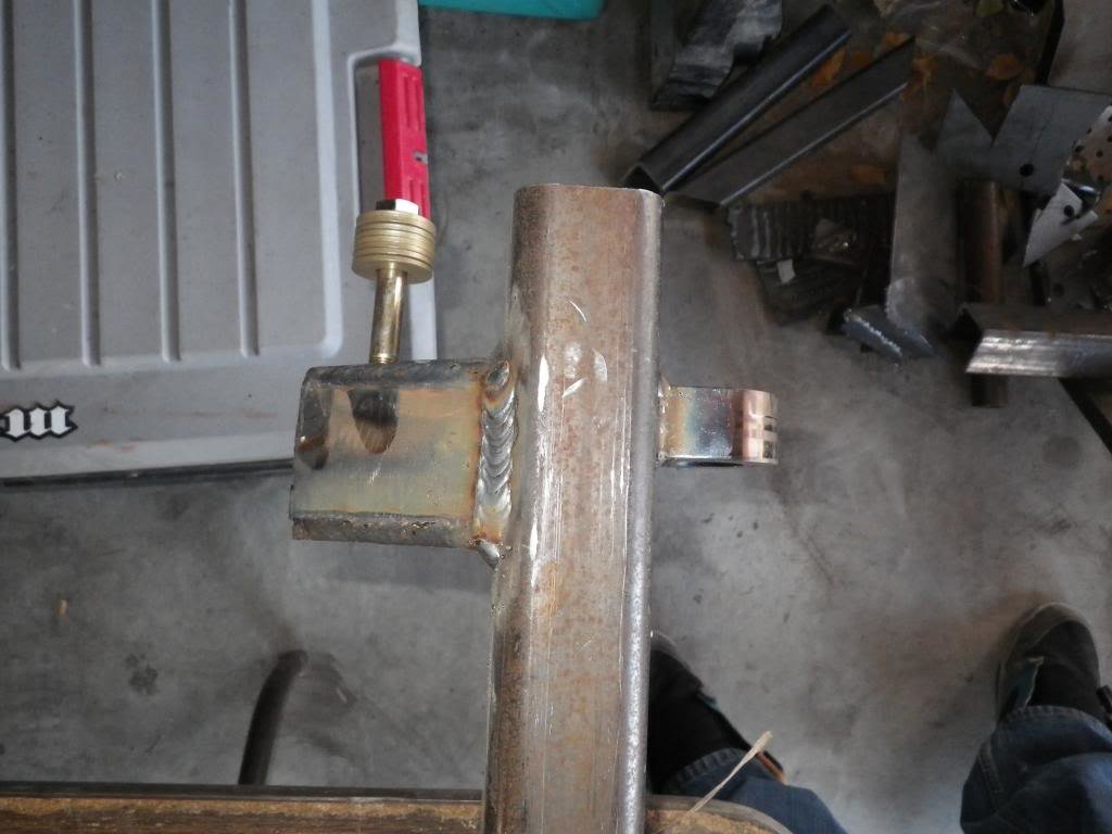

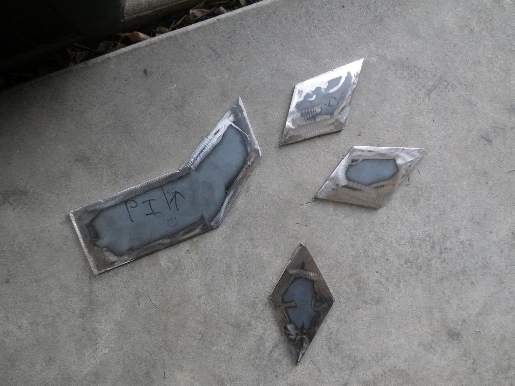

    I lost one of my shackle mounts for most of the weekend, so I didn't get the main crossmember/mounting piece complete as I had hoped (turns out I used the mount to support the body from the frame after I removed the body mounts and forgot I put it there until I was putting everything back together last night :eek:)
    Anyhow, here are some pics of the crossmember and shackle mount, I pierced the tube and welded from both sides as well as to the plate on the back, all 1/4" tubing and plate.

    you need a new rear cross member!
    Honestly, you shouldnt have cut the old one out before welding a new one in even. I've seen the rear frame section narrow by about 3/8" by cutting that crossmember out. I spread it back in place and welded in a new piece, but it was certainly crazy to see it narrow up that much when it appears to still be decently supported a little farther up by the track bar mount/spare

    I'm on it, there is still the one in there from the spare tire carrier as you mentioned, I also checked the spacing before and after I cut and will match it. But yes, I will be adding an additional one welded in. It is definitely pretty flexy back there with it removed, I was pretty surprised, also that the frame is only 1/8".
