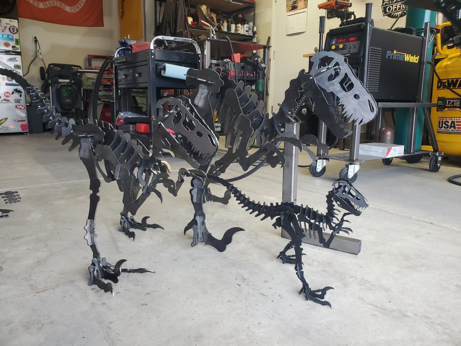

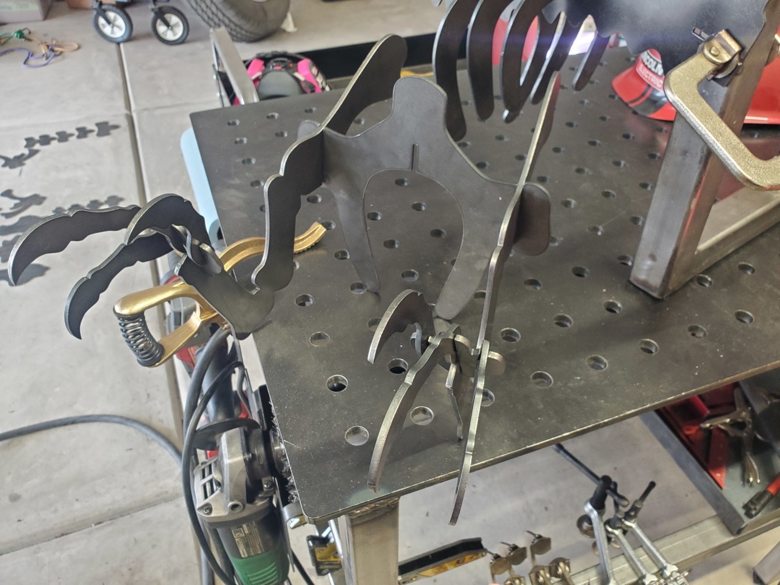

    So far I've got 95% of my parts cut out; I'm starting to think this might come out closer to 5' 6" give or take

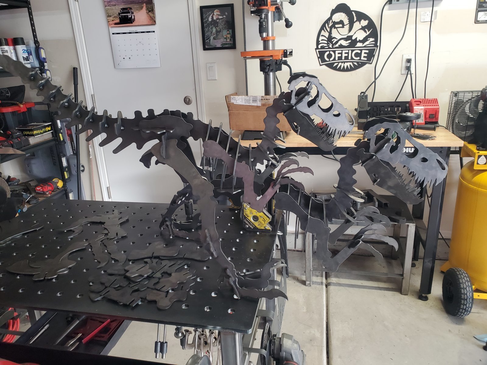

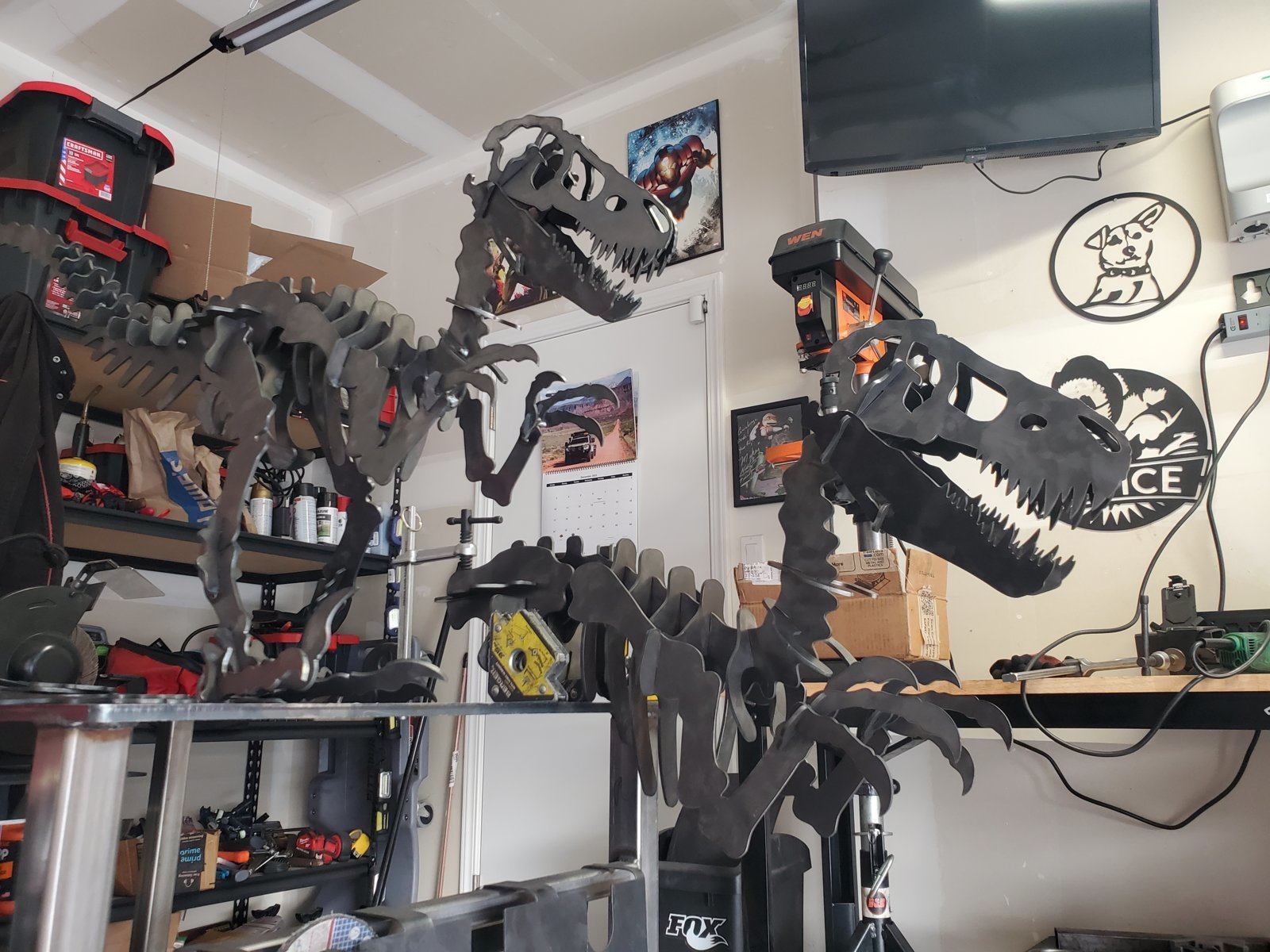

    Just to give you a visual on the size of this thing
    Once I cut the remaining two toes and spine/tail, I'll be able to weld the rest of it up

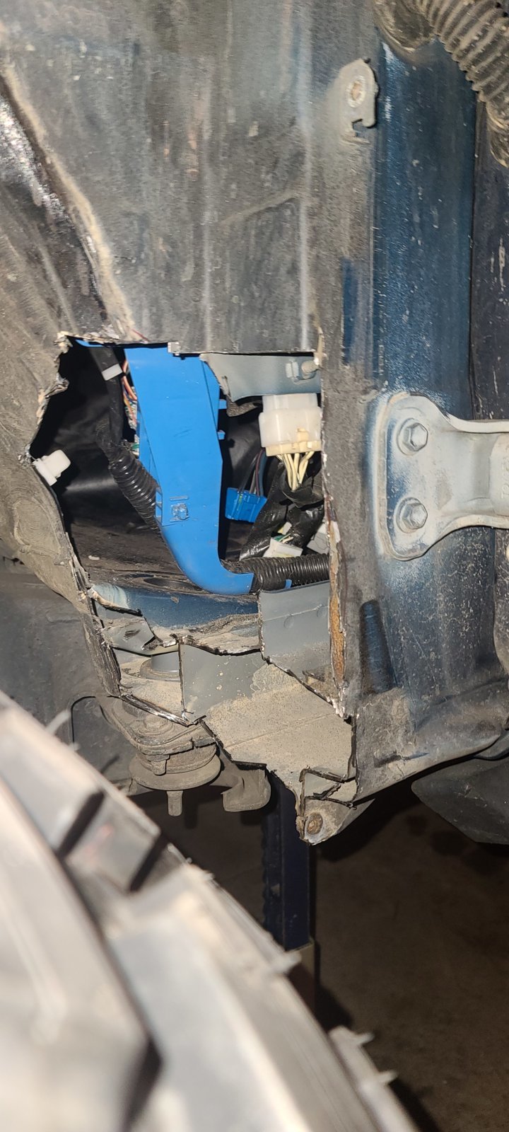

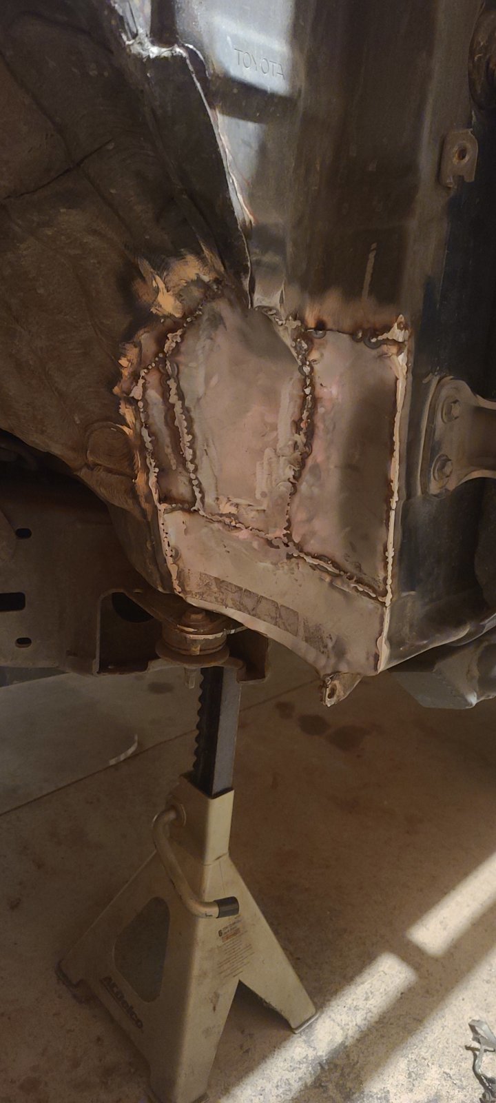

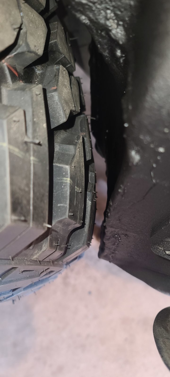

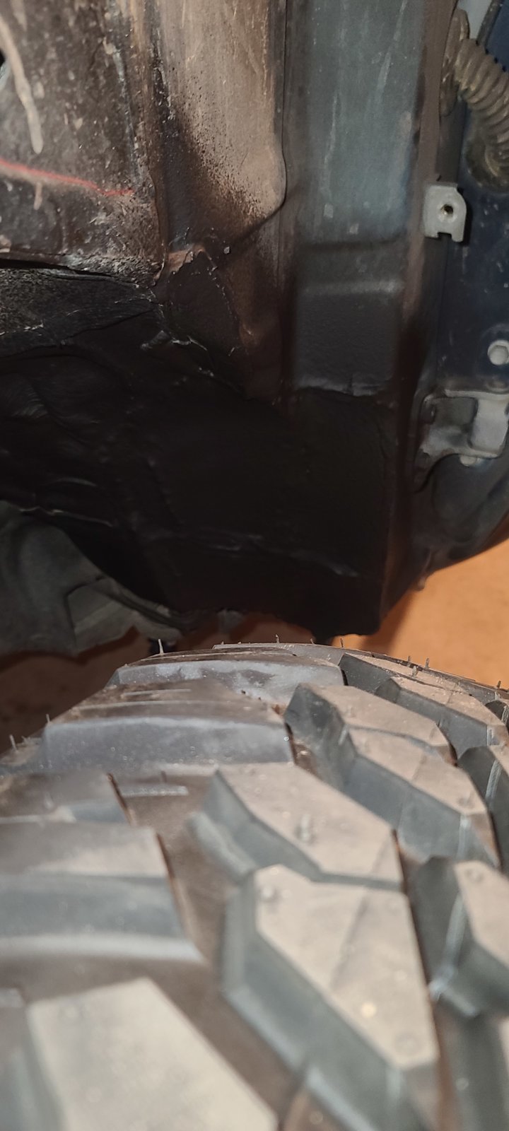

    Go easy on me, never welded anything this thin before. Tubbed the truck for 37's over the past few weekends. Used 20 gague as that's what seemed pliable yet still easy enough to stitch weld without blowing holes in it. Had some blow through but was able to get it all together eventually once I was able to get the welder a little more dialed

  11. Dec 30, 2023 at 3:09 PM
    soundman98
    soundman98 Well-Known Member
    May 31, 2021
    #367288
    6,357
    NW Indiana
    '18 Taco Sport, '14 Ranger
    looks good!
    never forget the old GM method. if everything else fails, Seam Sealer doesn't!

    Thanks! I killed the lights in the garage and threw my shop light in the truck. Didn't see any light shining through anywhere but still slapped on some seam sealer over my joints for safe measure as well as some rubberized paint lol.

    in all seriousness, as i learned myself with 0.030 flux core wire and a spare trunk lid that now has a rather large welding hole blown through it(i was trying to plug some holes no longer needed), the right way to do thin metal is to use a TIG welder.
    but barring buying more crap i'll never use, 0.024 welding wire and a gas MIG setup is the closest i'll ever come to a TIG. as long as the panel holds on, the seam sealer will do the rest, and it'll still likely be better built than many domestic vehicles on the road!
