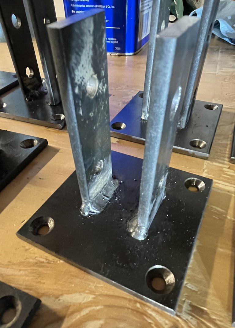

    I may be wrong about this and this is just a thought but what if you made the mounting plate with a square tubing to fit inside the railing say 7-8'' tall?
    The weight of the railing would just hold it in place. Usually walking up the stairs the pulling force is directed to the side and not up. As long as its a tight fit I think it would move, and when you need to remove it just pull the railing up 8'' and pop it off. worst case you could add a flat or a nice finish screw in one of the post to insure it from coming up.

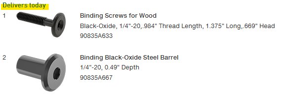

    An exposed screw head is one thing, but I rather not have a nut exposed when it's just as easy to conceal it.
    I had a difficult time trying to come with an easy way to achieve this.

    Metal suppliers should have square tubing that would fit right in to the size you need and if you still have some play, add a few tack welds and grind down to make it tighter.
    Or you could weld the inside tubes at a slight angle to create tension.

    I love McMaster-Carr:

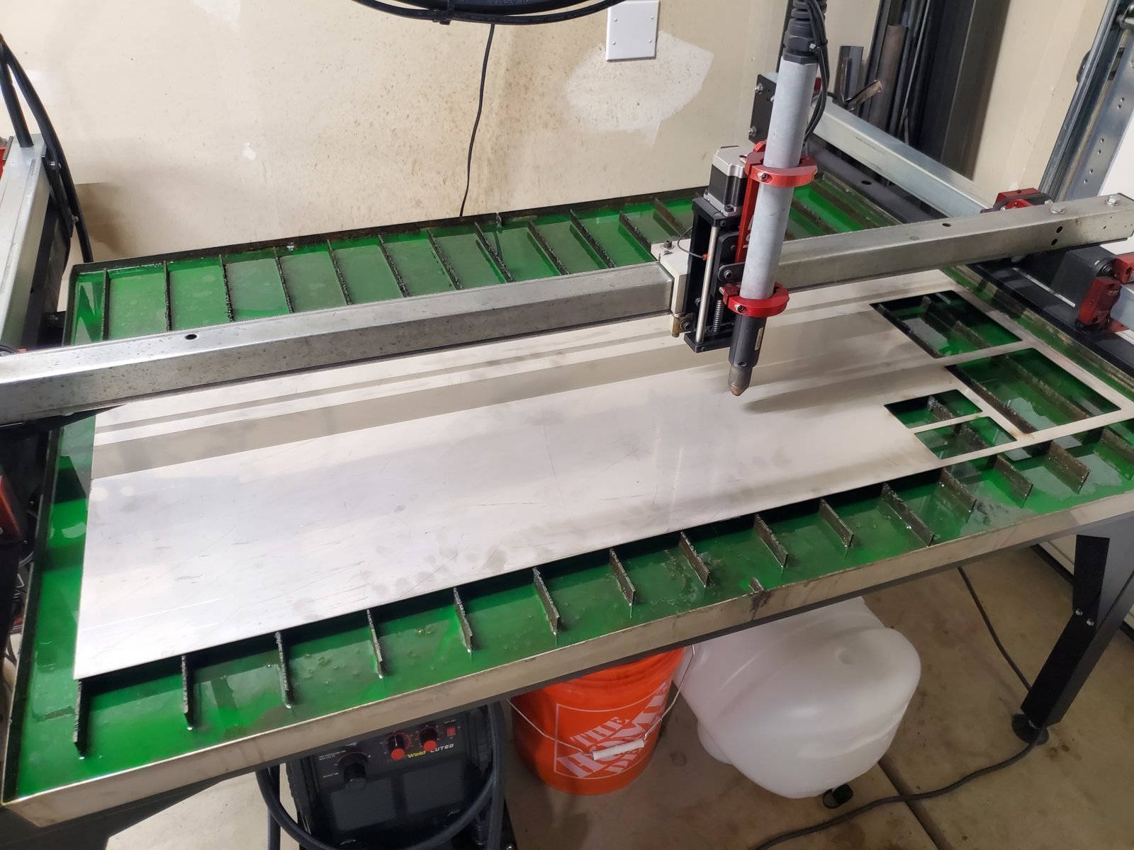

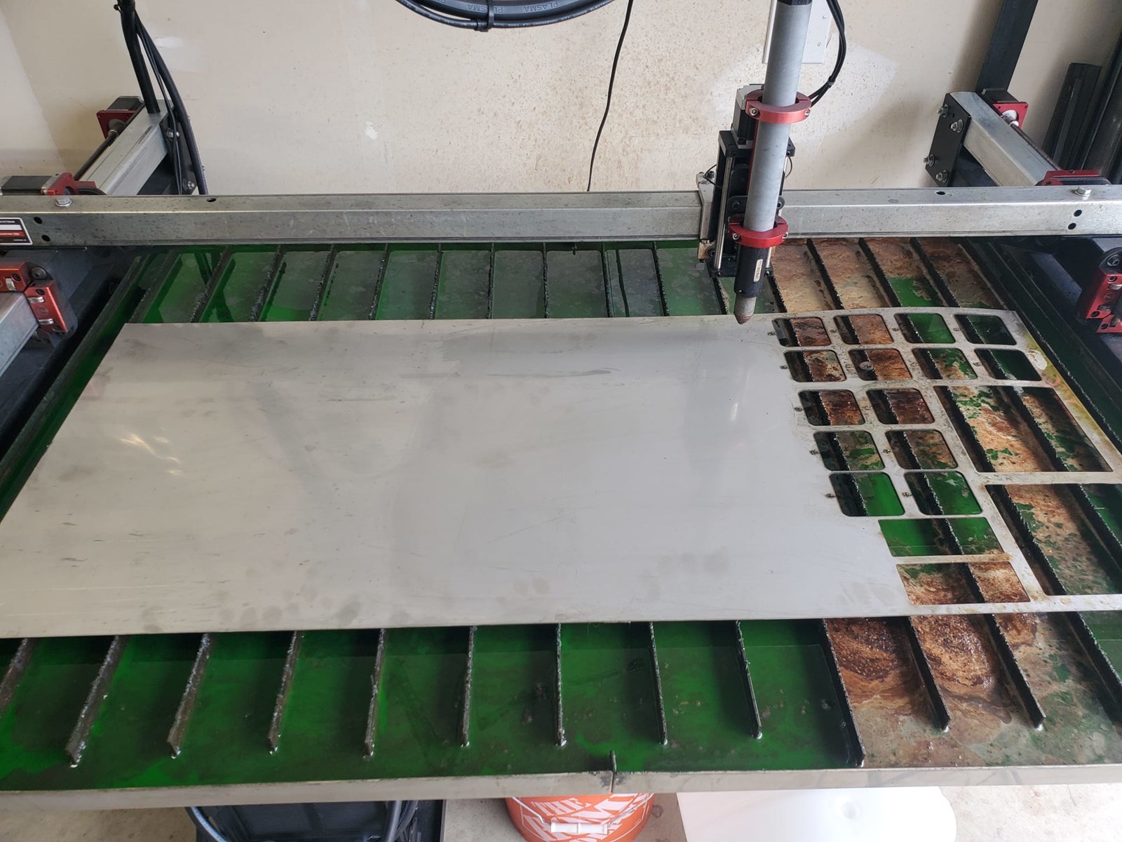

    Don't know what to cut, but picked up some stainless just for fun
    Here's some 16 gauge
    Got some 12 gauge as well

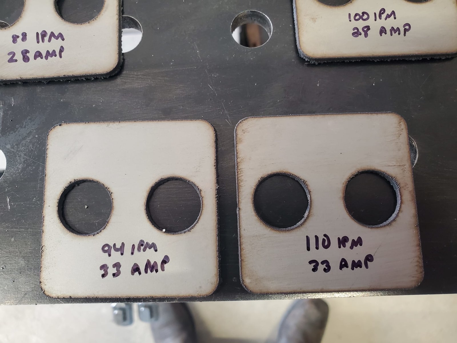

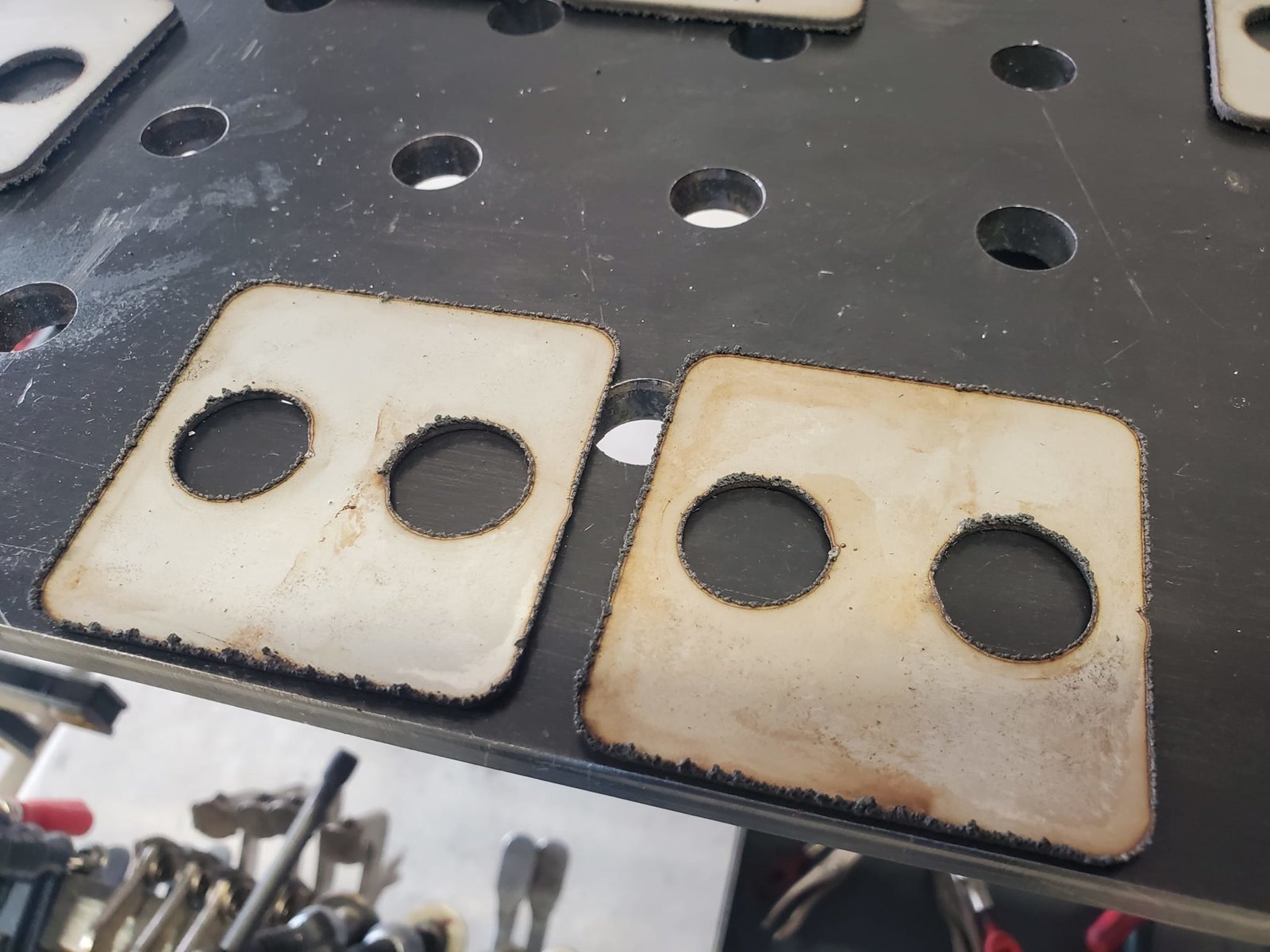

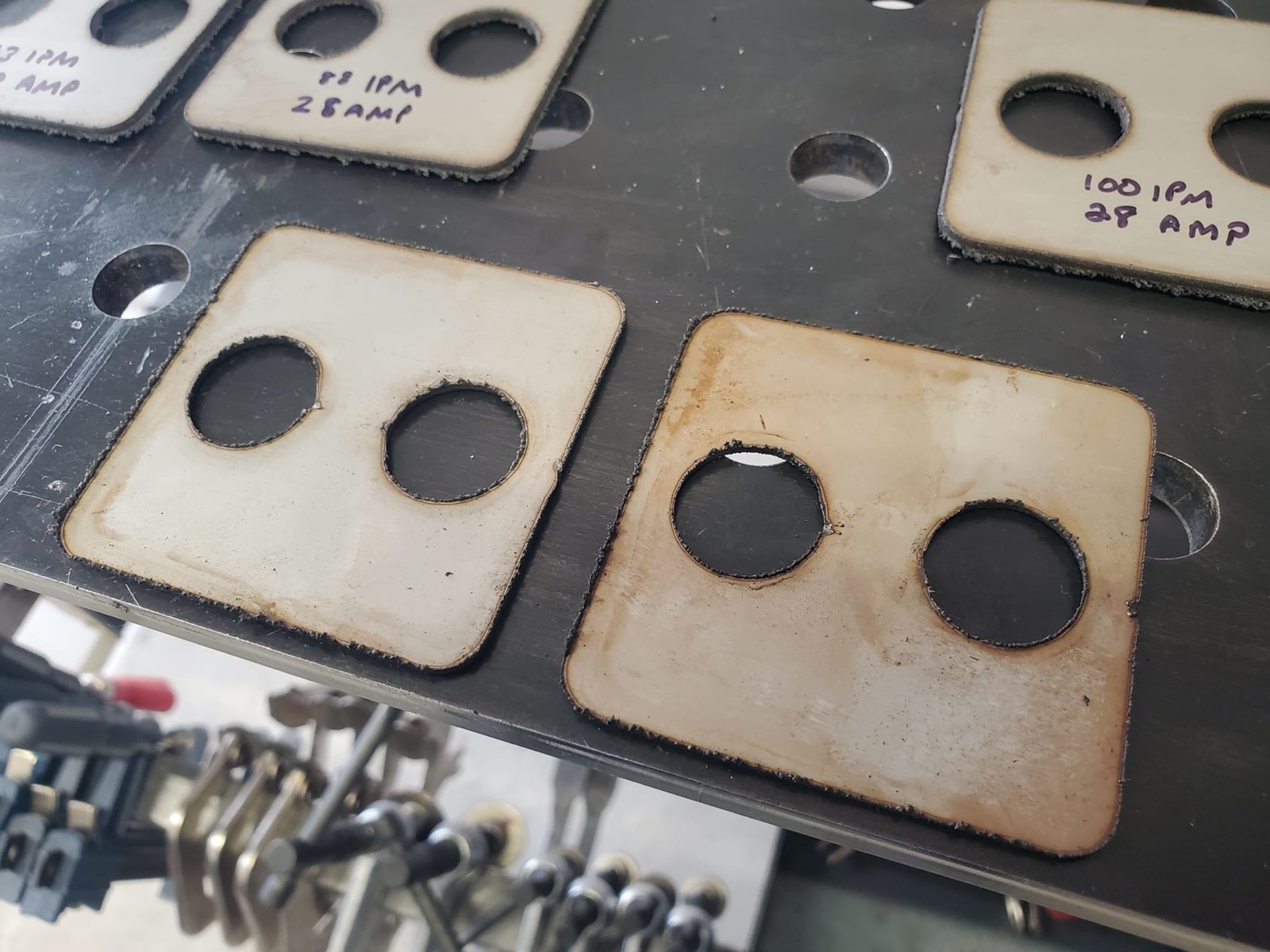

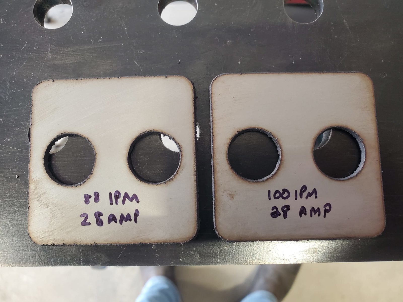

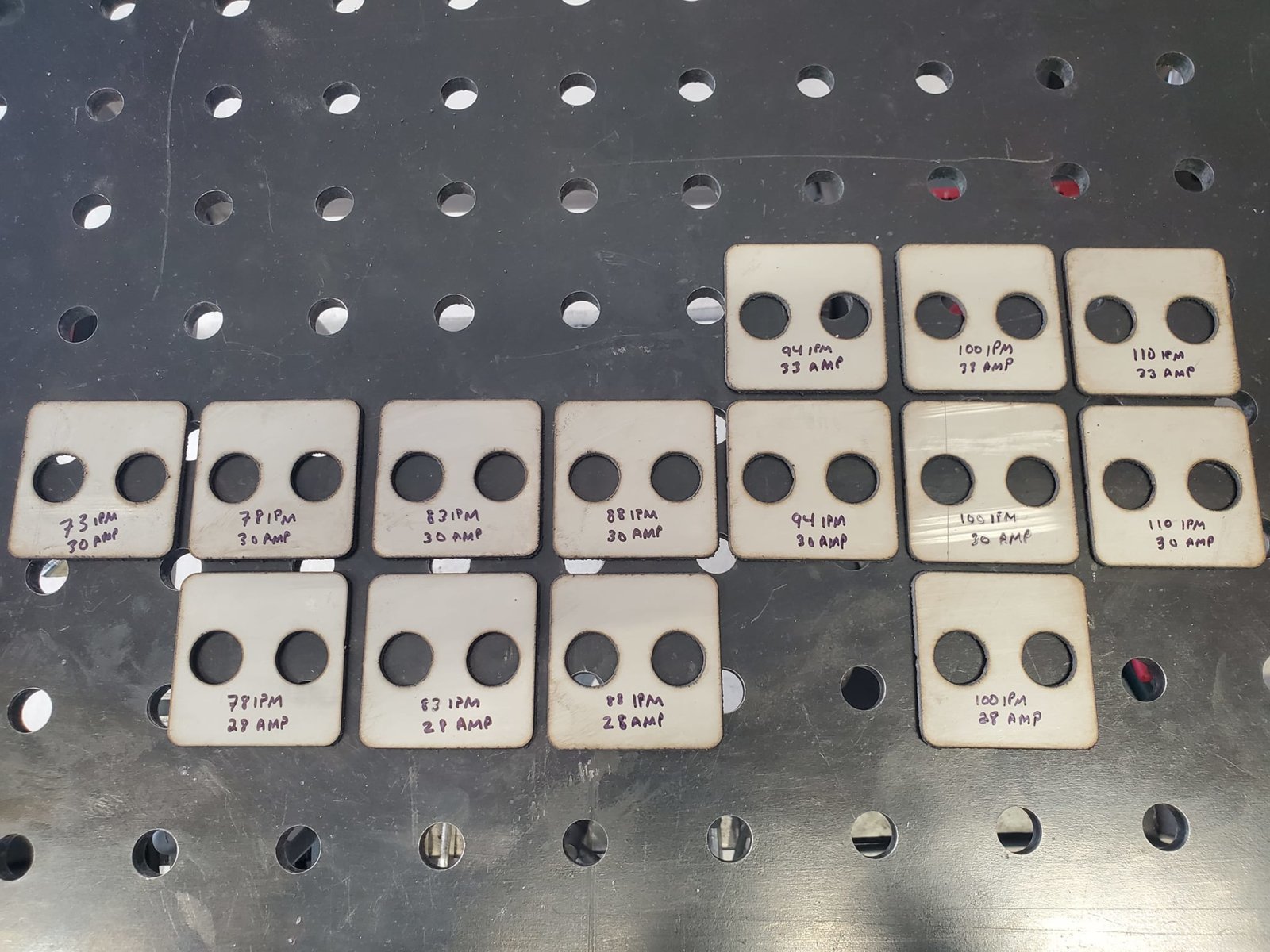

    So in talking to my friend today, he tells me on 16 gauge and thinner stainless steel, dross is damn near impossible to avoid
    Cut some 16 gauge test pieces
    You'll see I played with various settings; the constant here is a 45 amp (1.0mm kerf width) tip, 65psi, and 0.6 pierce delay
    The two worst
    Followed by the two best
    Bivouac, FastEddy59 and Drainbung like this.

    '13 Barc. Red Tacoma SR5 4X4
    Looks like you got ‘er aced. :thumbsup: No holier than thou attitude either. :)

    :rofl:
    Needs work; next testing will be more amps and more speed...but only when I've got time to kill.
    Right now I'm feeling lazy :anonymous:

    I know there is a fix for that but going back maybe 8 years one of those conversations With the Hypertherm Rep and the end user thinking it was a Plasma Machine issue .
    One of those things that in your case might not be practical . I am thinking shielding Gas instead of shop air. Big difference when your running production parts the added clean up time gets expensive.

    Shielding gas + a nice plasma cutter
    But, this is a hobby and stainless steel is not something I use so........I'll accept any donations if you wish to see my equipment upgraded :D

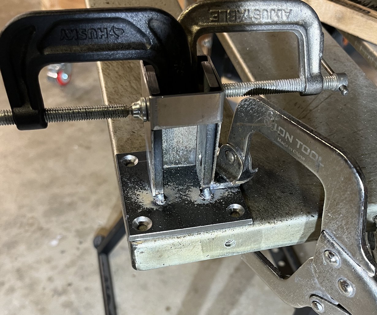

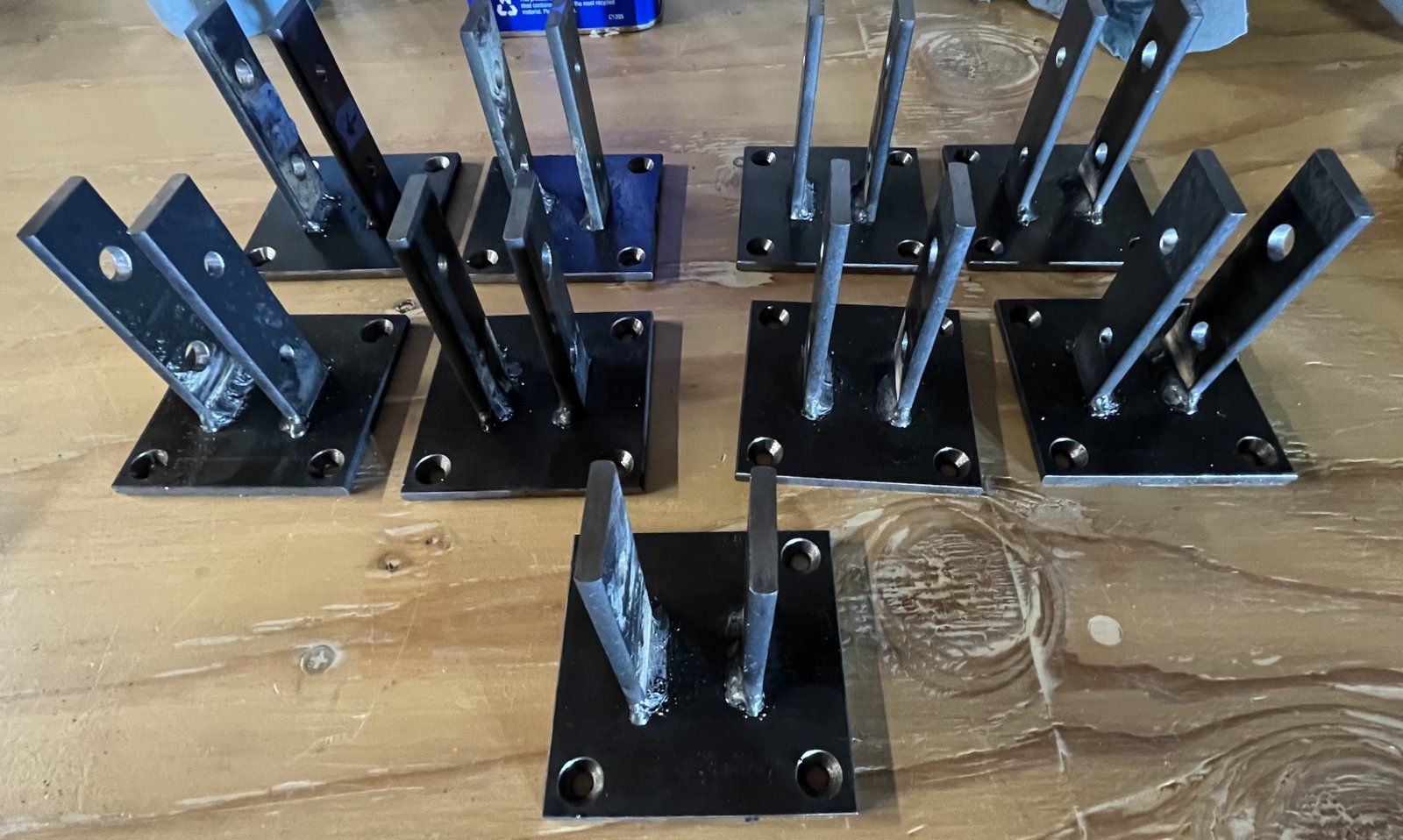

    Jig worked perfectly- was able to clamp align and clamp the mount tabs into the jig, align and clamp the jig to the base plate, tack the front of the tabs to the base plate, remove the jigs, tack the back, adjust the tabs if they pulled in a bit, and send it on the inner finish welds.

    Good stuff!
    Bevel the flat stock next time
