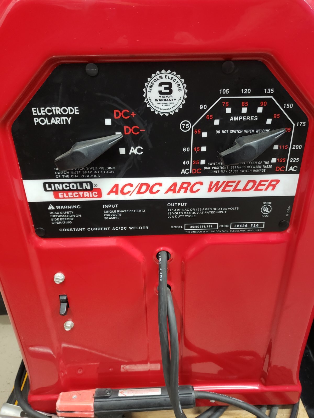

    I haven't welded in probably 15 years but have a 220V Lincoln AC/DC 225/125 arc welder that I previously used for some thicker steel projects (probably 1/4"). I now need to weld some exhaust pipe and stamped steel control arms and I'm concerned about blowing through. What settings would you recommend and what size rods? Also does the anti-splatter spray work? I was thinking of selling the Lincoln and getting a 120V flux core welder instead but maybe the arc welder will work. What do you think? Thanks.

    Sorry, I should have clarified this is a electrode stick welder.

    Not sure what all else you're welding but thin stuff I love using 6013 when I had to run SMAW

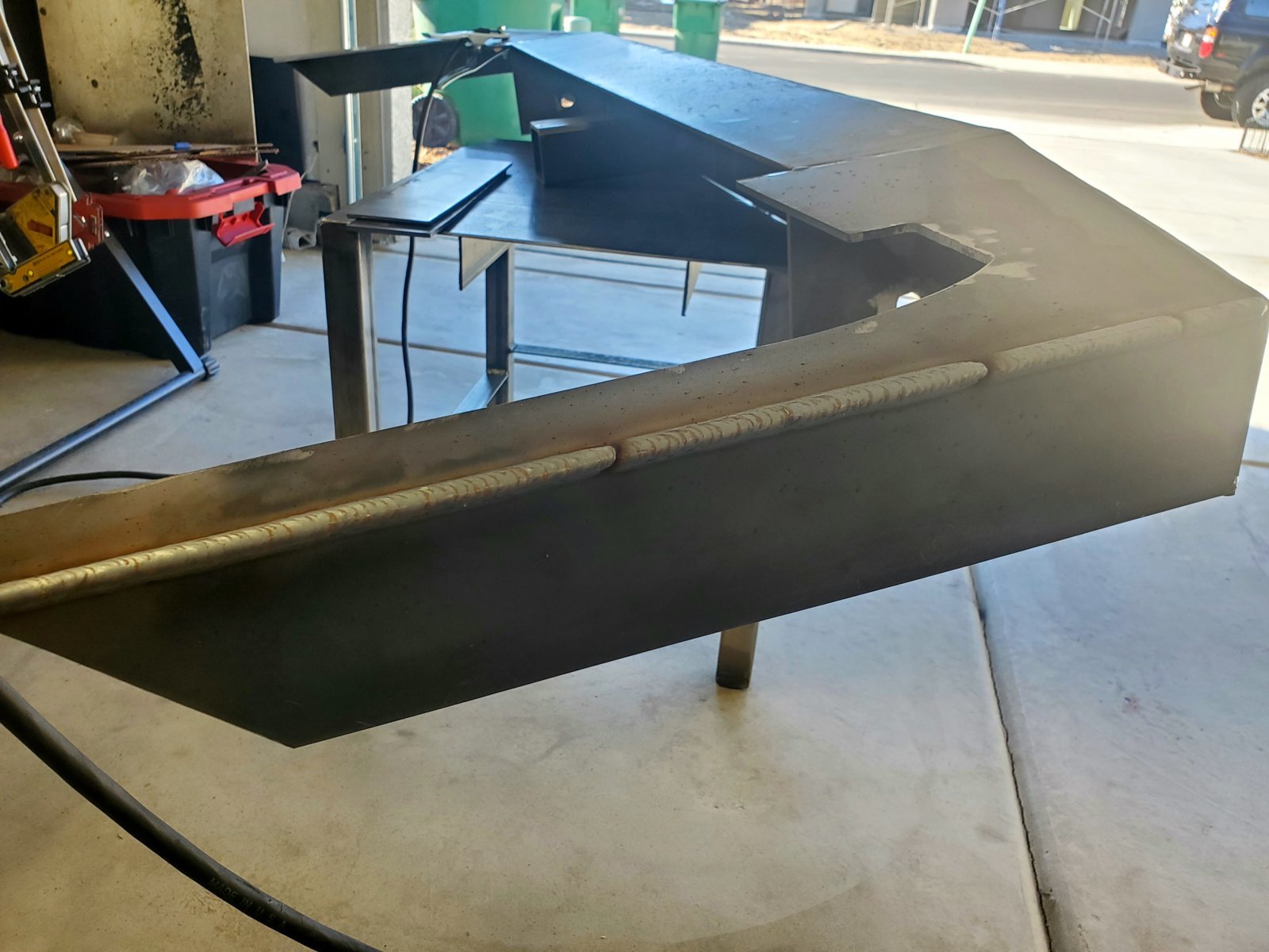

    Reserected from the dead.
    I got to play around with little guy today. I'm impressed for ~$200 rig.
    Owner asked me to set it as he could not get it to weld.
    He had his polarity set for flux core.
    I just ball parked the settings. This was my 1st attempt. It looks good enough for me.PXL_20240123_161213290.jpg PXL_20240123_171116212.jpg

    I would practice with 6012 or 6013 might take some time to get your hand back.
    Stop and start for a technique. Skip all around the pipe if possible slip one pipe in the other
    Control the heat by any means.
    Good luck

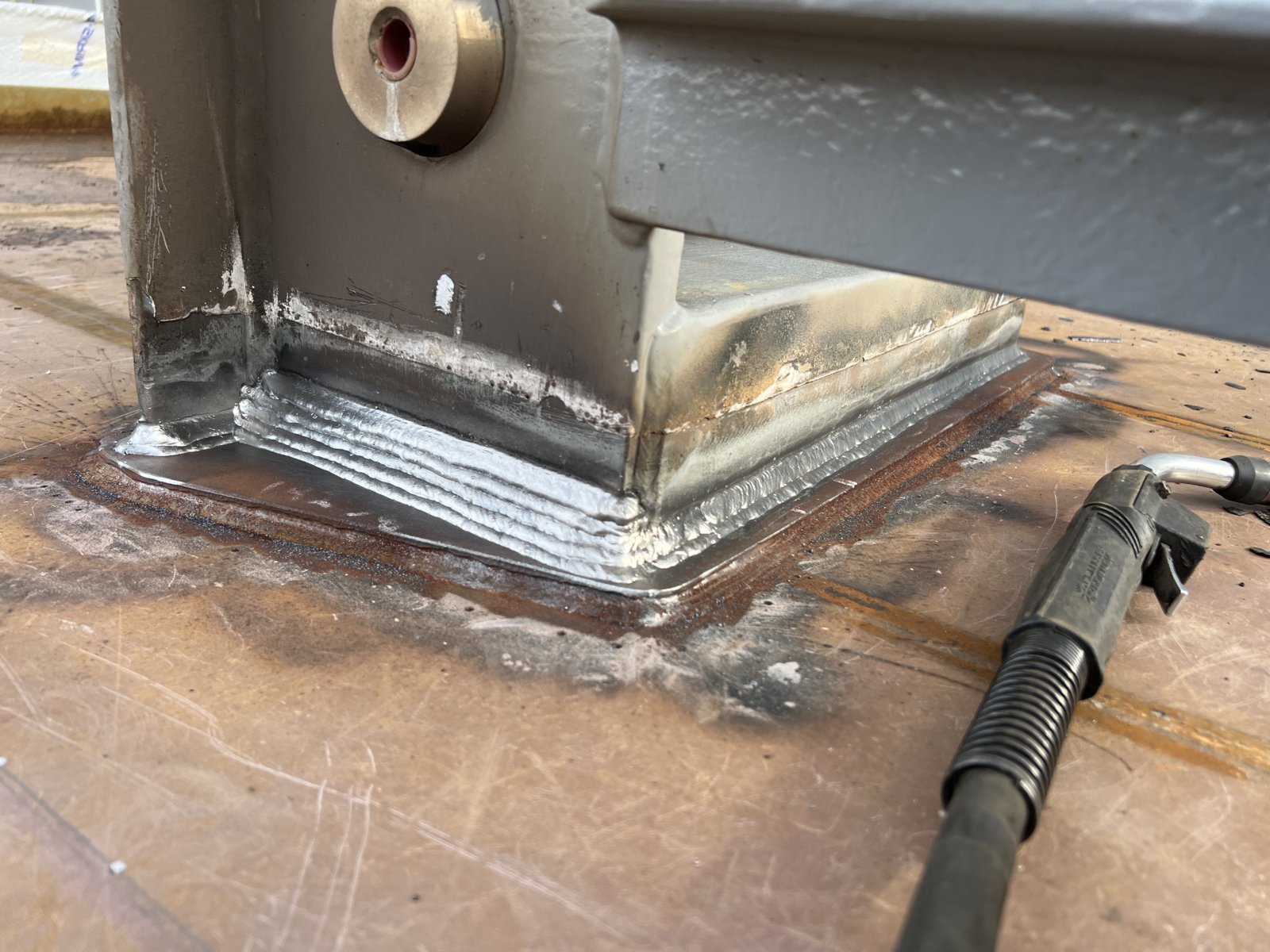

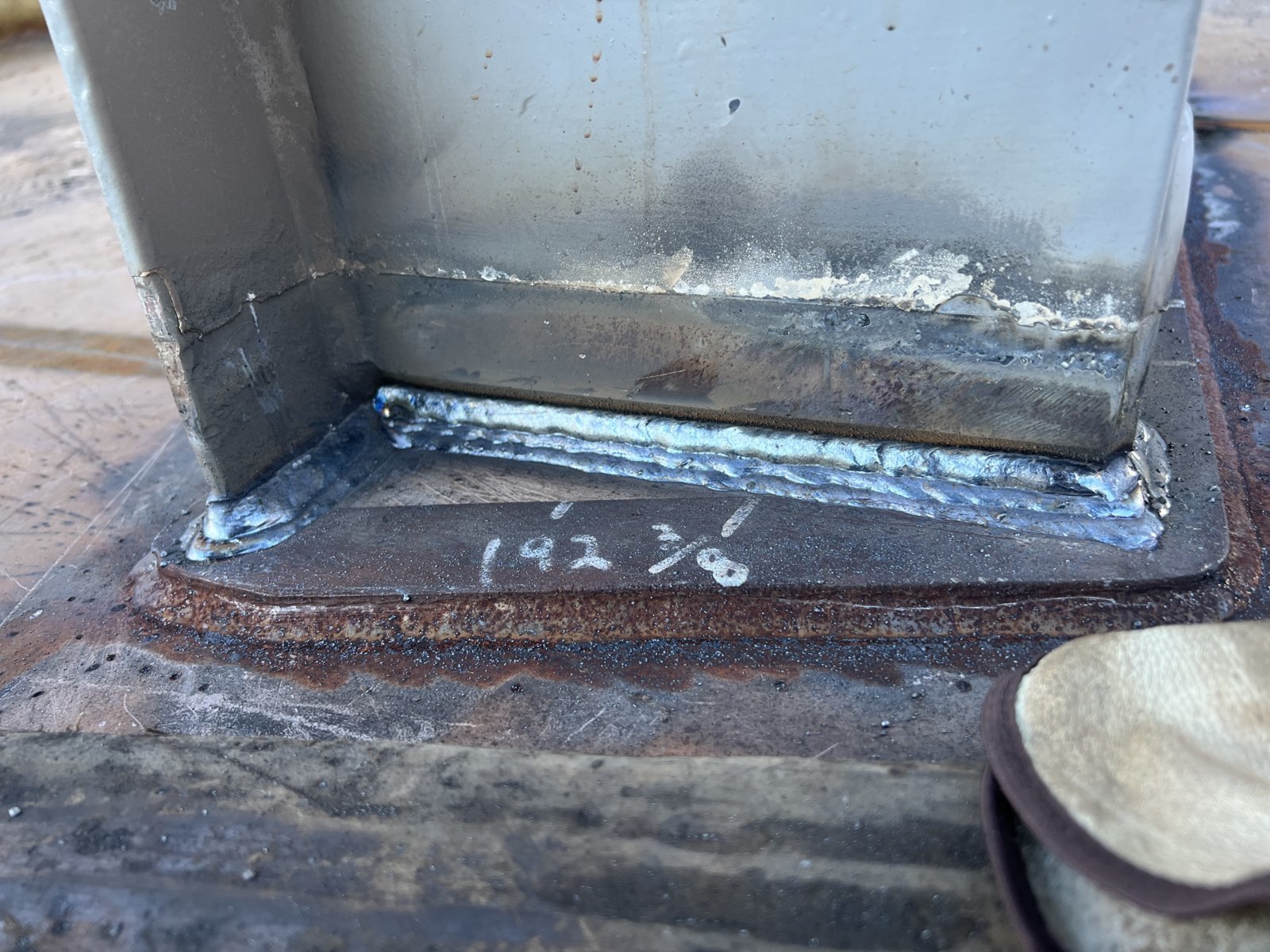

    IMG_6291.jpg IMG_6307.jpg1” single bevel grove fillet weld today at work.

    What size 6013 would work well on exhaust pipe? I see it is available in 1/16″, 5/64″, 3/32″ & larger diameters. I'm assuming I would select DC- but what amperage would you recommend? Luckily the exhaust is slip fit so that will make it easier and I definitely plan on getting some scrap pipe to practice on. 20 years ago I could lay some clean beads but a lot changes in 20 years :tumbleweed:
    Searching further online, it seems like 3/32" with about 70-80 amps DC- is preferred.

    Your going need to experiment to find your best current .
    The output could easily be + or - minus 10 amps so your going to find the sweet spot.
    I am hoping you are able to remove the pipe if not your going to need to practice out of position .
    Lets hope your machine still works Transformers don`t like being in the damp. being your in Az that should not be a problem.
