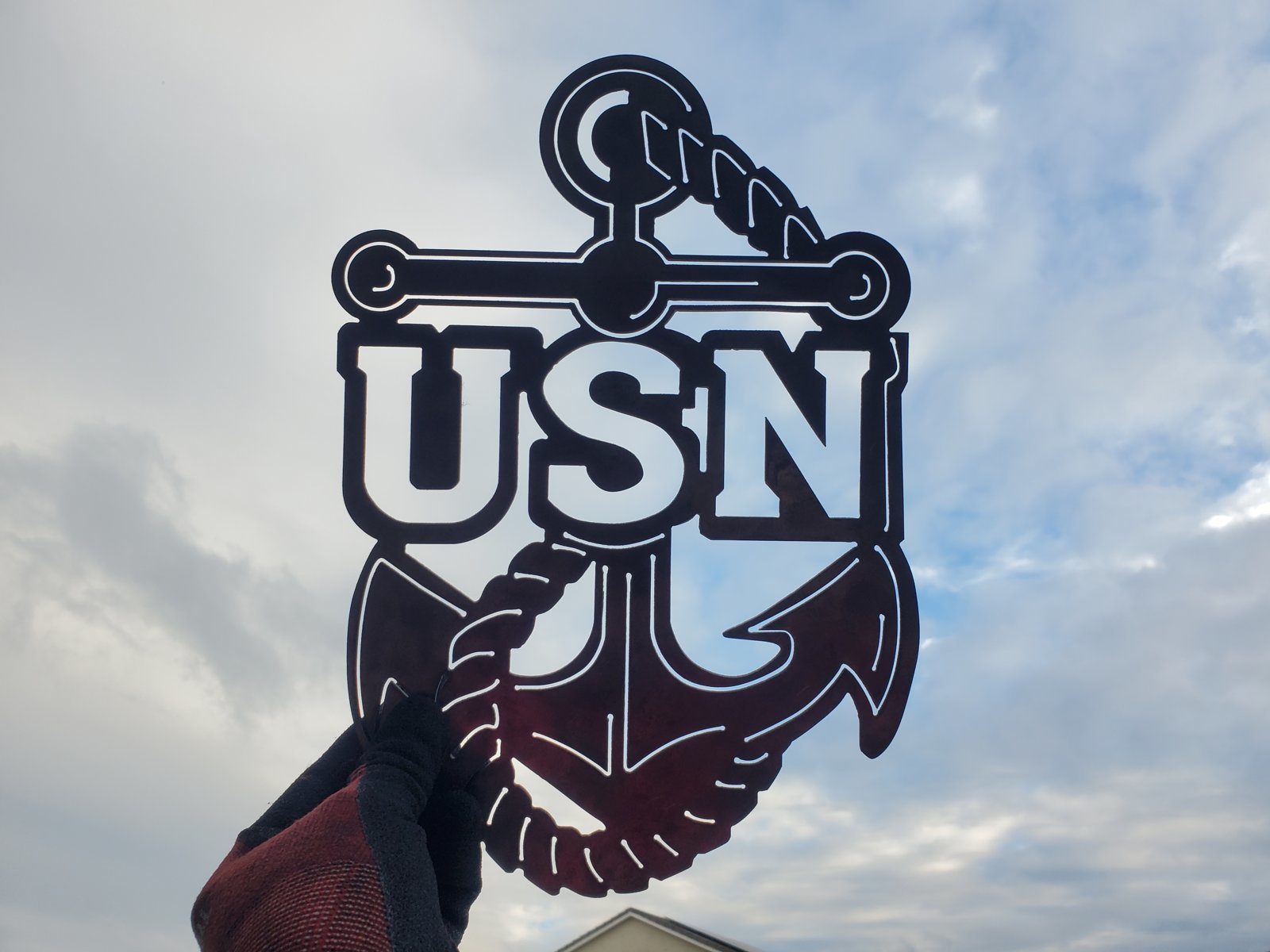

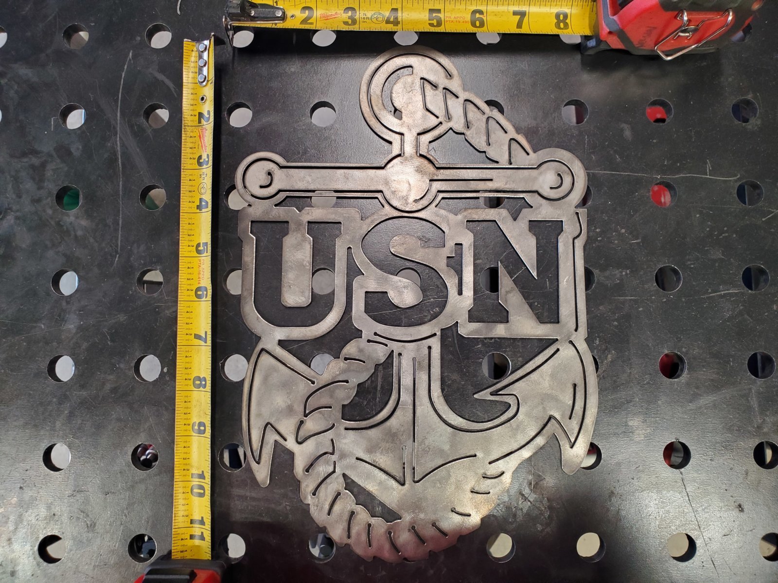

    This was cool; drew it earlier today and cut it out just now
    Using just your kerf width is perfect in getting details on small pieces like these (8.25" x 11.5")

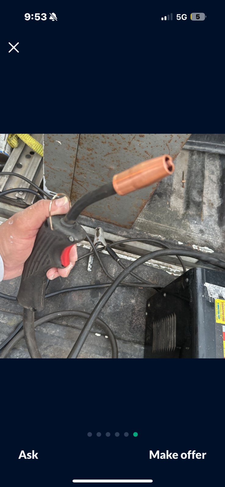

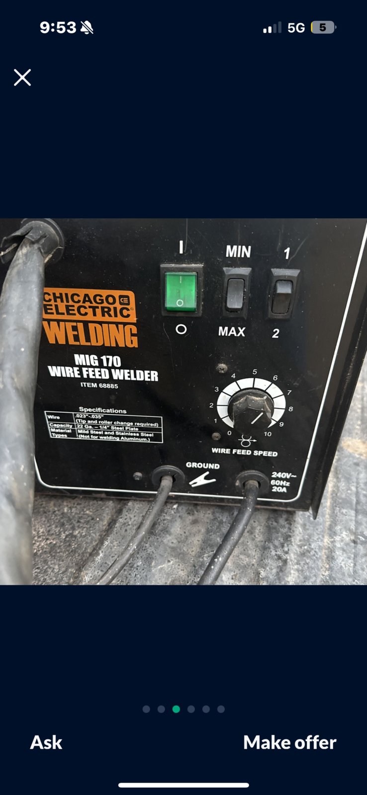

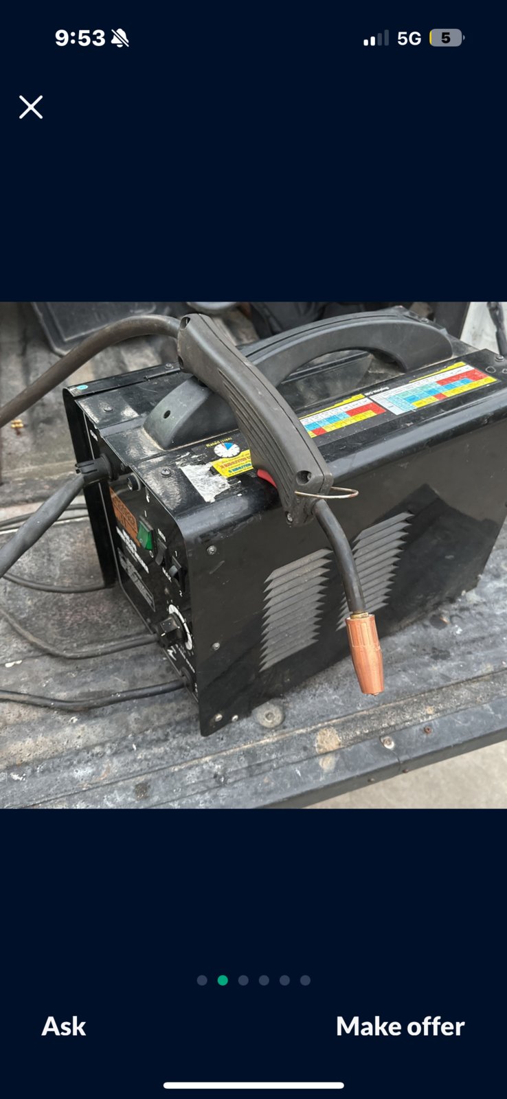

    i see this near me for 160. good deal for entry level stuff? i mentioned above i’ll be doing the archive shock relo and also wanna learn to weld

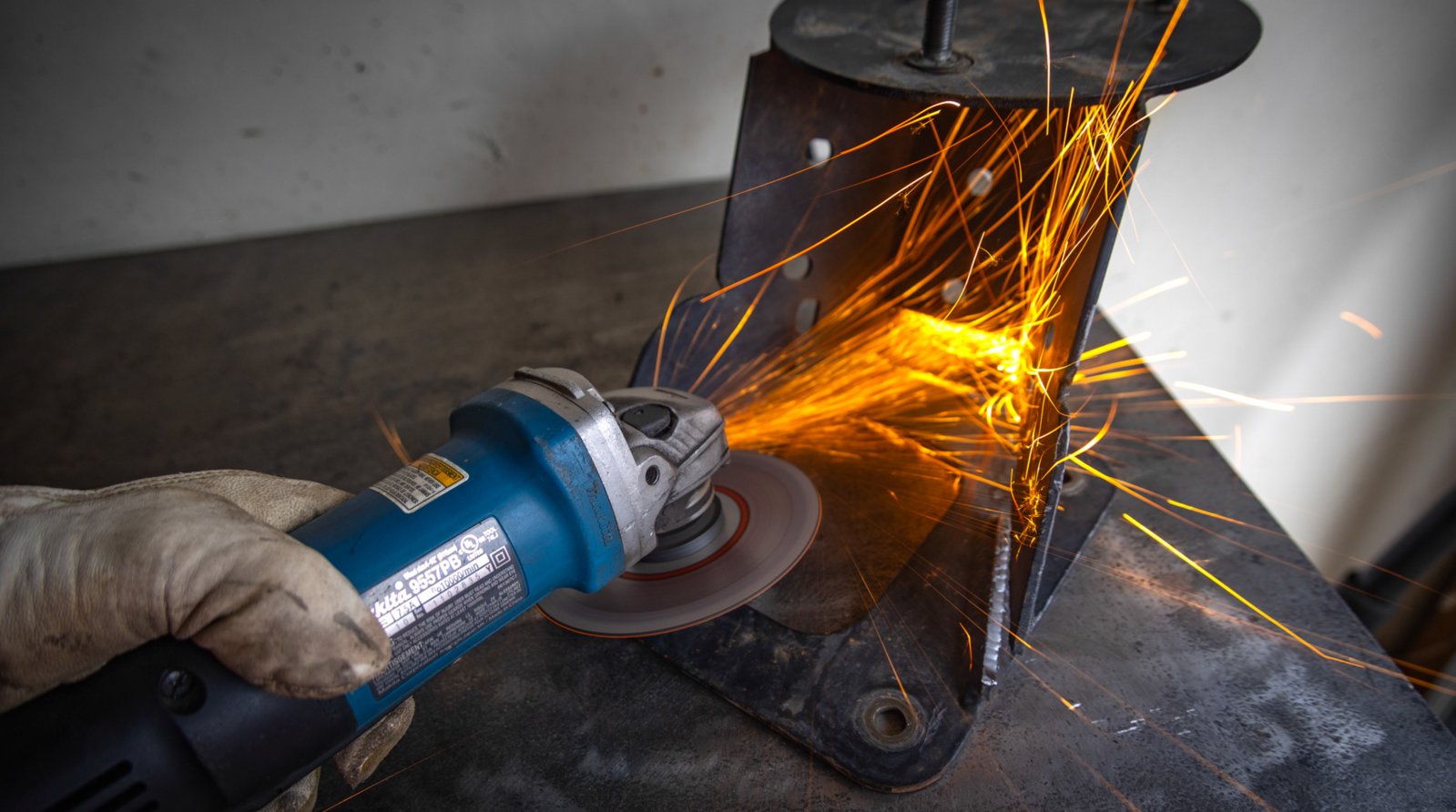

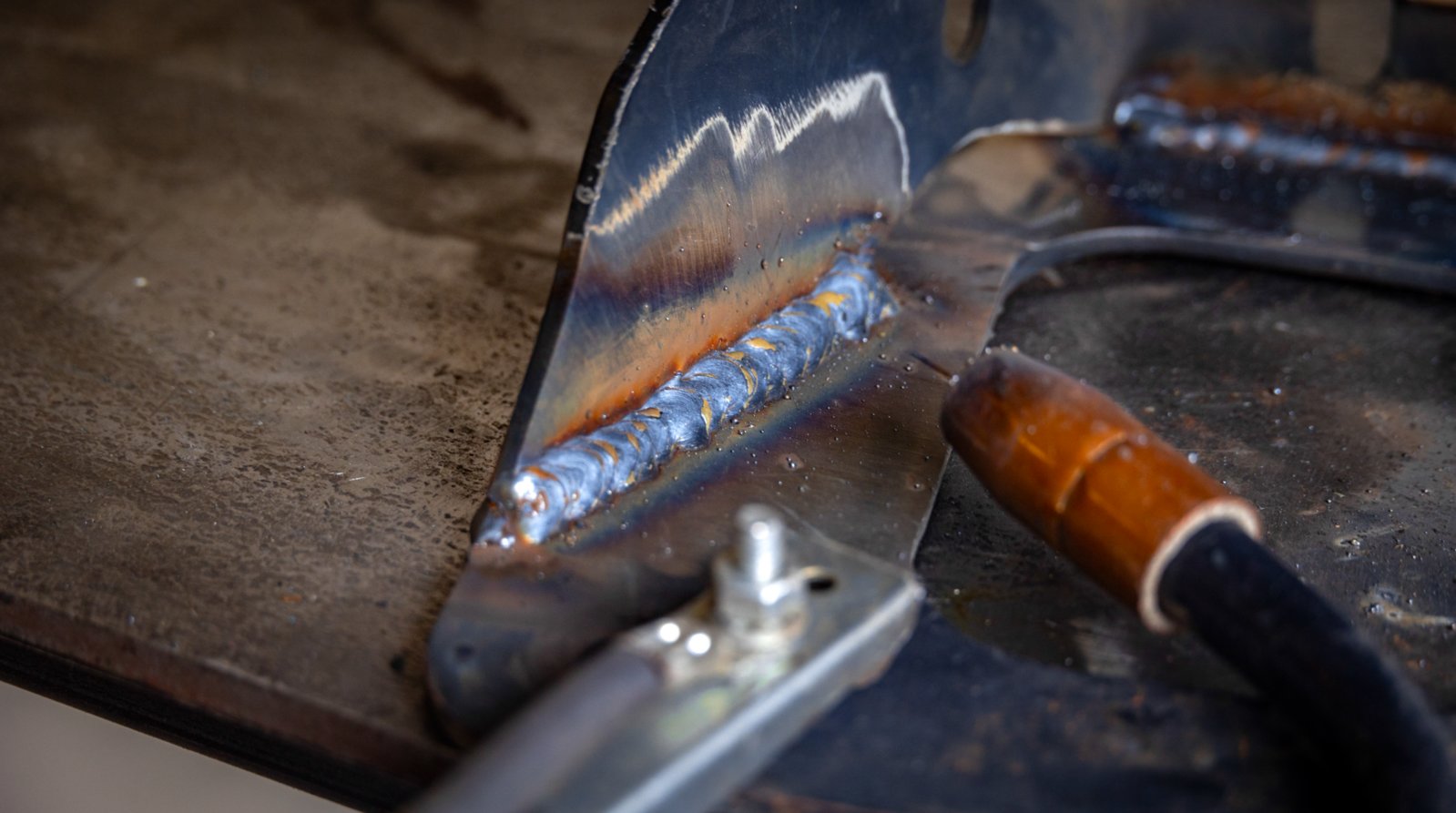

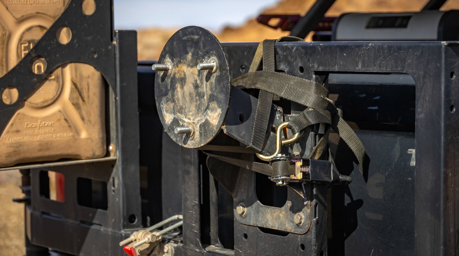

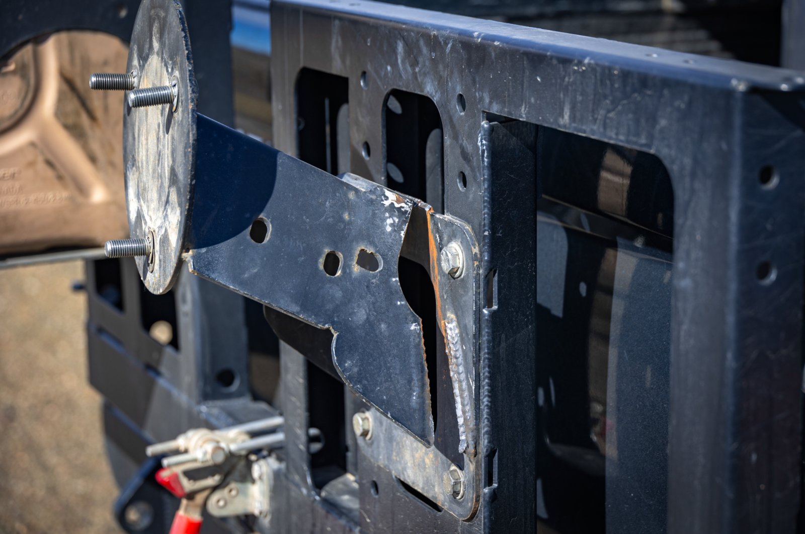

    So, on my last trip to the Mojave, my tire started bouncing around on the rear of the truck. Thought the lug nuts were loose, but they weren't.
    First class trail band-aid ensued...
    And, I finally got around to cutting it off, cleaning it up, and gluing it back together today. Man, I haven't welded in a while and it shows. I'm even worse than I used to be.

    Just get the MIG180 mentioned
    It will last you for a long time

    What are you asking with these pics?
    There is really no good way to say it. Those are some of the worse welders sold.
    It is very difficult to make these units produce decent welds.
    I tried to make these things work, but they are just horrible for anything more than just doing tack welds.
    Those welders have turned off more people to welding just because a person could never lay decent welds.
    Please keep hunting.
