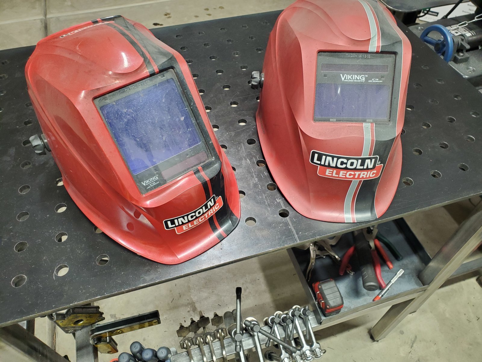

    cynicalrider
    cynicalrider #NFG
    Jul 25, 2012
    #83399
    17,160
    Jersey
    01 SR5 TRD 4x4, '23 Bronco Wildtrak, 2017 HSQV FE350
    Drop bracket lift and booger welds
    Curious on what you feel is the best hood? I feel like I need an upgrade, I can't see shit unless I place light directly over whatever I am welding.
    Drainbung and TacoTuesday603 like this.

  15. Jan 25, 2024 at 11:36 AM
    Kwikvette
    Feb 27, 2019
    #284735
    81,756
    Fresno County
    4 run, 2 don't
    My personal favorite is a Lincoln 3350 which I use all the time.
    I only own the Lincoln 1740 as I was welding at my last shop for 10-12 hours a day and wanted something lighter, and expendable.
    My go to in the garage since retiring is still my 3350, but if I need to swap the lens (and I don't want to stop mid-way through a job) I just grab the 1740.
    I've used both for welding MIG, TIG, and SMAW, as well as doing some overhead.
    I went this route because they've been in the business for a long time, and have a reputation for being reliable.
    soundman98 and Drainbung like this.
