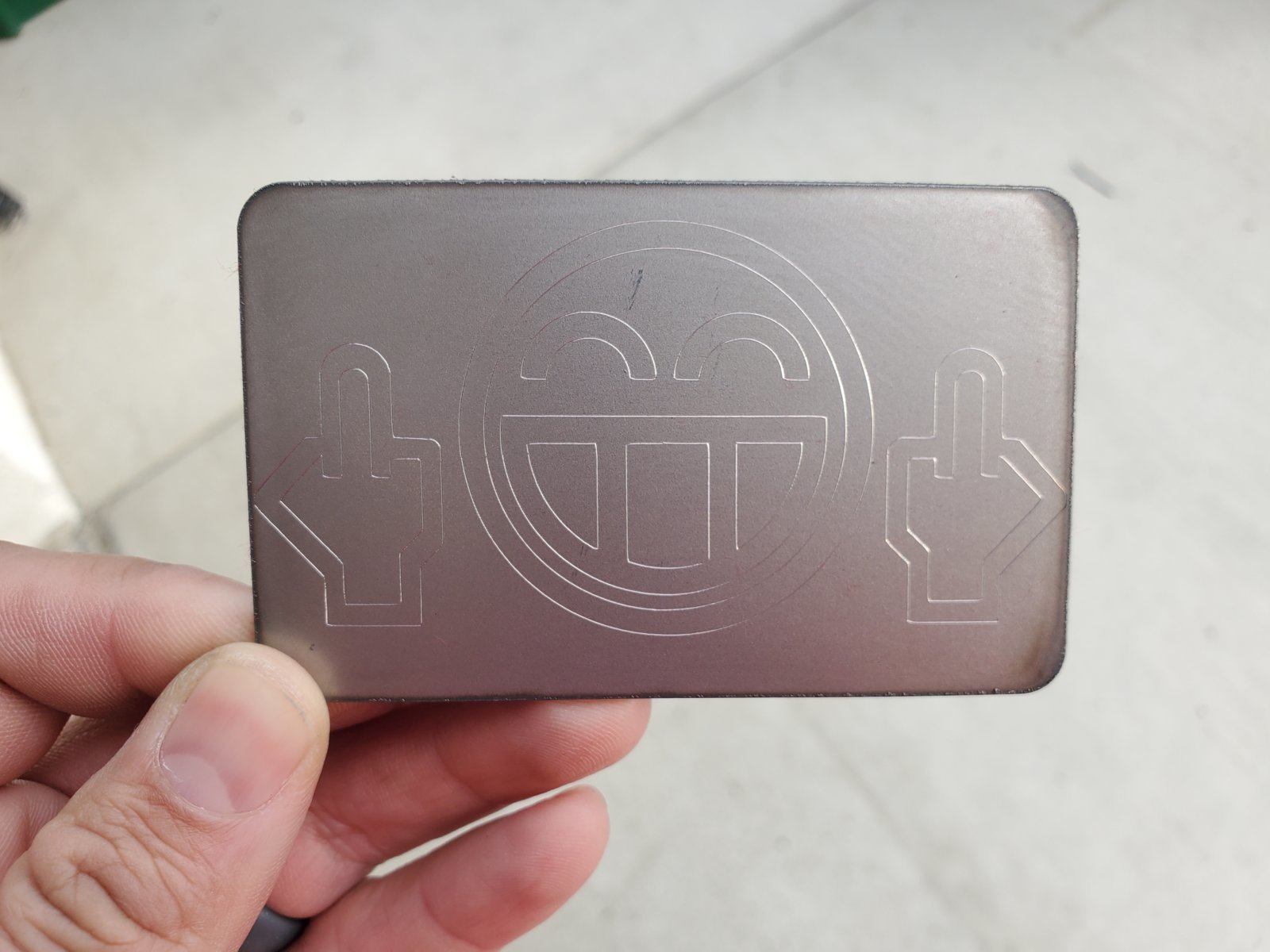

  16. Jan 27, 2024 at 2:20 PM
    Kwikvette
    Feb 27, 2019
    #284735
    81,638
    Fresno County
    4 run, 2 don't
    @Pyrotech
    I'll do some playing with in figuring stuff out before I give you (and anyone that watches this thread) detailed post on what I've learned.

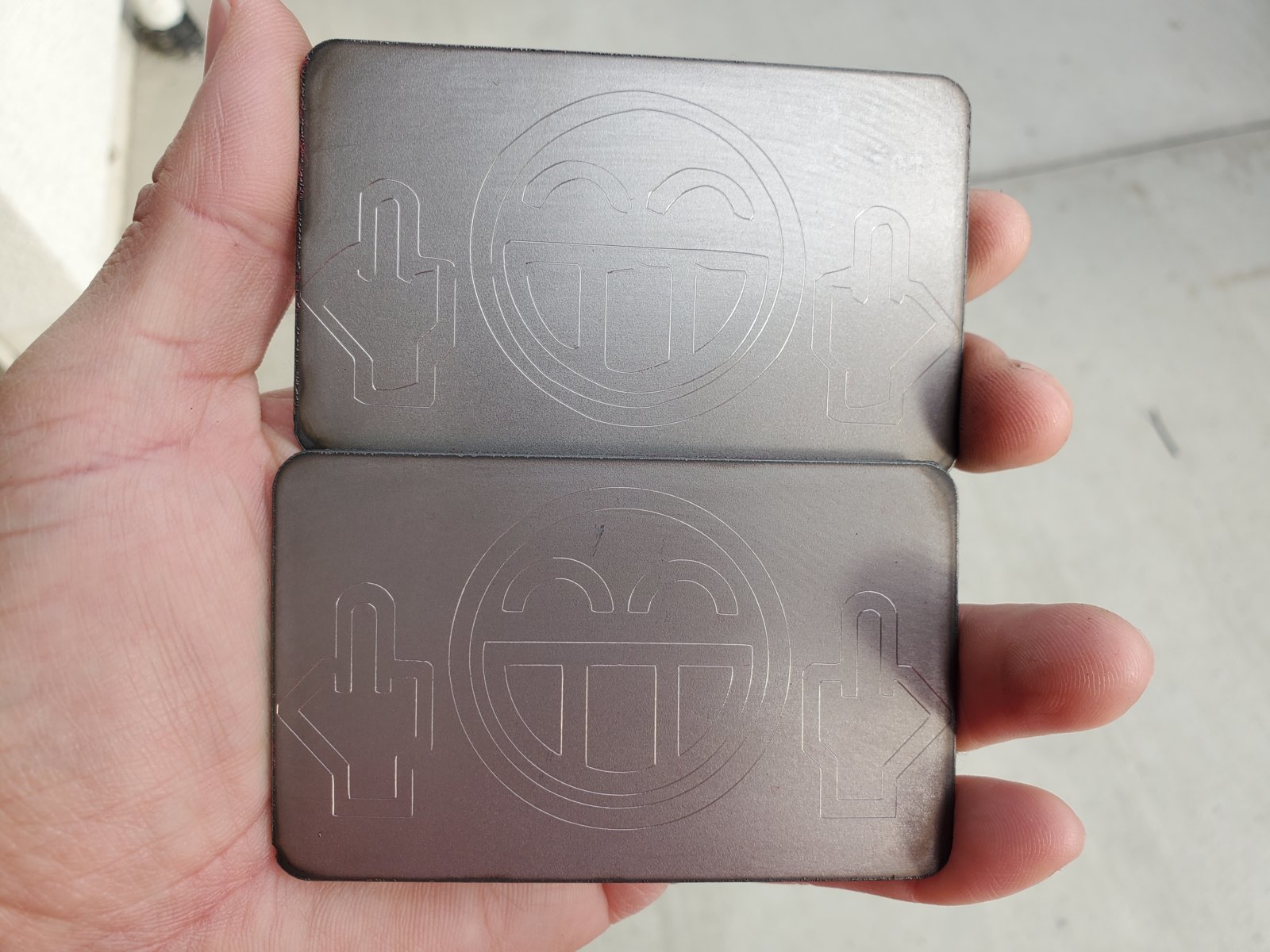

    I ran my first test piece as a "business card" application
    The experiment here was, something small with basic shapes but details that are close together
    This is as basic as it can get before I dive into hatch fill and all that
    I intend to learn how different tension affects the line work, not to mention speeds and how those two affect accuracy as well
    Drainbung, Pyrotech and koditten like this.

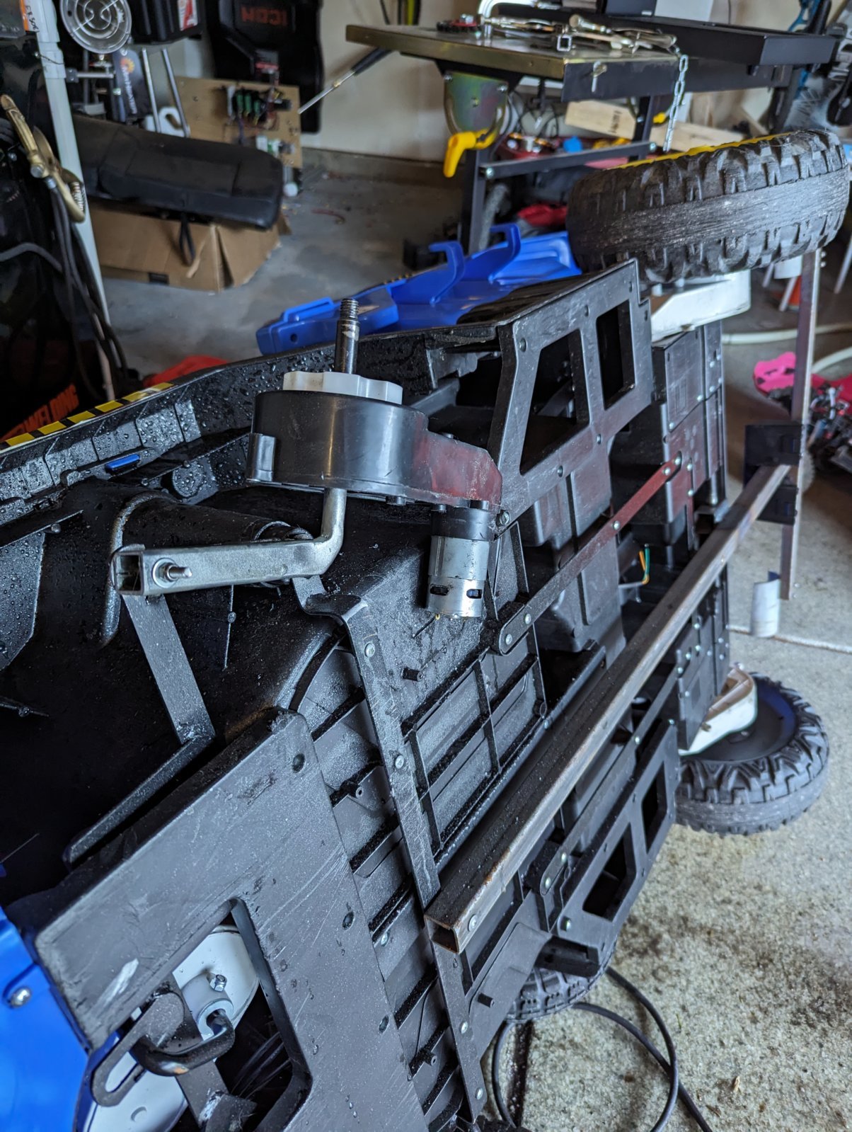

    A while back I posted a bike rack I made for a power wheels truck. You guys seemed to like it so here is the latest.
    He keeps bending the steering linkage so I'm reinforcing it with 14g 3/4" square. I'm also making it 4wd.

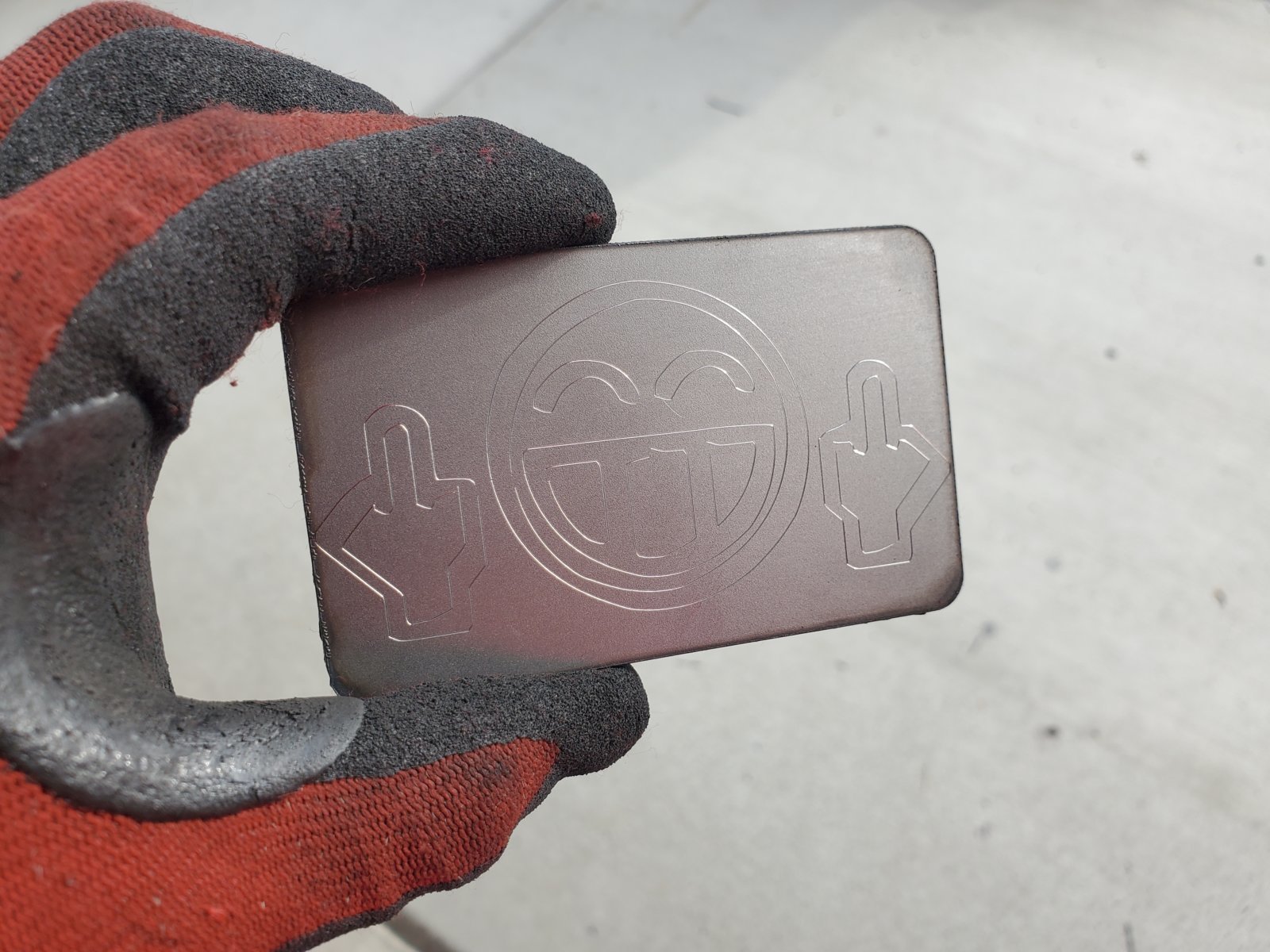

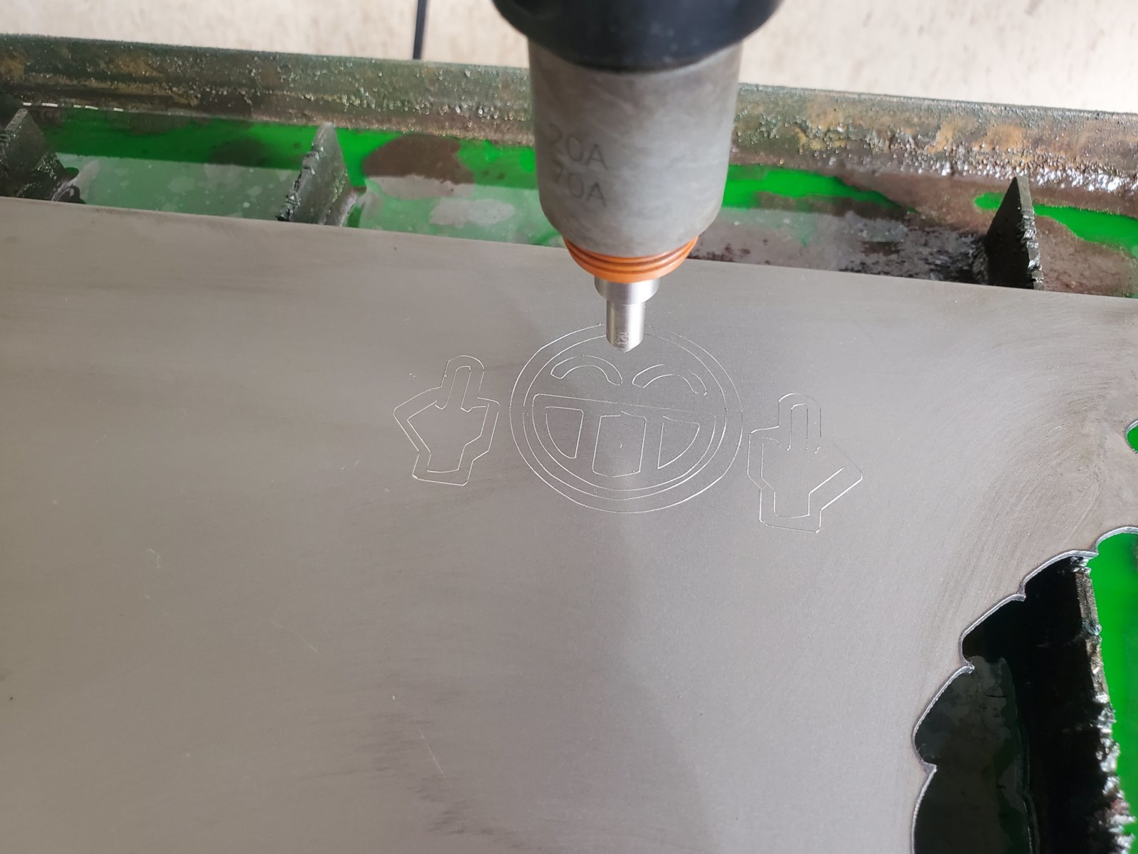

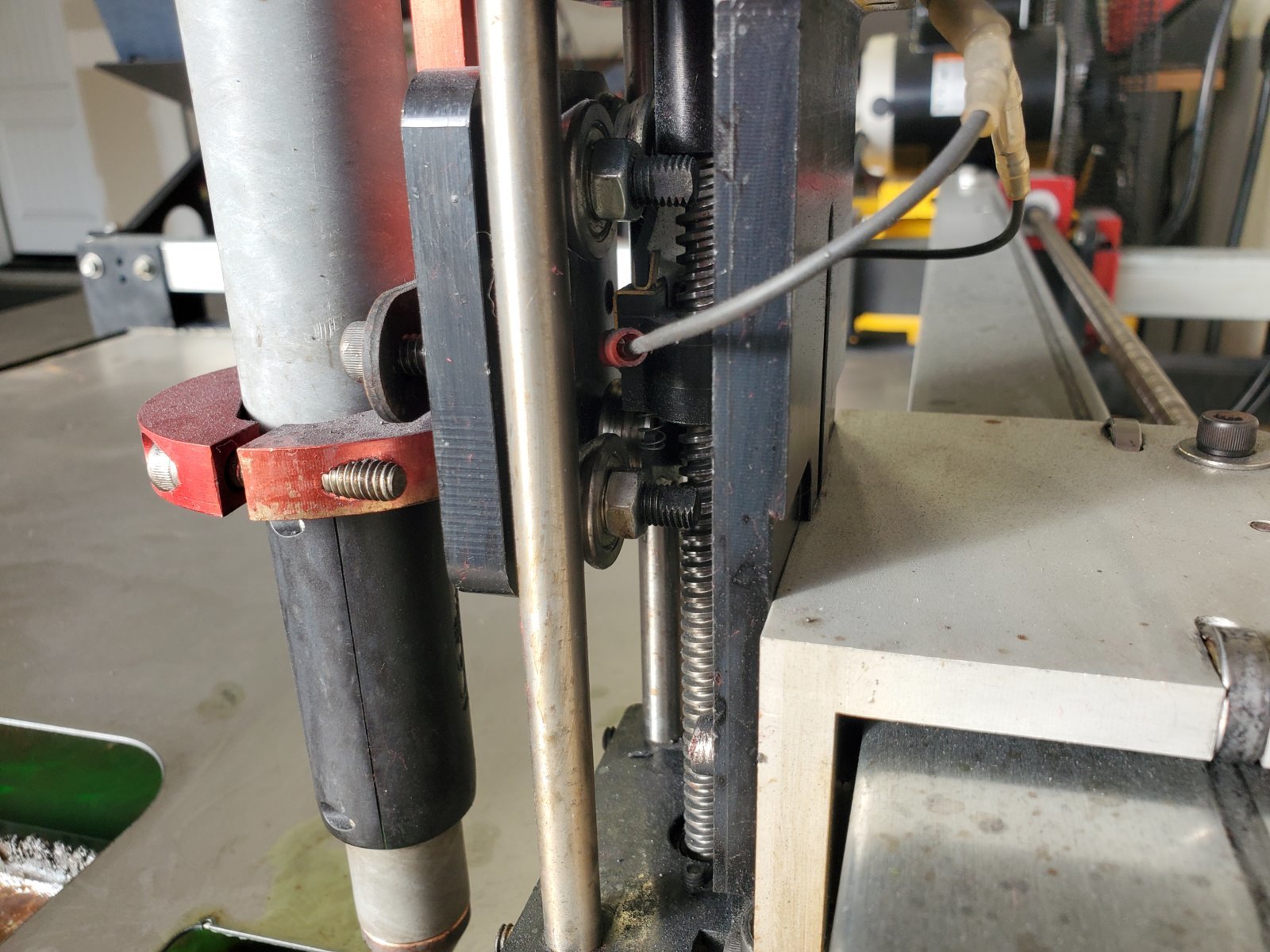

    I take that back, after assessing my torch mount I realized I had a tiny bit of play due to the eccentric bearings Langmuir uses.
    Tightened up these nuts (11mm although really it'san SAE bolt) and the play is all gone -
    The next run produced an accurate representation of my drawing -
    Here are the two for comparison -
    So @Pyrotech few things, you're building your own table so it's fair to say you won't run into any issues with 'loose' parts or assemblies. Mine was a simple fix, but it could be an issue for others on their tables.
    The drawing used is one I drew myself. It is no different than anything I would cut out on plasma with the only difference being that I don't have to worry about "drops" so no need to bridge parts.
    The only adjustments made in my CAM profile, and what worked for me is -
    Instead of a cut height of 0.06", you need to use a negative value to keep your scriber against the metal
    Instead of a pierce height of 0.15", you need a negative value (preferably matching that of your cut height)
    On my first piece that came out messed up I had used a cut and pierce height of -0.1 and 50 ipm
    I decided to add more tension (for a deeper score) so I went with a cut and pierce height of -0.2 but also increased my "cut" speed to 100ipm
    Here's a video of that run -
    https://youtu.be/rSJFAh1eLe8?si=NYanaRwv8cAEl4O_

    Is the vibration your picking up in the table causing any issues in the scribe line?
