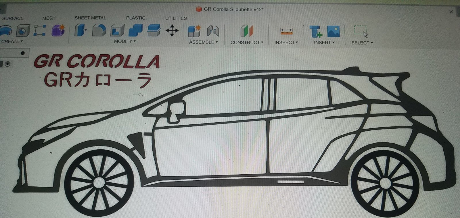

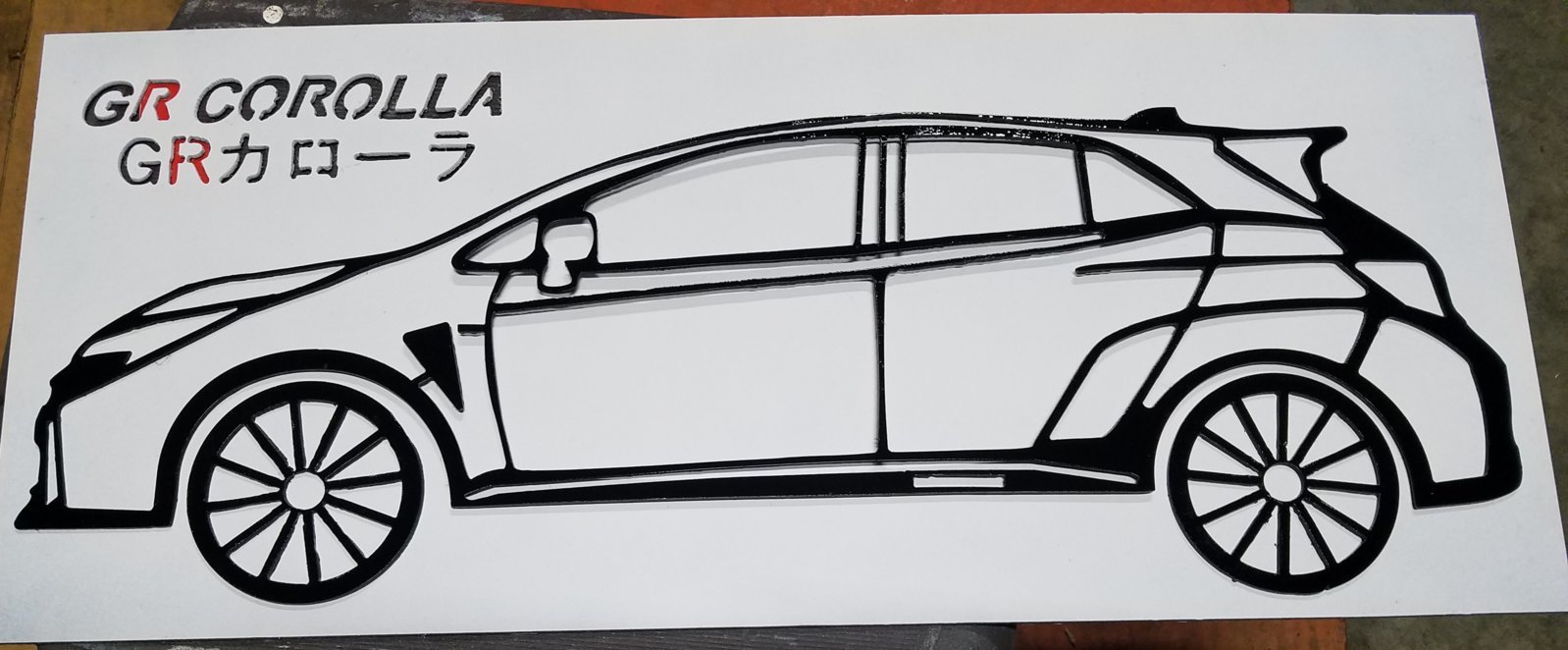

    I thought I'd whip up a tribute sign for my wall. Got more painting and some glue to apply, but at least it's cut out.
    My car:
    Fusion 360 rendering
    That spoiler is a future upgrade :)
    Cut out of 18 gauge with a 16 gauge backplate
    I'm going to paint rear lamps, tint the windows, paint background different color, etc...

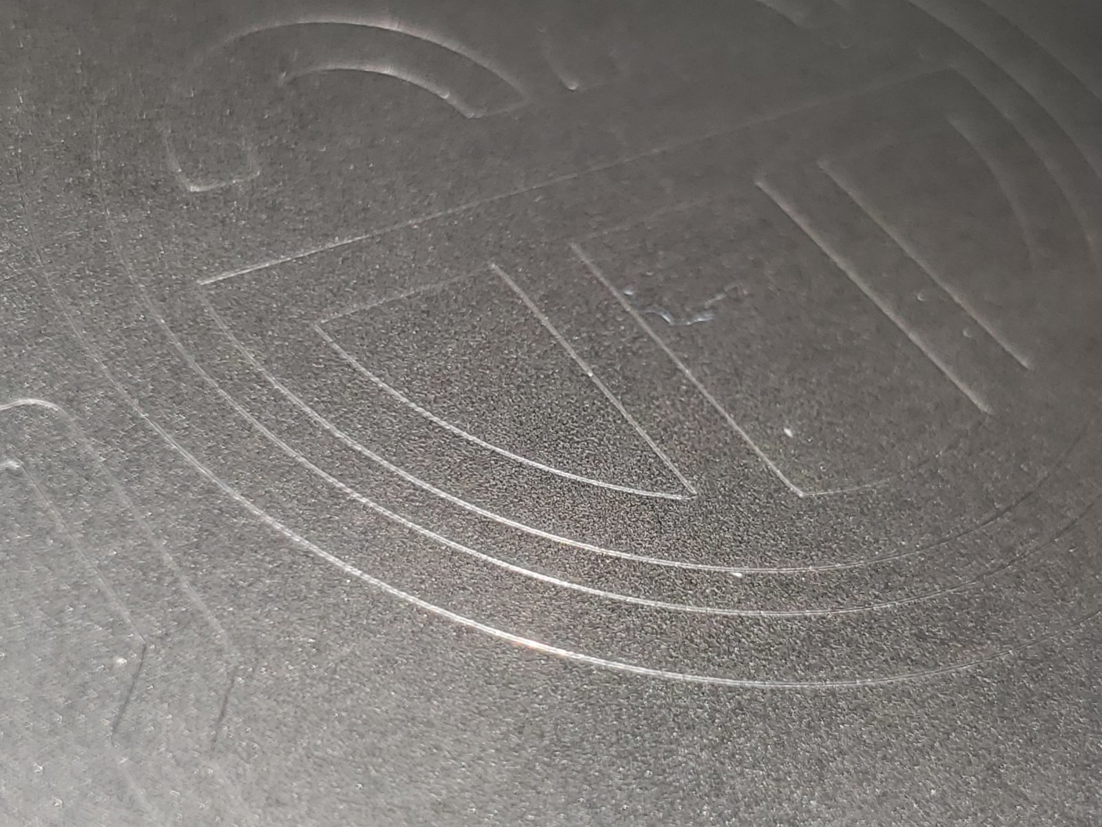

    Vibration is a non-issue
    The spring is long enough inside the EasyScriber to keep it against the steel even at the -0.1 cut height.
    Aside from maybe doing hatch fills and the sort on say...anodized aluminum, I'm not really seeing much of a use yet
    I do have two ideas for personal projects; one will be a few business cards (more to show) and second one of those tools with bolts and nuts, individually labeled for measuring the pitch and size of other nuts and bolts

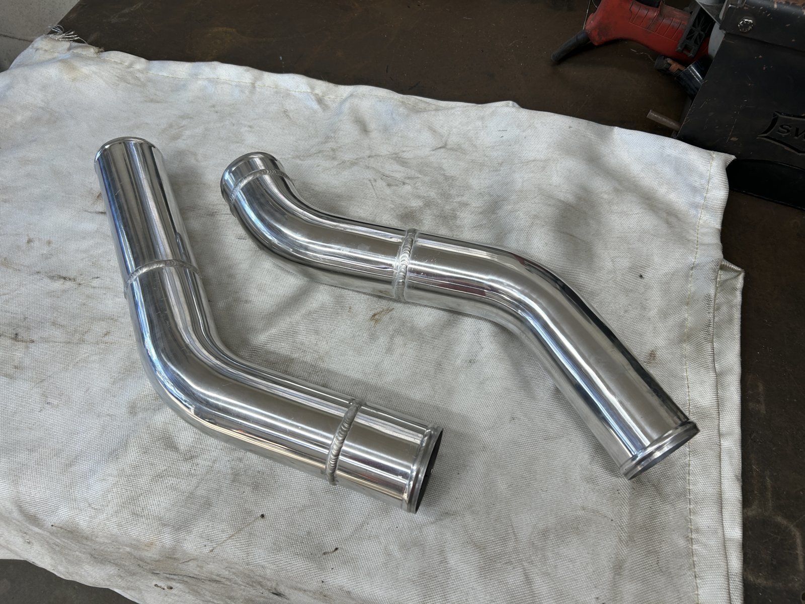

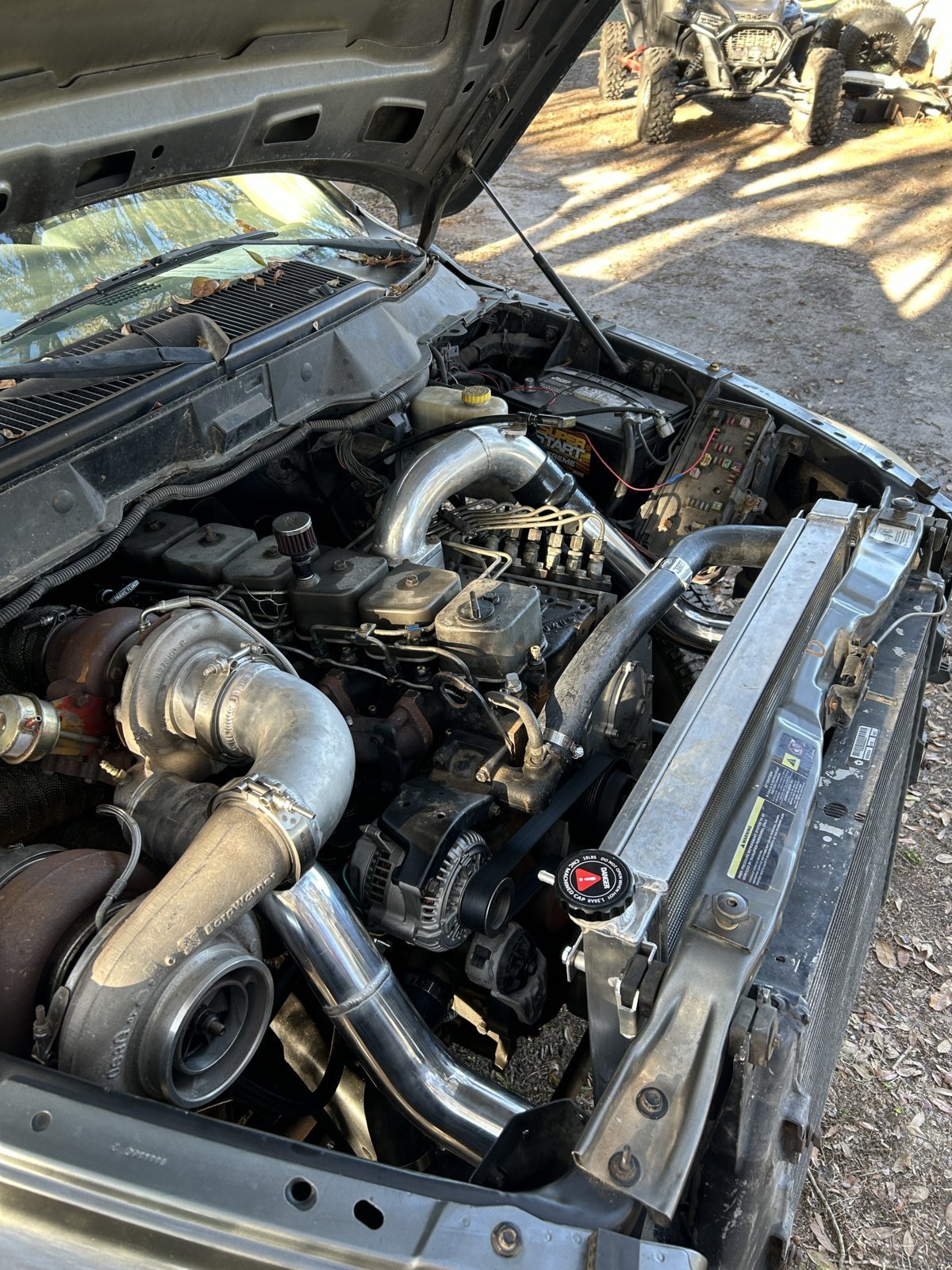

    First time welding aluminum tube. Knocked out some intercooler piping on a 12 valve Cummins
    KojiKP, soundman98, mjbtaco and 6 others like this.
  5. Jan 28, 2024 at 7:48 PM
    motolife313
    motolife313 Well-Known Member
    Dec 9, 2023
    #439227
    85
    Nice. That doesn’t look like a first timers work. Got my welder hooked up tonight. My other Lincoln shorted out a board think about 2 months ago when the extension cords ground was not on good enough and i kept trying to turn it on. And work in a wet hole on Friday. Picked up from the last welder, the tig welder had a thumb control on the torch and I didn’t like that wasn’t water cooled either, took the torch, foot pedal and water cooler off my other welder it was a precision tig 225 I bought new 10 years ago for 2350$ cost 4500$ lol got the square wave for only 1200$, has 340 amps and way more duty cycle and it’s definitely needed for some aluminum projects IMG_6492.jpg IMG_6443.jpg IMG_6455.jpg IMG_6459.jpg

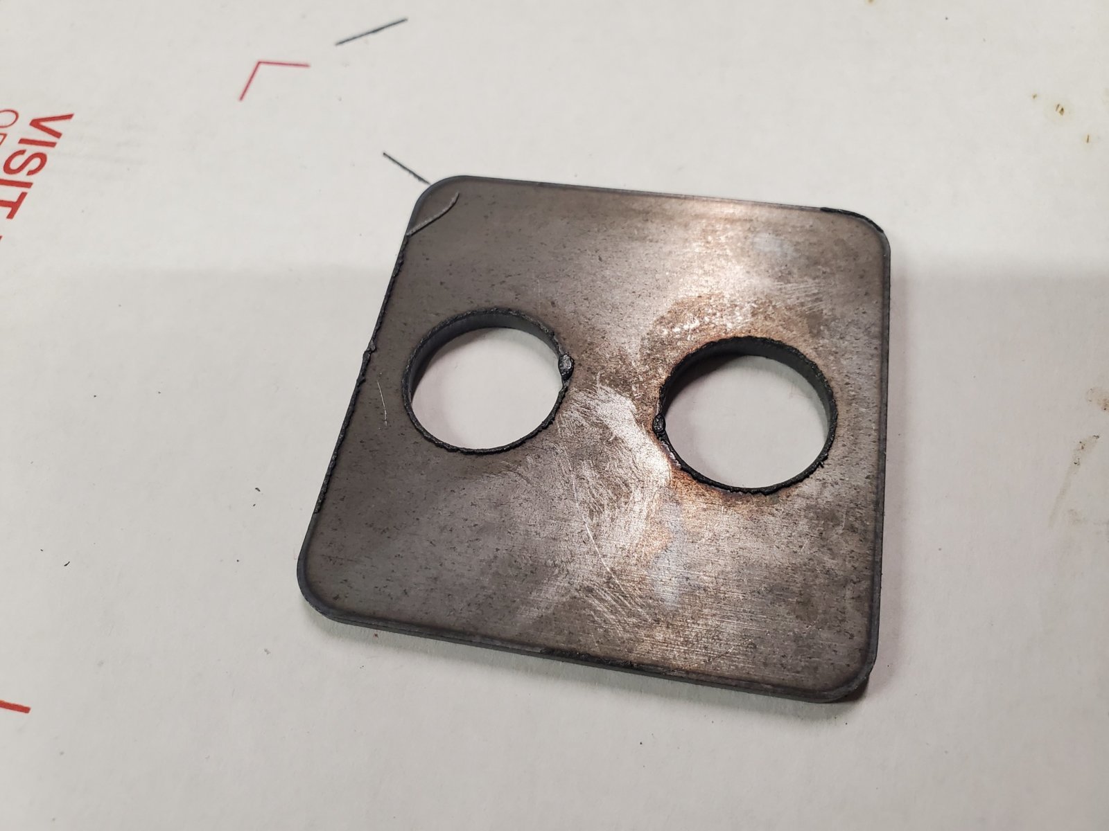

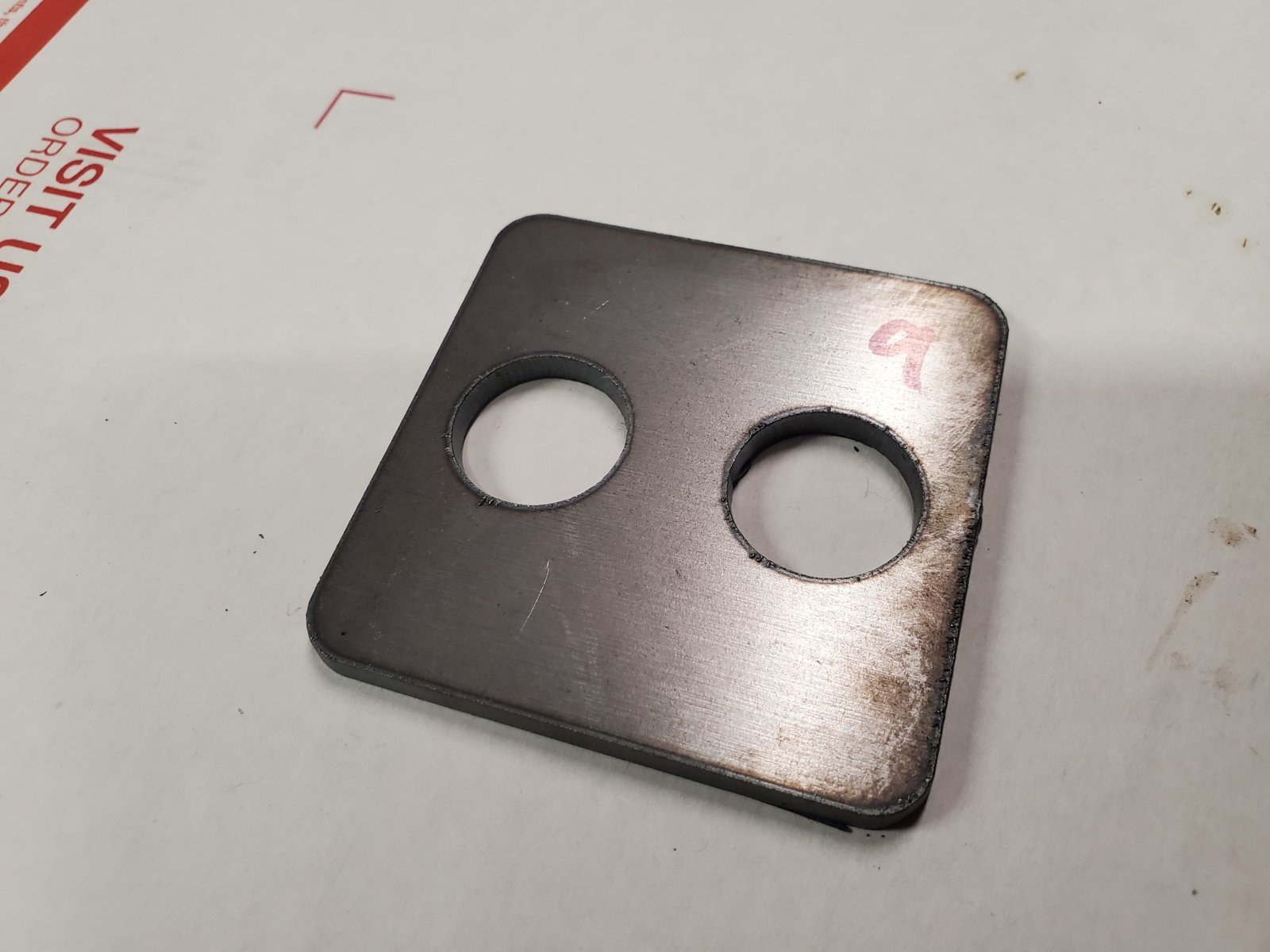

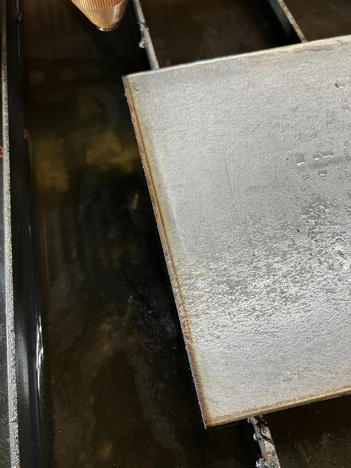

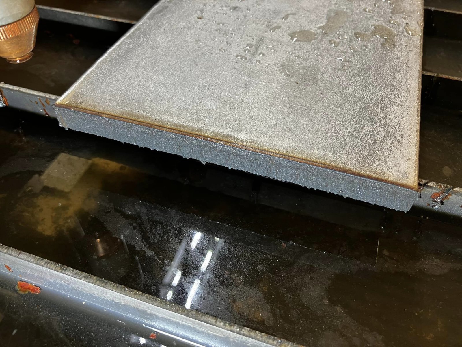

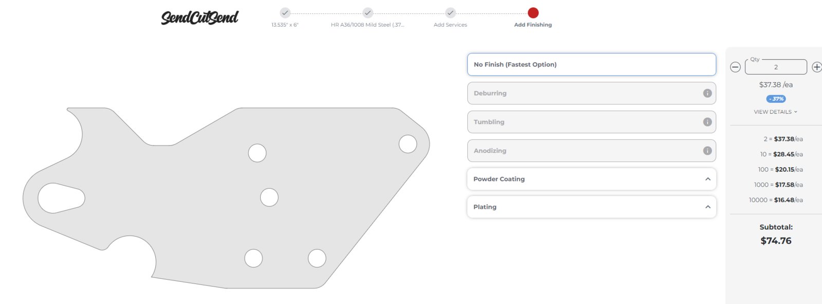

    @Kwikvette Have you cut any 3/8 on your table setup? I am looking at the primeweld cut 60 and would want to get a table in the future.
    They are for rear HC bumper brackets

    If I had extra 3/8", I'd send you a test piece or two for the cost of shipping (flat rate small box)
    I just don't use or carry it
  10. Jan 29, 2024 at 9:05 AM
    Kwikvette
    Feb 27, 2019
    #284735
    82,776
    Fresno County
    4 run, 2 don't
    On hand I got 12 gauge mild, little bit of 10 gauge mild, 18 gauge mild, and small bits of 1/4" mild
    12 gauge stainless, and 16 gauge stainless
    And 11 gauge aluminum

    Ok, just wanted to check before I send it to SCS. I still may just make these on a mill at work.

    Have you considered laminating thinner pieces to make it 3/8"
    When I made my log grappler I sandwiched 2, 1/4" pleices to make them 1/2" thick.
    Only one that's gonna know they laminated is you.
    @Kwikvette , didn't you do that with your metal bending brake?
    Bivouac and Kwikvette[QUOTED] like this.
  13. Jan 29, 2024 at 9:16 AM
    Kwikvette
    Feb 27, 2019
    #284735
    82,776
    Fresno County
    4 run, 2 don't
    I did, I had made gooseneck dies with notches in key areas for welding them together
    Came out really well but being 3/8", I wonder how much of a bevel it would have (if any) to begin with
    I would dial my setup for 3/8" but no one's ever asked for such a job so I haven't tried it yet
    I've got 1/4" dialed though mainly cause I've done my skids, dies, and motor mounts in that thickness

    One guy recently was asking the most basic newb stuff you can think of (cause he overthinks shit too much), days later he's cutting 1/2" stainless steel (posted today)

    It would take me 2 days to find if I could even cut it halfway decent .
    Bivouac likes this.
  18. Jan 30, 2024 at 12:14 PM
    Kwikvette
    Feb 27, 2019
    #284735
    82,776
    Fresno County
    4 run, 2 don't
    I mean, I guess that just depends on how much time you have to do something.
    If you have to fire up your stuff, cut, then walk away for a few days then sure.
    But you should be able to get a decent cut within half hour of dialing stuff in; once dialed no need to change anything.

    I shudder to think the cost for 1/2" stainless stock just gets your settings.
    I can't imagine having nothing less than the best for a cutter to run that SS stock.
    Just do be clear, are we having a discussion about you ability to cut thick SS? Sarcasm and 3rd person conversations throw me a bit and I have insulted people not knowing that I interpreted the convos correctly.

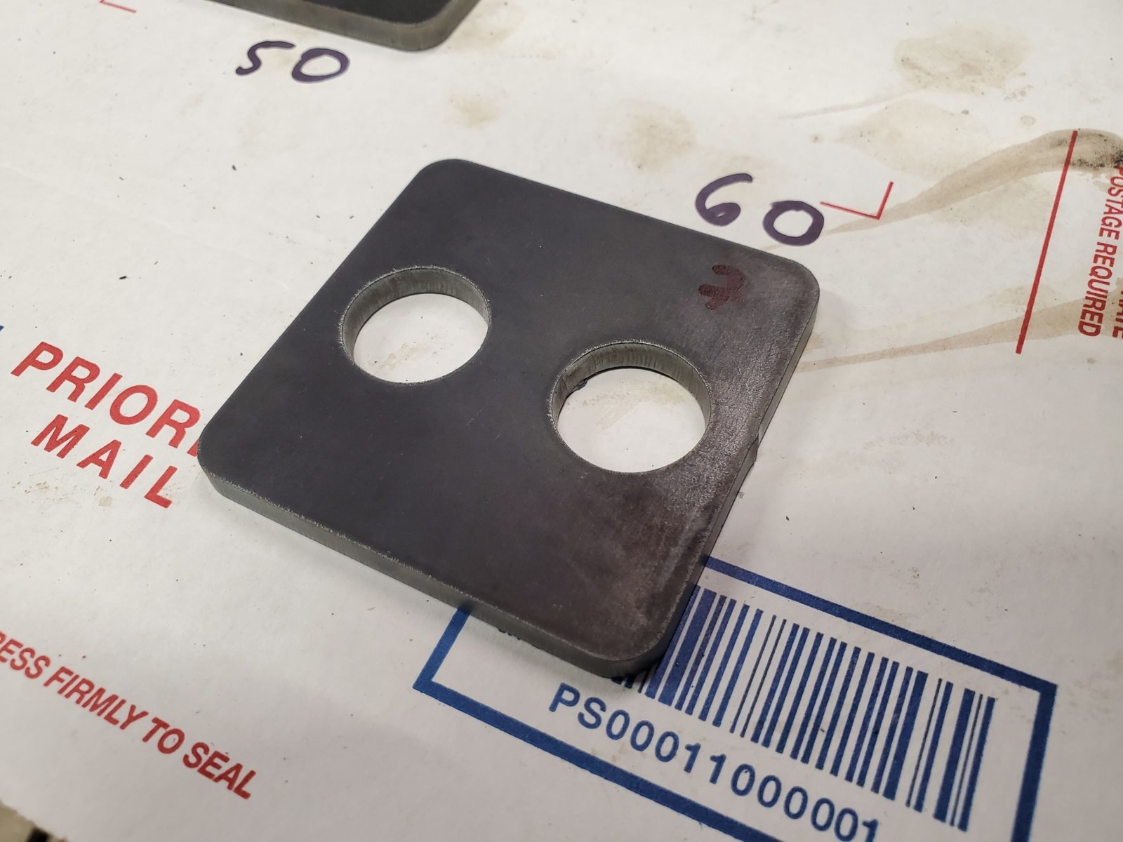

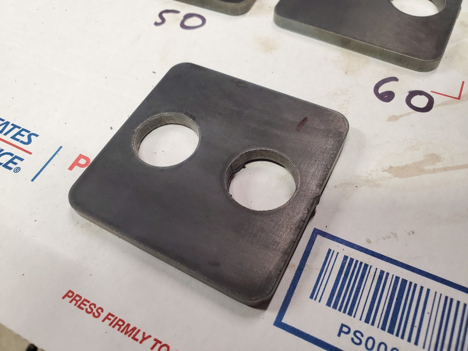

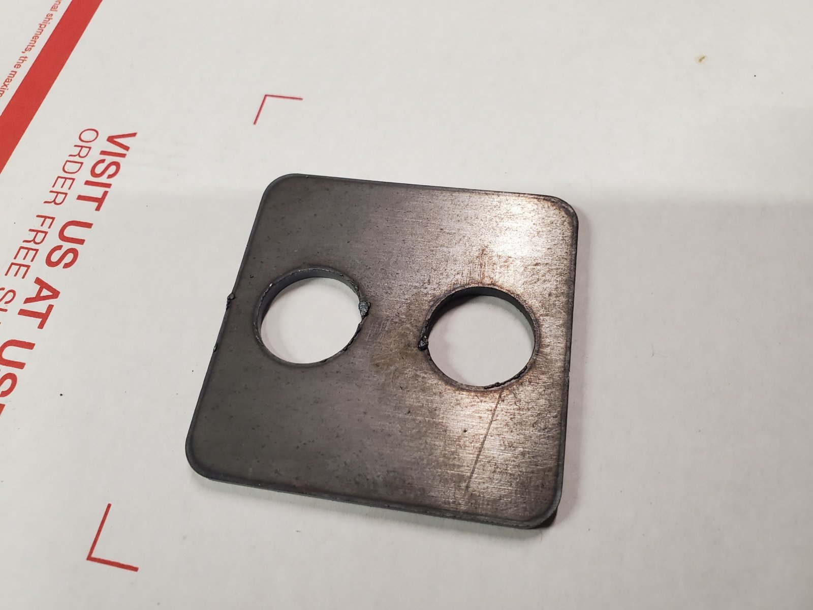

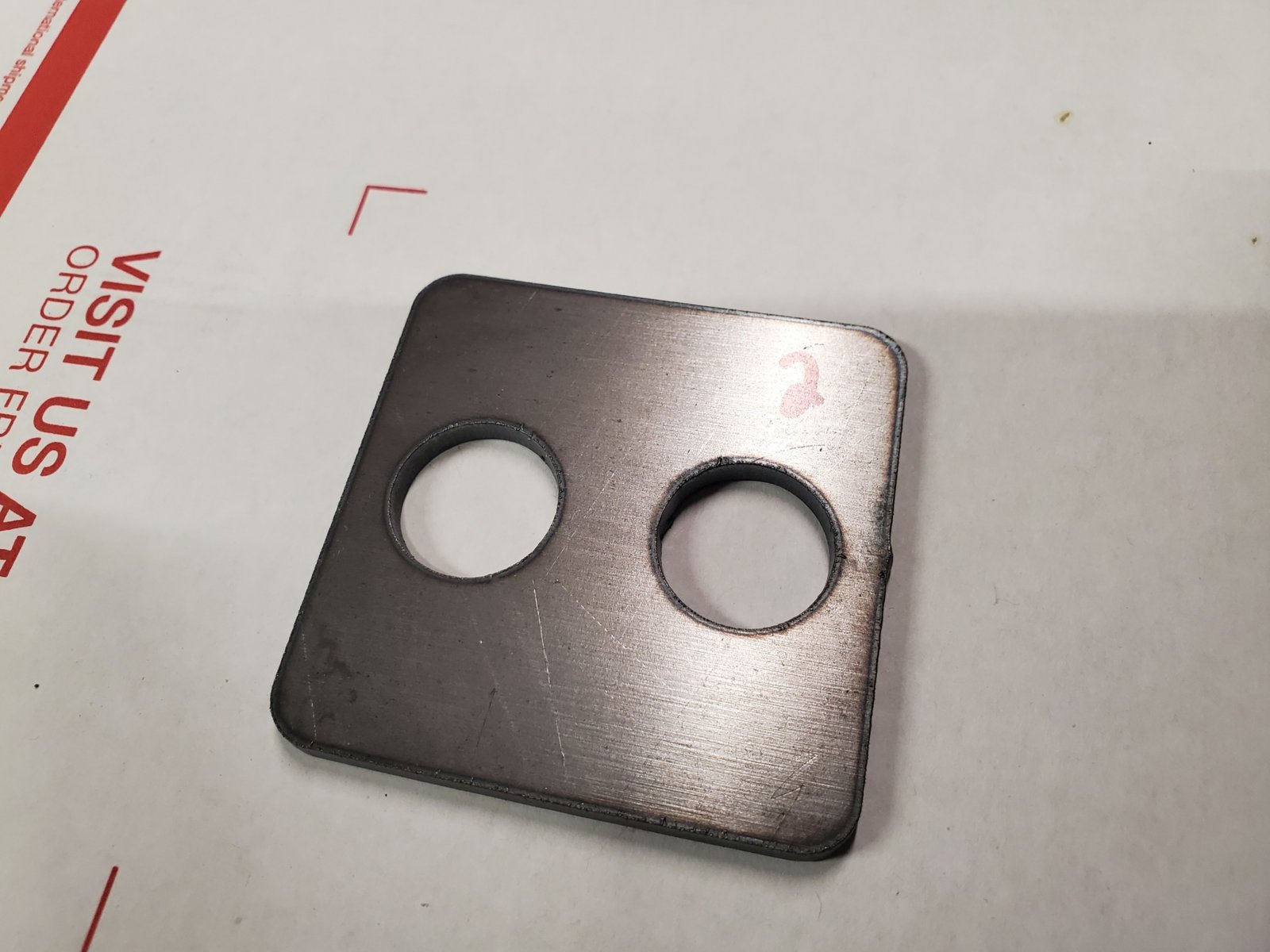

    I mean, I'm not gonna tell you what you already know (pretty sure you've got me beat in experience by many years lol) but what I did worked perfect
    Tagging @TacoTuesday603 since he showed interest in getting a table in the future so he could certainly benefit from the information

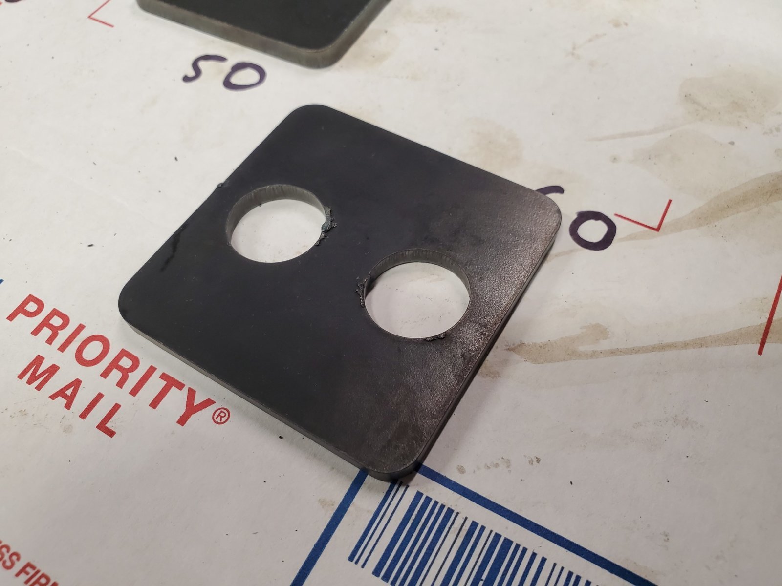

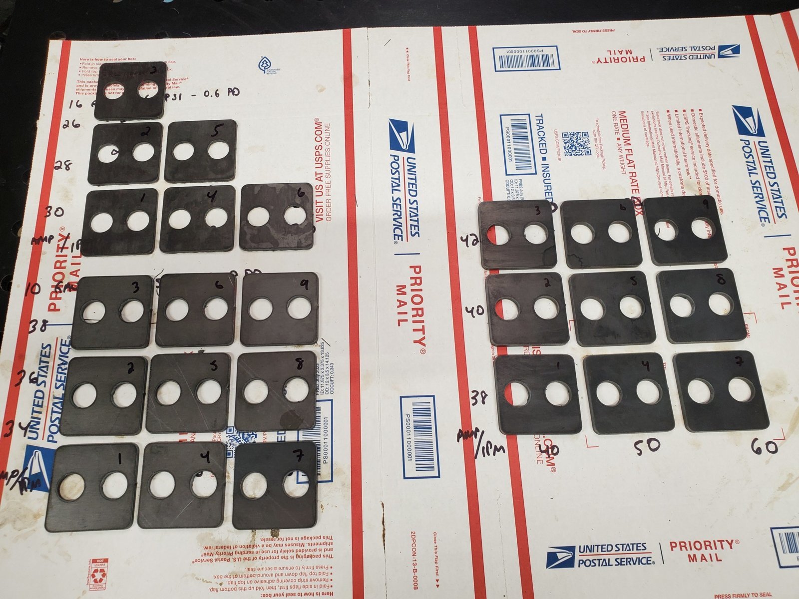

    Running the same test piece, at different speeds and amp settings
    Noting the best
    And disregarding the worst

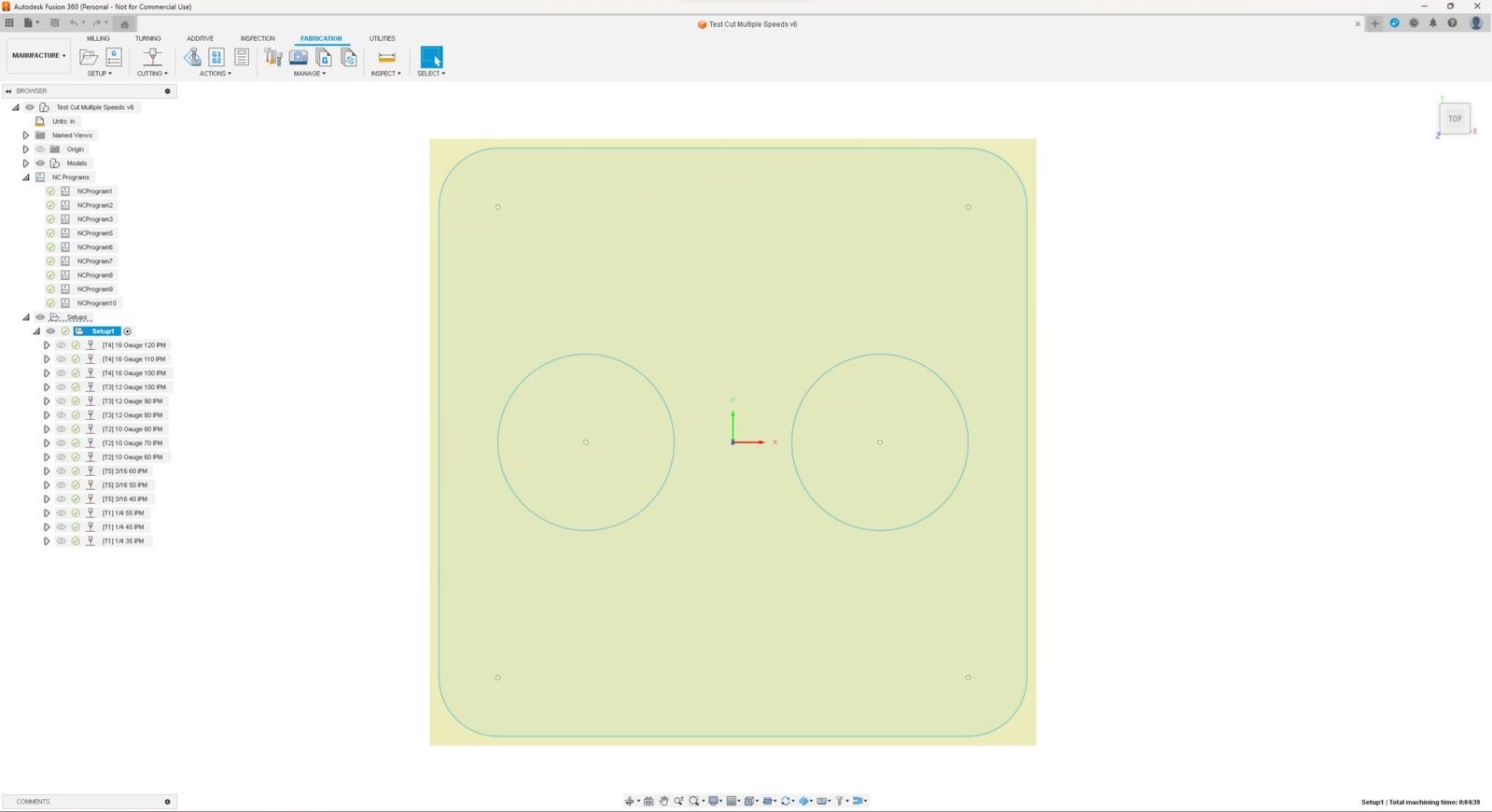

    An example of my programming (it's got way more profiles since this last picture for more thickness and metal types)
