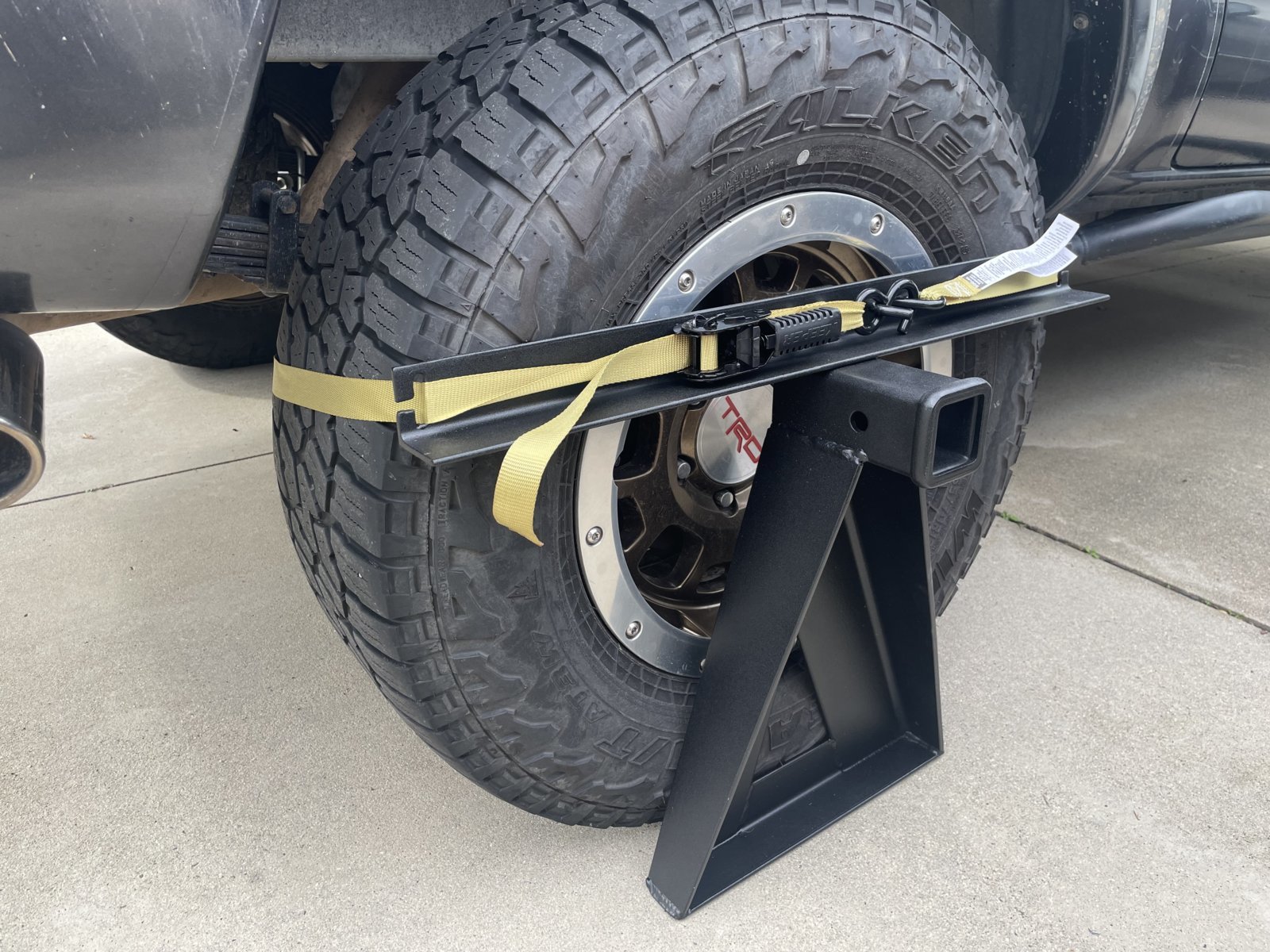

    Was able to copy a wheel mounted hammock base and save a chunk of change. Didn’t really get to set it up before the rain started today.

    $200 for what amounts to a ratchet strap, 2" receiver tube, and a little angle iron?!?
    honestly, that surprises me. most of the time, small projects like that, they sell for cheaper than most people can get the raw steel for.

    That’s like innovation 4x slider kits. I think I’d spend more on raw materials then all the prebent and cut tubes

    Exactly. I thought the price was a bit steep for what it was and it was easy enough to make. Paint, strap and everything, I'm only $70 down, plus I had fun doing it. Now only if the weather would let up so I could play with it!
