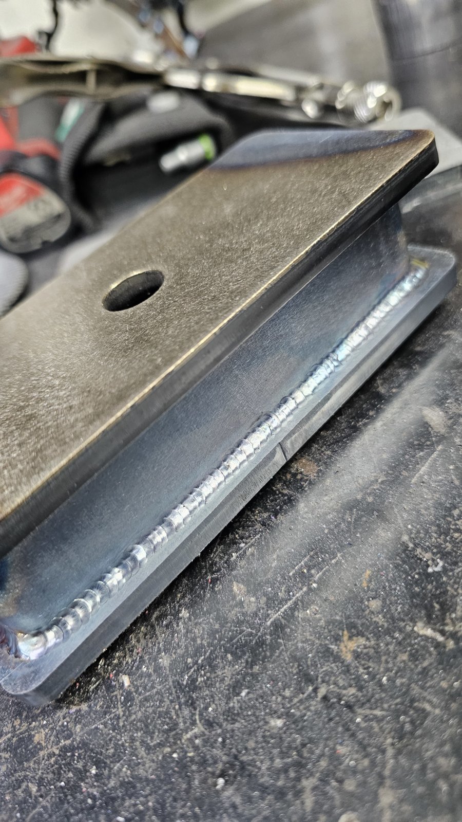

    Tested out the furick bbw cup. Holy shit it requires a ton of gas lol.

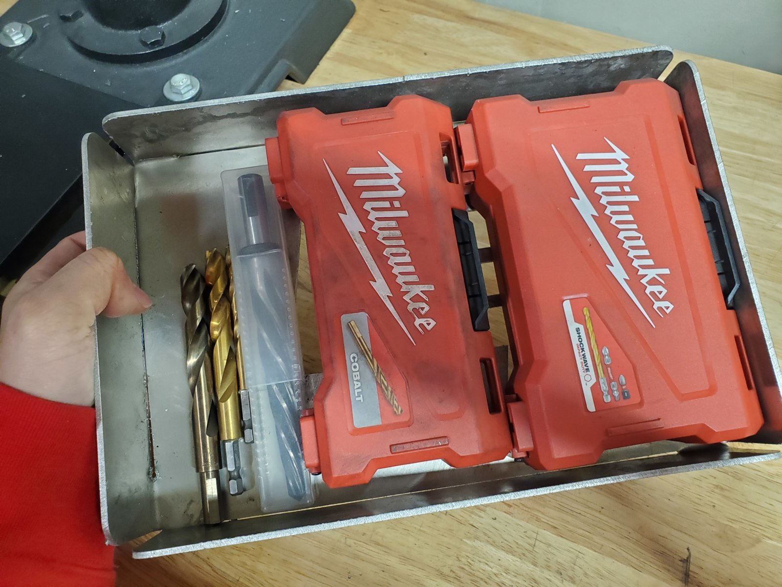

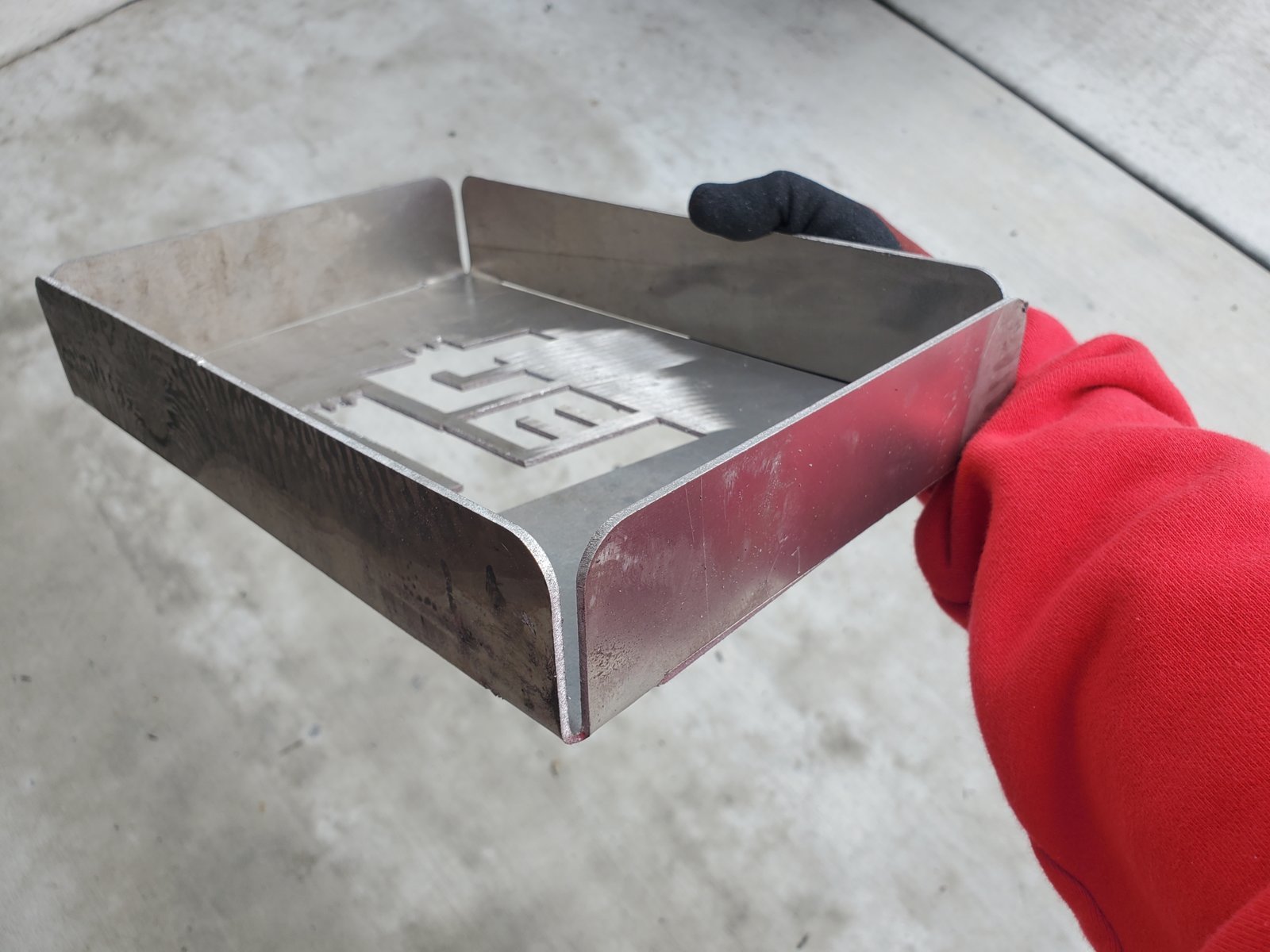

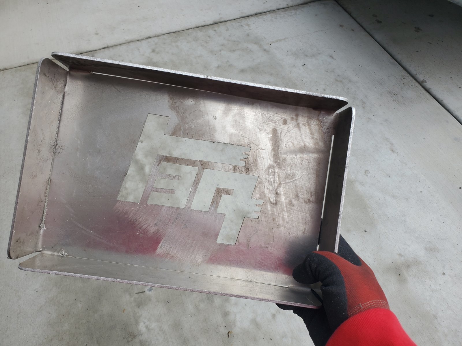

    Only aluminum I ever cut was a single bottle opener
    I just went by book and never adjusted
    With that said, I'm playing around mocking something up for someone and decided to use my scrap aluminum I paid $8 for :rofl:
    1/8" dirty as fuck aluminum
    0.8 pierce delay
    130ipm
    45 amps
    Everything cut really nice and clean and I think if I lower my pierce delay to 0.6 or 0.7, my pierce should be cleaner as that's the only dross I got

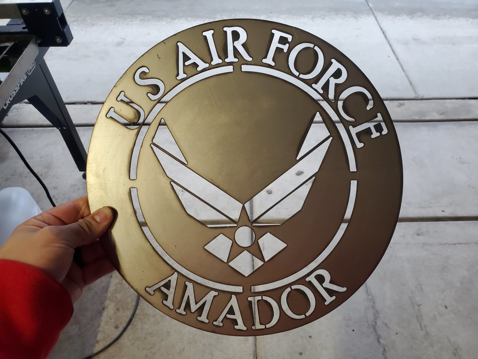

    Been raining a lot so haven't cut much. Still need to do that battery tray but in 16 gauge steel
    Made this right now as one of yesterday's requests
    Drew it myself cause I hate the font others use and turning a pic to an SVG did not render the sharpest lines

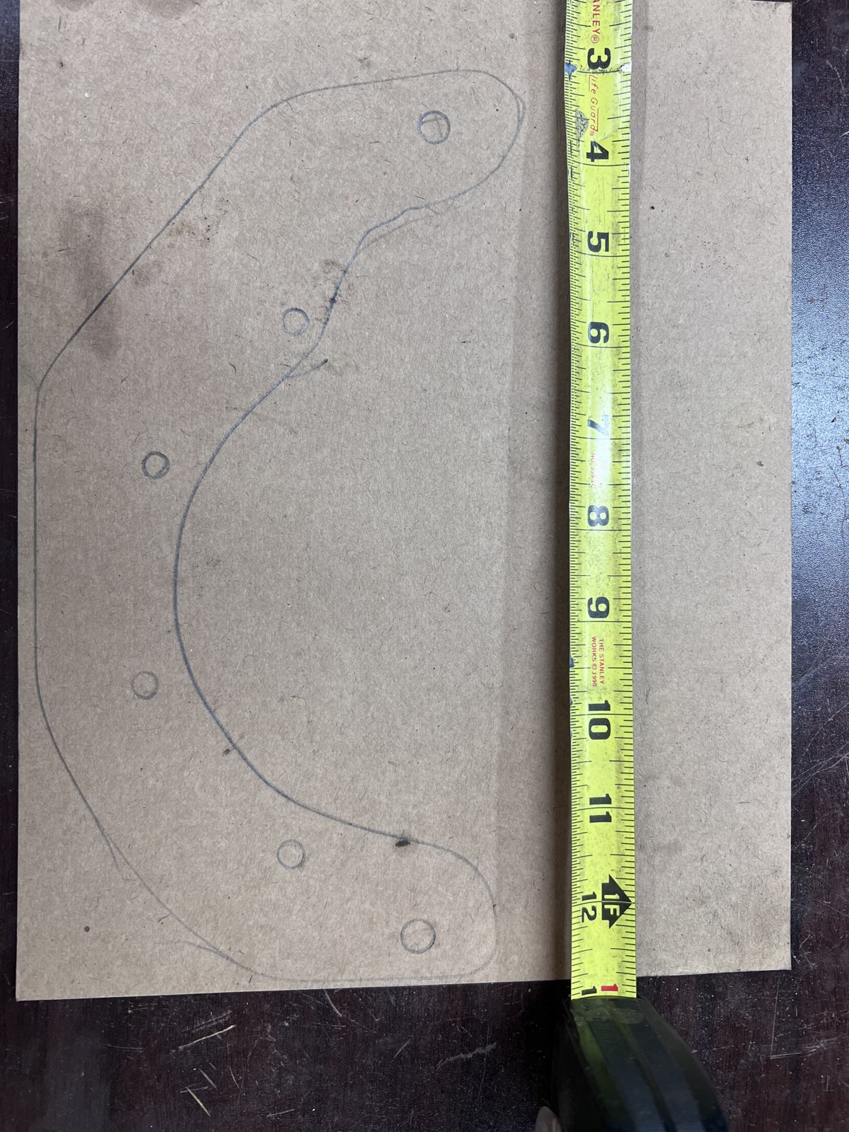

    Can any of you gurus put this into a file so I can send it to send-cut-send to have cut? Or be able to cut yourselves? It’s a mount plate for my class 9 transmission. 1/8”.

    Plenty of us could! Just pick your person :rofl:
    For anyone replicating that it'd be easier to provide multiple measurements such as the radius of a few of those ends
    Or really the hole sizes especially, if anyone's going to take the image and scale it up to a known dimension (something I do from time to time)

    That's exactly what I'd do as well.
    Give us the hole diameter and we can a lot with it.

    Thanks y’all. I’m not sure how to measure the radius’s. The inside edge is more important than the outside as it follows the transmission. Hole drilling isn’t important either as I can do that but 1/4” holes would work.
