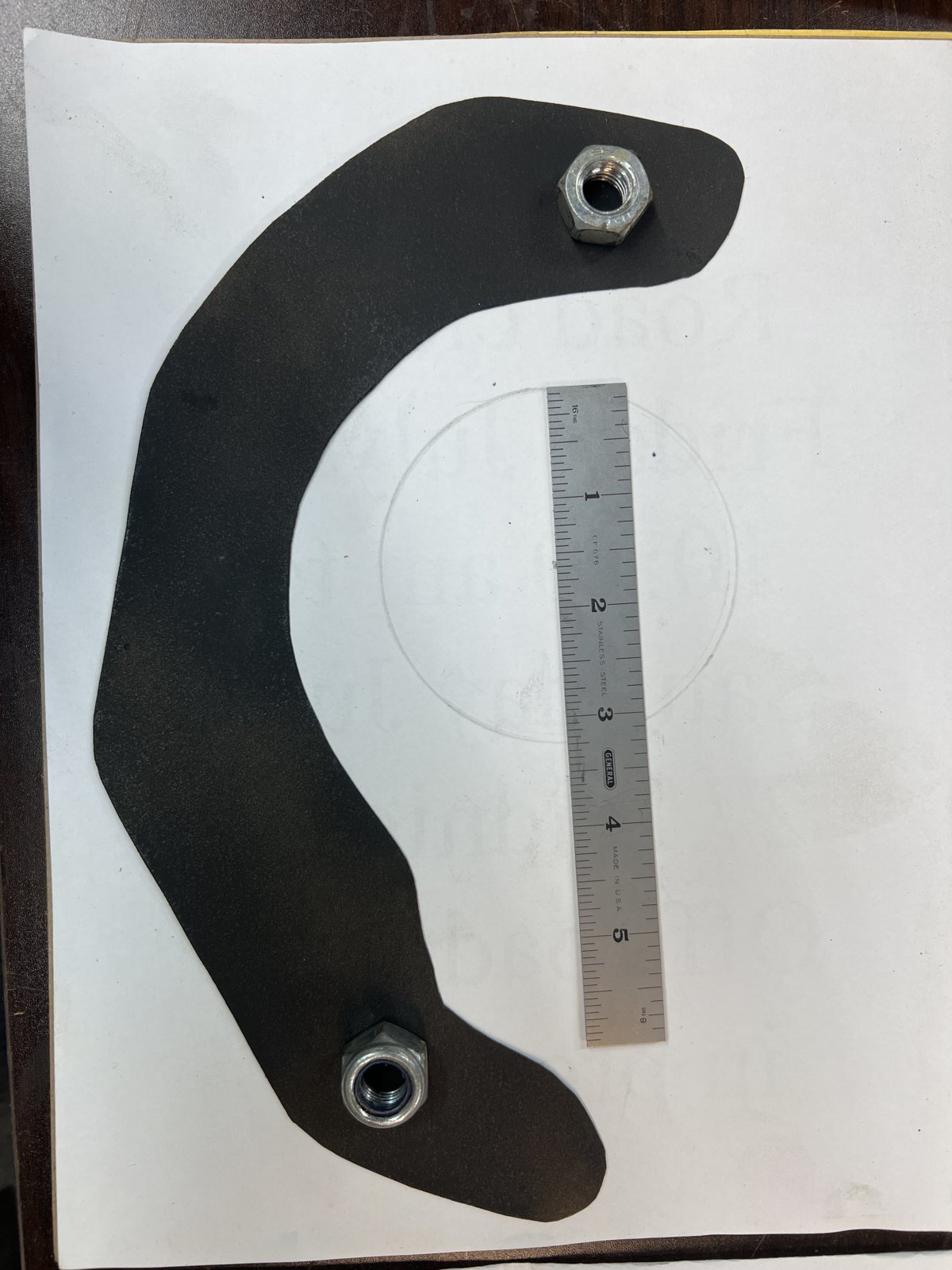

    Cardboard cutout
    Paint it black
    Place one circle with an exact size, and provide that dimension
    Place cutout on a white background, and take a picture of it (helicopter view)
    This will allow near-perfect duplicate drawing for cutting purposes
    Enjoy!
    (the hole and known dimension is for scaling reasons, and when using a tape measure always start at 0 never in the middle)
    lit_taco4x4 and koditten like this.

    In addition make sure your phone is programmed for the highest number of pixels. When zoomed in,the sharp edges can wash out. Max pixels helps a lot .
    Kwikvette[QUOTED] likes this.

    Image is reversed so I don’t paint the hole marks.

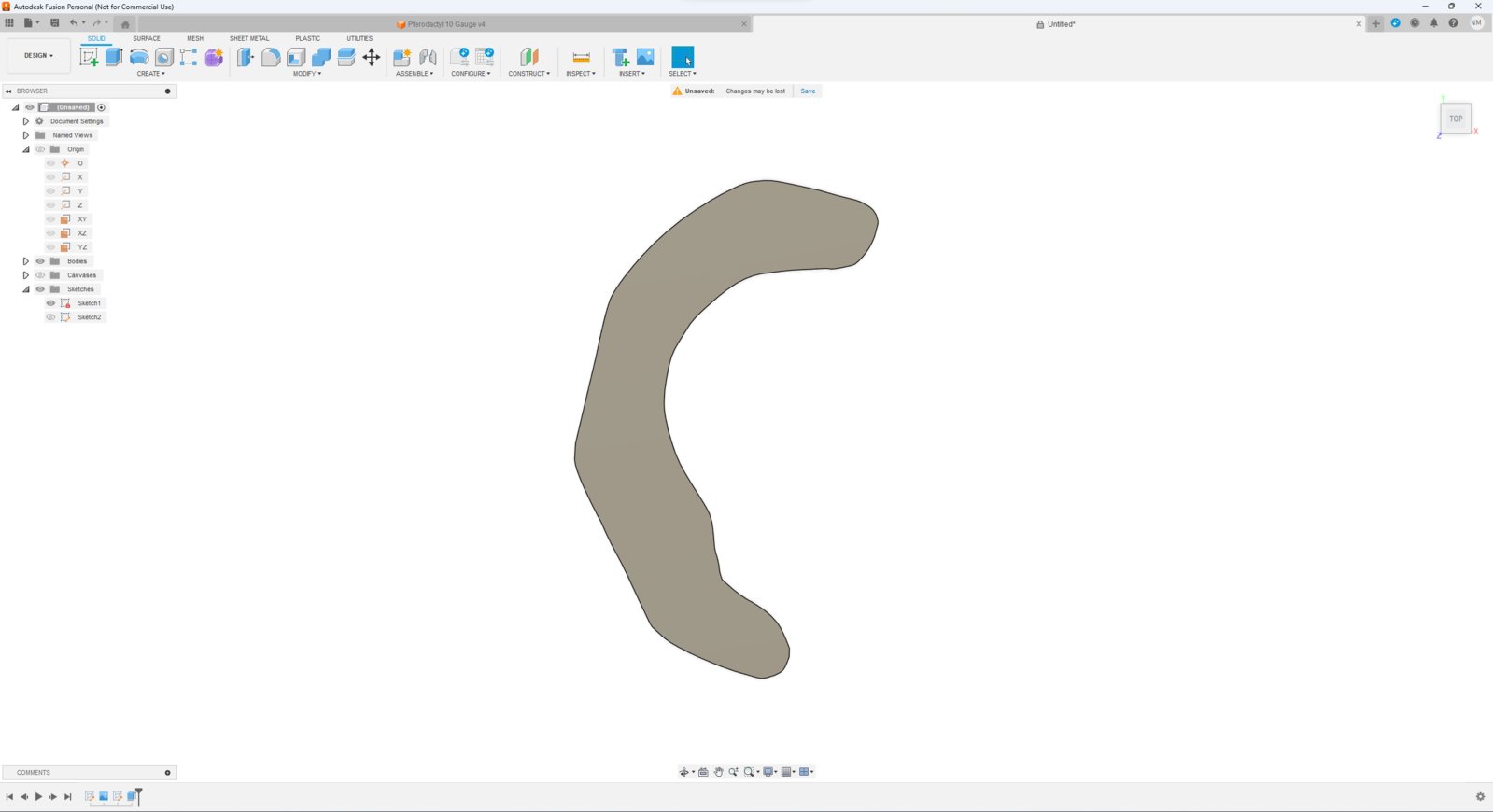

    That's a unique part!

    I think we miss communicated.
    We wanted the exact size of the bolt holes in the part.
    This allows us to tell the computer that everything else in the picture should be scaled to the size of the bolt holes.
    They may be metric or imperial, but we can work with that.

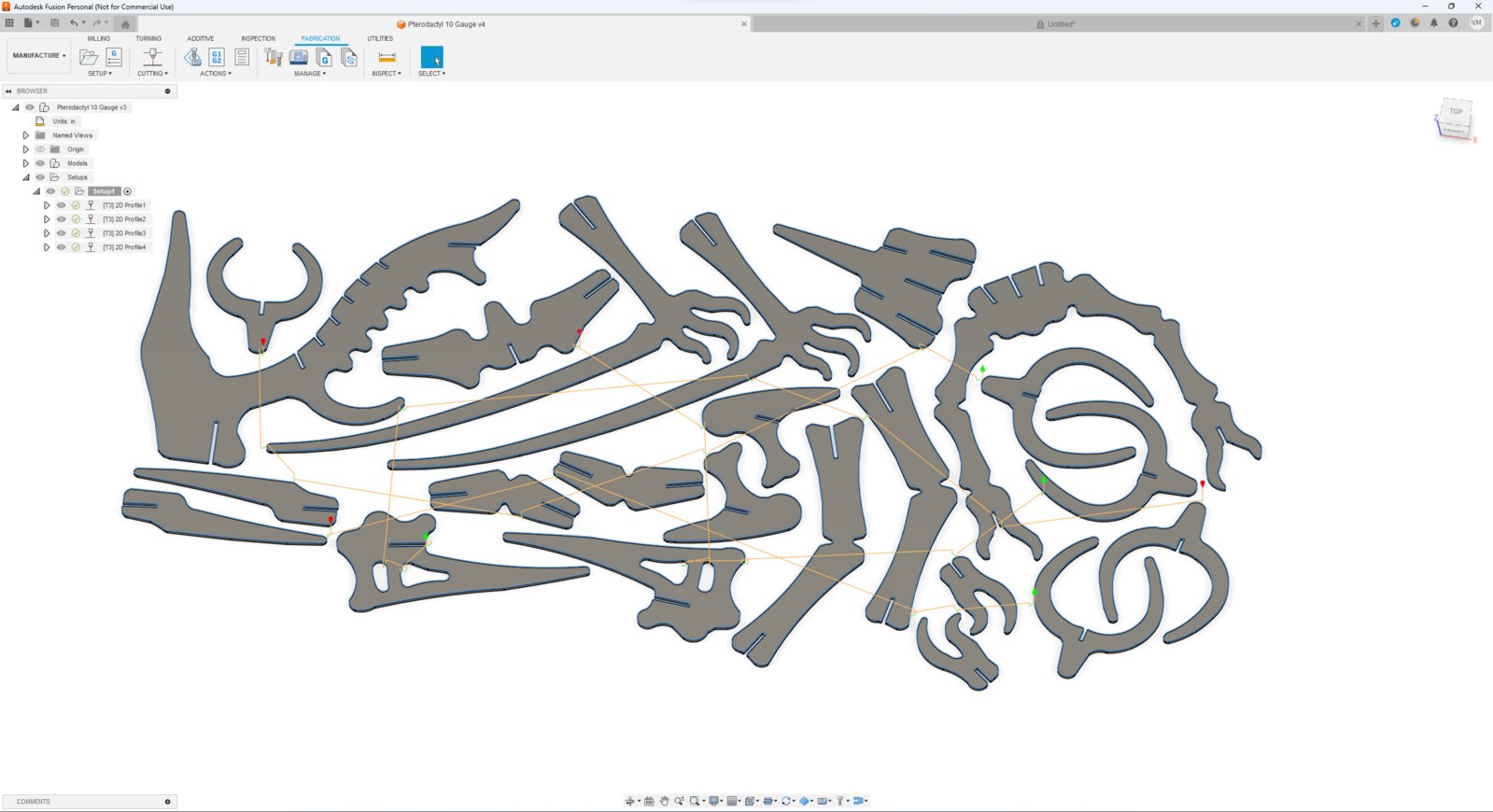

    I had just happened to be on Fusion lol
    Got my Pterodactyl pretty much ready :anonymous:

    Did you hand nest the parts or did you pony up the $ to let the program do it?

    Hand nest; the file (found on grabcad) has parts as close as .096" apart from each other and meant for laser
    My nest is done in a sloppy fashion but only to accommodate the odd scrap sizes I have remaining
    When I scaled it up for 10 gauge per my table settings, the drawing ends up over 4' wide :bananadead:

    As a hobbyist, I didn't find the nesting feature gained me much, either.

    As a hobbyist, same!
    Hell, I don't even bother with Sheetcam and do all my CAM on Fusion like all the other poors

    Yeah...I'm not cutting this.
    I figured it'd be cool to have and hang up but I have it scaled for damn 10 gauge, that's going to be at least 8-10lbs :rofl:
    Even got the remnants laying on my table but it wasn't until I threw it on there that I was like oh damn, she'll be too heavy to hang safely

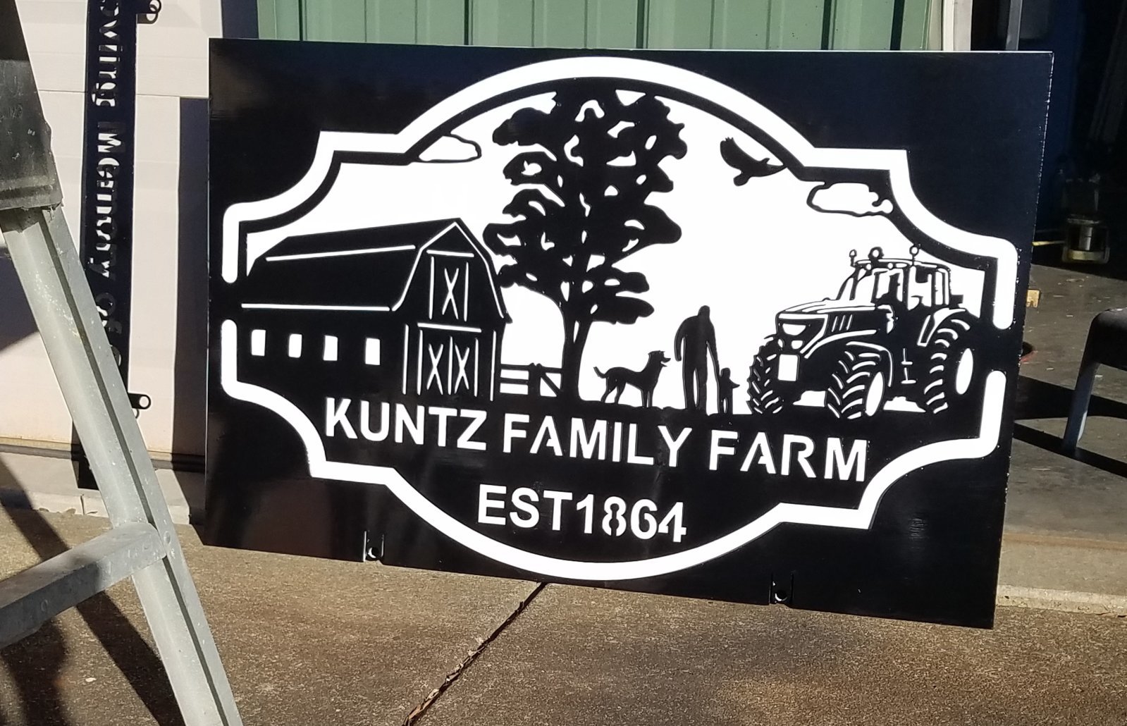

  15. Feb 7, 2024 at 7:32 PM
    Wsidr1
    Wsidr1 Well-Known Member
    Jul 11, 2018
    #259004
    3,079
    Indiana
    2 x 95.5 Ext 2.7L & 3.4L A/T 4x4
    I got this cut a few days ago. Painted it yesterday with oil paint. I put it on a bit thick because it's going to be hung outside by their driveway. I was afraid it would rust. Dammit, even 55F and standing in the sun wasn't warm enough. Got some paint runs :anonymous:.
    You can't see them from 5 feet, but... I may heat up the garage and try and fix them before I deliver it next week. 16-gauge with 18-gauge backplate, 40" x 30". Owner will build wooden frame and mount to post. That tabs at the bottom are for a hanging sign in tribute to farm founder.
