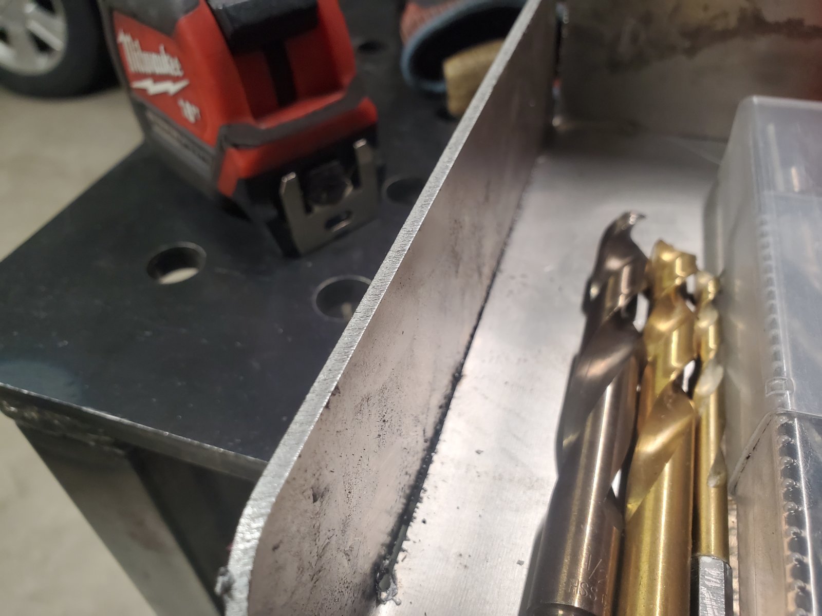

    Cookie Sheet...not just for oil drips anymore.

    Lowes wanted $14 for an 18 x 18" piece of sheetmetal.
    Fuck that!

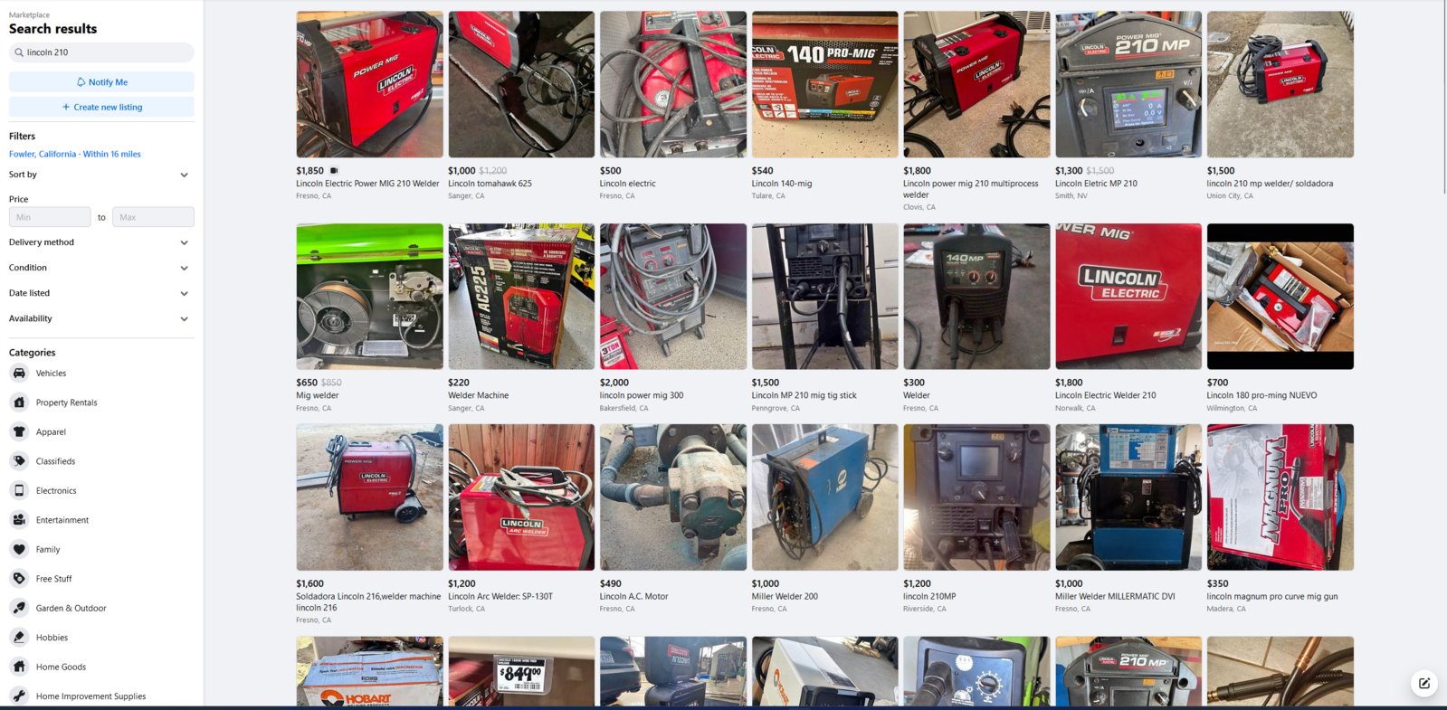

    The $1,800 models are basically mint, box opened but unused
    Just did a 5 second search and here's what pops up already

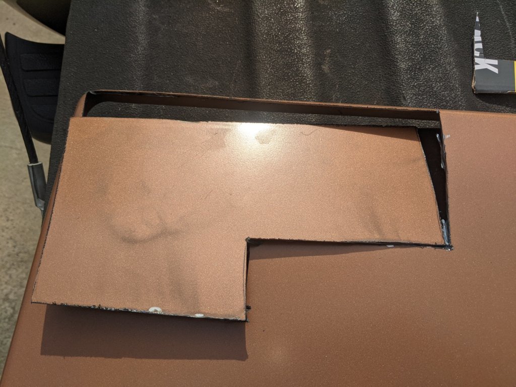

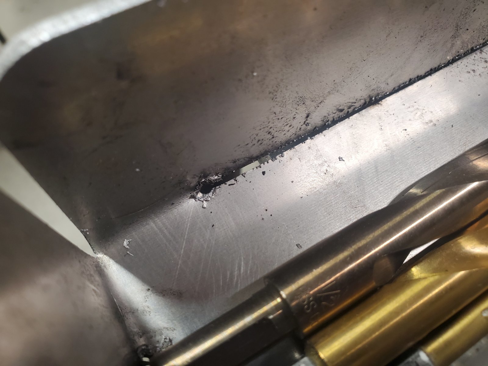

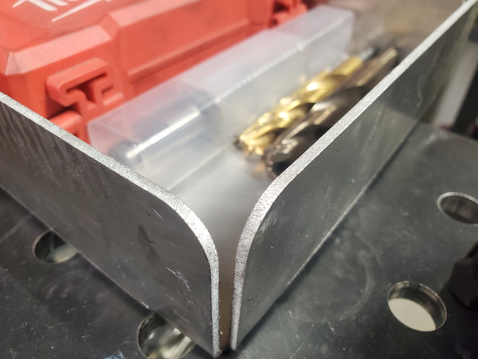

    Funny you ask, especially since I spent some time on the phone with my friend yesterday when he coincidentally sent me pics of him cutting aluminum...after I had just cut some myself.
    He uses a Hypertherm 65 Sync with Finecut consumables on an STV Pro table, 220v Campbell Hausfield compressor, and Harbor Freight refrigerated air dryer, and in-line filters.
    I use a PrimeWeld CUT60 with UPM-105 torch and 'fine' consumables (1.0mm kerf) on a Langmuir table, 110v DeWalt compressor, and in-line dryer and filters.
    Huge difference in setups but it's important to know this because -
    In talking, we both experienced top dross on our initial pierce. Mind you he uses book settings as Hypertherm figured it all out for owners, whereas I took a guess and used a 0.8 second pierce delay versus his 0.1 second pierce delay.
    Ignore the fact that I bent it but, that dross there is the top side of where the pierce was done. I didn't bother to clean it and I'm glad I didn't to showcase what I'm saying -
    We also both experienced a faint 'lip' or edge on the bottom side of our cuts. Nothing really noticeable unless you specifically felt for it or ran your finger nail down to the edge.
    As for the face itself, both were of a similar "rough" looking texture but felt smoother to the touch than it looks like -
    Seems that aluminum is just really temperamental when it comes to 'corners' or any sort of detail as that's where I got the most dross, around the letters when I cut this thing out. He explained that he experienced the same.
    We were both running around 45 amps on 1/8", yet I ran 130ipm and he was at about 92ipm if I recall...or close.
    Just another metal to fine tune really but I don't believe it would need much dialing in like steel does because if you cut on air, you'll get similar results to what I've posted above on dirty scrap aluminum; he told me his aluminum was also from a pile of scrap and completely filthy like mine.
    With that said, I expect better results on clean aluminum; there's a guy that only cuts aluminum as he TIG welds and does a lot of marine stuff using marine-grade aluminum all on air all on the same table I'm using (and a cheap Chinese plasma cutter).
    As for 1/4", yeah my machine will easily do it and I'd be down to try but I never bothered mainly because there's never been a market for it (for my people that is) and I'd hate to think about how much it'd cost.
    I'm not up to speed on aluminum types with the exception of temper and all in relation to bending.
    Oh and to answer your question about losing material upon cutting, that really comes down to how you have your kerf values setup on Fusion (or whatever CAM you'd use) as you're going to lose some on the inside and be dead-on with outside measurements or vice versa. Mine is kind of split between both.
