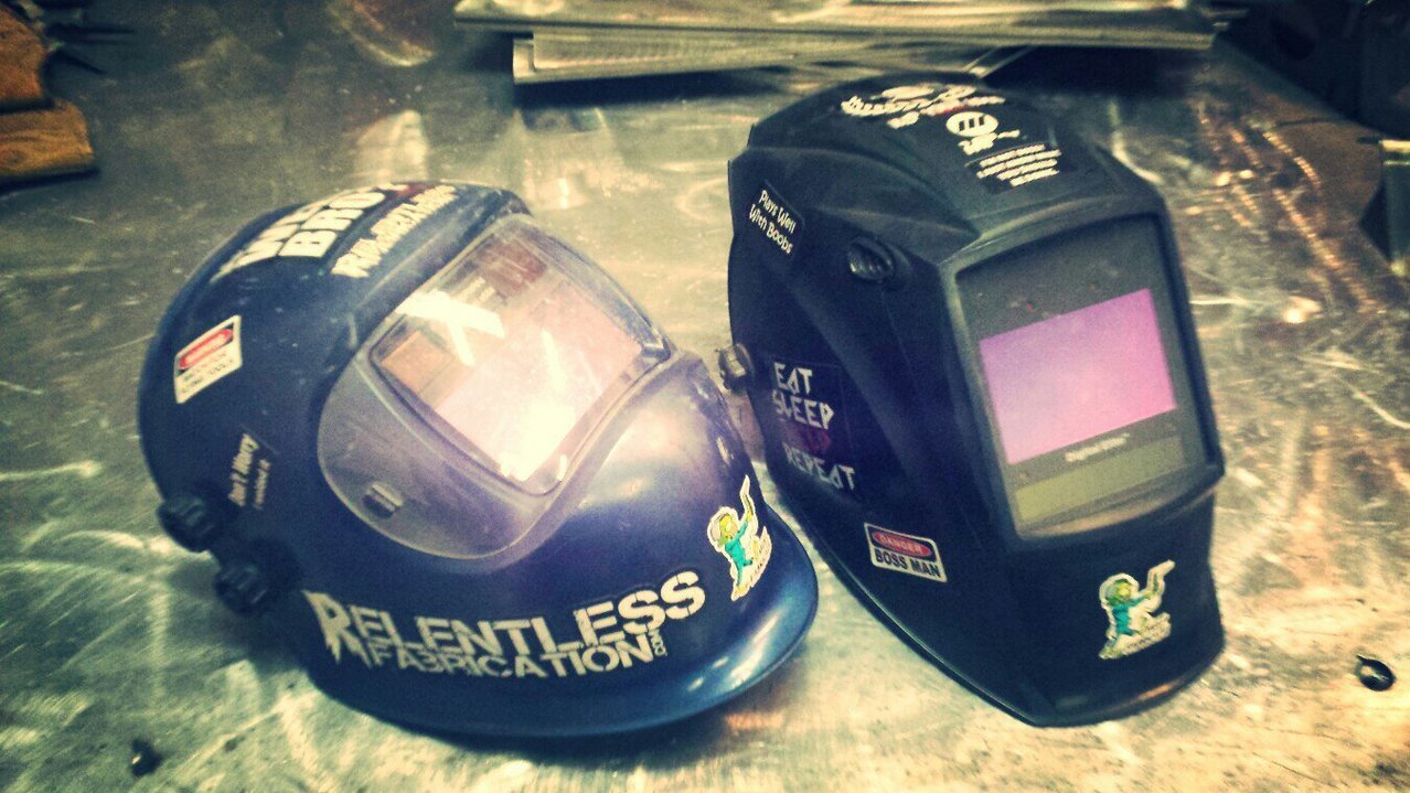

    I've got a miller digital elite and a Optrel e680. I'll take the Optrel any day over the miller. It's lighter, has a curved lense(only overhead rated auto dark I know of), has infinitely adjustable on shade from 5-13. It also shades bluer rather than green like many hoods (miller included) so I feel like you can see more definition when welding. geryby7a_f816928941e3cf0add57239ece030c19549d11e1.jpg

    No complaints from miller elite. Strides better then HF auto darkening for shit around house comparedto work.
