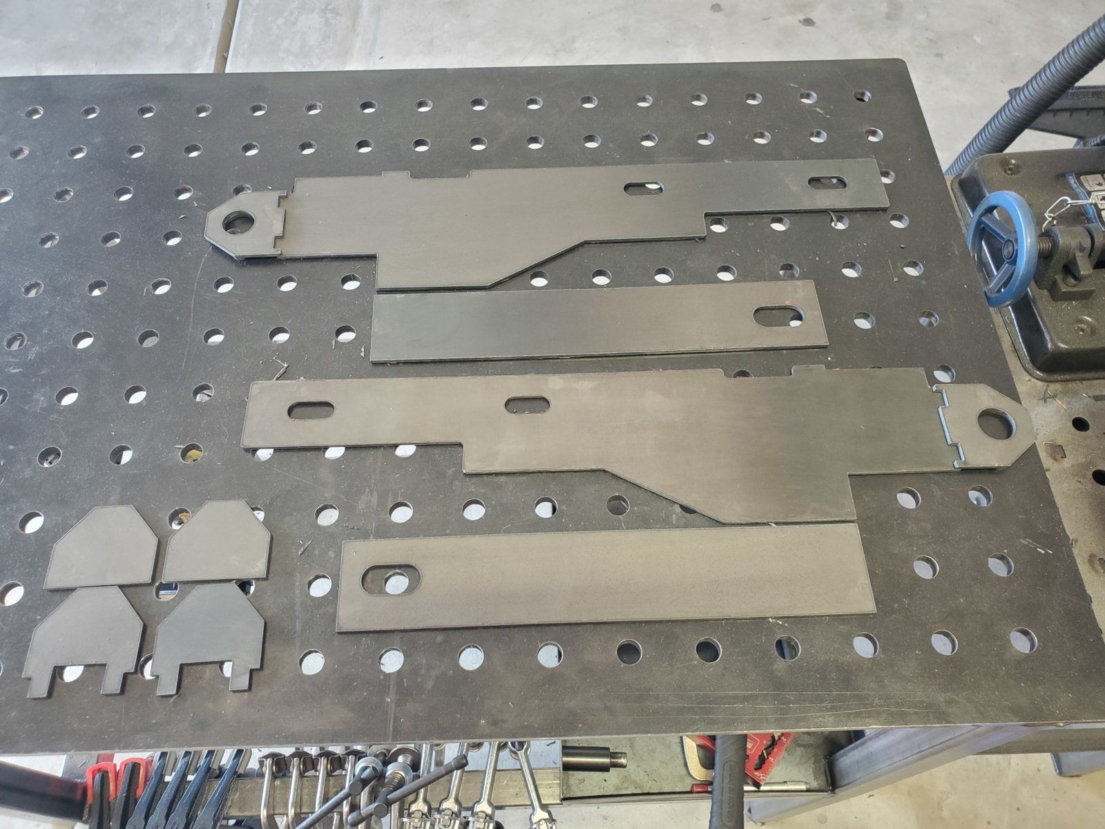

    Cut a few test mount pieces, just need the vehicle here and I'll test and adjustment fitment as needed

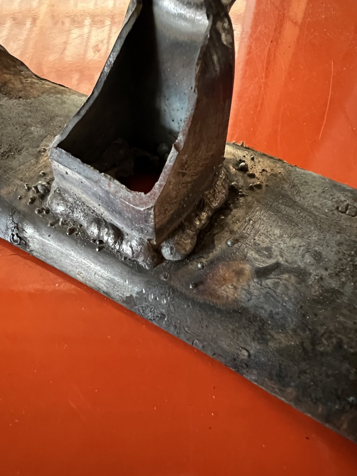

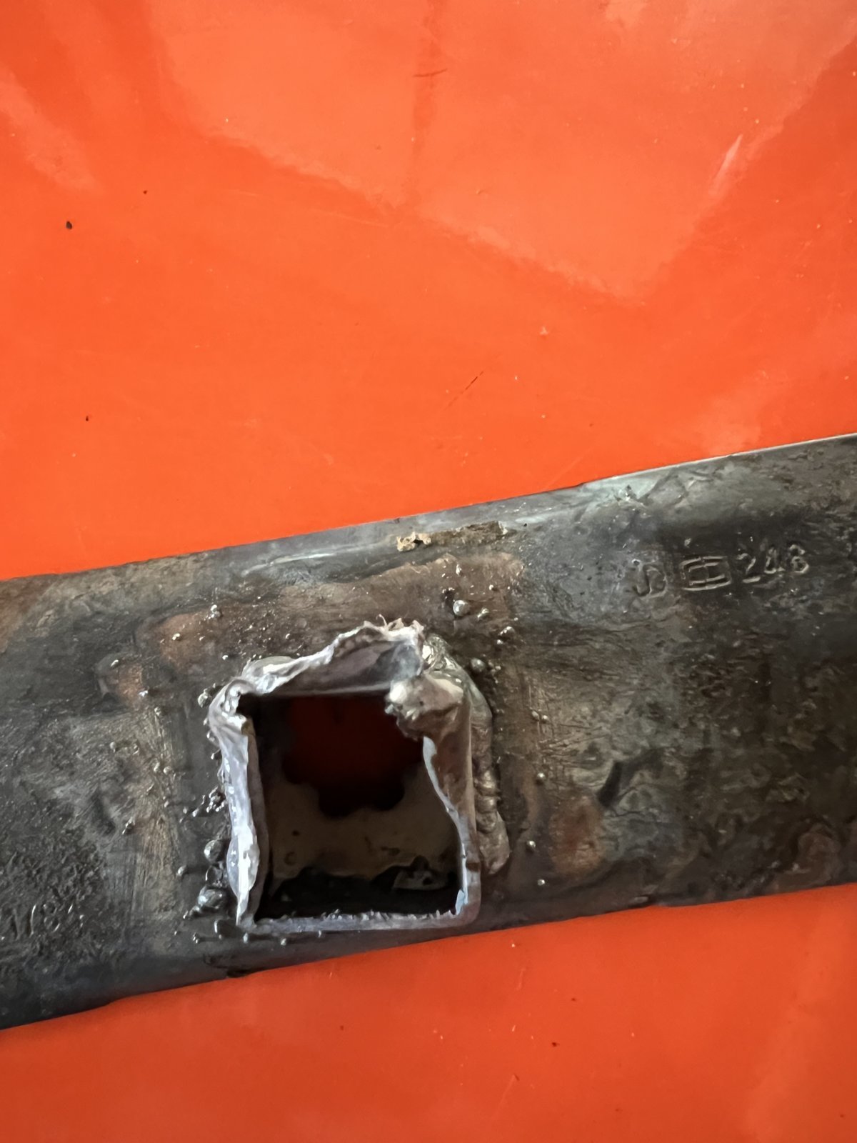

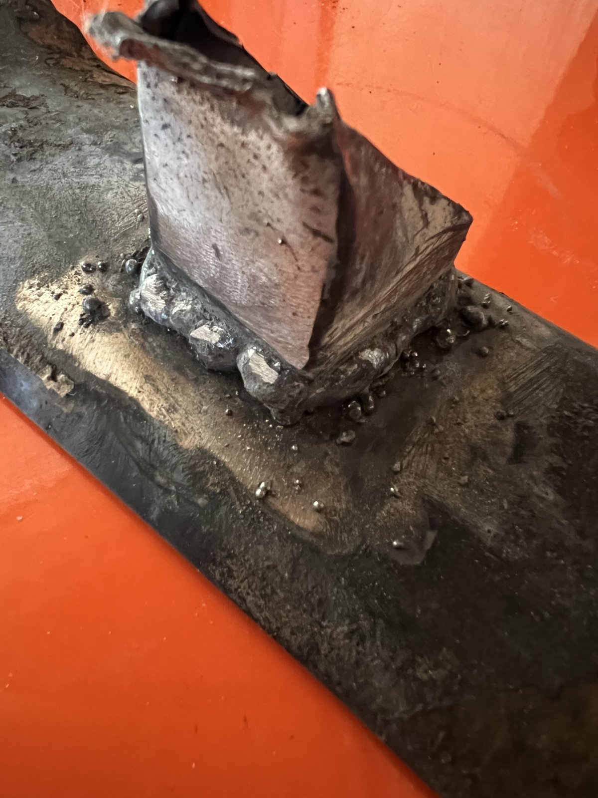

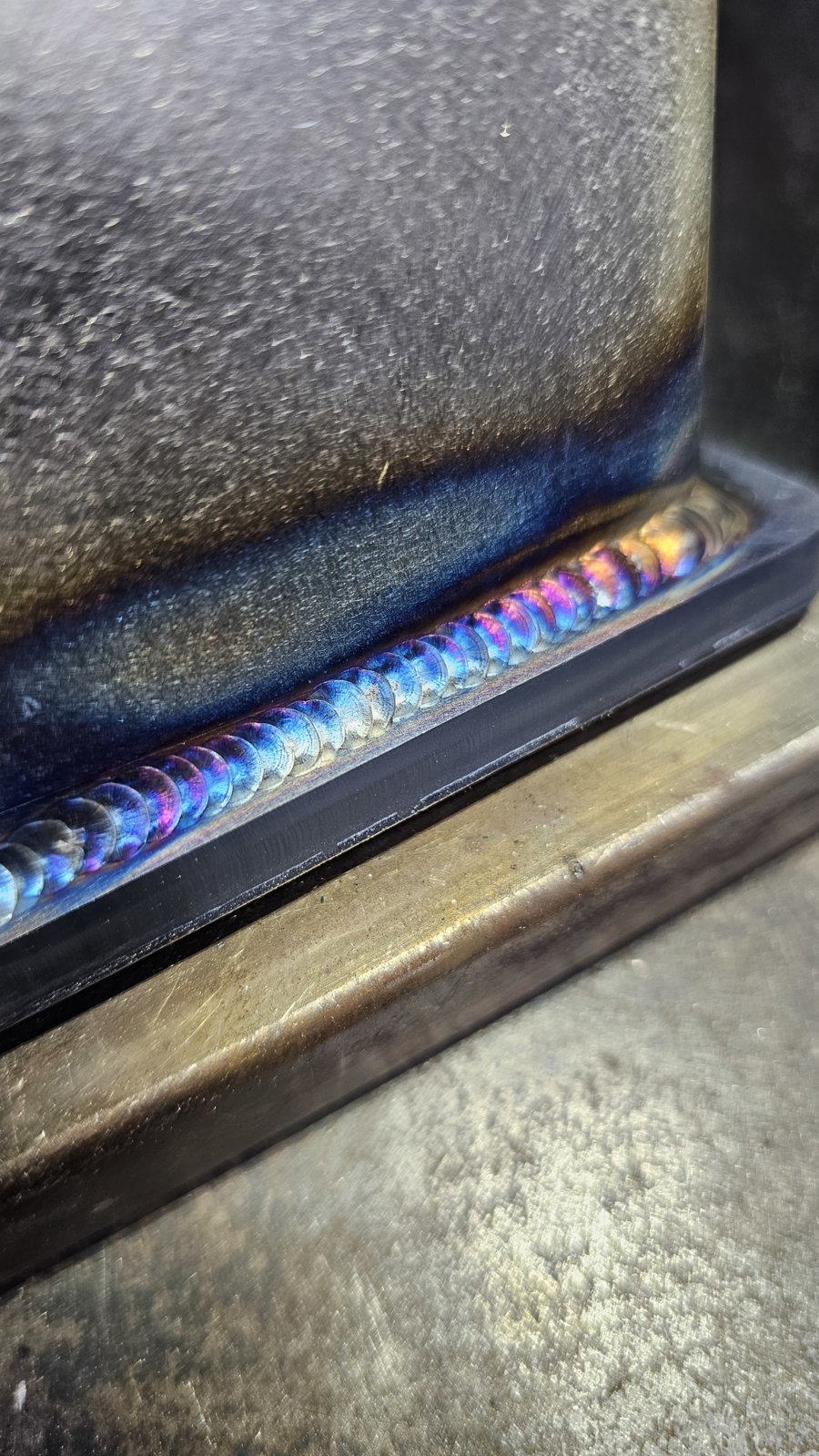

    it doesn't look terrible, but could also definitely be much better. i can see some flow pattern, so it appears you've got a grasp of the technique, but i've got to blame the tool here for the lack of voltage/current control. it looks like you could swing side-to-side more to try to get the puddle to better wick into the metals, but when it's only wire speed you've got to manage, it might be too much to ask of it.
    what hood were you using? I generally prefer to run around a shade 9, it helps me better see the puddle and how it's interacting with the two materials. When I first started, I was trying to use a shade 15, which made everything worse

    I don't really see a benefit to classes. There's really no substitute for just spending time with the welder.
    Biggest thing is to understand what a good/ bad weld is, and what adjustment is needed to correct it. Welding is usually more personal technique than it is machine setup in most cases.

    Thanks for the encouragement; no idea on the hood, just borrowed dad's stuff for a day to piddle around with. He doesn't seem to be using it at all anymore, so I may try to borrow it a little more often and try to play with different wire speeds, maybe some thinner scraps of metal to at least try and get some cleaner passes. I've got a little project I want to do with lots of 2x2" square tubing, so I'd like to at least learn how to make things structurally "good" on some scrap stuff before even beginning the project. If his welder doesn't seem to be fit for the job after a few more weekends playing with it, I may need to look into buying another "nicer" cheaper unit.

    i definitely think a different welder is in your best interest. given the price point you're at ('cheap'), i would advise looking mostly for new gear, as used gear, seems most everyone wants retail prices anyways, at least until one gets into name-brand $1k+ units.
    as always, watch the specials, plenty of sales everywhere at different times, but be careful as it seems many more retailers are starting to do the whole 'mark it up to be able to mark it down' sort-of-sale, so watch sale and non-sale pricing.
    i had started with a titanium easyflux 125, . big advantage is the price, disadvantage is that it's flux core only--meaning you must change welders if you ever want to do anything more like mig welding, and the leads are integral to the unit. flux core is different in that the 'smoke' from welding is really what's acting as the shielding gas. so it benefits from longer passes. shorter passes tend to have more issues because the 'shielding gas' hasn't accumulated. it also means more clean up, post weld.
    but an important note here-- some flux core wire is just bad. the first spool that came with the welder, i tried everything and just finally assumed that was what welding was. no amount of settings changes or adjustments got the 'crackling bacon' sound, and most welds were not great. i finished off the spool, installed a new spool of the same brand, just different purchase date, and suddenly all the same settings got me the great welds with the characteristic sound traits. so if things seem off no matter the adjustment, save the time pulling your hair out and try a new spool.
    these days i'm using a eastwood mig 90 at home. found it on an end-of-season sale, and selling off the titanium to my brother in law, it cost me all of about $20 for the changeover.
    https://www.eastwood.com/eastwood-90-amp-mig-welder.html
    biggest reason for the change is better adjustment, and further options, as well as more standard tweco consumables. the swappable positive/negative leads are a great option for different materials--changing the polarity changes the way the wire either gets 'pulled' into the puddle, or 'pushed' into the puddle, which changes how the puddle reacts. the other big reason for the change was MIG capability. cleaning flux welds is a pain. MIG is an additional $200+ investment in a tank+gas, but results in much cleaner welds with less post-cleaning. i just got a tank, but the weather hasn't agreed enough to change the welder over to MIG duties.
    knowing what i know now, i wish i had gotten something a little better than the eastwood. it's functional, and does exactly what i need it to, but considering the primeweld mig180 does all the same things, but also comes with a spool gun, and stick welder options, as well as a slightly better duty cycle, i wish i had splurged a little more for the further capability, if nothing else, to satisfy my own curiosity on other welding methods-- i can deal with me not being good at something, but i hate bumping against design limitations of products i use.
