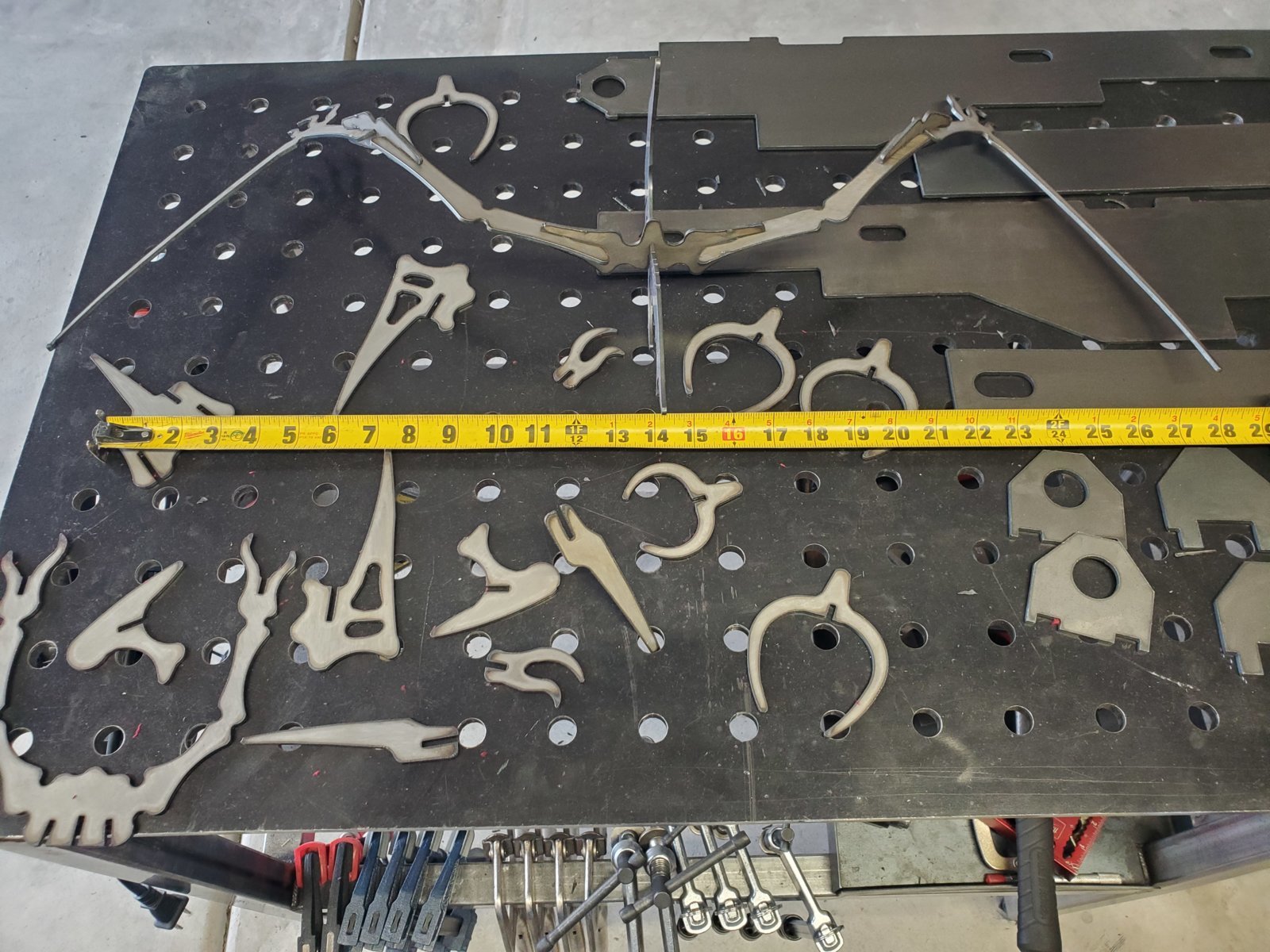

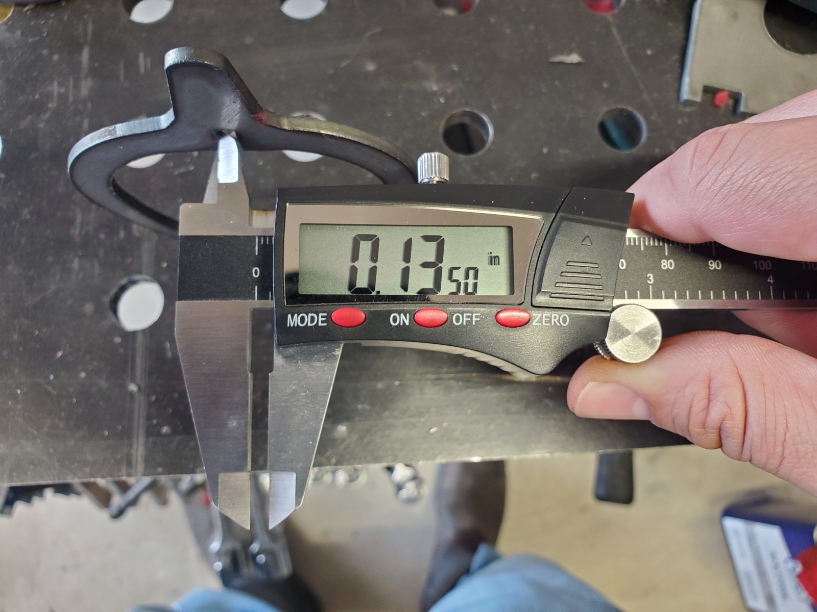

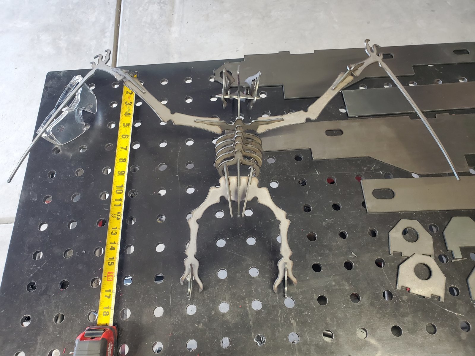

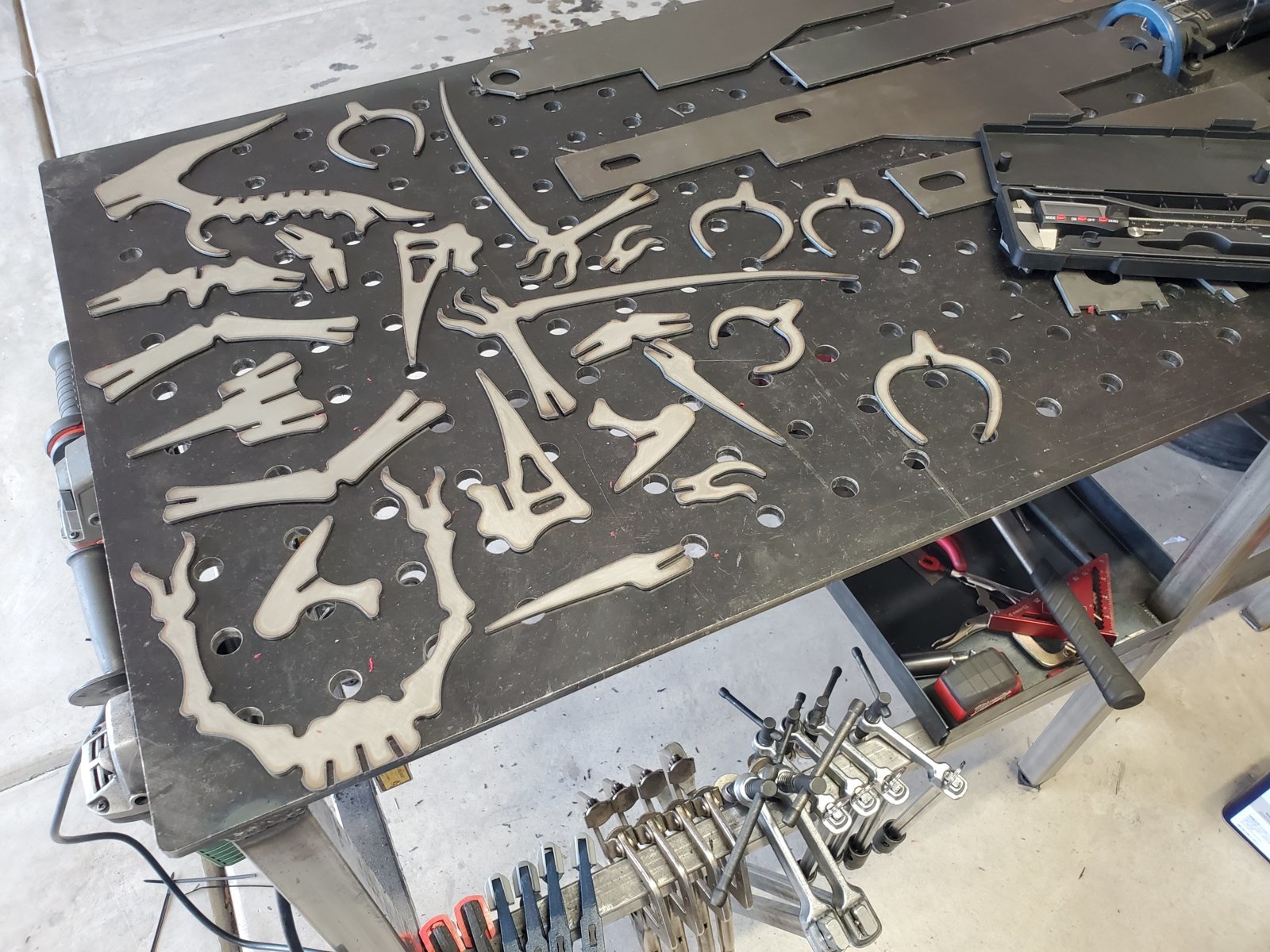

    Nice to see I can bring over my .02" tolerance to 12 gauge as well when cutting slotted items

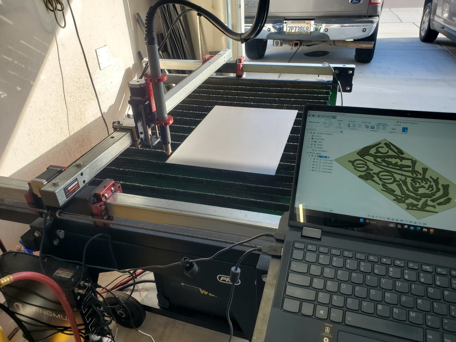

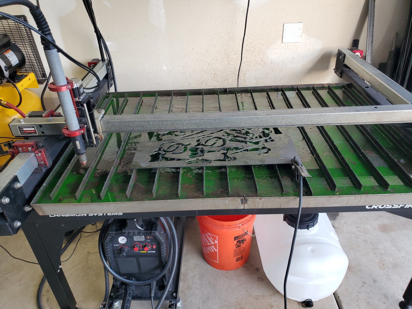

    This smaller and lighter model sits at 28" wide and only 17.75" long
    All while only occupying 21" x 15"

    This only encourages me to cut down my table.
    The 5 x 5 is just too big for my hobbyist ass. (7 x 6 with the random protrusions).
    Gonna start with chopping it to 2.5 x 5.
    The 5 x 5 eats up 36+ square foot of my shop. I got too many other skills that require real state to let the table eat into.

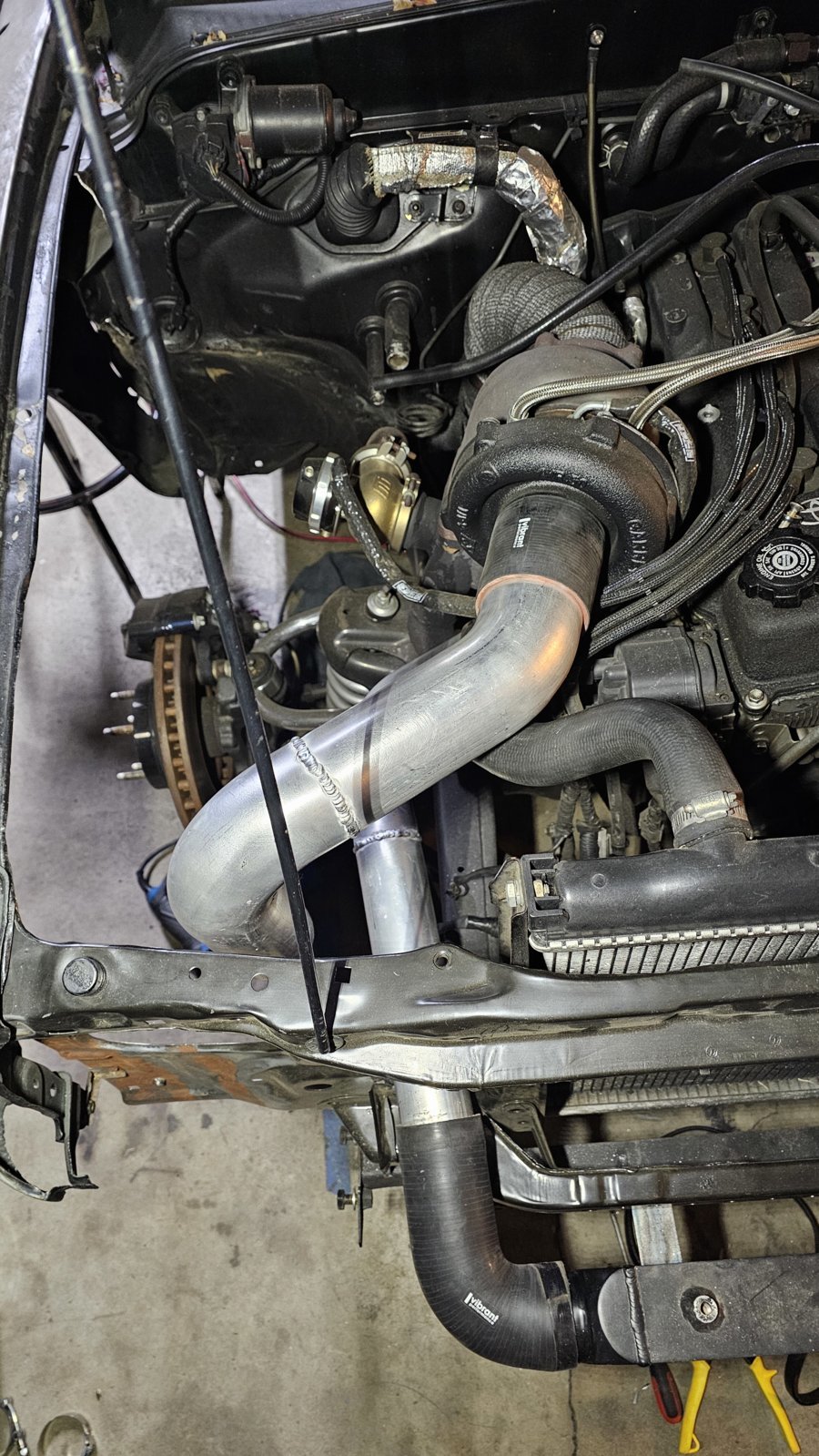

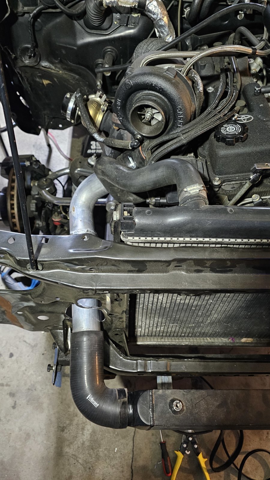

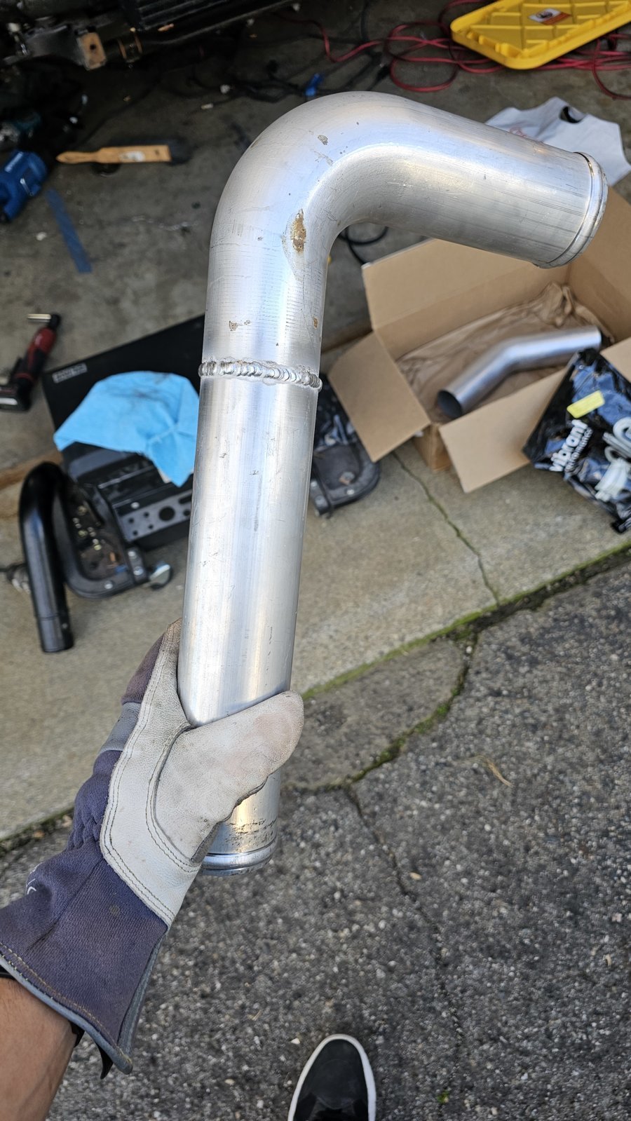

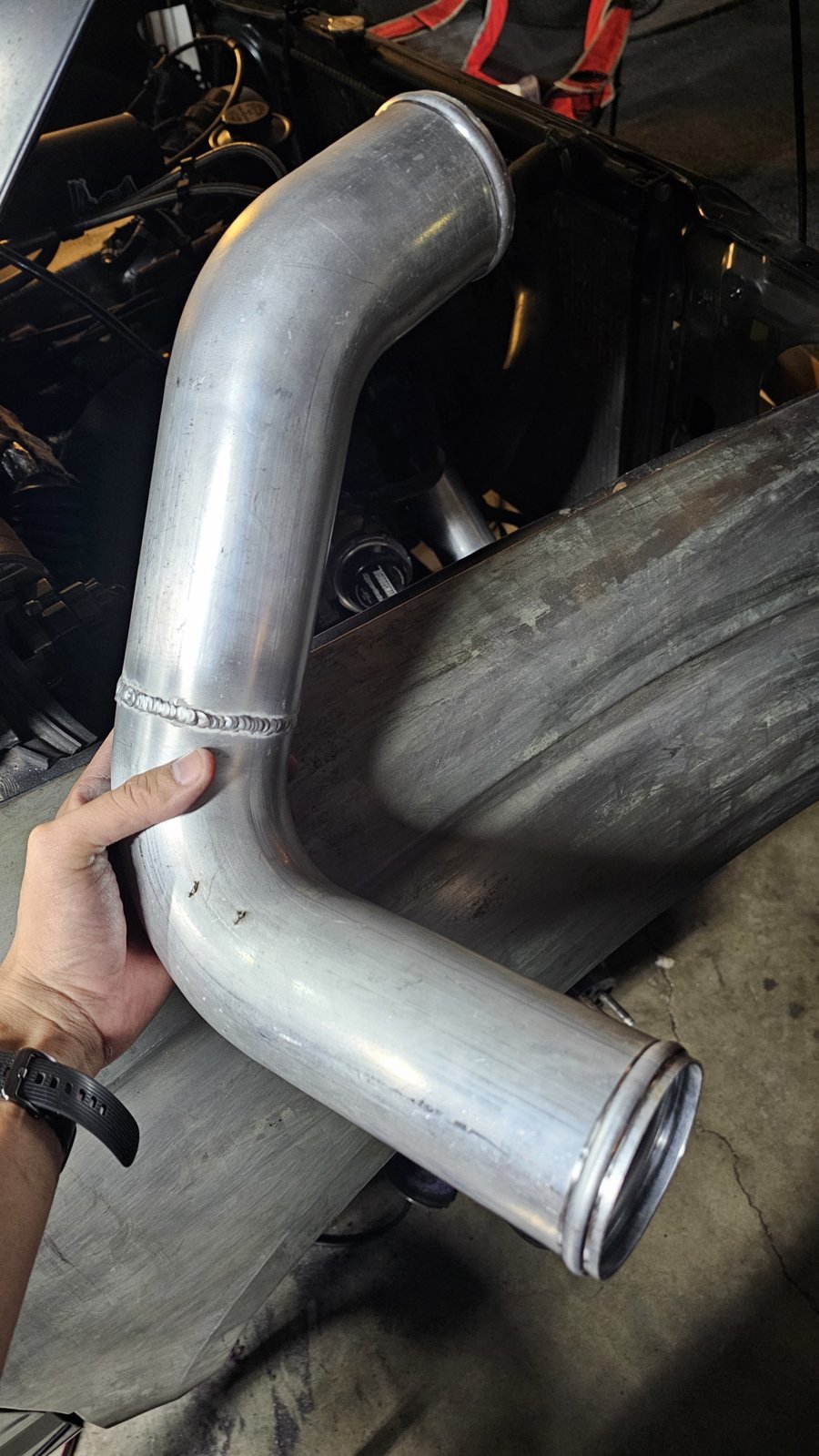

    Started remaking my intercooler piping and intake. I suck at aluminum lol

    Fitment has to be damn near perfect; I'd call it good because a lot of people normally go too slow and/or use too much filler and run cold.
    And when I say a lot of people, I mean people just starting out on aluminum.

    I dropped on of the pipes like an idiot so fitment was pretty bad on the intake lol. Had to tack it together and try to shape it back into place. Horrible haha

    I dunno?
    Situations like this make me wonder.
    The welds look fine. Actually much better than fine.
    I know you pressure tested them with soapy water to make sure the weld is air tight. That's more important than the visual. Burning a hole in piston because it was running lean is gonna be a bigger mess than having a " machine weld".
    We have so many pictures of beautiful welds, we start to judge ourselves much harder than we should.
    No one but yourself is ever going to see those welds and say " they should have been better".
    All those weld "porns" we see were usually done by a pro who only does that particular weld over and over again.
    Give the same cat your 2 pieces and tell him to make them look just like yours and it isn't gonna happen.
    Your welds are great!

    Thanks man! And yeah I know it's like woman and beauty standards these days lol. Just being a bit critical of myself. Appreciate the encouraging words.
