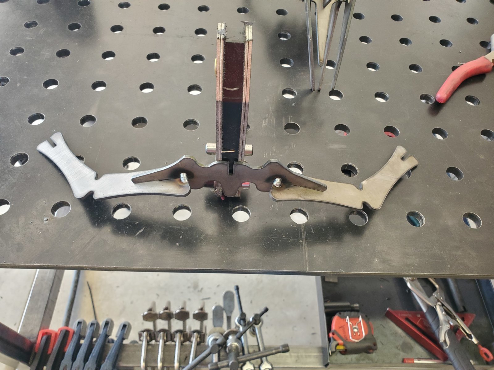

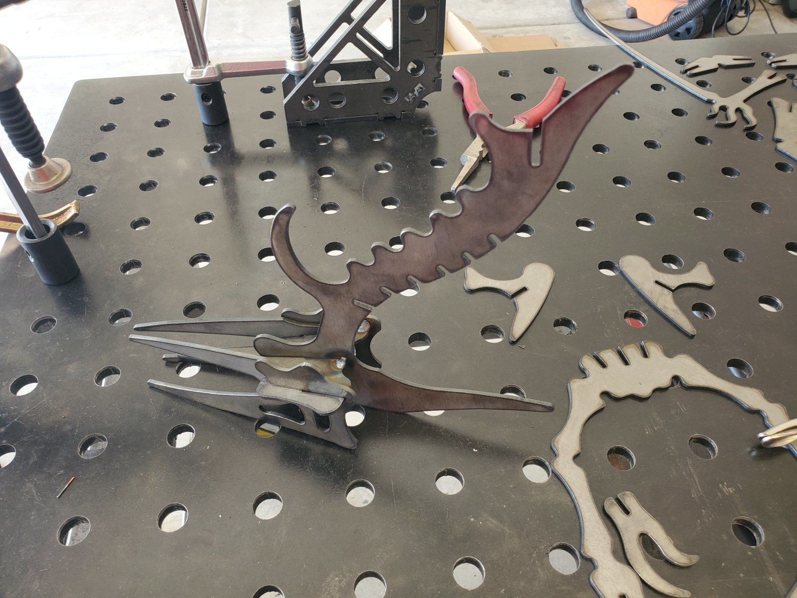

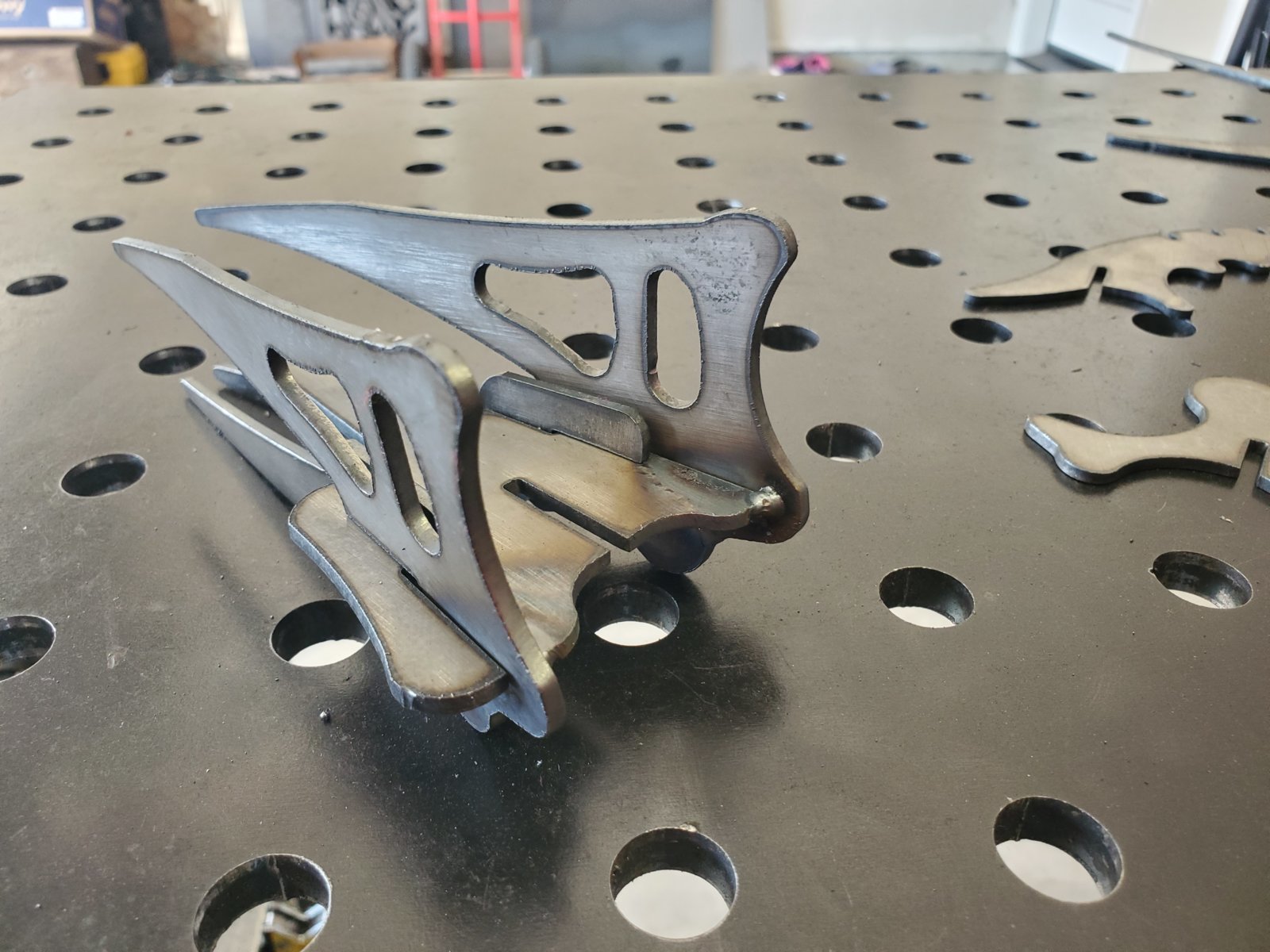

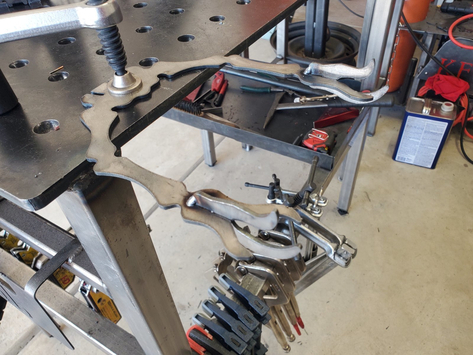

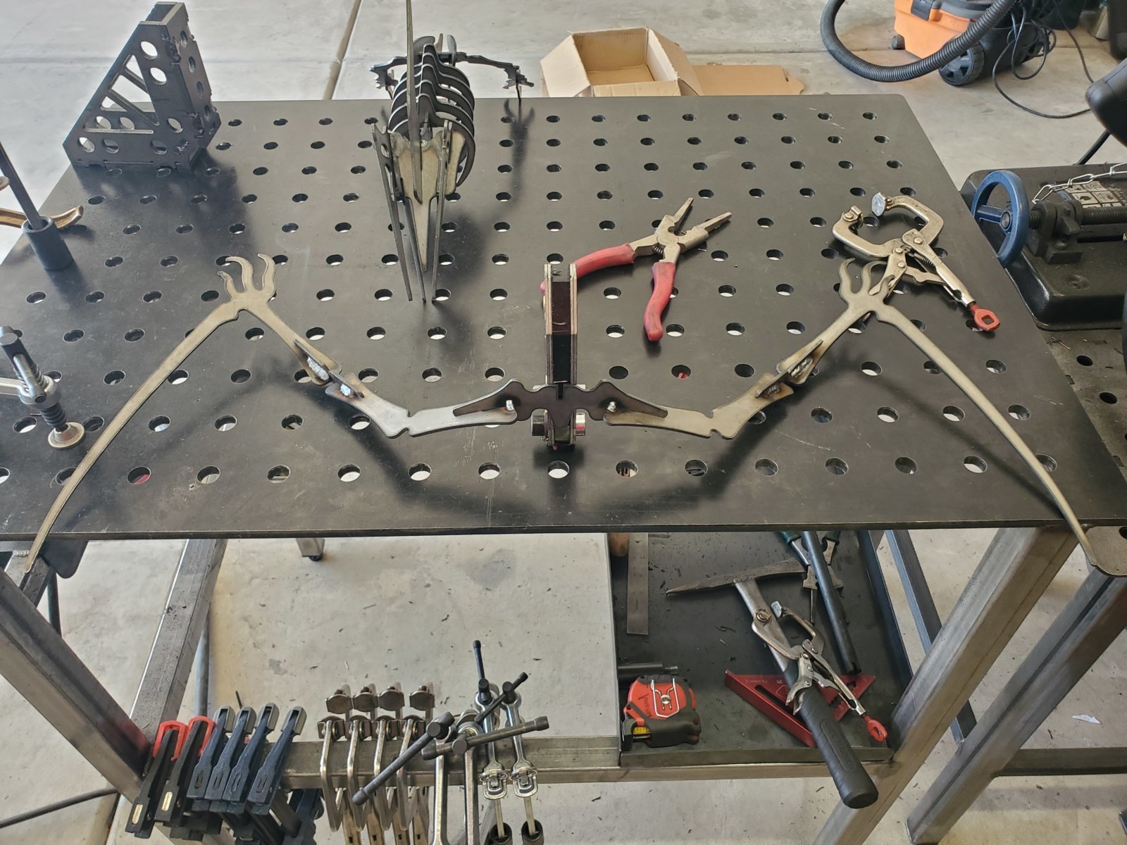

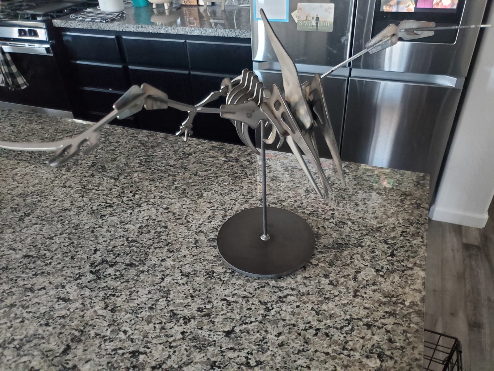

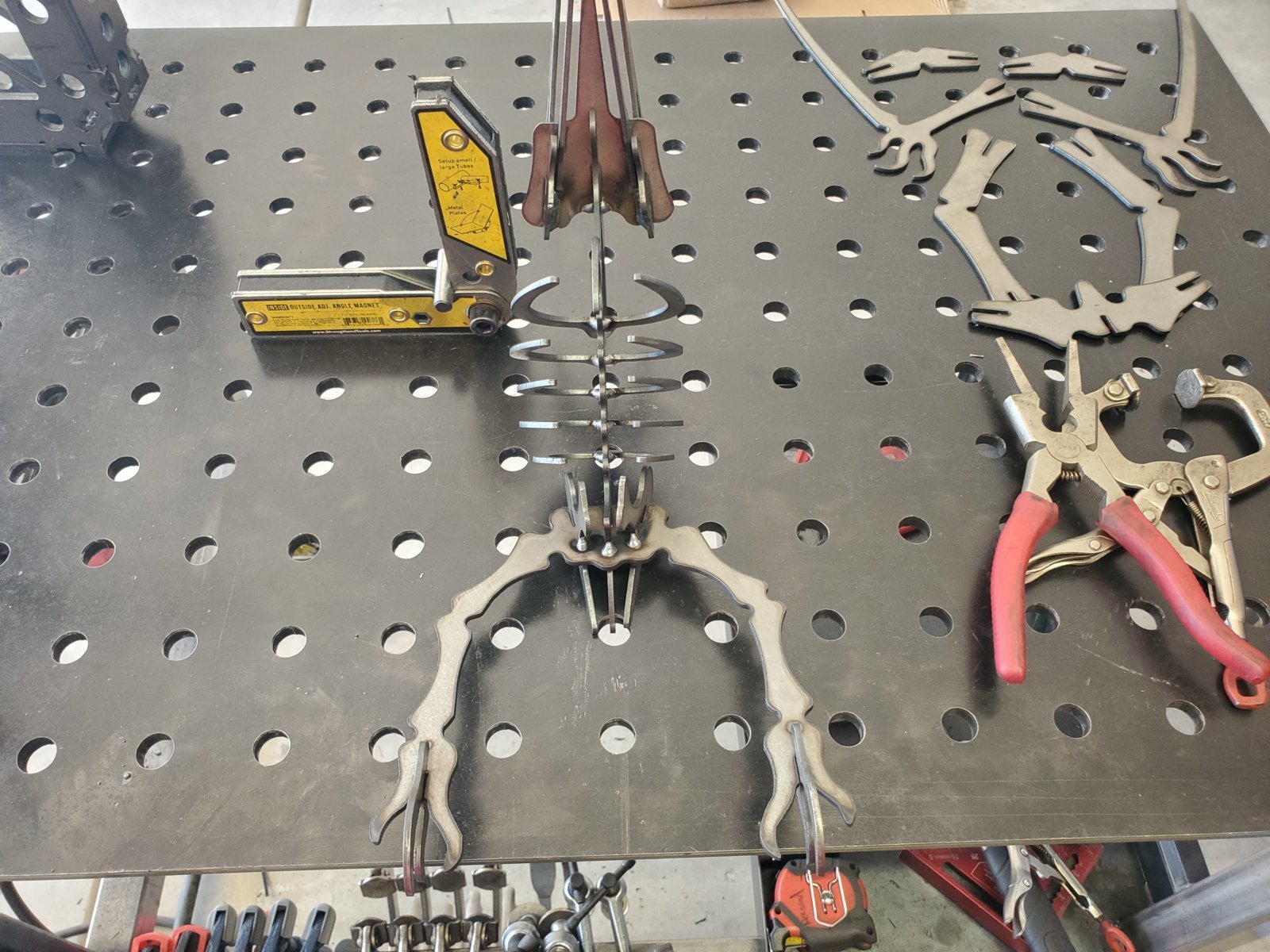

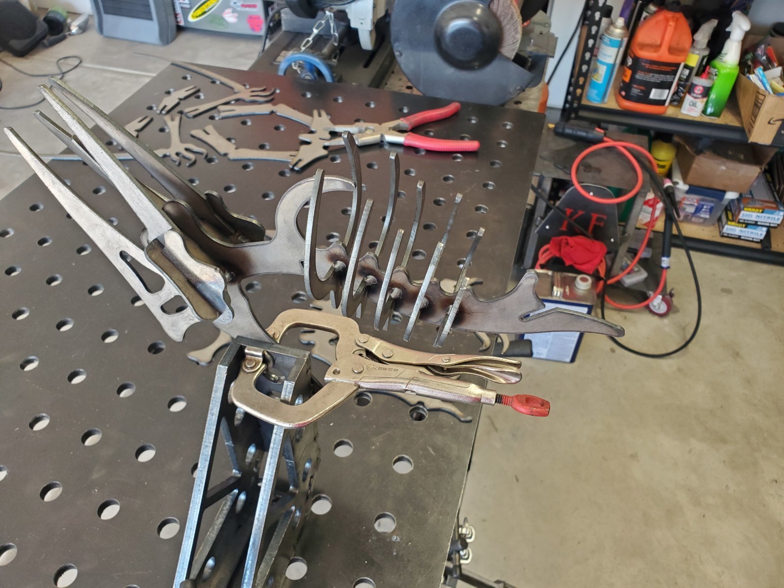

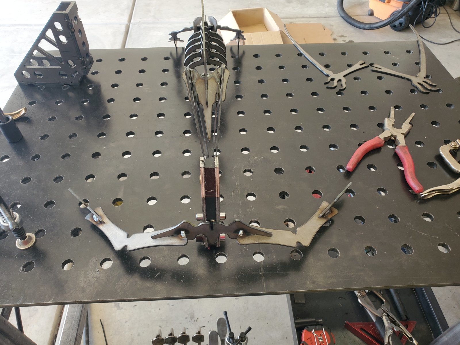

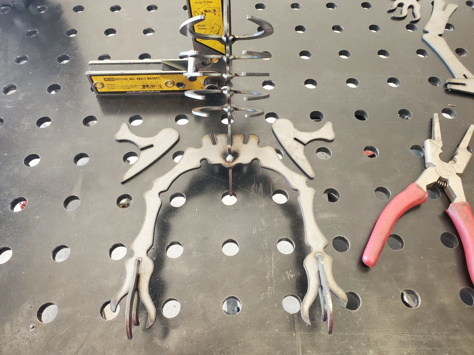

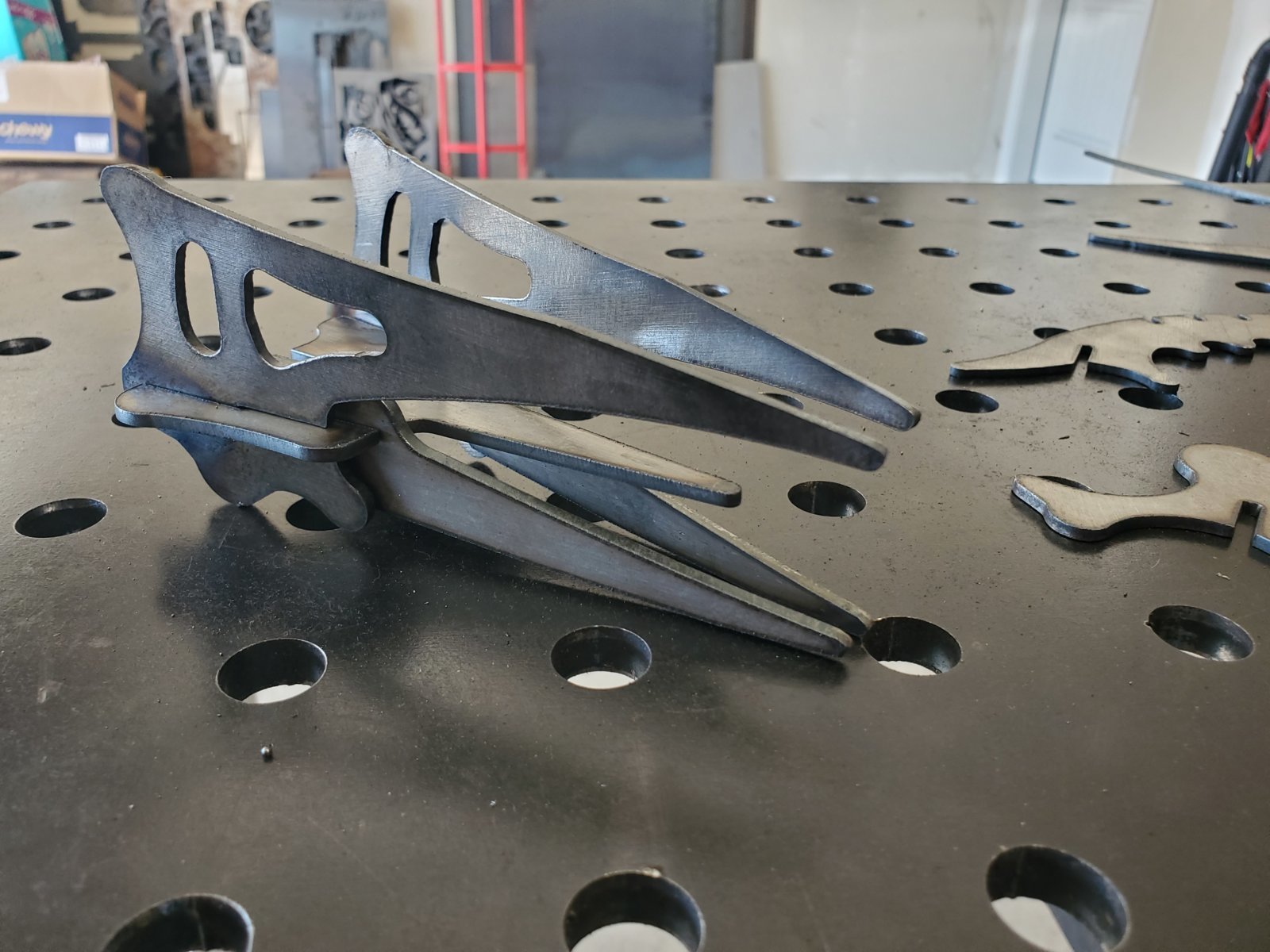

    Mainly posting because I wanted to document some sort of 'instruction' as I sell these 3D kits for those wanting to weld it themselves; I sell the physical components (whether welded or not) but do not own rights to the design so posting it here for those wanting to cut their own.
    This is basically how the groups are separated -
    Start with the head, as these components slide together easily for tacking it together.
    I suggest doing this first as it would be harder slotting and tack welding these pieces if you tack the main piece to the spine too early -
    Many of these pictures will show the assembly is upside down; I intend to place this on a desk so I wish to hide the welds and place everything either behind or underneath -
    Next step is now attaching it to the spine; little things like a 90 degree magnet or some sort of square means you can ensure everything is aligned before welding -
    Next is the rib cage, from front to back you want to use the largest set of ribs and go smaller as you move towards the rear.
    An important step here is that the first rib begins on the second slot; the first slot is for the wings -
    Set aside your partially assembled bird and move on to the legs by attaching the bottom claws; again I'm placing all my welds on the bottom/underside of my assembly -
    Now comes time to attach the pelvic area to the spine; magnets are your friend in keeping everything aligned -
    Tack on the remainder of the pelvis -

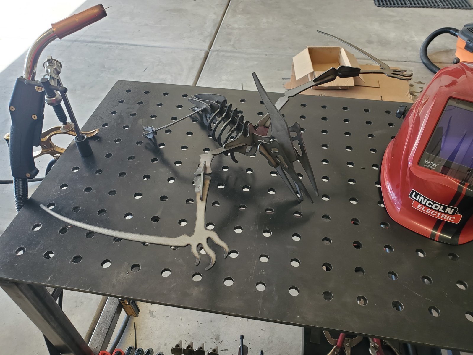

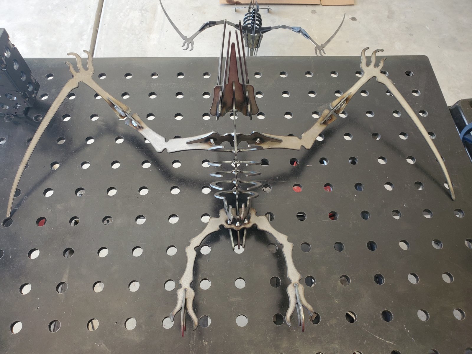

    Moving onto the wings; I like to assemble items right-side up before I turn them over for tack welding -
    Next comes the joints -
    And now your wings are done -
    Put it all together and you're good to go -
    Whole thing is like a 5 minute job -
    I'll be creating a small base and welding some rod for a "stand up" piece but you can get as creative as you like with these! Some people even hang them up.
    The smaller 12 gauge variety is much lighter and definitely takes up less metal so I'd be inclined to sell a few sets, just figured my larger 10 gauge variety would be more appealing. I like to cut these kits with .02" extra play for a nice and easy fitment.
    *DISCLAIMER* The provided DXF is not nested nor sized to any specific gauge steel. It is up to you to nest and scale appropriately due to your table's cut parameters and thickness metal preferred.

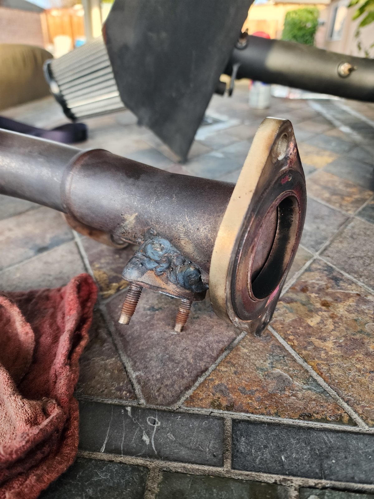

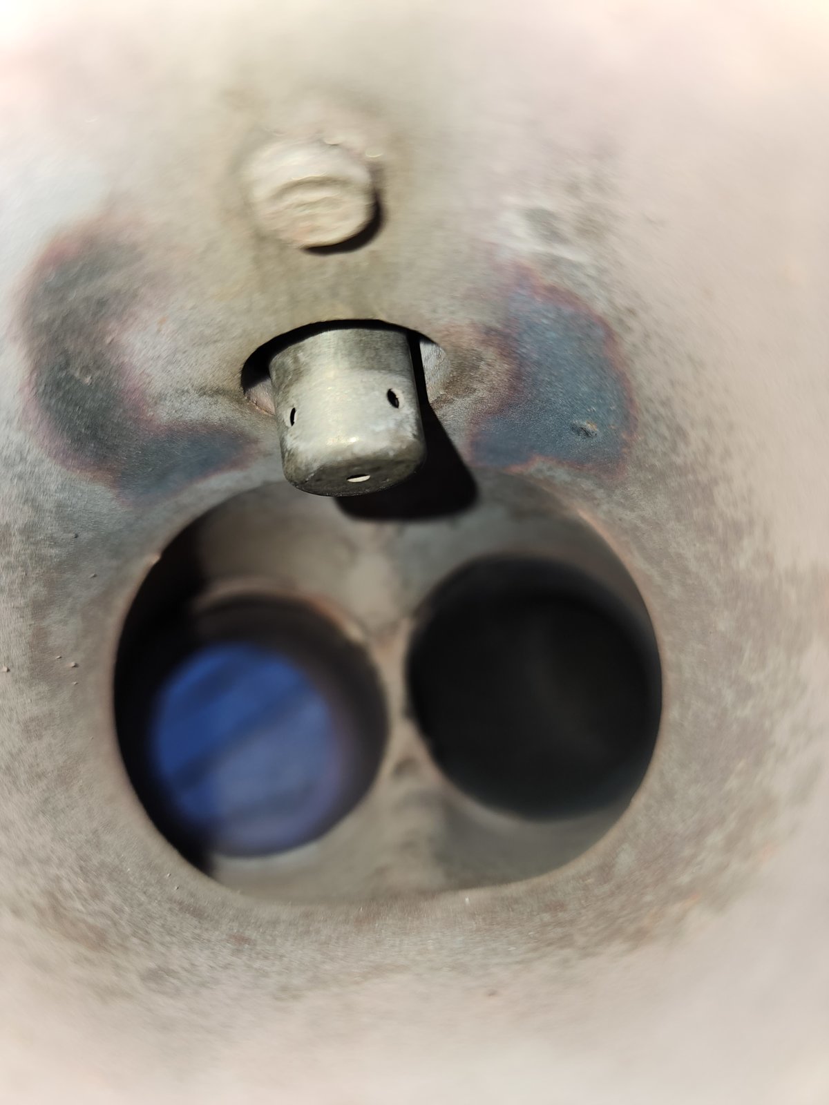

    I have a really newb question for you guys and I'm hoping that I came to the right place. I am not a welder nor have I ever attempted to weld anything and my knowledge about welding is not so great. I have done a bit of soldering with electronics so my question is this...
    Does applied weld melt down with enough heat similar to how solder does? Enough so to be able to pull off a welded part?
    A bit of background: I am wanting to undo a sloppy mess that a local exhaust shop did on my TRD headers y-pipe bung. My truck has gone from my daily driver to now my project truck as I'm doing an engine swap and using this downtime as finally being able to get this as well as other things on my truck fixed. I've reached out to a couple shops where they have quoted me $250 for about 2 hours of labor and would basically require cutting out the entire bung area and welding on a new one. The thought of undoing the weld or possibly just cutting and grinding came to mind today.
    I'm sure pictures will help provide answers or suggestions. Thanks in advance

    Most reasonable method is simply cutting it off and welding a new one. That area is too small to do some plasma gouging.

    That's what I am thinking I may end up having to do. Luckily the original bung is below that slop and so I just need to cut it down enough to expose the original bung then I'll be able to extract the broken stud which is what I wish I would have been able to do in the first place. So is my original question not doable? Is there any way to soften the weld or melt it with extreme heat?

    There's arc gouging, which uses a stinger, but if you don't know how to run stick you'll have a hard time running one
    It removes weld deposits
    Not in the way that "solder" melts
  13. Feb 26, 2024 at 6:22 PM

    Reason being that weld deposits FUSE with the base metal. That is different from soldering.

    Thank you! Looks like cutting it off is going to be my best bet. Way better option IMO than having a shop cut a hole into the pipe and reweld an entire new bung.

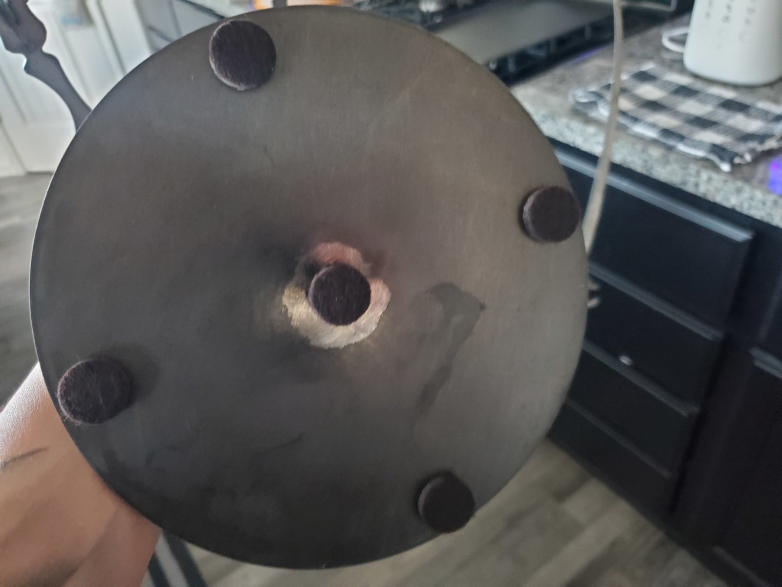

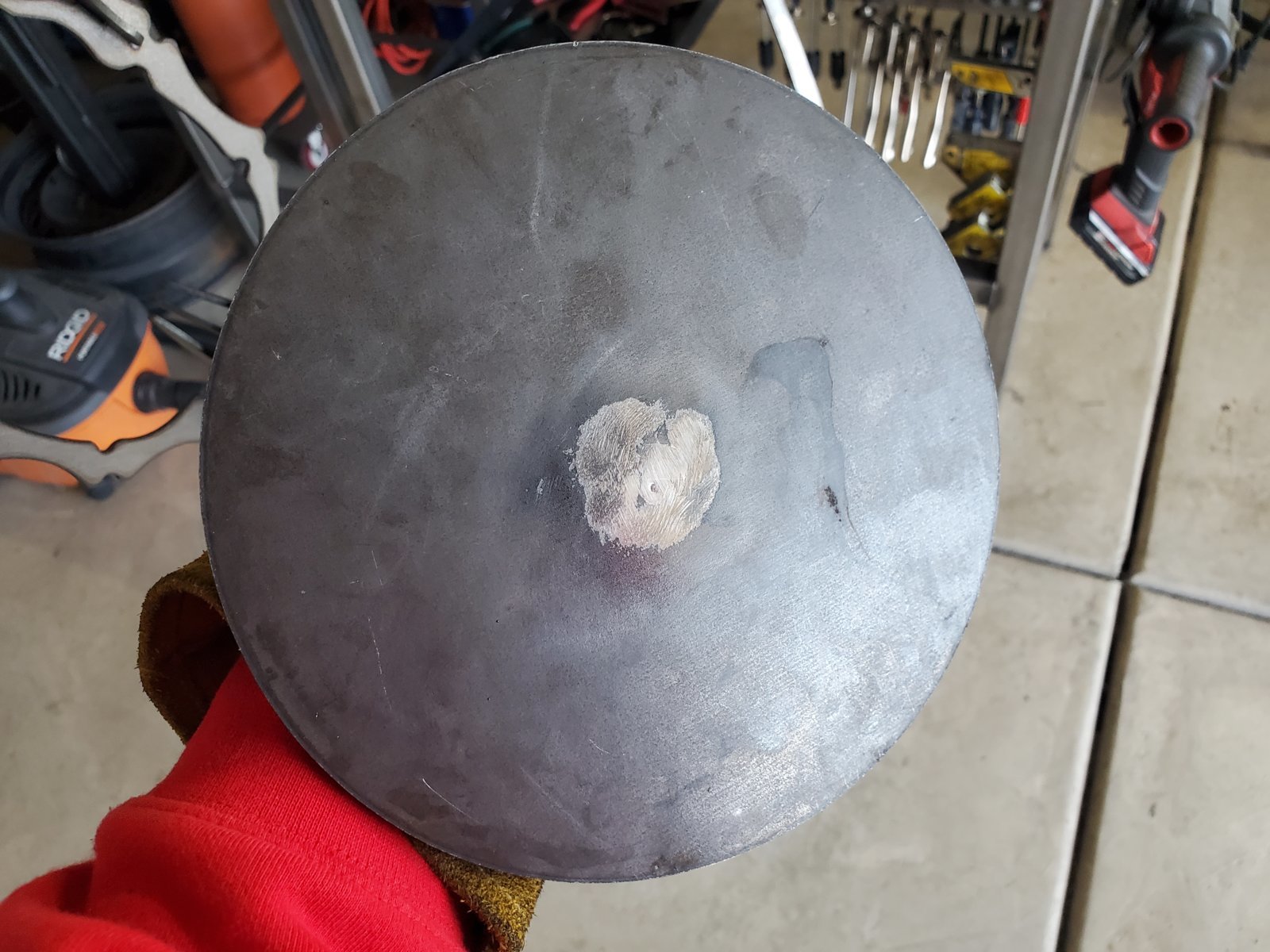

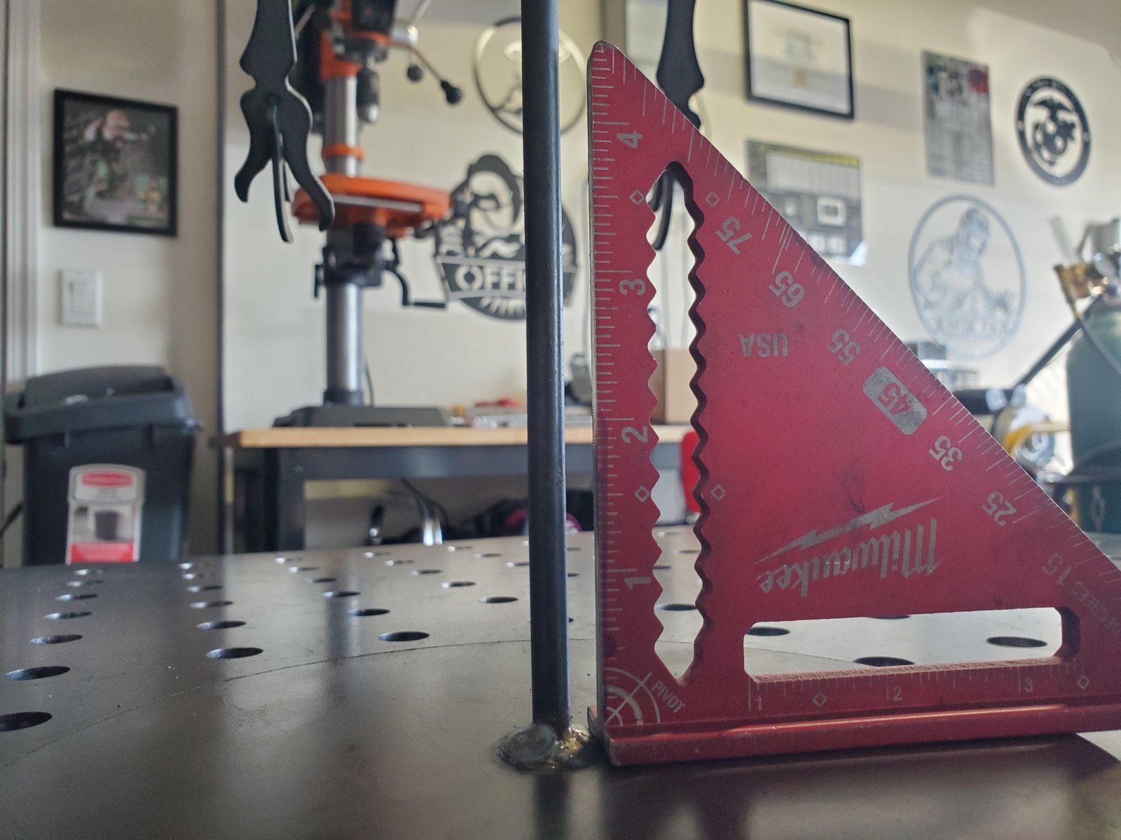

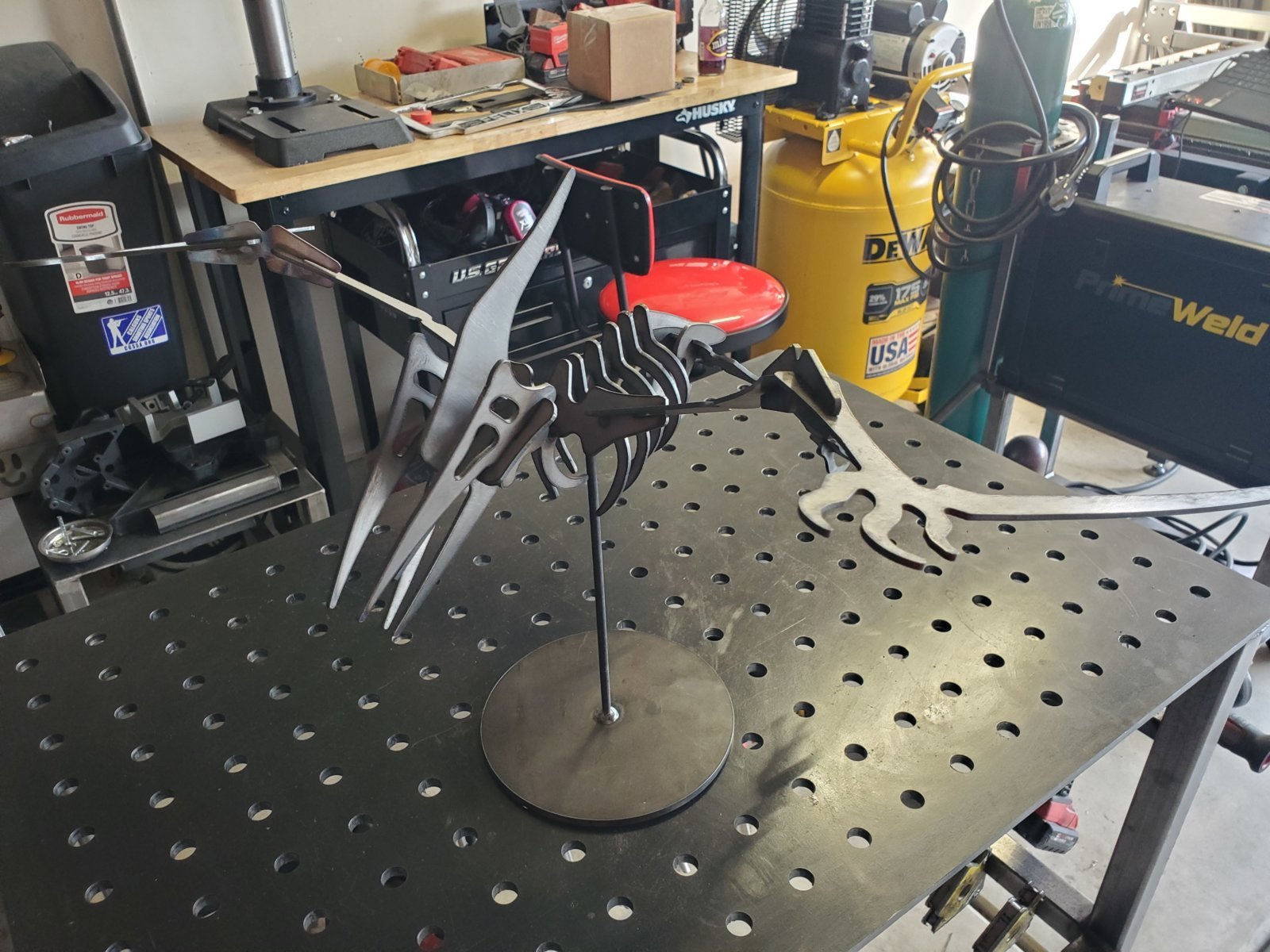

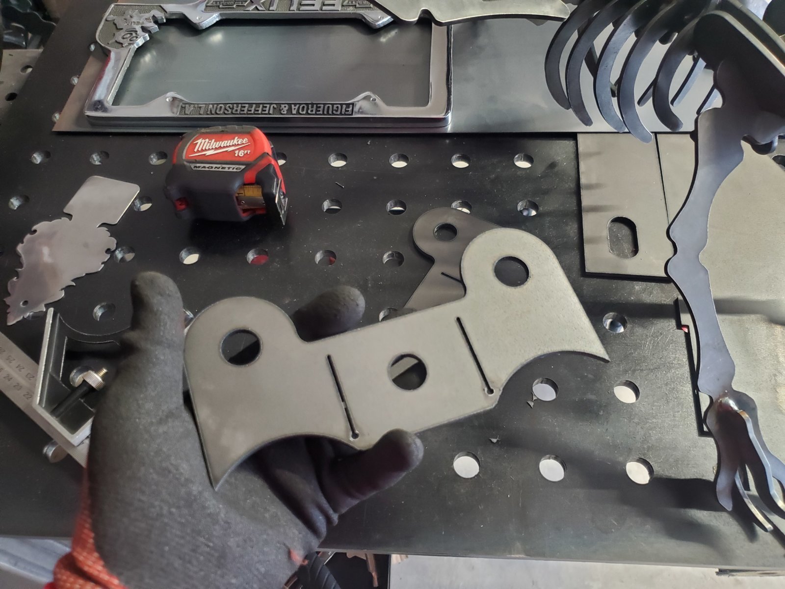

    Got an emergency request yesterday, so cut, bent, and welded these up and they're ready to ship to Canada
    While I cleaned up my garage a little, freaking ADHD got the best of me...so I fired up the air compressor again and did a little something
    Even made sure that shit wasn't canted at all
    Not sure if I should paint it or leave it bare; since it's too big for my wife's desk I'll make her a smaller one
    I know exactly who to gift this to though; one of my customer's that bought a welded dinosaur
