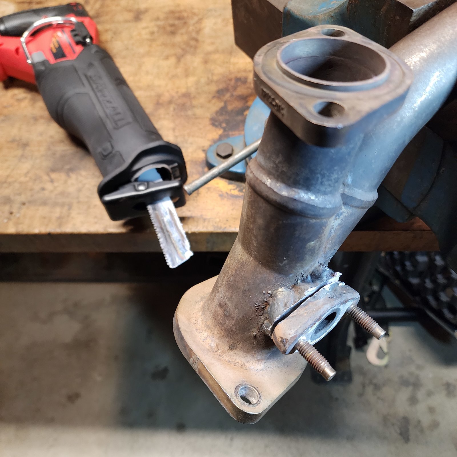

    Thank you for the response and suggestion. So what I ended up doing today was use my sawzall with a carbide blade to cut the welded bung off. My hopes were to cut the welded bung off enough to expose the original bungs stud holes to allow me to drill and extract the broken stud which is what I really wished I could have been able to do in the first place. I snapped a couple of pictures of what I'm dealing with after my cut. Now my plan is just to grind it down to a flat enough surface and cut off all of the sloppy weld around it, extract and tap the stud holes if needed.

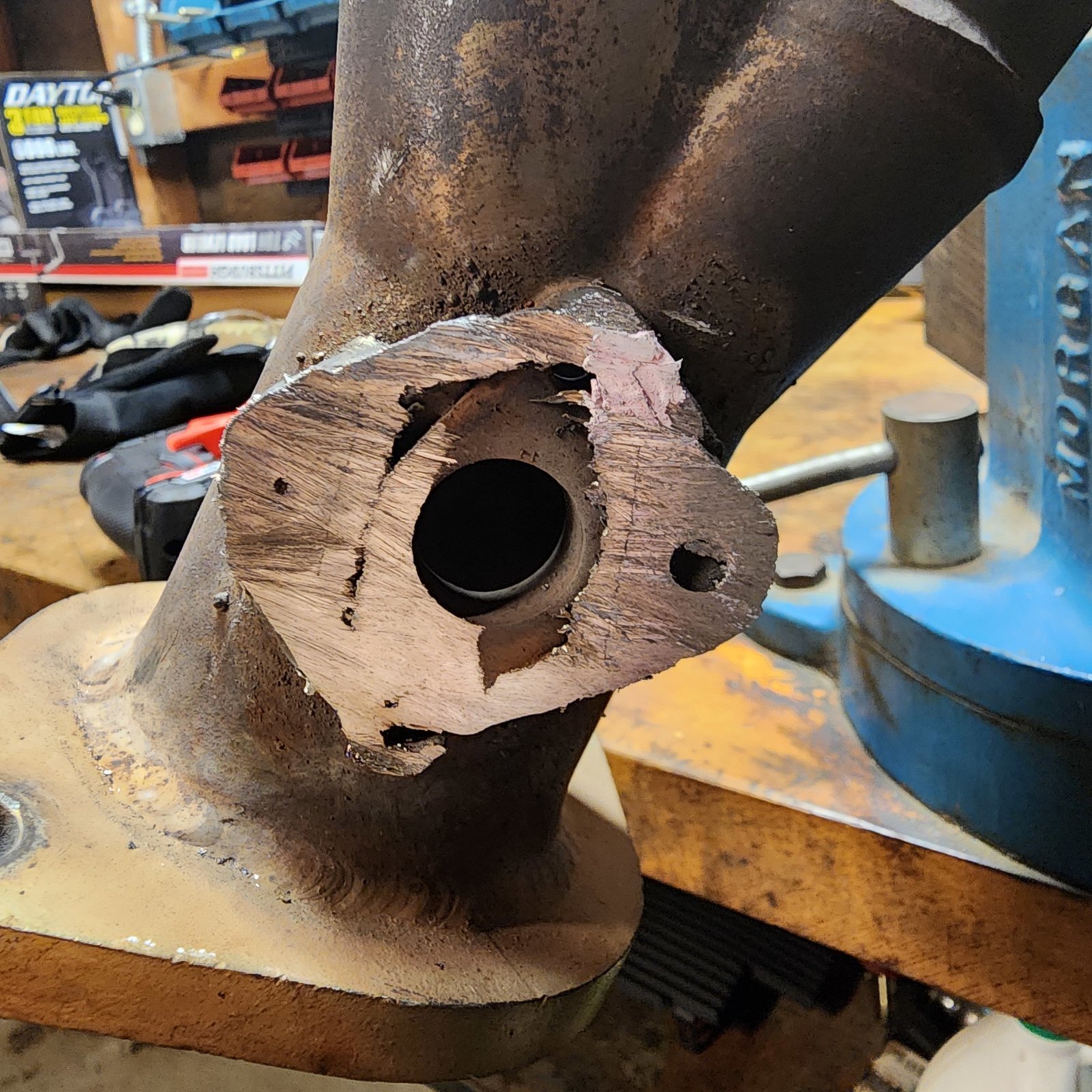

    You can see my cut wasn't dead on straight and I cut into the original bun just slightly But I'm hoping that I'll be able to grind this down to a flat surface to expose the two original stud holes. With that said, I don't have a grinder so I'm looking at buying one but just a small little one, would you guys say that the Milwaukee right angle grinder is good enough for this small job? I might have an opportunity of getting one brand new for $100 that I'm sure I'll probably use for other small projects. And if so what attachment would you recommend for it? It allows for 1-3in discs. Or should I use something bigger?
    I just re-read what you said about the "flapper disc" so I'll just need to get myself a 2inch flapper disc attachment to sand it down enough to get to the original stud holes. :thumbsup: So I may not require any welding. Is this what you would do?

    I would've used a Milwaukee cut-off tool
    Angle grinders are 4.5" and up, the small cut-off tool runs 3" discs
    I have one and have used it a lot for really small bits I've had to cut off in the past

    Looking at it closely once more, yeah I'd be cutting more off with the small cut-off tool I mentioned.
    One cut here -
    Then another one here -
    Flip and repeat as needed on the other side to get the pieces off that overlap the original piece.
    Drainbung likes this.

    i can understand trying to salvage the original bung instead of dealing with other people/services. my advice was centered around the idea of grinding down to raw tubing and replacing the bung entirely. to save part of it takes a slightly different approach.
    my first concern is the angled cut on the existing flange. it's hard to make it out in the pictures-- do you think you can still save the flange for a proper sealing surface? in the pictures, it appears like it's somewhat deep on the 'lower' side, and i'm not entirely sure it can properly seal anymore.
    if it can be saved, i would still mostly grind the rest away with a flap disk. i'd recommend sticking with the 4-1/2" range. 7" tends to be too costly, and 3" or lower, in my experience, tends to be more for 'detail' work, and doesn't do as well with long extended grinding.
    i understand what kwikvette is saying about cutting notches into the weld to remove it with cutoff wheels, but i'm not sure it's all that much faster than only using flap disks to grind the area away...
    i normally use 40 grit flap discs-- it's a moderate balance between a fast cut and a smooth surface. and i highly recommend the low-mid-range harbor freight grinder
