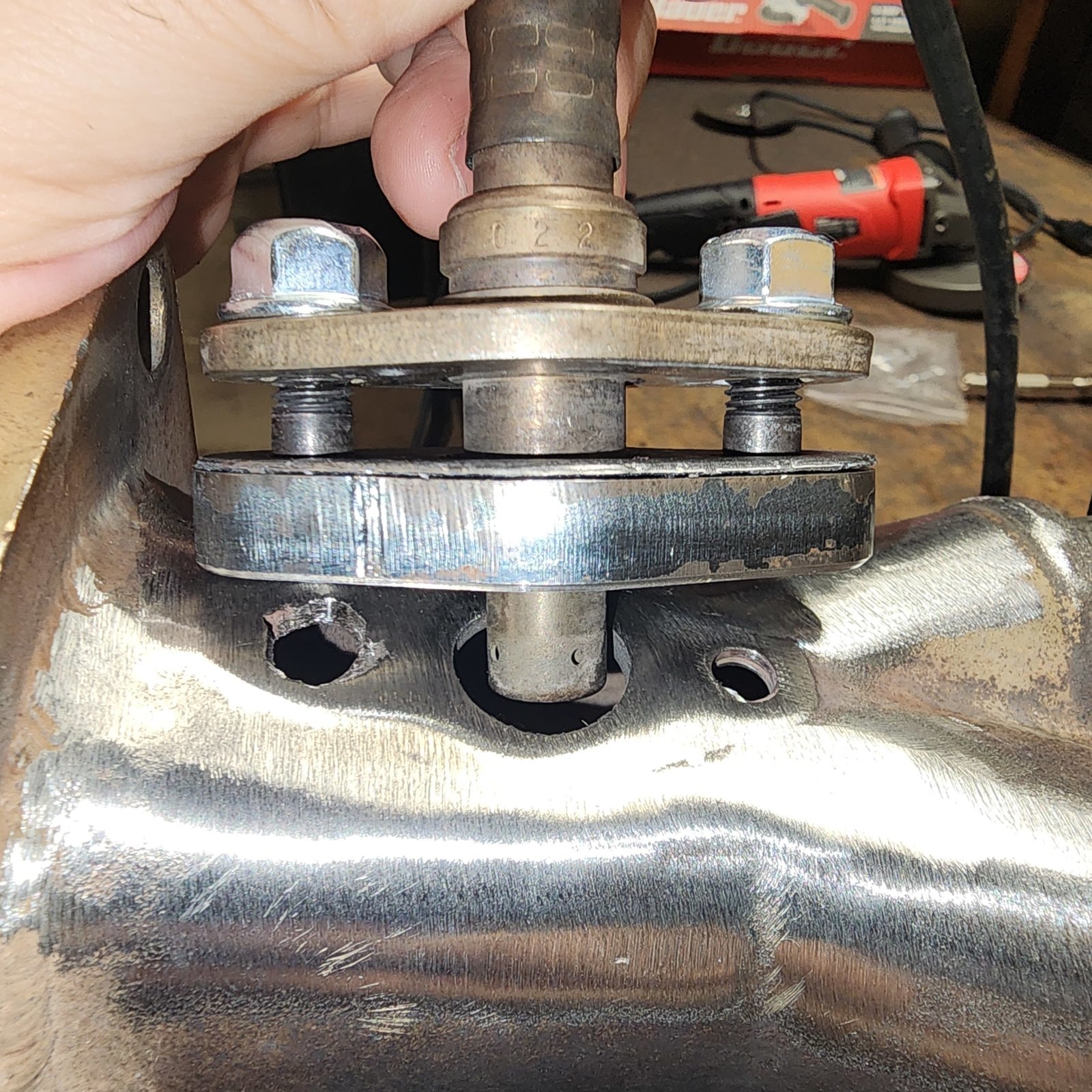

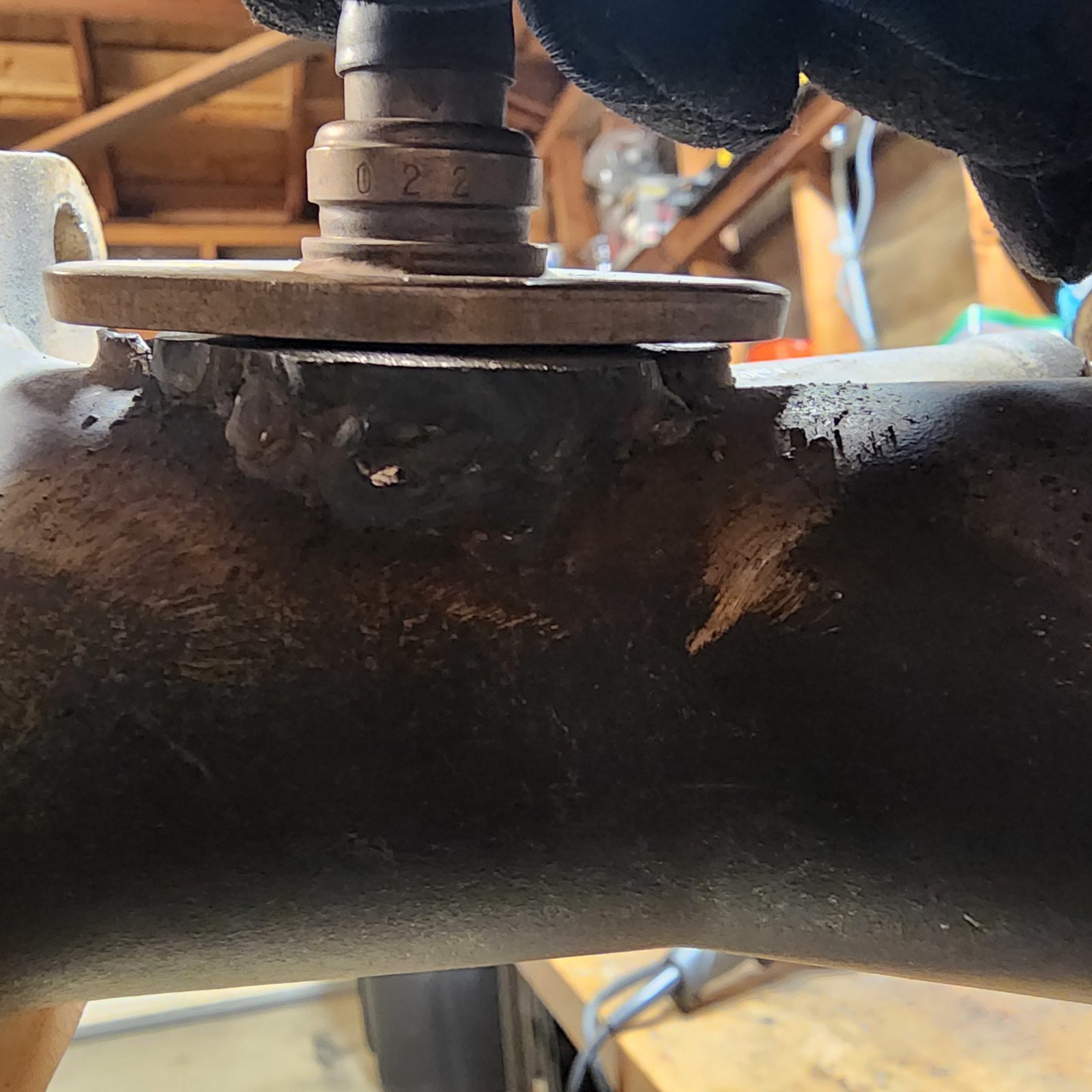

    Just got home from HB with recommended tools. As much as I got my eyes set on that lil Milwaukee angle grinder, that'll have to wait for another day. I'm feeling good about the 4.5 vs something smaller because of the cut I kinda messed up on. I did end up cutting into the original bungs so I'll have to see about leveling the whole thing out to get a proper flush seating of the sensor.20240229_181642.jpg
    I just hope I don't f this up! :eek:
    Drainbung and KRAMERICA like this.

    Worst case scenario, you have to cut the original bung out and have a good welder put in a new one that doesn't suck ass...

    :eek: I hope I can avoid that.

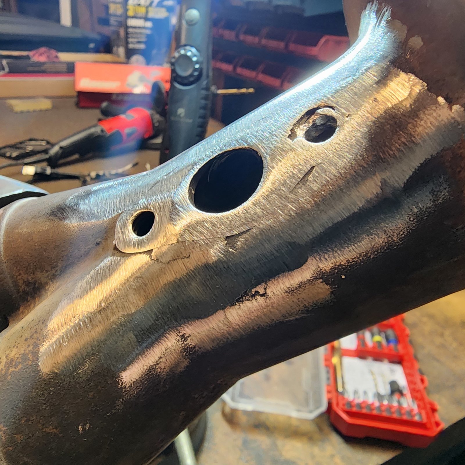

    I'm gettin there. It's lookin alot better now.
    I kind of do want to cut off all that slop to the sides now like @Kwikvette recommended.
    Drainbung and KRAMERICA[QUOTED] like this.

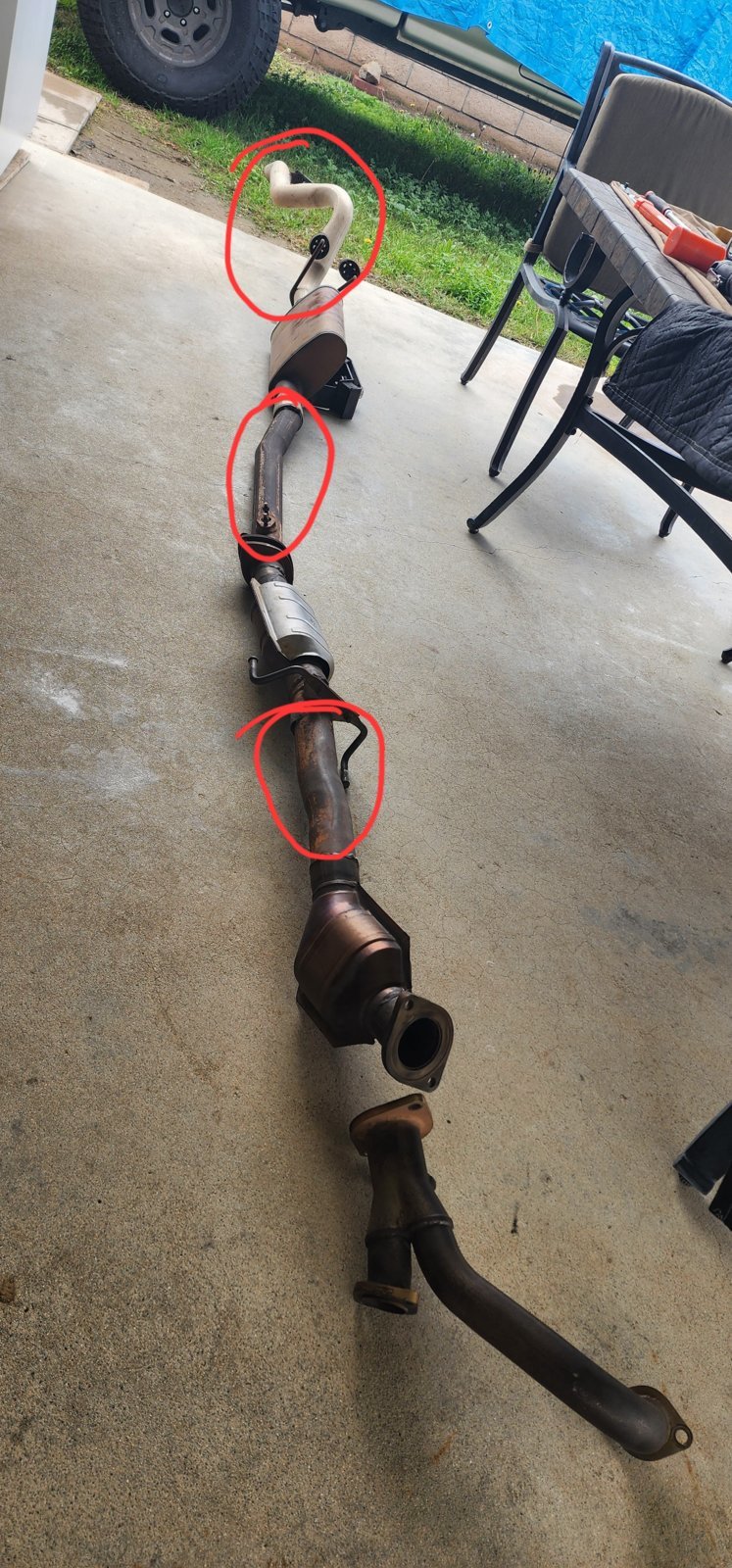

    Haha, I wish. And ya can build me a whole exhaust too to replace what I got now..
    I wanna delete all of what I have circled and dump it right after the muffler but before the rear axle.
    That would probably cost a couple cases :rofl::cheers:

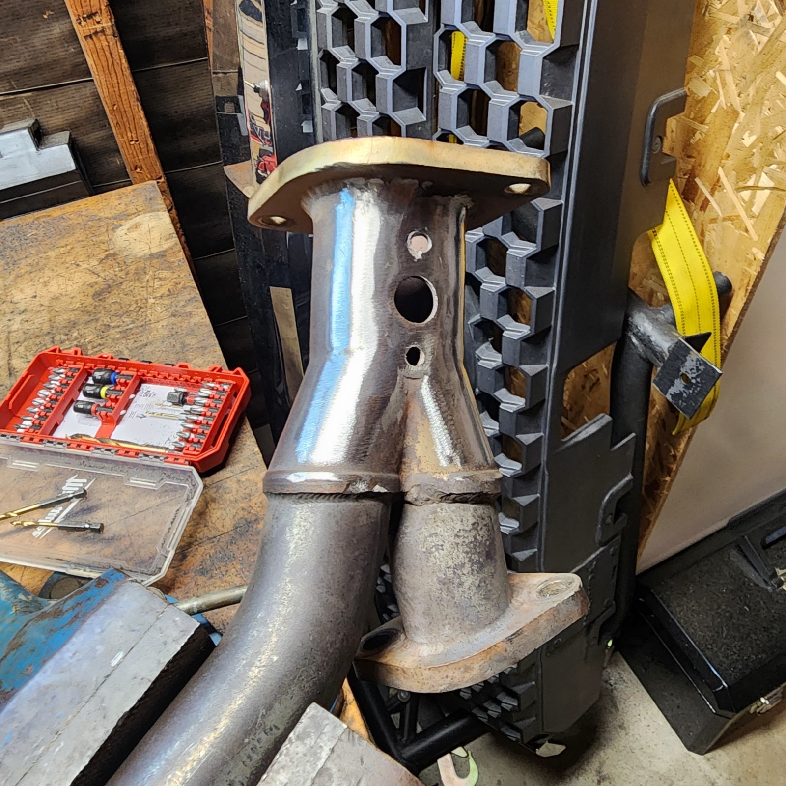

    I wasn't liking how the sensor was sitting so I ended up taking @soundman98 advice and grinded the whole SOB down to the straight pipe and I must say it's looking a whole lot nicer and cleaner now...
    So now all I'll have to do is get the bung(which I already have) welded onto this pipe. I'm actually thinking, I don't need the 2 holes where the studs screw into the pipe so those could be closed off since the bung is thick enough and can hold the studs anyways. Here's what it would look like...
    So obviously now the bung doesn't sit flush with the pipe so now my next question to you guys...
    Would you suggest having this bung welded on? Orrr could I DIY this by putting a good amount of JB weld or something better that you guys would suggest?
    This bung does seem a bit thick but it's a HUGE improvement compared to how it was before...
    I do have another bung that's maybe slightly less than half the thickness that I could use instead.
    So what you guys think? Weld or JB Weld?
    Drainbung likes this.

    Sorry didn't read anything yet JB weld stood out; weld that shit!

    So like @soundman98 said, most of the cost would have been the prep work(cutting & grinding). So with all of that done, what would you say cost of just the weld would be now?
    I think I do want to plug those 2 holes up though with some steel stick

    Welding the flange on there would seal off those holes
    Just find a buddy nearby, quick easy job

    Just stop by any welding shop. They got peeps that will weld that bung on with ease.
    You have done all the hard work already.

    To me just cutting the old one off and putting the new one on is the fastest way.
