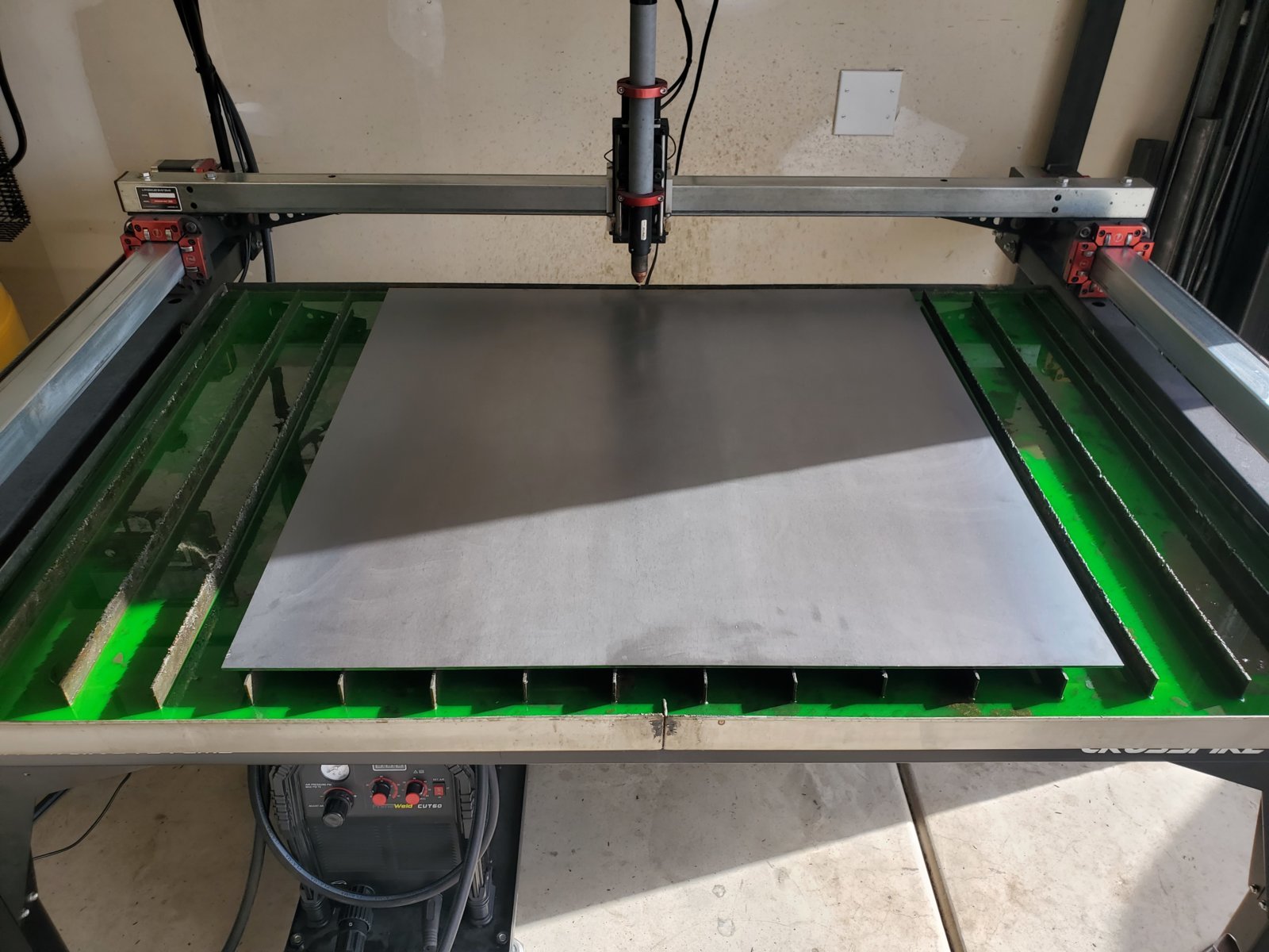

    My testing would be a combined 3/16" down to 12 gauge mild steel; no thinner and no thicker
    That's where "two" electrodes would come into play to utilize the 'median' pierce count of the two
    I'm also only using 1.0mm tips (45 amp) and the most common gauge cut would be 10 gauge (which I run at 36 amps, 3/16" runs at 38 amps)
    I spend a lot of time cutting, more often than I post about actually and I track everything since it allows me to figure out right away if something is "off"
    My desiccant beads only get replaced about once every 2 weeks, and all the steel I get or own is clean. Hell, here's a picture of "scrap" I typically work with

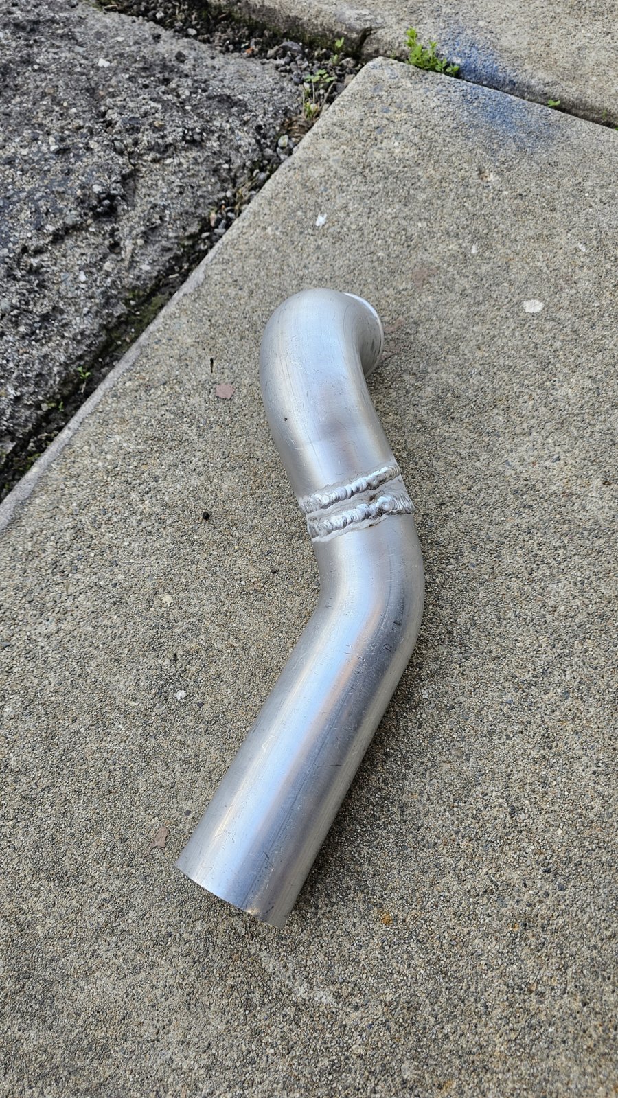

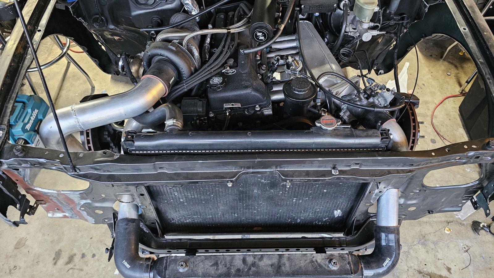

    Head a bit of trouble with this one. Got impatient and forgot to fully prep the material inside and out. Started welding it and it was super dirty. Had to cut it apart and clean all the material again. Ended up getting it all together.

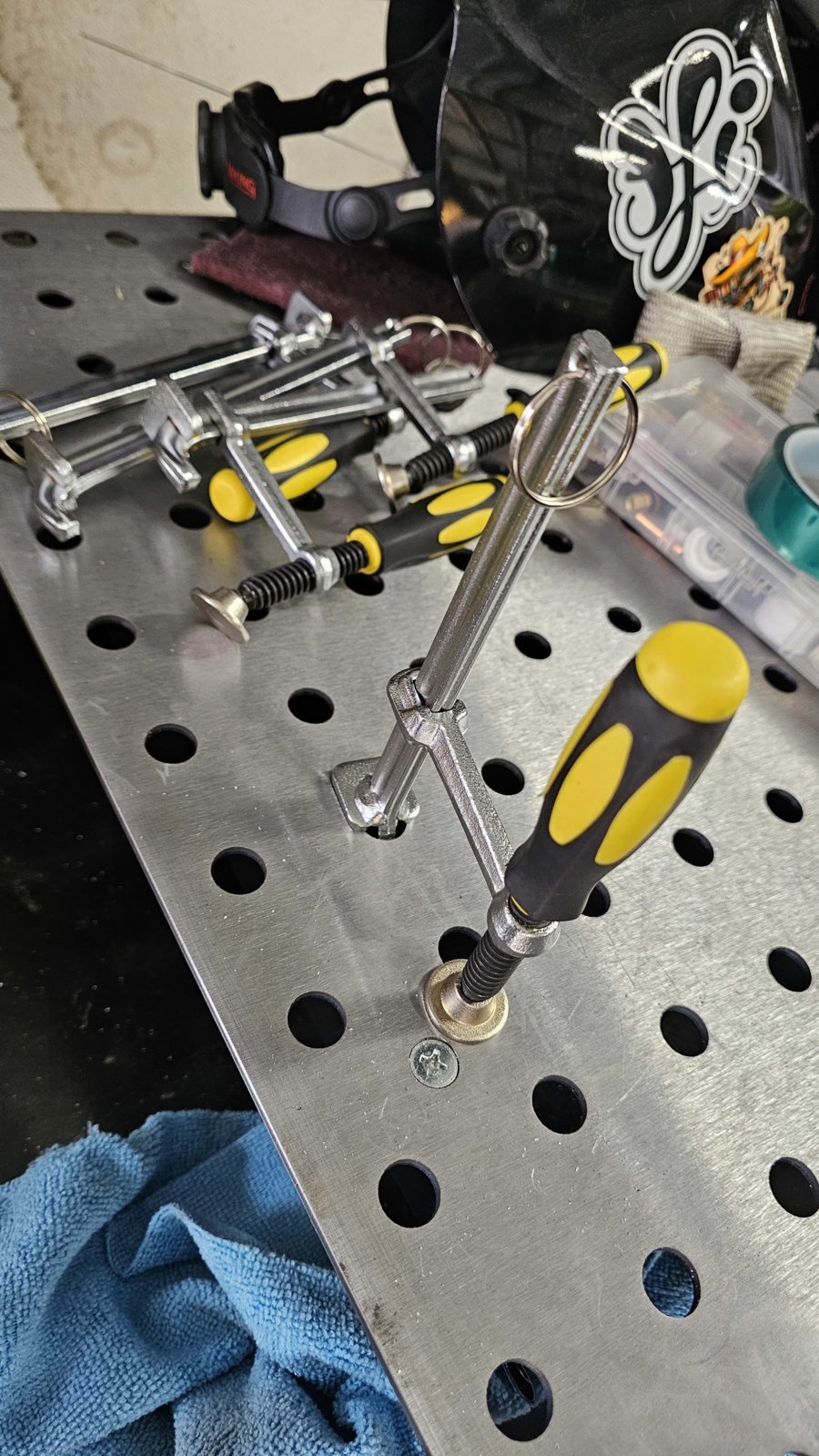

    Much better than having to reach under the table and use a nut.

    So you like them ;)

    No I hate them!

    Give me your email and I'll shoot you a pre-paid label for them to ship :D

    Lol! Gonna modify the ones that came with the table to hook in like this.

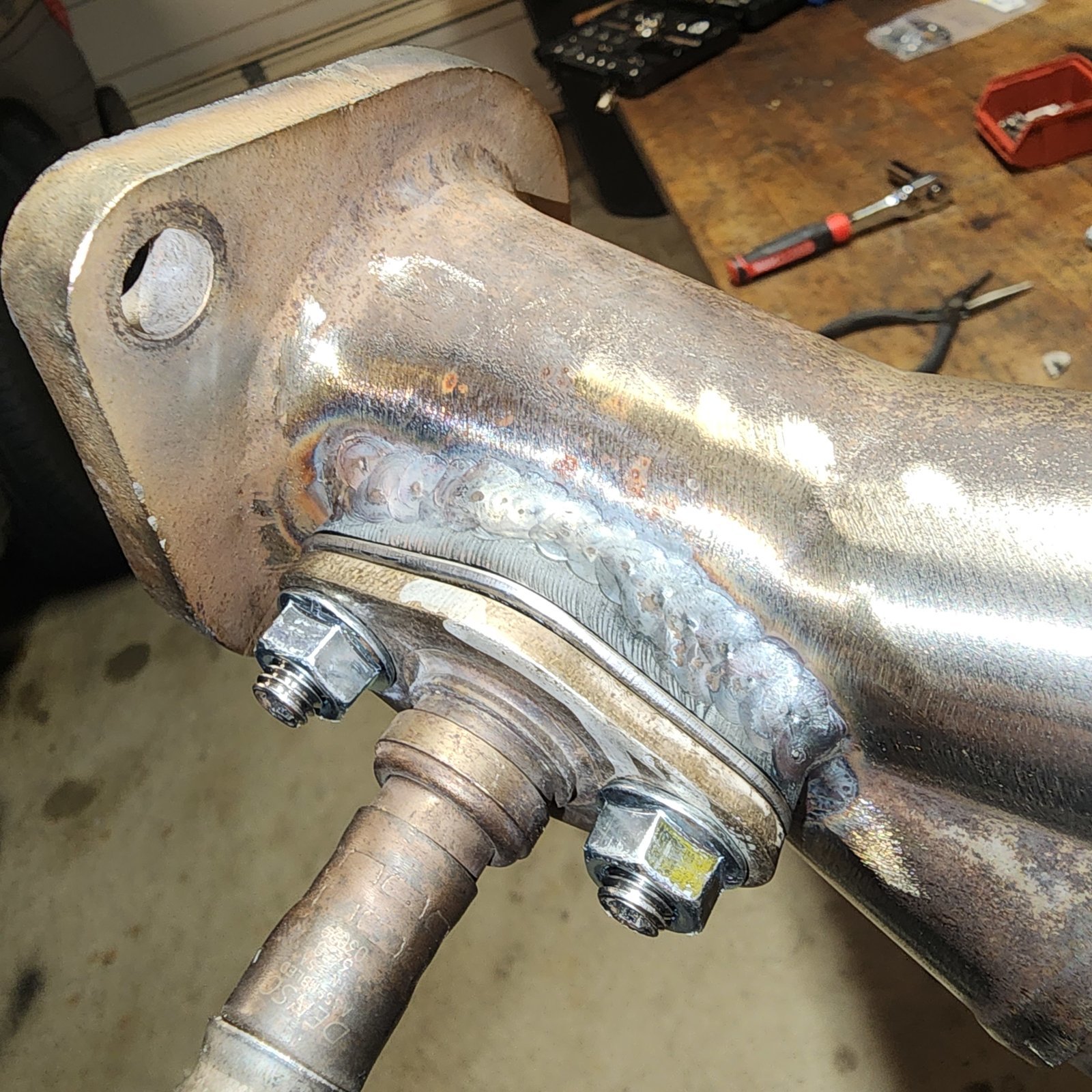

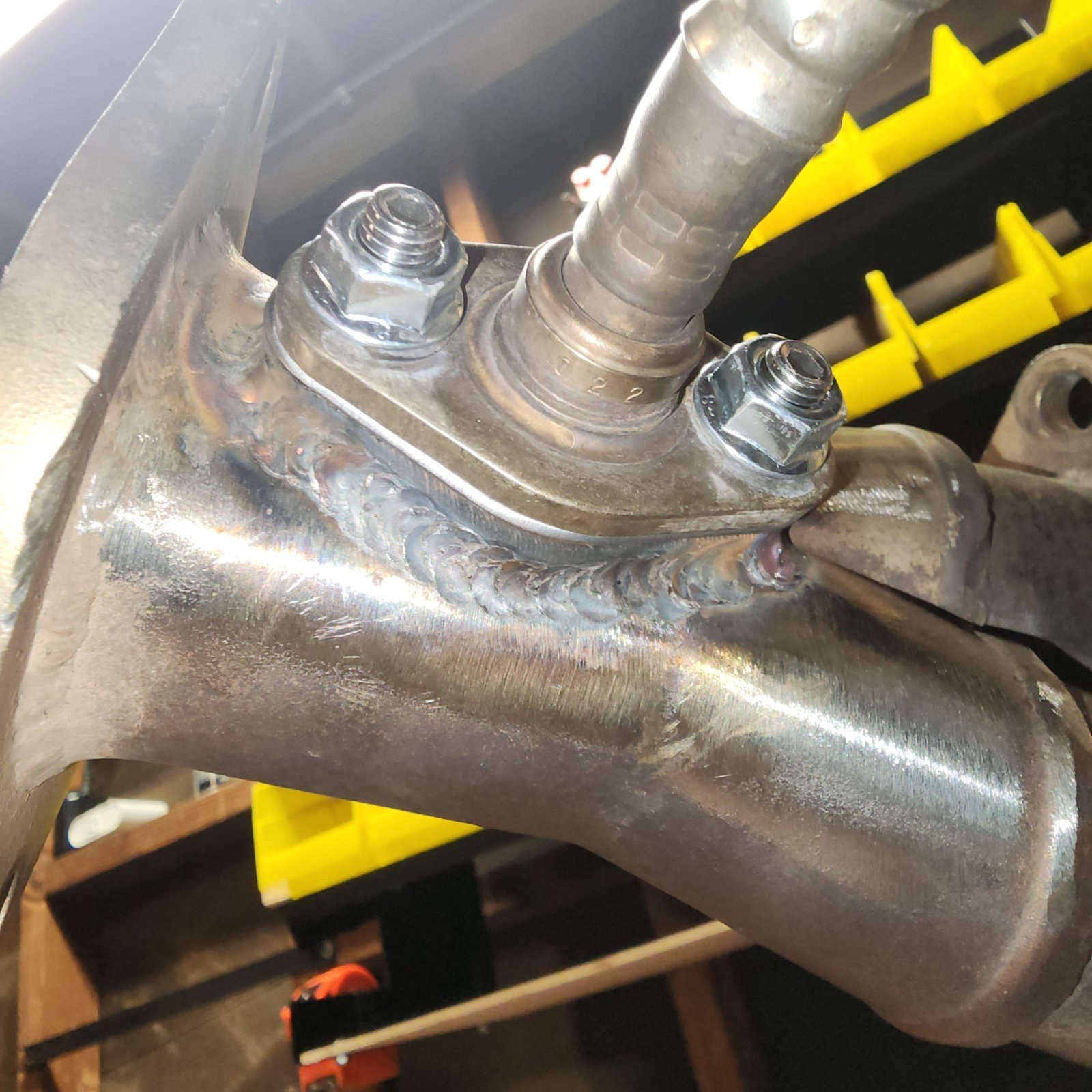

    Good morning all, just wanted to share the final result and thank you all who offered help and suggestions.
    So I ended up finding a local welder and it was a bit of a headache dealing with this guy. What I had thought would be a same day job turned into 6 days of dodging my calls and texts until I had to show up at his house :mad: definitely learned a lesson there and he won't be getting my business again! Anyways I'm glad that's over with and I got my pipe back so here is how it came out...
    Overall, I'm happy I've finally got it back to normal working conditions.

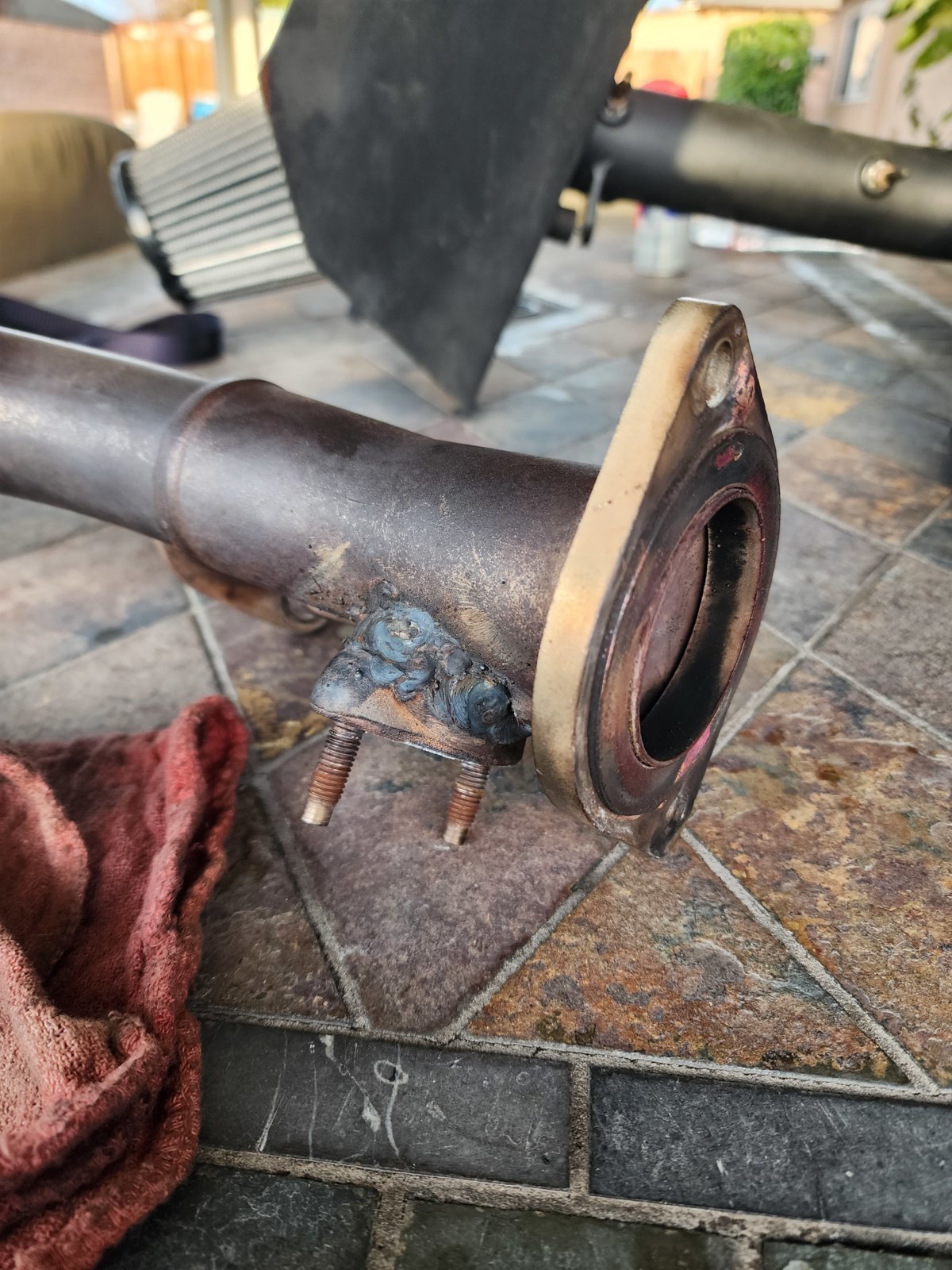

    For those who missed what it was before...

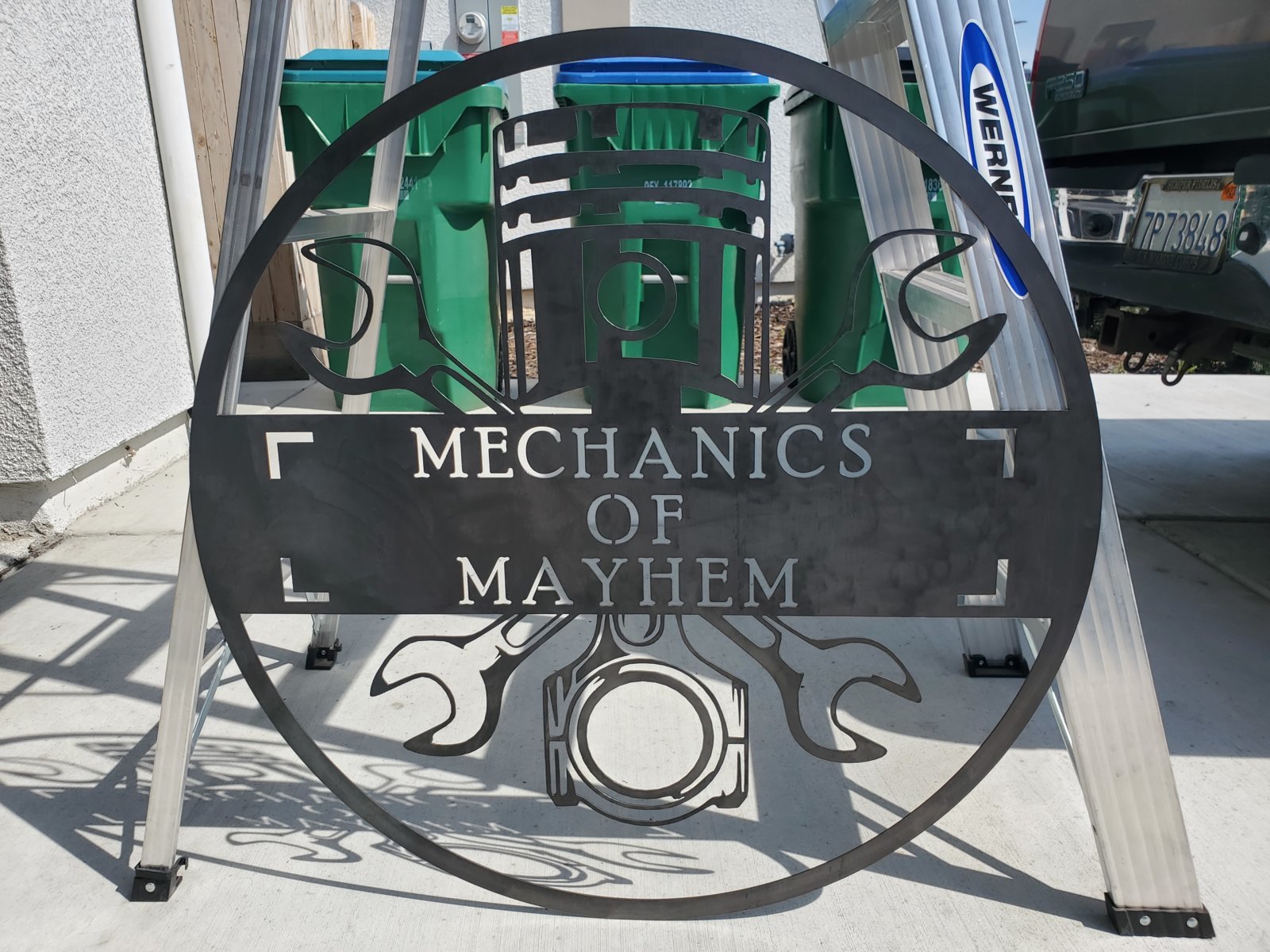

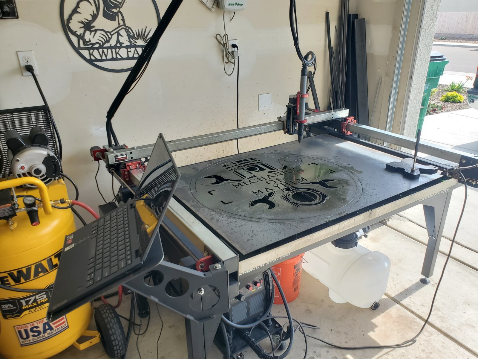

    I make parts, think I've emphasized this a lot :rofl:
    But when one of the shops I make parts for wants a sign, I ain't saying no
    They're getting a bigger shop (growing) so naturally, he wants something fresh and new to put up so I cut this today
    32.5" diameter out of 16 gauge
