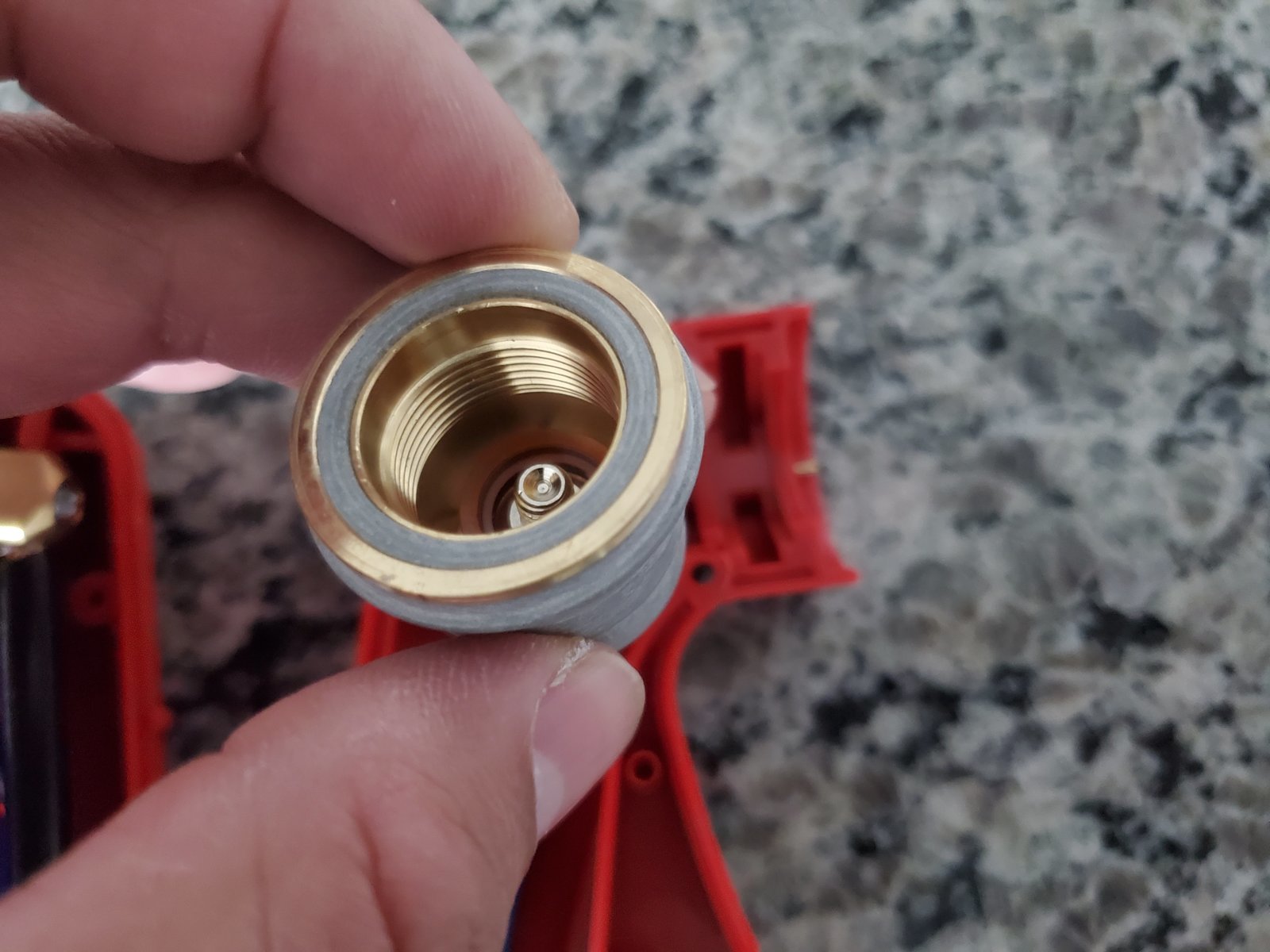

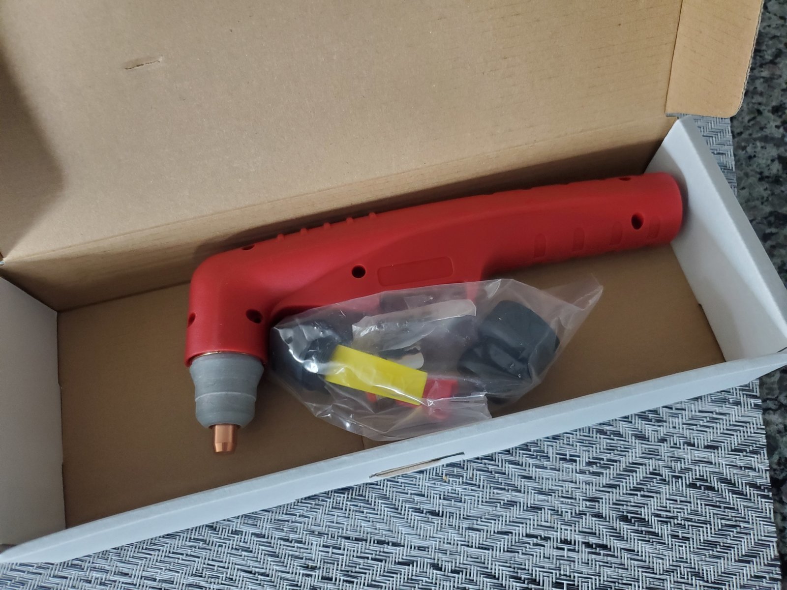

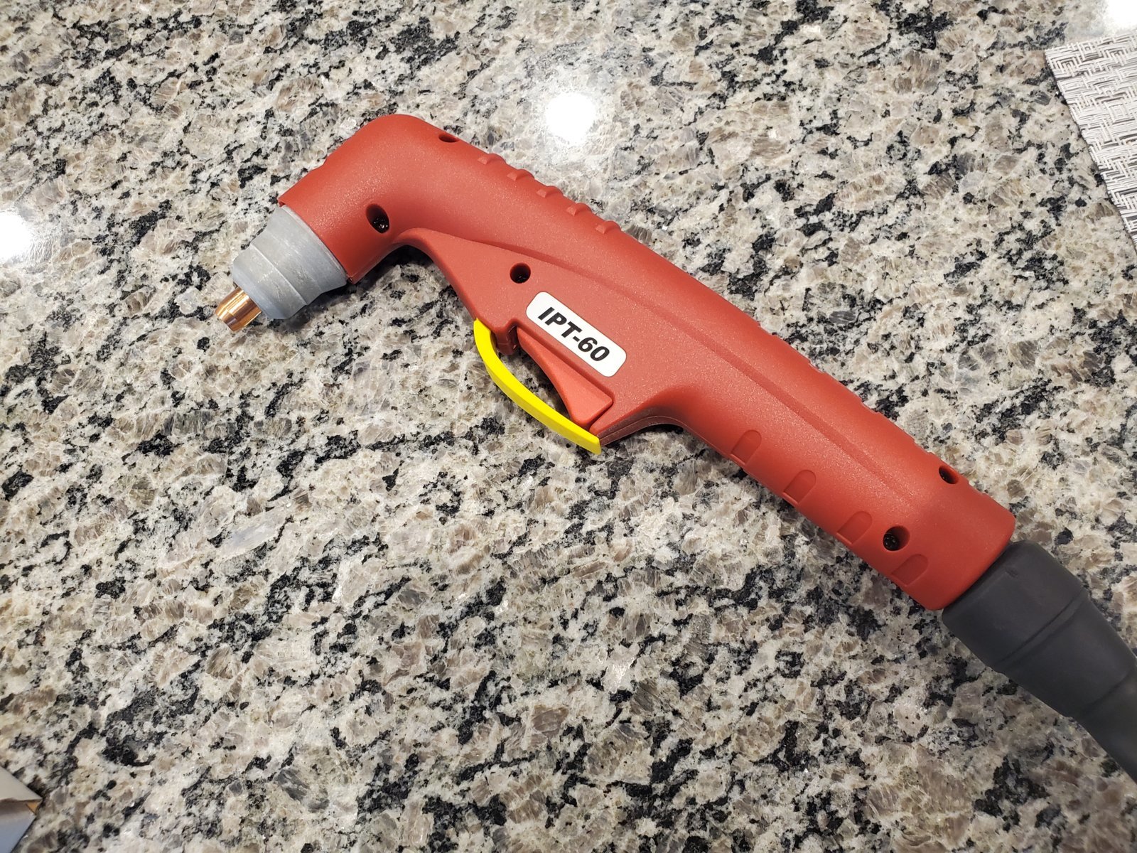

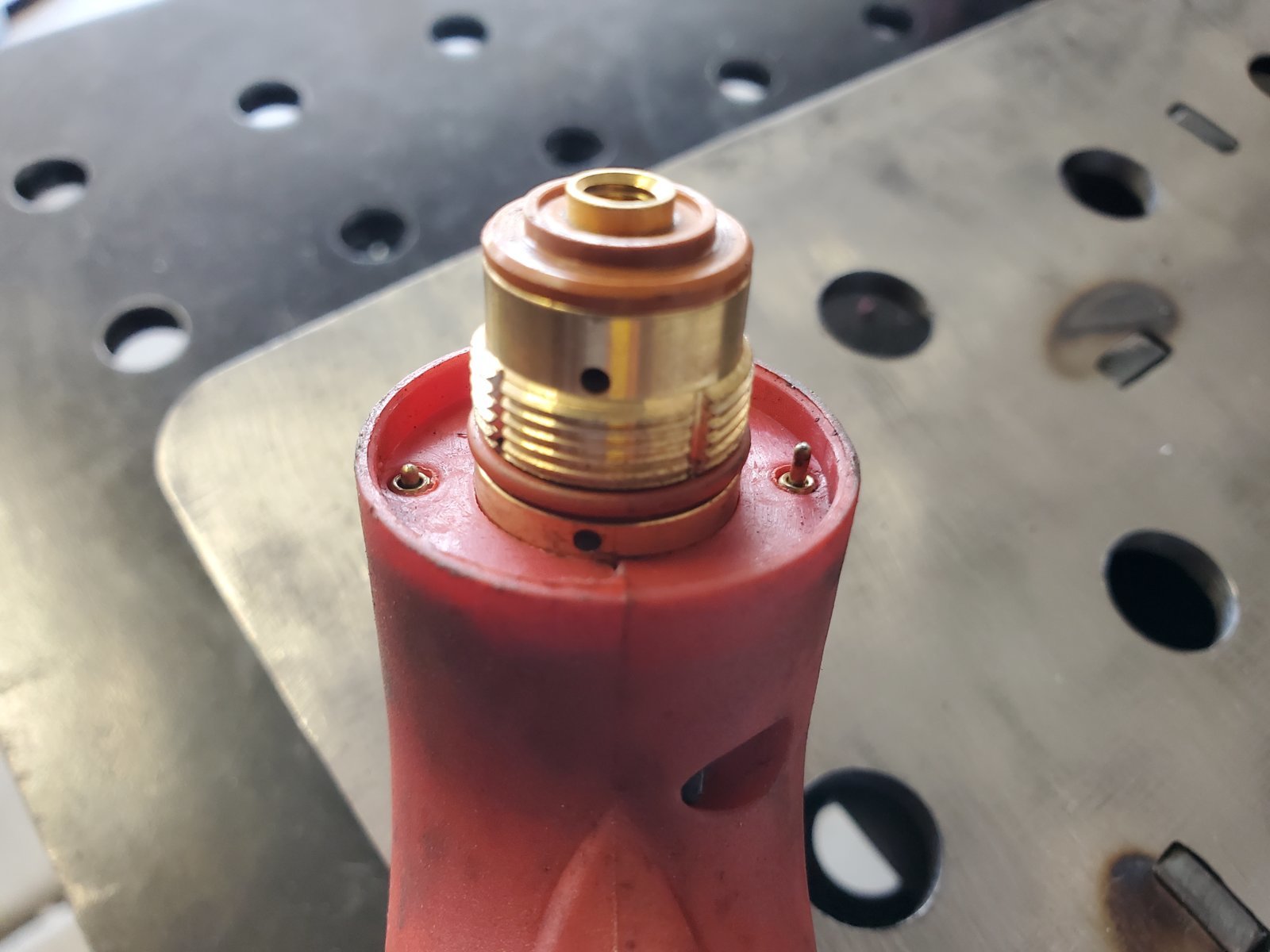

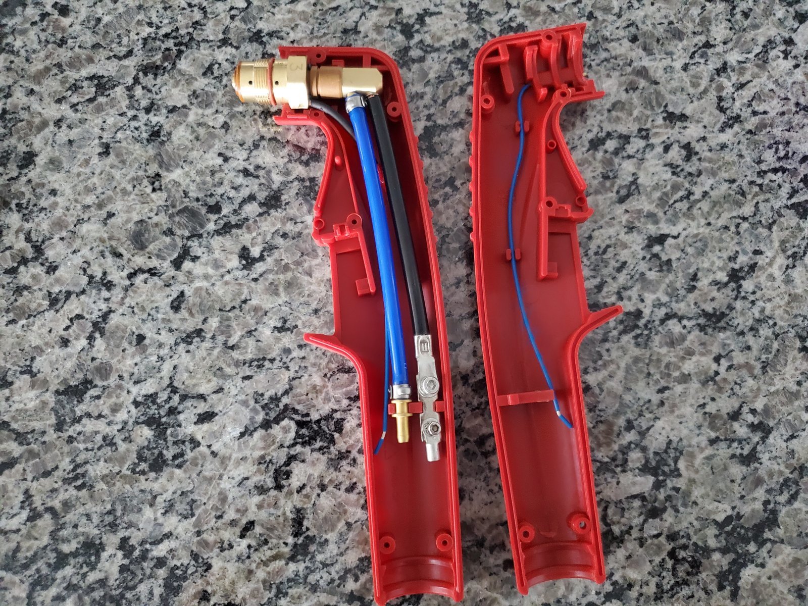

    Don't think I posted about my recent issue...
    New torch head arrived; some almost 2 years of heavy use and covered under warranty just cause one of the owners saw my asking about it
    If anyone wants to know what the inside of a blowback style plasma torch looks like
    The two wires trailing down can be bypassed, to remedy the issue I have on my current torch
    It prevents the torch from being able to fire if the consumables aren't properly attached, specifically the shielding cup as it closes the circuit for a "ready to fire" signal
    Well, one of the pins connected to that wire is stuck in the "down" position and even though it's a quick fix...I'll take a new torch head with new consumables any day of the week

    Was a bit busy, but got around to installing the new torch head
    Feels like a whole new torch again!

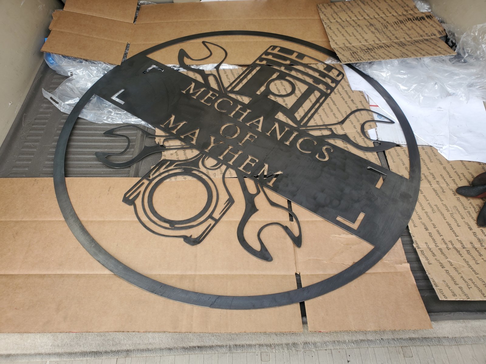

    Also, dropped off that sign I had made this last Sunday
    Got there and everyone freaking loved it; so much he wants another one
    But bigger, and out of 1/4" steel :rofl:
    Except a different style as it'll be hung and placed at an intersection for people to see as they drive by

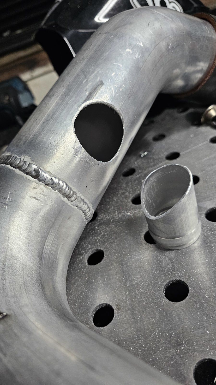

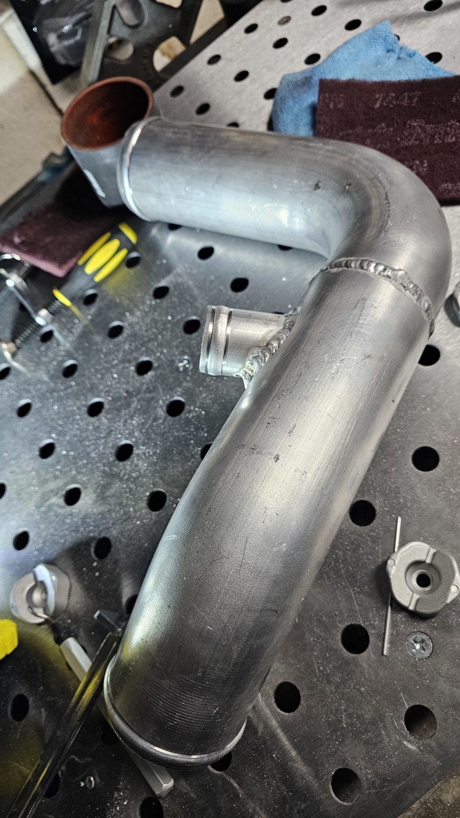

    Finished up my intercooler piping today. Definitely gonna get it powdercoated

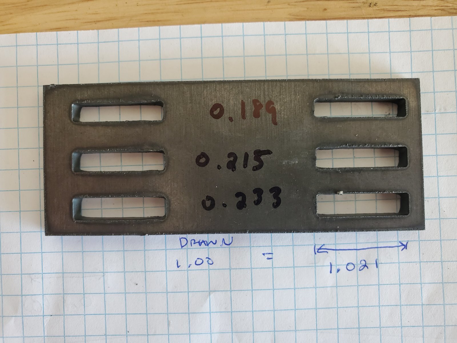

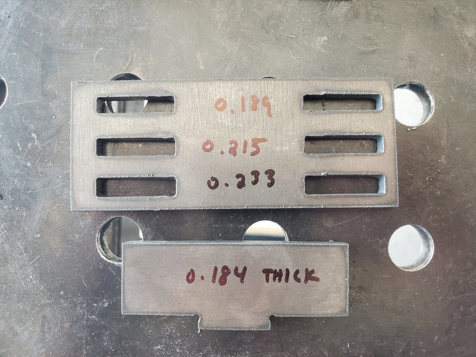

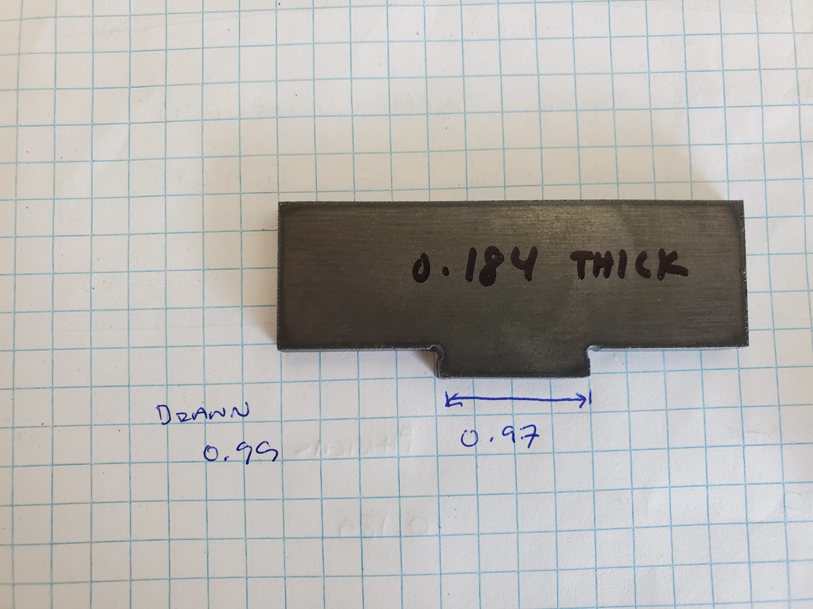

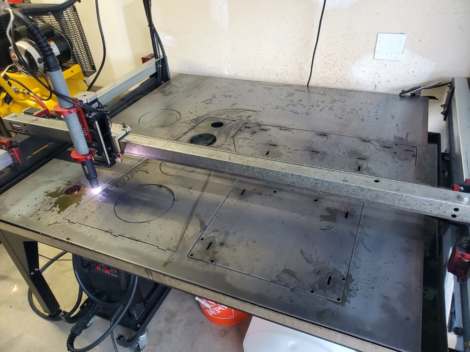

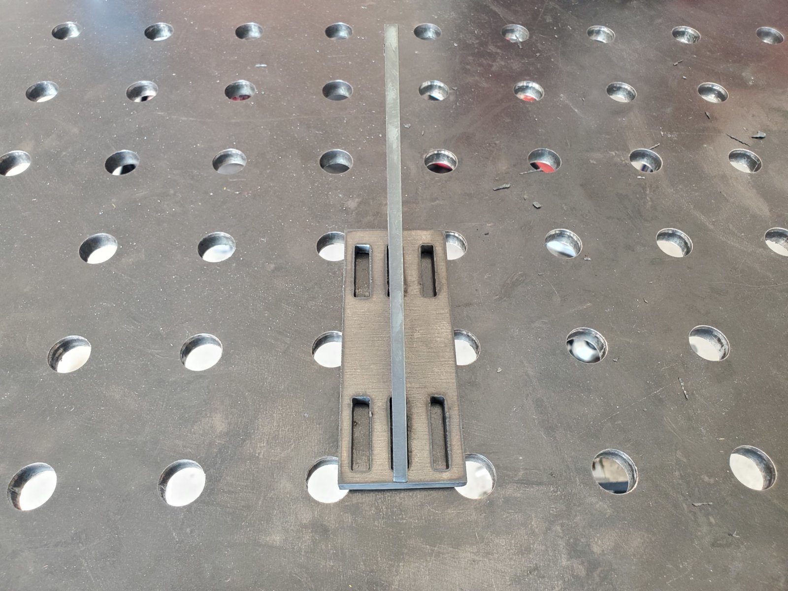

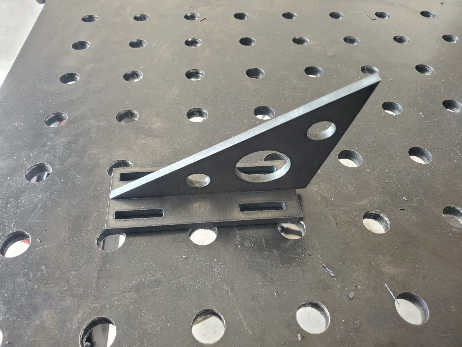

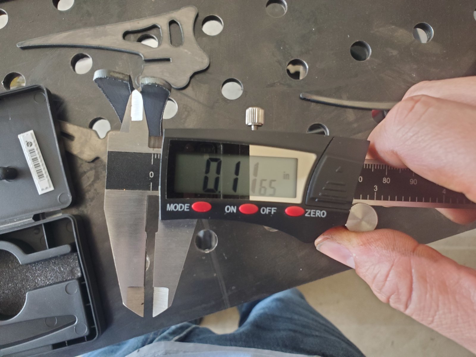

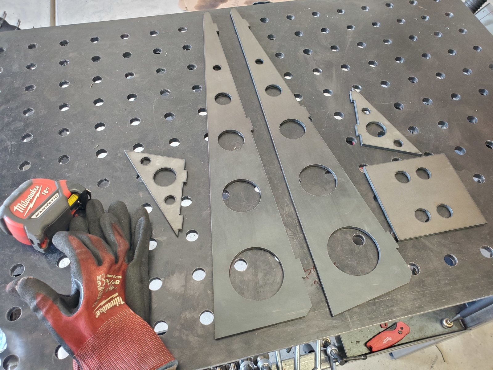

    Since I've yet to do tab and slot design in 3/16" I just wanted to confirm the same level of requested accuracy so I did some test cuts
    The gussets here are *actual* pieces from part of an assembly I'll be cutting soon
    The square with slots is my test piece
    As well as a test piece with a "tab" from one of the larger parts of the assembly

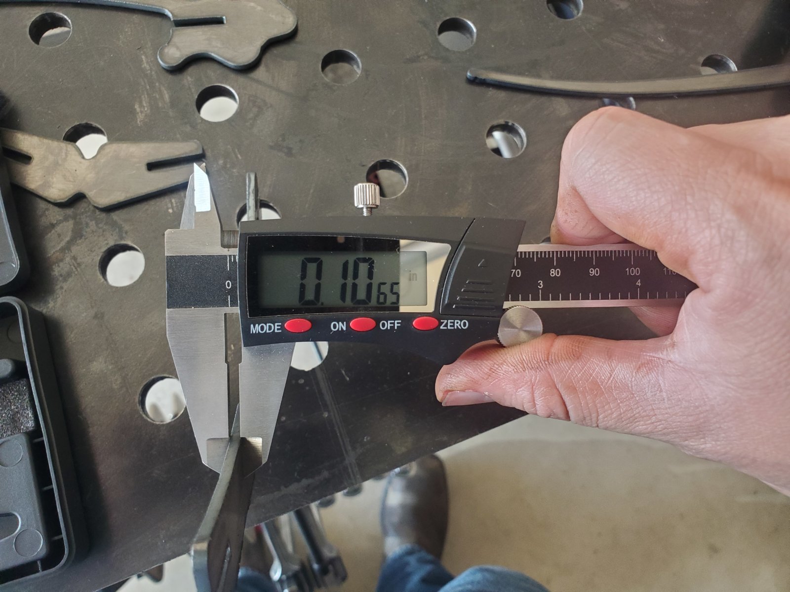

    From top to bottom, the drawn dimensions for the slots are 0.17" tall, 0.19" tall, and 0.21" tall respectively
    Here are their physical dimensions, within the two hundredths expected
    Same goes for the length of said slot
    And finally, the tab which is an exterior cut
    This was also expected based on how I run my offset and kerf values, but really happy that the difference is the same whether it's an inside cut or outside

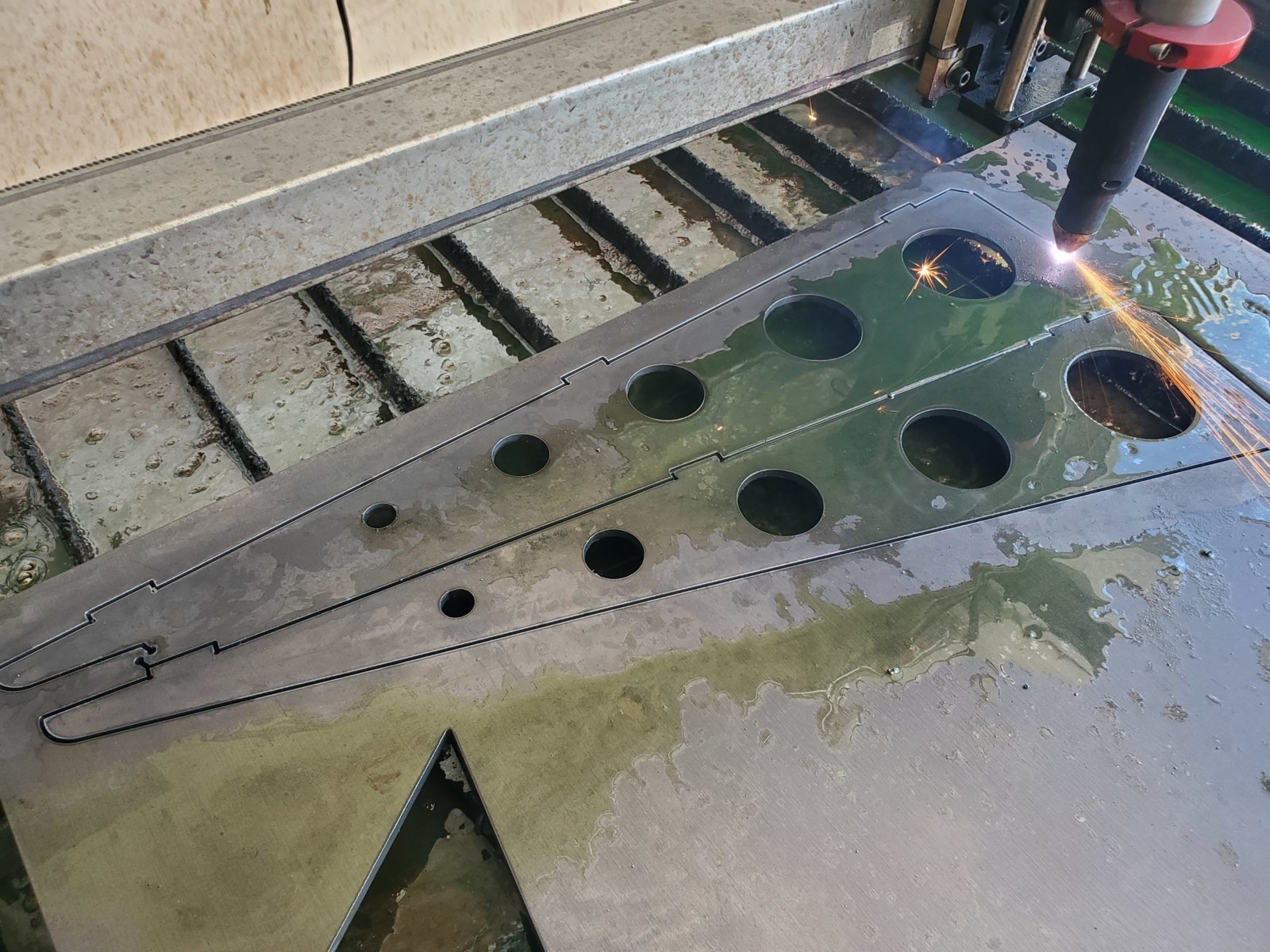

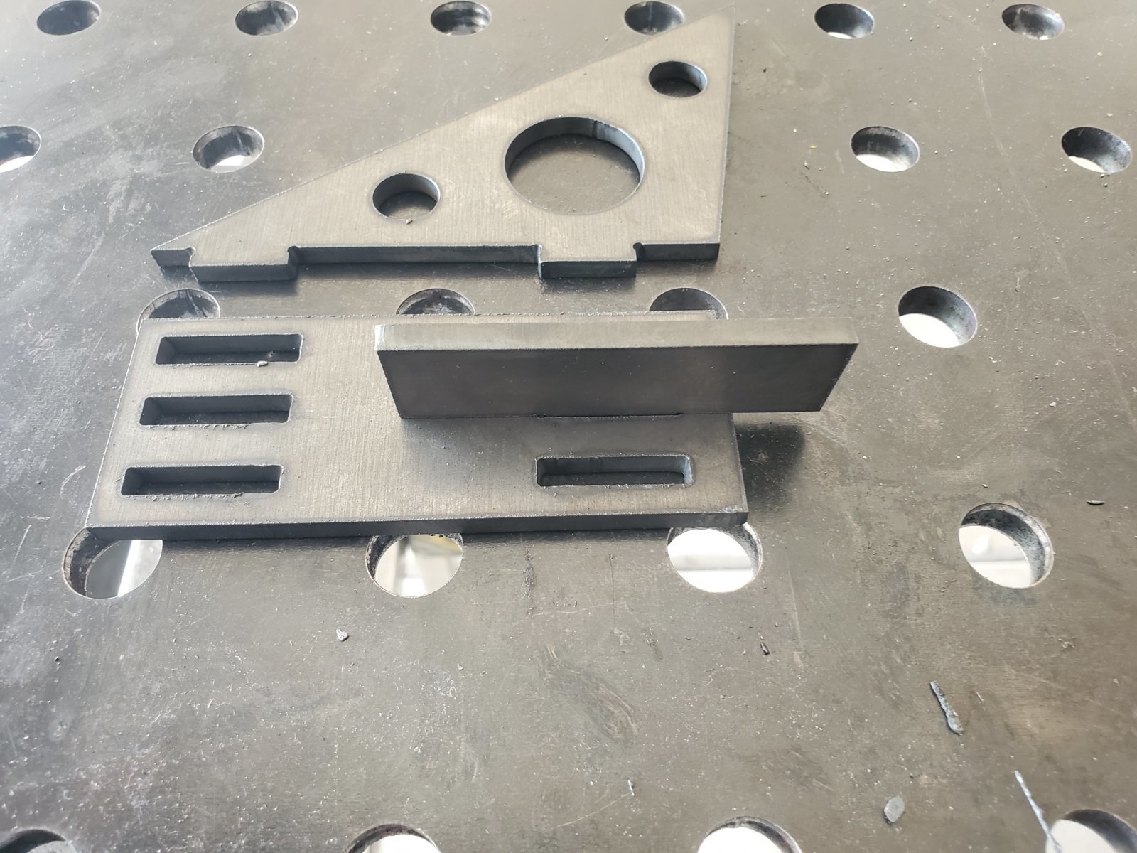

    Bonus pics!
    Not even sure why I do test cuts anymore :rofl:
    Had enough scrap to cut some more assembly parts; the rest will come when my friend brings over the 3/16" plate

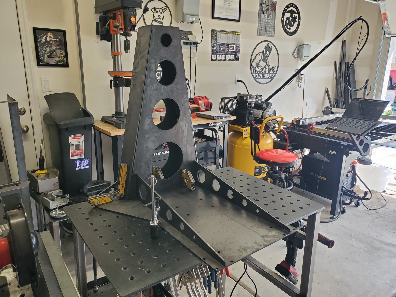

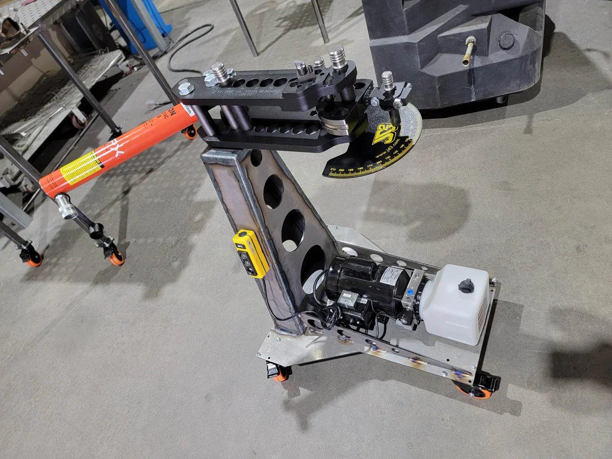

    Here's the rest of the setup!
    @El Taco Diablo gonna have a bitchin' tube bender setup

    What's the thing look like completed?

    Picture there is before the smaller side gussets were introduced
