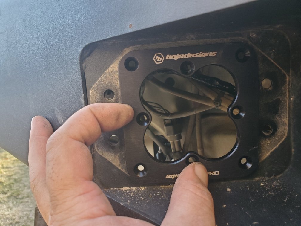

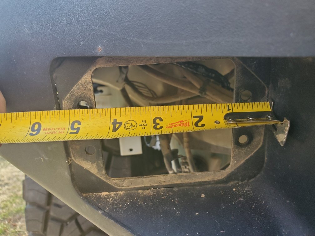

    Got some new lights that I want to flush mount, but the hole in my bumper isn't made for the flush mount brackets from BD.
    Looking for a metal bracket cutout in the shape of the dirt outline here:
    Basically this plate but with the side wings:
    I could even send you the faceplate from the light here (and the BD one above) for exact measurements:
    Willing to pay good money so I don't have to do it with a cutoff wheel. If you're interested, let me know and I'll move over to DM.

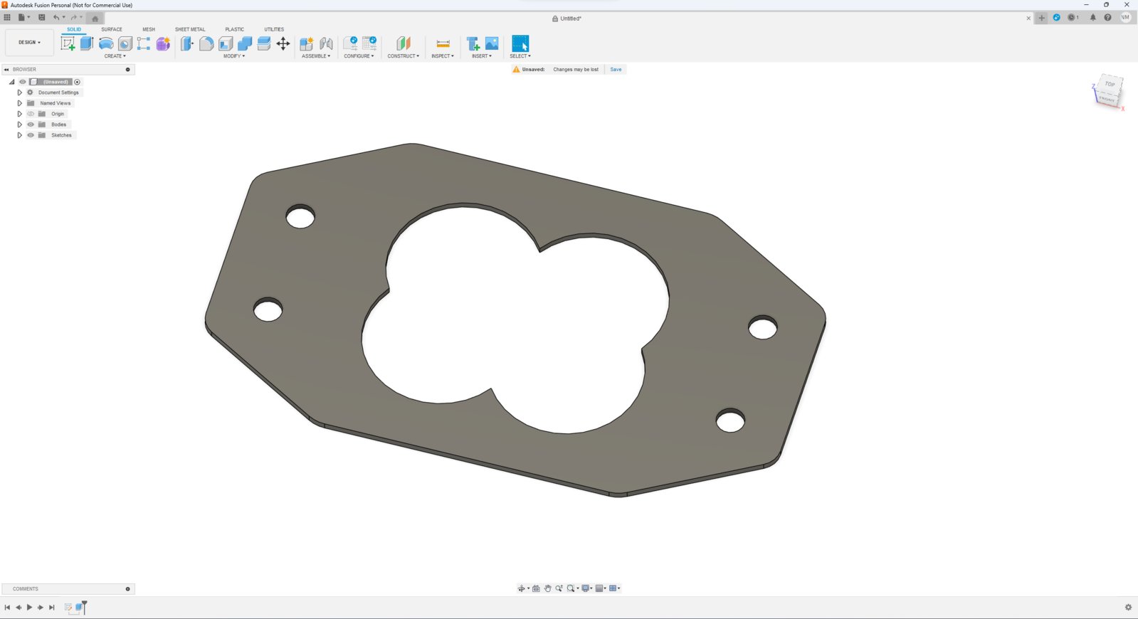

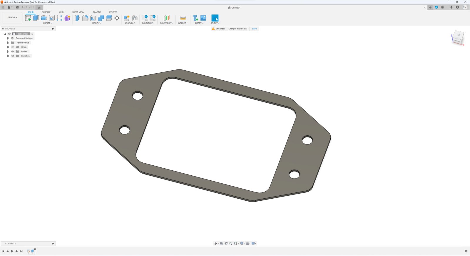

    Got your PM; I actually replied here via phone but now that I see it on my PC oh yeah that's way easy
    Heck here's a 'rough' draft of the current setup you have before incorporating the new bolt holes you need for the new lights
    And rough cut out for the light itself

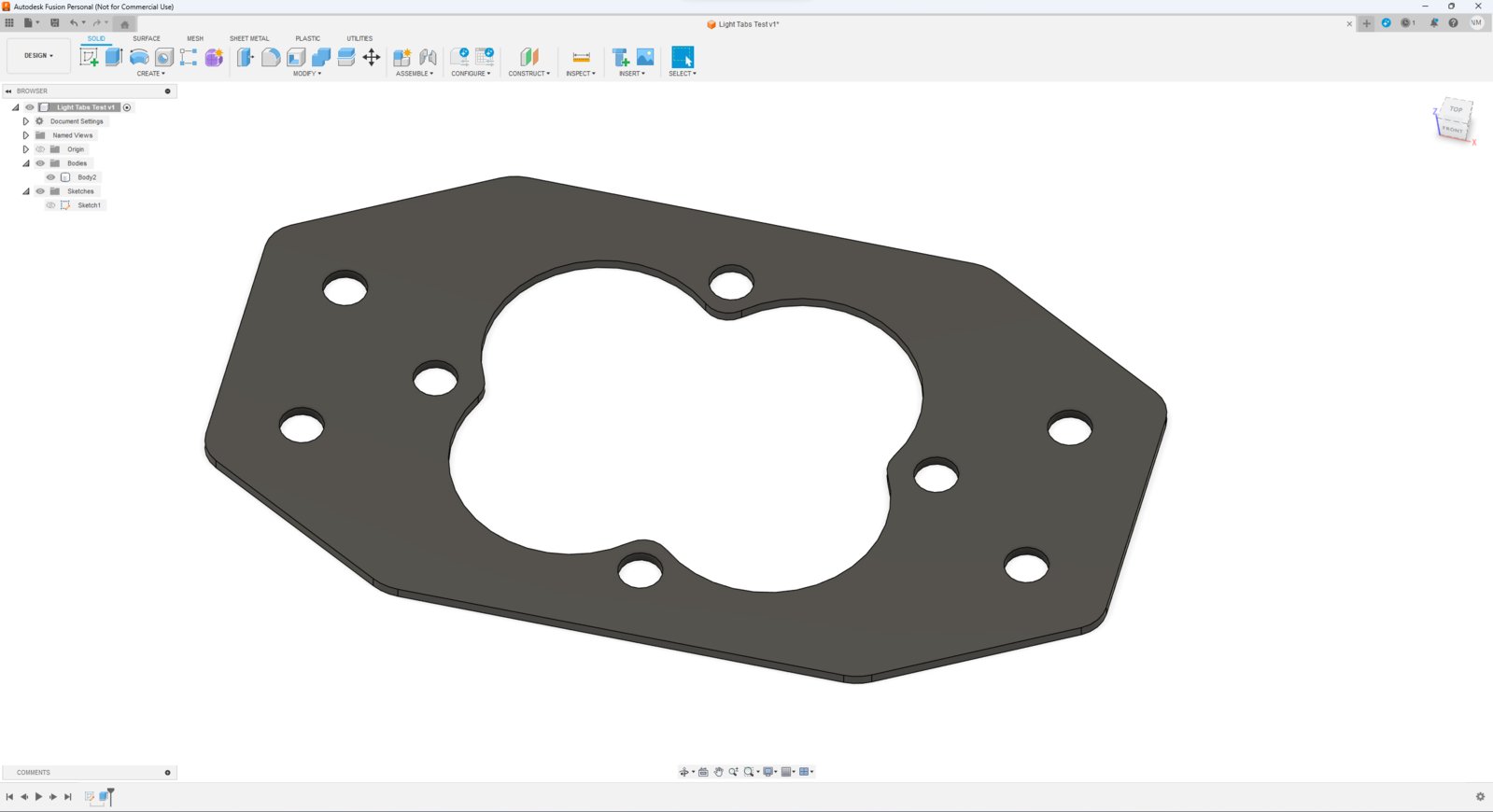

    EXACTLY what I'm looking for. Just need a couple holes for the light mount itself. I know you have that drill press, any way to do counter sunk holes?

    I just need the right bit for it, if someone wants to toss me a recommendation for some that won't break the bank for metal? I have some for countersinking but I think they're for wood.
    If the holes are less than 3/4" I'd just drill them out myself as really small holes can come out slightly jagged due to the concentrated heat in a small area.

    Can't recommend anything myself, but am happy to pay for any tool costs for bits etc. Would be looking to get these holes added (definitely less tham ¾"):
    If not, it's not a deal breaker.

    Yeah, I was planning to make it look like this
    But with the appropriate dimensions

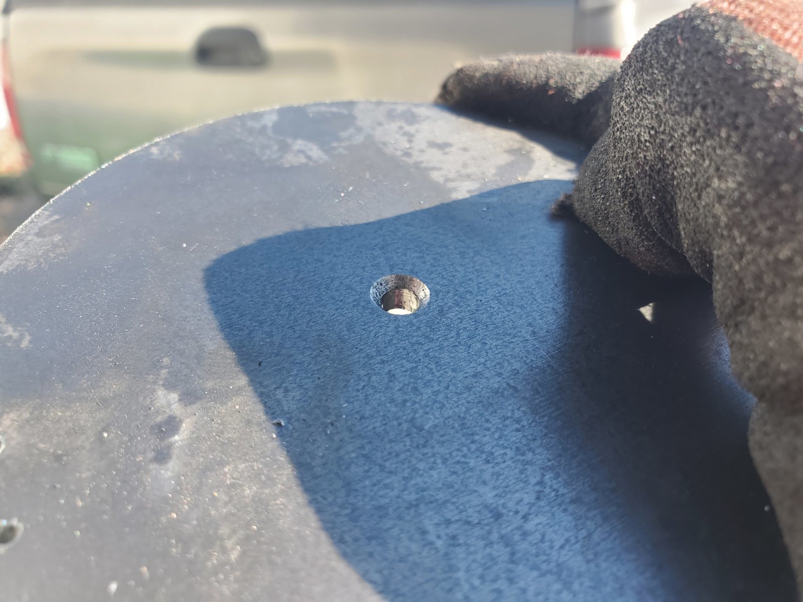

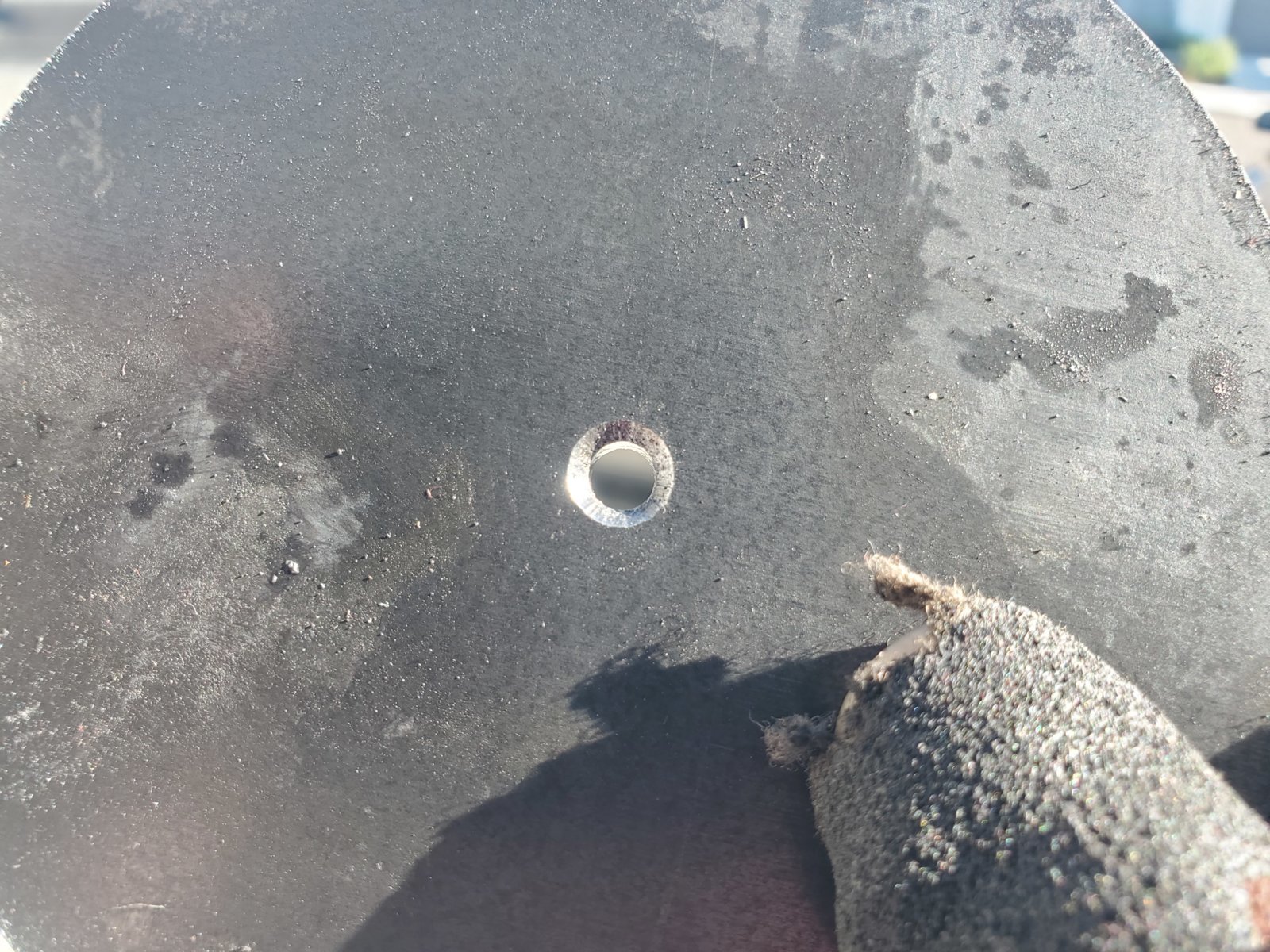

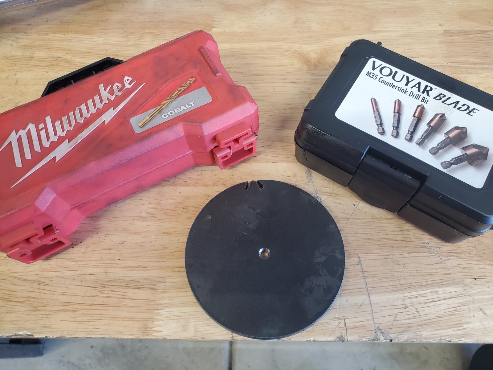

    Tested those new bits; drilled a 3/16" hole and used the 5/16" countersunk bit
    Let it spin for quite a bit to clean up but it still came out a little rough so I'll definitely be taking another member's suggestion of getting a single carbide bit from a local machine shop
    For anyone watching, I can say I don't recommend these as this was just mild steel and it still looks rough

    yeah, if i had seen this earlier, i would've warned you about that. i've tried a few of them, but all of them suffer from chattering that tends to make the countersink look horrible. i've ended up using cobalt step bits for deburring. it gets a consistently smoother edge, but can't go very deep.

    I've got a cobalt step bit already, so I could try that
    I've never owned a premium drill bit though so I'll fork out for a nice single carbide bit
