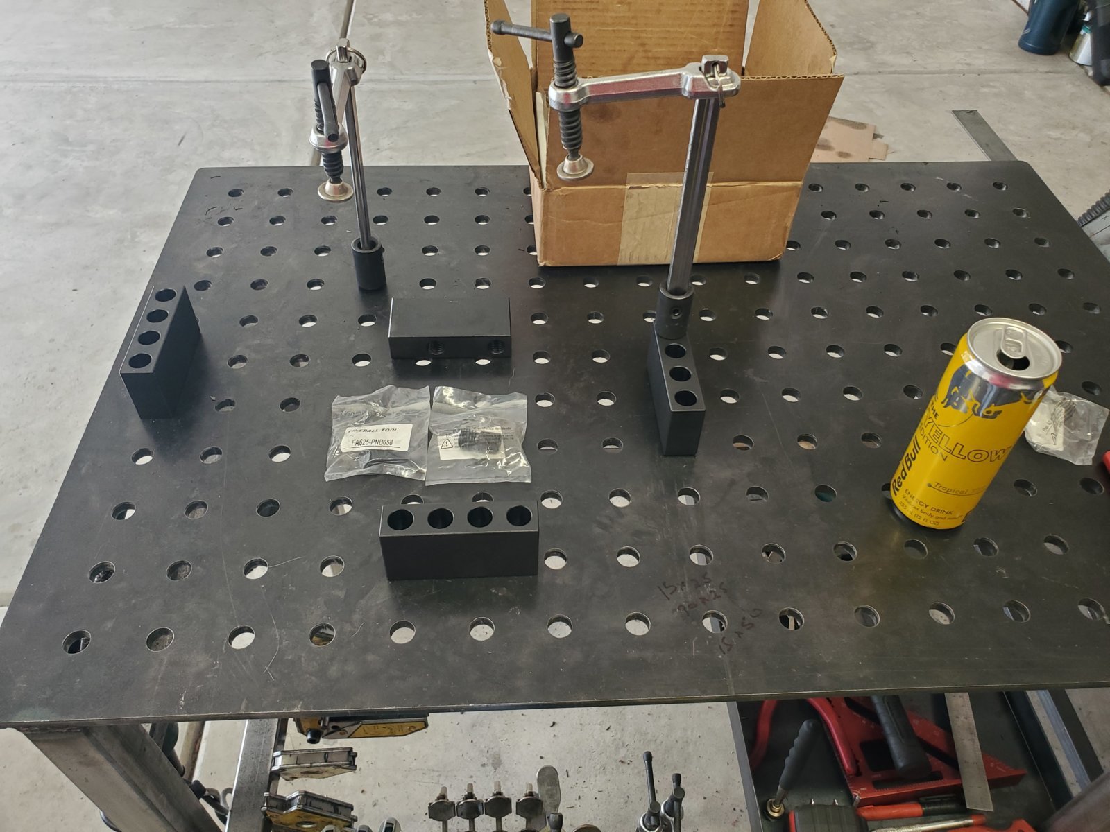

    Table toys (blocks)

    looks like somebody has been shopping at fireball tool..
    Seen those in his video awhile back.

    Just the blocks; they're always sold out in the size I need and they finally had several in stock so I bought 4

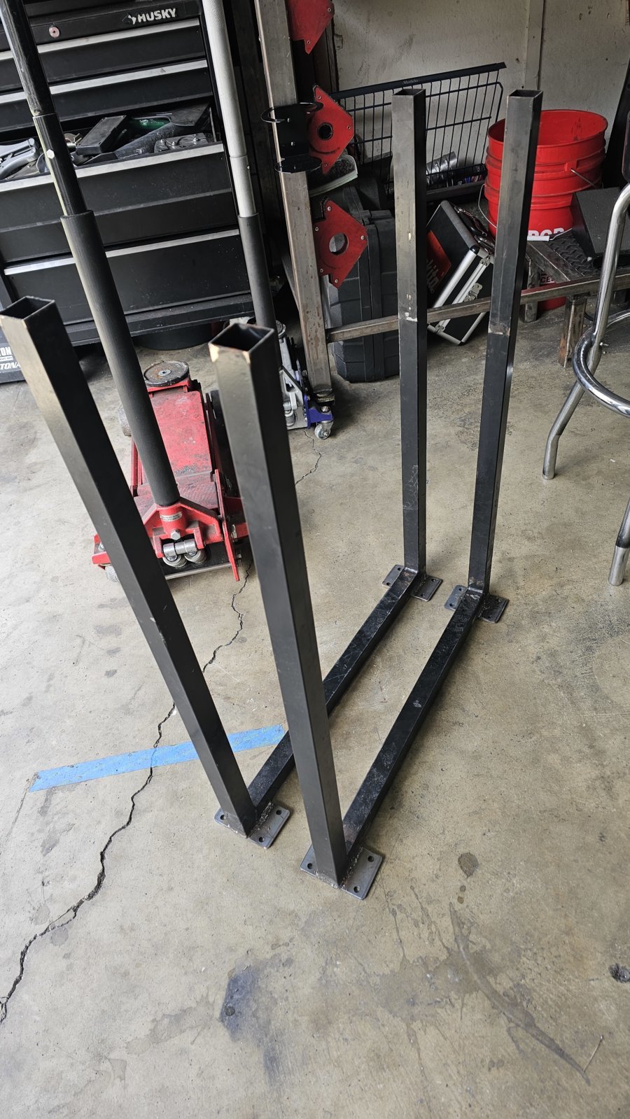

    Modified these grill cart legs. The old casters were welded on so I cut them off. Whipped up these base plates to have the new and future casters bolted on instead of welded on. Welded em to the legs and job done.

    Where are the super close-ups of your welds like all your other clean ones!

    These were mig welded lol

    Should be way nicer then!

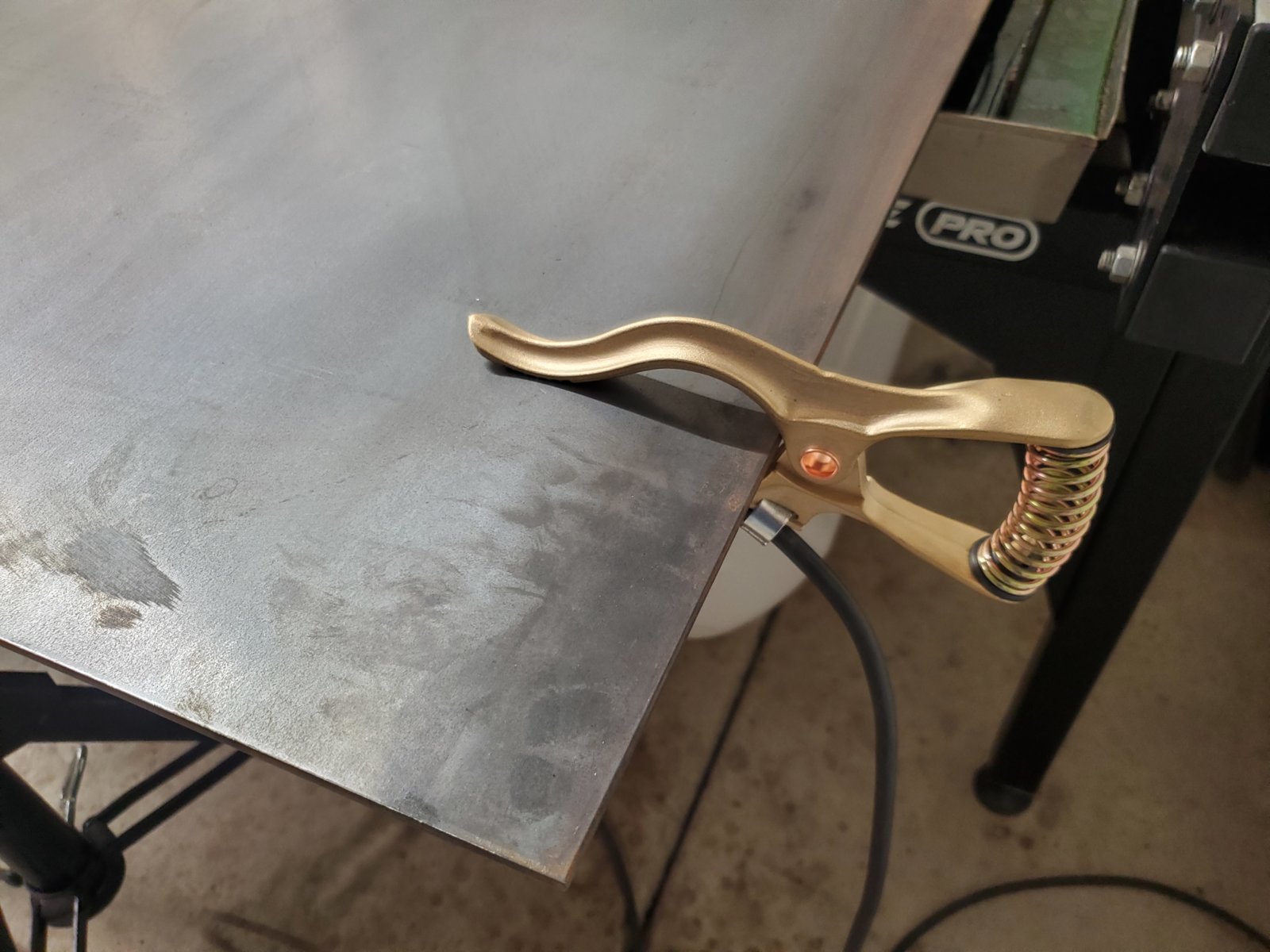

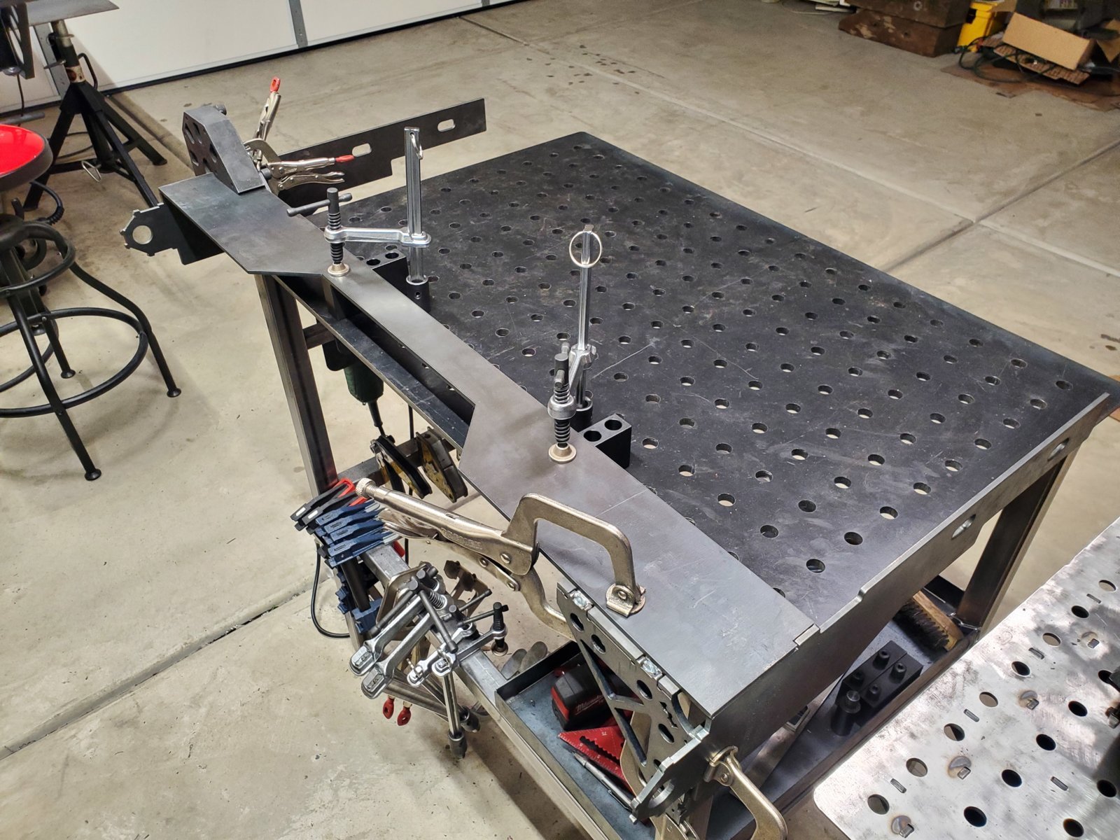

    Little bit of cutting, although it got interrupted when my work clamp started to smoke
    My fault for pushing the clamp up to the braided wire, but it lasted 2 years so no biggie
    Cut these pieces out, still need to model and cut more
    New Harbor Freight work clamp

    Lol nah the material was damaged from previous replacements and super thin compared to the plates I made. So I had to do a lot of filling and build up quite a bit in a few areas.
    I'm going to be making him set of new legs with thicker material. I'll also draw up the base plates in fusion to have them ready to go next time. I'll tig weld that whole thing and take close ups of those lol

    Was just messing with you at first, MIG is way easier but now you got me wondering with all the excuses :luvya:

    No excuses lol it wasn't pretty haha

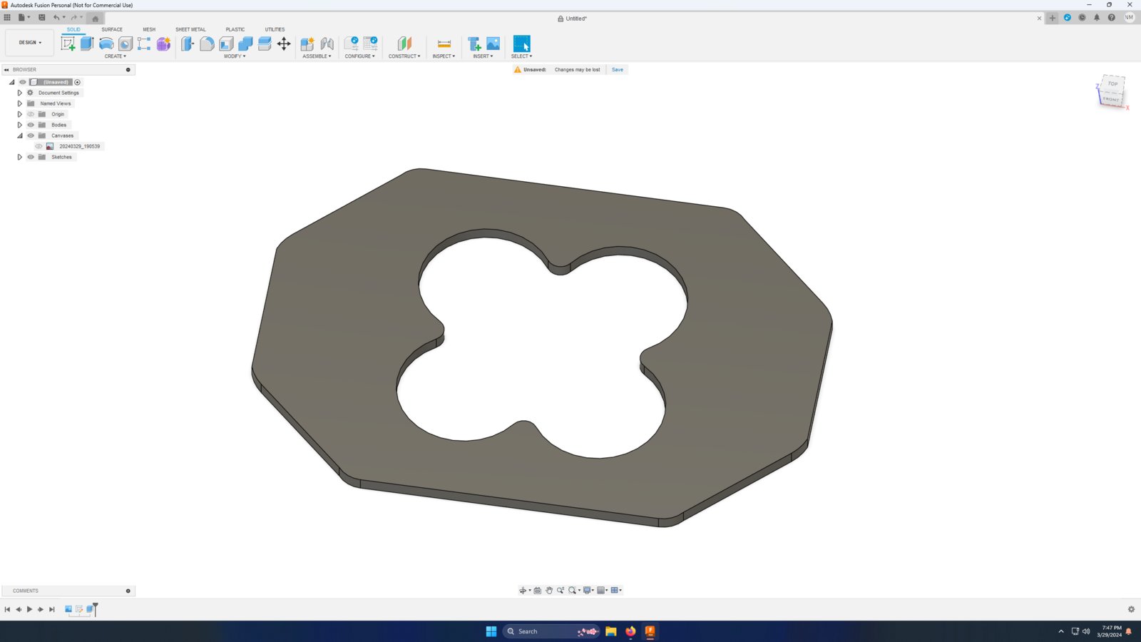

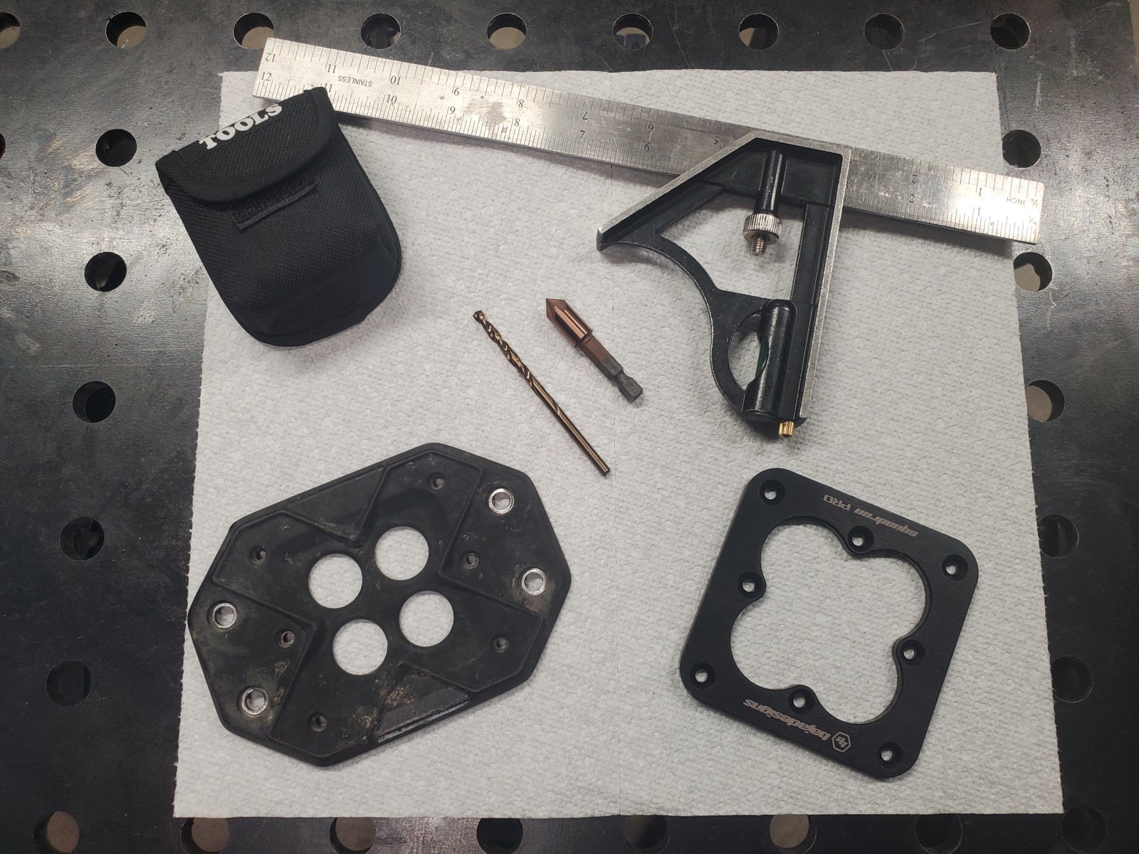

    @Gen1FTMFW
    Got your goodies!
    Gonna draw them up tonight
    The countersink bit would be 3/8", but thinking I'll find a metric bit for drilling the hole since 5/32" is a hair smaller
    Edit: Test piece done; holes will manually be drilled to prevent any hardening
