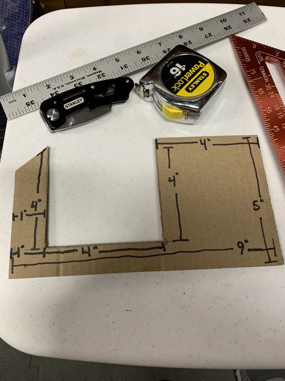

    @Kwikvette Have you cut out any camper bumper reinforcement brackets? They’re made to fit 4”-4.5” square tube bumpers. Like this:

    1/4”? Can you cut that?
    Here are my measurements for my camper. The one in the bottom left is 1”

    They also show the inside corners radiused, I guess to prevent cracking?

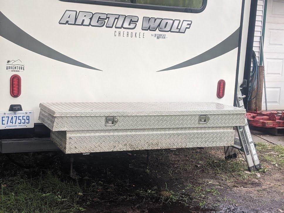

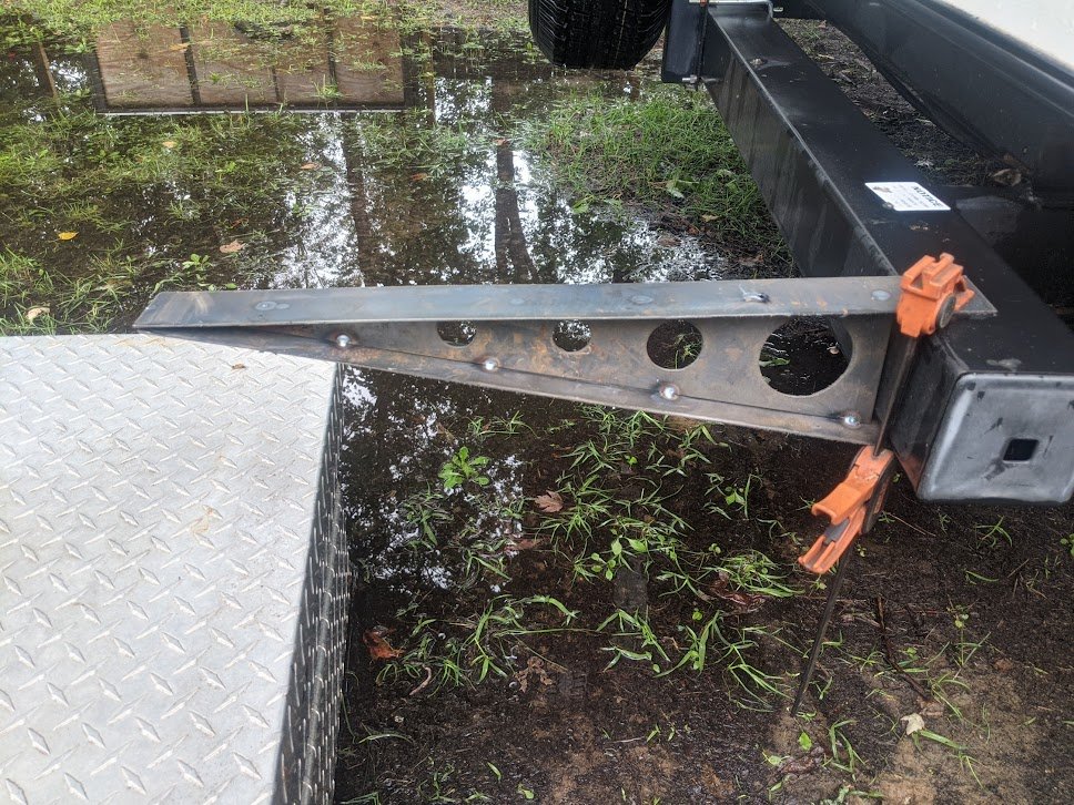

    AP1GczMISQz8JtrsSxOWgMvRCzTK6JOiFsDPc4bD_2689e22e9e12cd6769bd0333e3a90f9865c869fd.jpg
    I made these brackets for my RV with my plasma table. They work great!
    AP1GczPKJP77noVZBF6_02pa5DWhIY5o_1W1Una8_128d5f2af7f855a566117752cb4a93a641a2f9fe.jpg

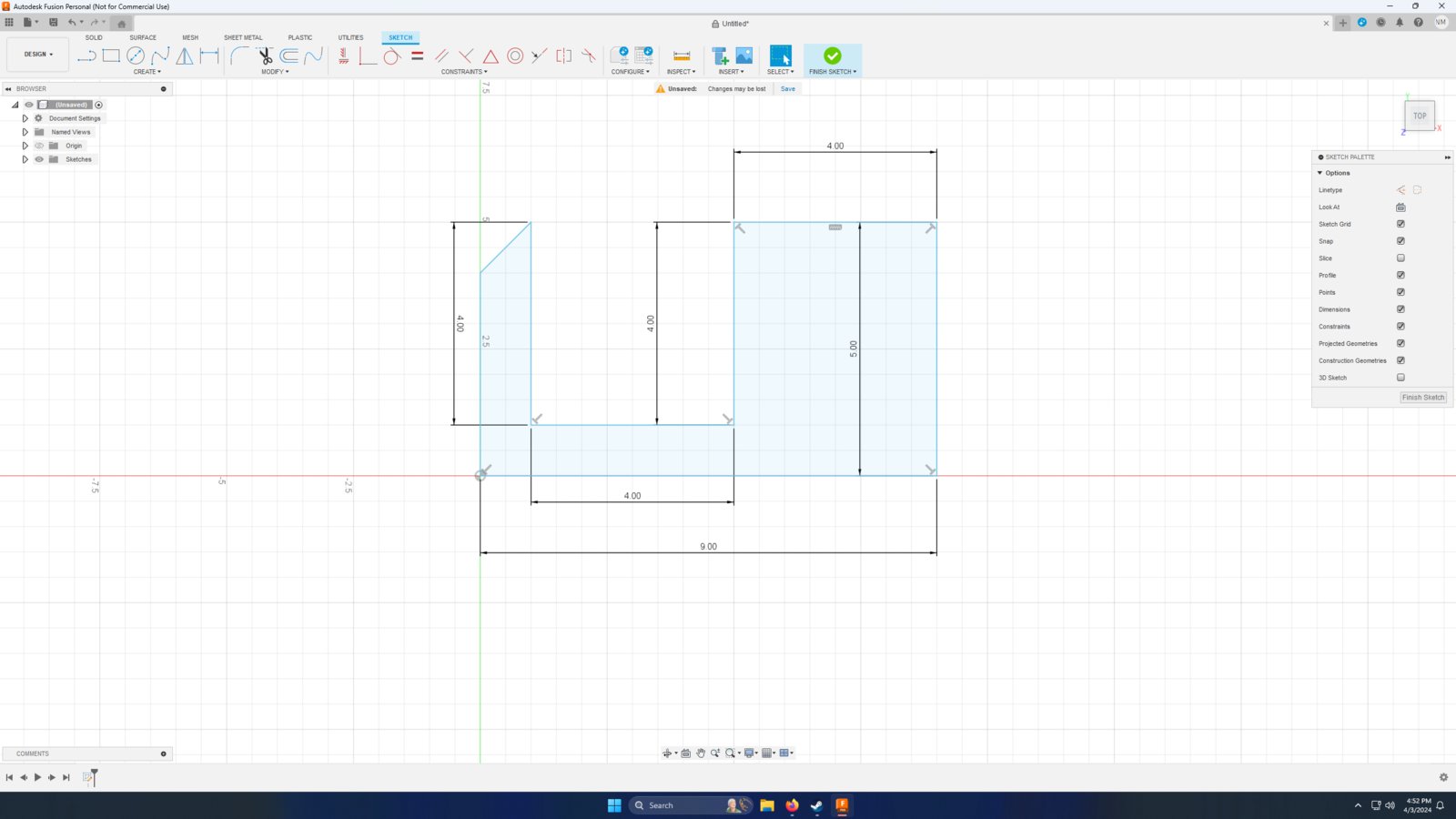

    Man, I wish I was that kwik to draw
    Oh wait

    Not at all.
    I purposely overloaded the box to see if any sag was noticed. Just got back from 1600 mile round trip. It's still exactly the same as when I installed it.
