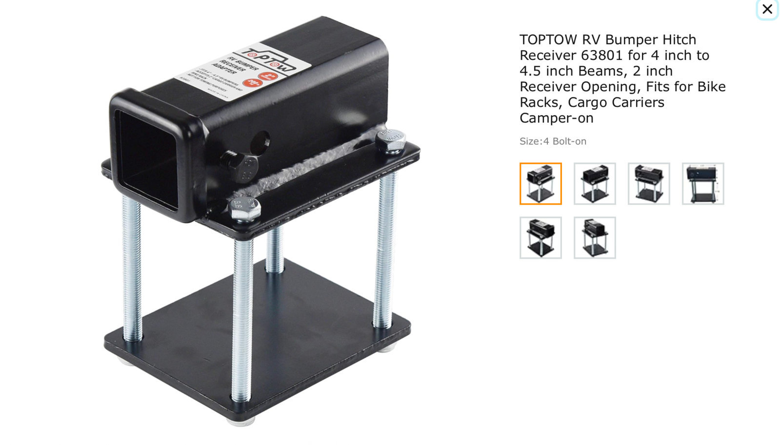

    So my question would be, if you add a 2” receiver hitch that clamps onto the bumper between the bumper mounts, compered to your brackets that attach near the frame mounts, would that make a difference as far as torquing the bumper?

    Most of the hitch receivers are mounted directly to the trailer frame in front of the tube bumper.
    I wouldn't be comfortable mounting a receiver hitch to the 14 gauge bumper unless it was only going to hold a bike bracket.

    This is the receiver I’m talking about

    That would be fine for sticking in a bike rack.

    What he was trying to tell you is that the bumper is about half the thickness of the plates of that receiver. In 4" square tubing, that isn't going to be strong. Camper/motorhome bumpers are more for show, you get hit and it's going to fold pretty easily. Carrying (or pulling) more than 100 lbs would be pushing it.

    You still have the same thinwall tubing as the base. Some people run a piece of 2" square up under the camper and tie into the frame for support. The only way to get the bumper to support anything heavier than a bike rack is to cut it off and weld on a heavier piece of 4" square.

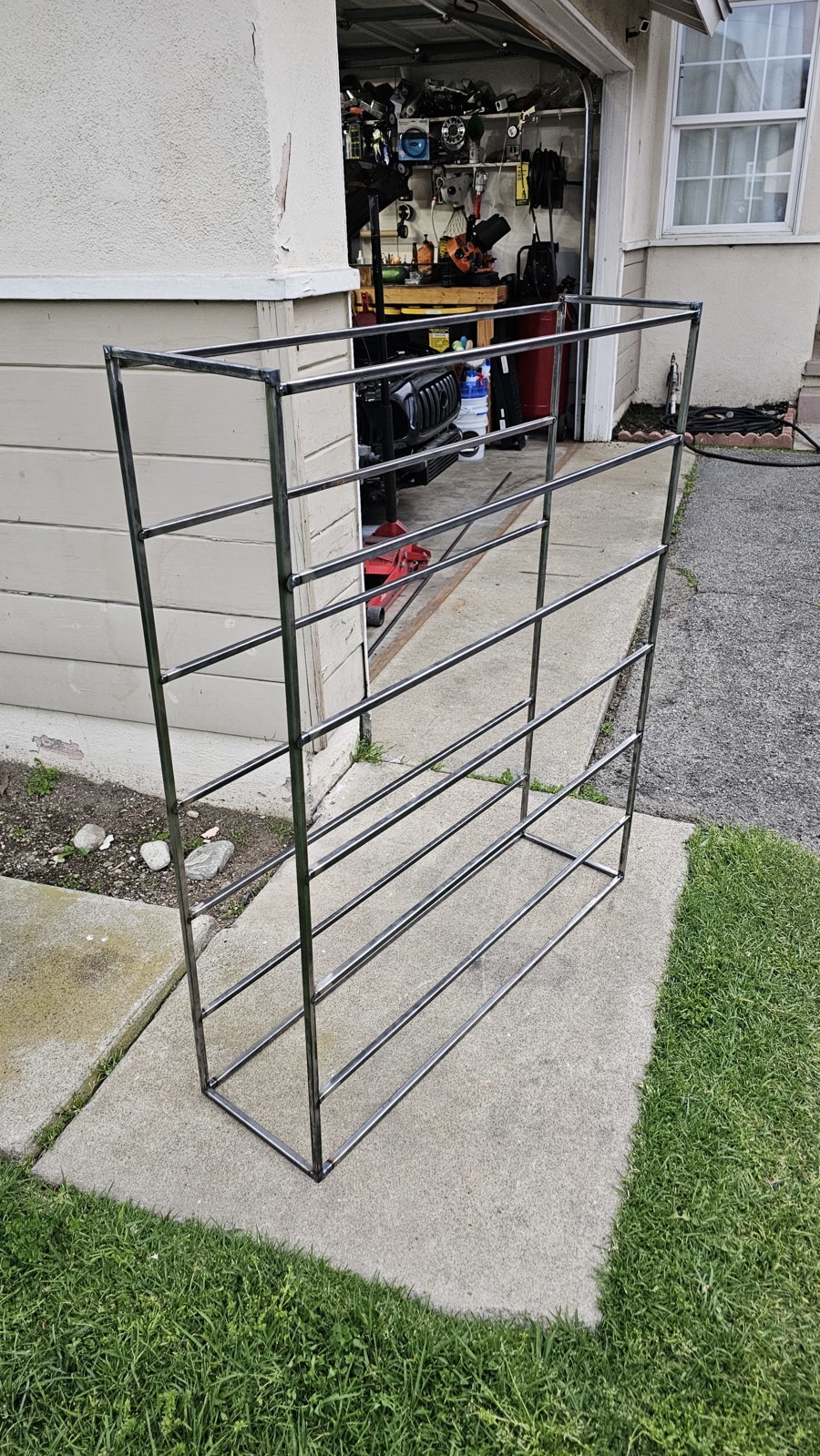

    Finally finished the shoe rack I started......Last October lol. Just needs some paint now.
