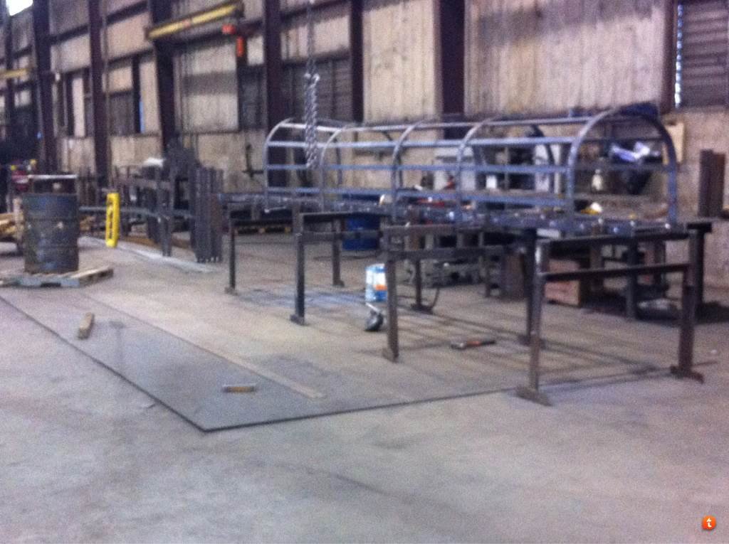

    Here we go!!!

    Got any close ups?

    Not yet. I will try and get a couple tomorrow.

    Looks good!

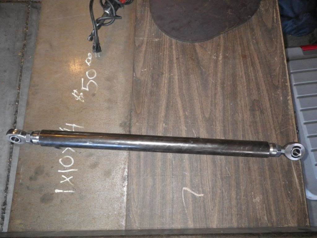

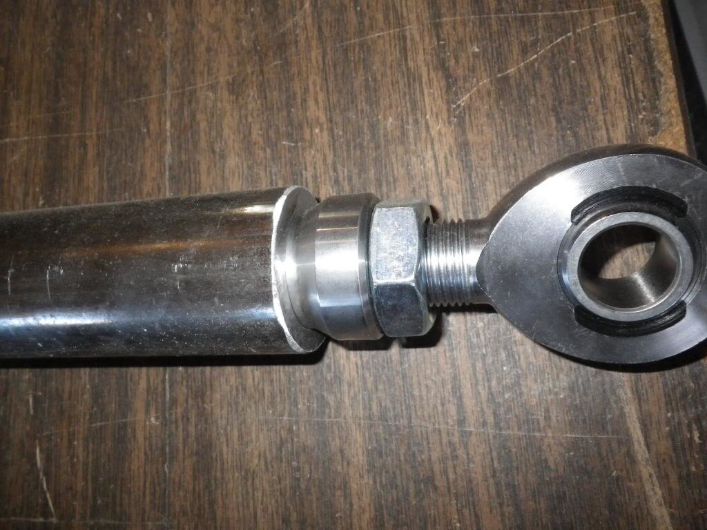

    Question for those of you that have done welding on links, what is the best way to weld the weld-o-lets to the DOM, fully inserted or sticking out some for more surface area?
    1.75 DOM, .25 wall, 7/8 x 3/4 heims.
  8. Feb 21, 2014 at 10:42 AM
    #2808
    45acp
    45acp Paint me back in Wyoming again...
    Aug 9, 2009
    #20861
    6,706
    Jonathan
    Boring, Wisconsin
    1981 Long bed 4x4
    I'd set them all the way in there. They're already beveled for welding.

    Set them all the way in, key hole it while someone else rotates them for you.
  10. Feb 21, 2014 at 11:33 AM
    #2810
    Wishbone Runner
    Wishbone Runner Because 4R
    Sep 9, 2012
    #86546
    6,353
    James
    CO
    04 SR5 4Runner
    King/Dirt King
    Thanks, that what I figured, but just checking. What do you mean by key hole?

    What I used to weld out at work before I started my fab job
    But now i'm currently studying for my certified welding inspector test for work
