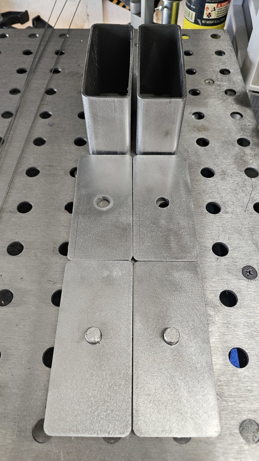

    Another day another set of blocks going out.

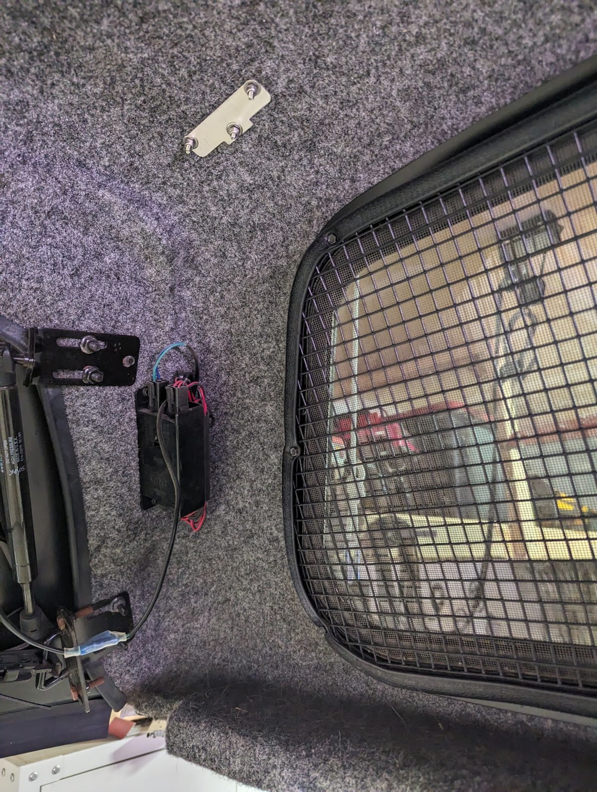

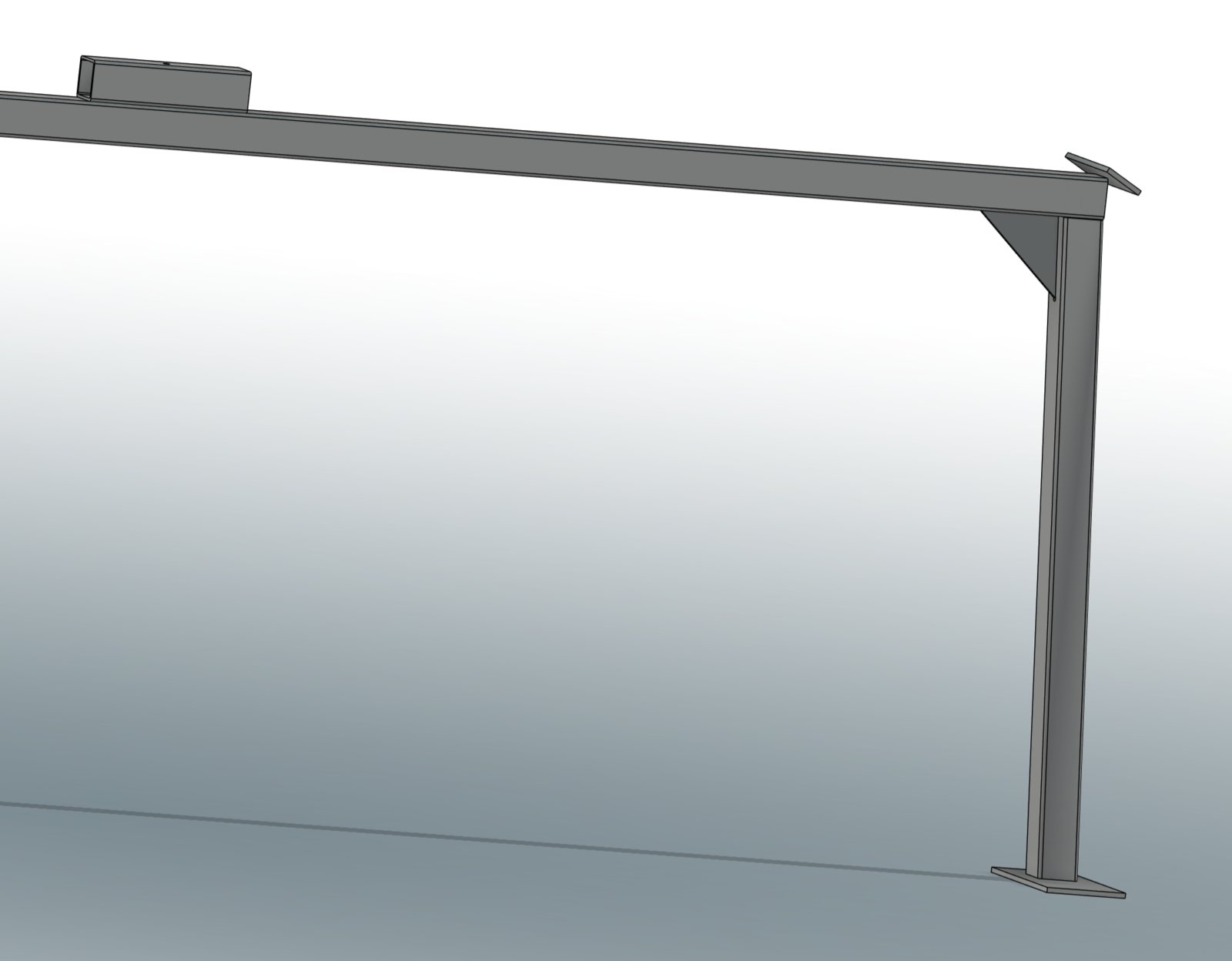

    I have a camper shell with a ultra low profile roof rack bolted to it. it's fixed on each end and one in the middle. I've had it for a year and so far it's been great but I do worry that it could crack over time so I'm considering adding an internal 1" 14awg structure to it. The base is going to sit on the inside of the shell.
    Dumb idea?
    Here is a rough sketch of the rear drivers side corner

    it won't really hurt, but it also won't prevent it from cracking. it's more like putting your hand behind cardboard. it makes it slightly stiffer, but will still move enough to cause issues.

    My first thought was adding fiberglass reinforcement to those areas. A few layers of a heavy chopped cloth would work. Taper their size...
    You'd have to peel back the interior carpet, etc... It would be a job, especially if you haven't worked with glass and resin before, but so would fabing an internal support structure...

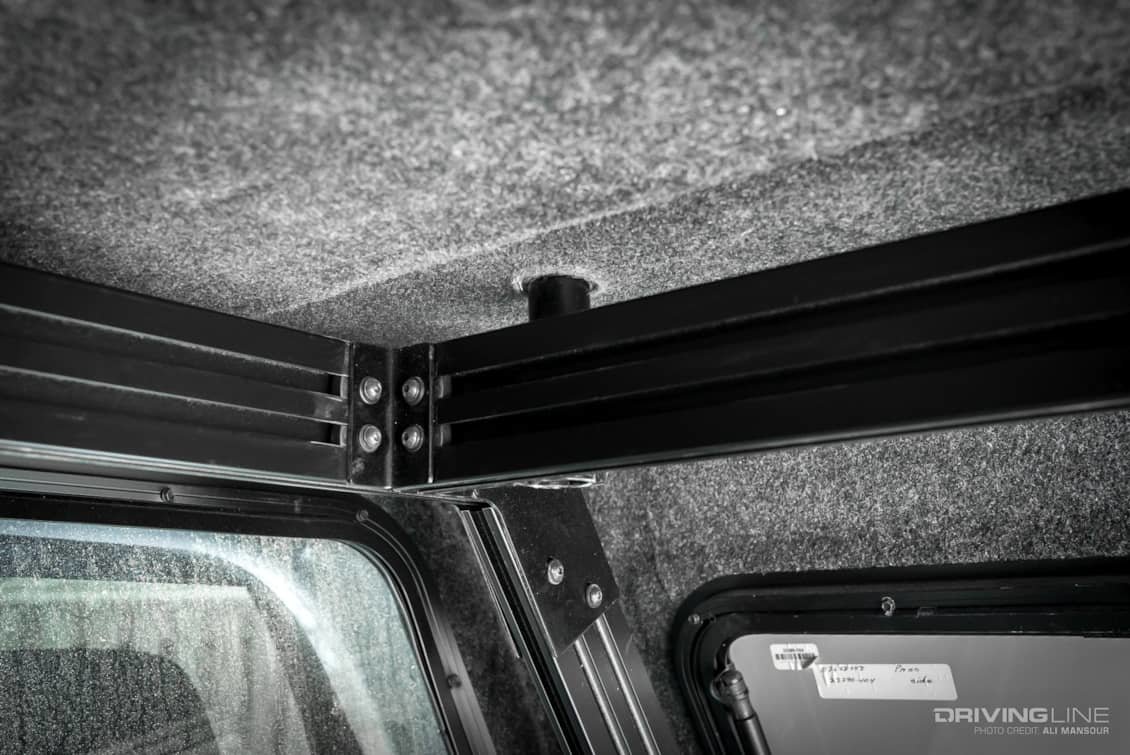

    ARE CXHD is pretty simple, rated for 500lb

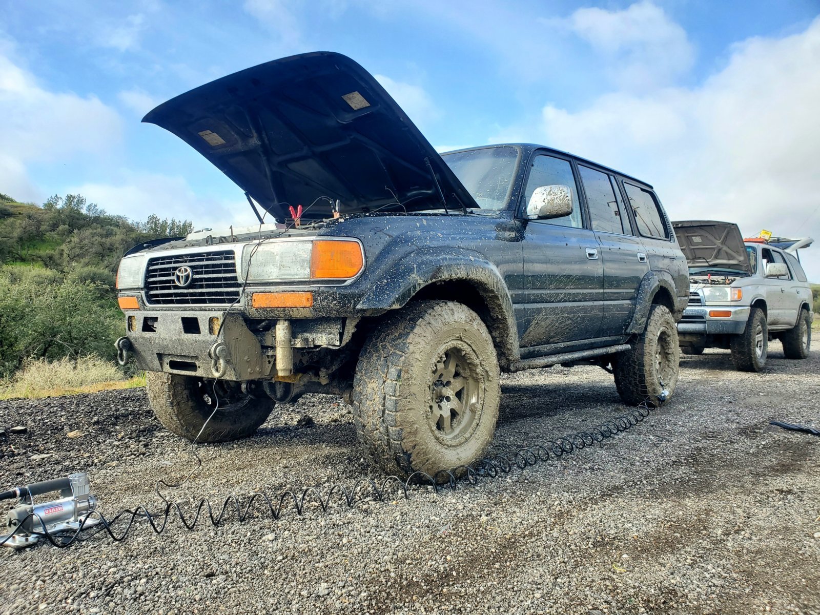

    I ran a Coastal Offroad on my Land Cruiser; great stuff for sure and definitely recommend
