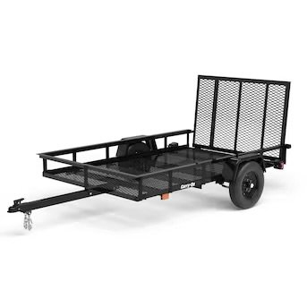

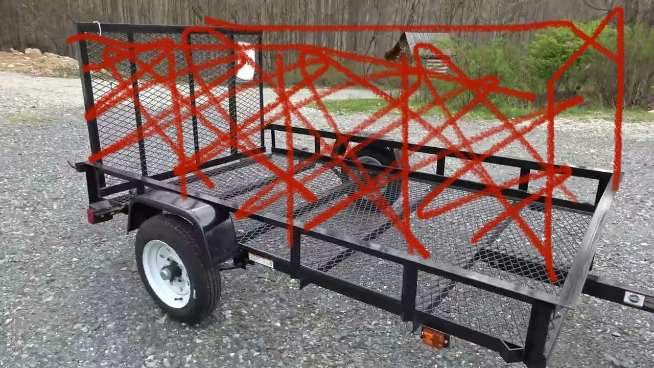

    Can't say anything about the trailers you mentioned; the HF one I almost picked up cause it would've been free (was offered to me) but I was too busy to pick it up
    You can opt at spending less and buying a used trailer that's already plated too
    If it needs some work, even more of a reason to negotiate as metal can always be cut and replaced; I wouldn't say having 'sides' welded up would cause the trailer to lose any resale value, it can be considered a utility trailer
    Fixed several trailers myself as small jobs, just helps having the material on hand already

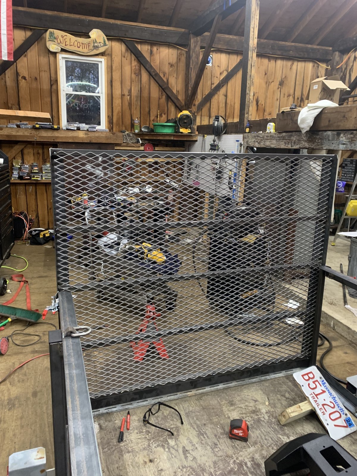

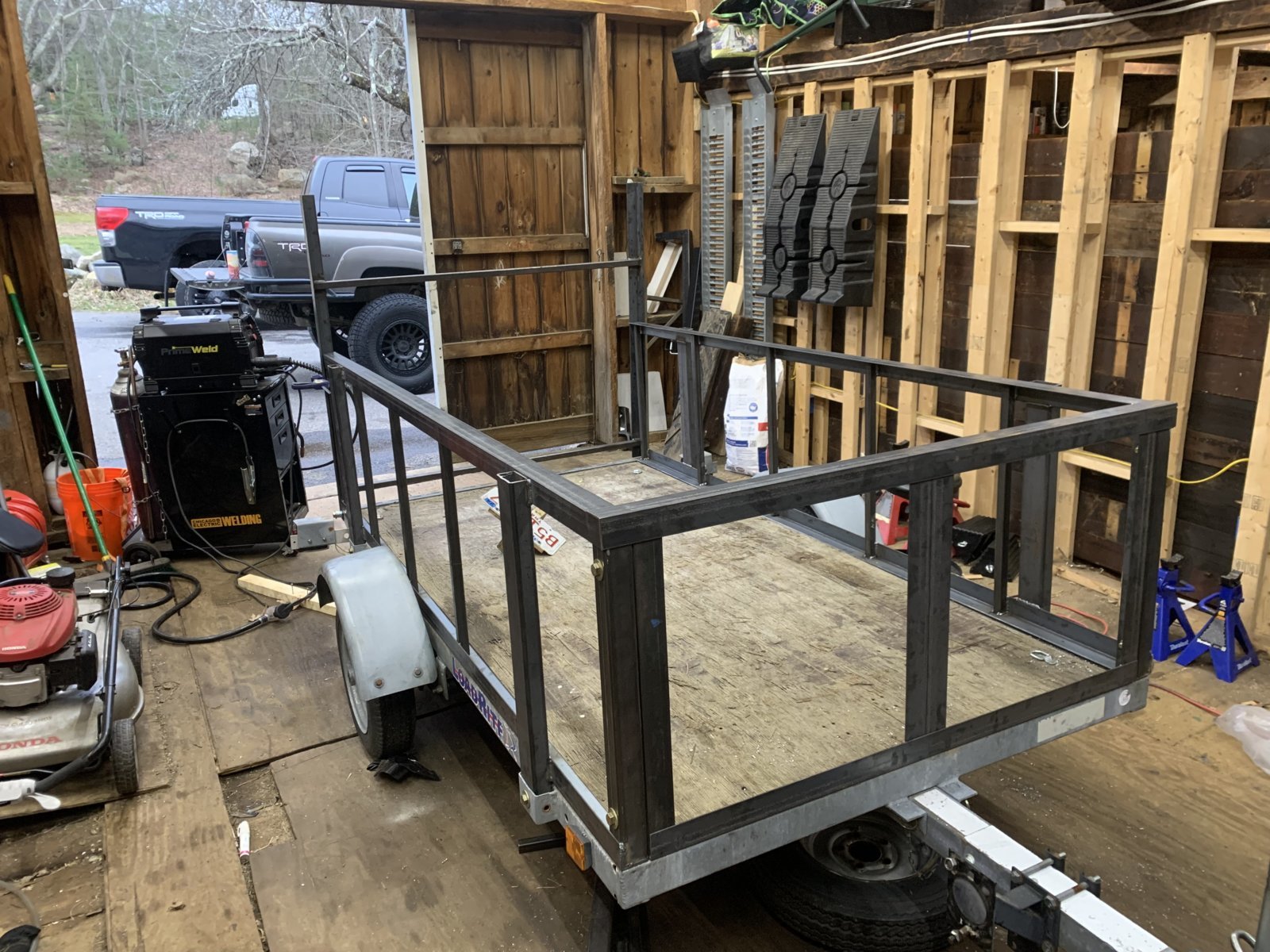

    I just did this for a friends trailer. His has stake pockets though so I put 1.5x3 box tube into the stake pockets. Then welded everything onto those 4 points. He is putting plywood on the sides.

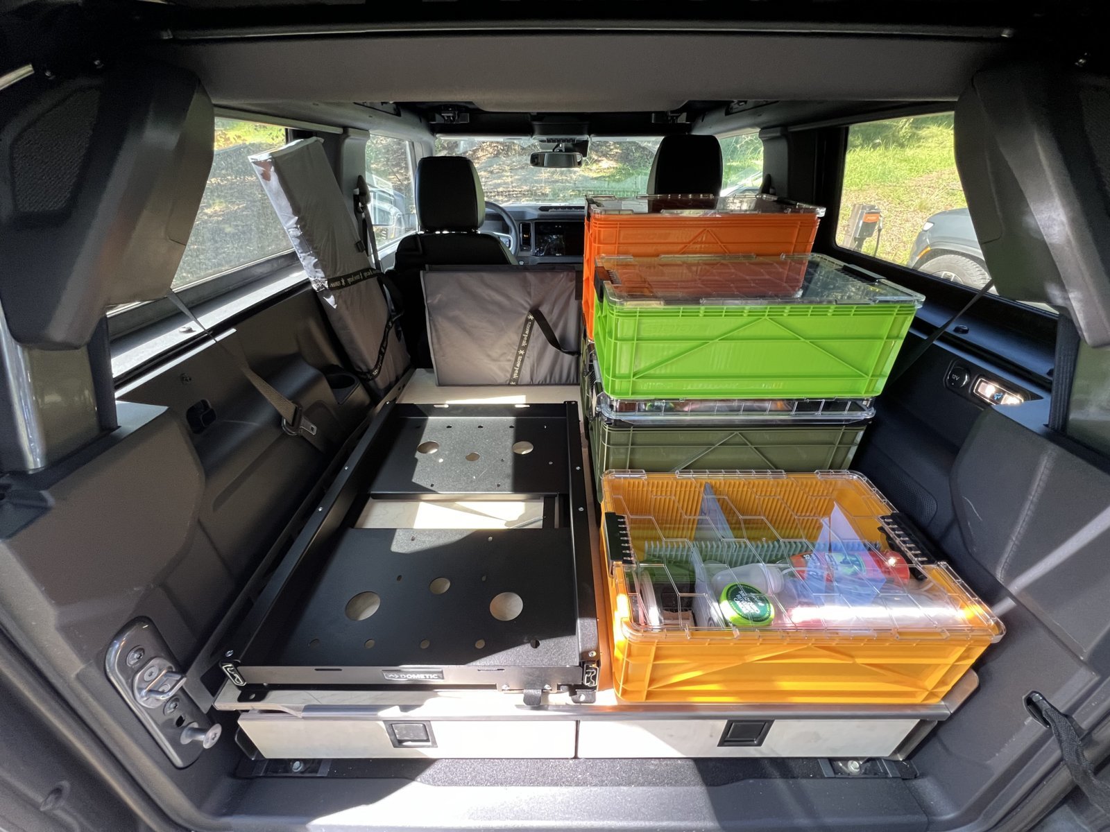

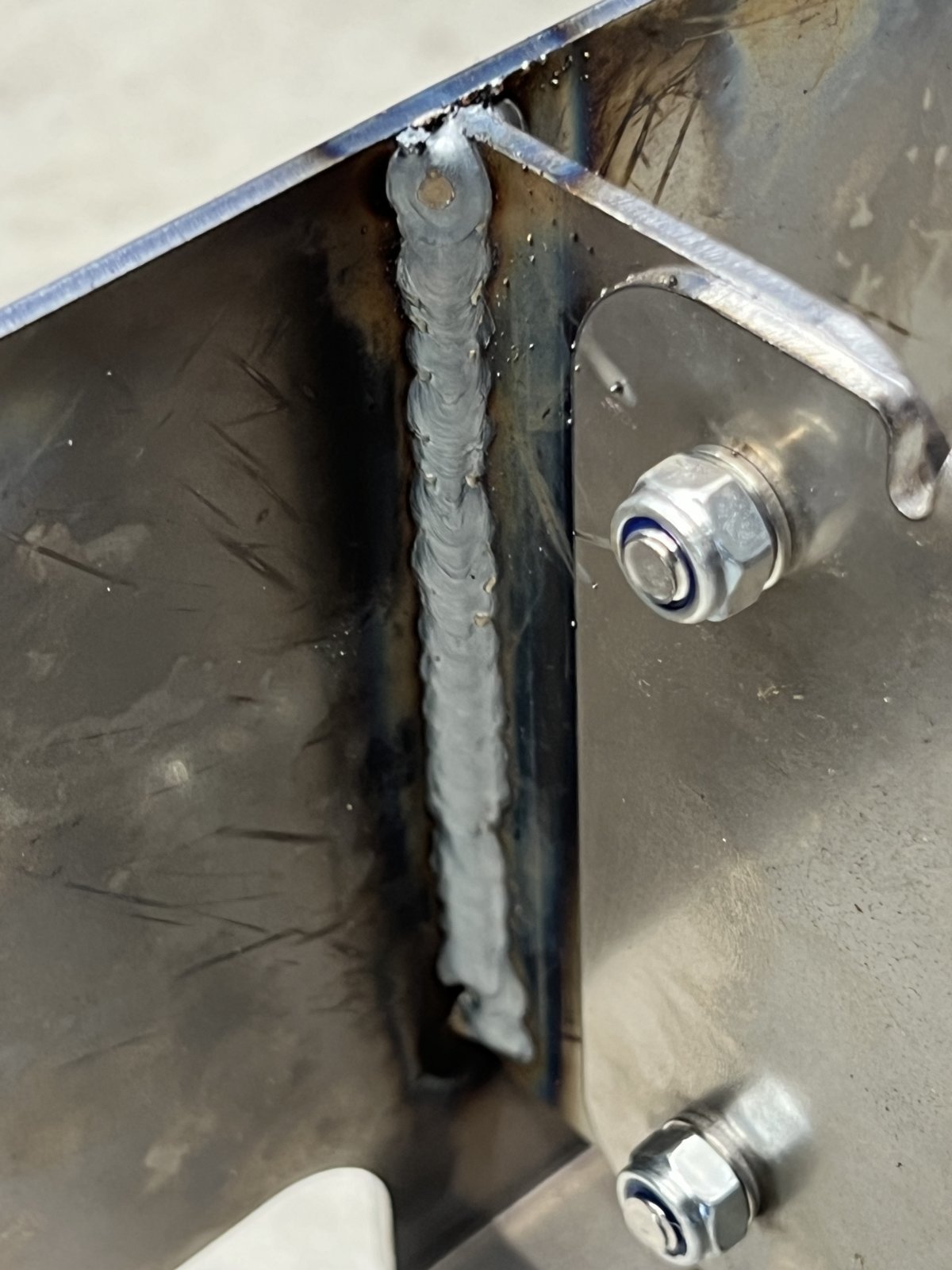

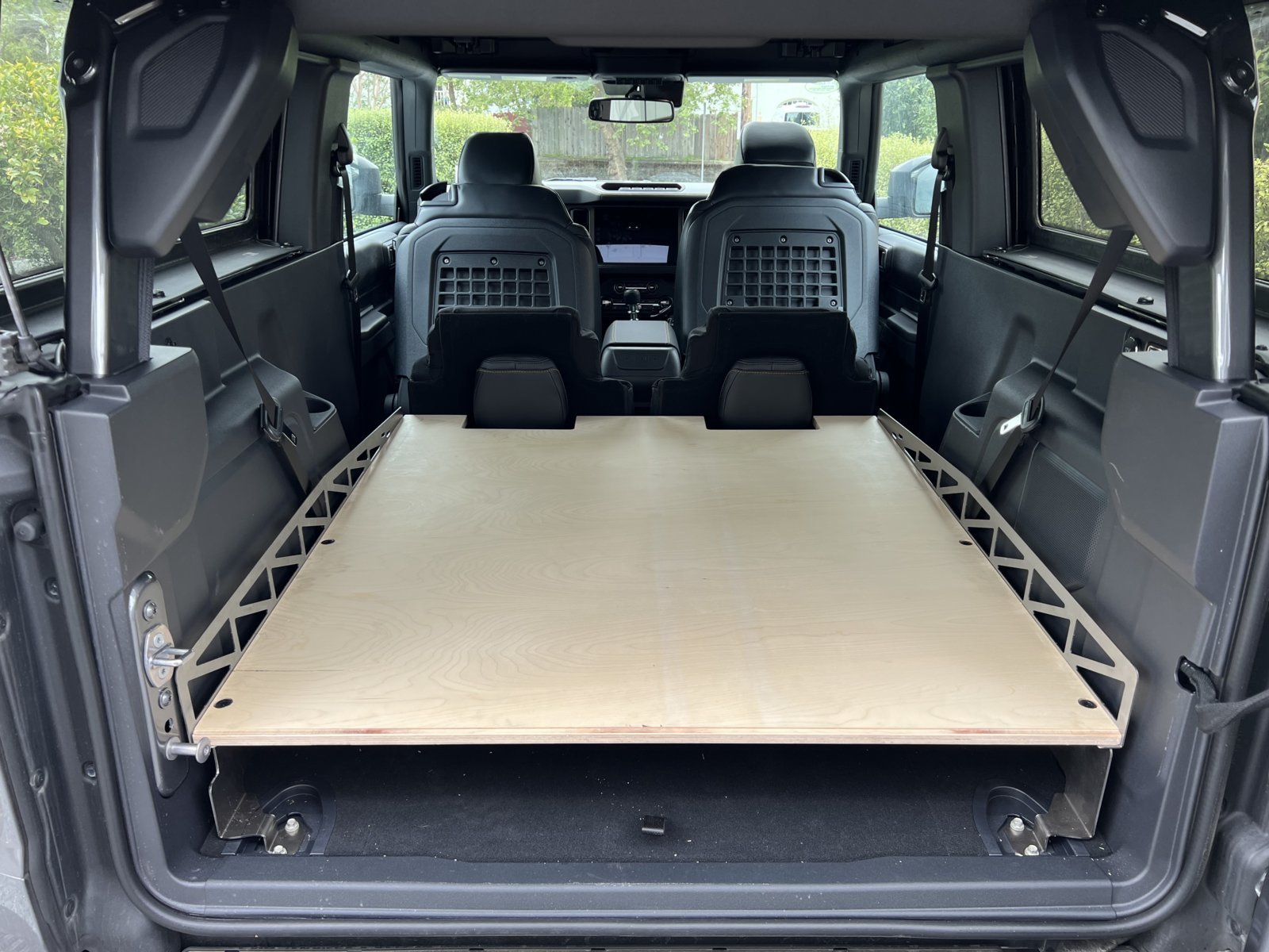

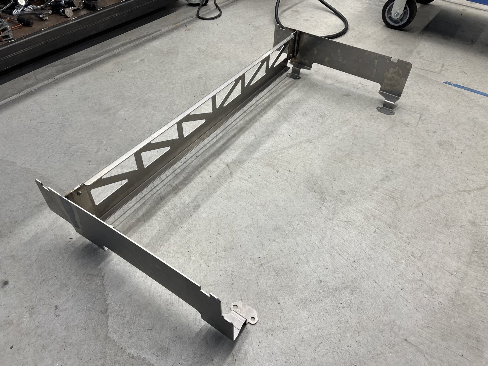

    It’s been a minute since I welded anything but got some parts from send cut send and had to do a little… rework. Oops. Making a cargo thingy for my brother-in-law’s 2d Bronco. Not sure all the gear is gonna fit!

    considering the cost of steel, and the implied use that it might only be once, i would do this instead
    https://www.uhaul.com/Trailers/6x12-Cargo-Trailer-Rental/RV/
    if you've got the steel on hand, maybe a little different story. i would just do 3-4 pairs of uprights with a brace across the top, basically your own 'ladder rack', and then stretch a tarp over it.

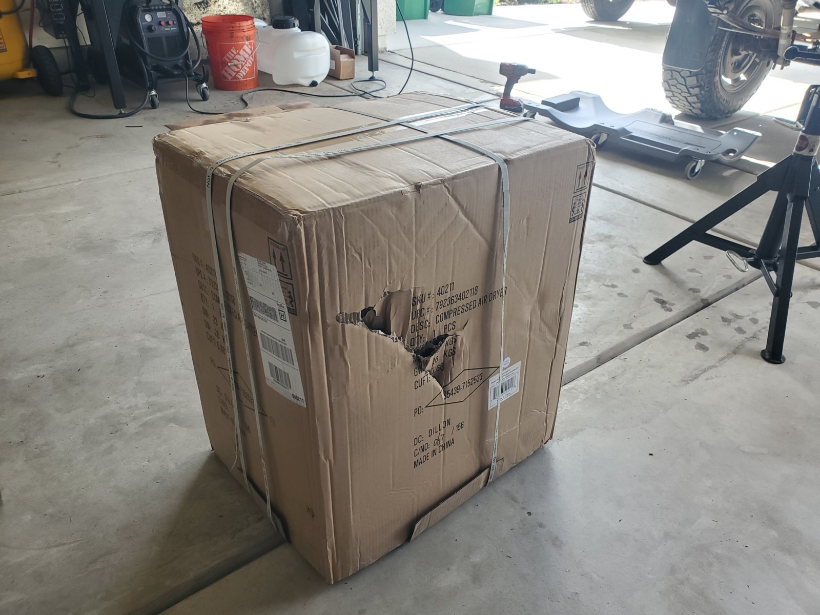

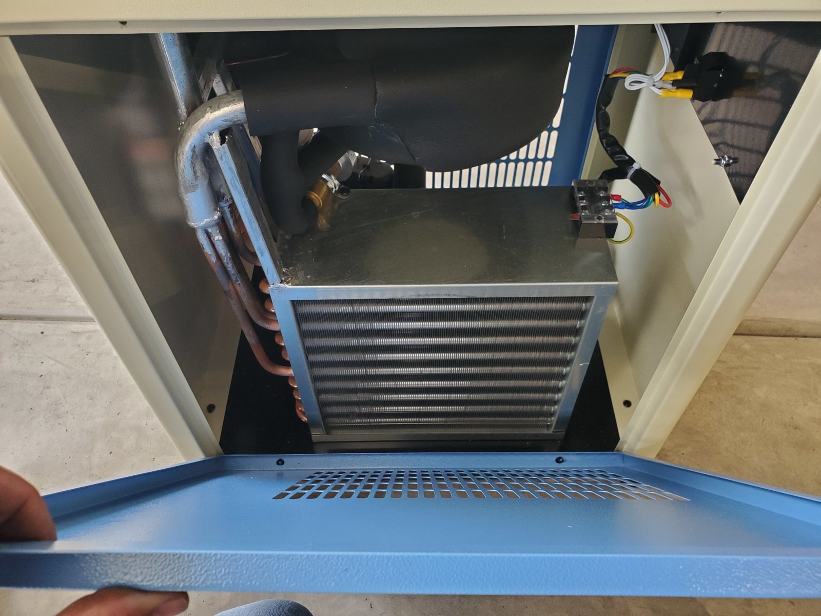

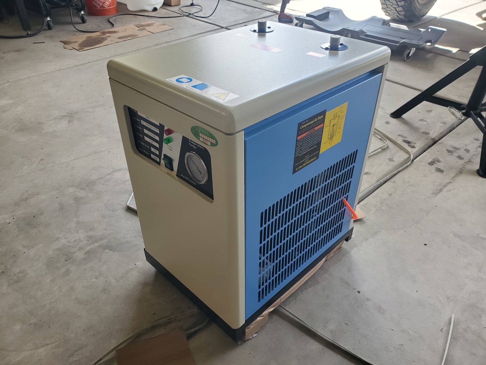

    Air dryer arrived 2 days early :D
    Check out those atrocious welds :rofl:
    Just need to buy a power cable for it and figure out where I'll be placing it

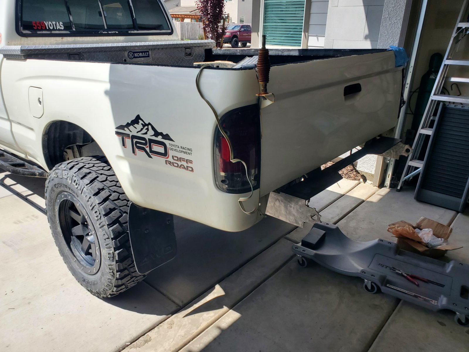

    Friend was by for some last minute measurements

    Love the design!

    Run hotter ;)

    Thanks! Bit of a puzzle as my brother wants to keep the rear seats. (I would take them out) So the whole thing has to come out easily. So far so good. 4 bolts and the whole thing lifts out. The frame stays behind but is unobtrusive. I just need to reinforce the mounts a bit as they’re a little springy, but I have a plan. Wish I had a friend around the corner with a plasma and a brake! lol.

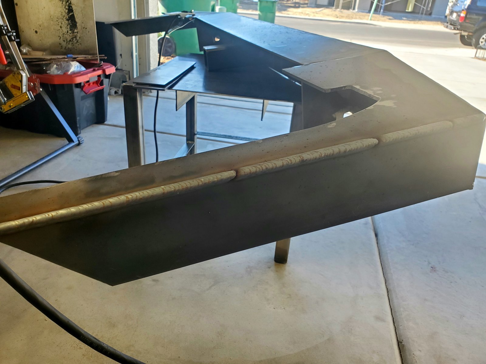

    Im putting too much heat into it. I have open corners that are meting. There is a butt load of welding on this fully boxed 10 gauge gusset and I keep getting it too hot. Even after I setup both at the same and then alternated. I have some blocks on aluminum to set them on but I still have to walk away for an hour to let them cool.
    :annoyed::annoyed::annoyed:

    Oops realized when I said "run hotter" I was actually referring to @Zebinator welds thinking they were also yours
    I do a ton of 10 gauge and run it as hot as someone runs 3/16"
    Even on open corners like the first post in the page prior to this one
    Hotter = more wirespeed which means more deposits filling in those open corners nicely

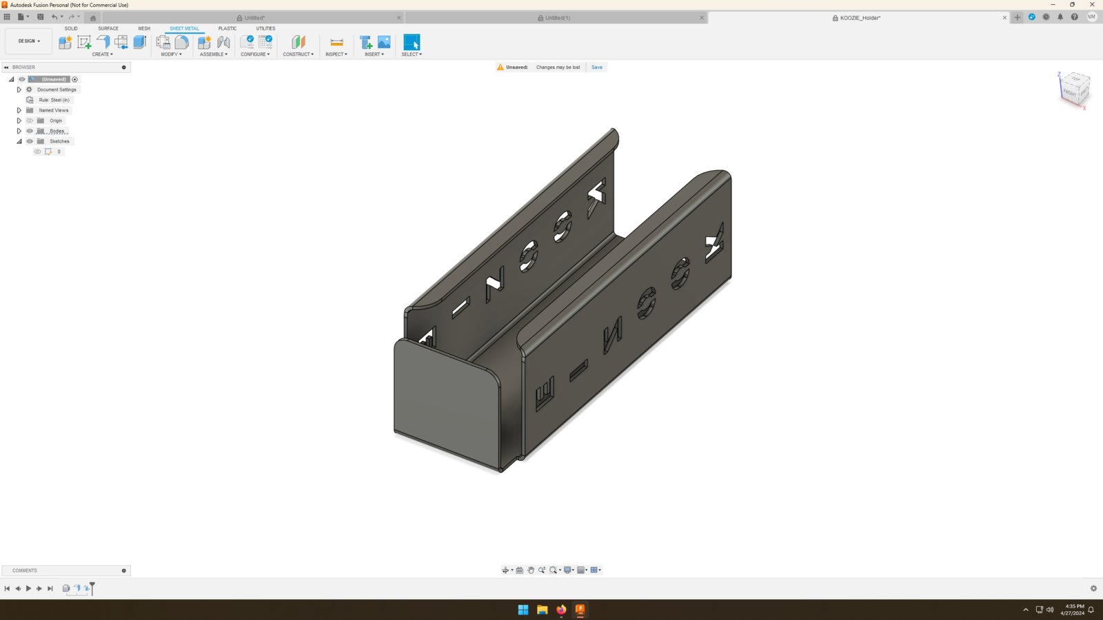

    Of course this is just a sample; I can add the bottle opener as shown in one of your links (choose one side or both) and a design if you want/need
