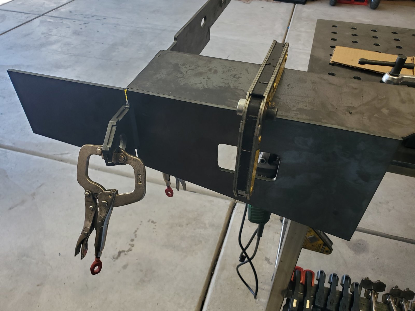

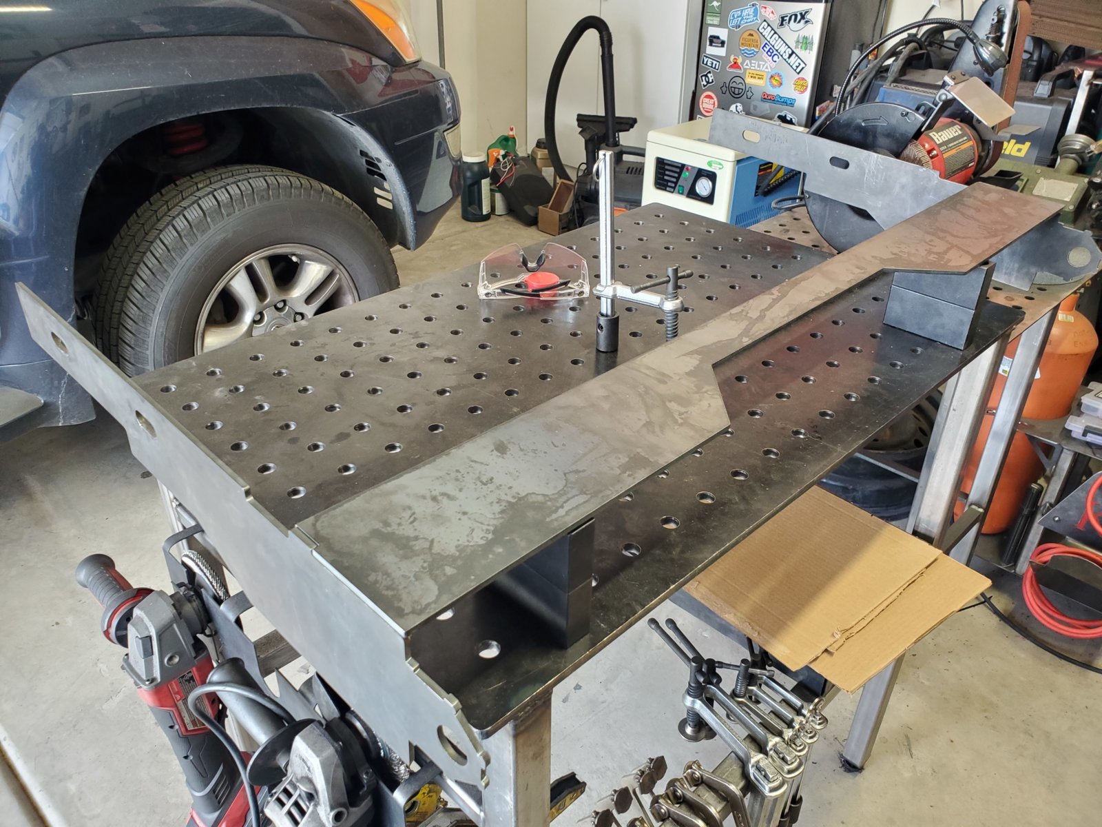

    Probably ship flat, but I'll cut a test piece out to ensure the relief cuts will suffice for bending
    Just need to get some steel :spending:

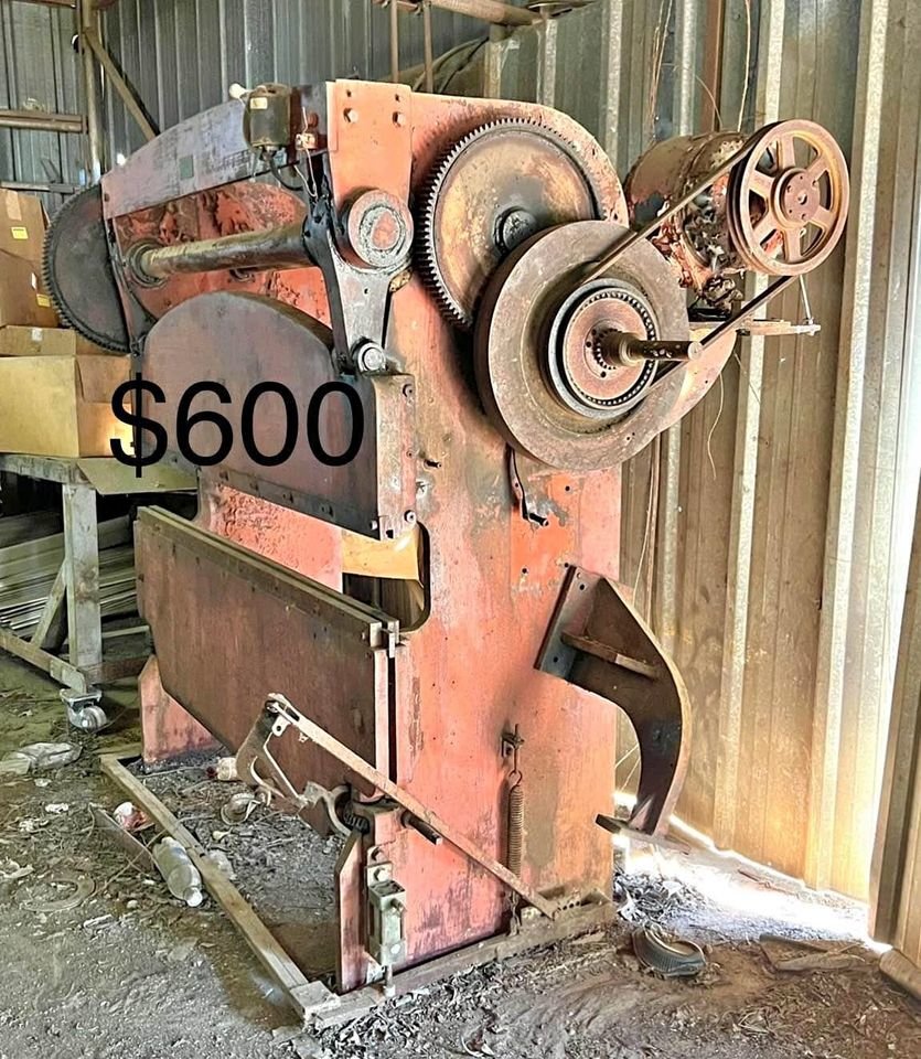

    I’m gonna guess that’s 20-30 tons so it’ll do a couple feet of 1/4… do you have the all important press brake chart?
    And yes they do get massive.
    For 600… you couldn’t buy the steel to make that for 600! Could be a good foundation for a project!

    Yeah at our fab shop we have a massive Cincinnati brake and even that tops out at like 3/4" I believe. Hell, even bending 1/8" plate requires a decent press to do it cleanly
    Definitely would have one in my dream shop if I was a millionaire tho lol

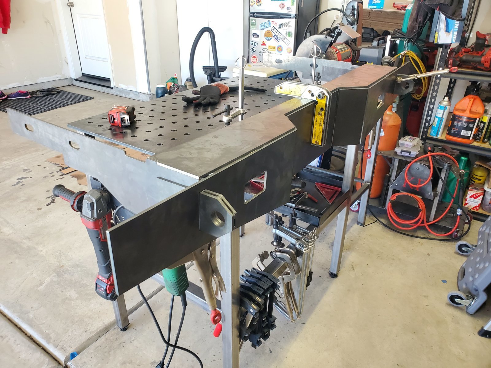

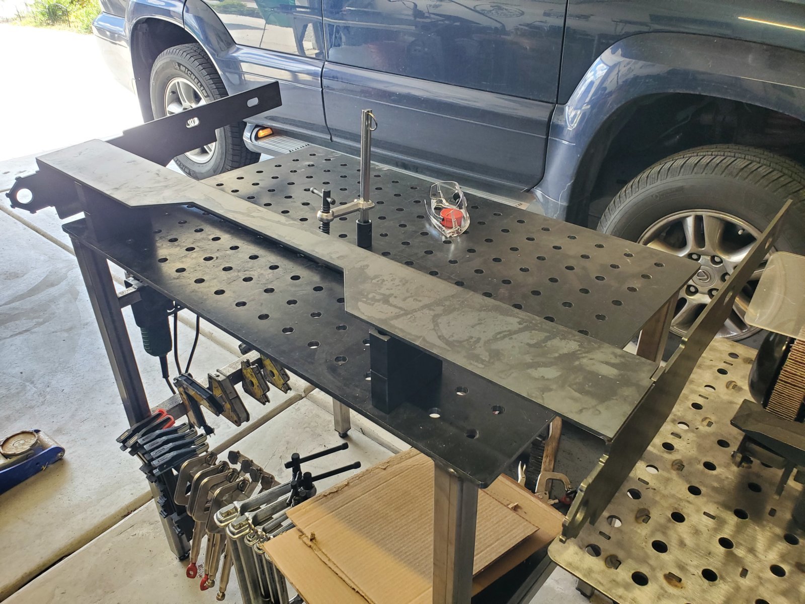

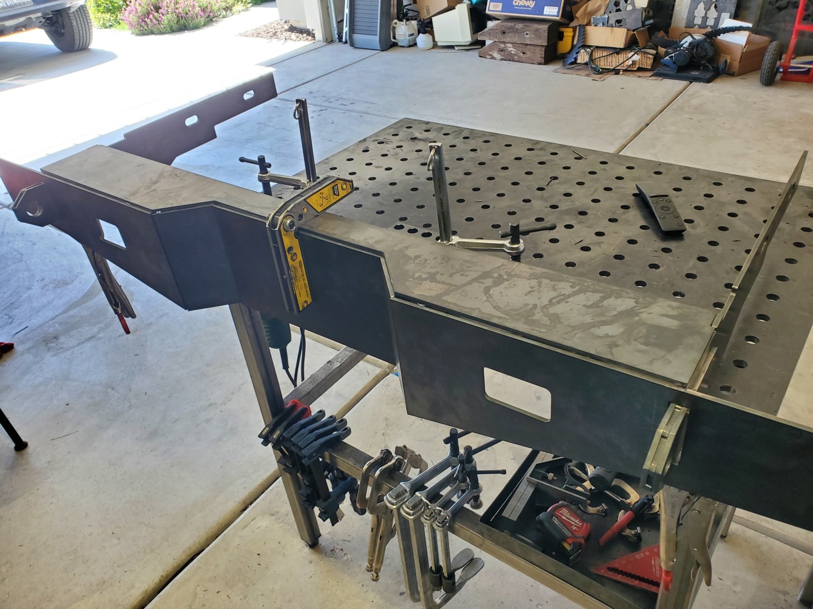

    Follow up to this
    Tacked the mounts and top panel together and threw it up on the table
    Also tacked some pipe to maintain the width needed; don't need it closing up on me when I burn it in later
    It'll get replaced by a larger piece of DOM for strength

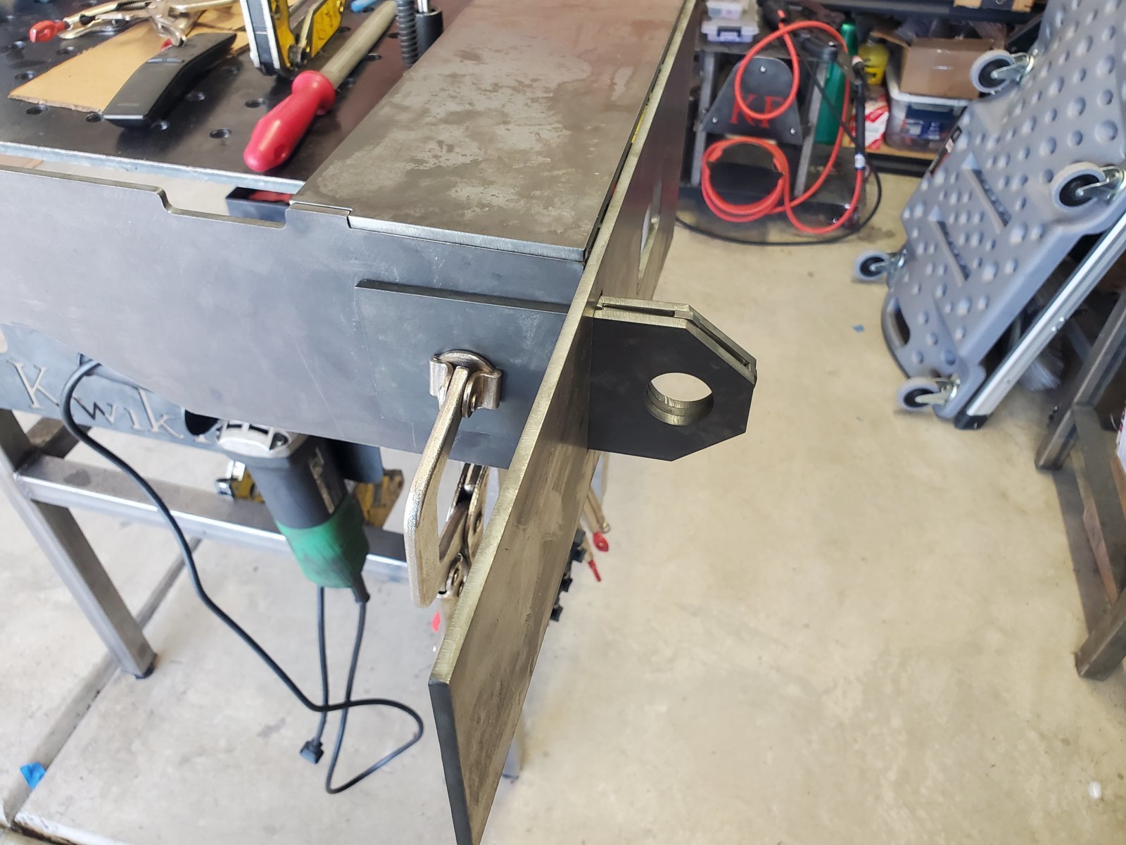

    Did some CAD to work up the face
    Drew it up and cut a few test pieces; this would allow me to get the right sized opening for the recovery points as well as making this a one piece
    Also lengthened the recovery points as to weld them directly to the frame mounts
    They will also be welded along the outer edges when they're sandwhiched together as well as at the opening on the front face
    Bulk of it is now already done
    Will most likely wait for the lights to be ordered before I burn things in
    Gussetting will be added between the top and behind the front face
    Then I'll work on closing up the bottom before doing more work on the wings

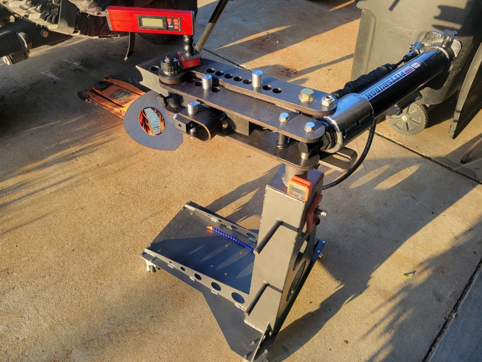

    Finally finished the bender project.

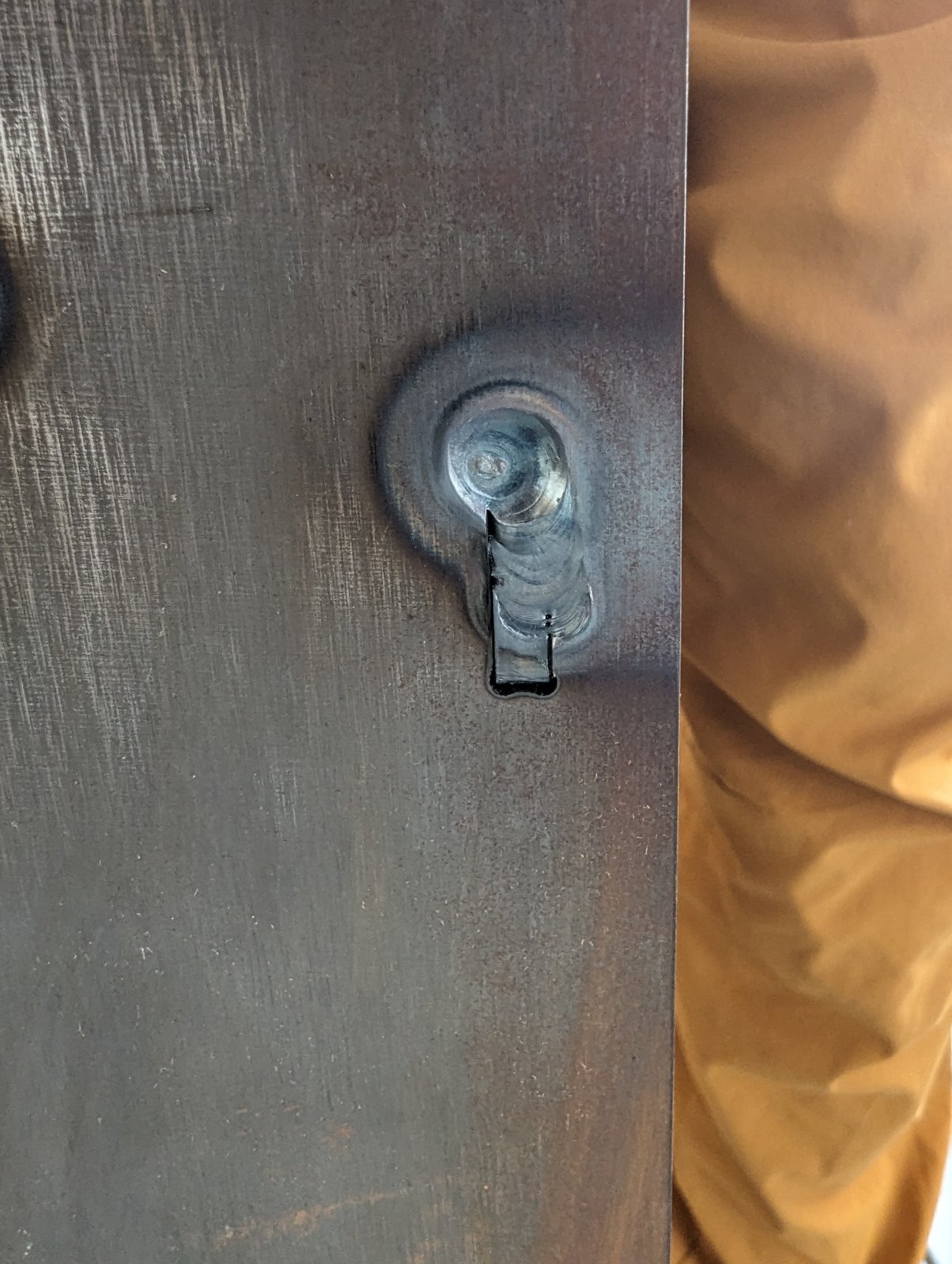

    What's the best way to remove this? Drill it out?

    Sure, I mean that's just one angle/picture of it and depending on the tools at hand and what you're trying to keep intact varies greatly
    Just know you'll want a good cobalt bit as the heat had hardened that metal up

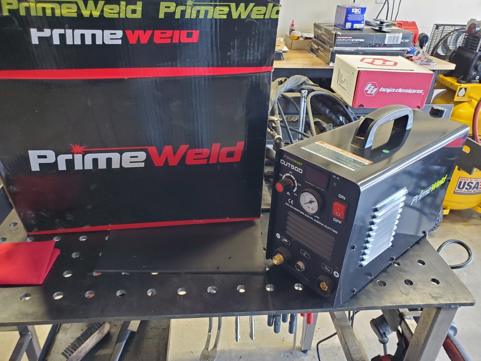

    Picked up another PrimeWeld machine :laughing:
    Actually, it isn't for me. Just happened to pop up on FB and I stumbled across it.
    Listed for $200, but got it for $150. Was happy to find @El Taco Diablo a means of cutting metal without resorting to an angle grinder for everything :rofl:
    Sat for years and was never used.
