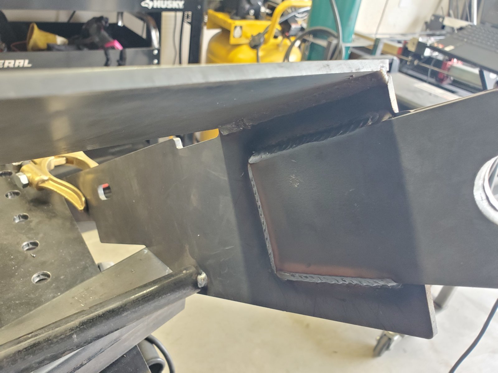

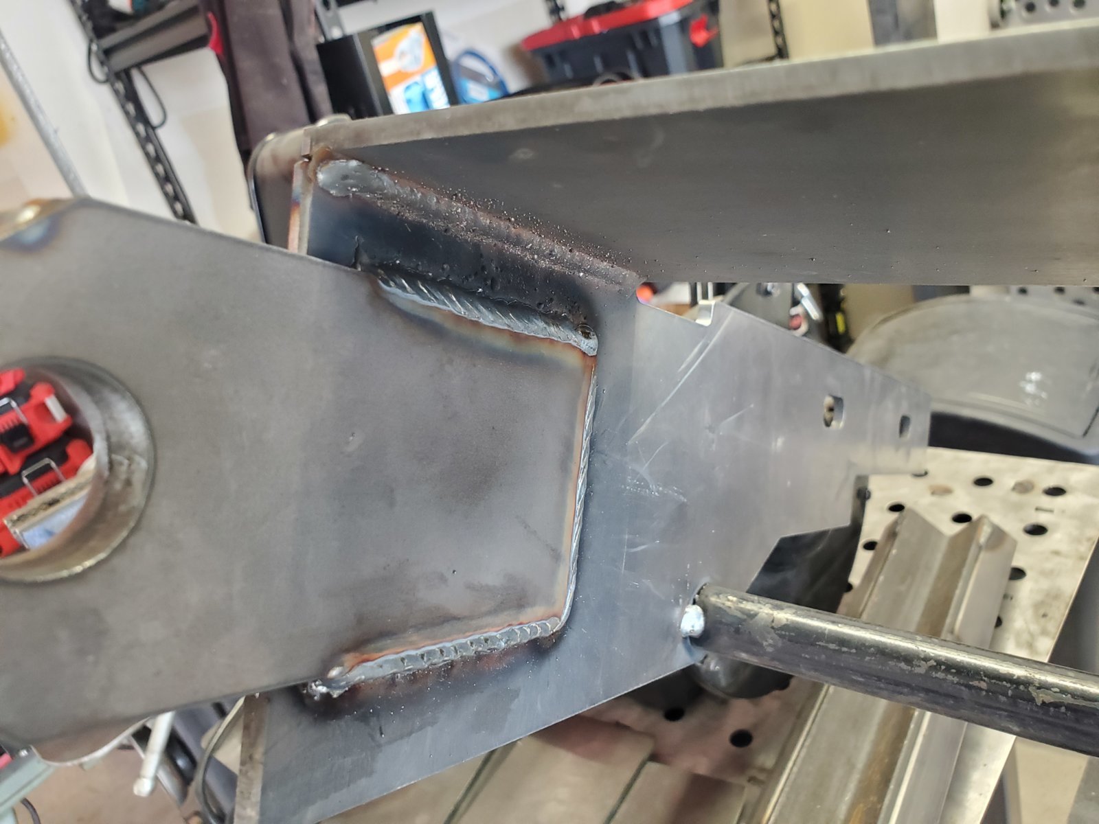

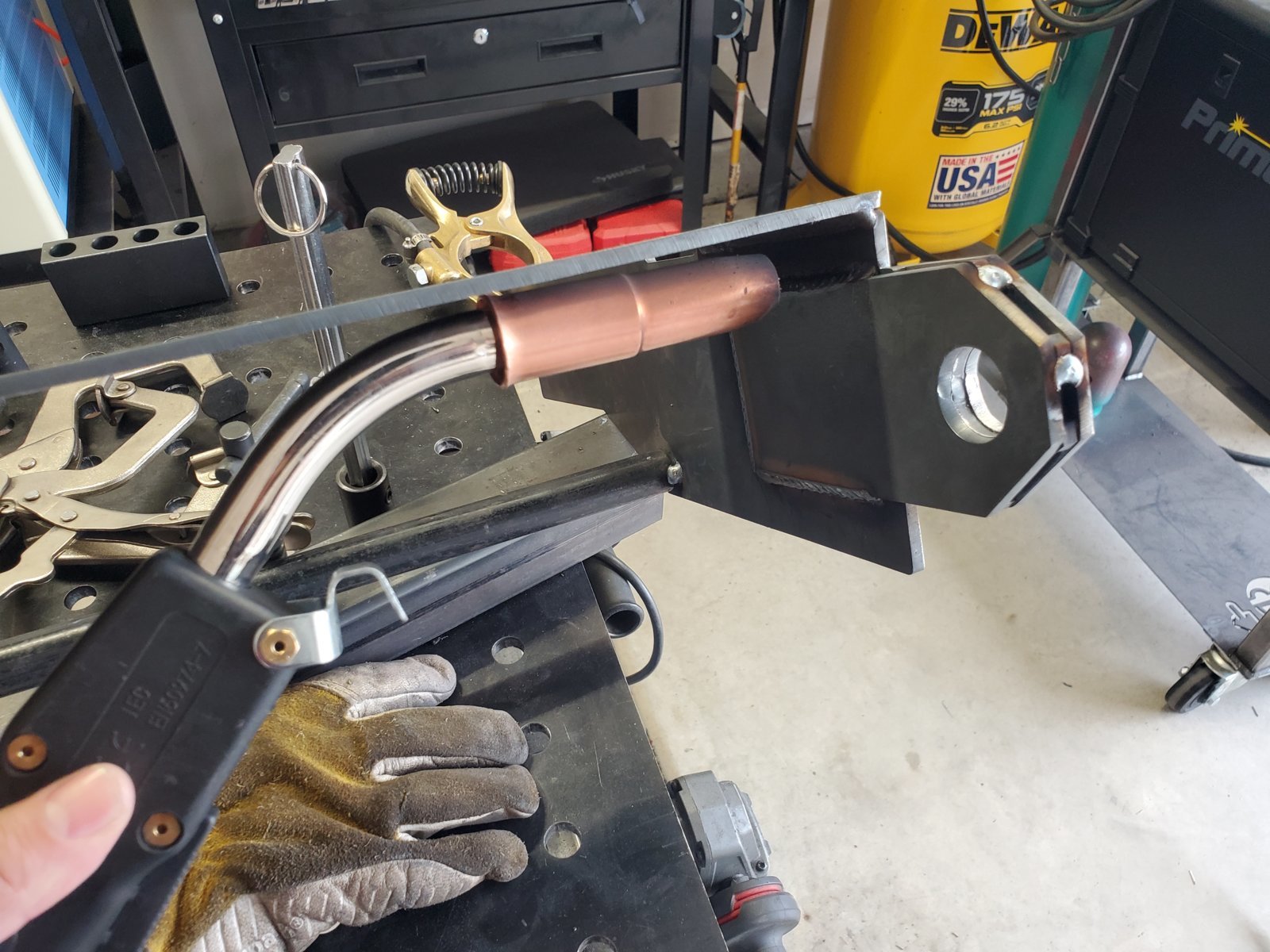

    Just do yourself a favor and ensure you can run said techniques correctly with both hands and both out of position
    Just had to weld the tops of these recovery mounts as the top plate is already welded
    Right hand, out of position push
    Left hand out of position push
    Not a small torch by any means :rofl:

    lol, i do a lot of blind welding, where i can get the torch in between the two surfaces, but there's not enough space for me to see it!

    I both blame and thank my last fab job; it had me do TONS of out of position welding and I wouldn't be able to knock this out easily if I didn't have to experience a lot of that

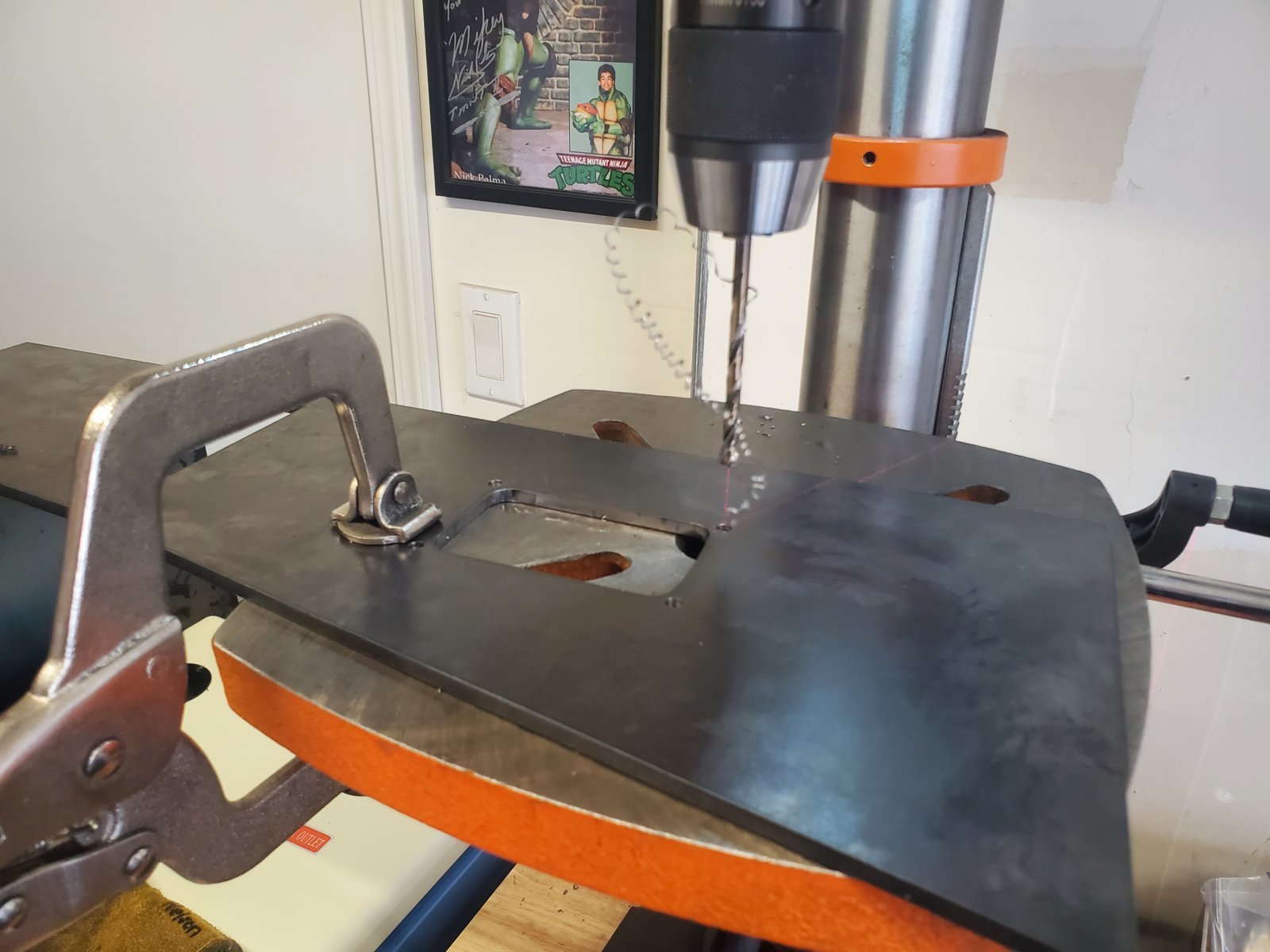

    Little more labor but she's sanded down; that little finger belt sander I bought for making bottle openers coming in clutch
    And now to drill @Zebinator favorite bolt hole pattern :laughing:

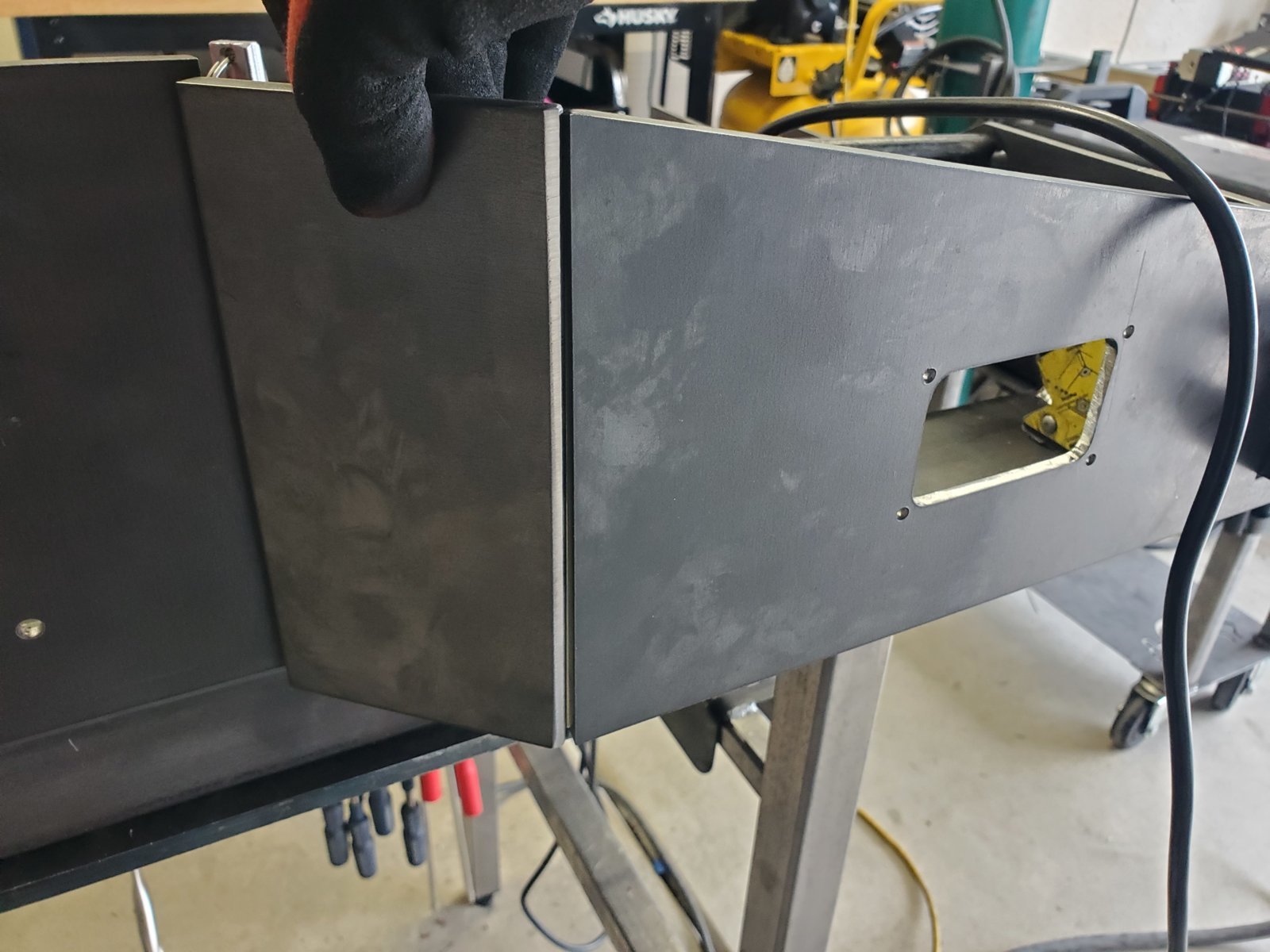

    She looks good
    Now to get the other part clearanced, drilled, and tack all the face pieces together

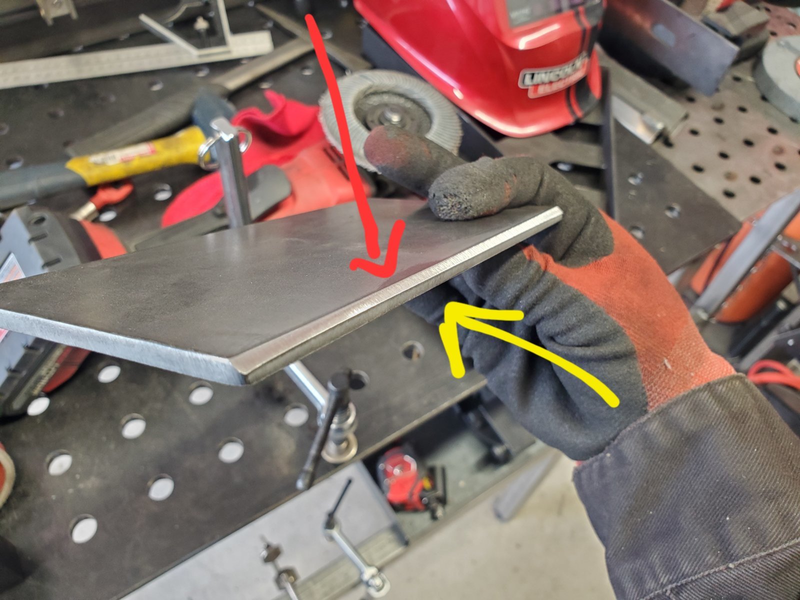

    @soggyBottom
    I'm not doing a welding test but just an example as to why bend tests are done and why this practice is done a lot with fab work
    The red depicts the bevel, and the yellow flat spot is called the landing
    You will mate two pieces that are done just the same with a small gap between the landings
    The landing maintains some thickness and allows for a nice even area for weld deposits to collect and fuse both pieces together
    The beveled area allows one to fill and better fuse everything together
