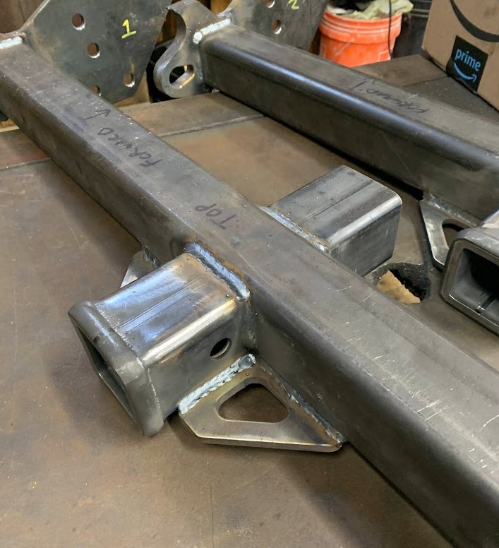

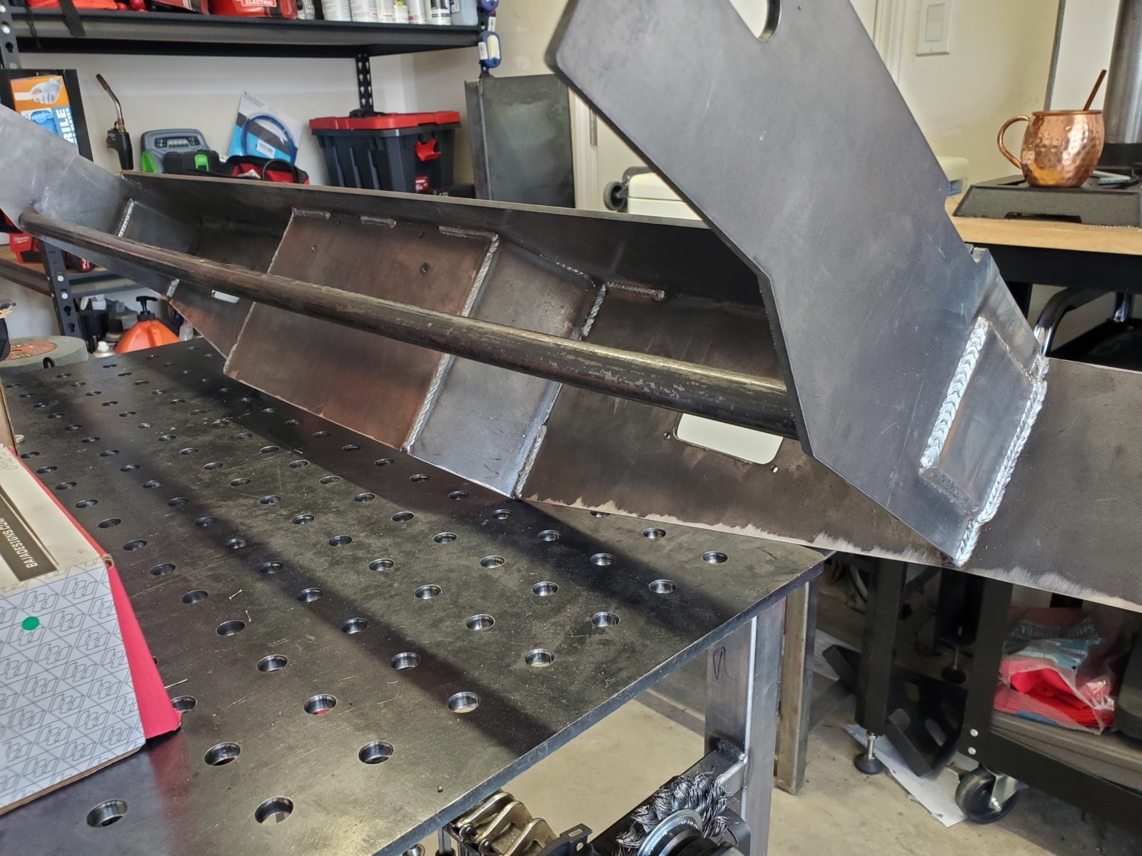

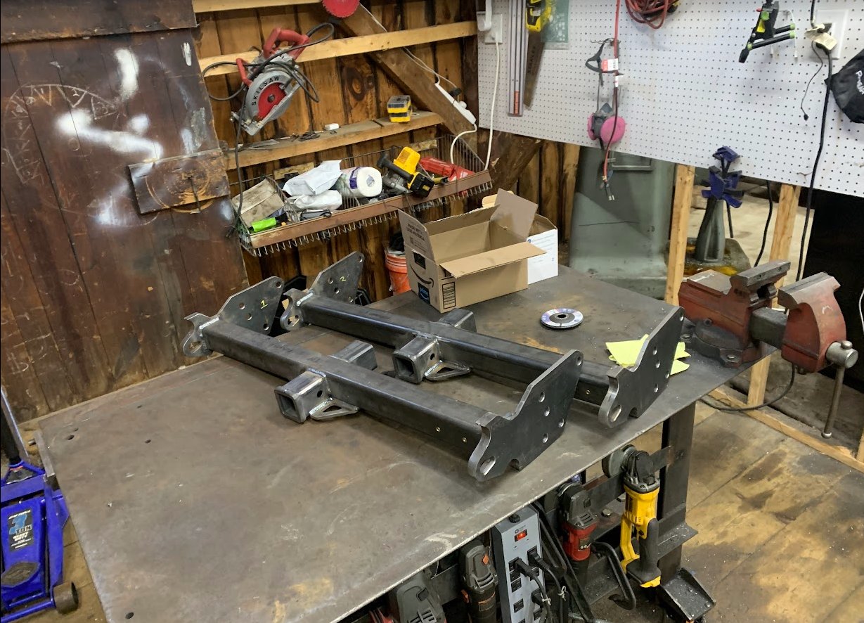

    ... both hands both out of position haha - not a chance for me. I get a fraction of the hood time and I need all I can to continue getting better with my good hand while in position. I love the setup of those anchor points. I have some mounting plates to build a rear bumper. I've been looking at those 1 piece 1" x 5" clevis / shackle mounts but now I think i'll sandwich a few plates directly off the bumper plates like you have.
    Are each of those 1/4" so you're at 3/4" sandwiched together? Also - maybe I missed it from earlier pics.

    Oh you owe it to yourself to use your weak hand! I did it a lot for shooting whether pistol or long range rifle so it made it easy when applying it to welding
    As for the mounts, yeah it's all 3/16" plate so it'll bring it to 9/16"
    It's what Coastal Offroad does and it's a solid mount seeing as how it uses the frame mount as part of that recovery point
    I do have a set of extra recovery points being unused but if I were to make another one of these bumpers, I'd want to make it all the same again
    Only difference is I made the inner/outer mounts extend much farther so there's more surface area to weld to
    When the front face gets welded on, the front part of the recovery mount will also get welded to that face just like most standard mounts

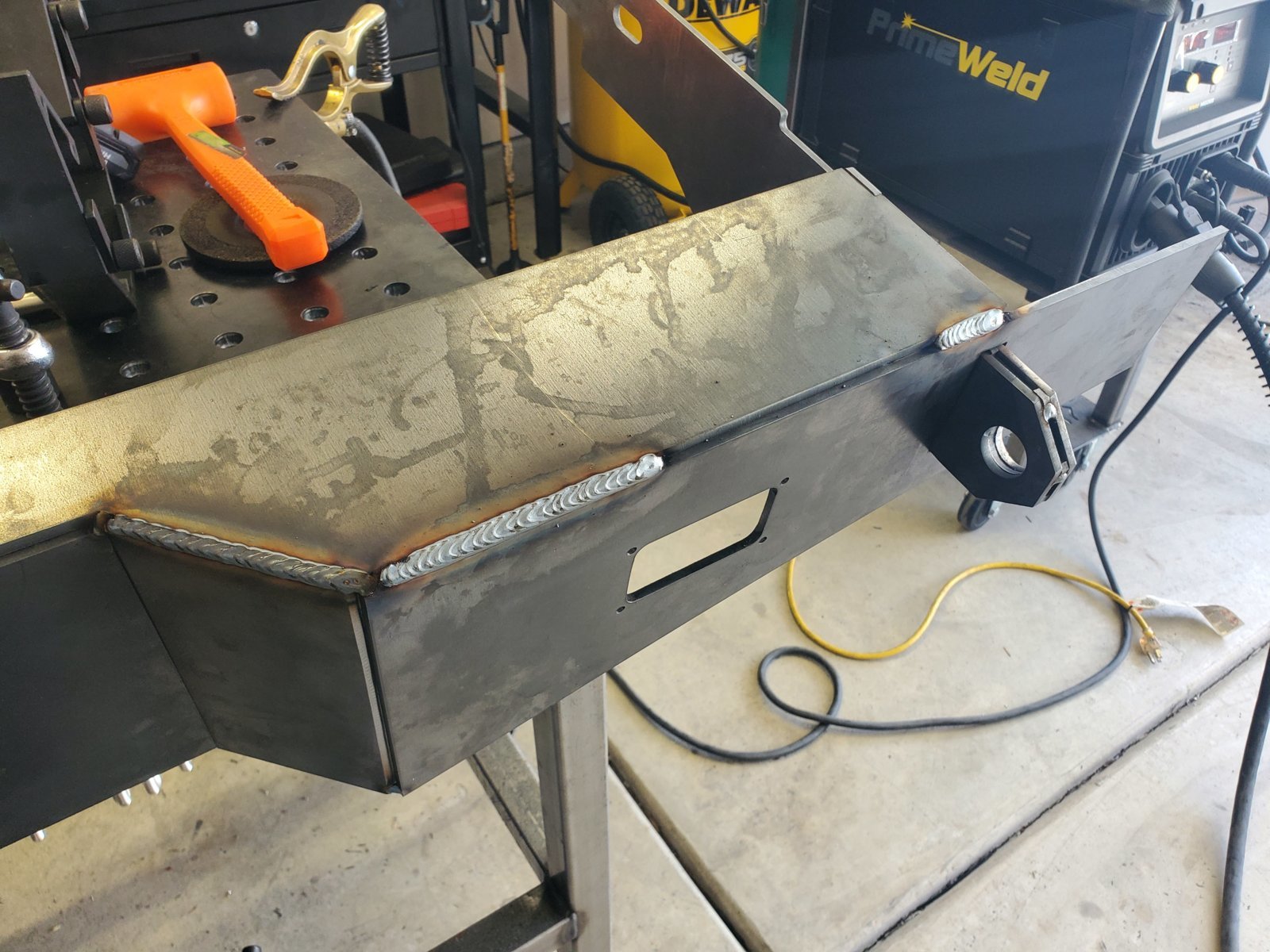

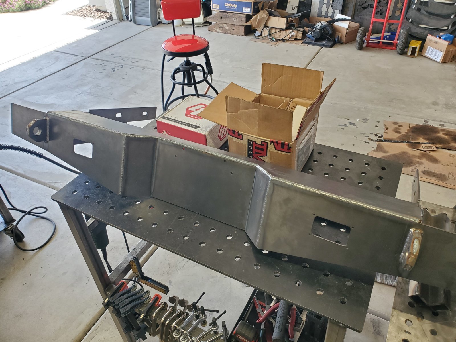

    Forget who was having trouble with blowing through open corners
    Fast and hot

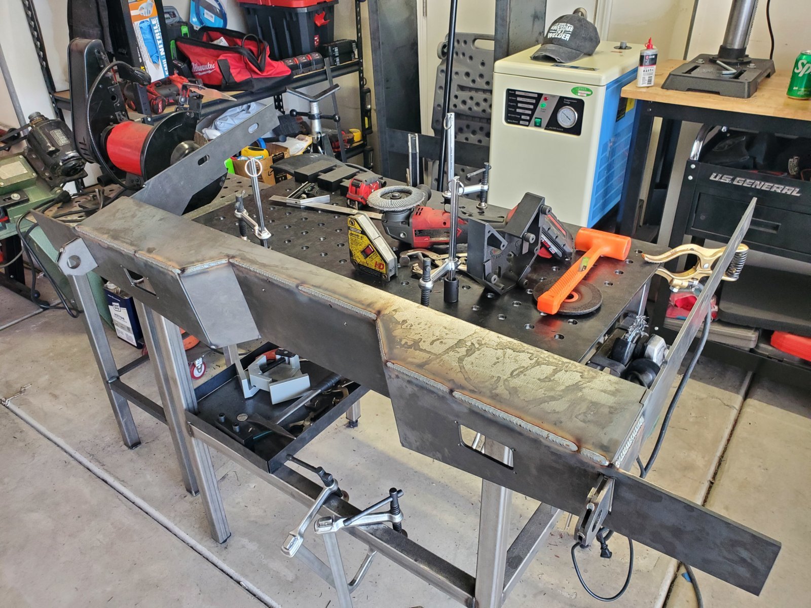

    She's done for today; need to get it mounted and start working up the wings for the swingout
    Followed by replacing the DOM for larger, and working on a bottom landing to prevent from hanging up on shit

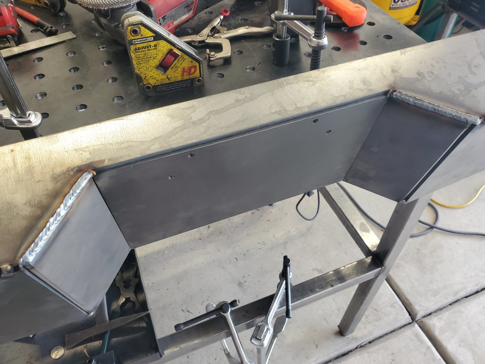

    I saw this before working this weekend and decided to give it a try. I think this is my new favorite.
    Any tips are welcome

    holy hell! those side plates are thick. Is that an artifact of the camera?

    Best tip?
    Time under the hood
    Next time, run it hotter as you can see the bottom plate is really thick as is the corner of the tube. It sapped the heat out laying it a tad cold, otherwise it looks nicely fused!
