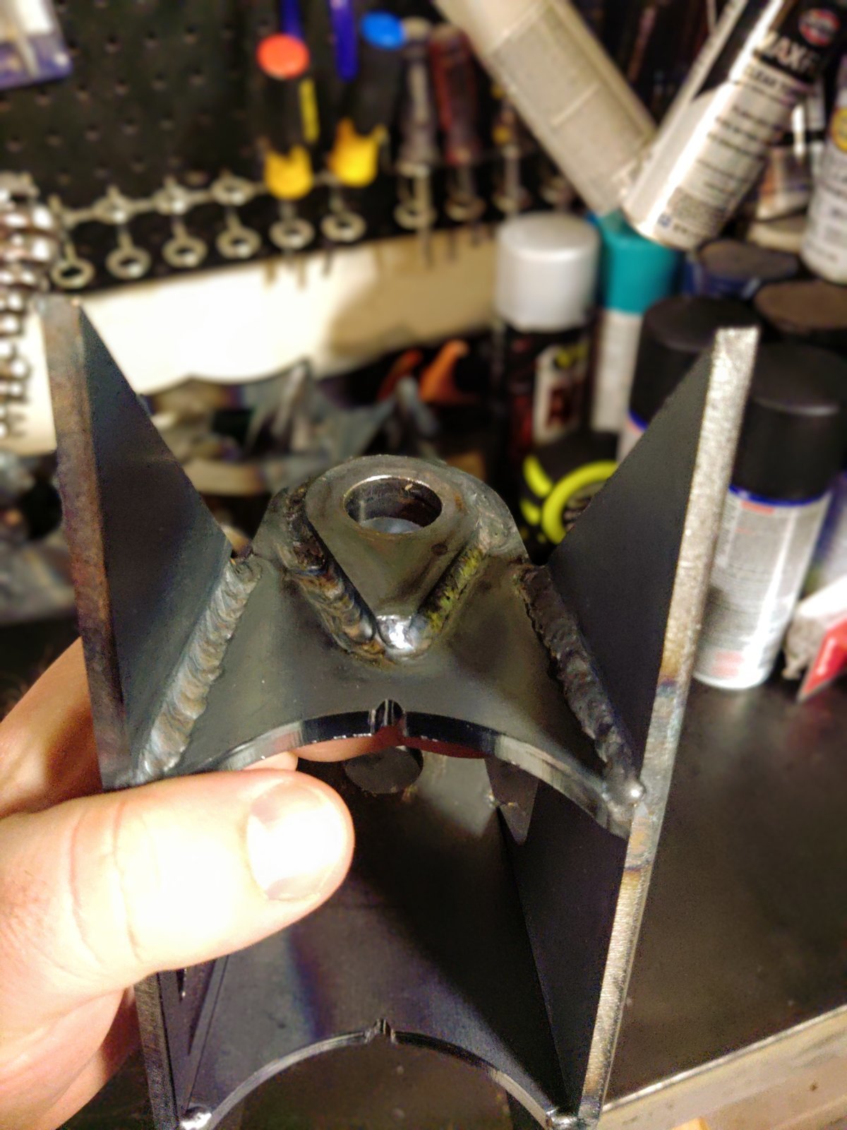

    Yep all 3/8 and is doubled up towards the rear to beef up the recovery points and to capture the tow bar. Was only a few lbs heavier than doing the same thing with 1/4"
    Loving my design with this one

    Could you point to where your seein this? I just want to learn what exactly to look for.
    Hood time wins for best tip, wish I could spend more time
    dk_crew likes this.
  3. May 6, 2024 at 8:08 AM
    Kwikvette
    Feb 27, 2019
    #284735
    81,614
    Fresno County
    4 run, 2 don't
    You moved a bit fast and whipped in large movements, and because of that the weld laid a bit cold as shown by the edges
    You can move at the same speed as you did above, but with quite a bit more heat
    The wall on that tube is thick, as is the chain loop there
    Still, that thing ain't going nowhere as its solid

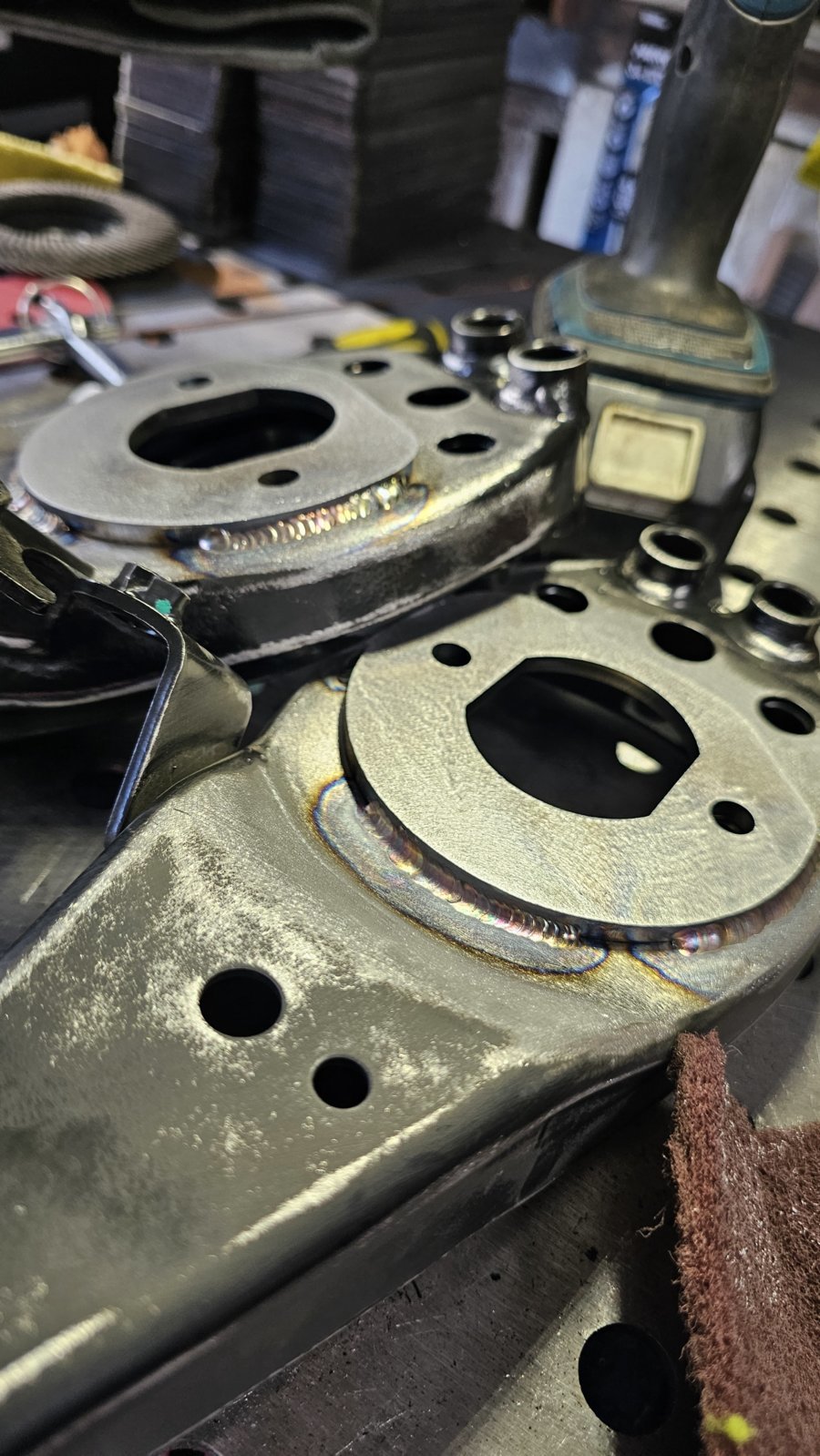

    Another set of arms this week. Got a random surge of orders our of no where. Seems to happen every now and then.

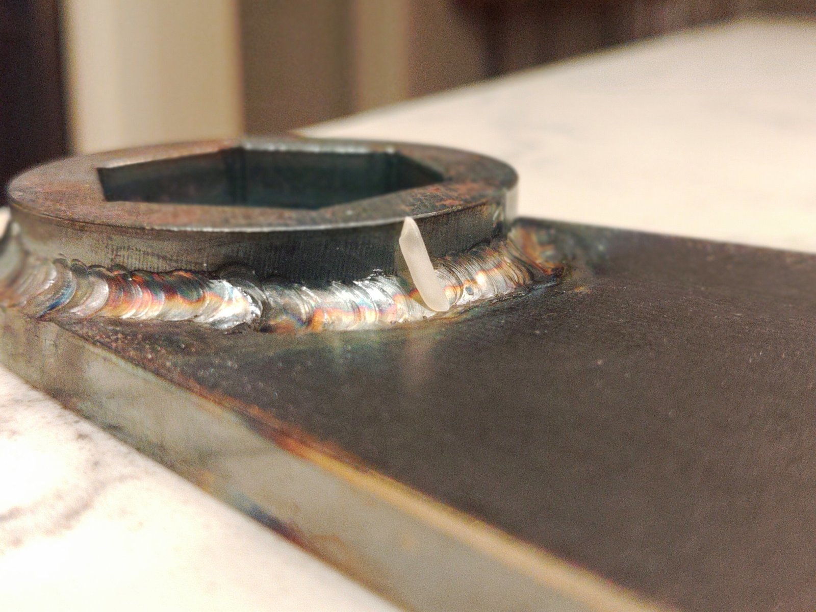

    can't remember if i posted these. been a crazy couple months working on back-halving/4-linking my '07, while also navigating our first child, now 6 months old.
    from a welding standpoint, there's nothing too unique about the build, just a bunch of tube and plate. the only bit that's thrown me off was welding the bolt head capture plates and weld washers on to the link brackets. i tried the first two with a full height fillet weld. it was alright for the bolt head capture plate, but for the weld washers, even the slightest bit of cut into the washer made the seating surface of the nut very tight. didn't want to risk the nut overhanging the washer, so i switched to a much smaller fillet that didn't affect the surface area of the washer.
    first time doing small welds. certainly a learning curve. 1/32'' filler rod was just making too big of a puddle no matter what i did, so i ended up using some .035'' mig wire. grain of rice for scale.
    weld washer side....
