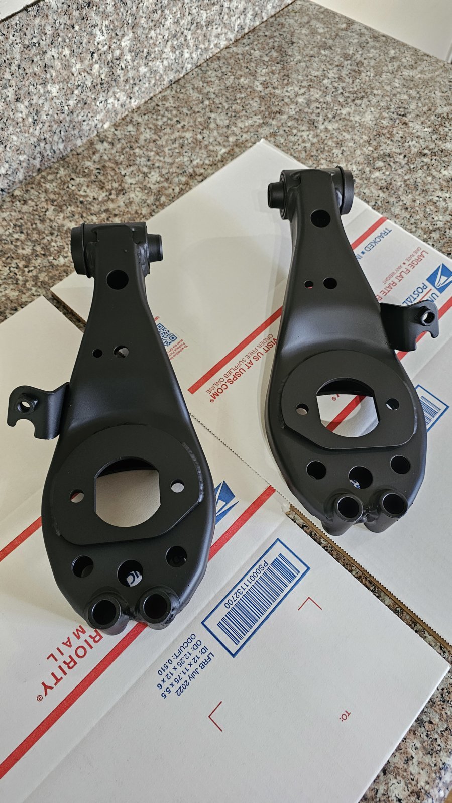

  5. May 7, 2024 at 8:28 PM
    mjbtaco
    mjbtaco low and slow
    Mar 21, 2008
    #5423
    4,827
    Michael
    Montclair , so cal
    Turbo'd 95.5 extra cab and 2013 Silver DCSB TRD Sport
    PERFORMANCE Custom Turbo Setup FRONT SUSPENSION Drop Spindles by Aaron Carswell 01-04 Swaybar Endlinks Energy Suspension Endlink Bushings Cando Upper Control arms QA1 coilovers with 8" spring Custom 4 pot Brembo BBK Modified lower control arms with mjbfab qa1 mounting plates and Poly bushing sleeves REAR SUSPENSION Chasis Tech drop leafs QA1 adjustable shocks weld in drop notch Gas tank cross member bridge 3" angled blocks 2013 Double Cab Short Bed TRD Sport Eibach Pro Truck Shocks front and rear Lifted to the 3rd setting on the front shocks
    I don't think I ever post the finished product before I ship em out lol. These went out to Florida.

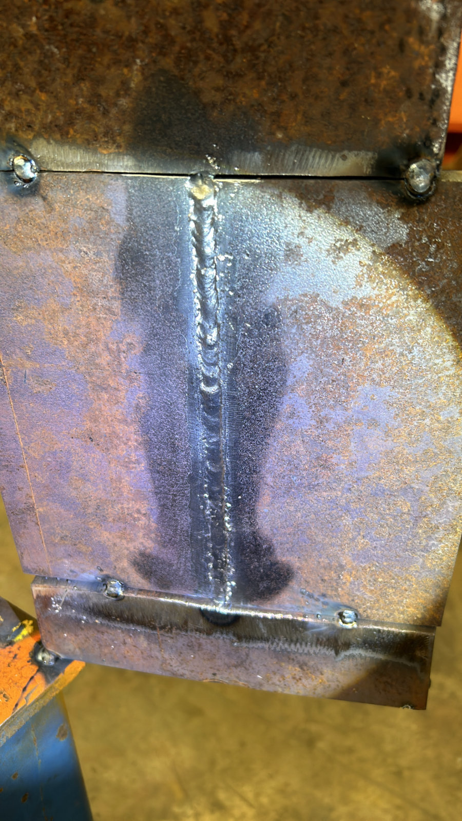

    3G plate test with FCAW. This is the first open root plate test I’ve taken since 2010. Root came out great, still have to skim it with a grinder and put a pass on the backside

    I admire the work each time these and your blocks pop up ... but I do wonder what vehicles these are for?
    mjbtaco[QUOTED] likes this.

    1/8" gap?

    3/32” gap, 1/16” landing. Wish I knew the settings but these machines here are junkers

    Heads up. Nobody open roots fluxcore ever. Mig root. Flux core rest of the way. Only time you use flux for the root is with a backing strap.

    Ah gotcha
    I've had to do those with either a 1/8" gap or 1/16" gap, same with the landings

    Yea, it threw me off when this place said they open root test. Every plate test I’ve done since 2010 has had a backing strip. They even handed me a WPS to follow lol. I did a 6G MIG root and FCAW the rest last week, they still haven’t bent the coupons yet. Guess they don’t care too much since I already got the job

    The arms are for 95-04 5 lug Tacomas to convert to coilovers. Blocks are pretty universal but most of my customers have Toyota trucks. They've fit all the way from first gen Hilux's to 2nd gen 5 lug Tacomas.
