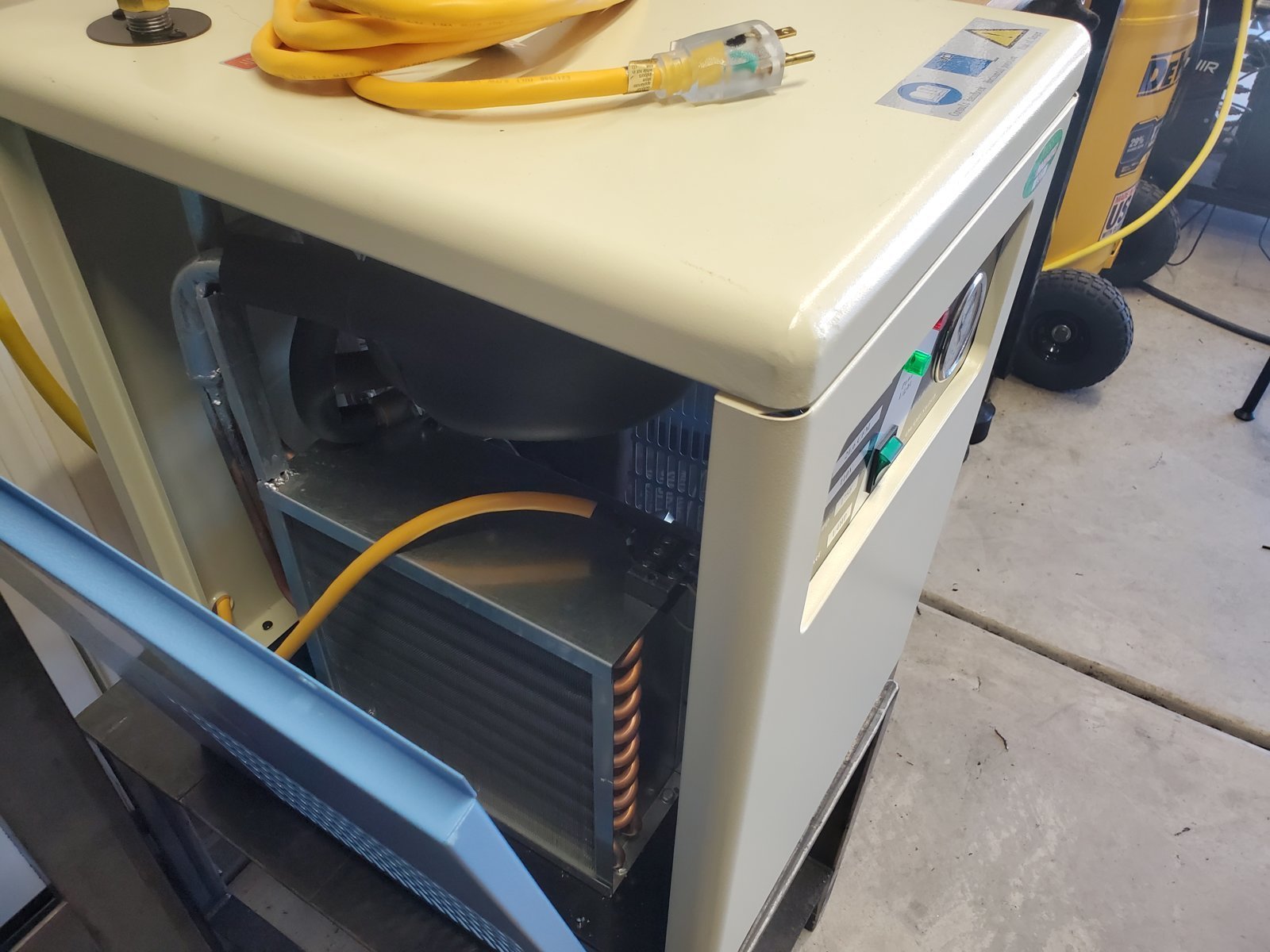

    If anyone opting to buy that refrigerated dryer from HF for CNC stuff, get yourself an extension cord and just chop it up
    The dryer doesn't come with one, and you get a longer, thicker gauge extension cord versus buying an open ended power cord

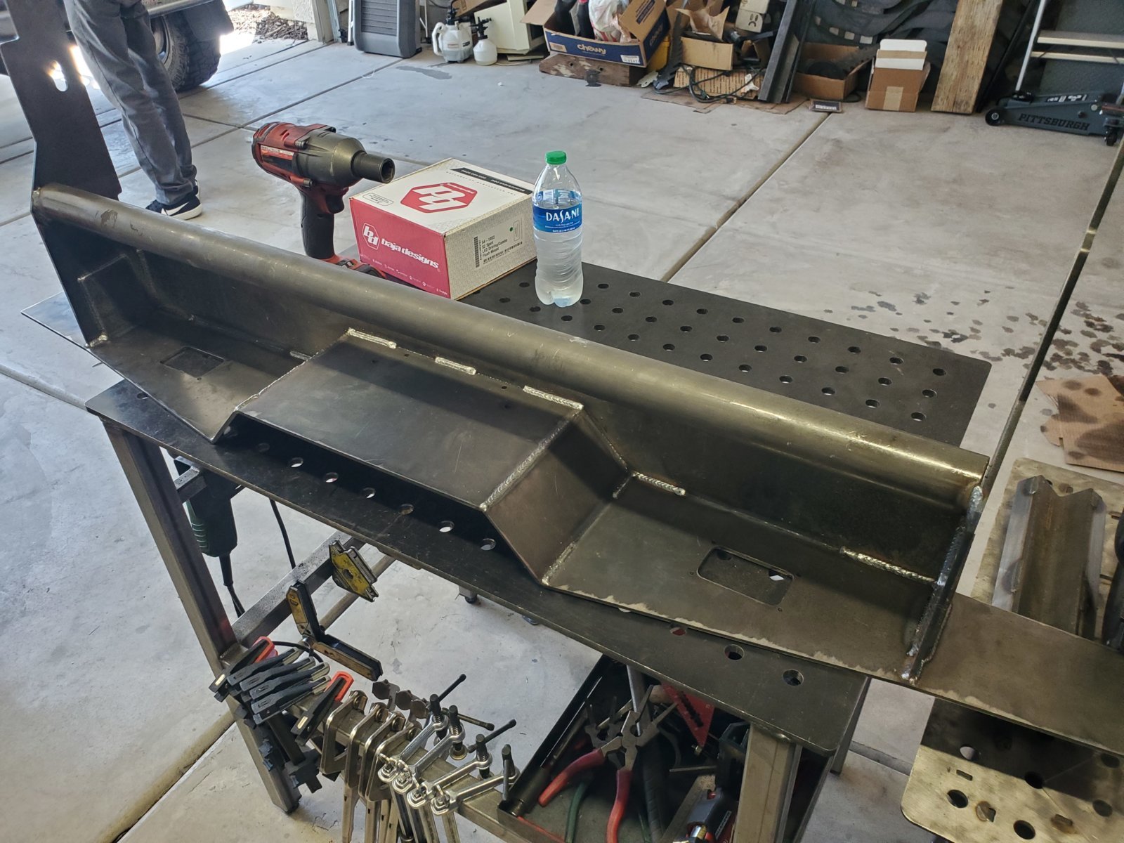

    koditten likes this.

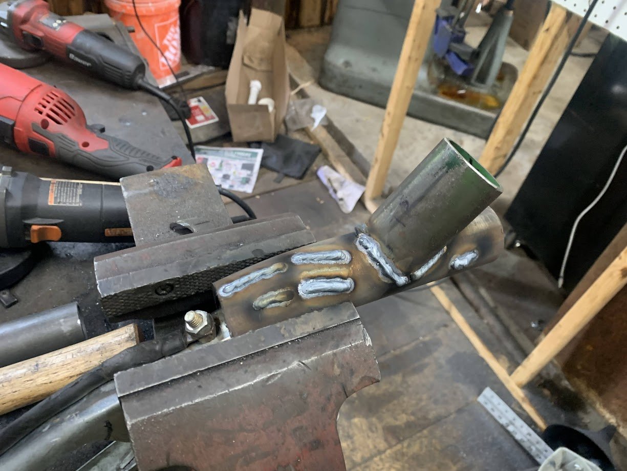

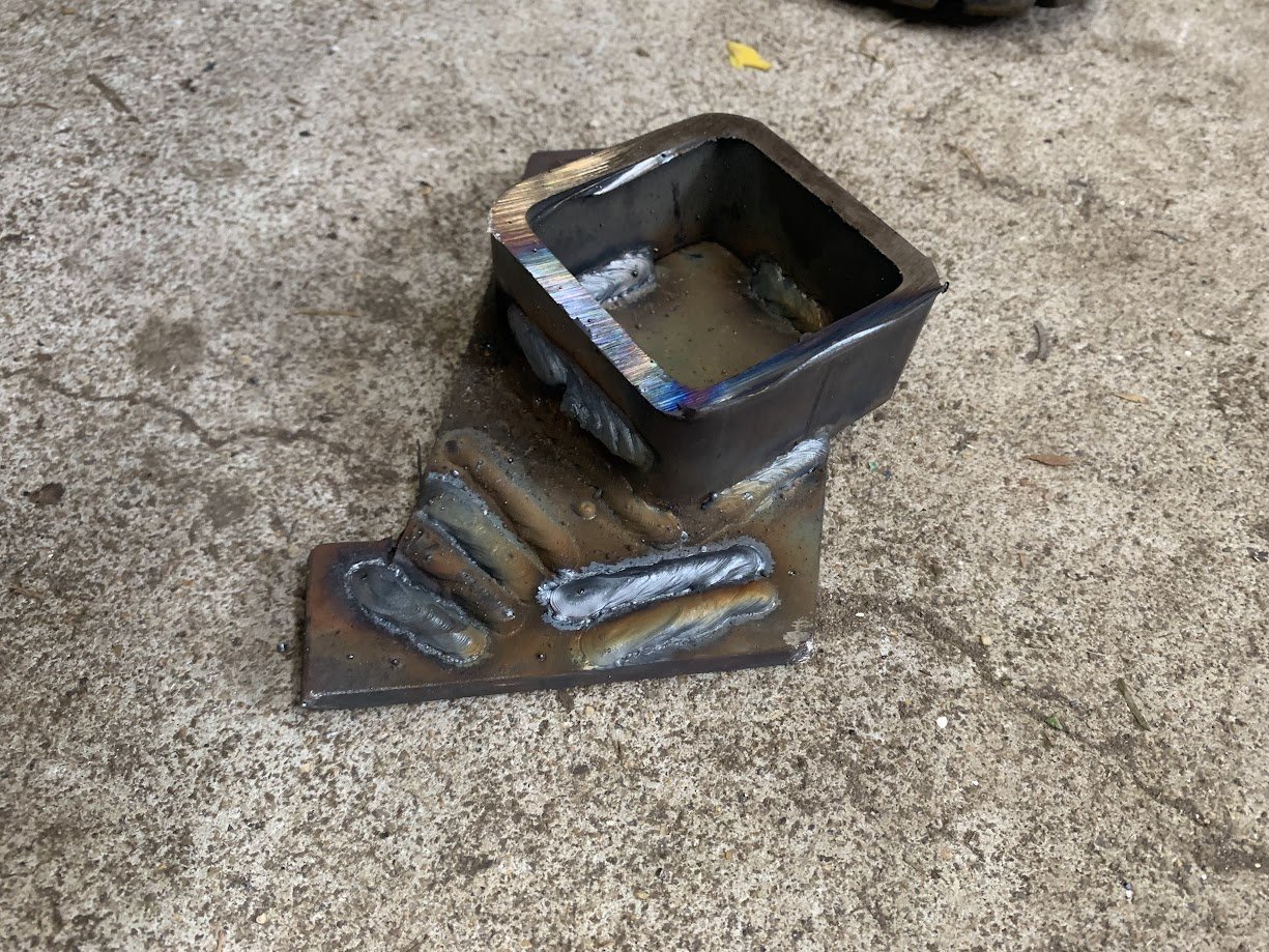

    Im having some issues welding this weekend. The welding doesnt sound right it sounds kind of spotty and the welds arent sitting down in the parent materials no matter the settings.
    I have tried
    voltage up/down
    wire speed
    gas flow
    welding 1/4 and 1/8
    changed the contact tip
    cleaned everything
    This is with a new bottle of gas
    Any ideas? I was screwing around with scratch start tig the other day so I hope I didnt screw anything up.

    Are your leads correct? They should be since there is some penetration from what it looks like.
    DC TIG runs straight polarity, so you'd swap your leads from MIG, and back over when you're done with TIG.
    I don't see anything wrong other than needing to use proper technique and more hood time?

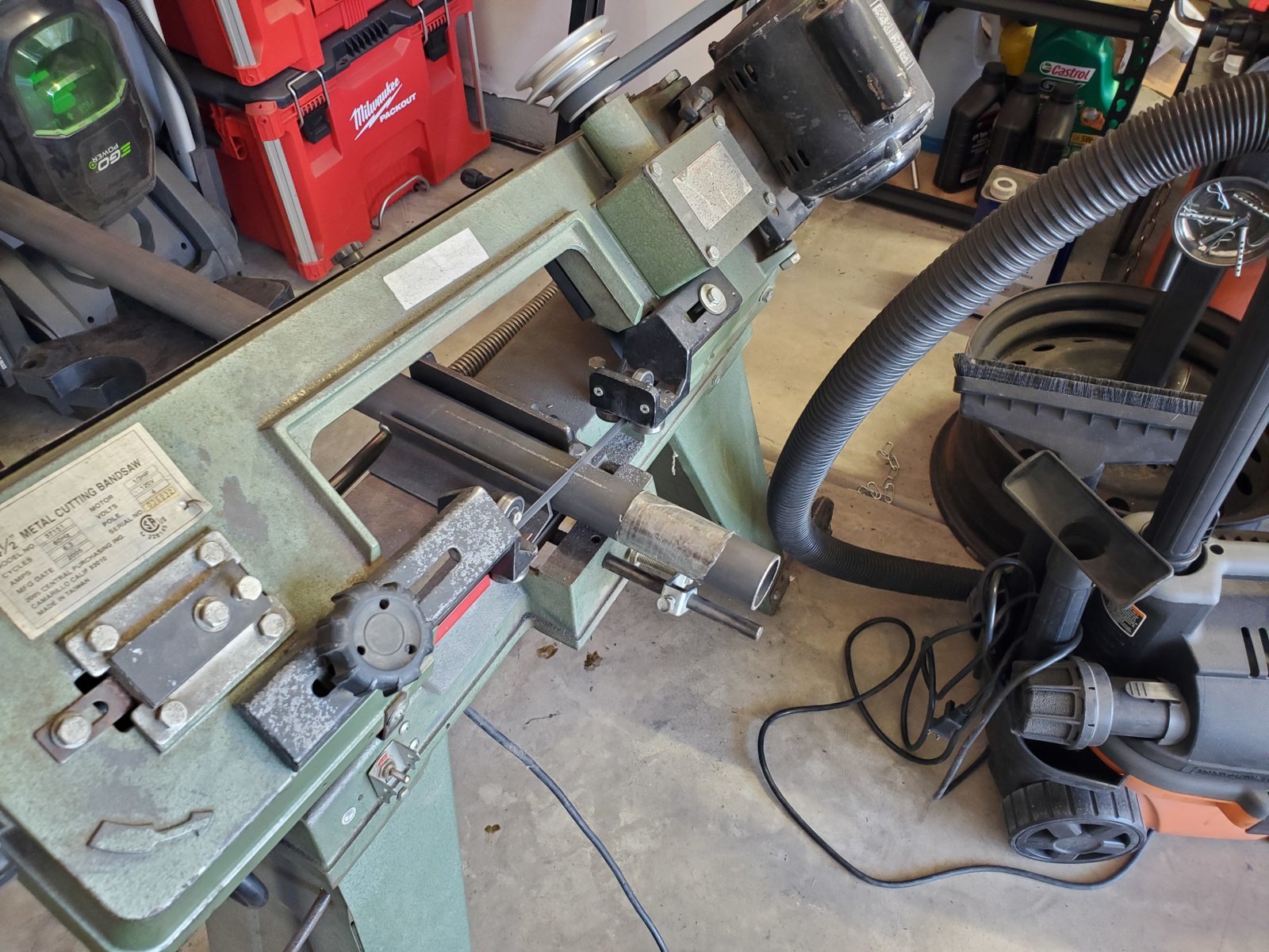

    Got the truck in earlier and the bumper fitment is on point so far
    Got some DOM cut as well, and removed the black pipe I had used as a placeholder

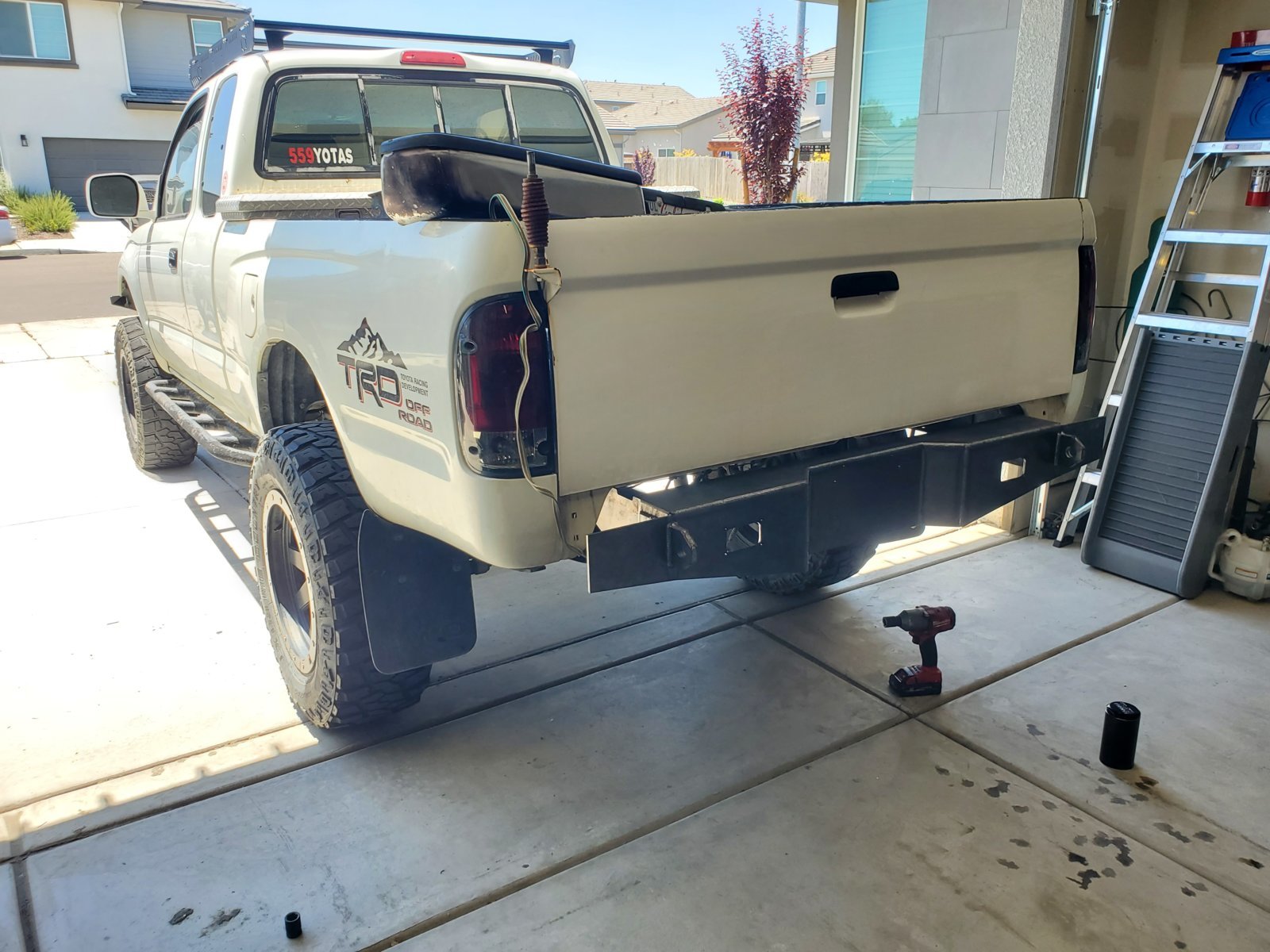

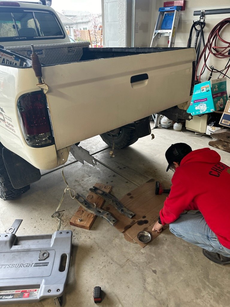

    Buddy got some pics of me lol here's the first visit when I gathered measurements for everything
    Followed by the second visit earlier today
    Back on the bench and back to working up the wings on CAD. The swingout will go on the right side of the bumper and it will carry a spare tire along with a small fold out table on the inside.

    it looks to me like you're running the welder 'reversed', where the grounding clamp goes to the positive, and the gun loop is attached to the negative. it's how it should be set up for flux core, but opposite for mig. i did the same thing when i switched over from flux core to mig, and couldn't for the life of me figure out why my beads were standing up so high and not laying right.

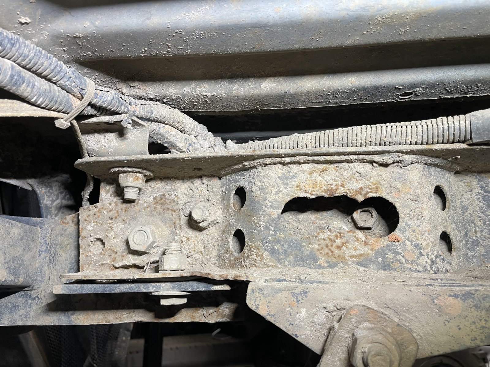

    Trying to reverse what a much younger me did. I put new holes in the frame of my truck to make a rear bumper work with a (now removed) body lift. I would like to replace the bumper with a different style and use the stock mounting locations. How would you guys go about fixing this? Will welding a piece of flat stock to the back side of the frame provide enough reinforcement?

    A picture backing up a bit to show the setup in its entirety would really help

    Like I mentioned the other day, it sounds like 1 of 2 things -
    Either your leads are switched, or your wirespeed is way off in relation to voltage and the metal thickness
    I normally run a good 50-100ipm more than suggested
